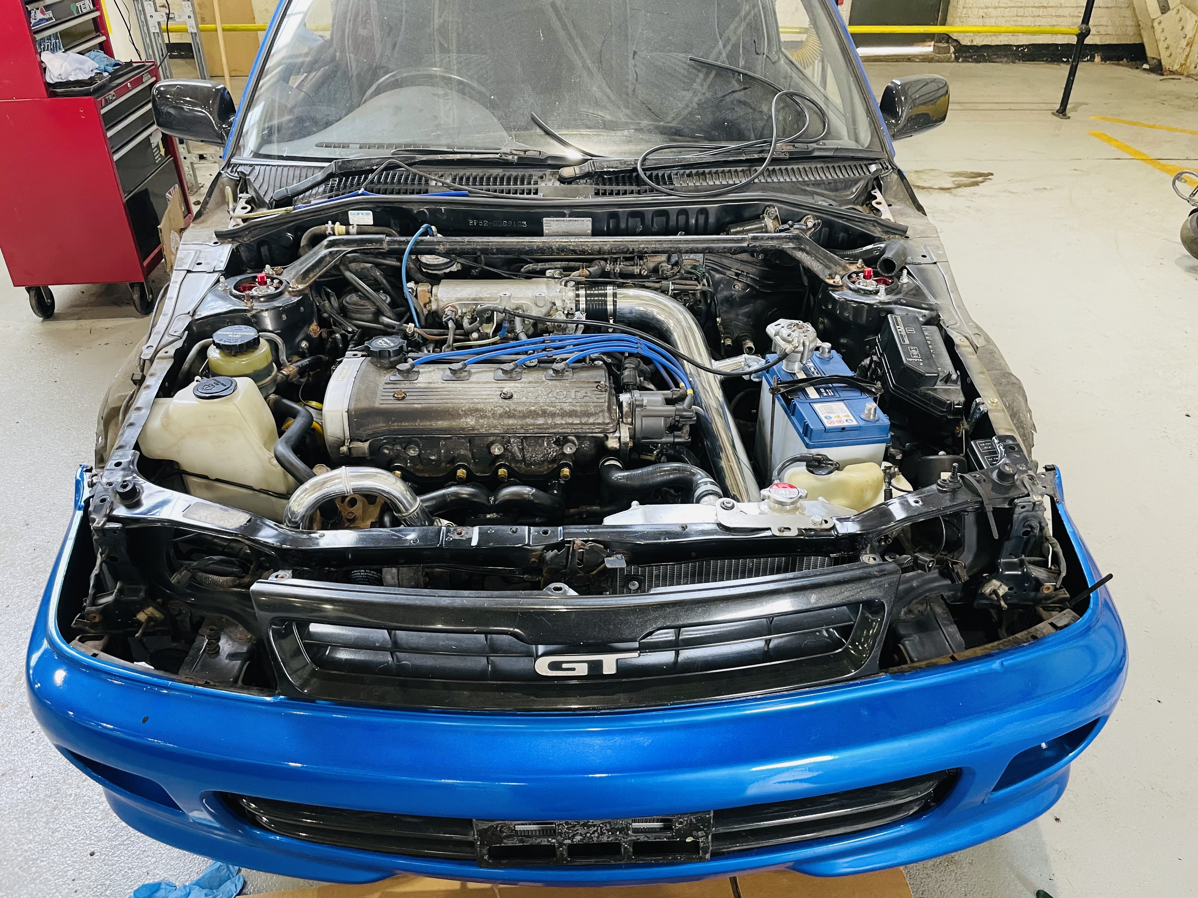

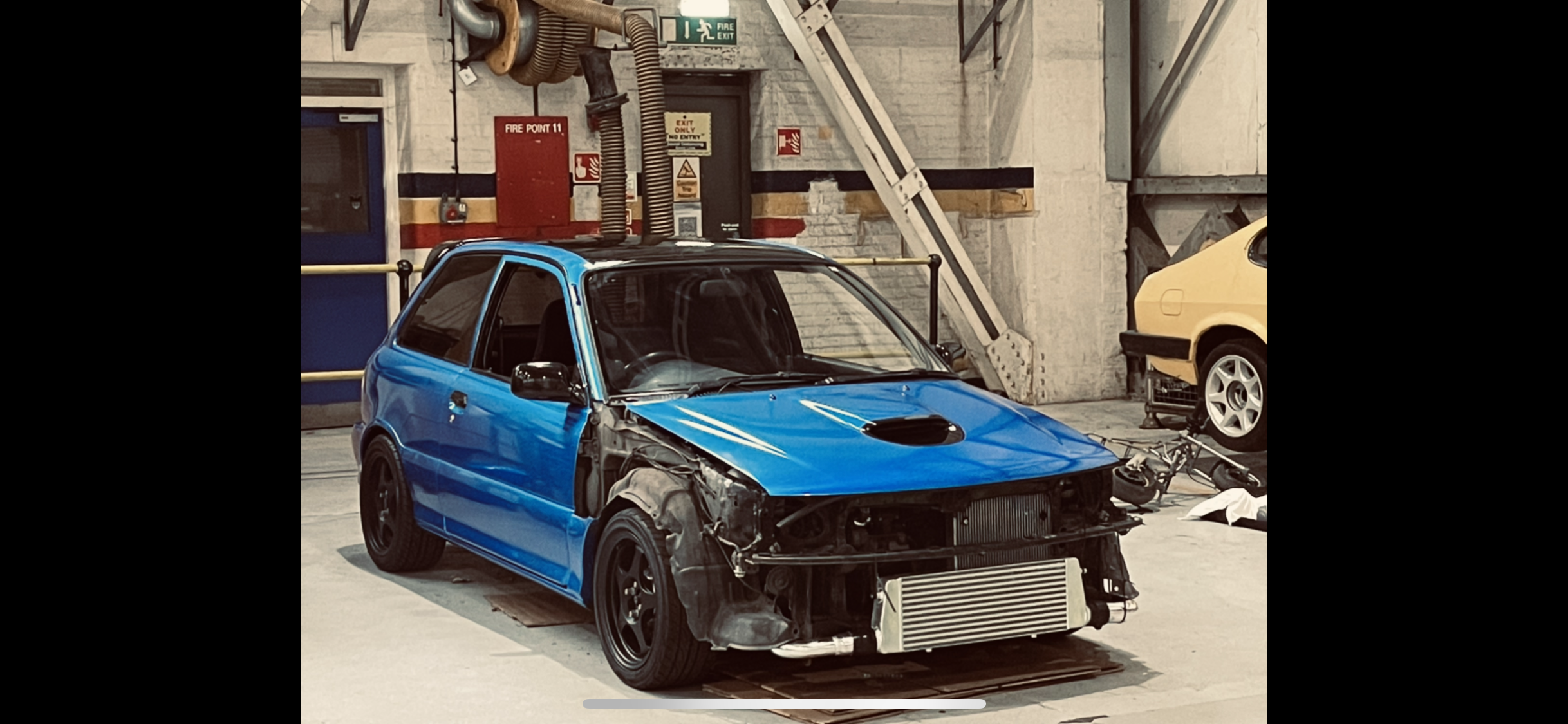

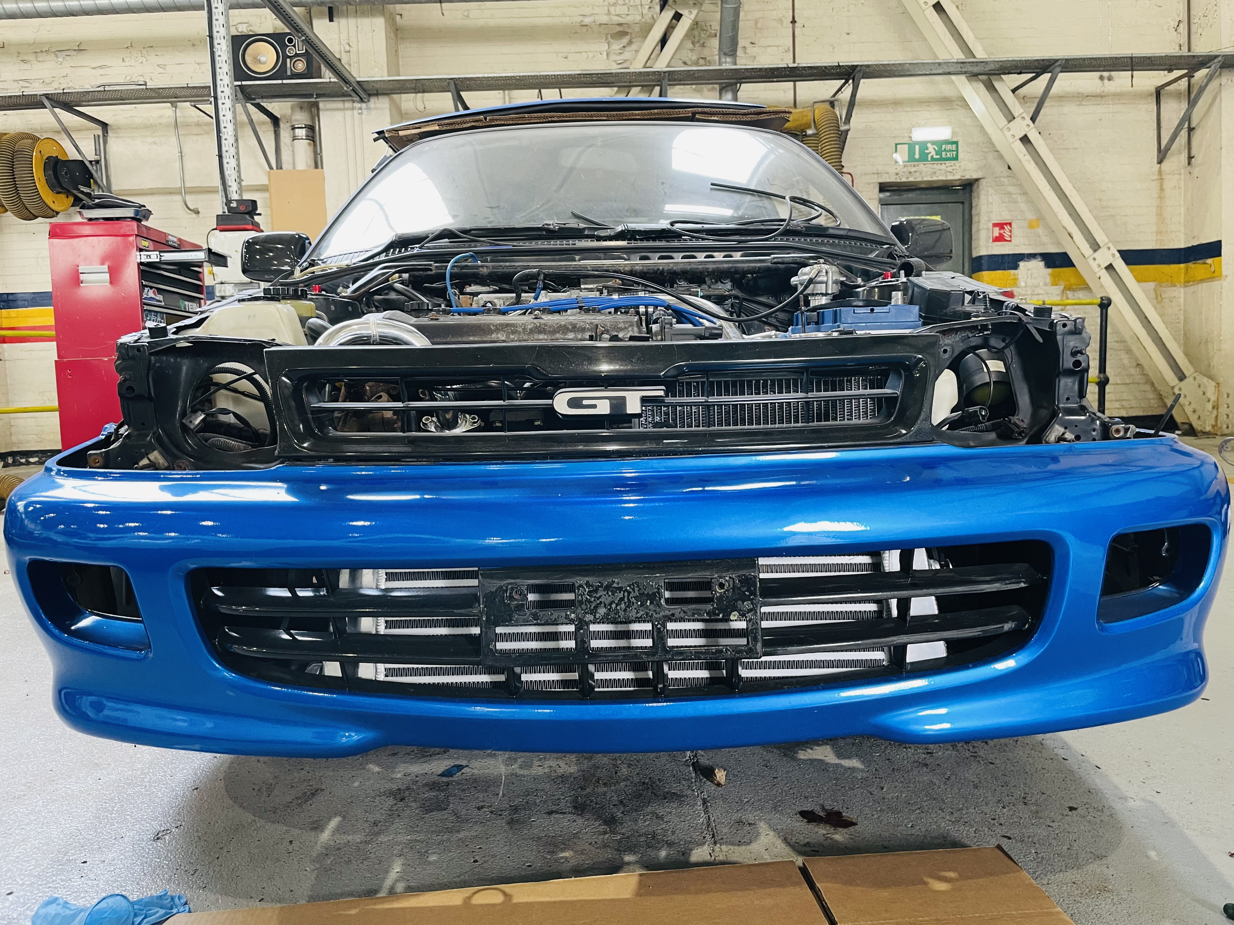

Pikey009 Posted April 13, 2021 Author Posted April 13, 2021 Plenty of space left for my custom intake Quote

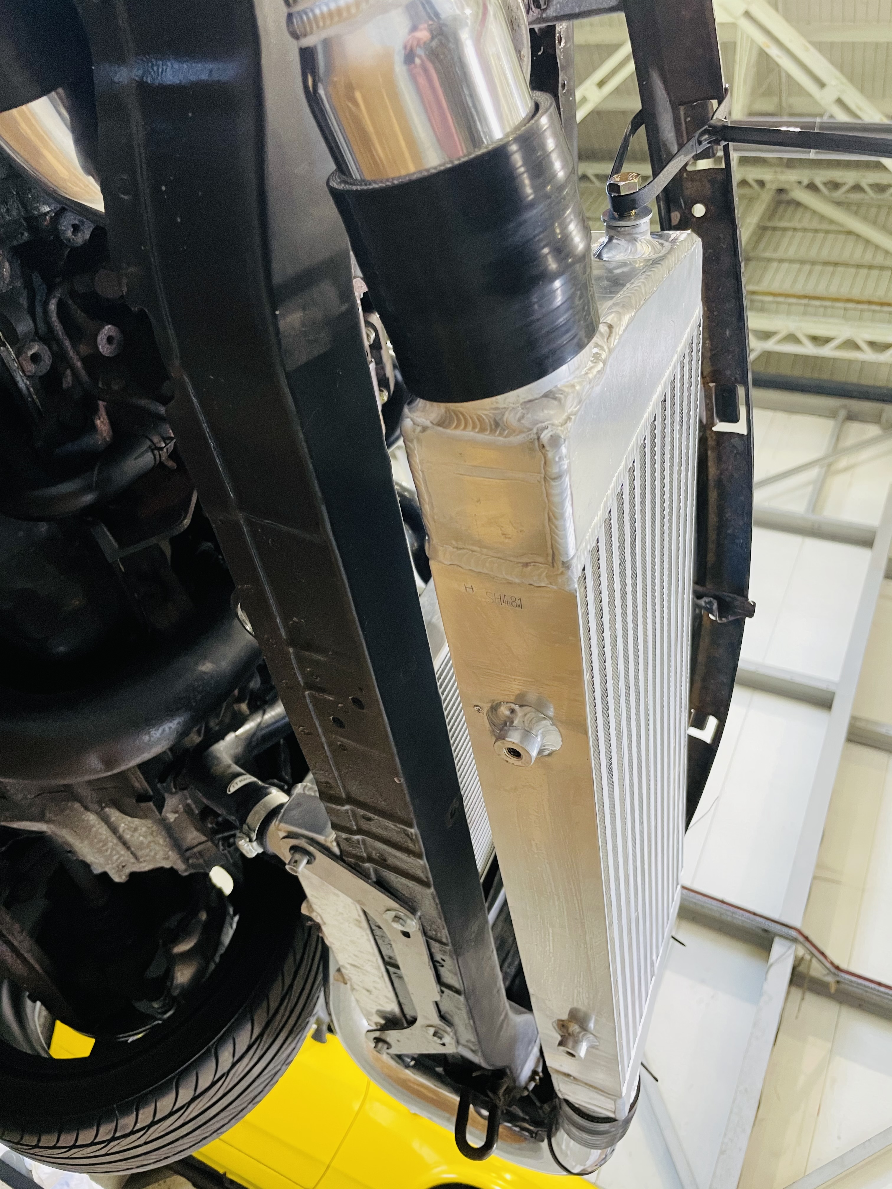

Pikey009 Posted April 13, 2021 Author Posted April 13, 2021 I’ll be using all 4 mounts: 2 underneath will bolt near the lower rad bracket and the upper 2 will bolt to the bumper mounting bar anchor points. the brackets they give you are pretty much useless which I was fully expecting. I’ll post pictures of the brackets once I’ve made them. Quote
Pikey009 Posted April 13, 2021 Author Posted April 13, 2021 The bumper almost fits on but just needs a little trim on the lower section for it to sit flush Quote
SKINY Posted April 13, 2021 Posted April 13, 2021 Lol I thought the bumper would just need a wee trim too when I put the fmic on 😅😶fuck was I wrong bud Quote

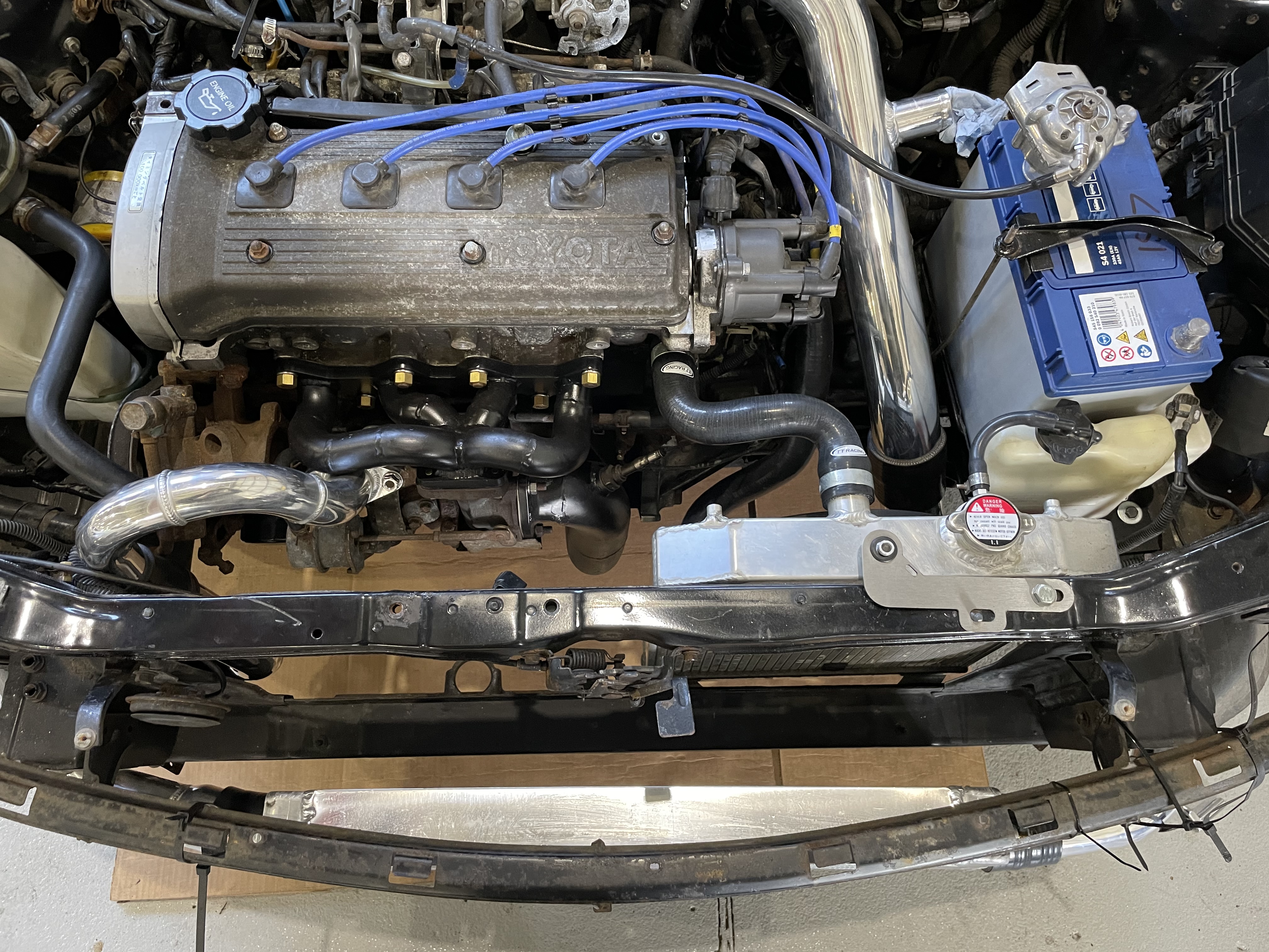

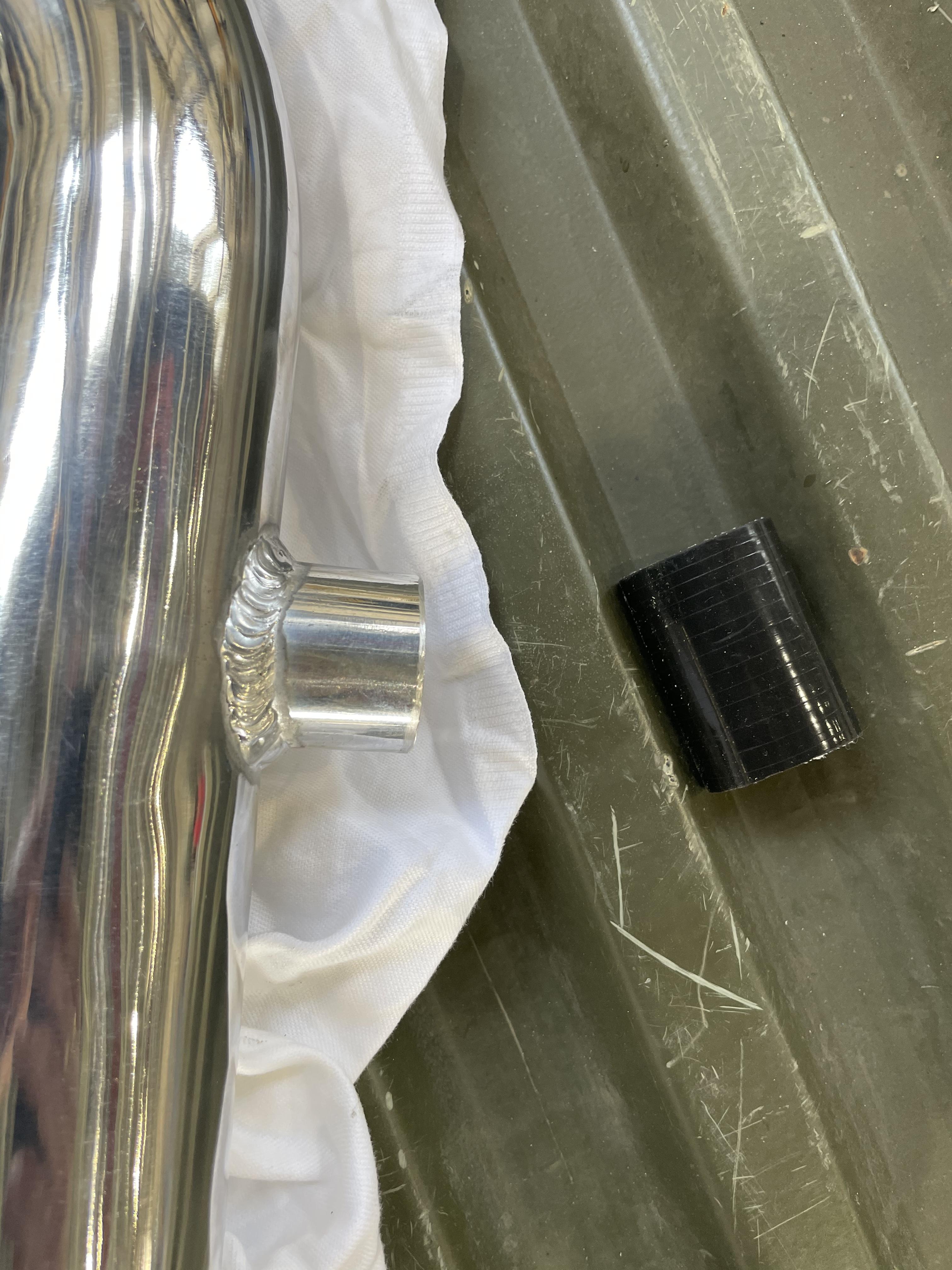

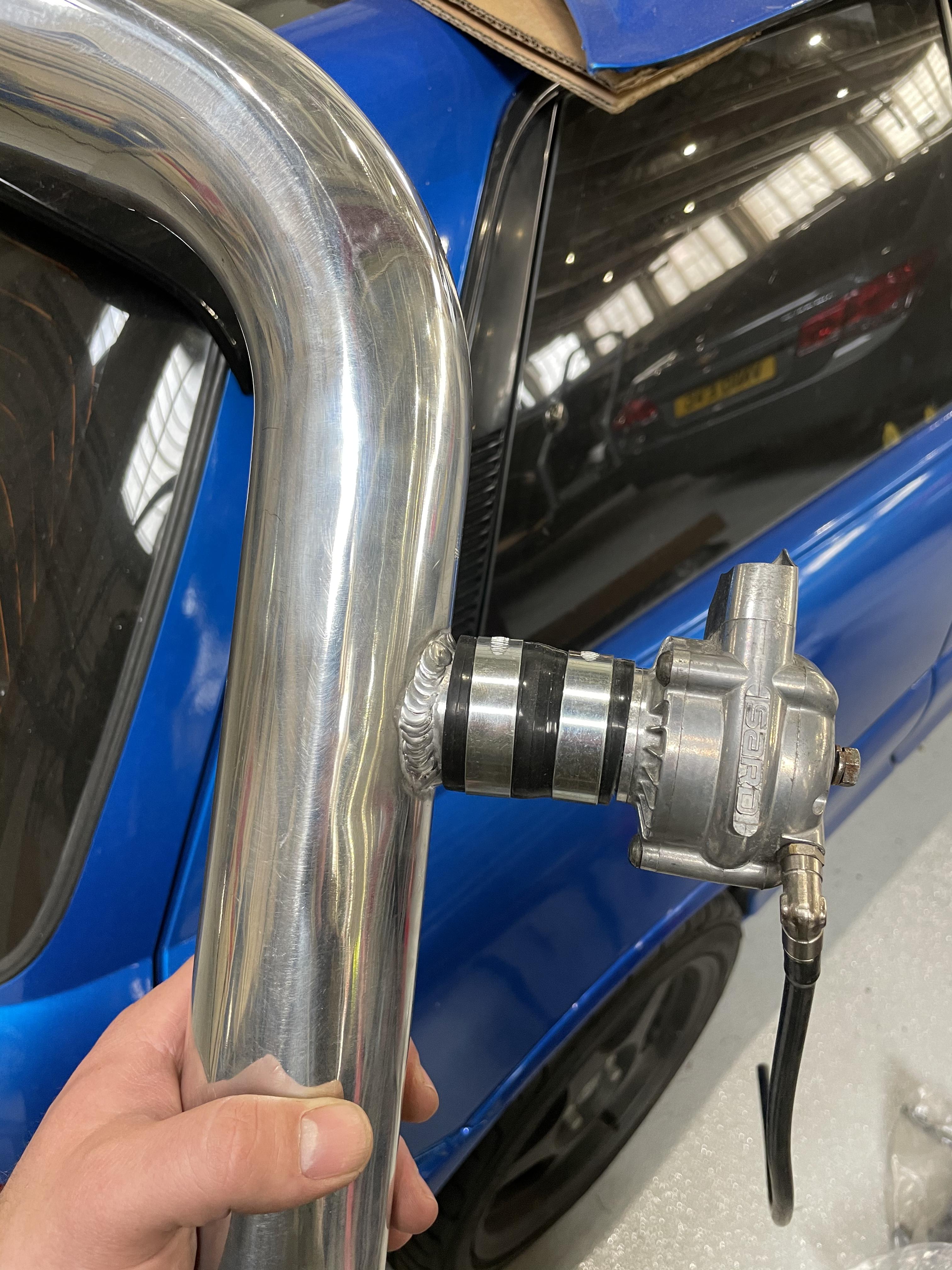

Pikey009 Posted April 23, 2021 Author Posted April 23, 2021 I’ve had to trim the bov pipe on the intercooler pipe work so that it doesn’t fowl the catch can. Once the cooler is fixed in place it will give me a little more room to play with. Quote

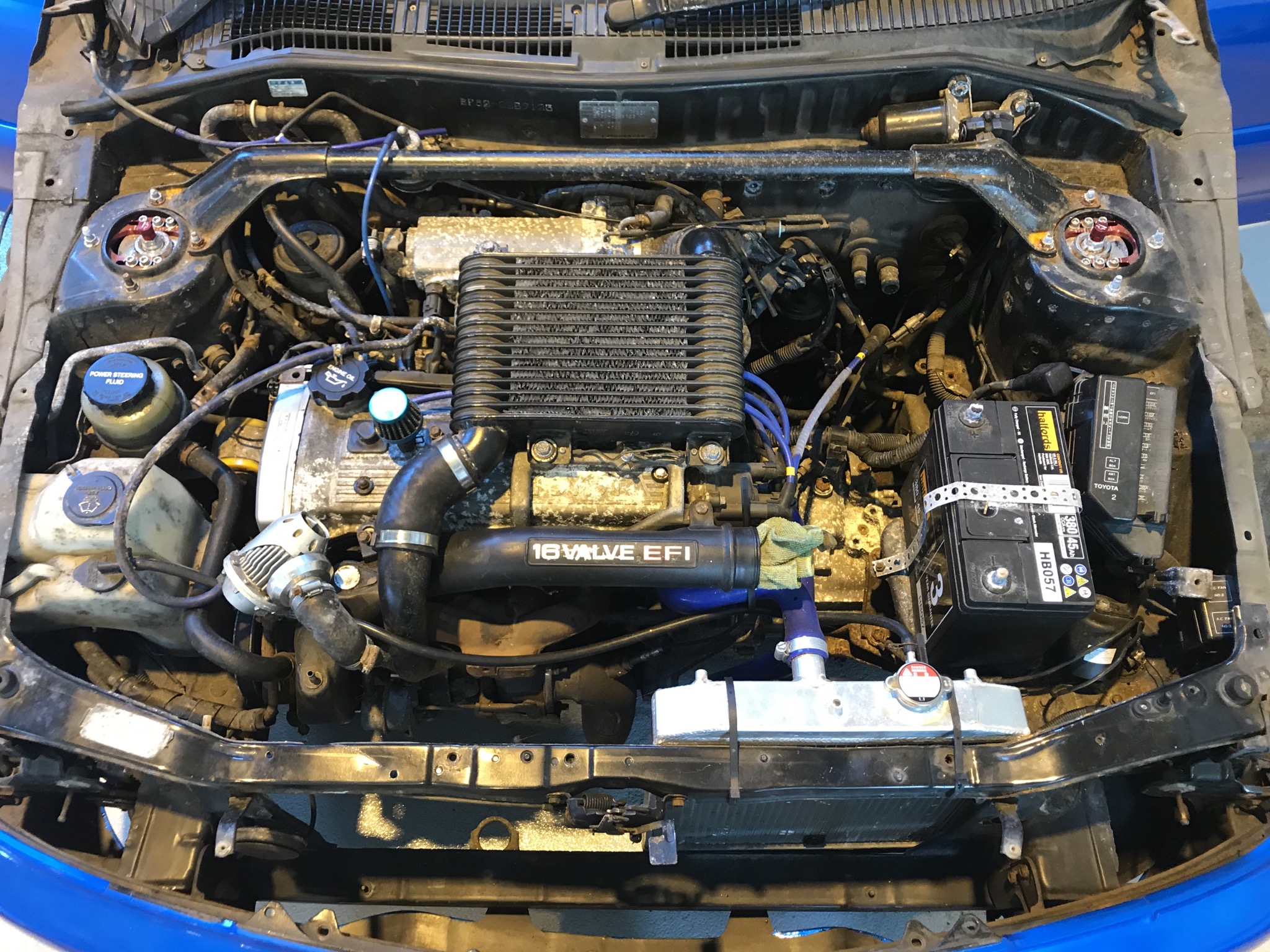

Pikey009 Posted April 23, 2021 Author Posted April 23, 2021 I’ll re-rout the vac line to tidy the bay up a bit more and then hopefully fit the rocker next week. This is how the bay sits at the moment, catch can fitted along with the powder coated strut brace and new top mount nuts. Quote
SKINY Posted April 23, 2021 Posted April 23, 2021 Looking well now bud, did you rough the cut down blow of pipe up so the blow of valve wont blow of now you have the lip off read that pissed Quote
Pikey009 Posted April 23, 2021 Author Posted April 23, 2021 I have no idea what you just said lol Quote

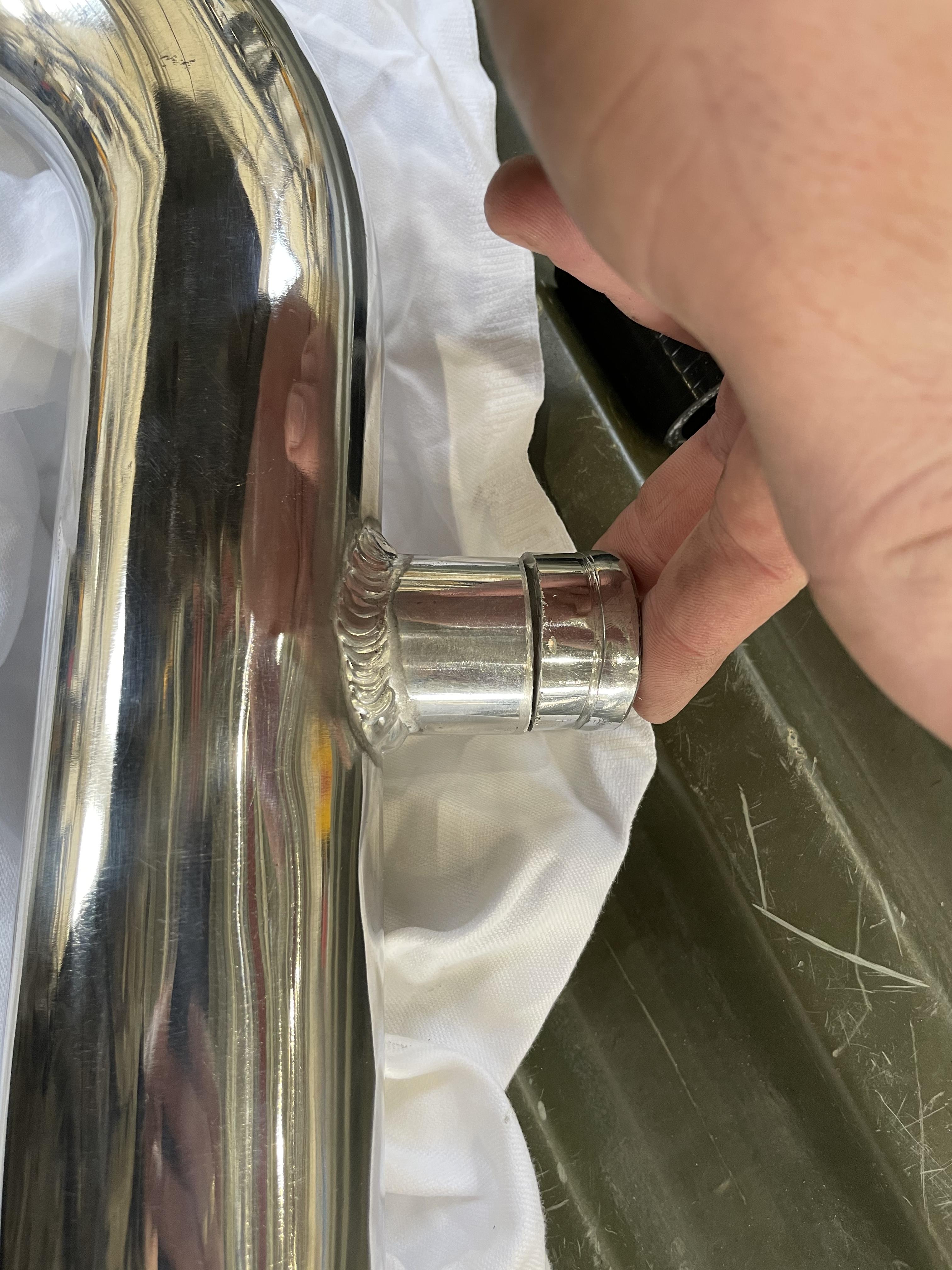

Pikey009 Posted April 23, 2021 Author Posted April 23, 2021 It’s a v v tight fit for the silicone pipe on the IC pipe work (I had to soak it in hot water to get it on and put it on with a mate). Perfect fit for the bov side and that still has the lip on it Quote
burty Posted April 24, 2021 Posted April 24, 2021 Such a tidy install mate really looking forward to see this to say you randomly got it the effort your putting in is great Quote
SKINY Posted April 25, 2021 Posted April 25, 2021 On 4/23/2021 at 8:45 PM, Pikey009 said: I have no idea what you just said lol Lmfao The intercooler pipe where you cut it to make the dump valve fit, you have took the lip off that seals it. Have you roughed it up a bit so the pipe has enough grip Quote
Sam44 Posted April 25, 2021 Posted April 25, 2021 the old school bov valves do look the bollocks. im running the old school hks unit. built to last. Quote
Pikey009 Posted April 26, 2021 Author Posted April 26, 2021 (edited) 17 hours ago, SKINY said: Lmfao The intercooler pipe where you cut it to make the dump valve fit, you have took the lip off that seals it. Have you roughed it up a bit so the pipe has enough grip 🤣 yeah it’s properly on there with a decent clamp too. But there’s only one way to find out I guess! As the metal is quite thick I’d be able to machine another small ridge anyway if I need to Edited April 26, 2021 by Pikey009 Quote
Pikey009 Posted April 26, 2021 Author Posted April 26, 2021 12 hours ago, Sam44 said: the old school bov valves do look the bollocks. im running the old school hks unit. built to last. Yeah I was really lucky to find the Sard to be honest, was exactly what I was after. the stock gt4 bov’s disconnected to atmosphere sound great if you’ve ever heard one Quote

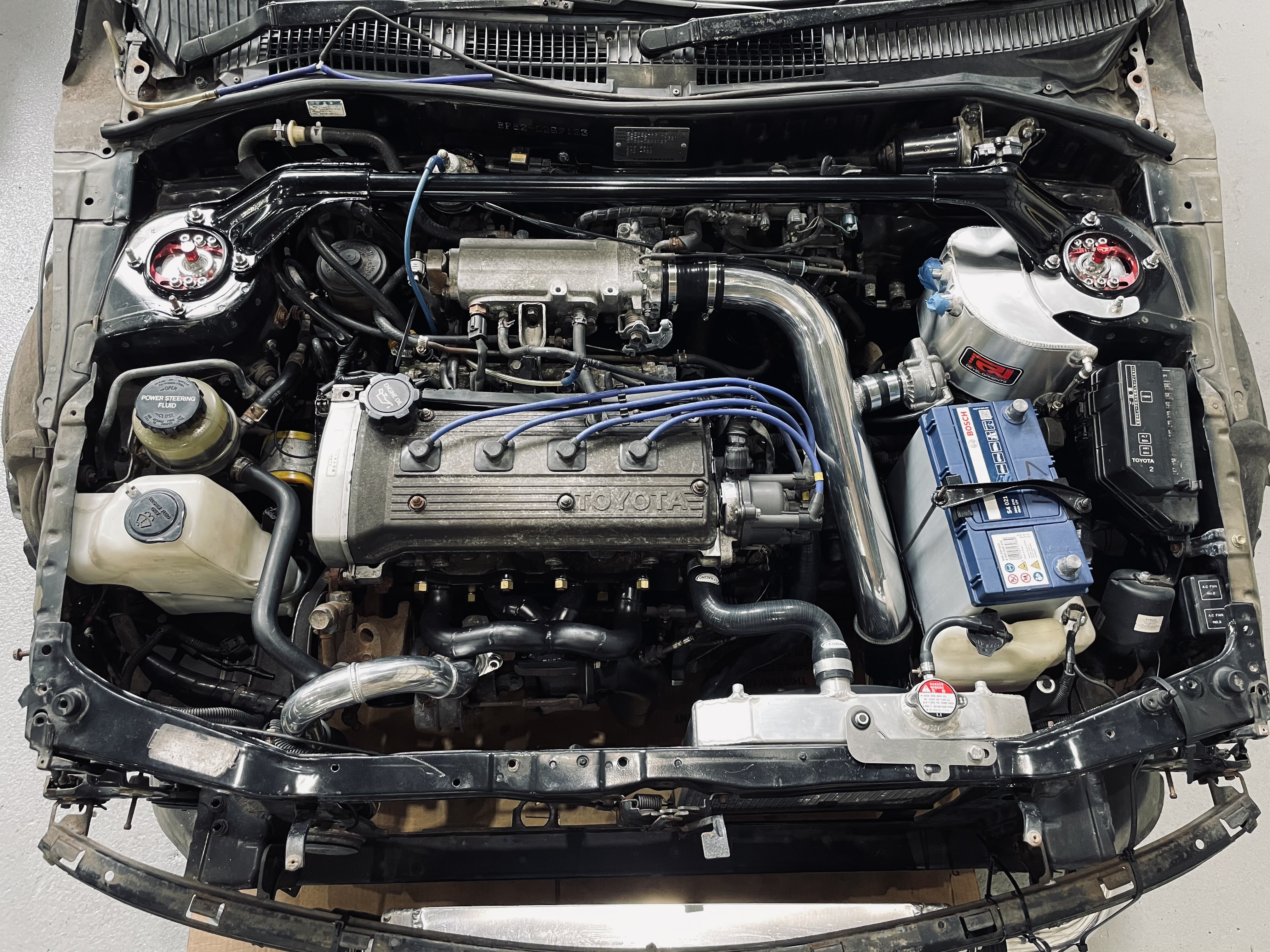

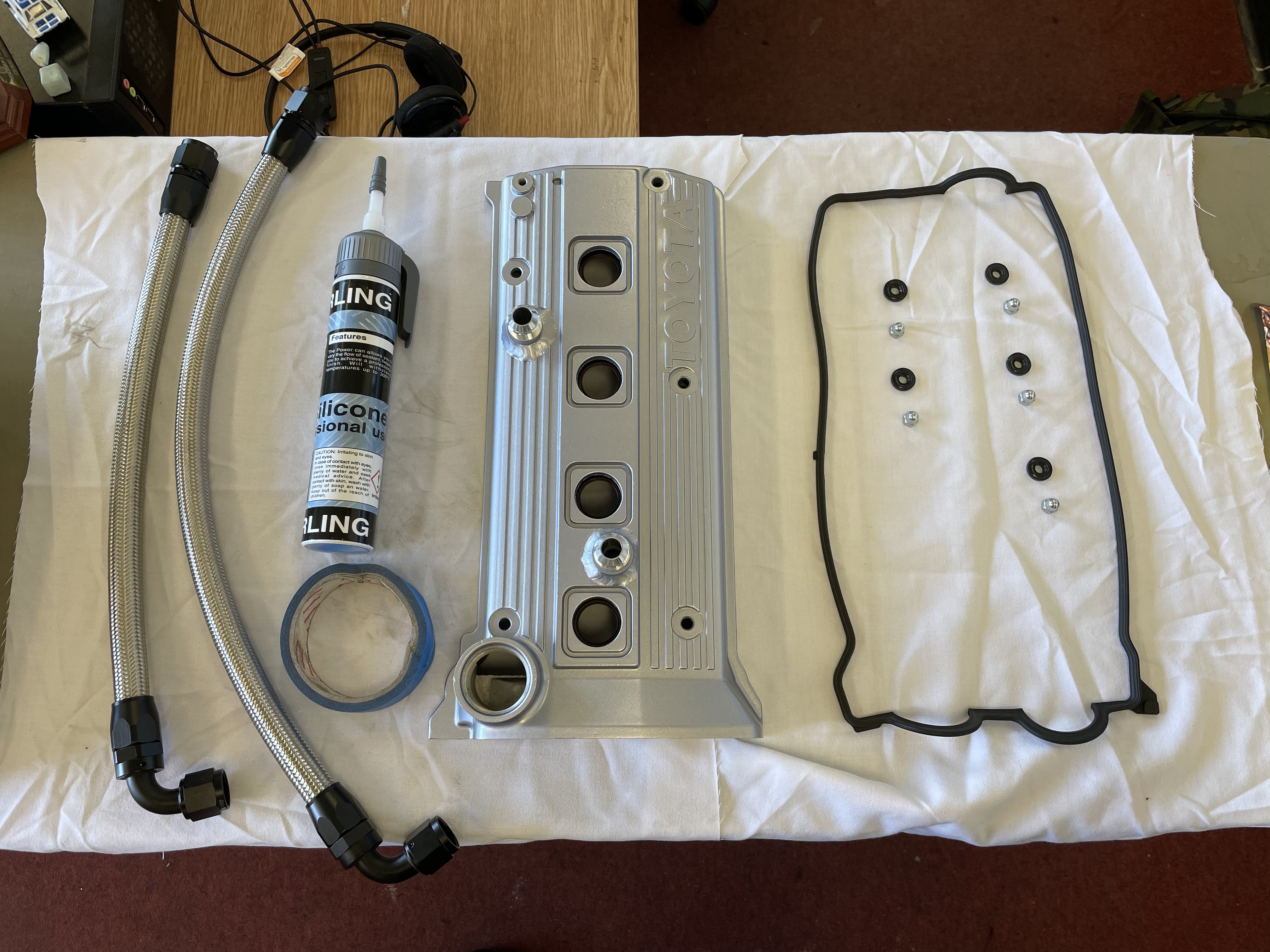

Pikey009 Posted April 26, 2021 Author Posted April 26, 2021 Today’s lunch time job: Fit the rocker finally. Quote

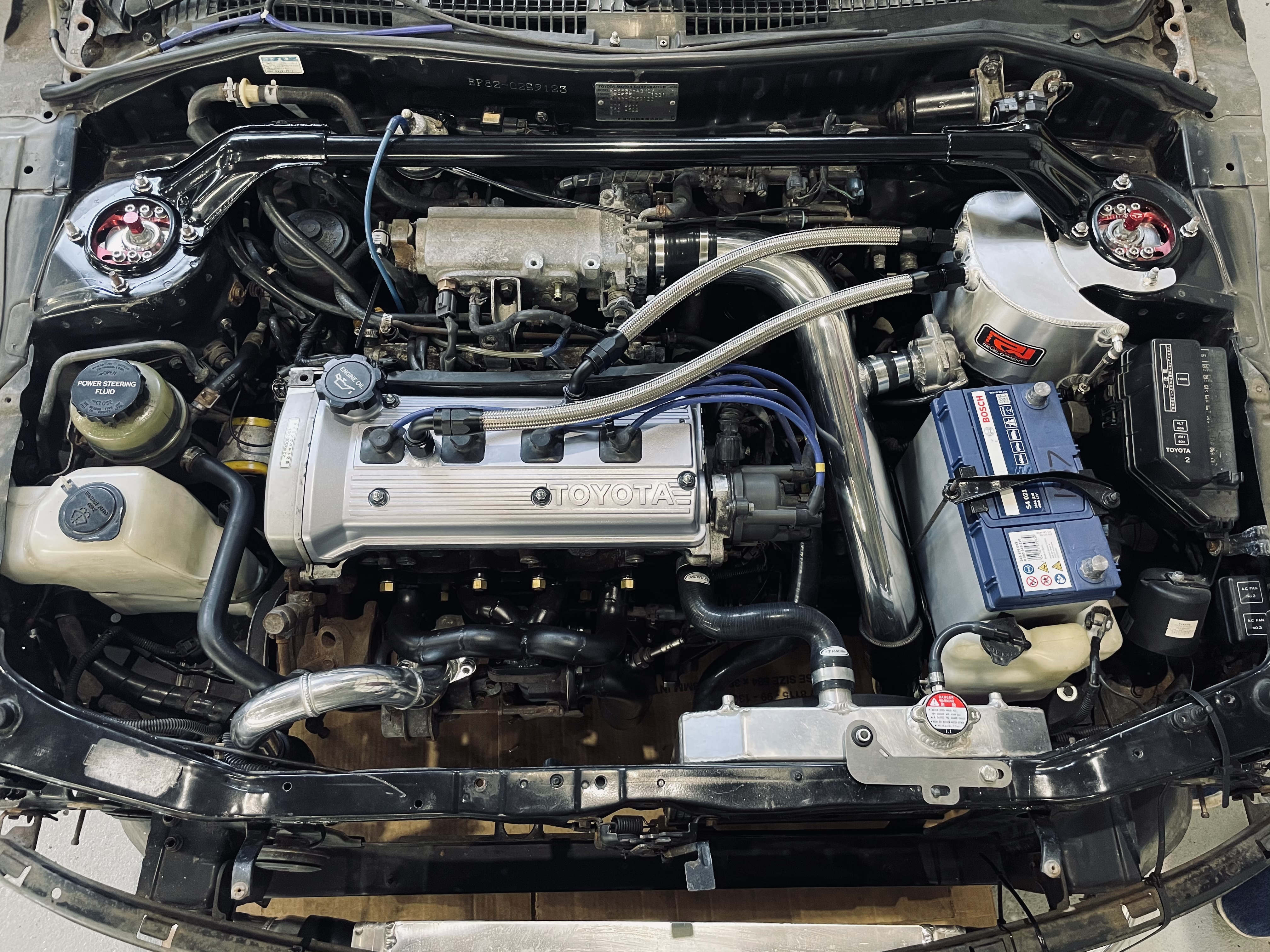

Pikey009 Posted April 26, 2021 Author Posted April 26, 2021 (edited) So, first engine bay pic compared to the current one: Edited April 26, 2021 by Pikey009 Quote
Pikey009 Posted April 26, 2021 Author Posted April 26, 2021 I’ve still got some wiring to tidy and bolts to replace along with finalising the intake. Quote
Dale SR Posted April 26, 2021 Posted April 26, 2021 This looks super clean well done! I do like the look of having the rocker cover on show having the front mounted intercooler. Especially with it looking like new! Quote
RoyalDutchie Posted April 26, 2021 Posted April 26, 2021 Amazing, bay really cleaned up well. The intercooler route seems to fit really good, I personally had some issues with the cold pipe hitting the king lead on the coil side. Quote
Pikey009 Posted April 26, 2021 Author Posted April 26, 2021 Thanks for the kind comments, I’m chuffed with how it’s coming together. with the FMIC the position of the core seems to have a decent affect on how the pipe work it routed. I’ve got it pretty much in the sweet spot suspended with cable ties. In the coming weeks I’ll get the mounts put on then secure the pipe work. After that it should be little touches and a bit of test driving on the airfield before the MOT. Quote
