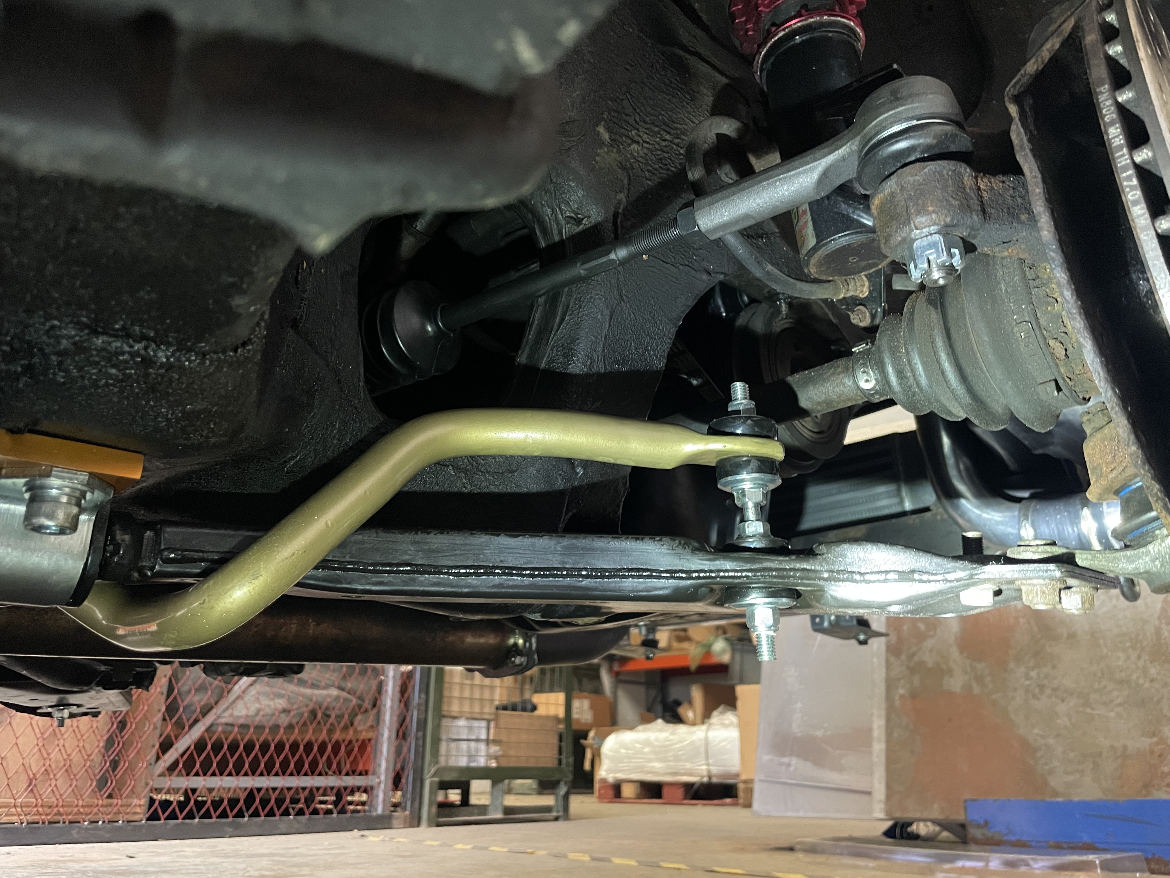

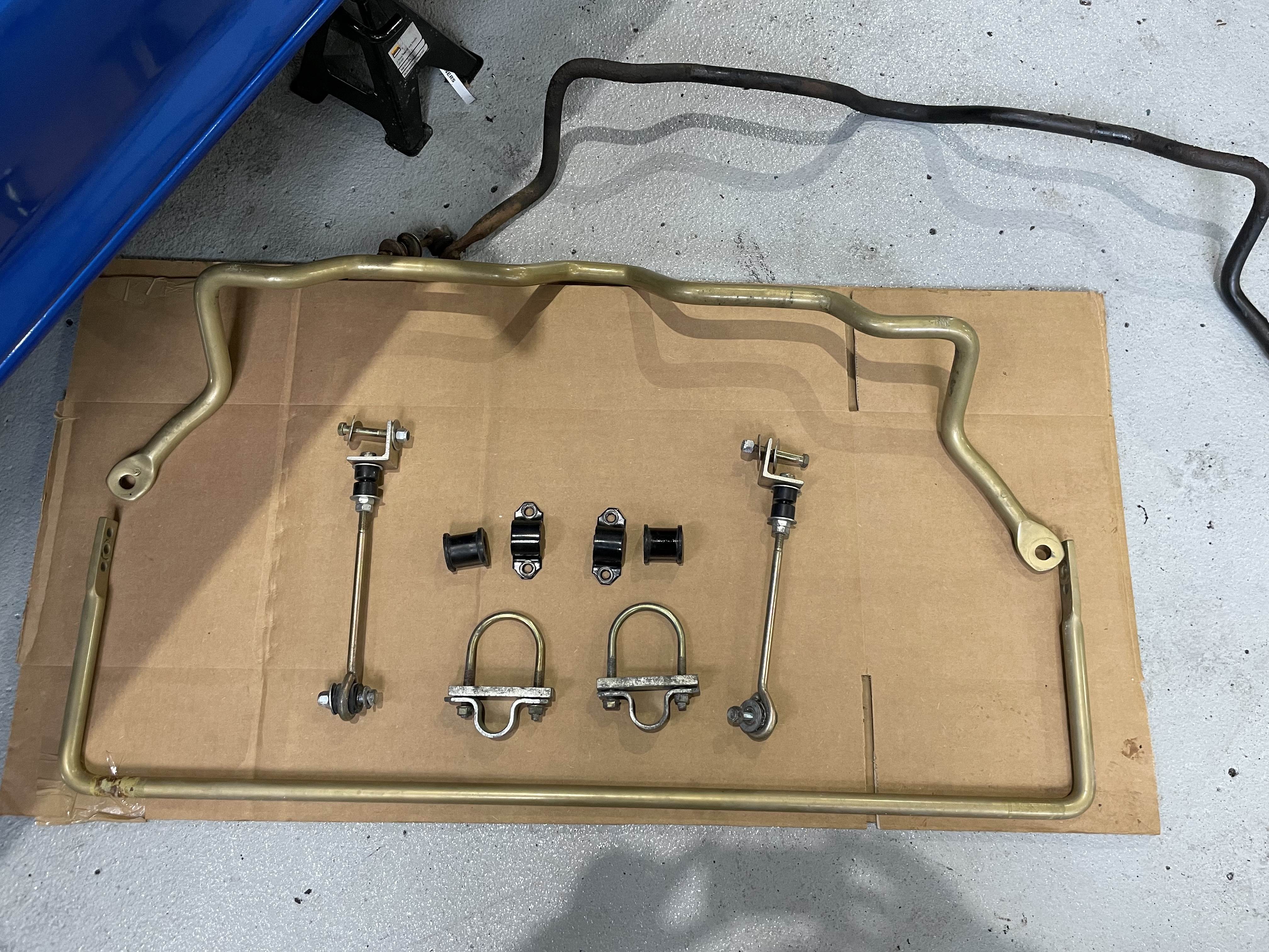

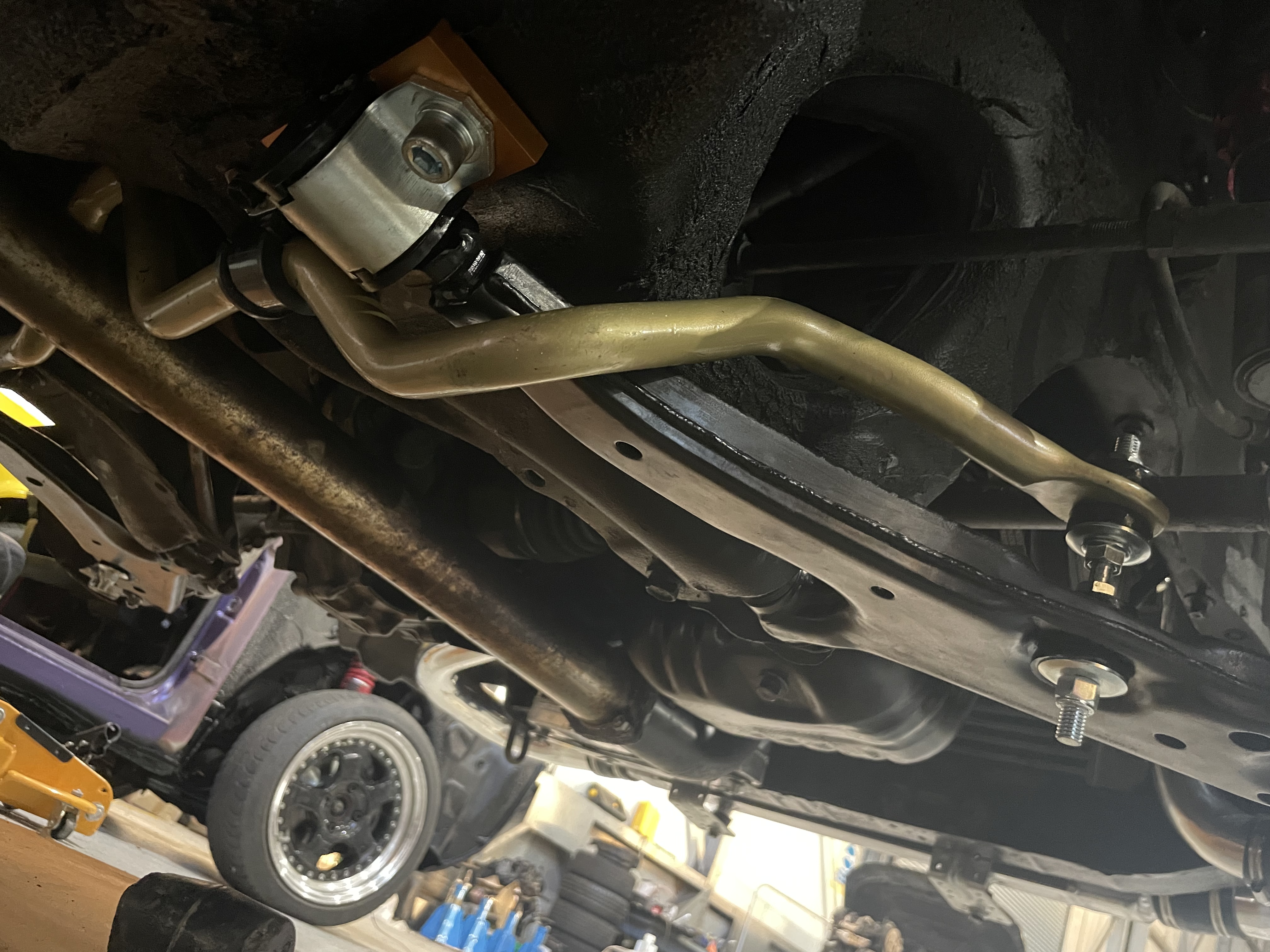

Pikey009 Posted September 30, 2021 Author Share Posted September 30, 2021 I got these on Sunday along with a GFB boost controller from Si. Really happy with the condition. Fitted the front ARB which was a mission as I didn’t want to take the front pipe back off now that it’s nicely sealed. Got there in the end though Quote Link to post Share on other sites

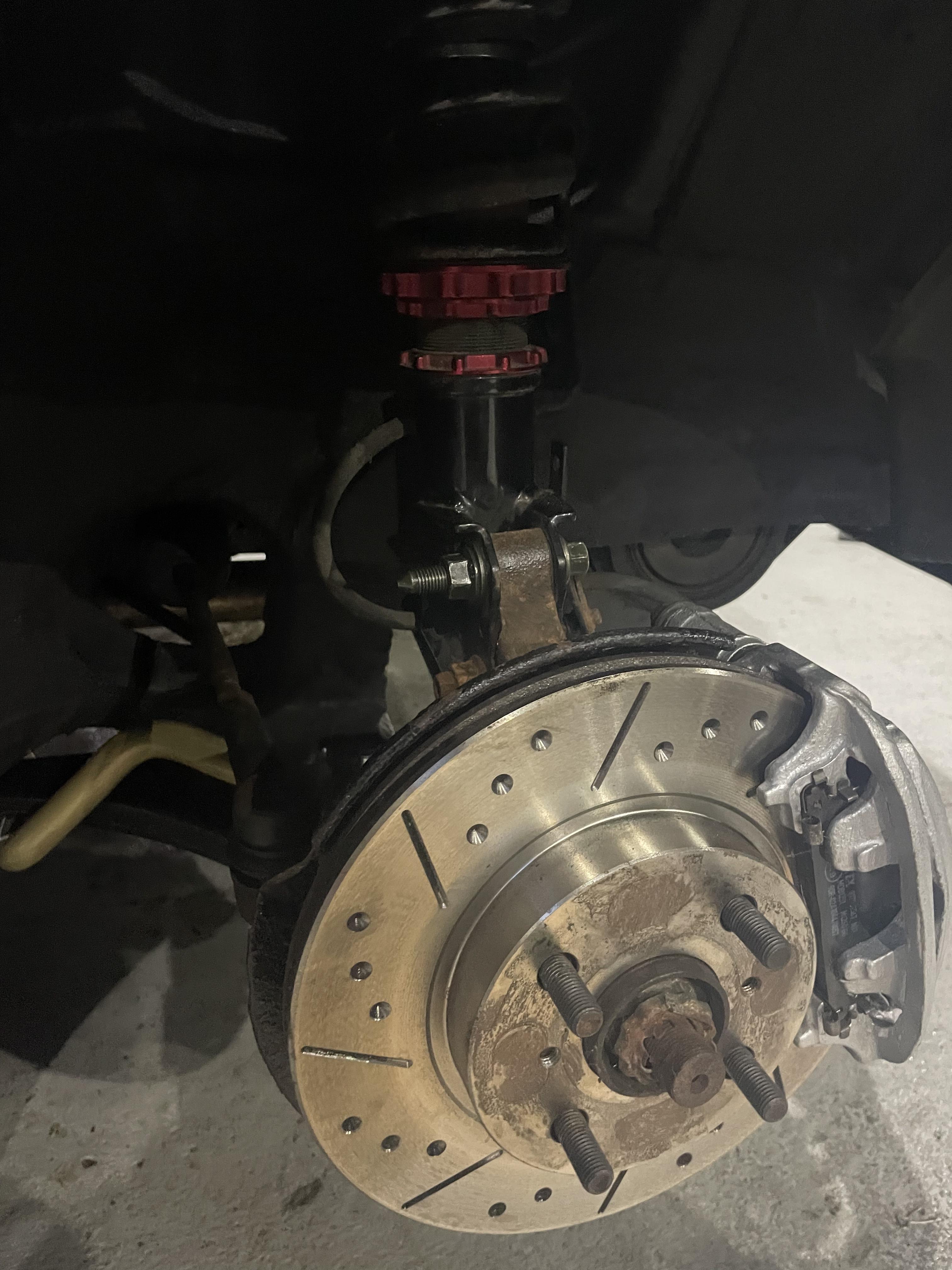

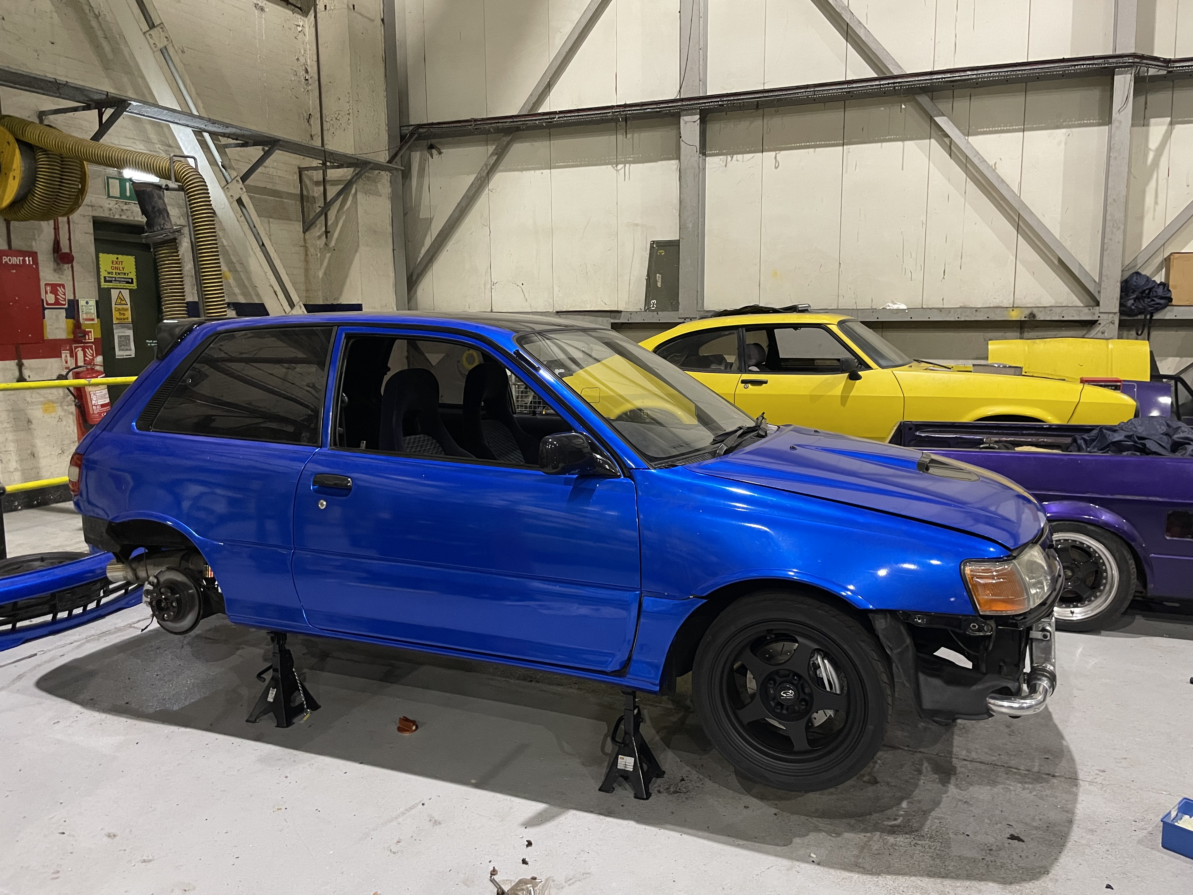

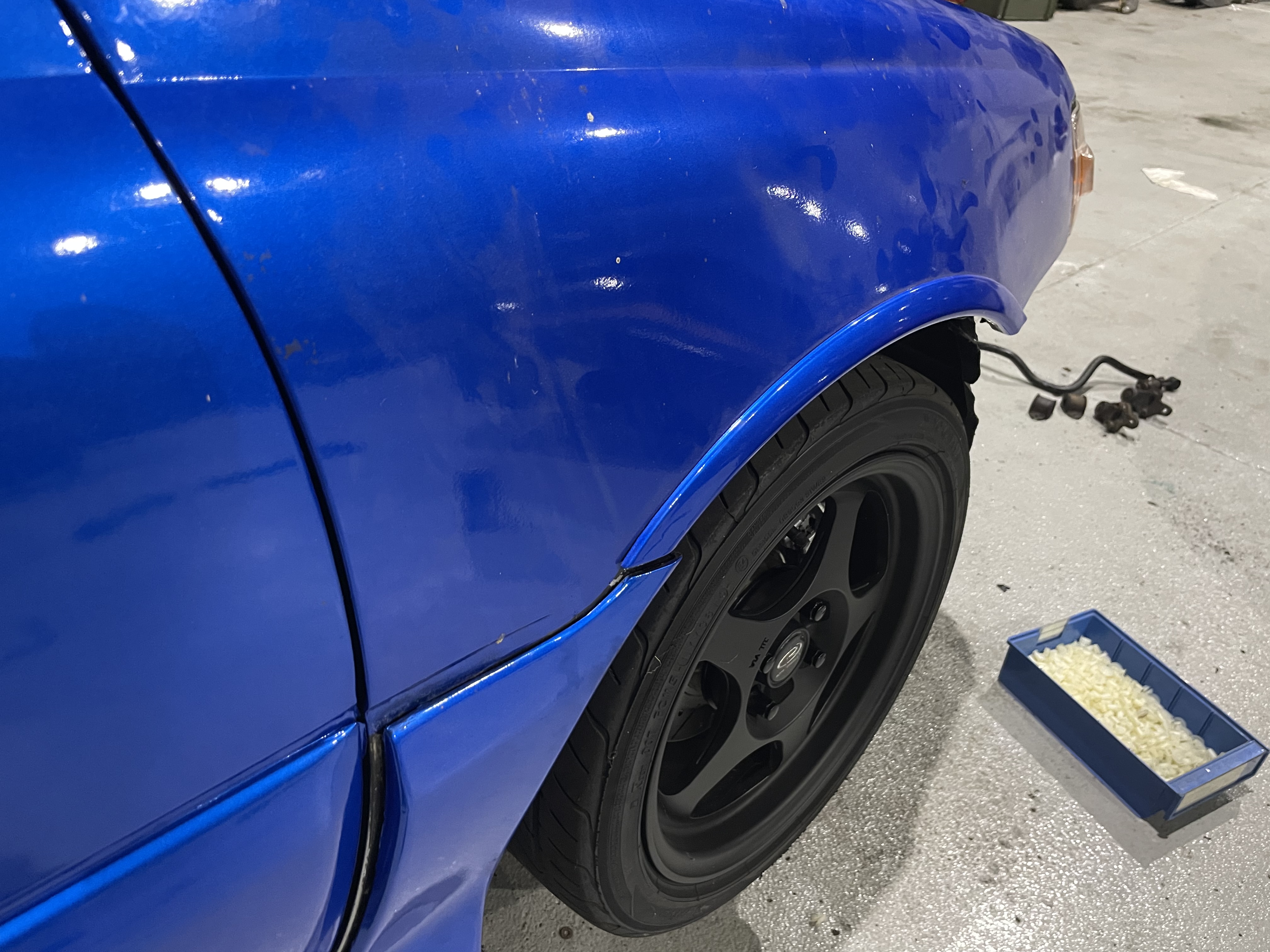

Pikey009 Posted September 30, 2021 Author Share Posted September 30, 2021 (edited) As usual the job spiralled and I ended up replacing the hub ball joints as I had a nearly new set on some spare hubs and the originals were knackered. Also fitted the whiteline droplinks, new wishbones, anti lift kit, camber bolts and test fitted the wings ready to transport the car to my new work next week. I also cleaned the arches and waxoiled them. Edited September 30, 2021 by Pikey009 Quote Link to post Share on other sites

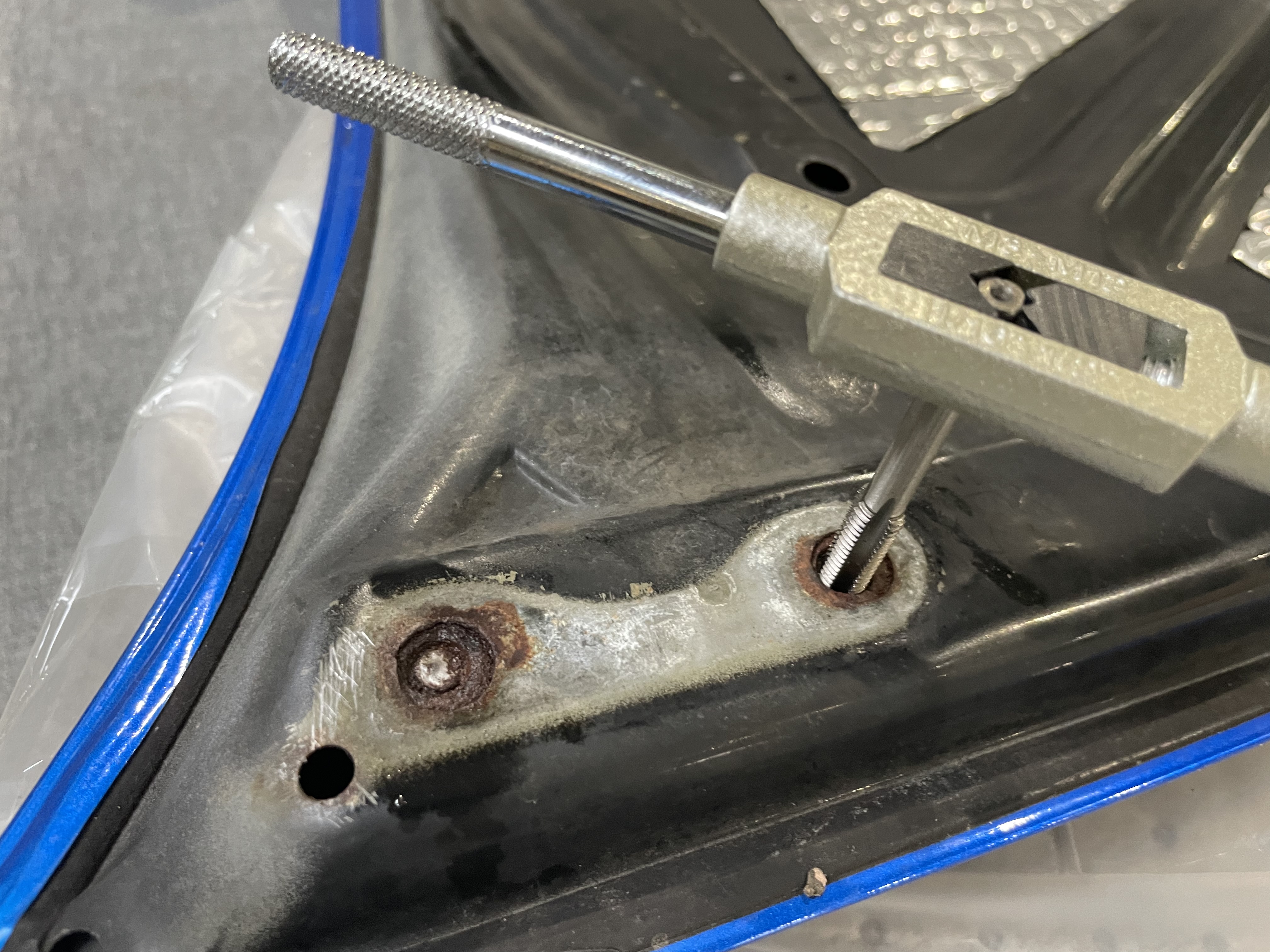

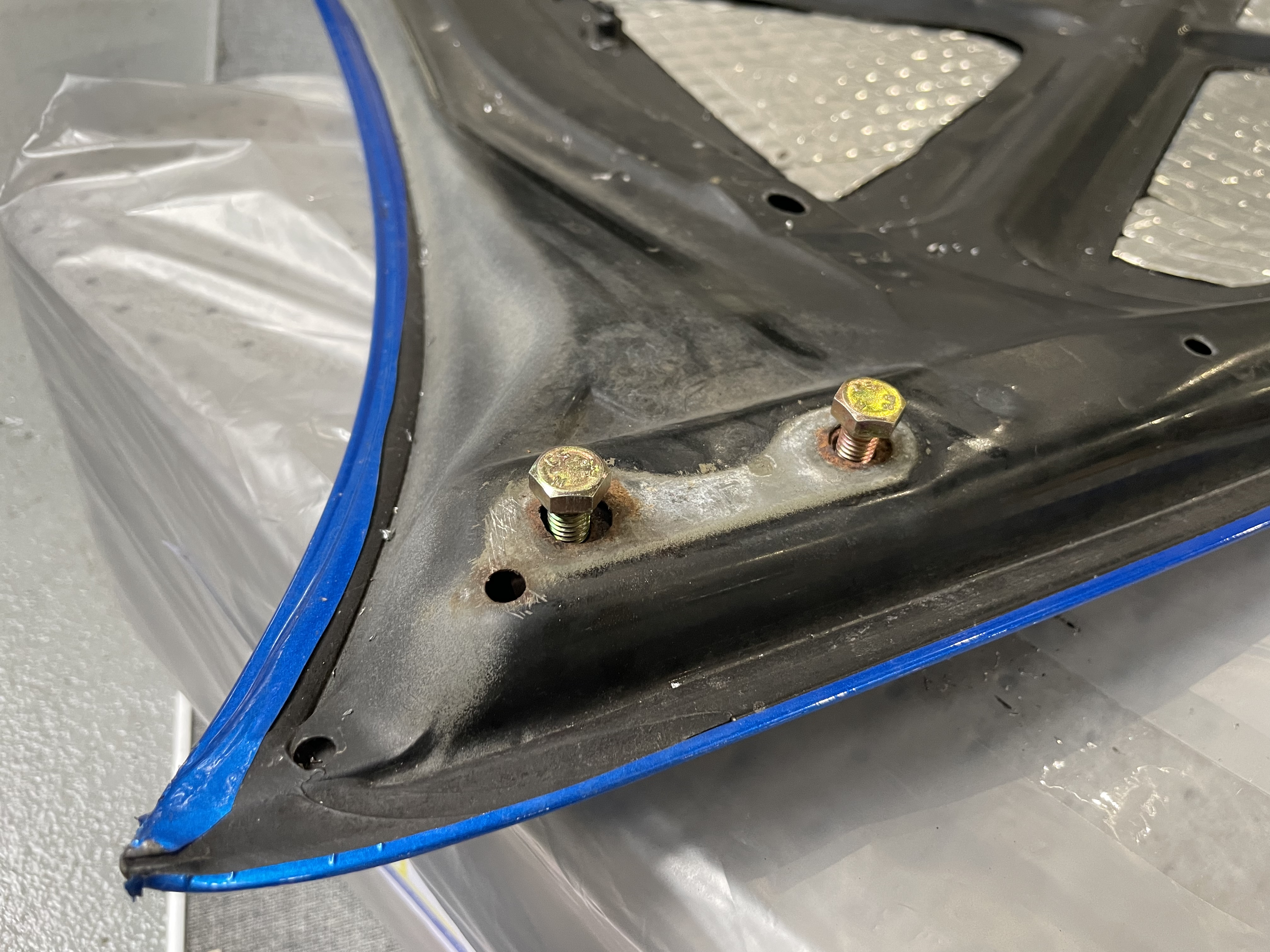

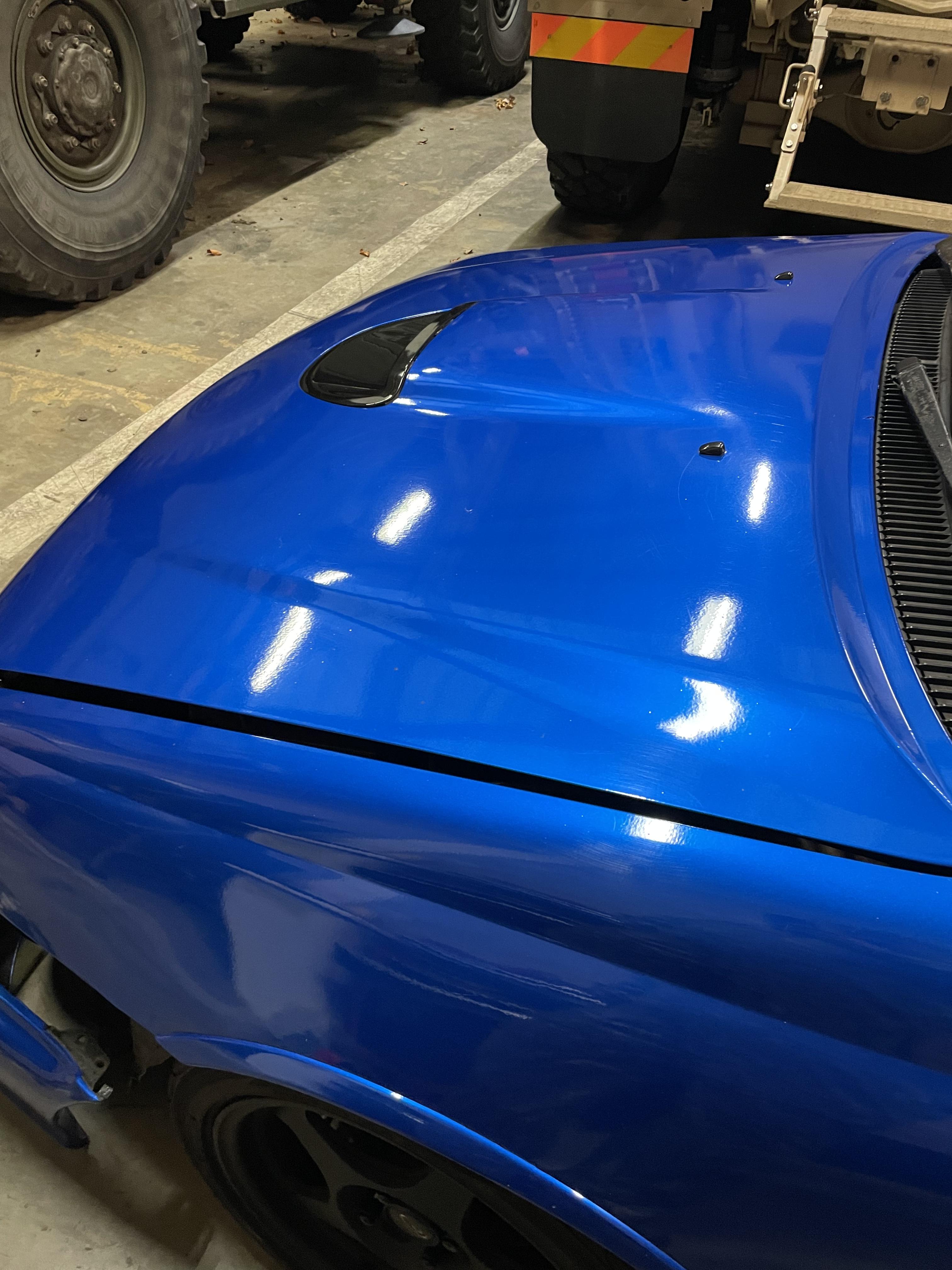

Pikey009 Posted September 30, 2021 Author Share Posted September 30, 2021 Good little job done today, re-cut the threads for the bonnet holes and extracted one that was sheered then sorted that one too. Fitted it all temporarily for now but will clean everything up and paint it in the future. Quote Link to post Share on other sites

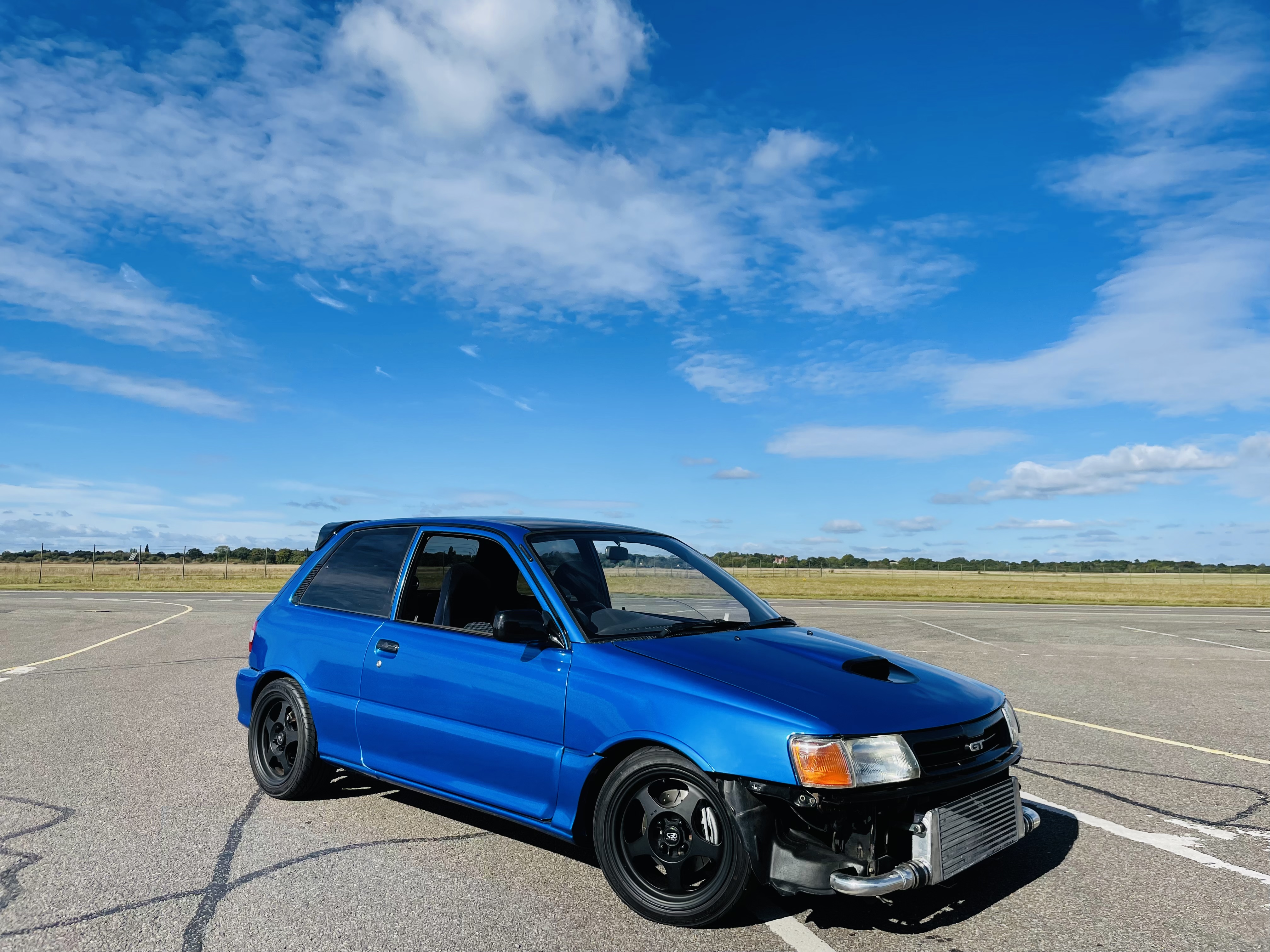

Pikey009 Posted October 6, 2021 Author Share Posted October 6, 2021 Went for a little drive before loading up to transport to my new workplace. Tracking needs doing but other than that she’s all good. Quote Link to post Share on other sites

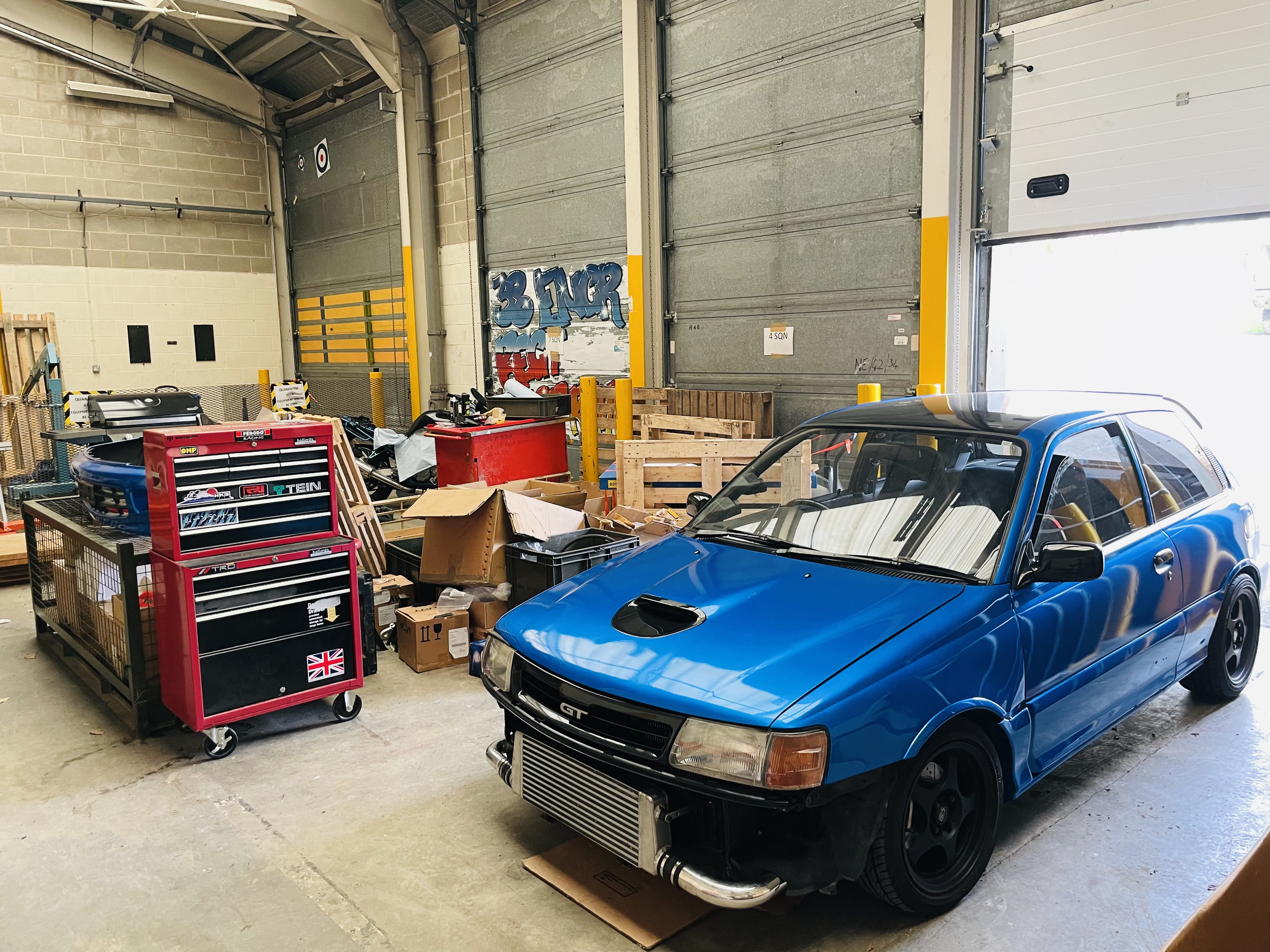

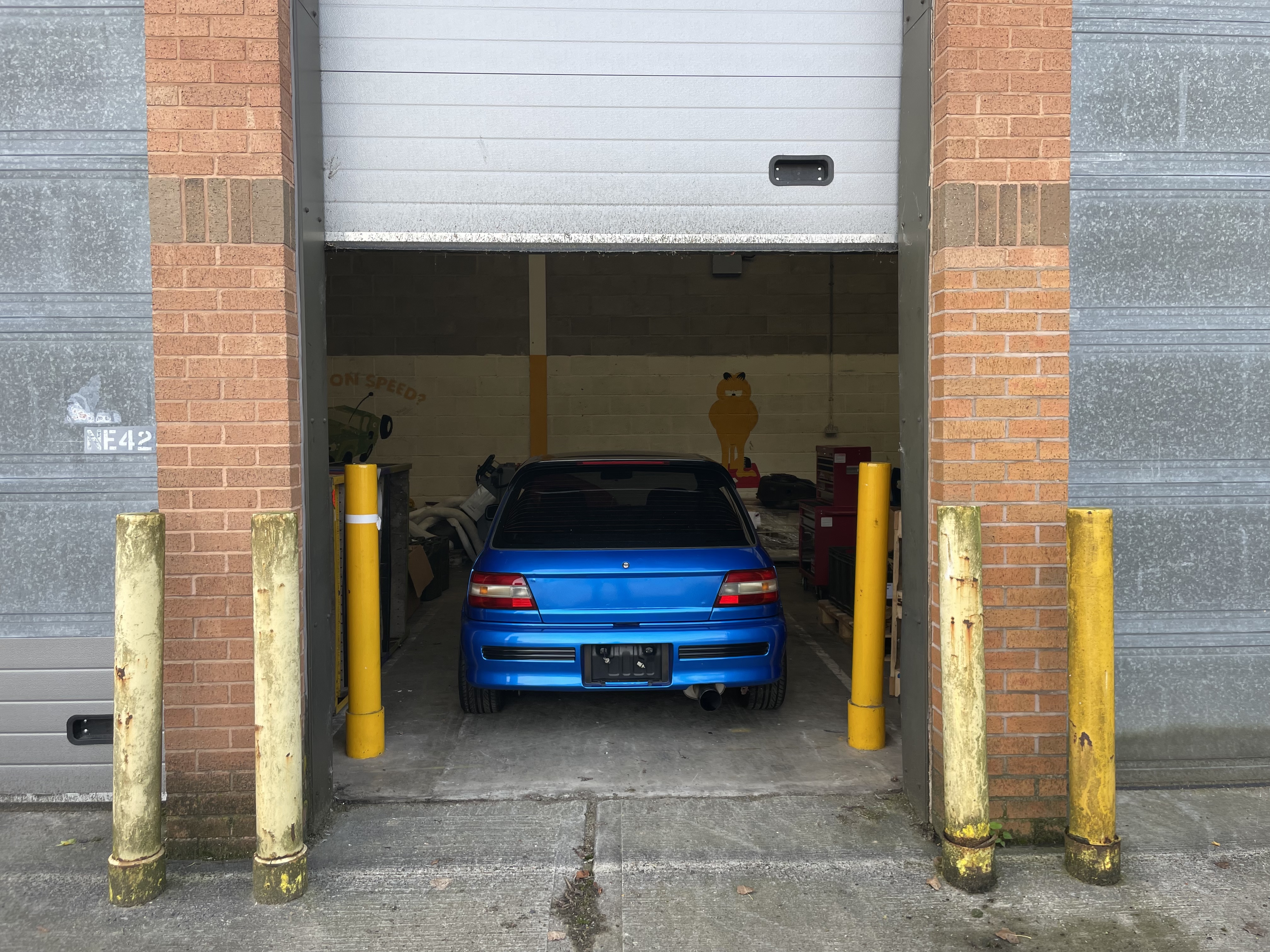

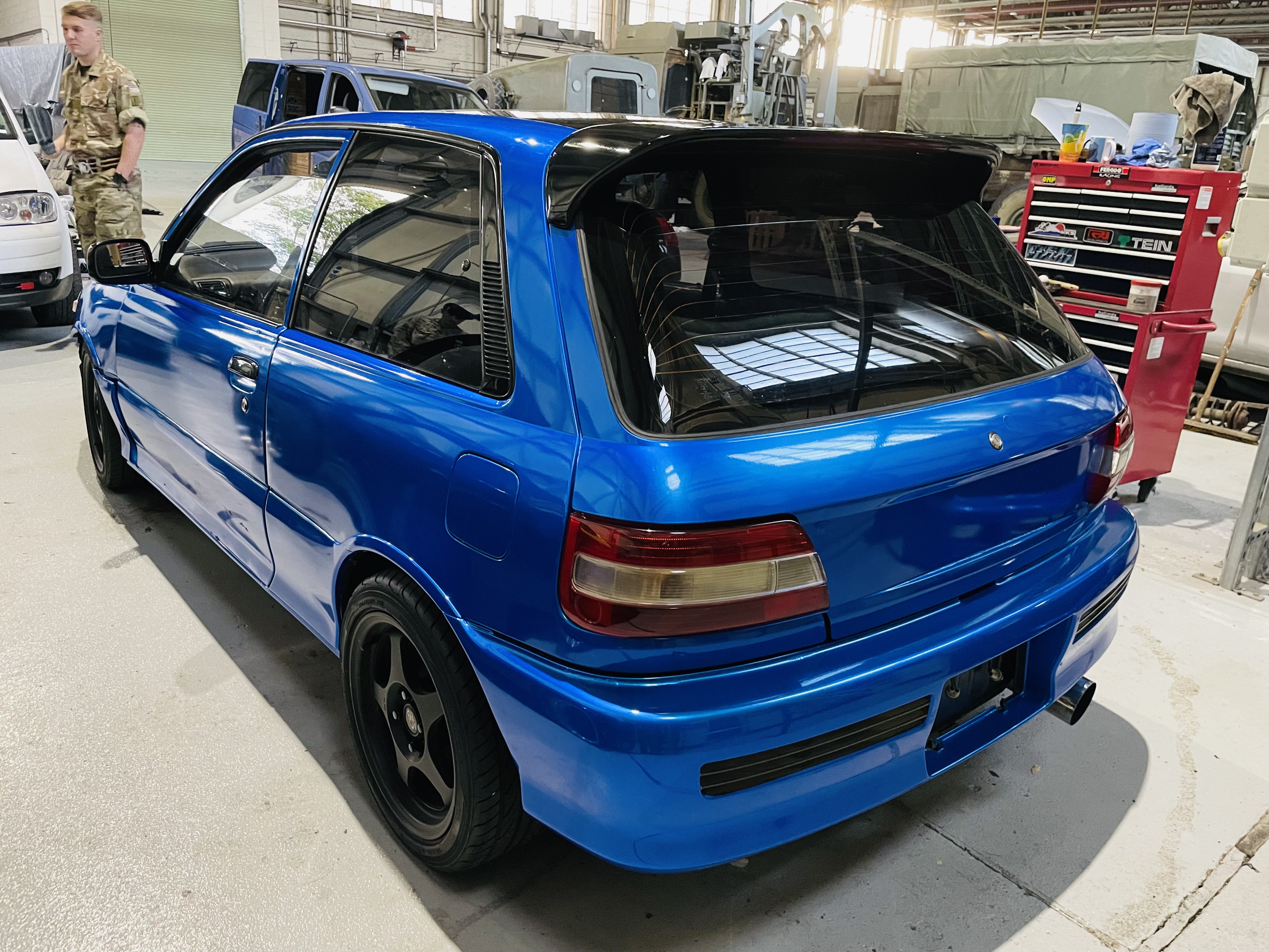

Pikey009 Posted October 12, 2021 Author Share Posted October 12, 2021 Took it to its new home last Friday, Ripon, Yorkshire Quote Link to post Share on other sites

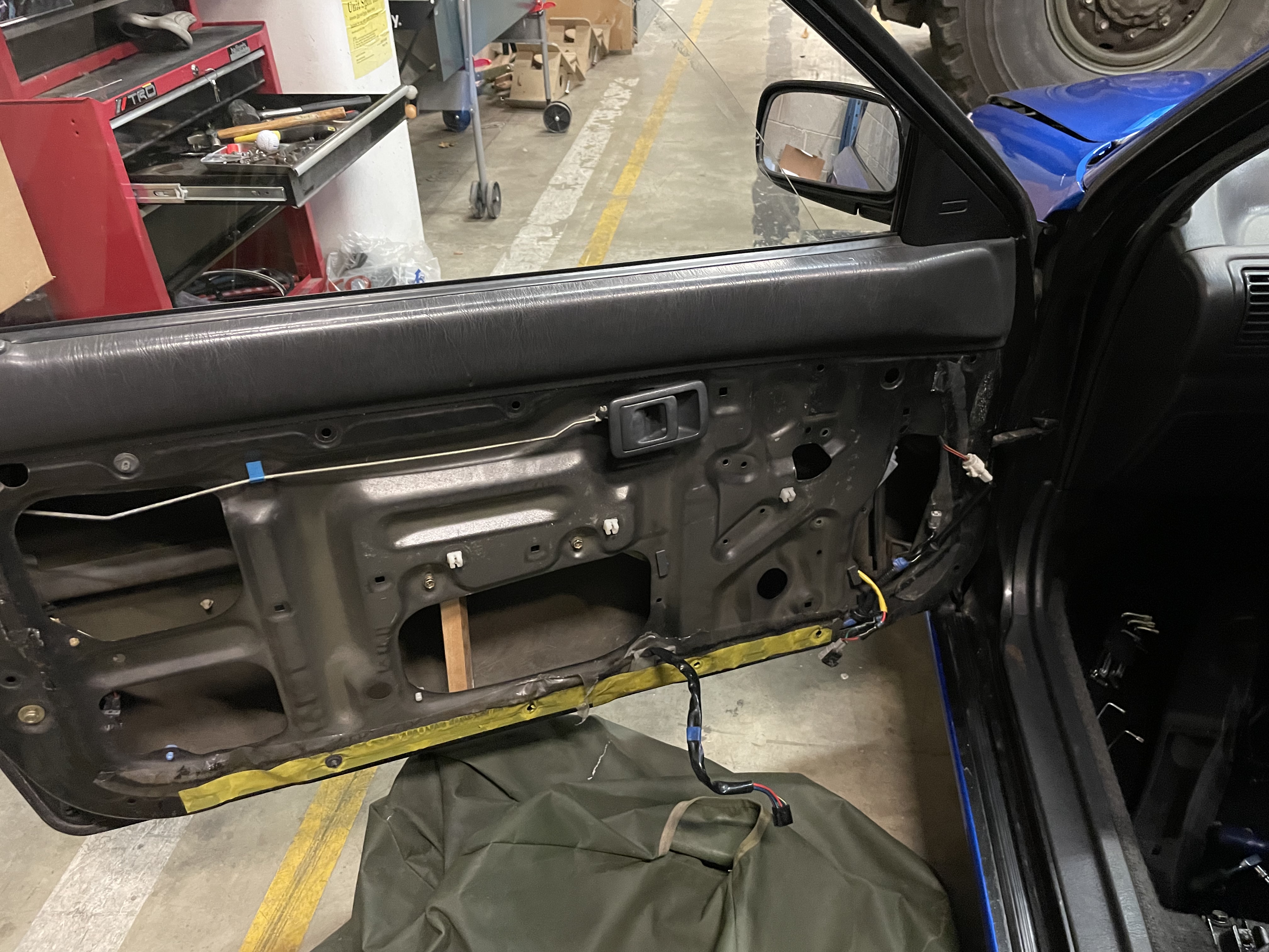

Pikey009 Posted November 13, 2021 Author Share Posted November 13, 2021 Boring update but a big win for me. Just before I moved jobs the passenger window failed. Could hear the motor clicking away so I knew it had to be something simple. Quote Link to post Share on other sites

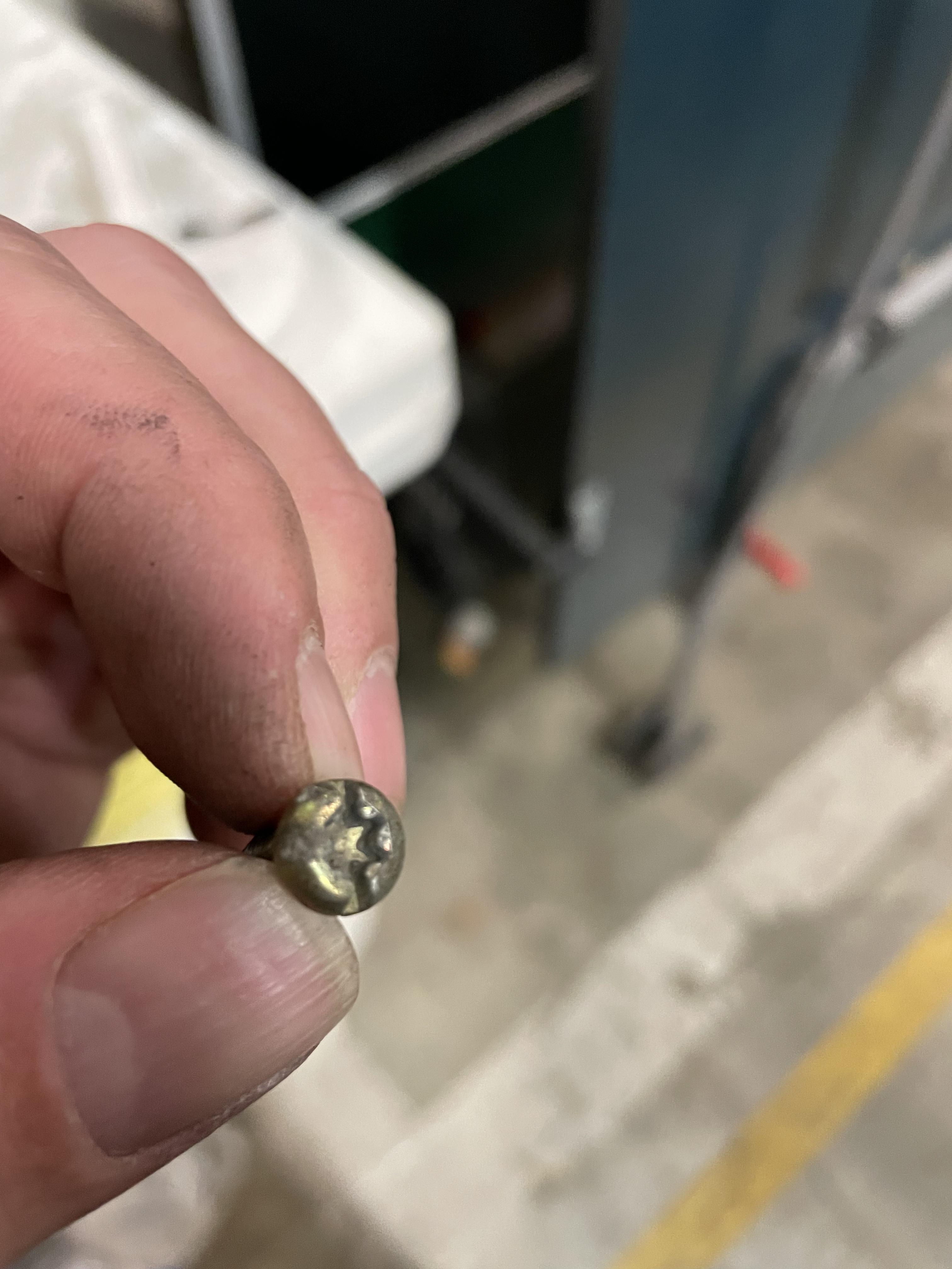

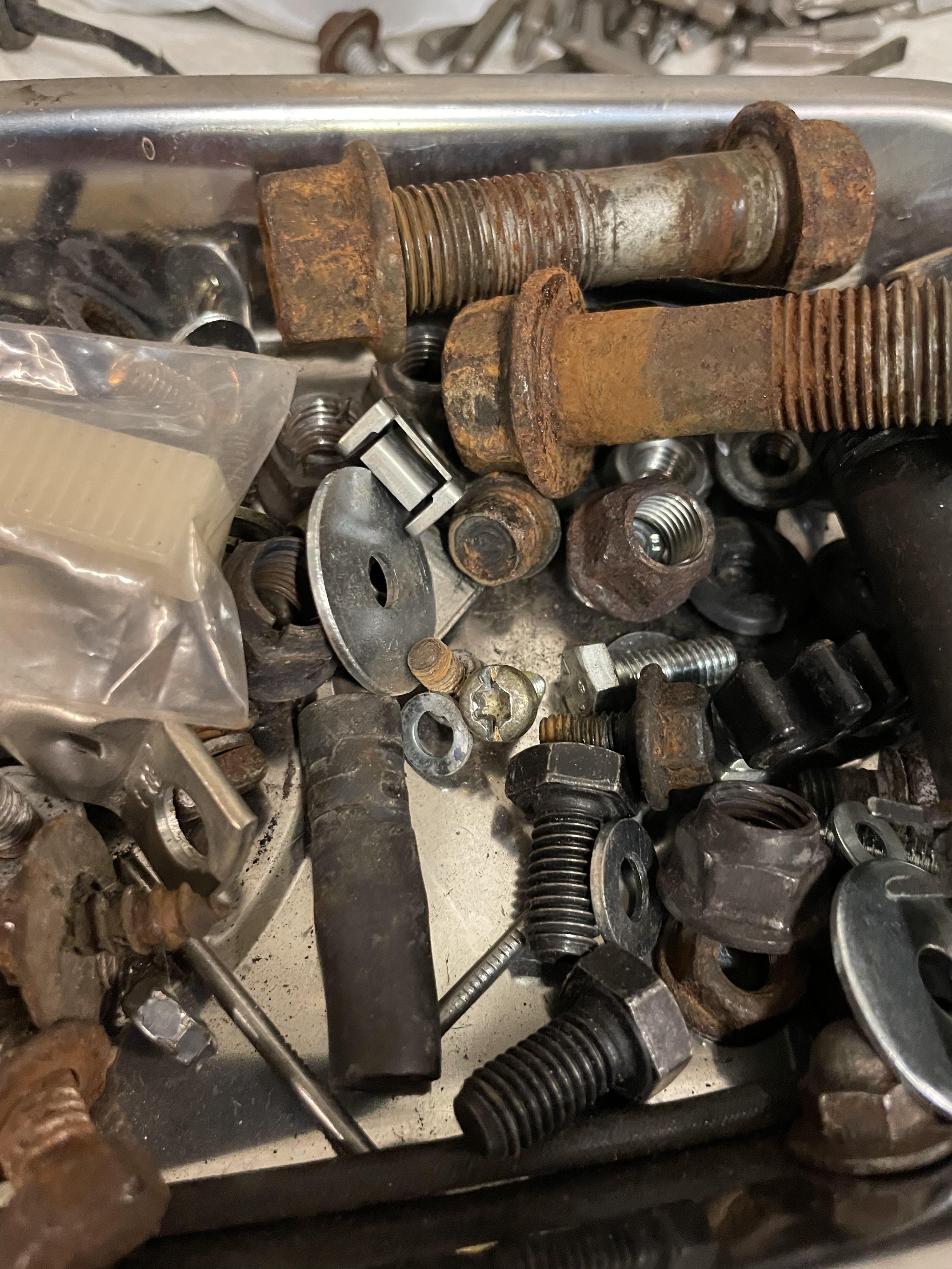

Pikey009 Posted November 13, 2021 Author Share Posted November 13, 2021 After stripping it down I found there was only one bolt holding the motor to the regulator. Sounds like a simple job but I had to wrestle for over an hour to realign everything. I’d kept all the old bolts since buying the car and hidden amongst them I found the spare bolt. Quote Link to post Share on other sites
Pikey009 Posted November 13, 2021 Author Share Posted November 13, 2021 ‘Simply’ rebuilt it and it now works. It best keep on working as I never want to deal with it again Quote Link to post Share on other sites

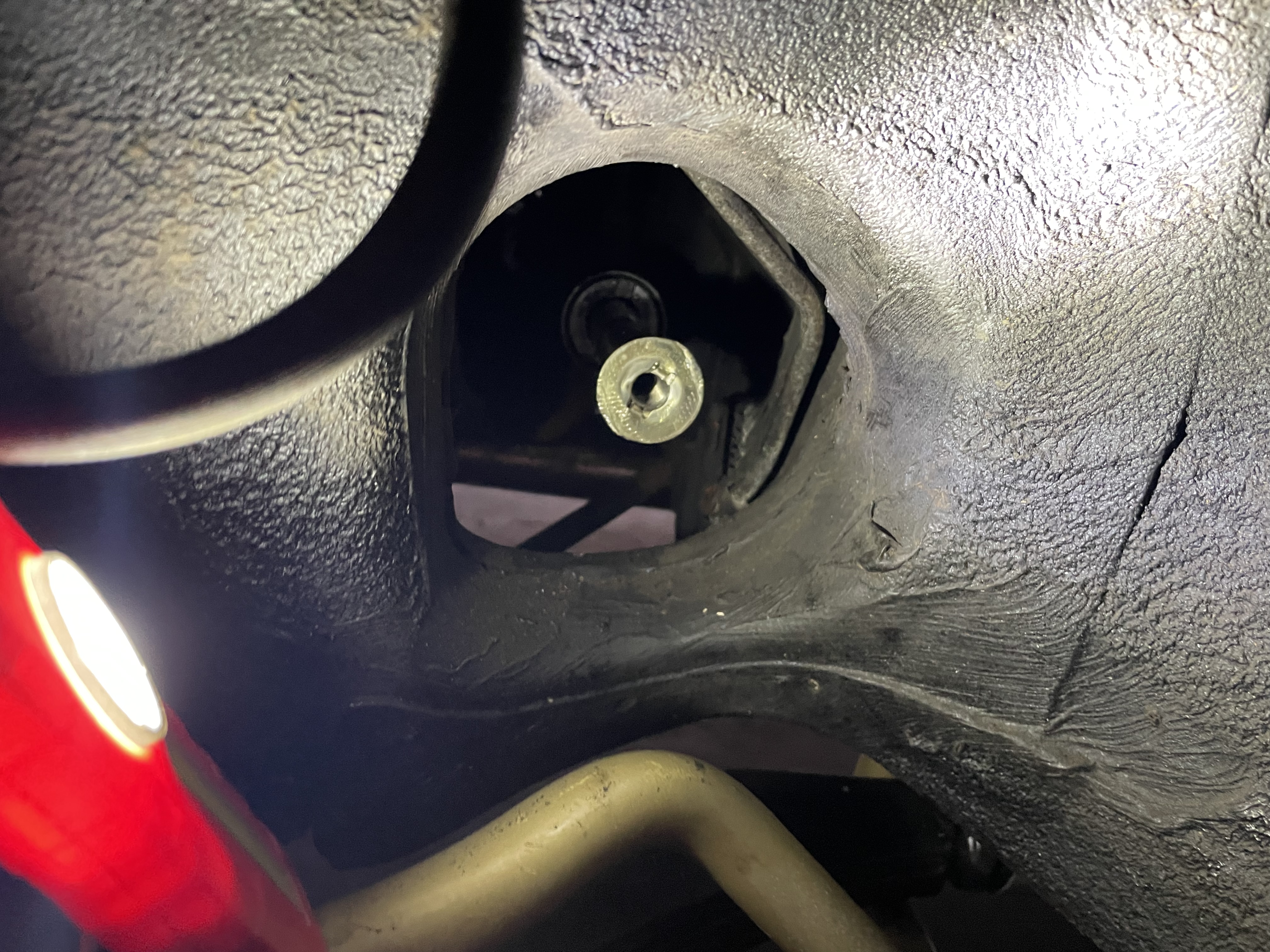

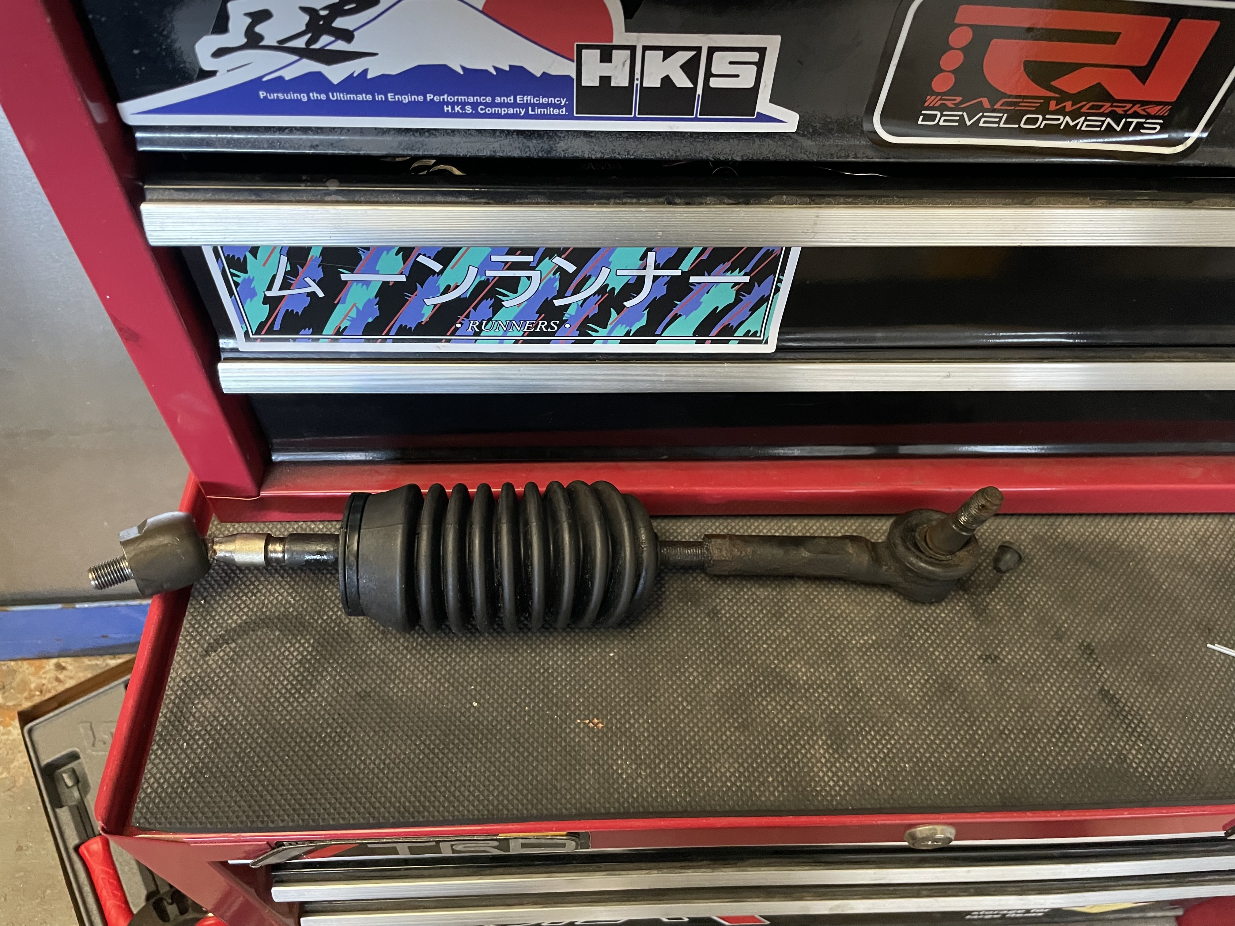

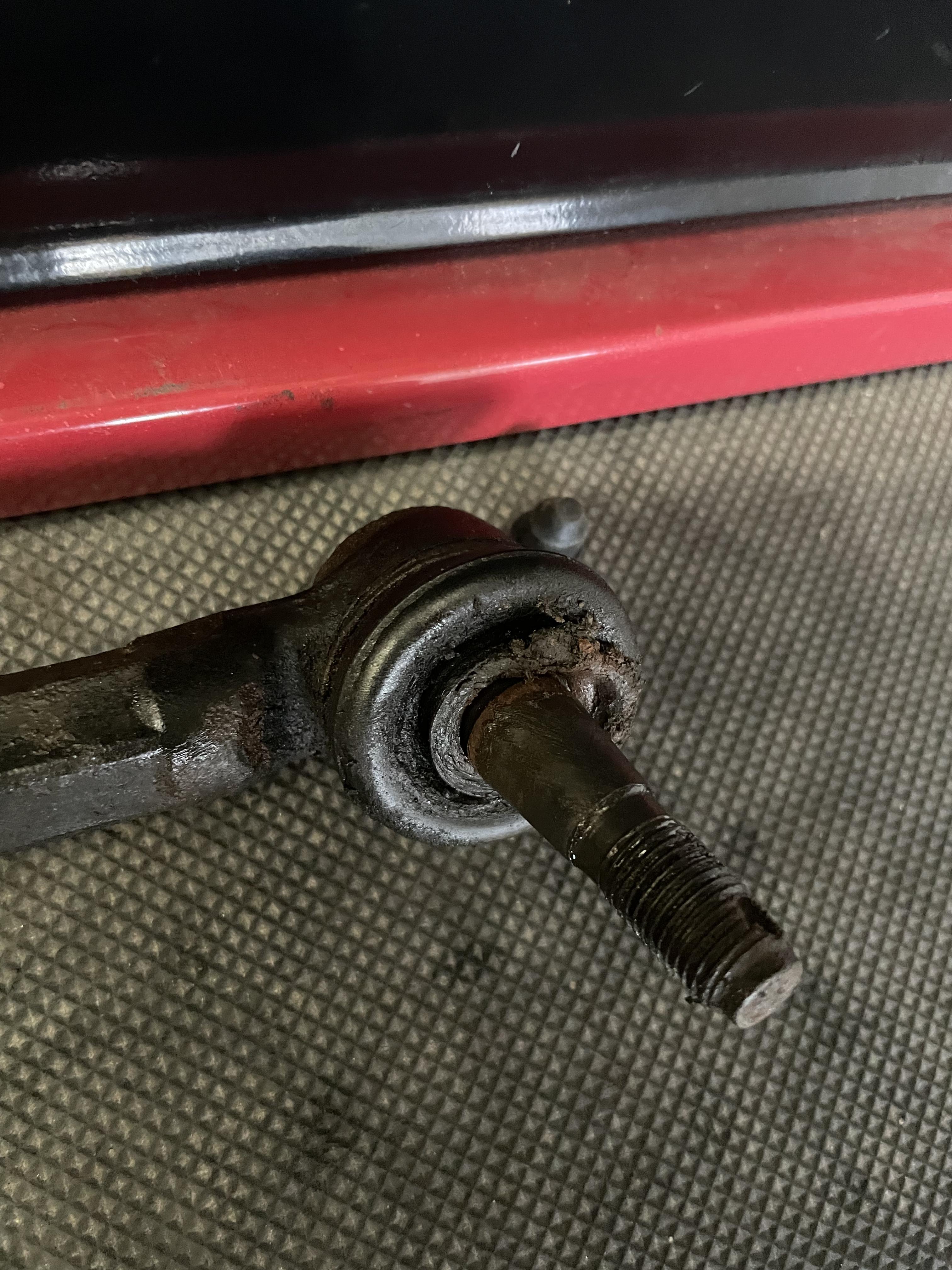

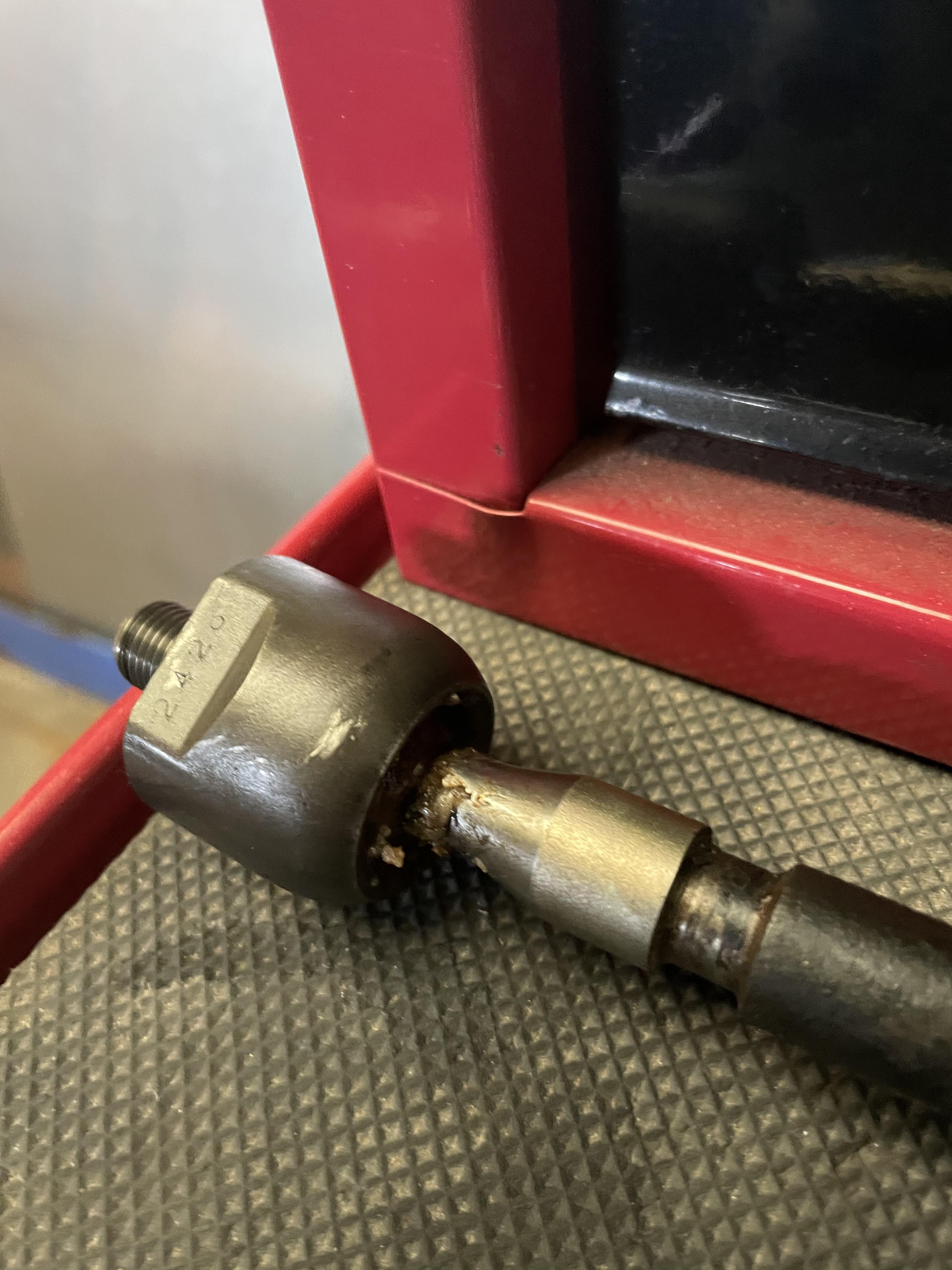

Pikey009 Posted January 26, 2022 Author Share Posted January 26, 2022 Finally got the tie rods changed today. Took me ages to find the inners and in the end ECP actually came to the rescue. I also managed to get hold of some new boots too. The old ball joints were totally gone and both rods were seized together solid. Quote Link to post Share on other sites
Pikey009 Posted January 26, 2022 Author Share Posted January 26, 2022 Just incase it’s not been covered, there is a brass locking tab that folds over the inner rod nut, the tabs will need tapping back out of the way in order to get the removal tool on. Quote Link to post Share on other sites

Pikey009 Posted January 26, 2022 Author Share Posted January 26, 2022 (edited) Underside of the car is really starting to come together. Edited January 26, 2022 by Pikey009 Quote Link to post Share on other sites
