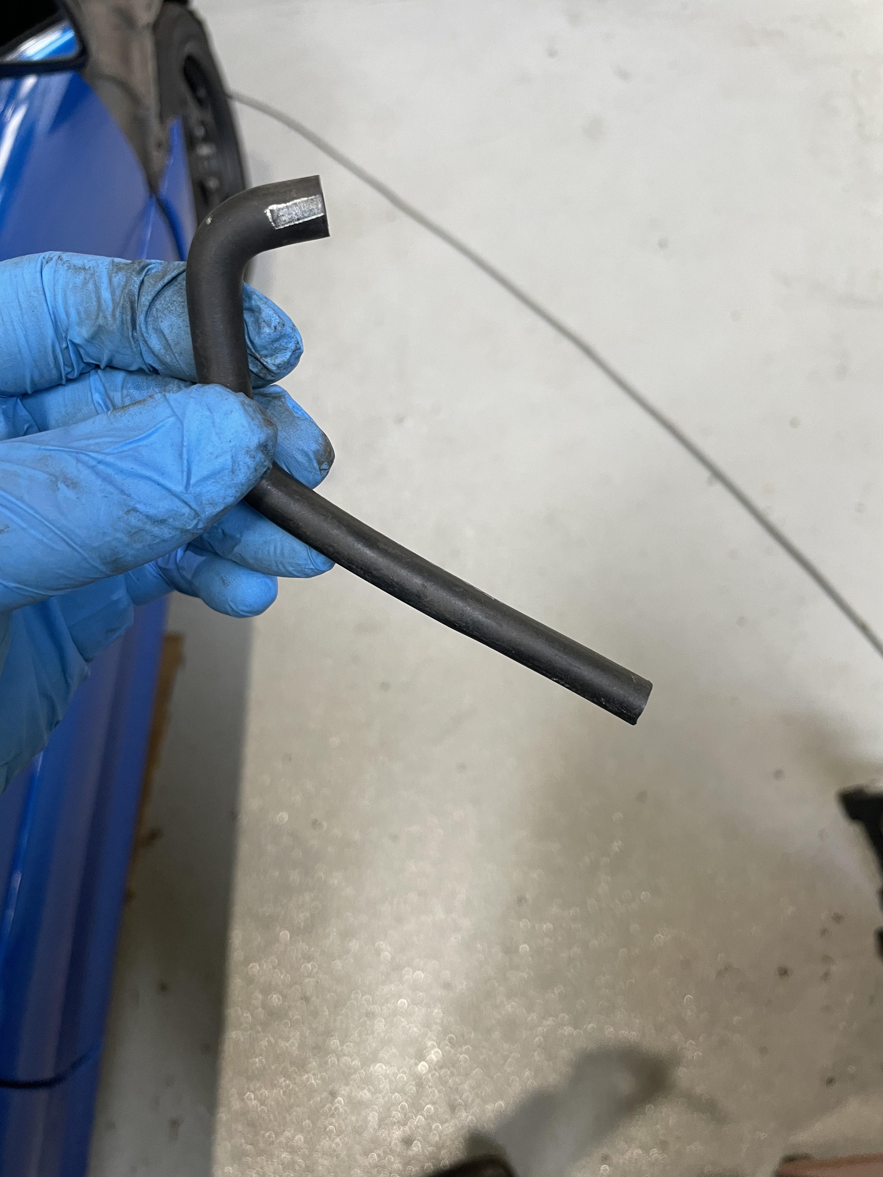

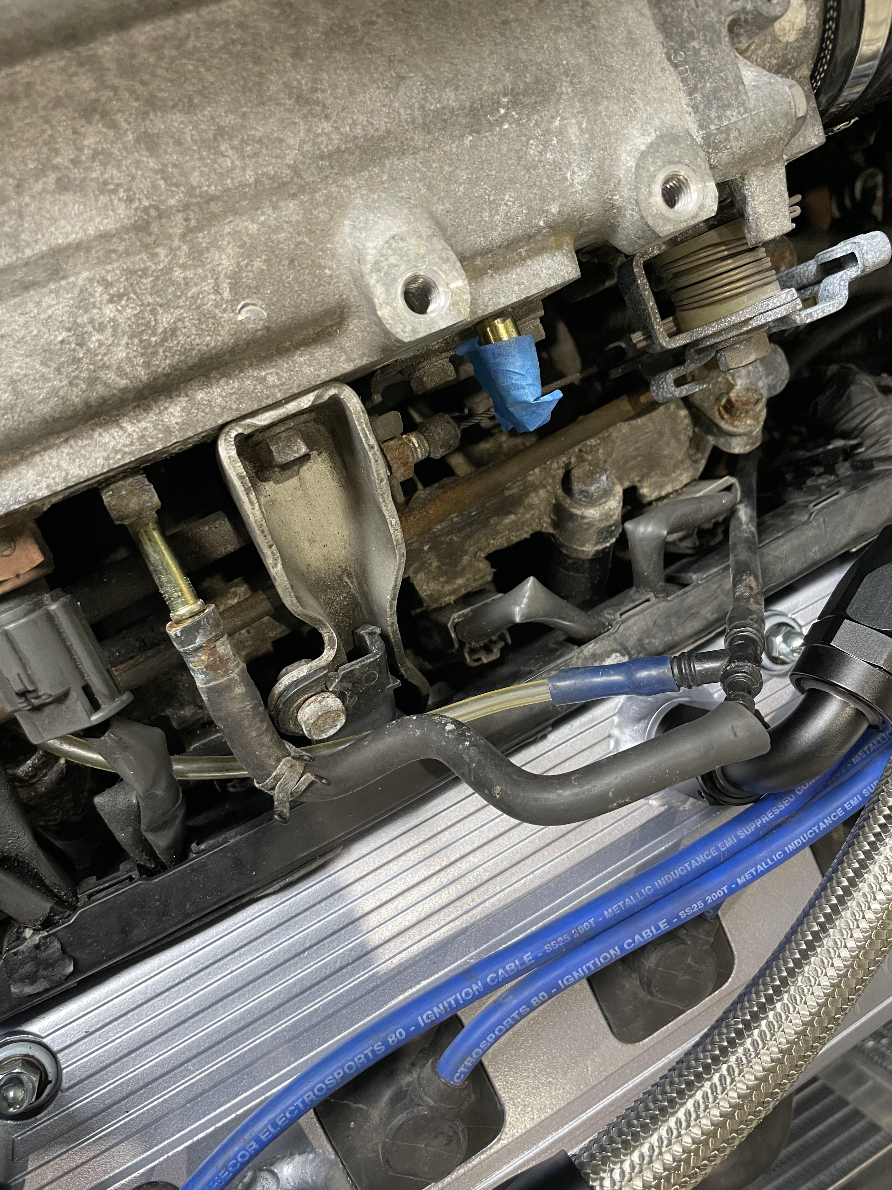

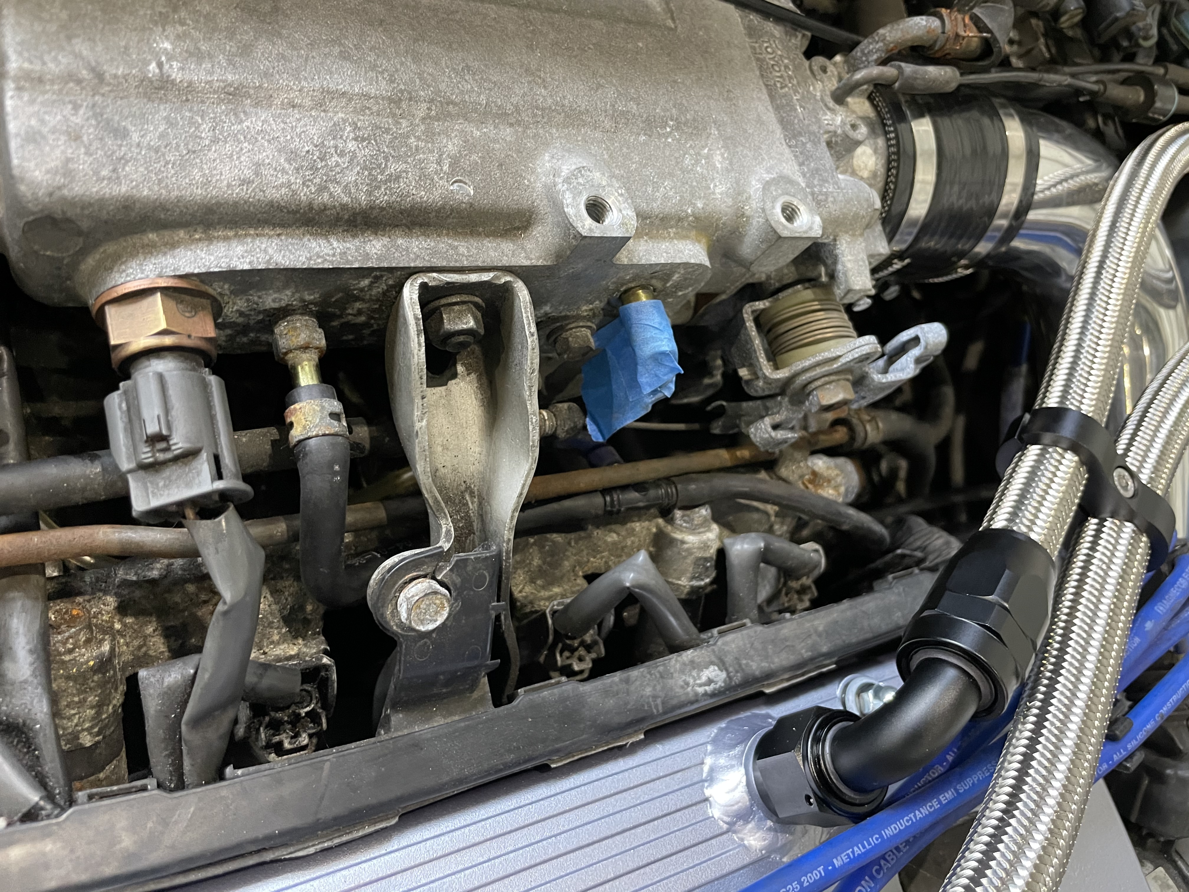

Pikey009 Posted May 7, 2021 Author Posted May 7, 2021 So I’ve loosened the turbo kit ready to fit the new gasket when it arrives. I’ll mock up some intercooler brackets next week to get it all mounted up properly. Then it’ll be up on the ramp to do the sump and re-fit the downpipe. In the mean time I’ve been sorting out dodgy wiring and tidying up vac lines- right bloody mess: Quote

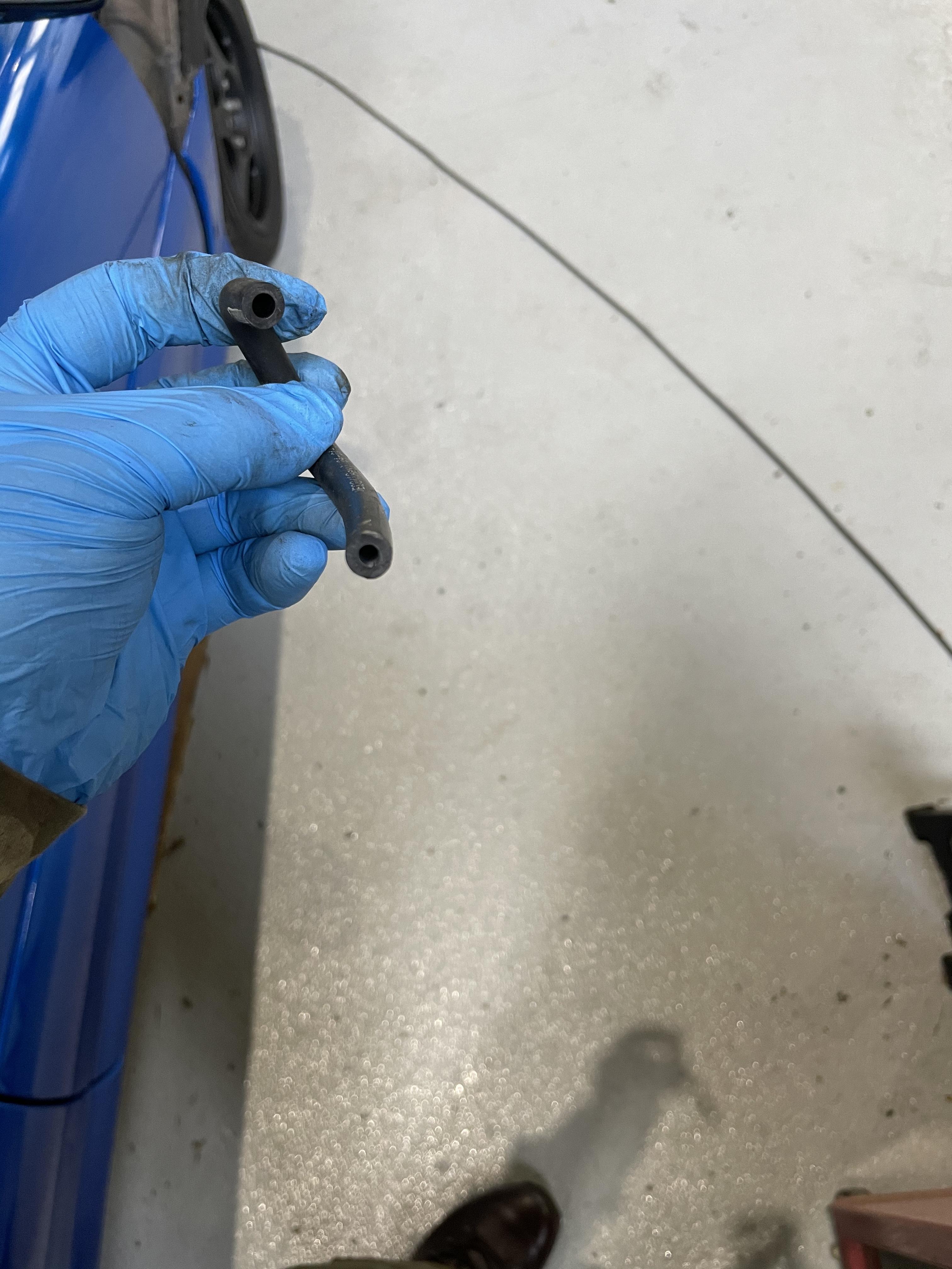

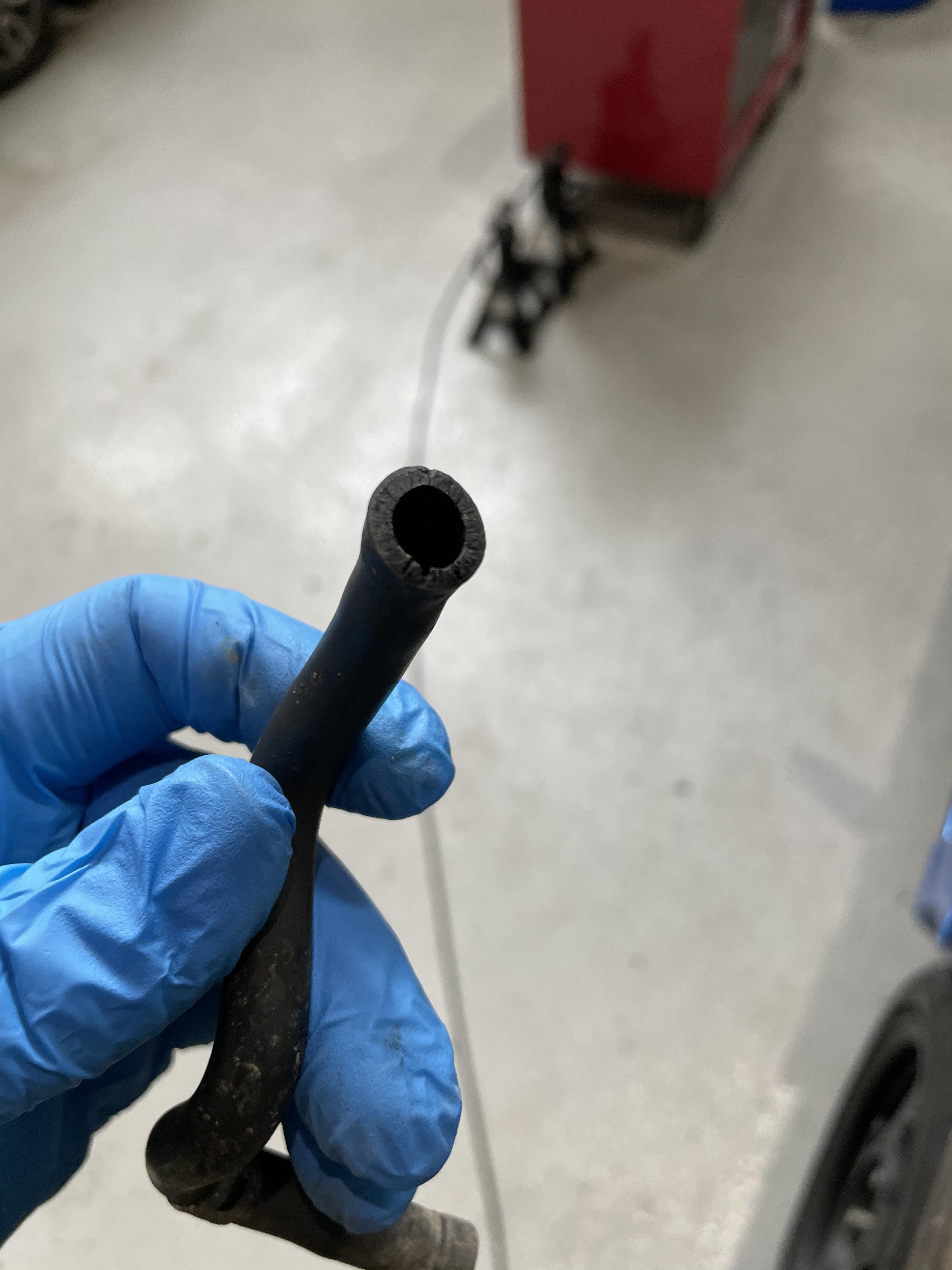

Pikey009 Posted May 7, 2021 Author Posted May 7, 2021 (edited) Used a nice bit of pre- shaped vac hose from some work I did on my fabia a while back. Has two different sized ends which worked perfectly as a step down. Edited May 7, 2021 by Pikey009 Quote
Pikey009 Posted May 7, 2021 Author Posted May 7, 2021 Another nice little job sorted. I’ve now blanked that vac line on the inlet manifold too Quote

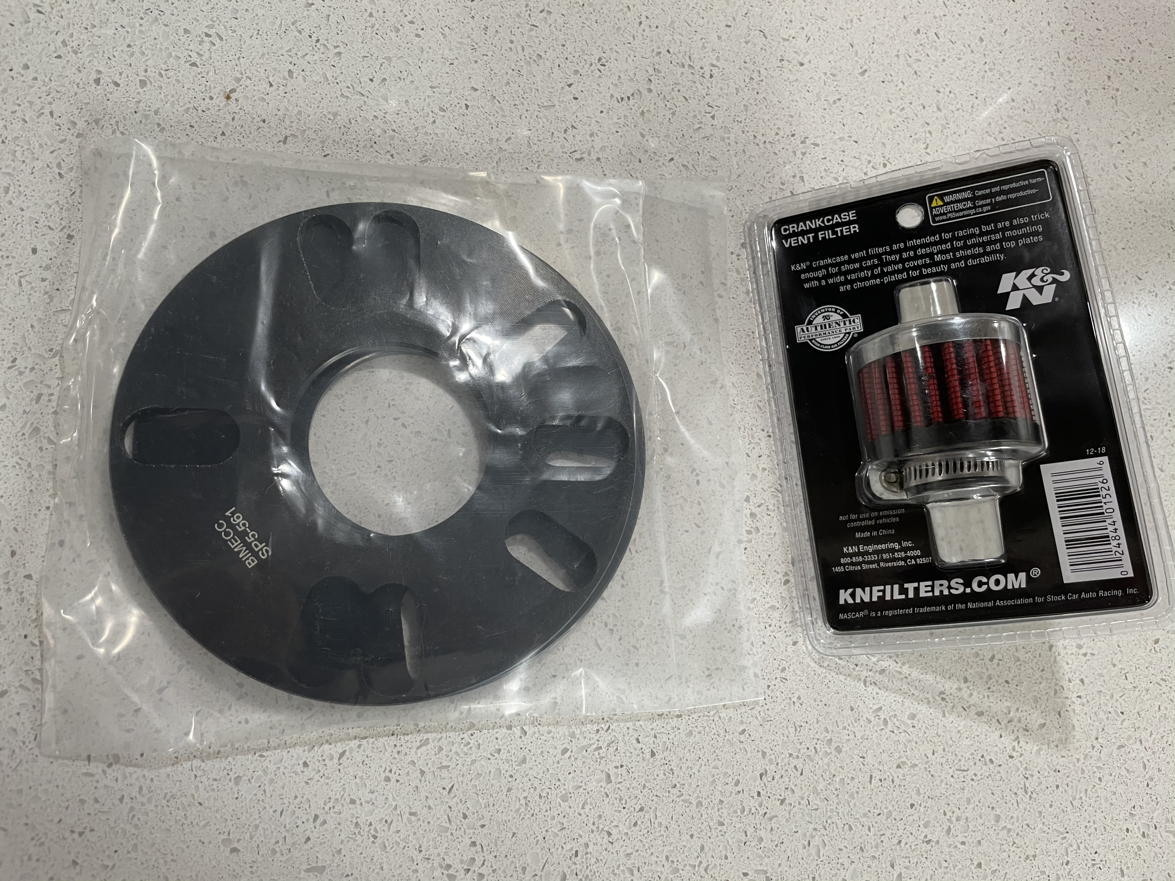

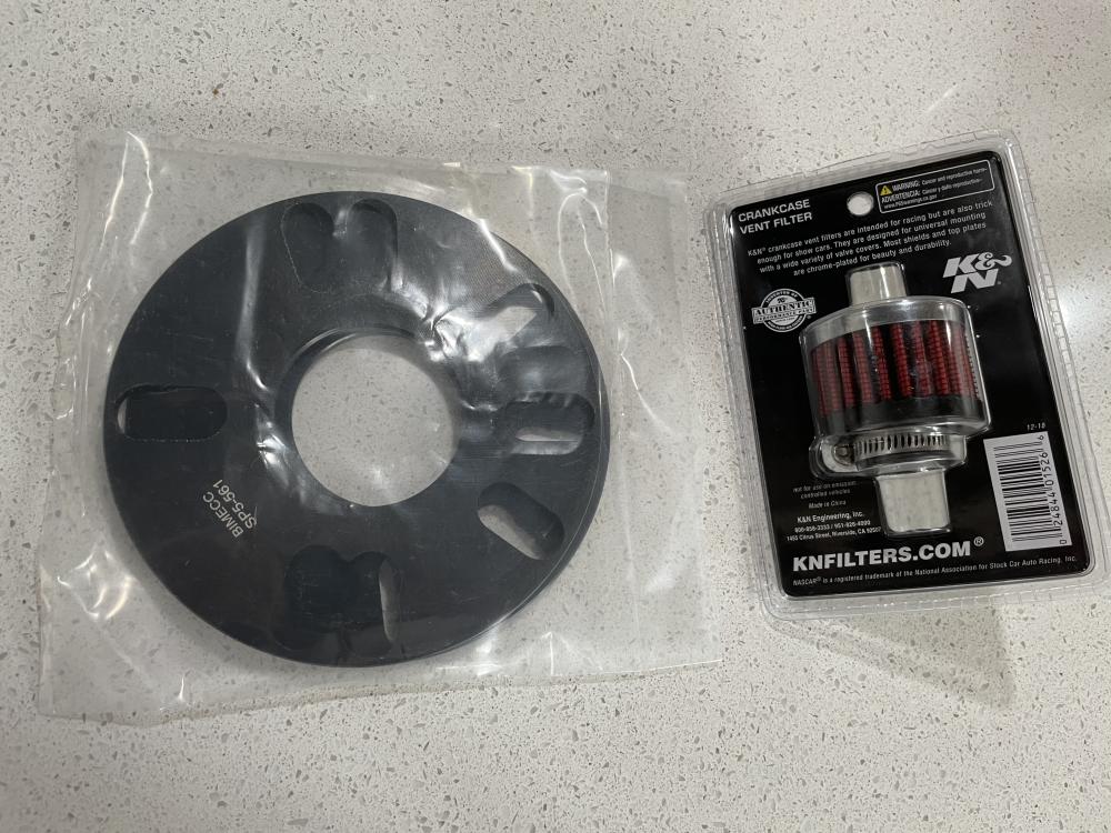

Pikey009 Posted May 7, 2021 Author Posted May 7, 2021 Breather filter for the catch can arrived along with some front wheel spacers so that the Rota centre caps don’t pop out Quote

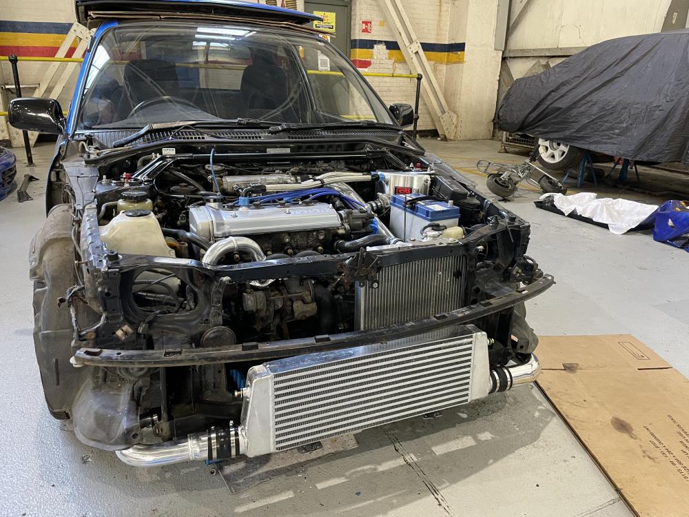

Pikey009 Posted May 19, 2021 Author Posted May 19, 2021 Today I was determined to make some decent progress after work. I’d already prepped the turbo kit to be removed so that I could replace the manifold gasket. Quote

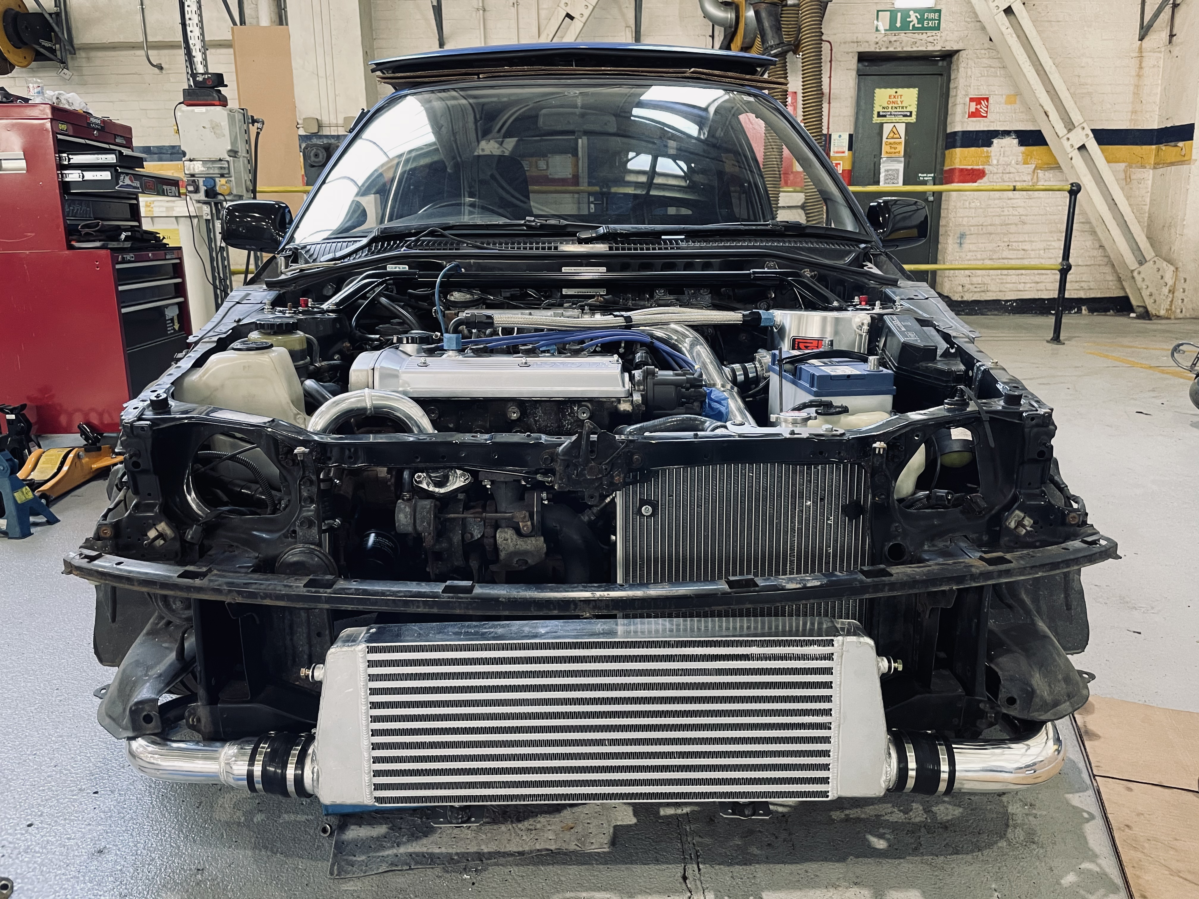

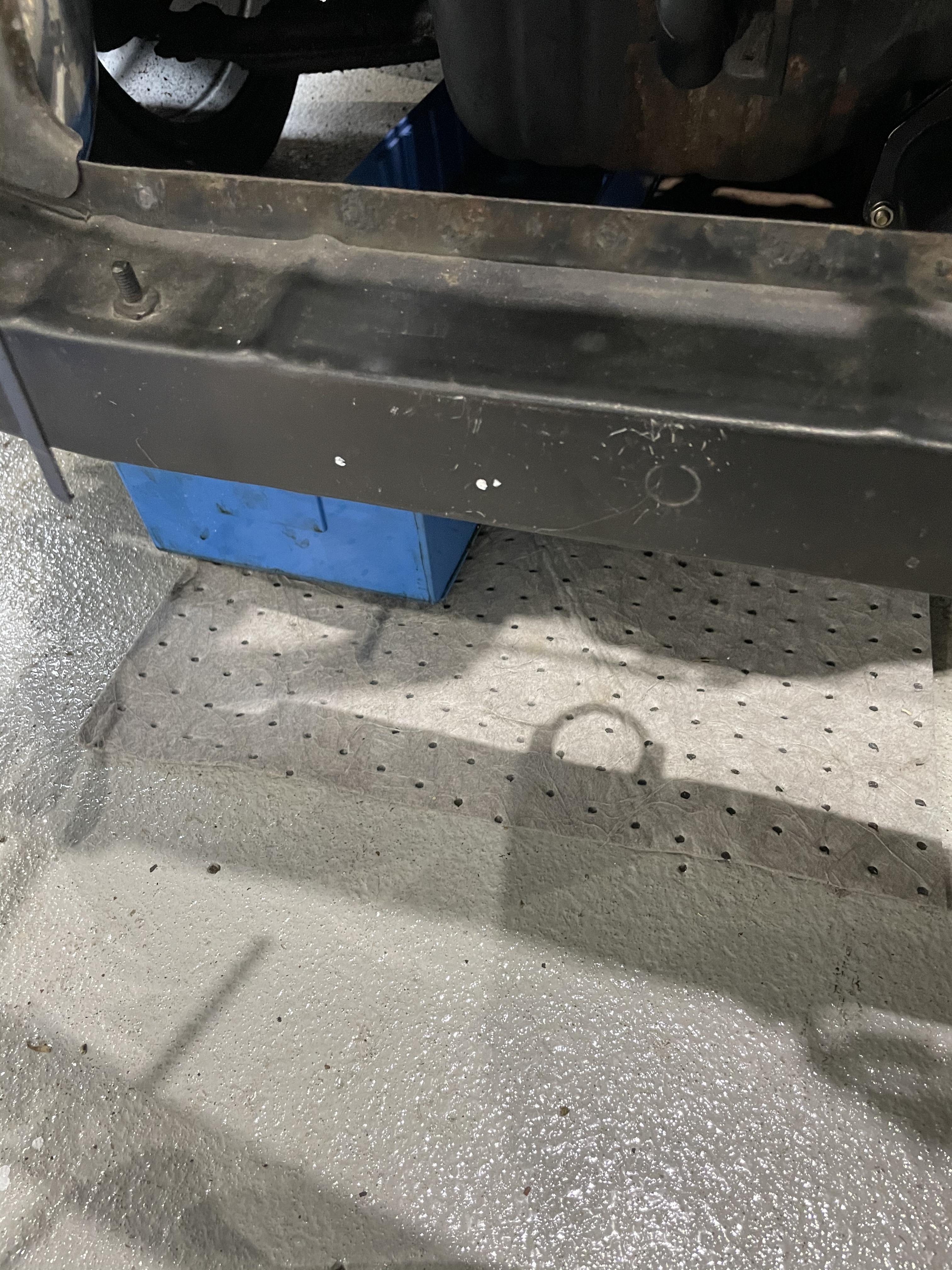

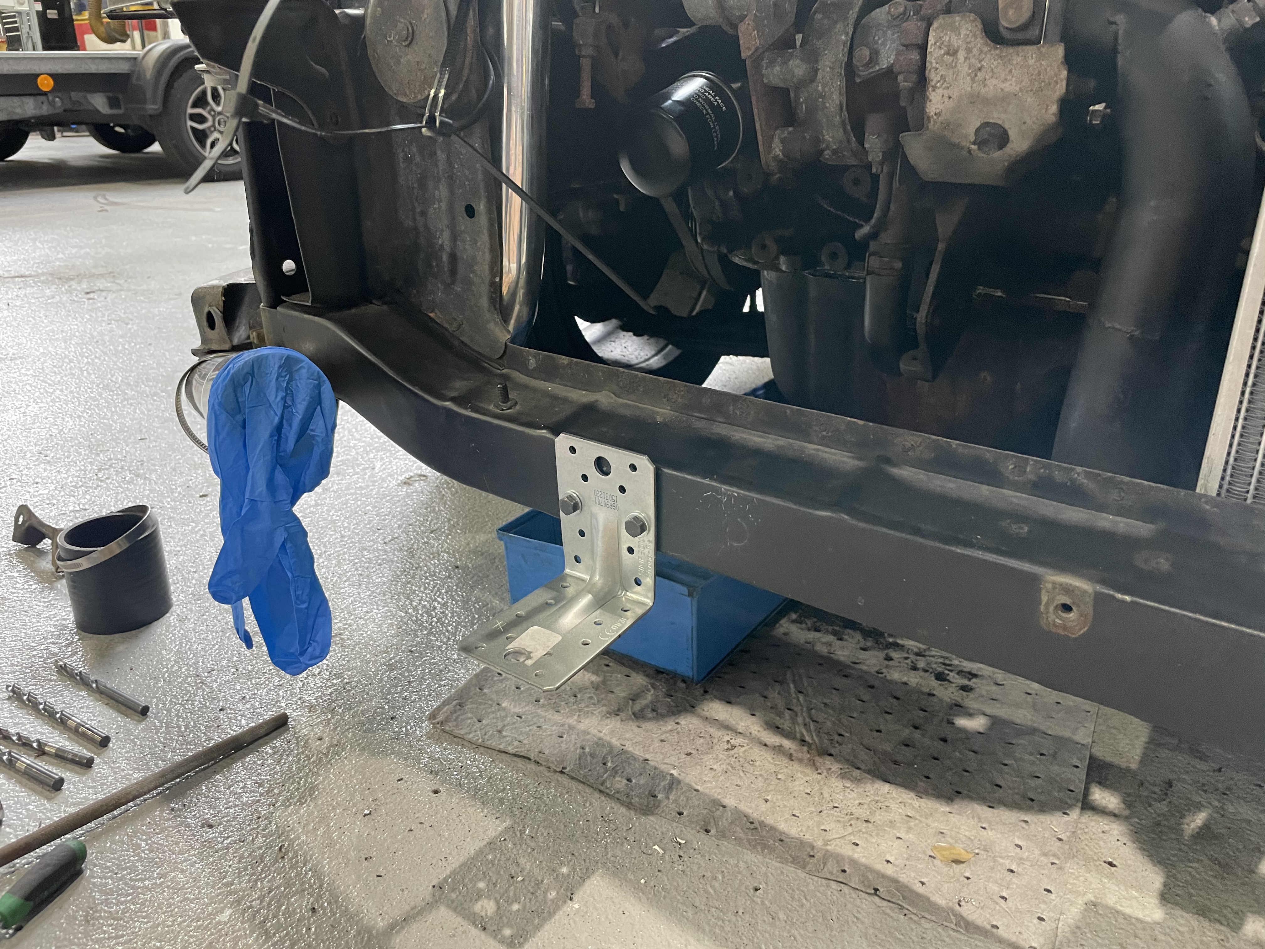

Pikey009 Posted May 19, 2021 Author Posted May 19, 2021 Got everything bolted back up and was happy to find no more blowing issues. So next up was mounting the intercooler properly. Once I was happy with the position of the core I mock mounted the support brackets and marked up the crash bar. Quote

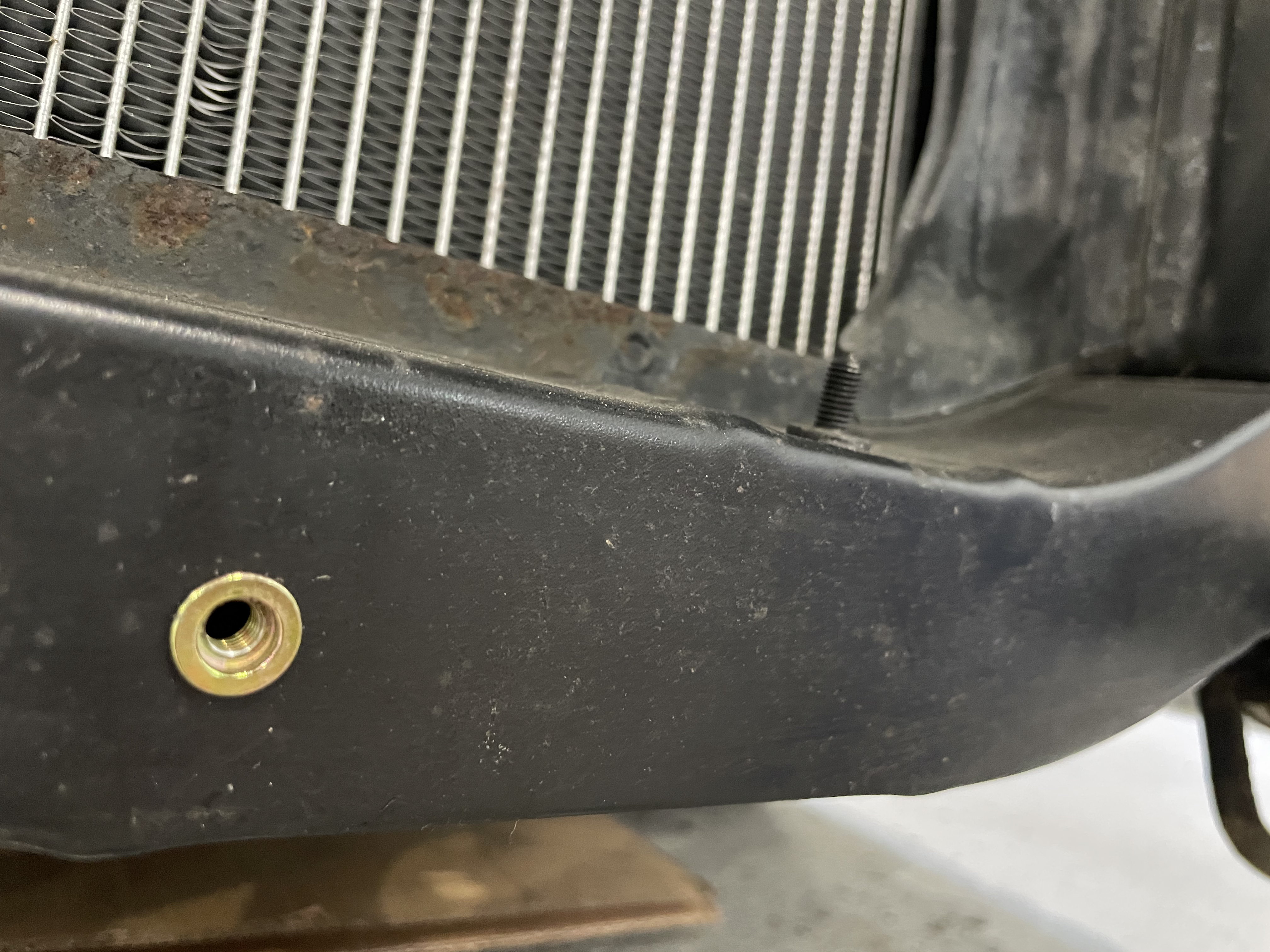

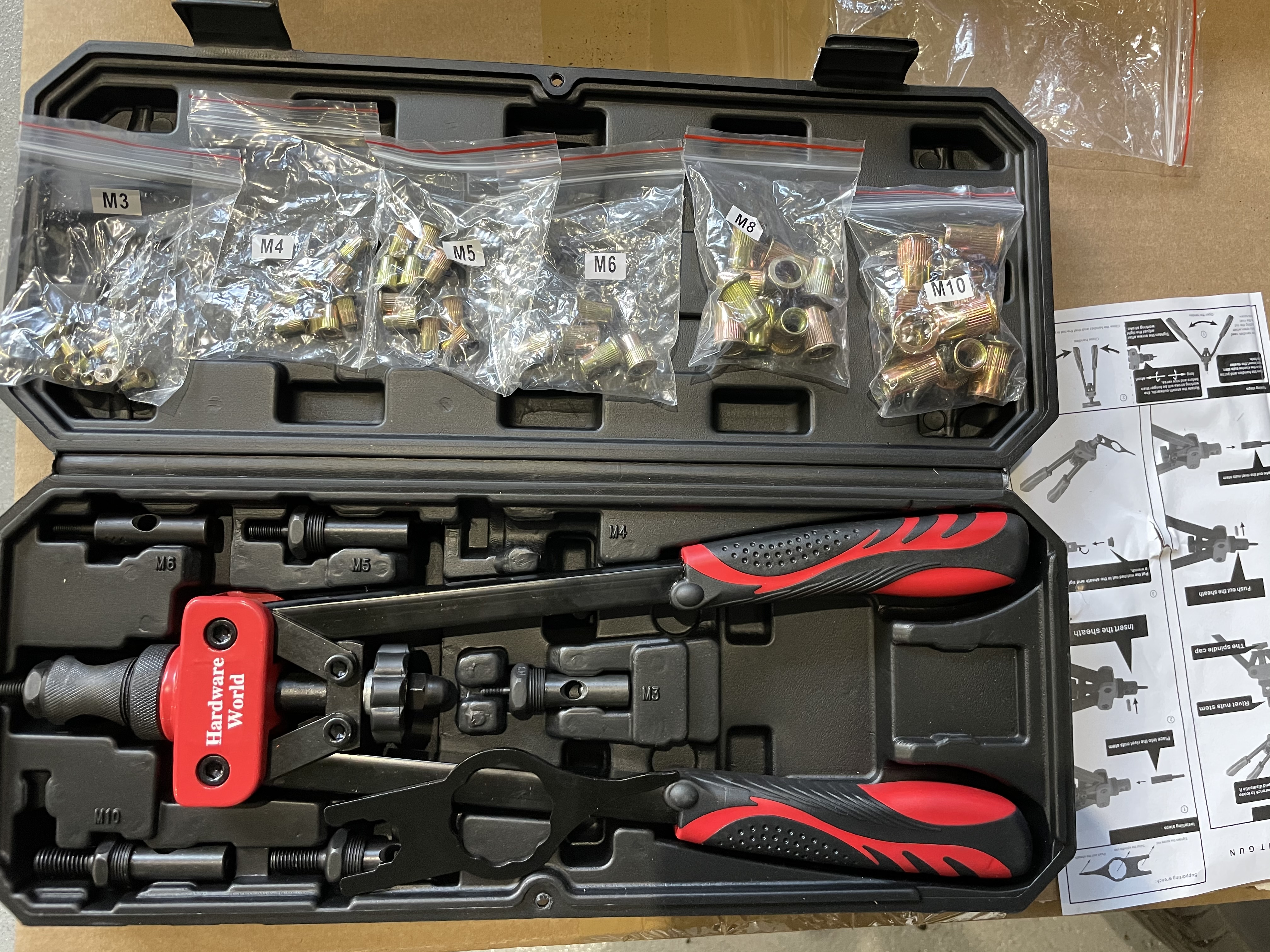

Pikey009 Posted May 19, 2021 Author Posted May 19, 2021 Once the holes were drilled I inserted an M6 rivinut. I got the gun and the nuts for £28 on Amazon. Quote

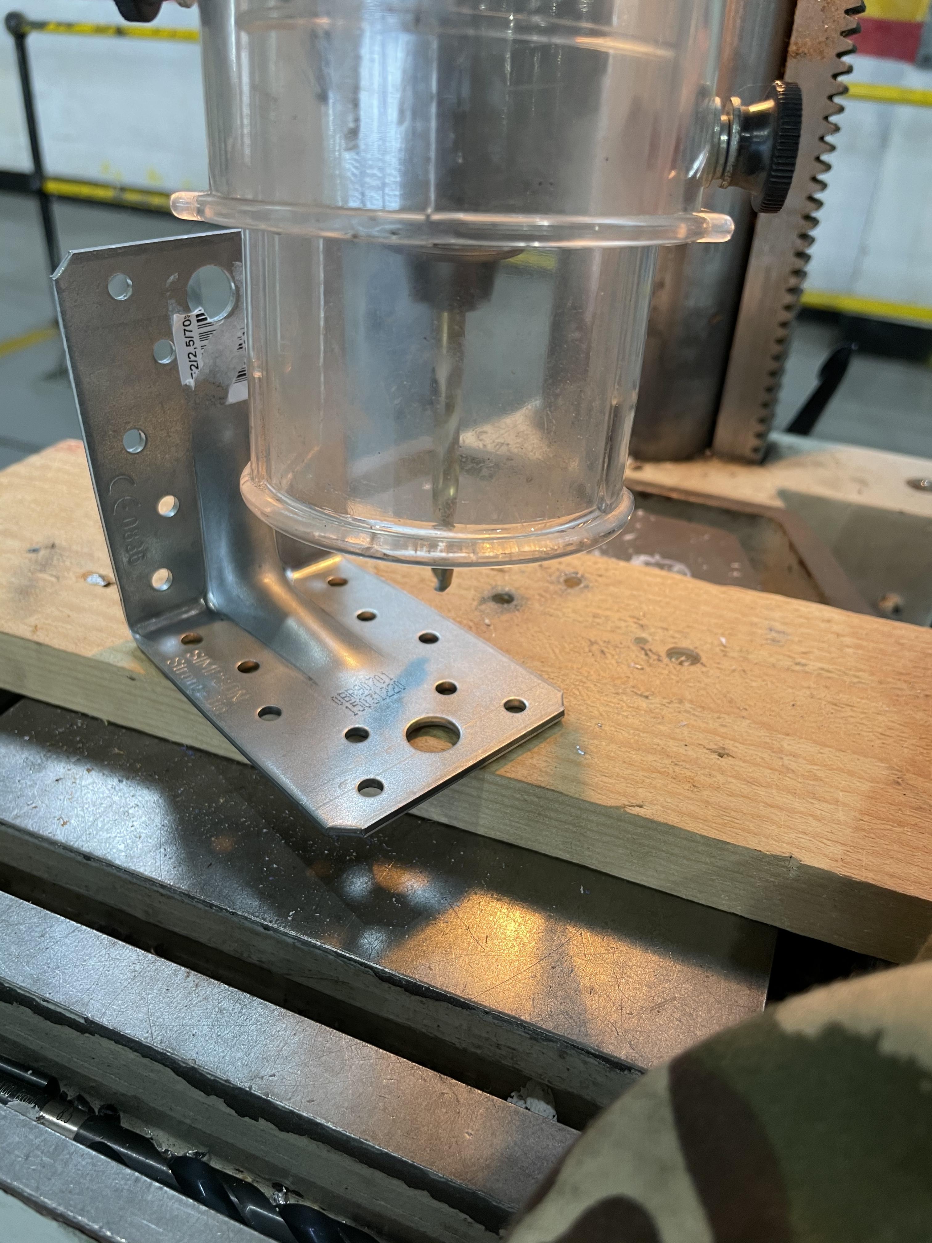

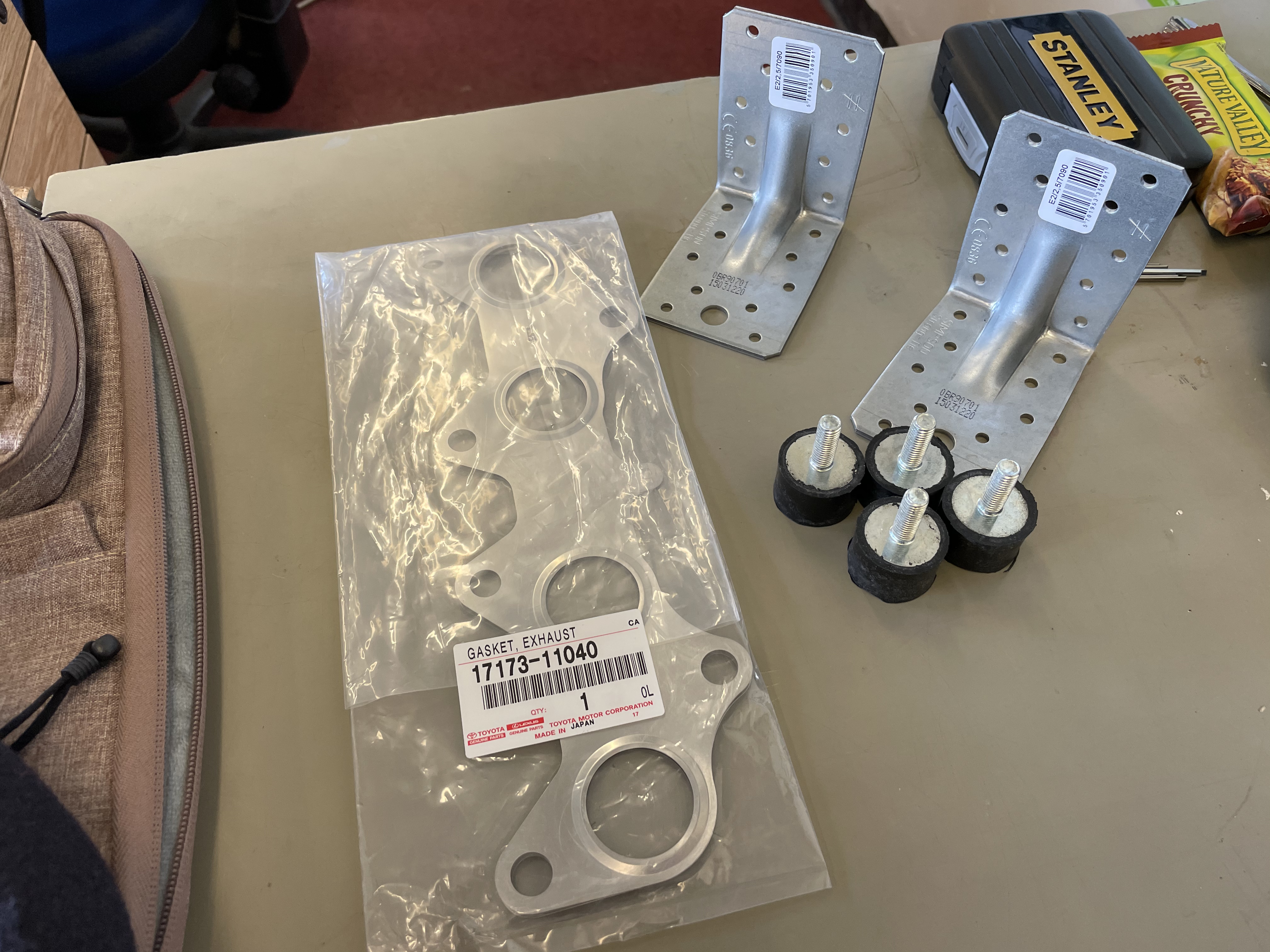

Pikey009 Posted May 19, 2021 Author Posted May 19, 2021 Nice clean finish and worked a treat. I widened two of the wholes on the brackets to accept the M6 bolts. The brackets are from screw fix and I had to buy 25 as you can’t buy them individually! But they are lightweight, strong and galvanised. Quote

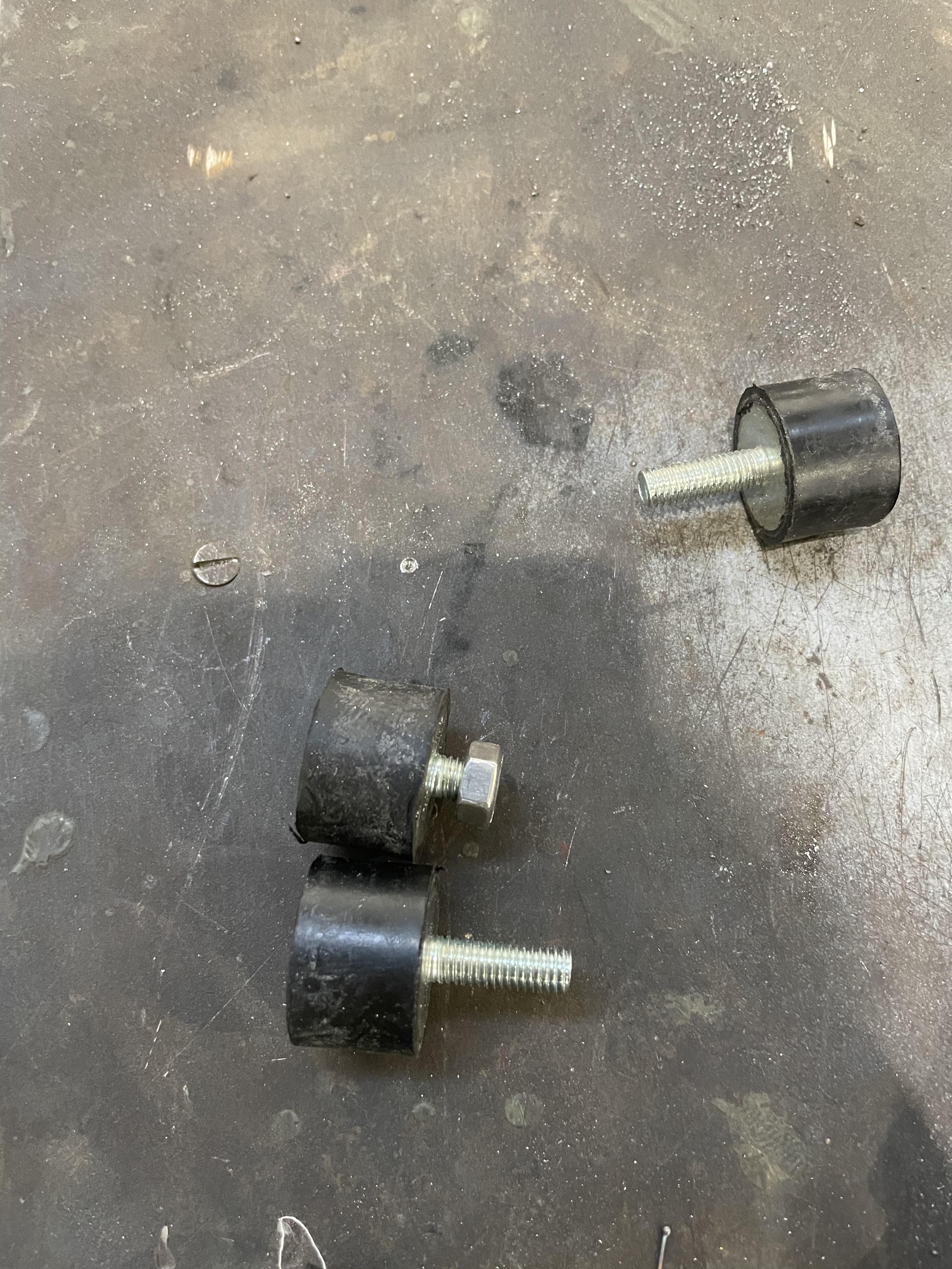

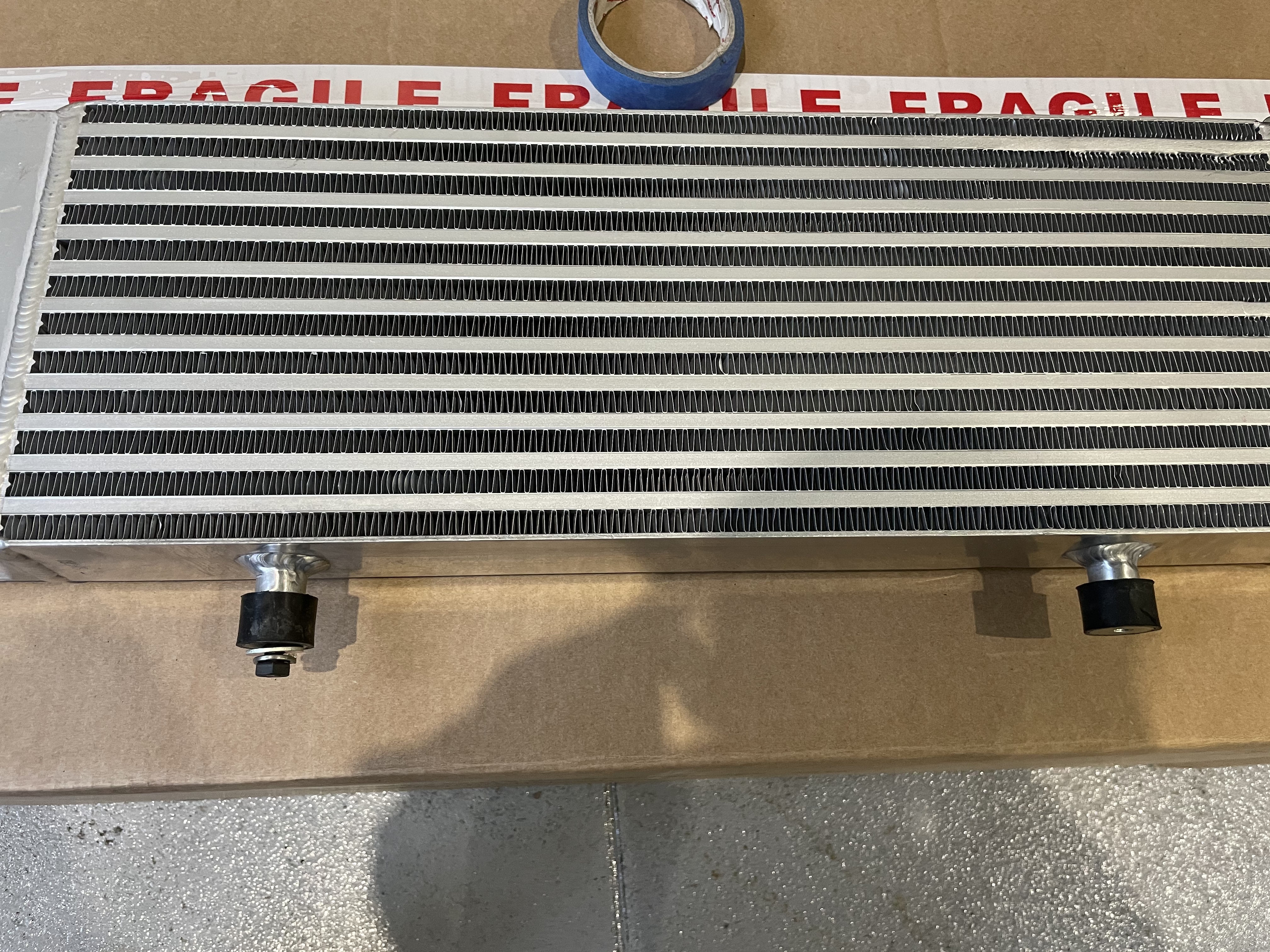

Pikey009 Posted May 19, 2021 Author Posted May 19, 2021 I ordered some threaded rubber dampers from eBay. The idea is that they will provide a little bit of give rather than solid mounting the core that would transmit shock through the threaded mounts. I had to trim them a little so that they could sit flush. Tip: if you’re trimming a thread, wind a nut on before you begin to cut. It can be used as a guide, stops you damaging other threads and once you’ve cut through, as you wind it off it re-cuts the original thread so that it’s easier to wind in to where ever it’s going. Quote

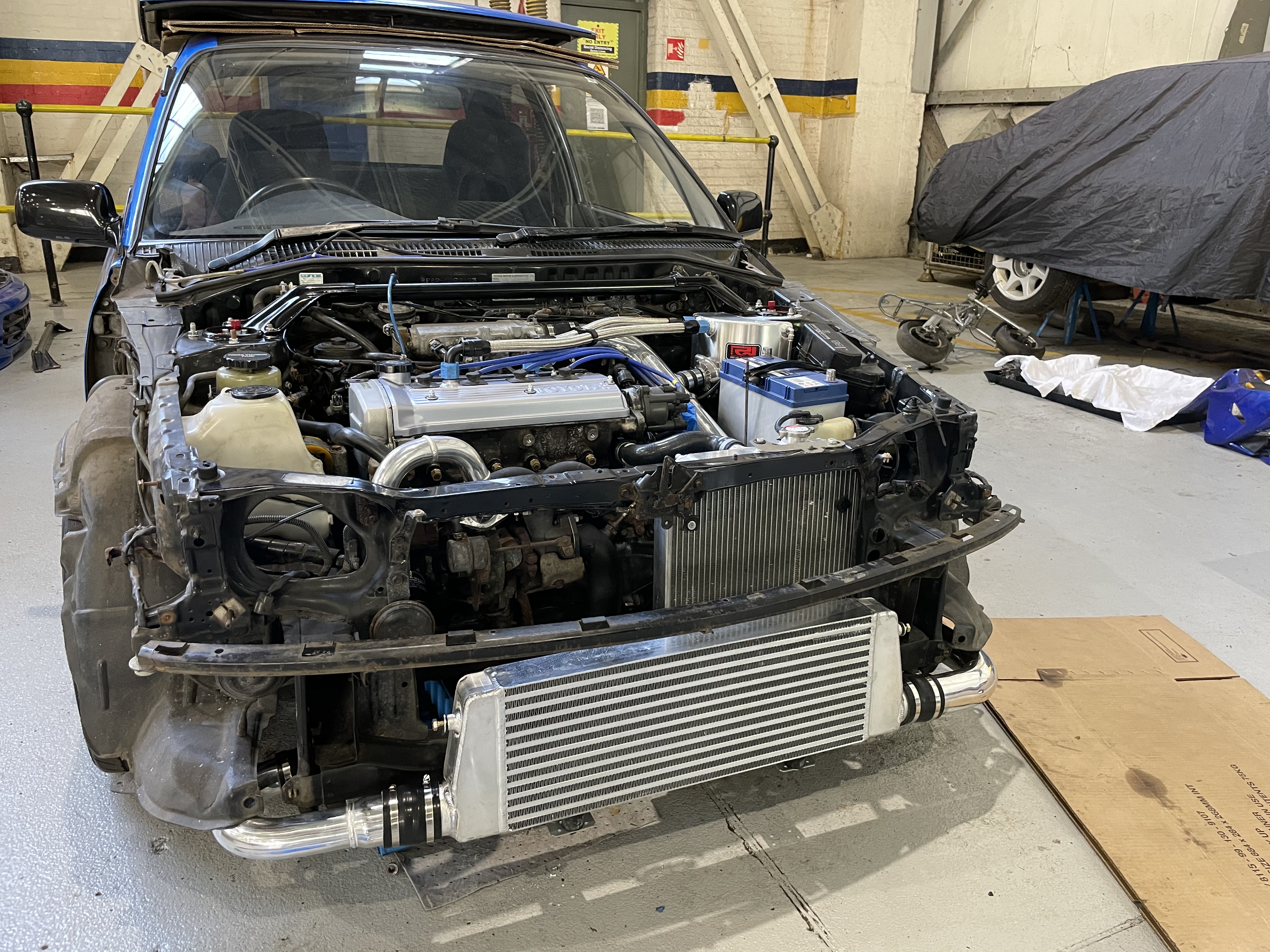

Pikey009 Posted May 19, 2021 Author Posted May 19, 2021 Got the core mounted nicely and then tightened all of the pipe work which fits perfectly. Really happy with he result but I’ll have to trim some of the front bumper to get it to sit on properly. This won’t be visible once fitted. Next, I need to Fabricate the two upper mounts. Quote
Pikey009 Posted May 19, 2021 Author Posted May 19, 2021 I’ll mock up the brackets tomorrow. I also trimmed the intake pipe so I should be able to get that mounted properly too- the air filter needs a support bracket making. next week I’ll be tackling the leaky sump Quote

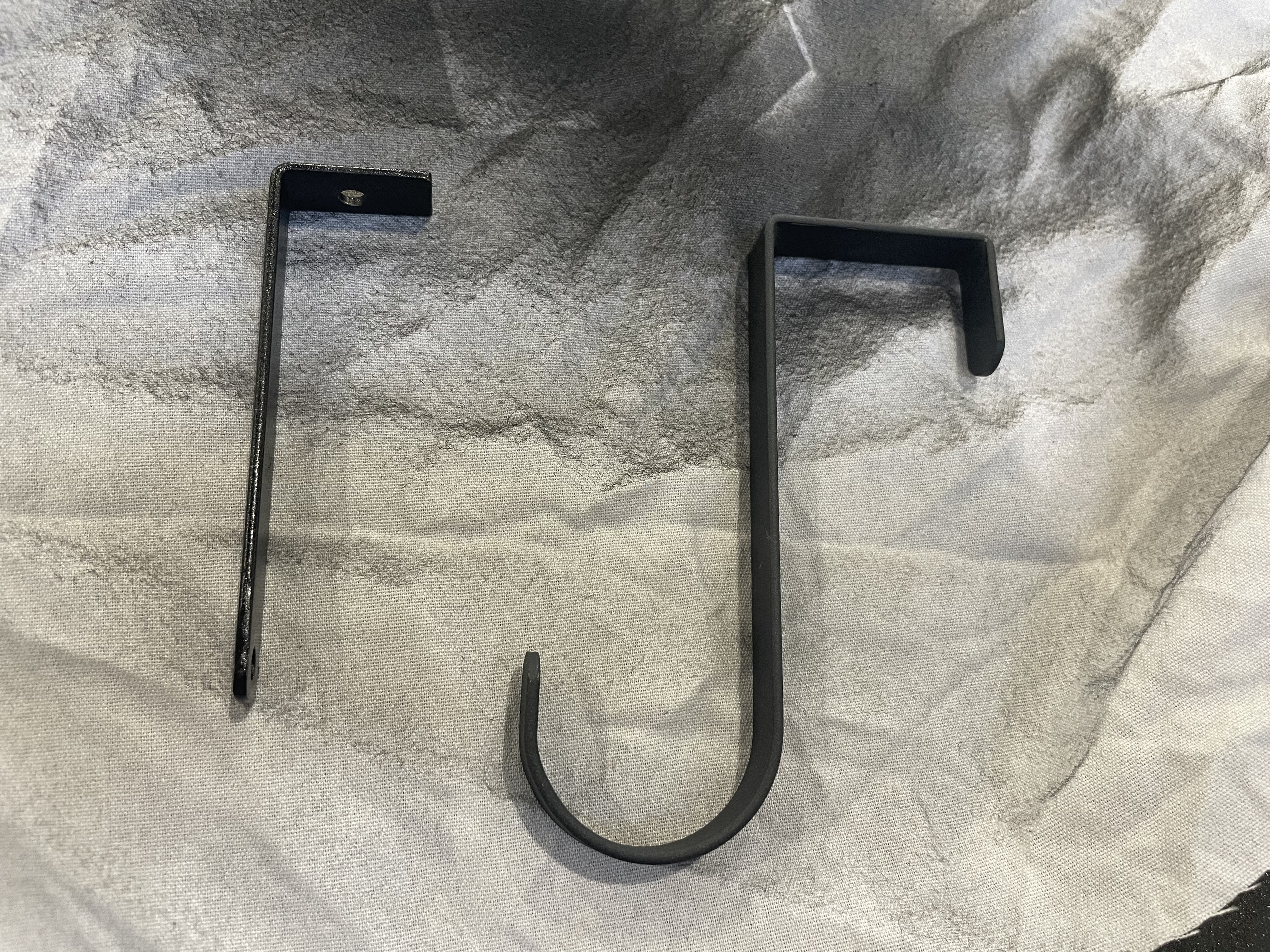

Pikey009 Posted May 26, 2021 Author Posted May 26, 2021 Made the intake bracket out of an old hook I had laying around. Just bolts up under the slam panel and attaches to one of the bolts in the apexi filter Quote
