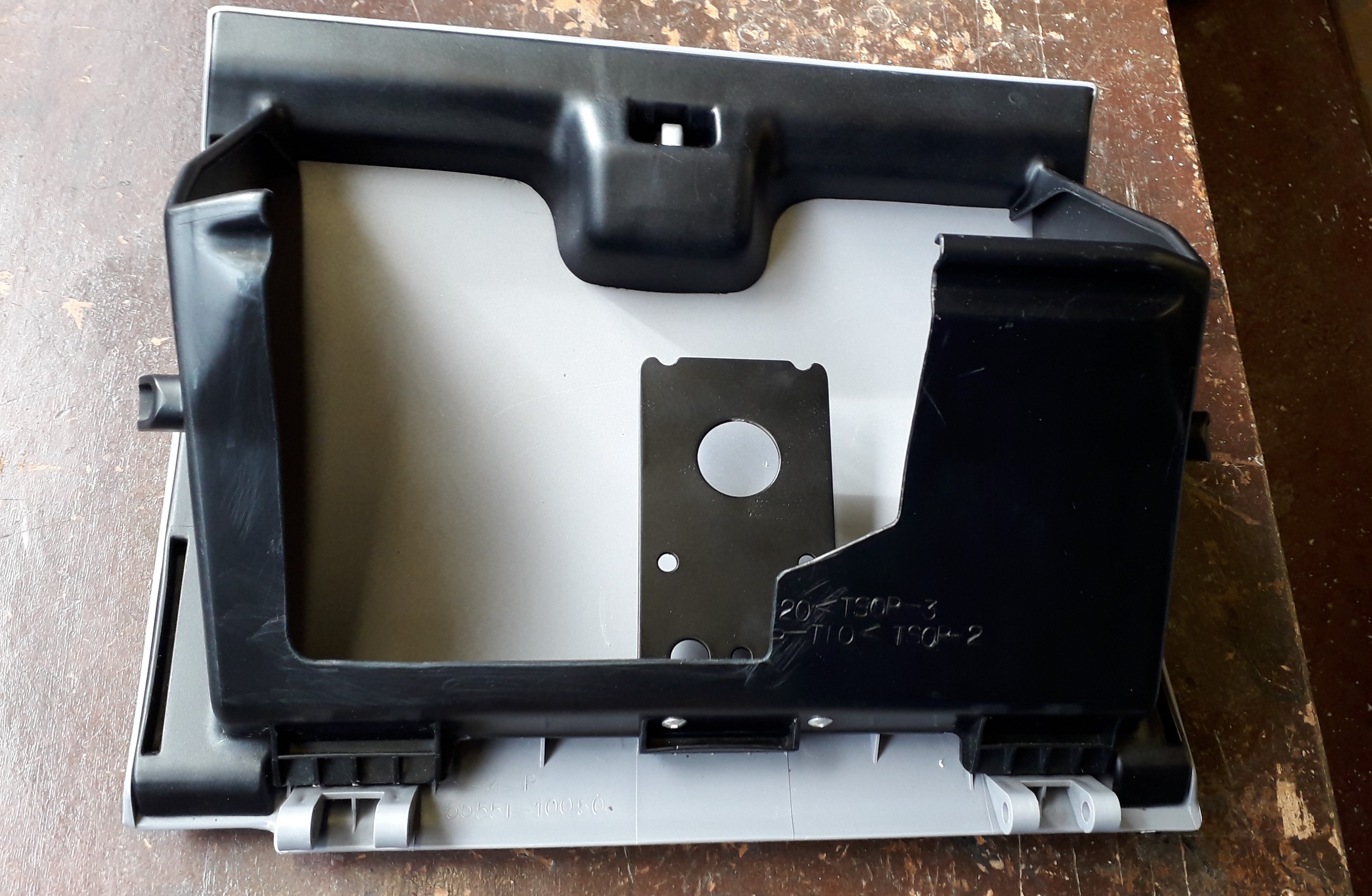

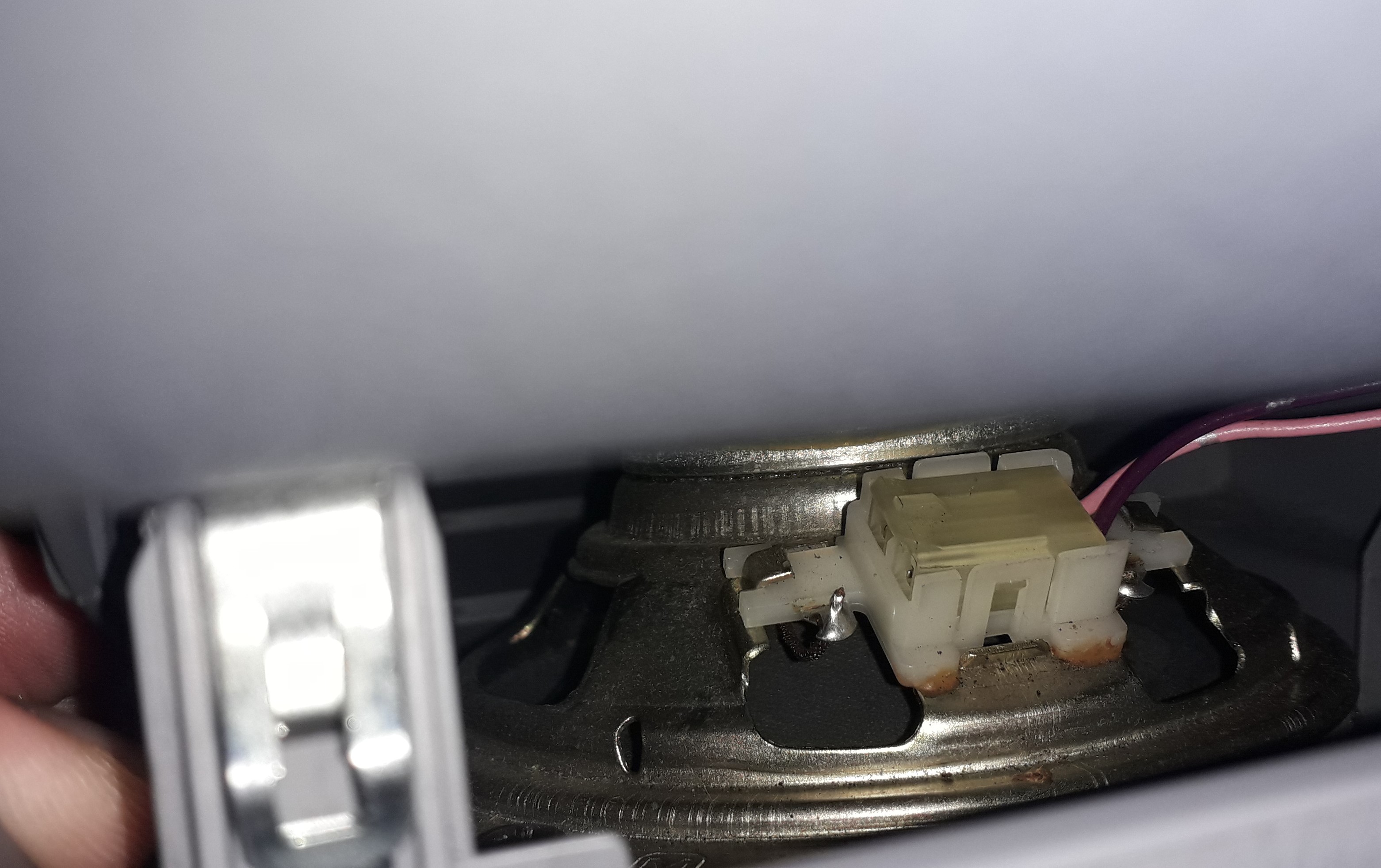

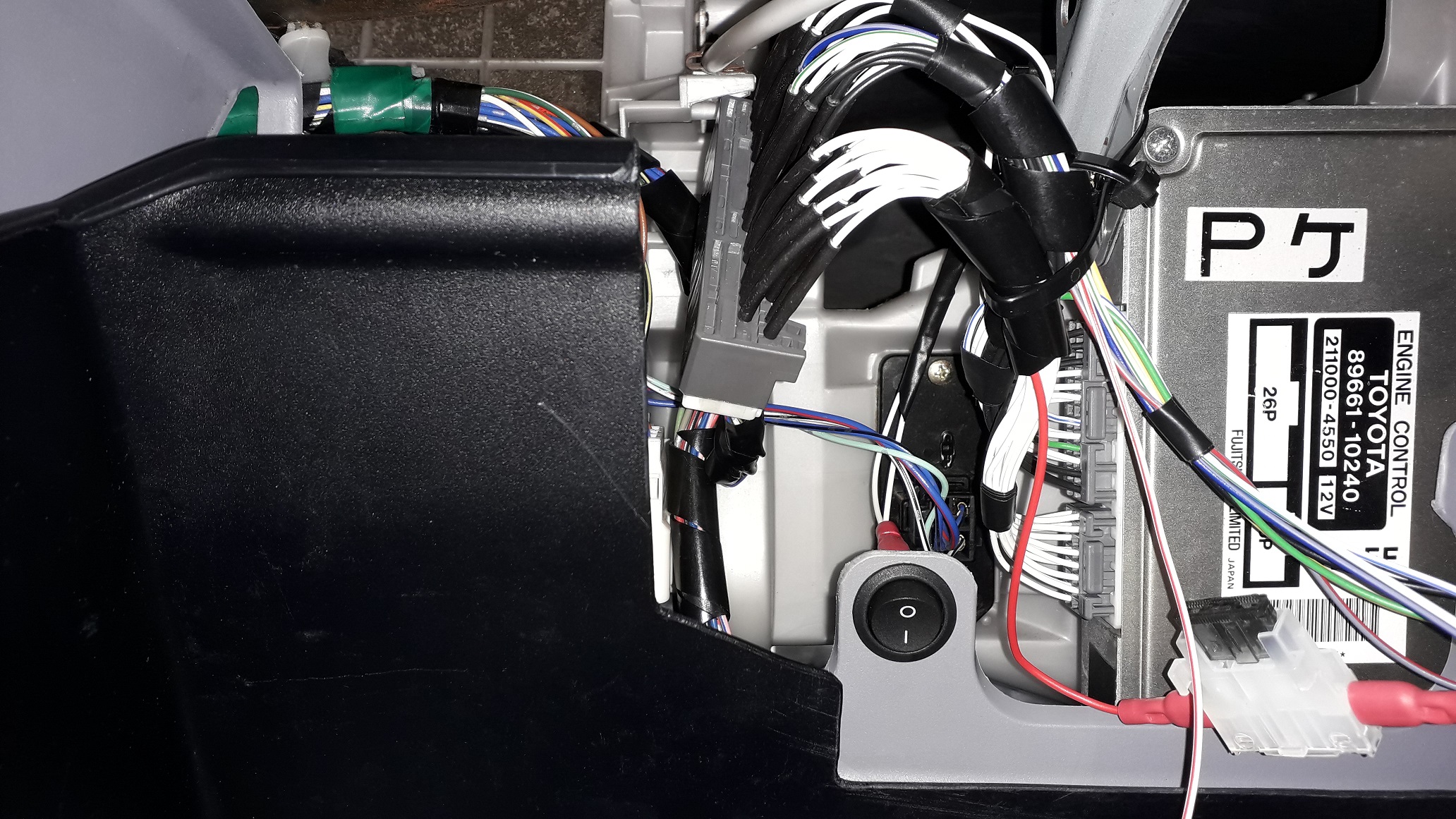

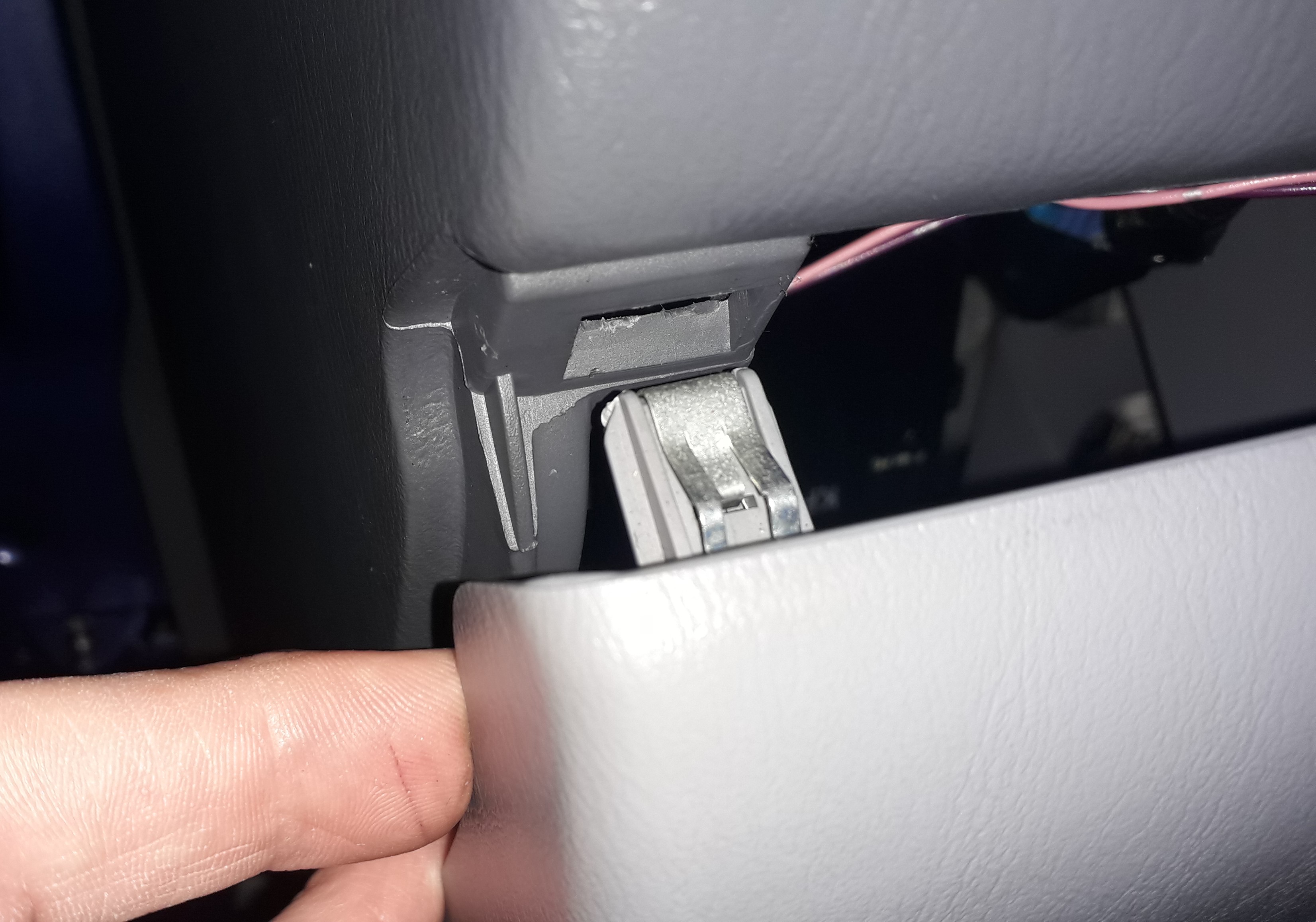

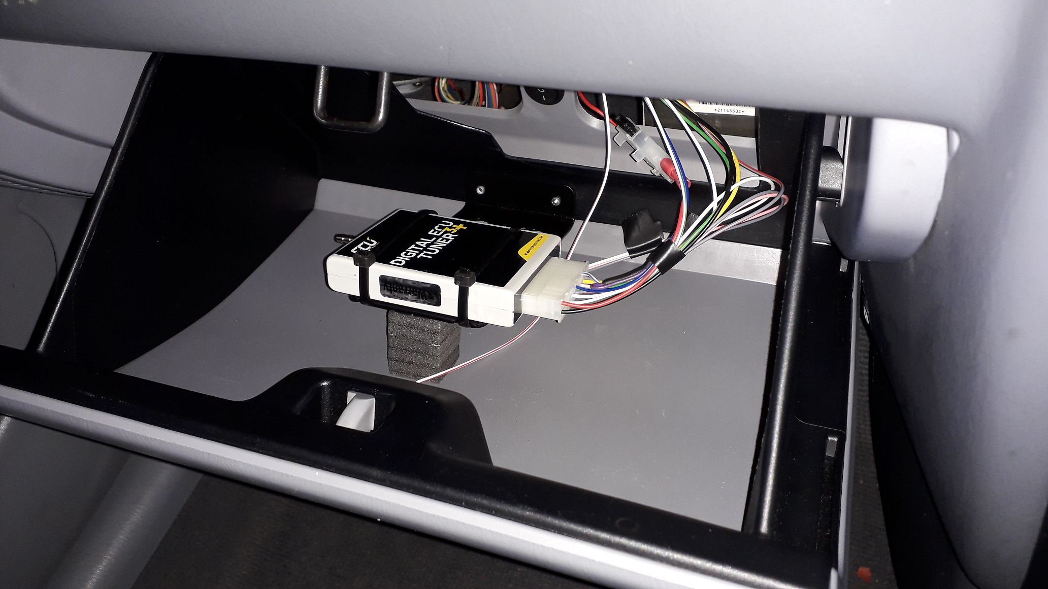

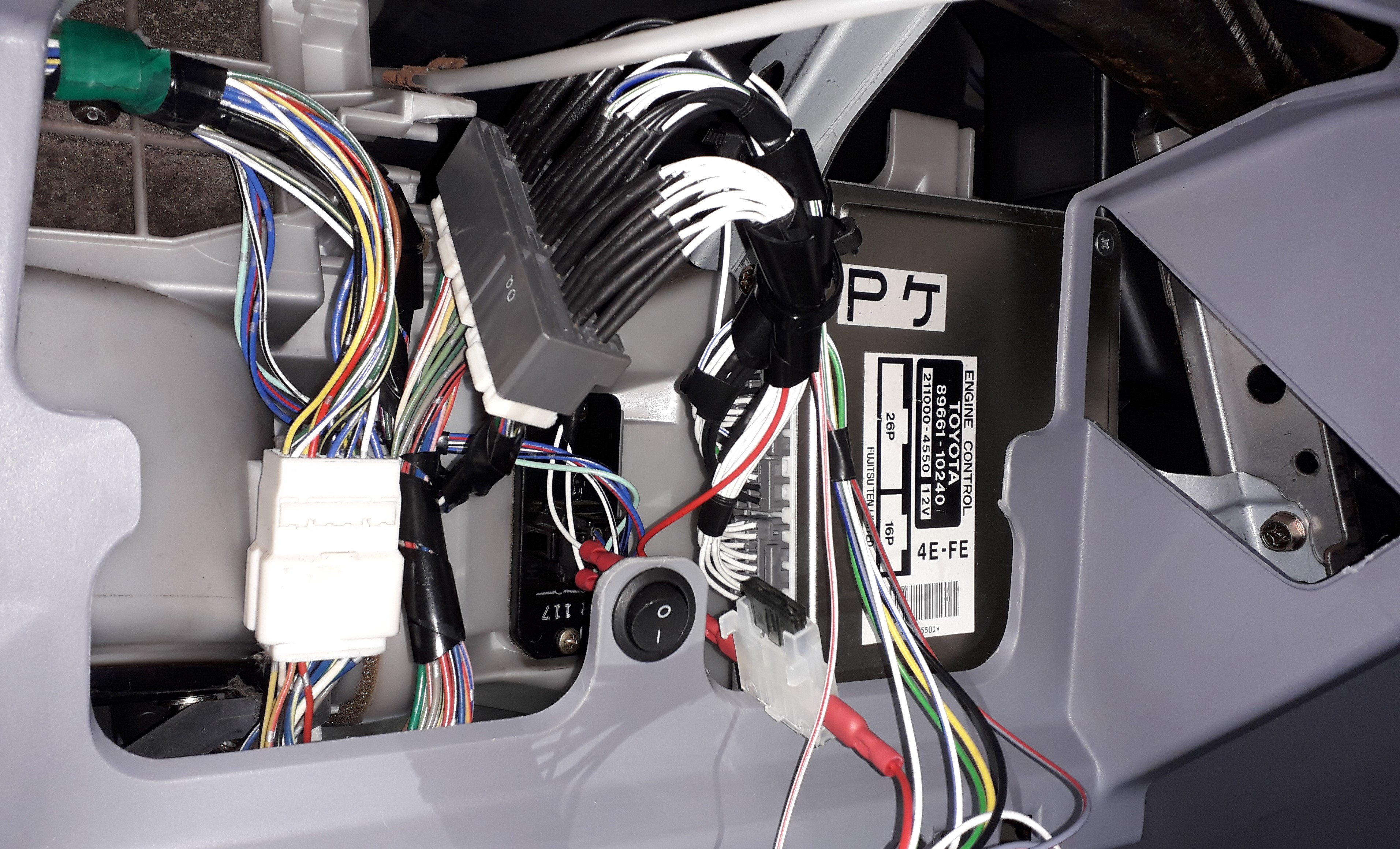

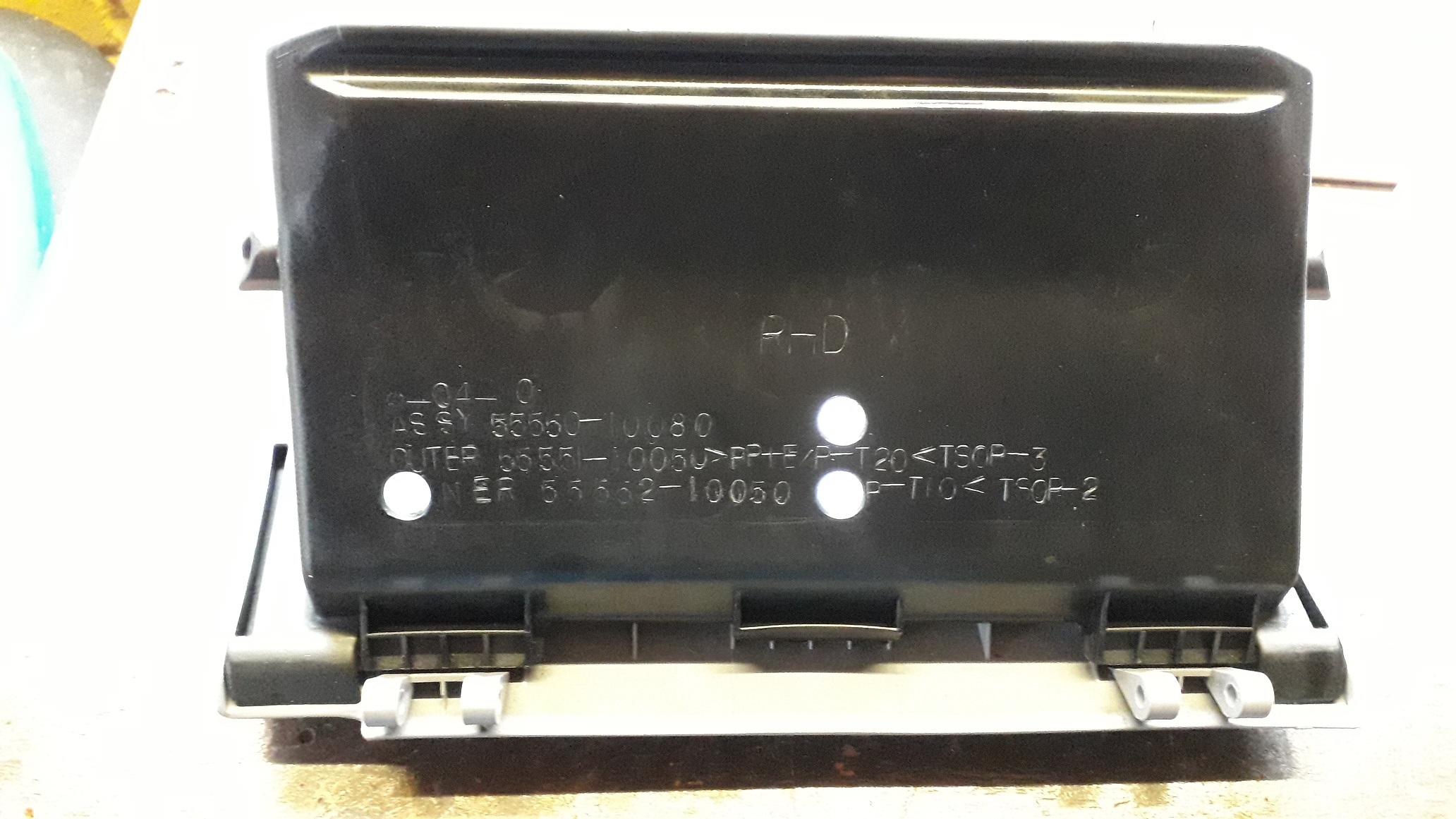

Claymore Posted February 16, 2021 Author Posted February 16, 2021 (edited) ECUmaster det 3 harness install. First I needed to remove the glove box and dash panel, there are 2 screws at the bottom to remove and once the glovebox is open there are three in a row at the top edge. Then I pulled the top left hand corner down to release a spring clip. The bent the plastic retaining clips off the speaker plug and disconnected it. The lower left corner of the panel needed lifting up and out from behind the sill corner trim piece, roll panel away from dash and out the door. Edited February 16, 2021 by Claymore Quote

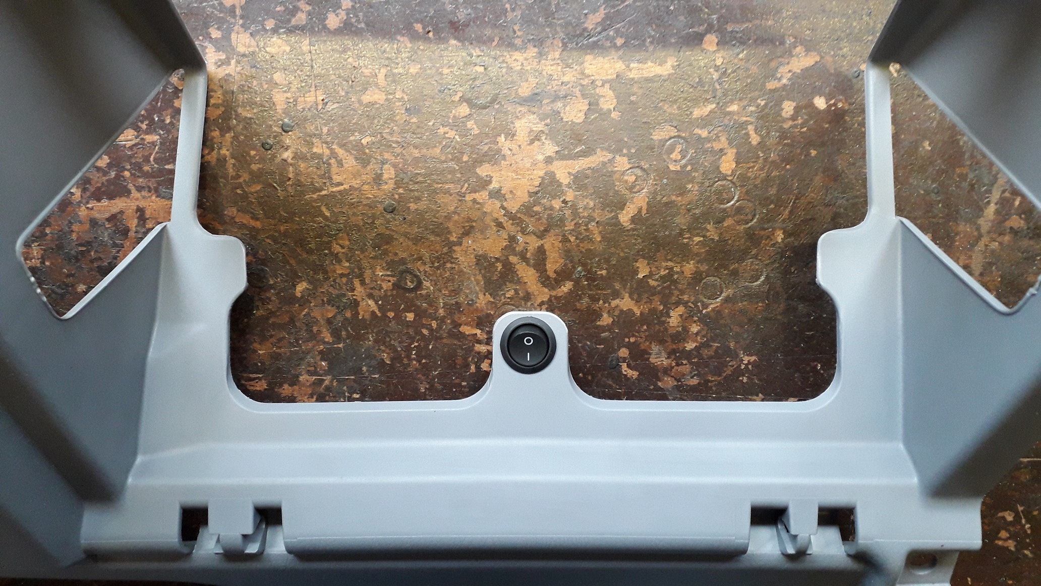

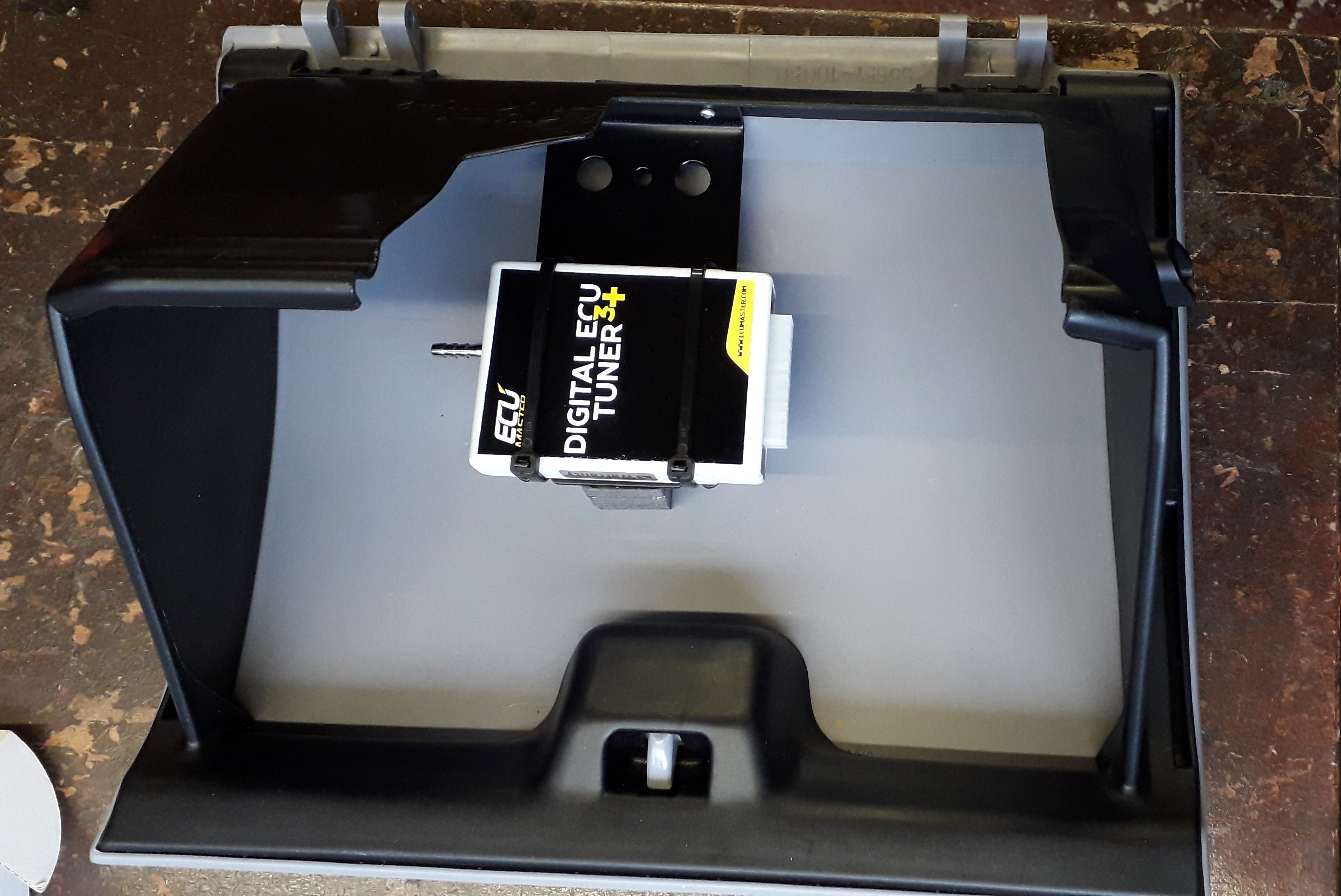

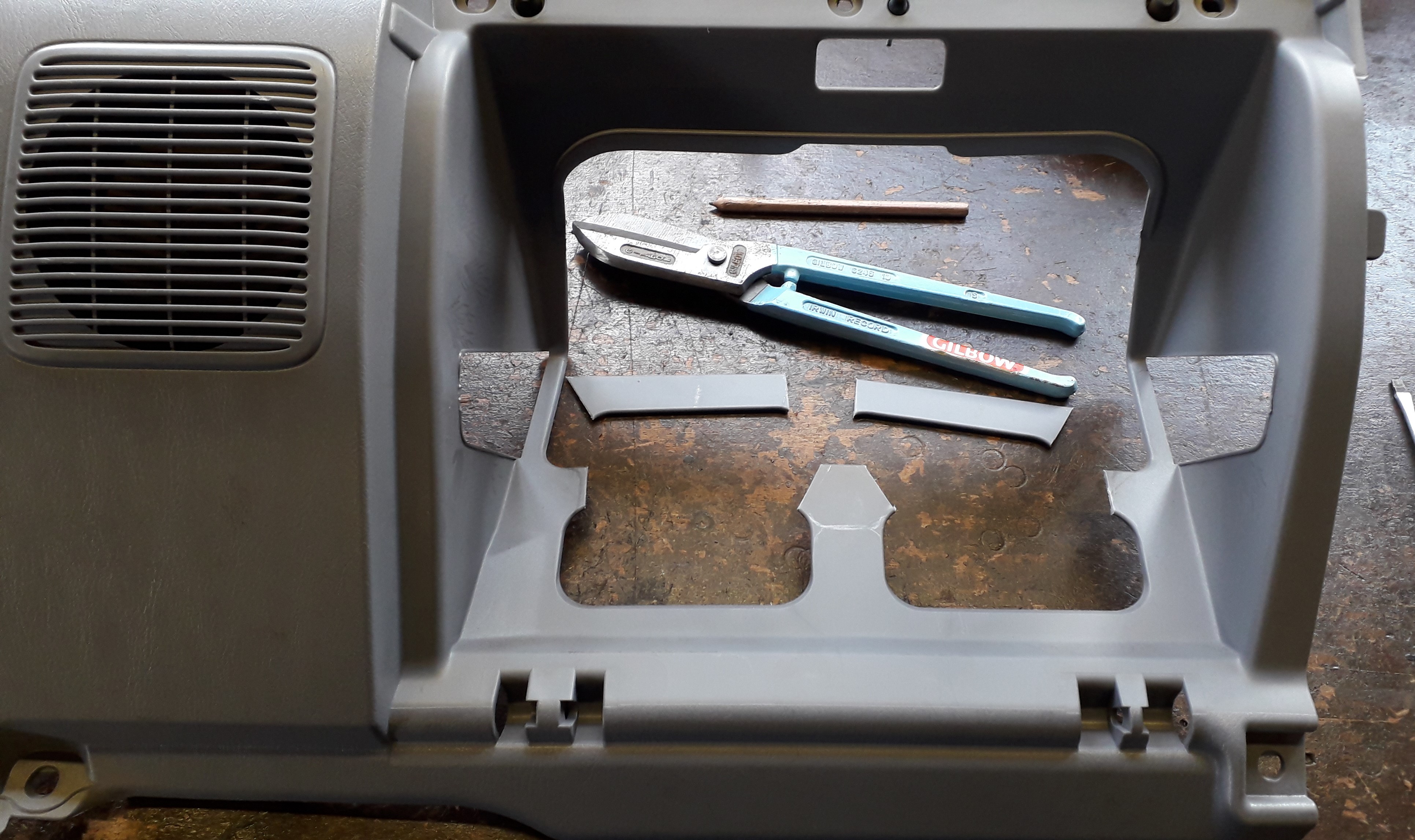

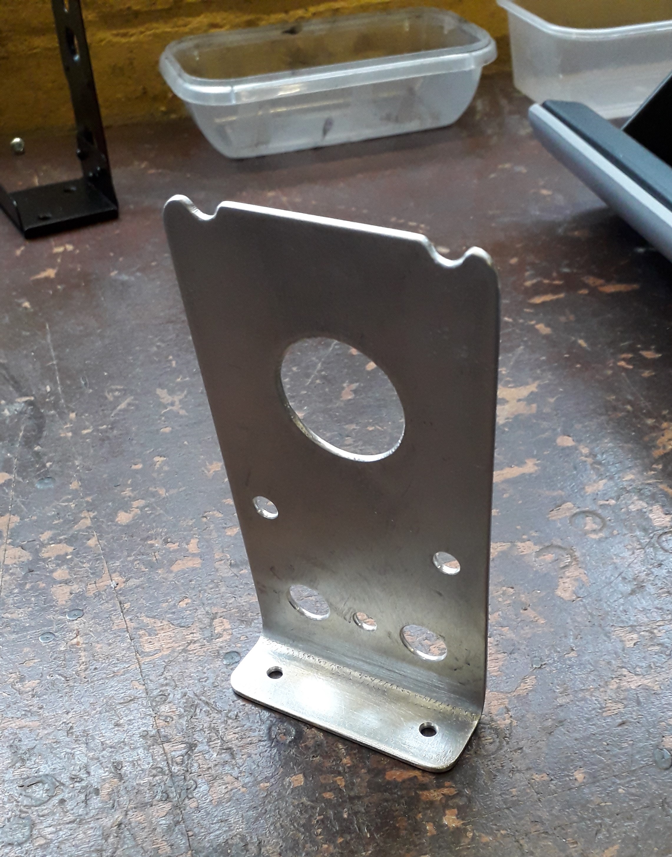

Claymore Posted February 16, 2021 Author Posted February 16, 2021 (edited) Needed to make some room for the new components and there isn't much room for the Toyota stuff so I cut out the "T" section of the panel. Drilled the hole for the O2 off switch (drilled the hole off to the left slightly on purpose 🙄 🤬) smoothed off the edges to prevent chaffing. Installed the PnP harness into the ecu and the car loom into it. I added spiral wrap plastic to prevent chaffing on the necessary areas (contact with parts / cable ties), bent it gently to shape and cable tied the harness up as far as I felt reasonable without causing any undue strain to the contacts at the header end. I could have moved it up higher and further back but I felt happier with its position here. This left an obstruction where the glovebox wants to be so it was time to chop the box up. First I drilled holes in the corners of the area to be cut out. This adds a curve to the corners where the cuts meet as you cant put it back in afterwards. Step drill and cutting disc to the rescue once more. Cut edges were scraped with a stanley blade to make smooth. Then I needed to make another bracket to hold the piggy back in place. Started by recycling another piece of scrap alu (2mm thick). Marked out the holes and bend line. Finished and folded up. The lower holes are to attach to the glovebox. The upper notches and related middle holes are for the cable ties to hold the piggy. The other holes are for lightness, no need to swage as the material was stout enough. Painted and riveted in. With the structural integrity of the box slightly compromised the bracket had a bit of spring to it and I countered this with some self adhesive foam blocks as a support foot. Strapped in ready to fit. Edited February 16, 2021 by Claymore Quote
Claymore Posted February 16, 2021 Author Posted February 16, 2021 (edited) Fitted the box back into place (2 x plastic axles with arrow clip ends. Can be fitted to panel without removing panel from dash.) Hooked up the harness. There is plenty of room for the attachment of vacuum line and the USB cable access is fine also. Opens and closes without clashing, wiring moves neatly into glovebox. Edited February 16, 2021 by Claymore Quote

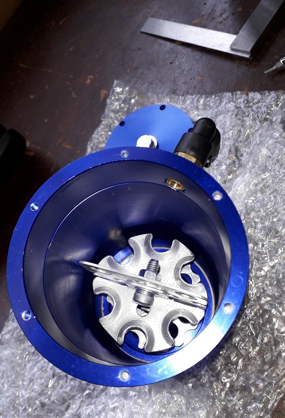

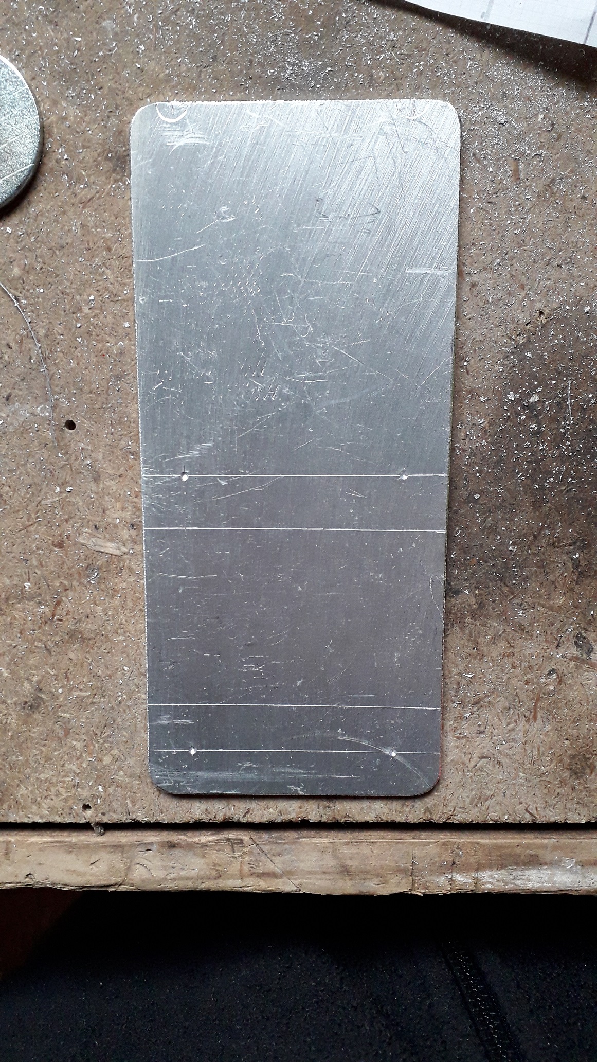

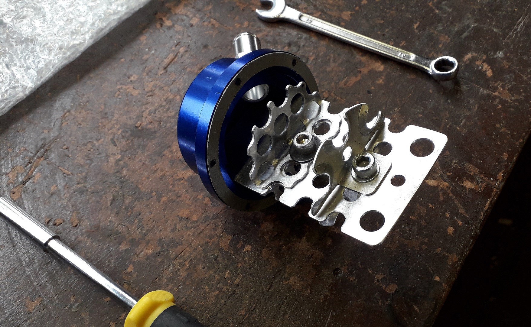

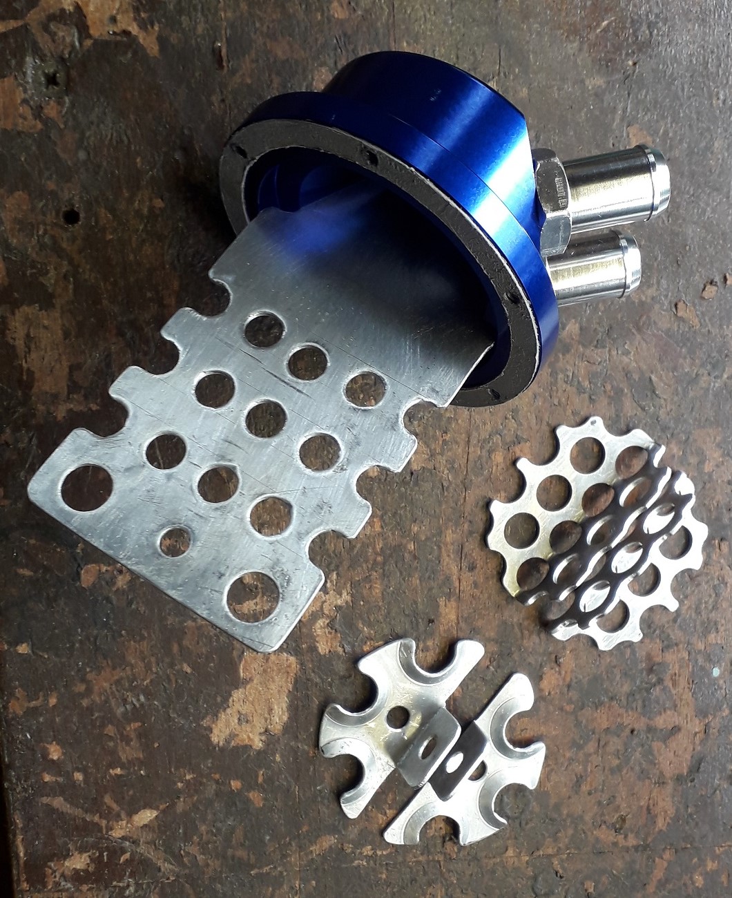

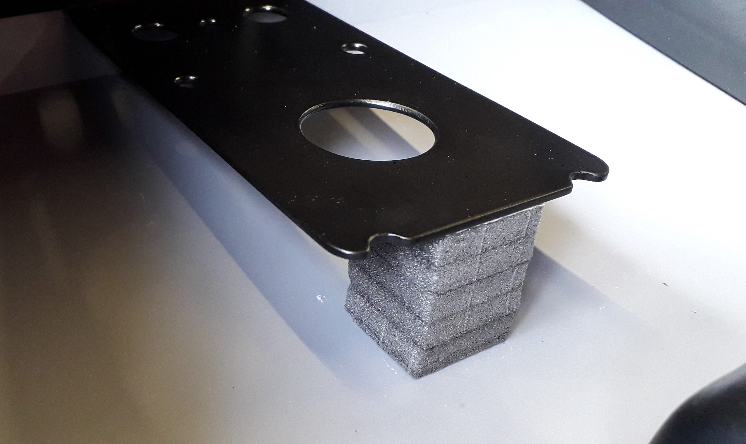

Claymore Posted February 26, 2021 Author Posted February 26, 2021 (edited) Just a quick update, finally received my thread seal so I could do the final assembly of the catch can. Once test assembled the lower baffle plates rattled on the side walls of the can when it experienced shock impact, and over time this would have eroded alu particles that may have entered the crankcase or turbo so......after a lot of swearing I took it apart and modded the internals. It didn't help that the top of the can is slightly off centre due to its cheap construction. Trimmed the centre baffle for width and cut a section off the bottom. Also reduced the size of the baffles. Assembled with fresh locknuts. Thread sealed the level indicator fittings to the can body with Loctite 577. Top of can installed with smear of instant gasket on both sides of the rock hard card gasket that was supplied. No chance of it sealing without. Overall 5mm clearance between the baffles and can wall. No more contact / rattling. Might be less effective, but better than the alternative. Used aluminium anti-seize on the threads of the assembly bolts. They're stainless steel going into aluminium. The "little blue bastard" is now ready for install time. Edited February 26, 2021 by Claymore Quote

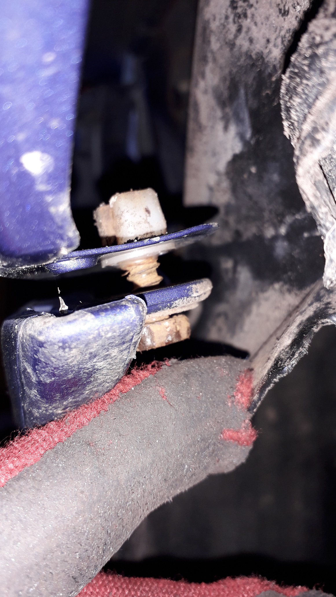

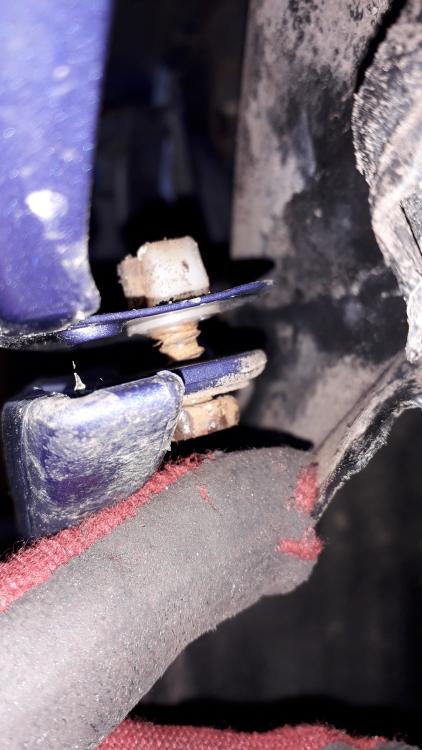

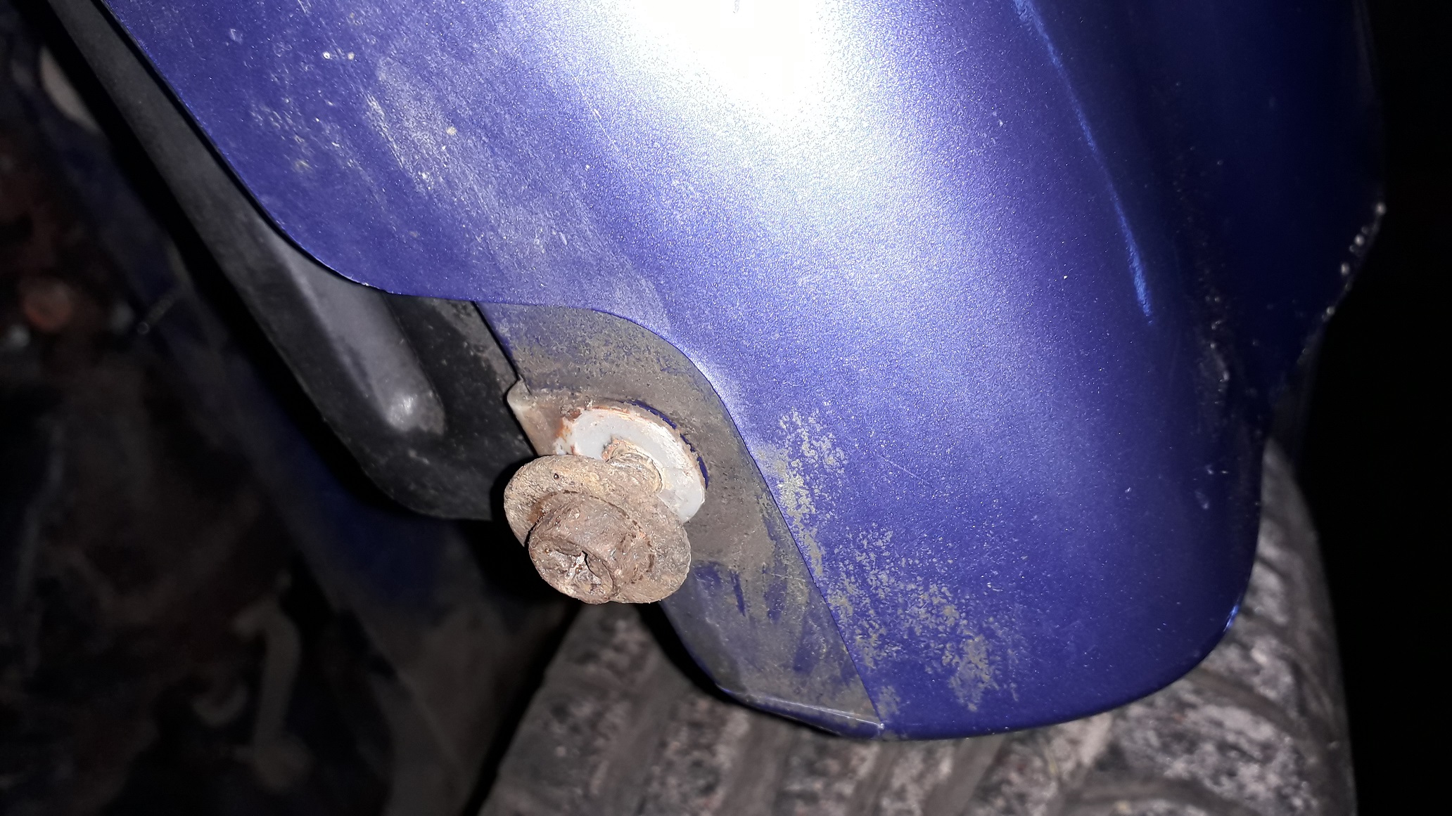

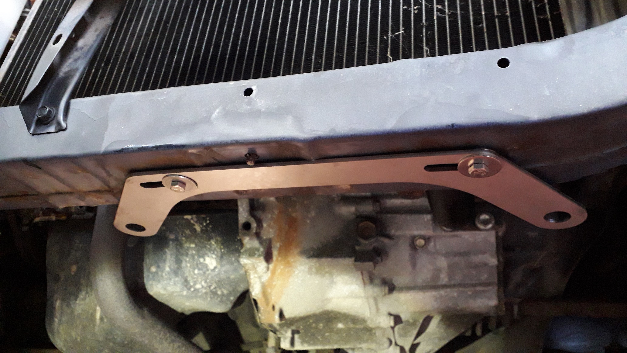

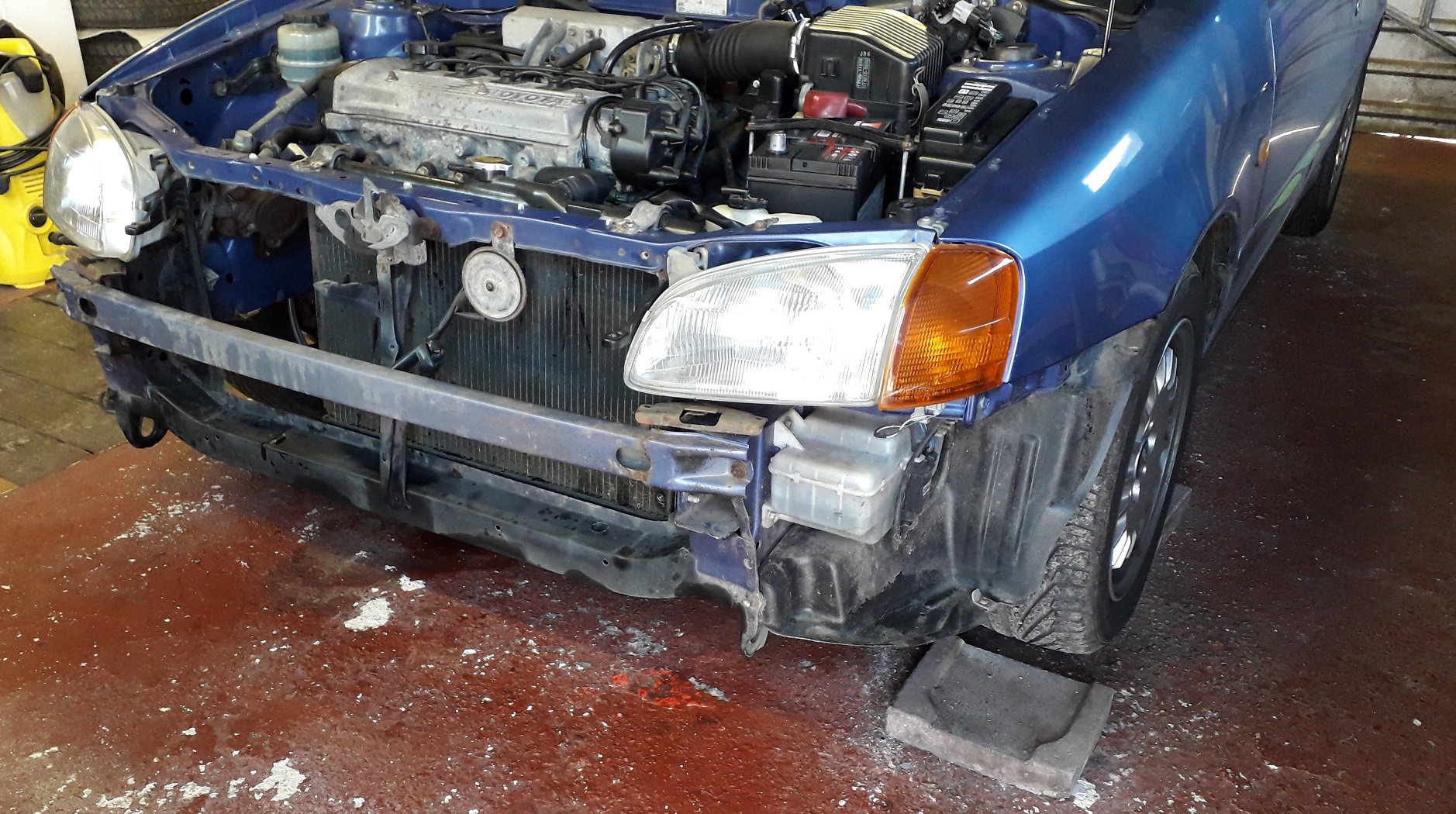

Claymore Posted February 27, 2021 Author Posted February 27, 2021 (edited) So after 320ish glorious N/A miles it begins....... Removed the undertray and front bumper to give access for the upcoming work. Undertray is easy to see the fasteners, 2 x nuts down each side and 4 x bolts across the front cross member. Managed to get all the nuts off fine but the bolts were rusted quite badly, 1 came out, 3 snapped 😲 (par for the course with stuff this old). I even tried the old trick of loosening them 1/2 a turn and then tightened it back up and then loosened a full turned then tightened a half back and repeated to try and "work" the rust off the screw threads. Not really a problem. Then the bumper, 2 x philips self tappers on the top edge of the grille, 2x bolts in the lower grille opening (one each side) 4 x bolts along the bottom of the front cross member (2 out, 2 snapped this time. 🤠), then there are 2 more each side, one at the bottom connecting to the arch liner.... and one behind the arch liner connected to the wing. Unhooked from top grille area and slide forward off brackets under headlights. Currently playing with the power steering setup....more to come. Edited February 28, 2021 by Claymore Quote

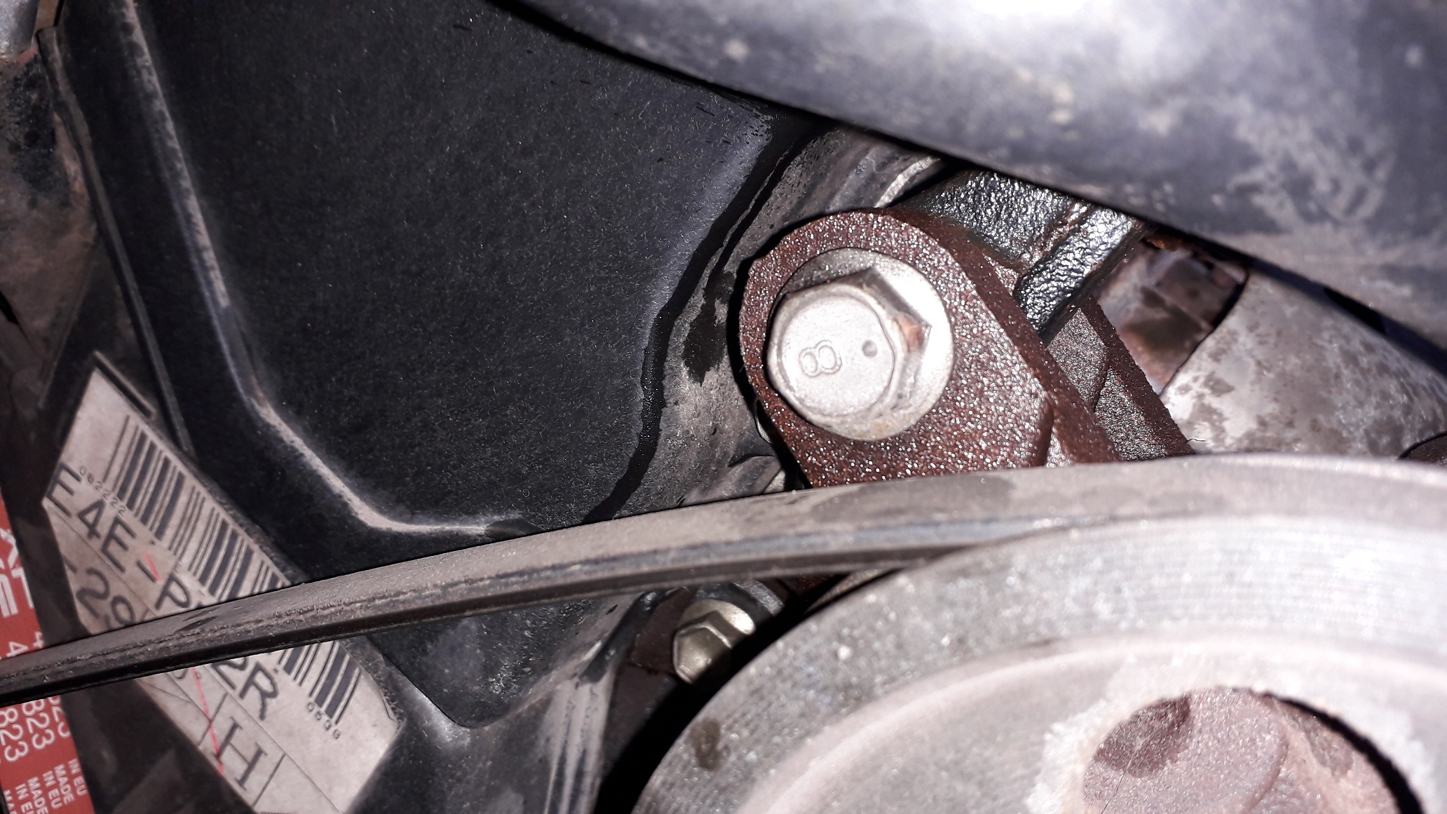

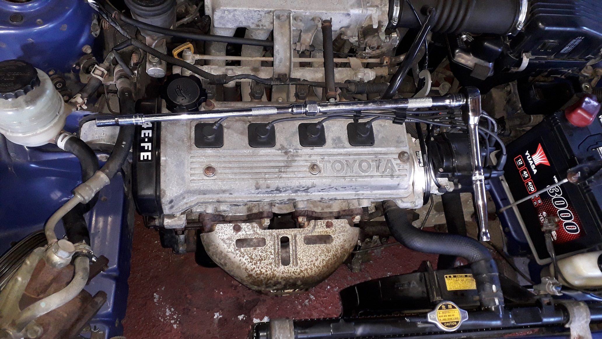

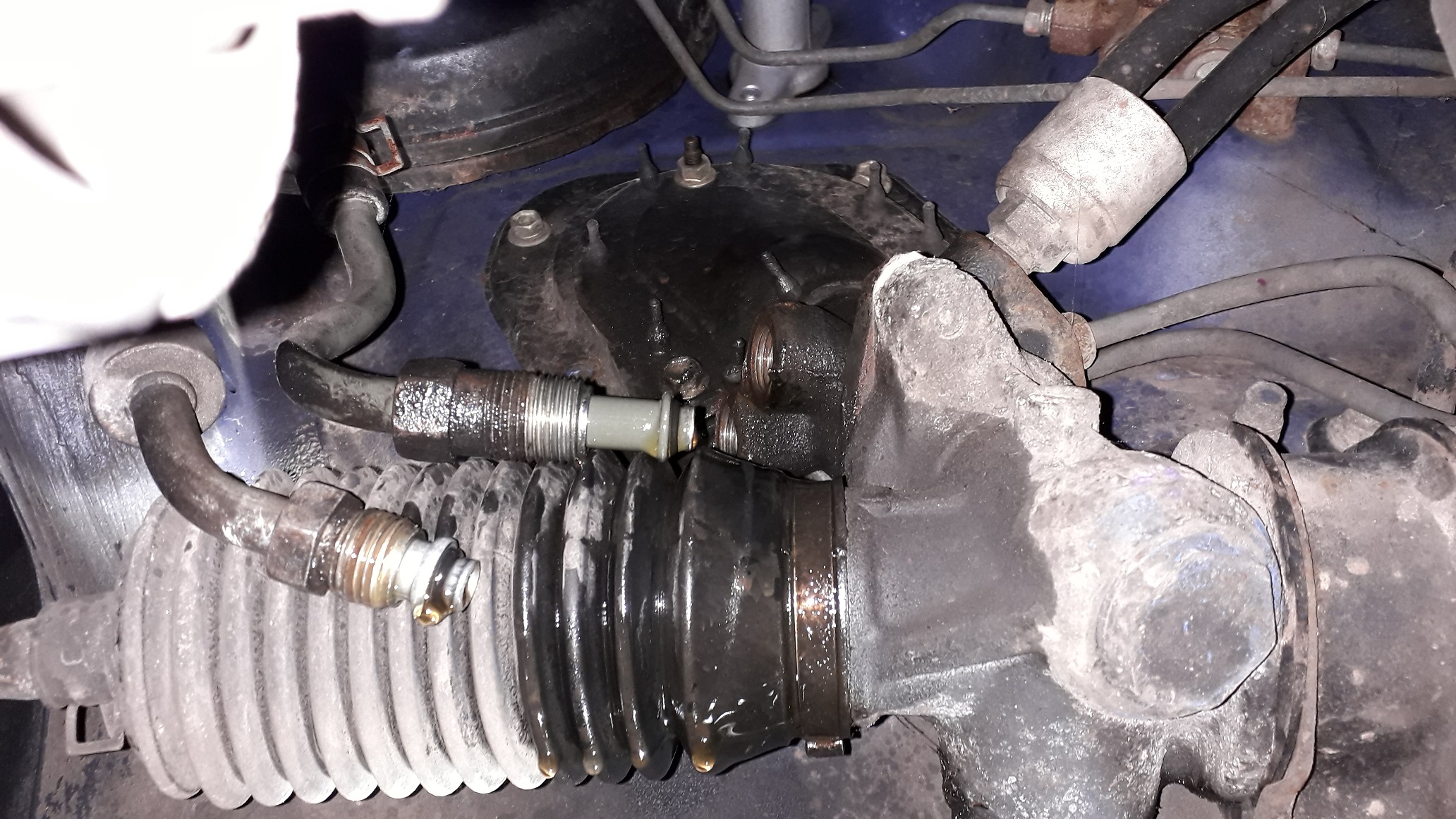

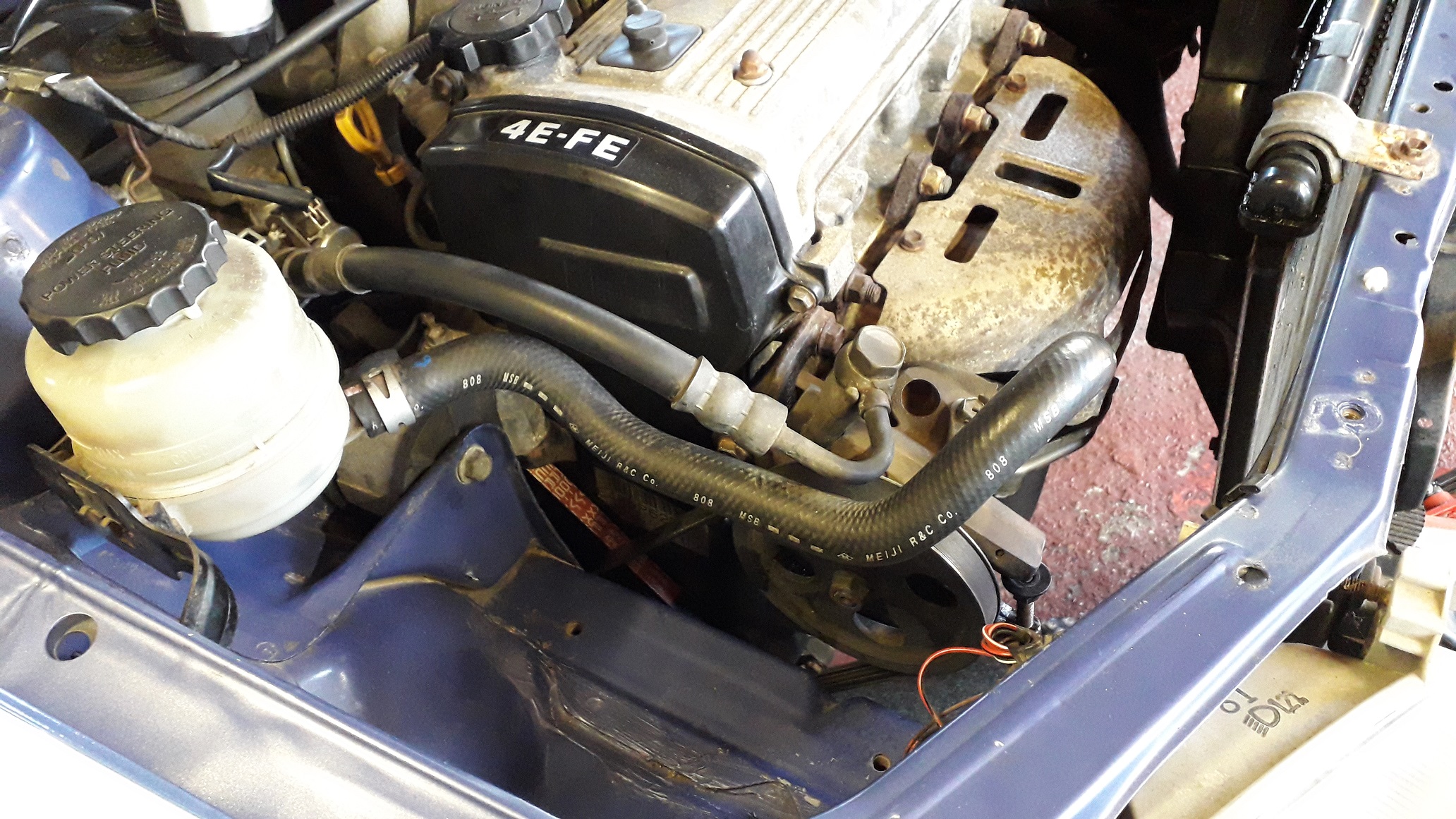

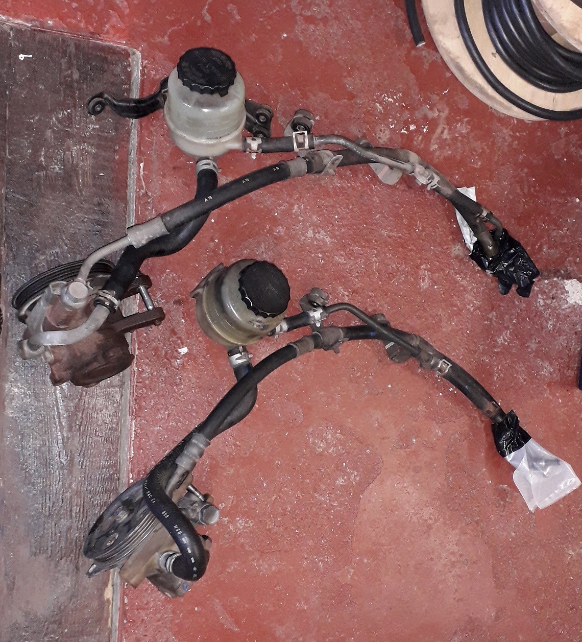

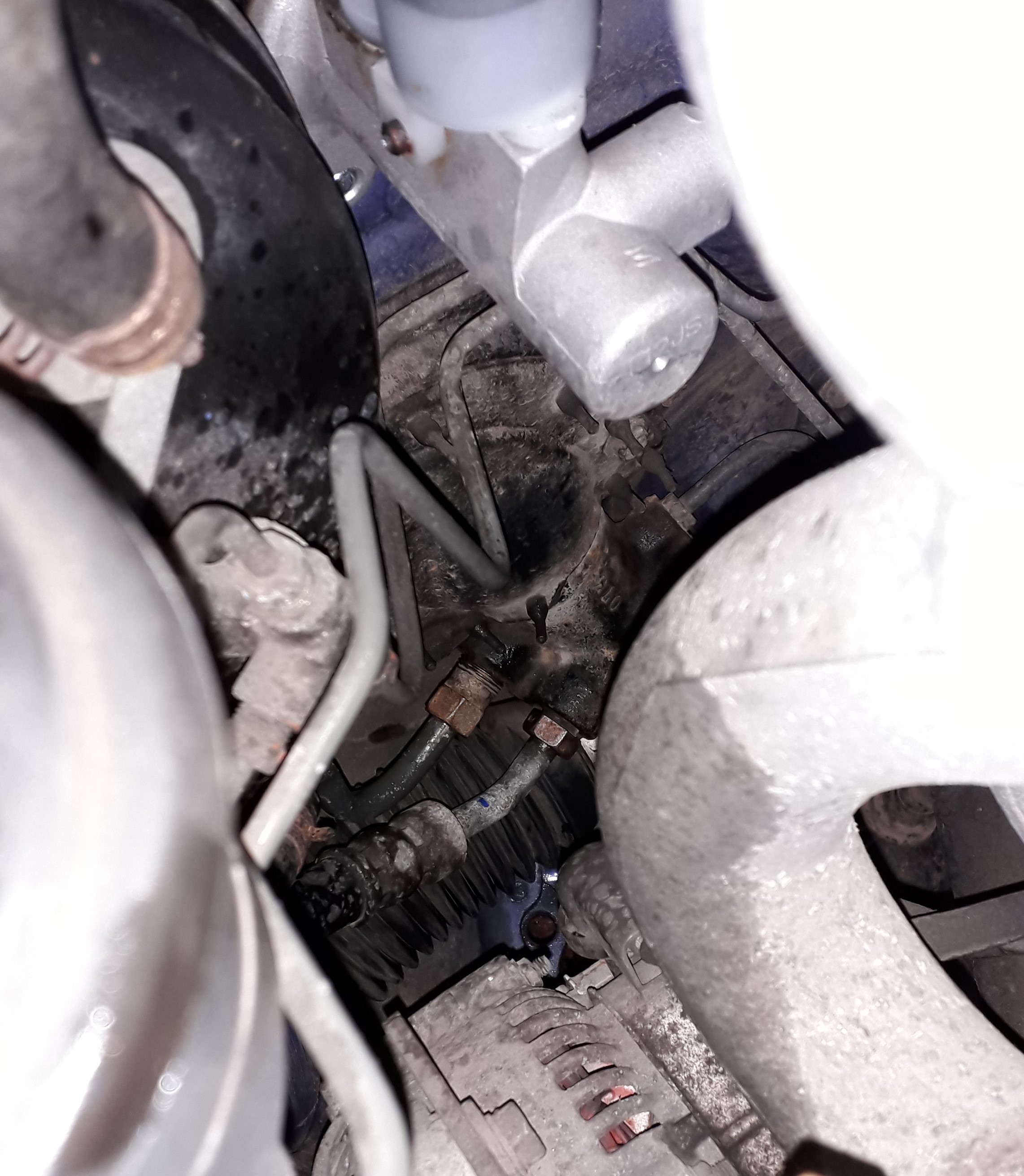

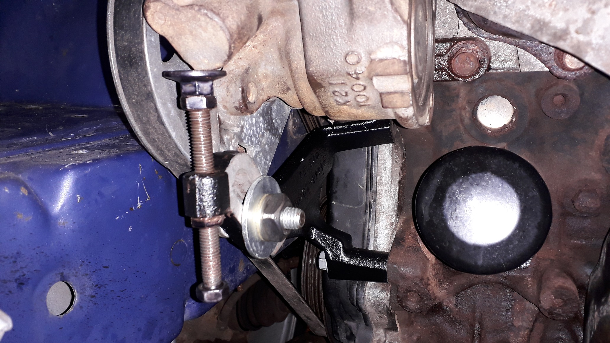

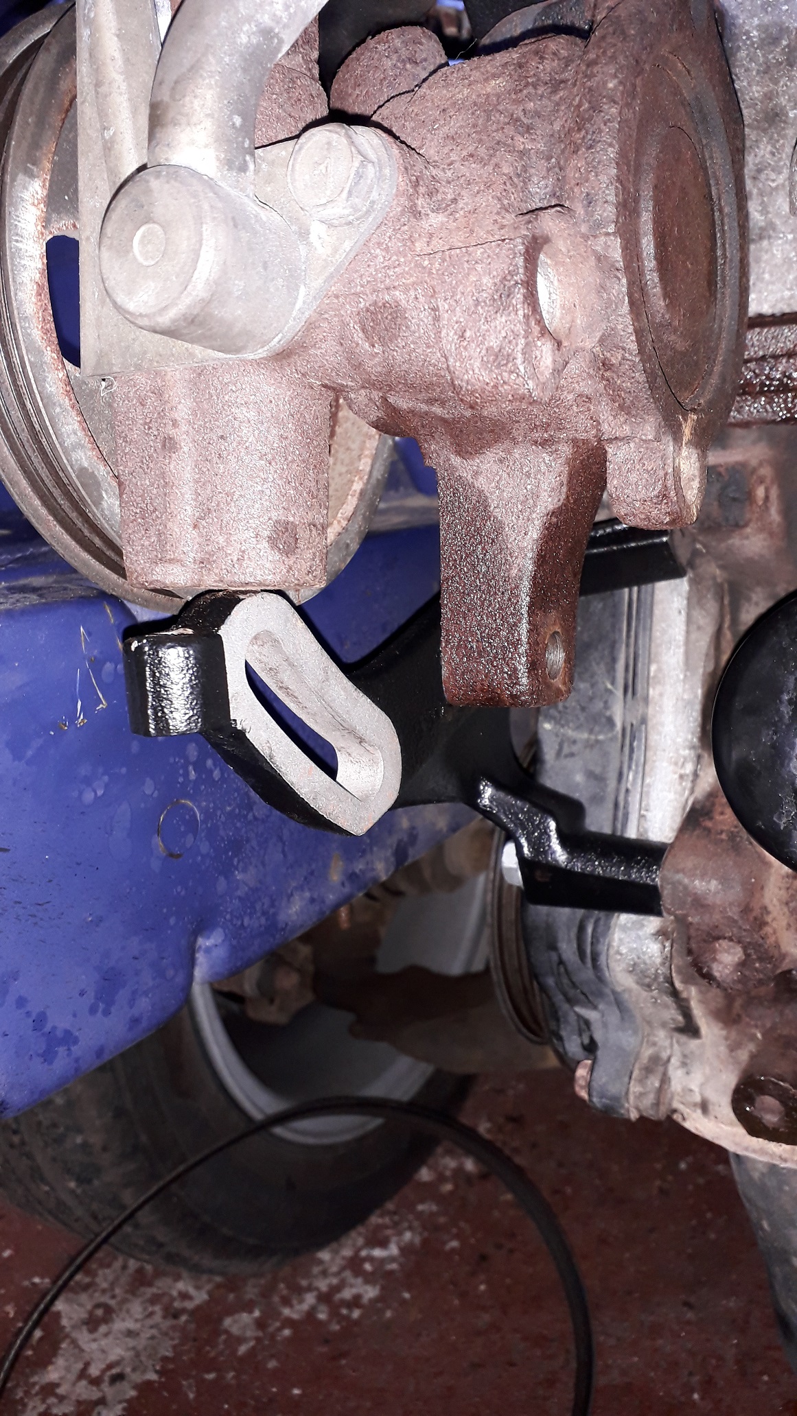

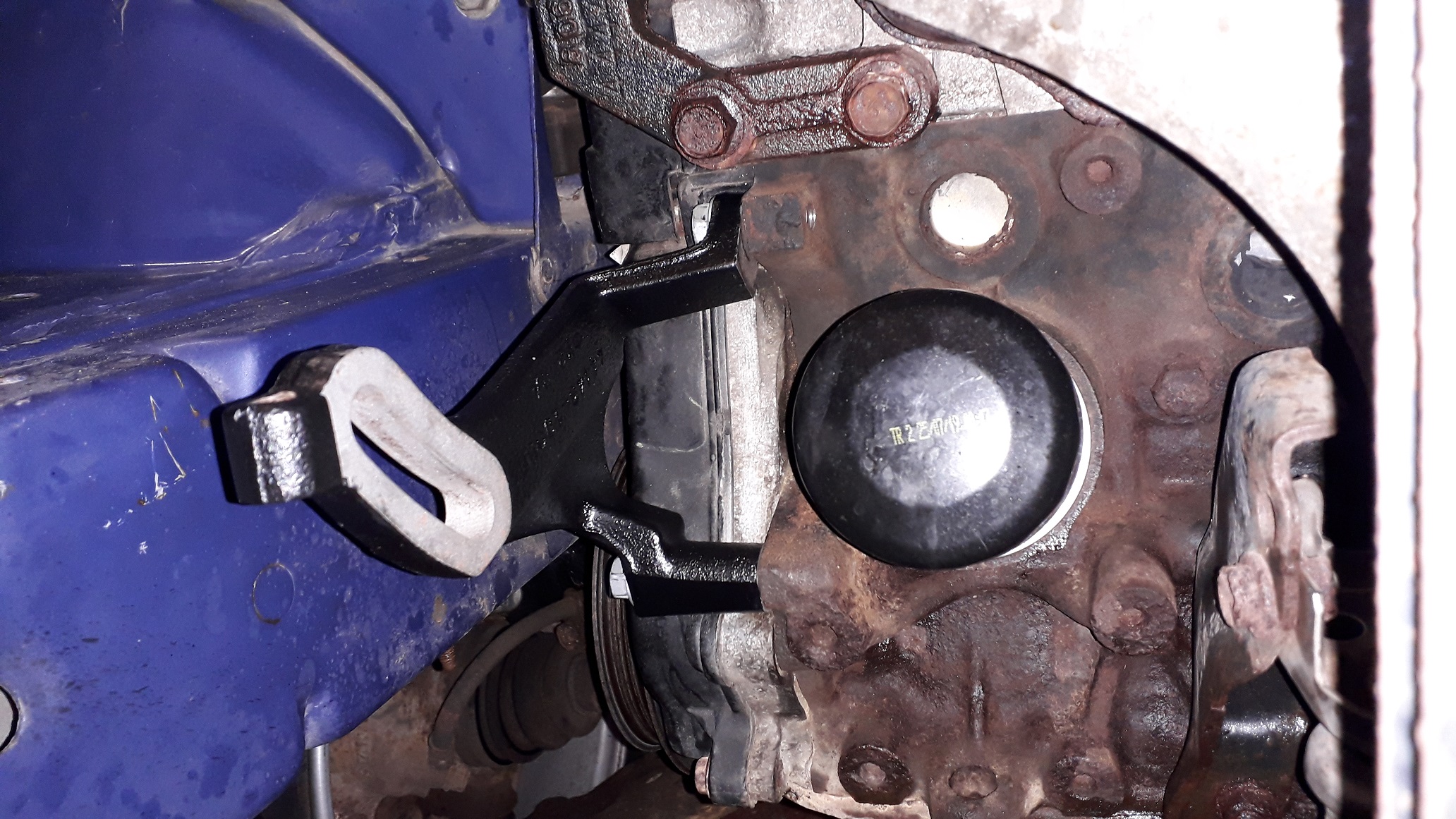

Claymore Posted March 1, 2021 Author Posted March 1, 2021 (edited) 4efte power steering install. As we know, to fit the 4efte oil relocator as Toyota intended you need to change the lower power steering bracket to make room, you then need the 4efte pump and pump feed hose. I have seen people use the 4efte pump and the 4efe lines but it puts a sharp bend in the high pressure line just after the clamp section and this can't be good. Also the 4efe low pressure return line would be fine to use as it's already fitted to the car from rack to reservoir anyway. I decided to do the lot as I had managed to source the components already. So I'll be using the 4efte pump, high and low pressure lines, lower adjuster bracket. Kept the 4efe reservoir as they're the same. First step was to remove the lower adjuster bracket. Loosened off the pivot bolt at the top of the pump followed by the tensioner clamp bolt. Removed the lower 4efe bracket by unscrewing the 2 x m 8 bolts that hold it to the block. The replacement bolts for the fte bracket were longer and the threads had corroded so needed cleaning out with a tap. Couldn't fit the tapping handle in the space available so had to use the farmers wrench 🐮. Fitted the fte lower bracket. For a laugh I fitted the 4efe pump back on and the required work to make it fit became more apparent. The lower section of the pump sits on the bracket, the clamping hole and slot don't line up, the belt is too short and the clamps that hold the pipes to the engine bay are not the right shape. It may be possible to modify the angle of the pipe location brackets to allow the pipes to move up / back and the pump to pivot up, fit a longer belt and make an adapter plate to bolt from the pump to the lower fte bracket. Didn't try any of this but it looks doable if you only have the lower bracket. Edited March 1, 2021 by Claymore Quote

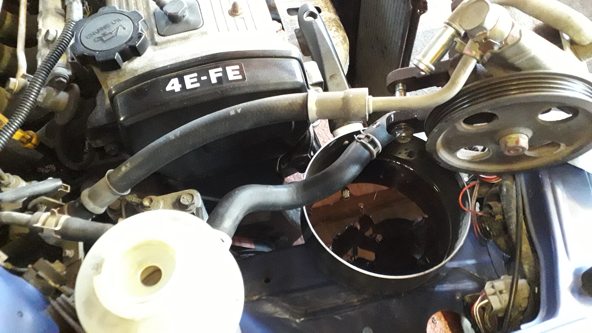

Claymore Posted March 1, 2021 Author Posted March 1, 2021 (edited) Next up it was time to remove the 4efe pump, lines and reservoir as a complete unit. Its easier and cleaner than separating it out in the engine bay. First needed to drain as much fluid from the reservoir as possible, so used a turkey baster to start and then removed the pump feed hose and drained the rest. With the car safely supported on jack stands, I undid the high pressure feed pipe and the low pressure return. The pipes are only snugged down tight and loosened off without a fight. The pipe located closest to the firewall is the low pressure return line, it has a hook shaped metal pipe, a longer hex section and has more thread showing out of the rack when fitted. The pipe located out towards the engine is the High pressure feed line, it has a 45 degree bend metal pipe, thinner nut section and little thread showing when attached. Thankfully I took photos before disassembly! Drained the rest of the fluid, then attached an old vinyl glove to the fittings to keep them clean. Next I removed all the bolts holding the reservoir and pipes to the engine bay. Starting on the inner wing by the headlight it's 3 x bolts for the reservoir, then 2 x bolts for the pipes. The last of the 5 was difficult to access even with a ratchet spanner so I fashioned this "apparatus" to unscrew it from the other side of the bay. 🙃 Unclipped the wiring loom holder from the pipe mount bracket. Lifted out the assembly and here it is next to the 4efte version. Swapped the reservoirs as the fte one was grotty as. Then fed the whole lot back in. Edited March 1, 2021 by Claymore Quote
Claymore Posted March 1, 2021 Author Posted March 1, 2021 (edited) Re assembly was the reverse of dis assembly, cleaned the threads of the mounting bolts / nuts out (even less access this time) and re attached the res. and pipes loosely into position with copper grease on the bolts. Re-attached the lines to the rack (snugged them down). Attached the pump to the upper bracket and lower bracket loosely. Fully tightened the res. and pipes to the bay. Clipped the wiring loom holder back onto the pipe mount bracket. Attached the lower tensioning ("third arm") bolt into place and set the belt tension, locked it in place. Nipped up the upper bolt and then fully tightened the lower adjuster clamping bolt. Fully tightened top pivot bolt. Frustratingly the Toyota lower clamping bolt I bought was a superseded part and the nut was also nla. It was a m10 fine thread and of course I didn't have the nut available so this had to do. Thanks Toyota for making a simple bolted connection "special". Topped up with ATF and bled the system by turning the steering wheel from side to side until the bubbles stopped appearing and the fluid level stabilised. Pipes in place. Not a quick task but fairly simple nuts and bolts stuff. I quite enjoyed it and atleast I know the pump I bought 6 months ago works! Edited March 2, 2021 by Claymore Quote

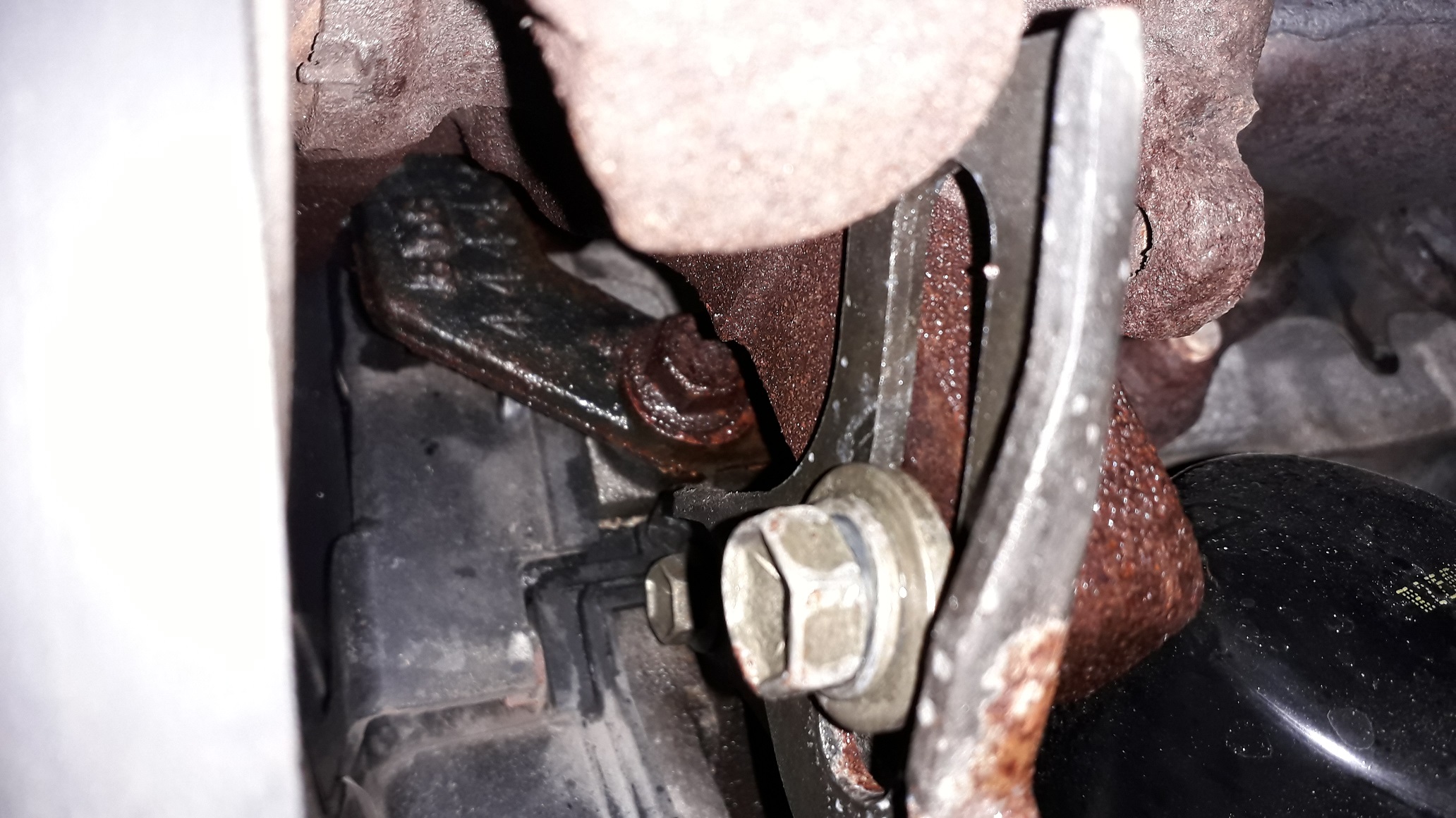

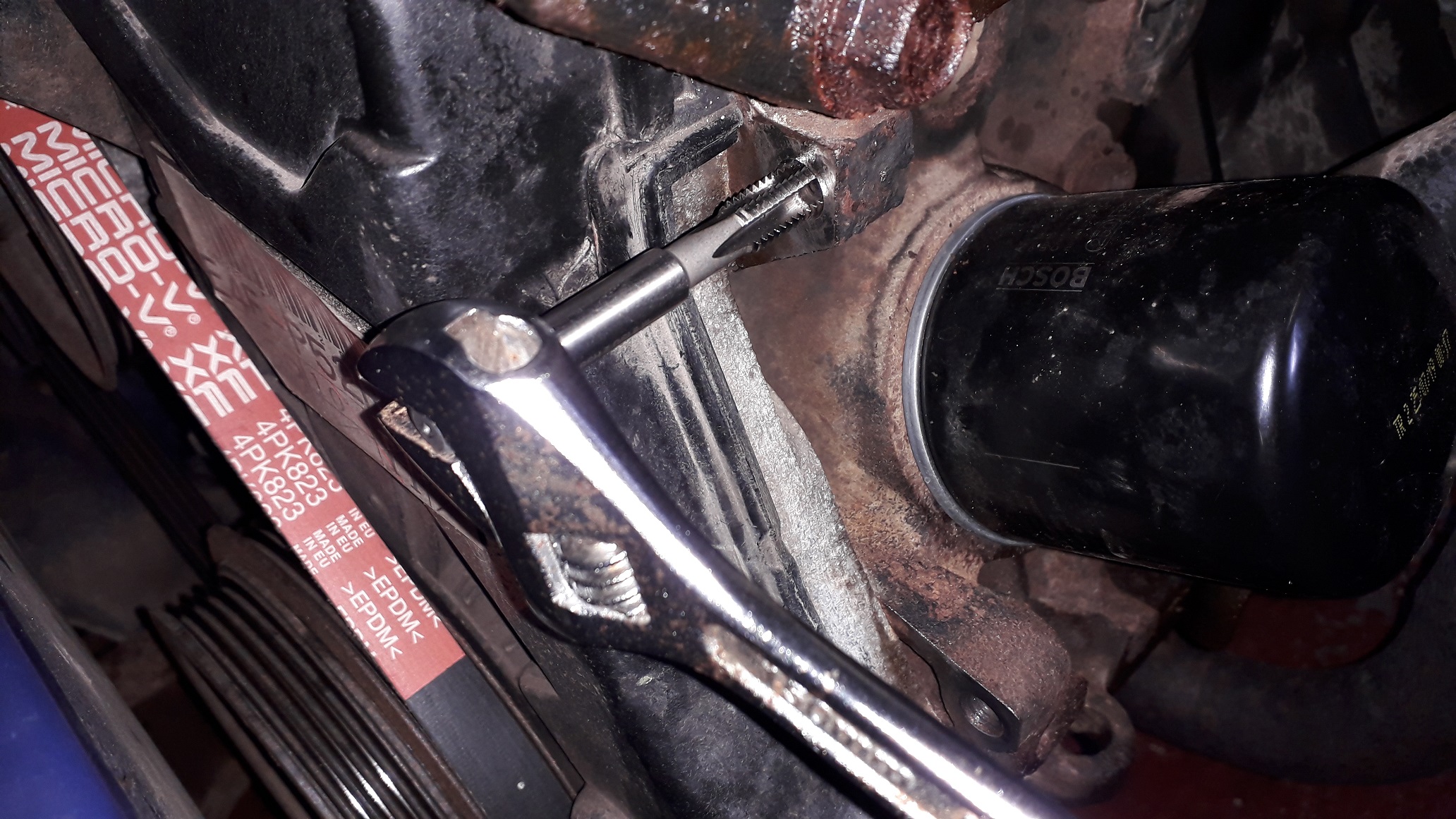

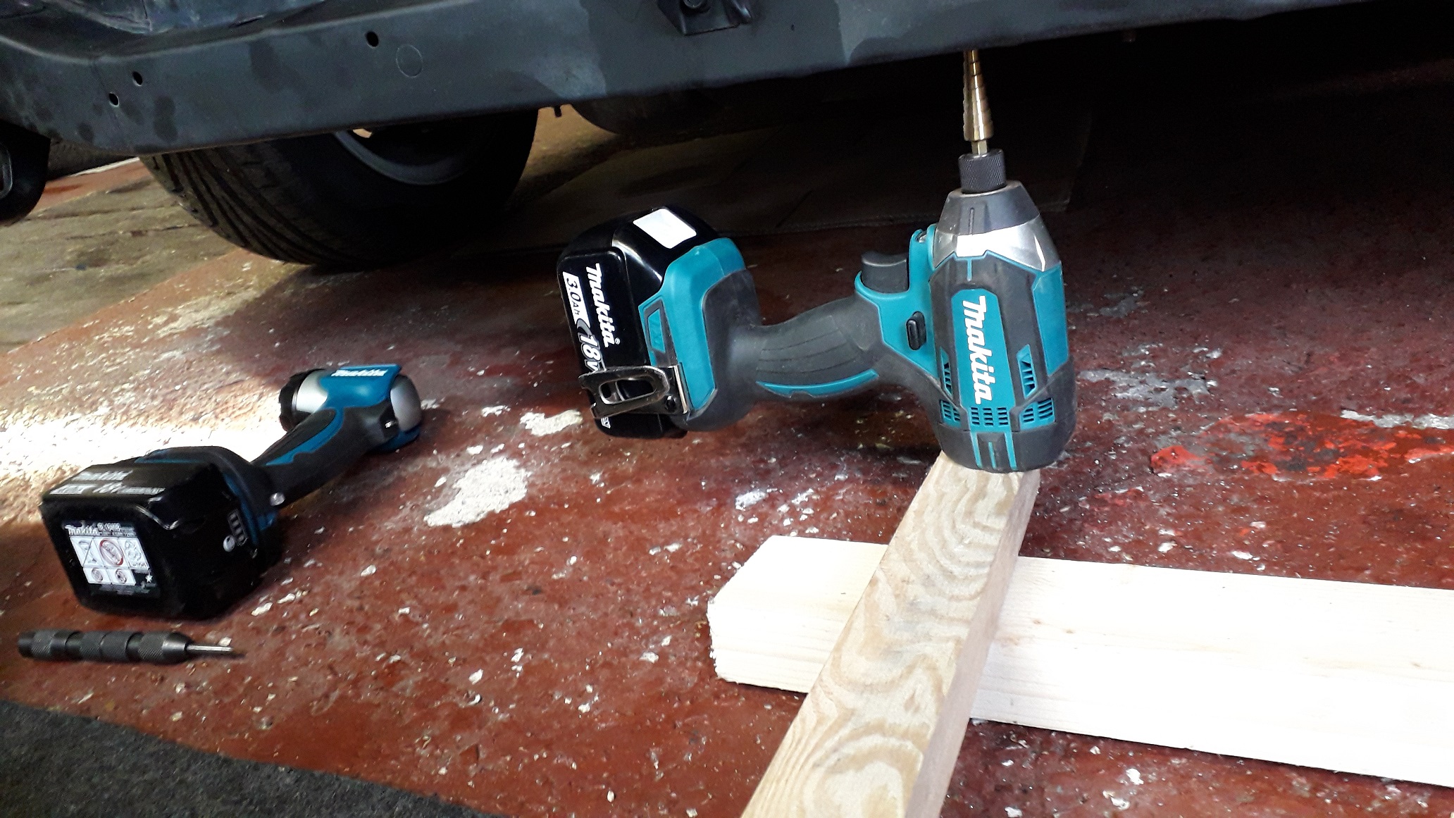

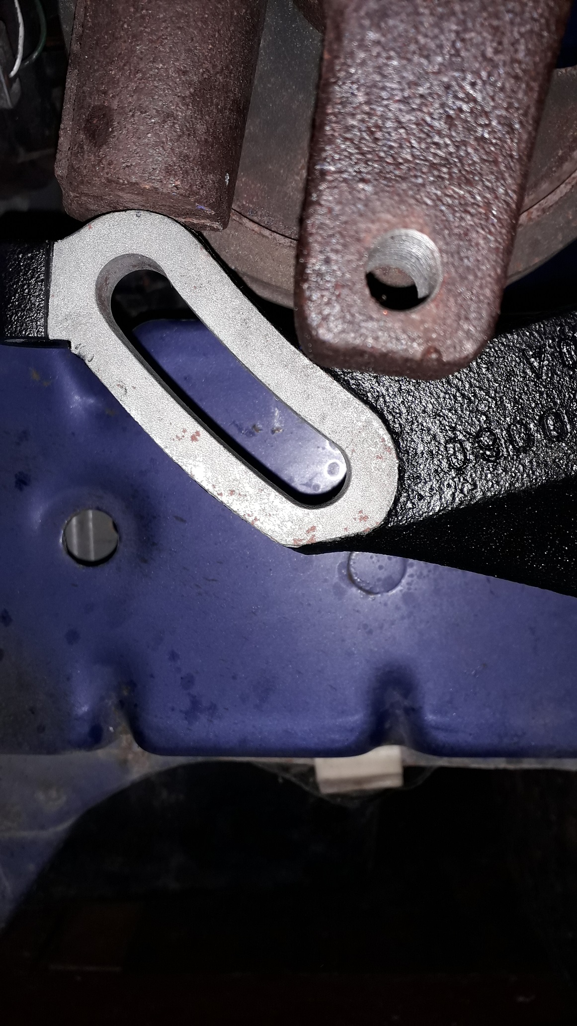

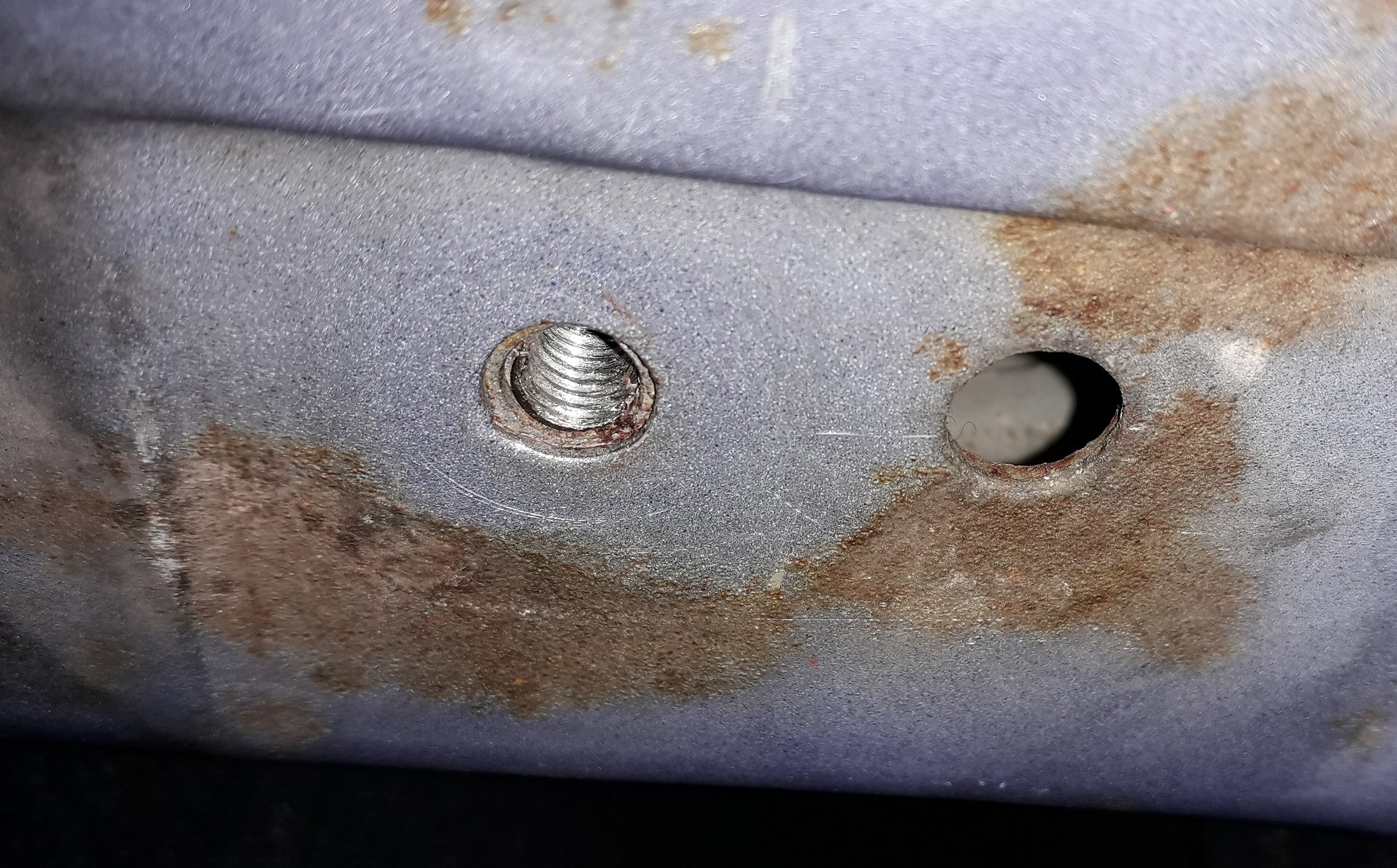

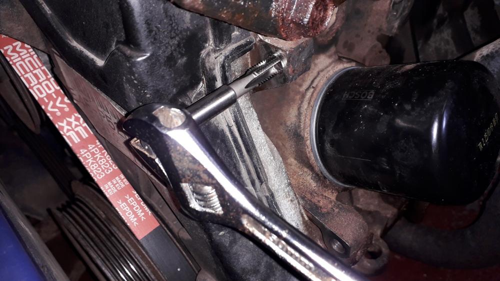

Claymore Posted March 2, 2021 Author Posted March 2, 2021 (edited) Tiny update, one of the screws that snapped off whilst removing the undertrays is required to attach the lower civic half radiator bracket. Needed to drill it out and re-tap the hole. Thankfully the screw snapped off flush so was easier to deal with, centre punched the remaining stud. Its very important to get this mark in the centre as it is where the drill bit will start and as I had to drill out to 5mm to tap m6 the closer to the centre the better. Ideally the drill hole will remove only the snapped bolt body and none of the nut, then you just use a tap to clean the old bolt out of the existing thread. Most of the time when freehand drilling it will be slightly off and you cut a new thread instead. Using my impact driver with step drill (confined space) I started drilling. Not easy with the limited clearance so I made a lever device to push the drill up with extra force whilst I kept the trigger pressed. Sort of a reverse pillar drill. Re-tapped m6. Should do the job, I can always go bigger. Test fitted the bracket. Chipping away at it. Edited March 2, 2021 by Claymore Quote

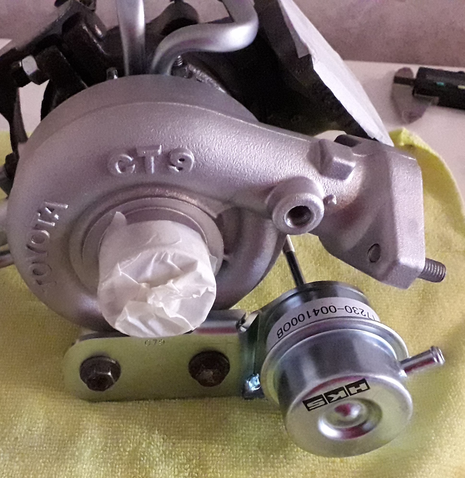

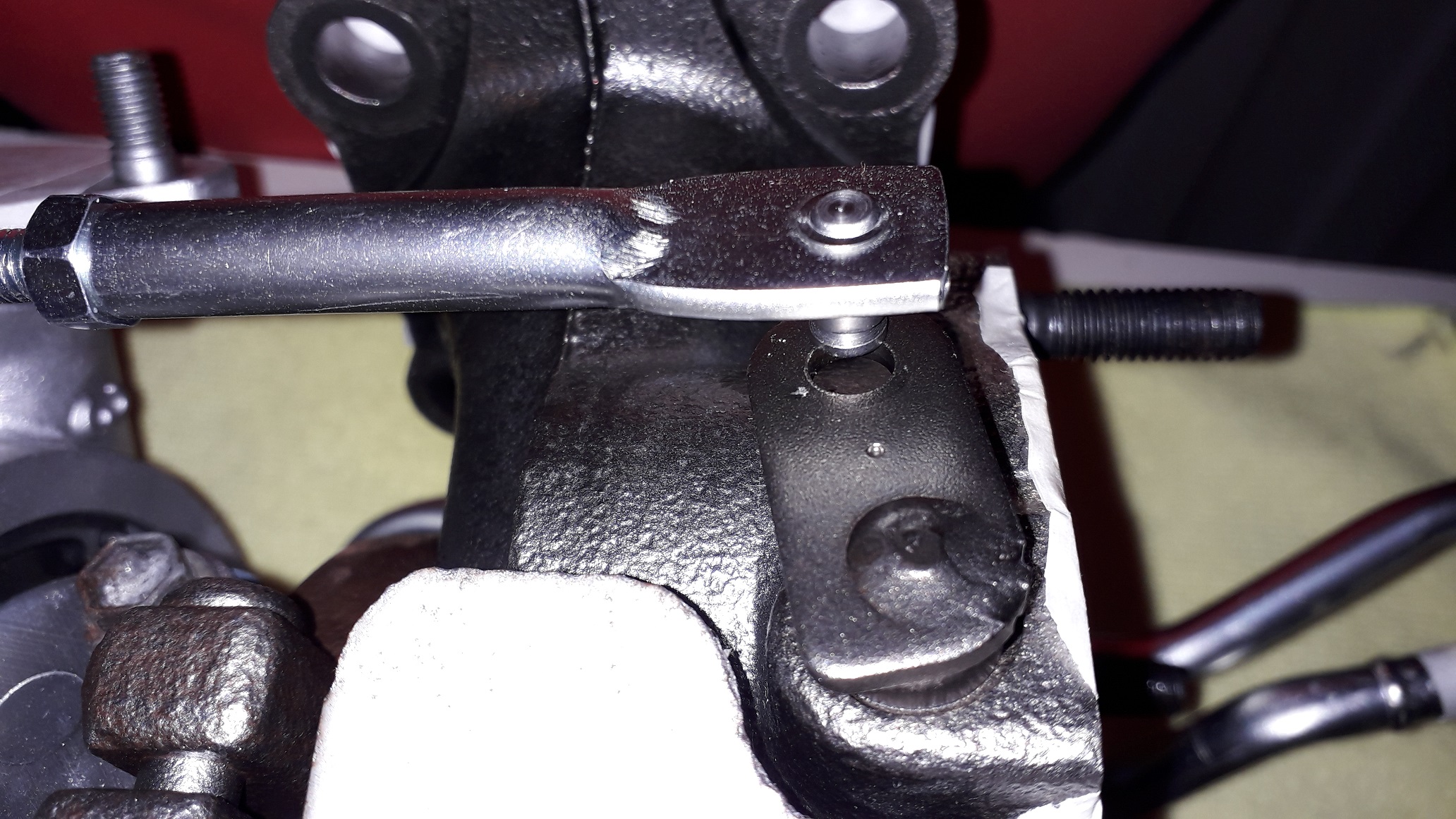

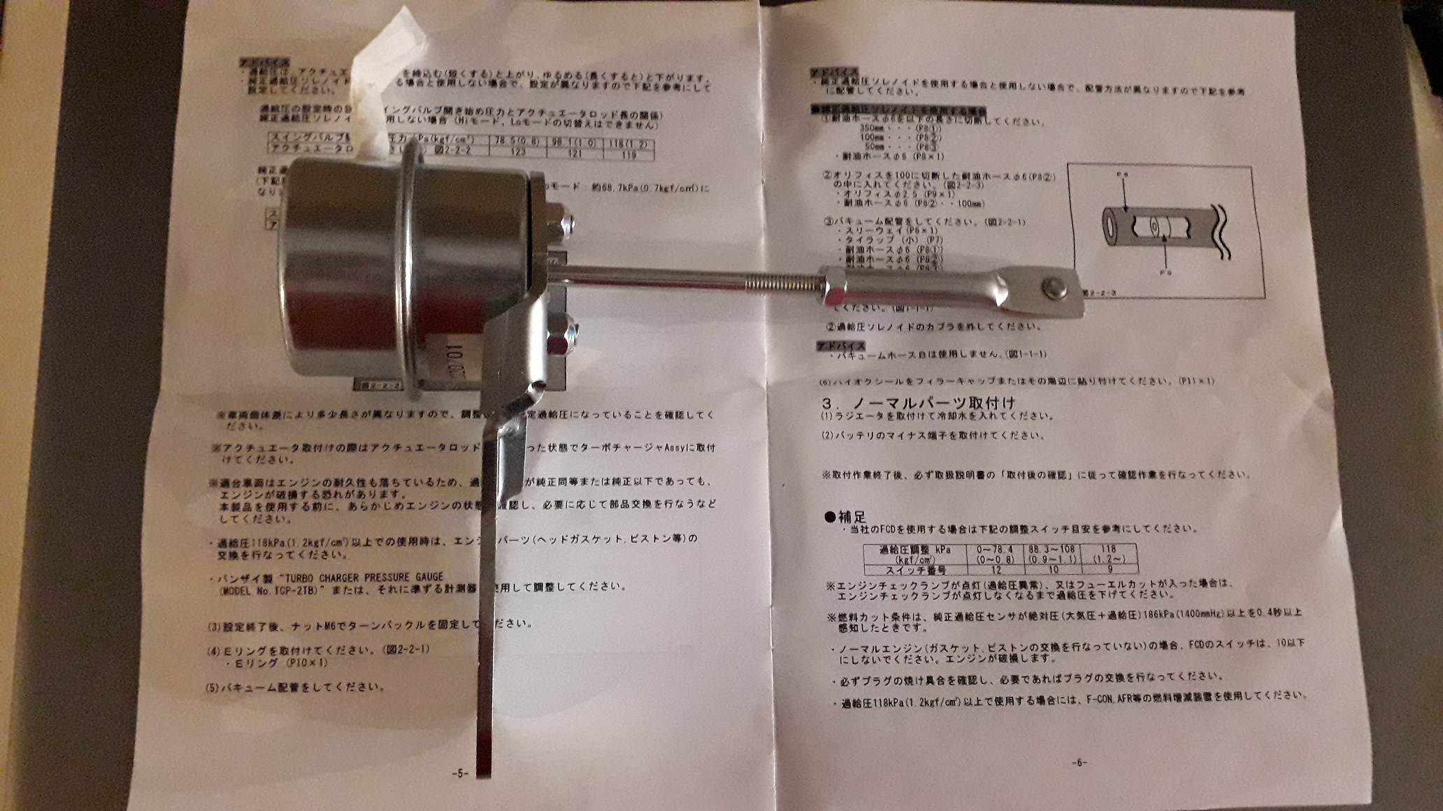

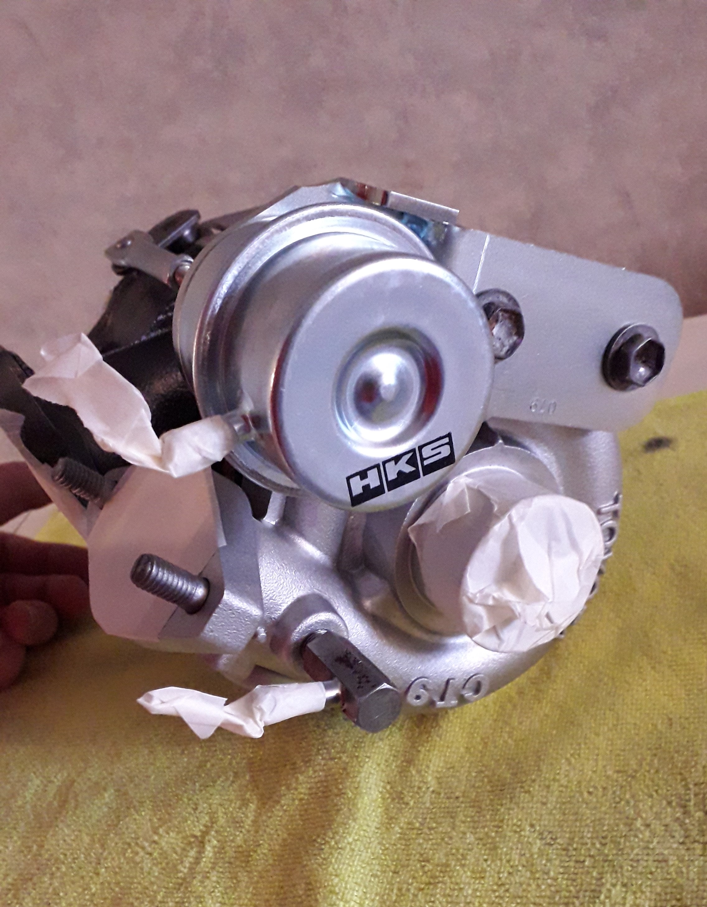

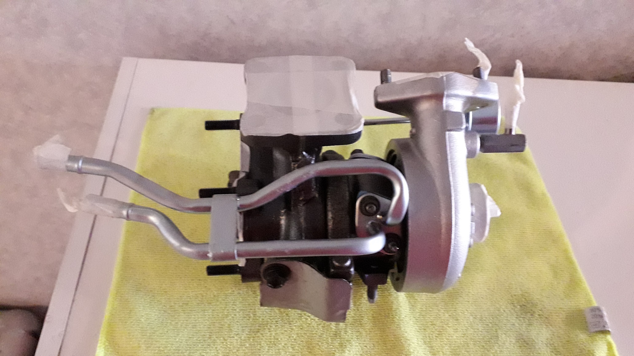

Claymore Posted March 5, 2021 Author Posted March 5, 2021 (edited) Turbo assembly. After getting the CT9A back from Midland turbos I thought I'd get a head start building it up, I got the water pipes, blanking plate and oil feed / drain pipes re-plated (BZP, 7 microns, clear passivate.). Also bought a HKS actuator to replace the tired looking original 2 port jobby. Easy enough to assemble, the bracket is attached to the actuator so the turbo housing mounting face is to the left of the actuator mounting face (as shown below). If you put it on backwards you'll get all the psi's! The actuator rod is adjustable for length via a turn buckle end and lock nut, after choosing the appropriate end (hole for bolt or axle with e-clip) to suit the turbo. The turnbuckle was also pre-greased with copper grease (now this I like!). Used google translate to help decipher the instruction manual (scan setting works alot better than live translate 😉). Length settings and approx. boost: 119mm (1.2bar), 121mm (1.0bar), 123mm (0.8bar) and 128mm (0.5bar). The shorter the length, the more preload on the spring resulting in an increase in pressure required to actuate the wastegate. Set the arm length at 128mm (0.5bar) as this is all I'll need for the N/A+T. It's also the lowest setting so be aware of that if you want less boost. After attaching the actuator to the compressor housing (2 x m 8 bolts) it became apparent that when the turbo was rebuilt the boost source fitting had been tightened in (taper thread) further. This meant that the nozzle pointed at the actuator and I couldn't get a hose on it. Removed the fitting, cleaned it out and reassembled with thread seal at the correct angle. Pulled the actuator rod into the wastegate lever hole. At the 128mm setting it barely adds 0.5mm of preload. Will adjust tighter if necessary. I was quite surprised how much stronger the spring was than the standard item. I assume this is to do with the 2 mode turbo settings on the stock glanza actuator. Bolted the water pipes and blanking plate on (2 x m6 nuts or bolts). The turbo came back with a gasket set to re-assemble so they were used where required. Made sure all openings were taped up. Finally, I added the original small heat shield to the turbine housing (2 x m 8 bolts again). I have ordered a new, aftermarket oil feed / return which will be fitted when it arrives. Edited March 5, 2021 by Claymore Quote
JamesG Posted March 5, 2021 Posted March 5, 2021 Good work as always Claymore, really well detailed write ups. If its any consolation the same bolt snapped on mine when removing the undertray to fit the lower half rad bracket. I used a small reverse drill bit and was lucky enough for it to grab the bolt and spin the rest of it out the thread. Keep it coming, Looking forward to seeing the finished article 👍. Quote
candy_red Posted March 5, 2021 Posted March 5, 2021 You ll be surprised how much better spool you ll get just by that tighter spring. I remember way back when i installed mine even though initial setting turned out to be 0.4 bar instead of the irregular 0.6-0.8 i was getting with the sloppy old oem actuator, i was caught in surprise by how much more responsive the car felt. Excellent work. Wouldnt have looked this good even when it was new in the factory!!! Quote
Claymore Posted March 5, 2021 Author Posted March 5, 2021 6 hours ago, JamesG said: Good work as always Claymore, really well detailed write ups. If its any consolation the same bolt snapped on mine when removing the undertray to fit the lower half rad bracket. I used a small reverse drill bit and was lucky enough for it to grab the bolt and spin the rest of it out the thread. Keep it coming, Looking forward to seeing the finished article 👍. Thanks mate. You can get lucky sometimes with the reverse drill bits, I've found them useful for m 8 sizes and up. Smaller than that and I haven't had much luck, nothing worse than snapping a tiny "easy out" extractor off in one either! 2 hours ago, candy_red said: You ll be surprised how much better spool you ll get just by that tighter spring. I remember way back when i installed mine even though initial setting turned out to be 0.4 bar instead of the irregular 0.6-0.8 i was getting with the sloppy old oem actuator, i was caught in surprise by how much more responsive the car felt. Excellent work. Wouldnt have looked this good even when it was new in the factory!!! Hopefully not too quick spool! Thanks for the kind words, I'm getting there. Quote

Pikey009 Posted March 5, 2021 Posted March 5, 2021 Great progress mate. You’ll be surprised how well it pulls with the actuator set like that (as a few people have mentioned). That’s around what mine is on and it feels great. good attention to detail as always Quote

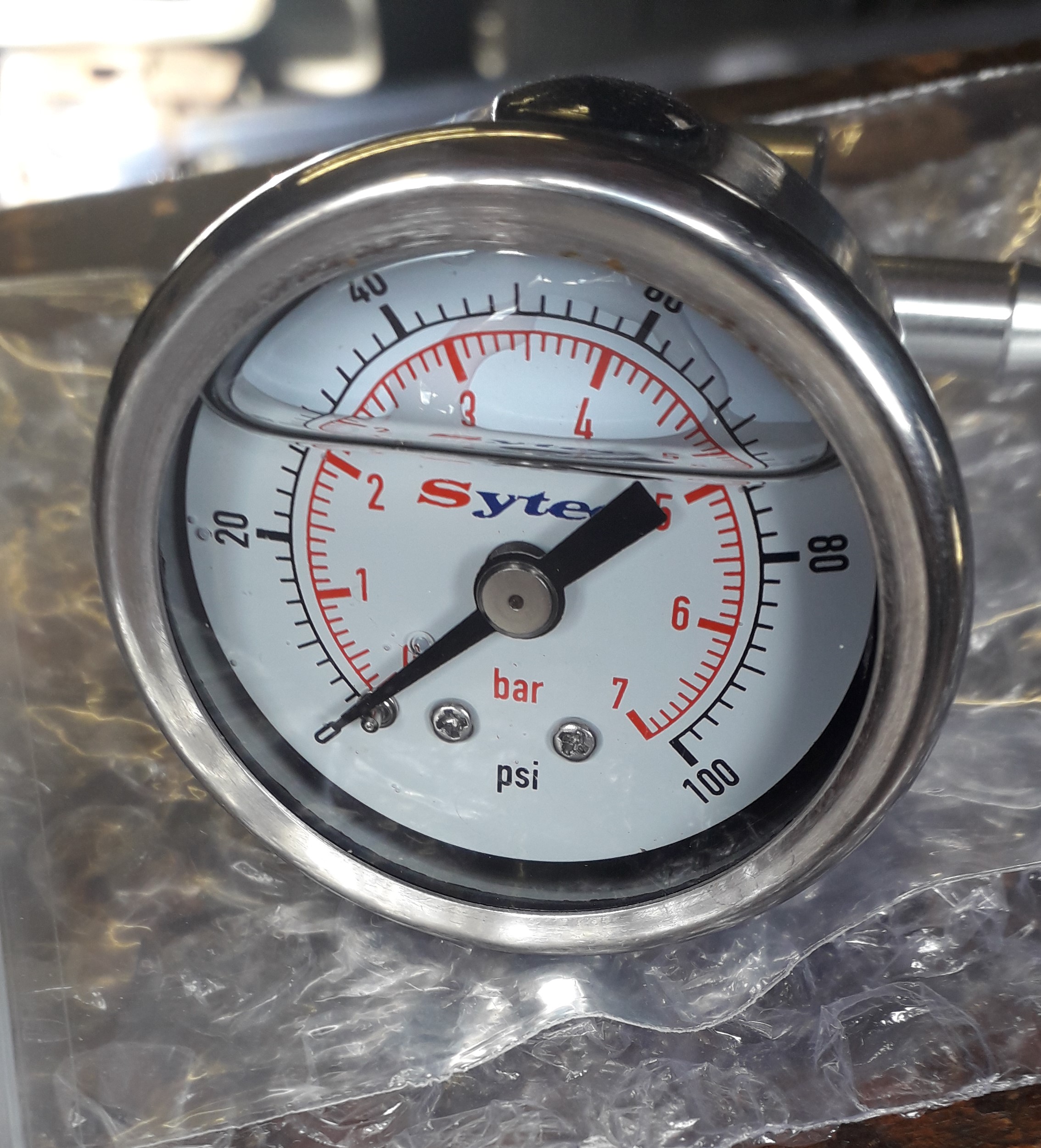

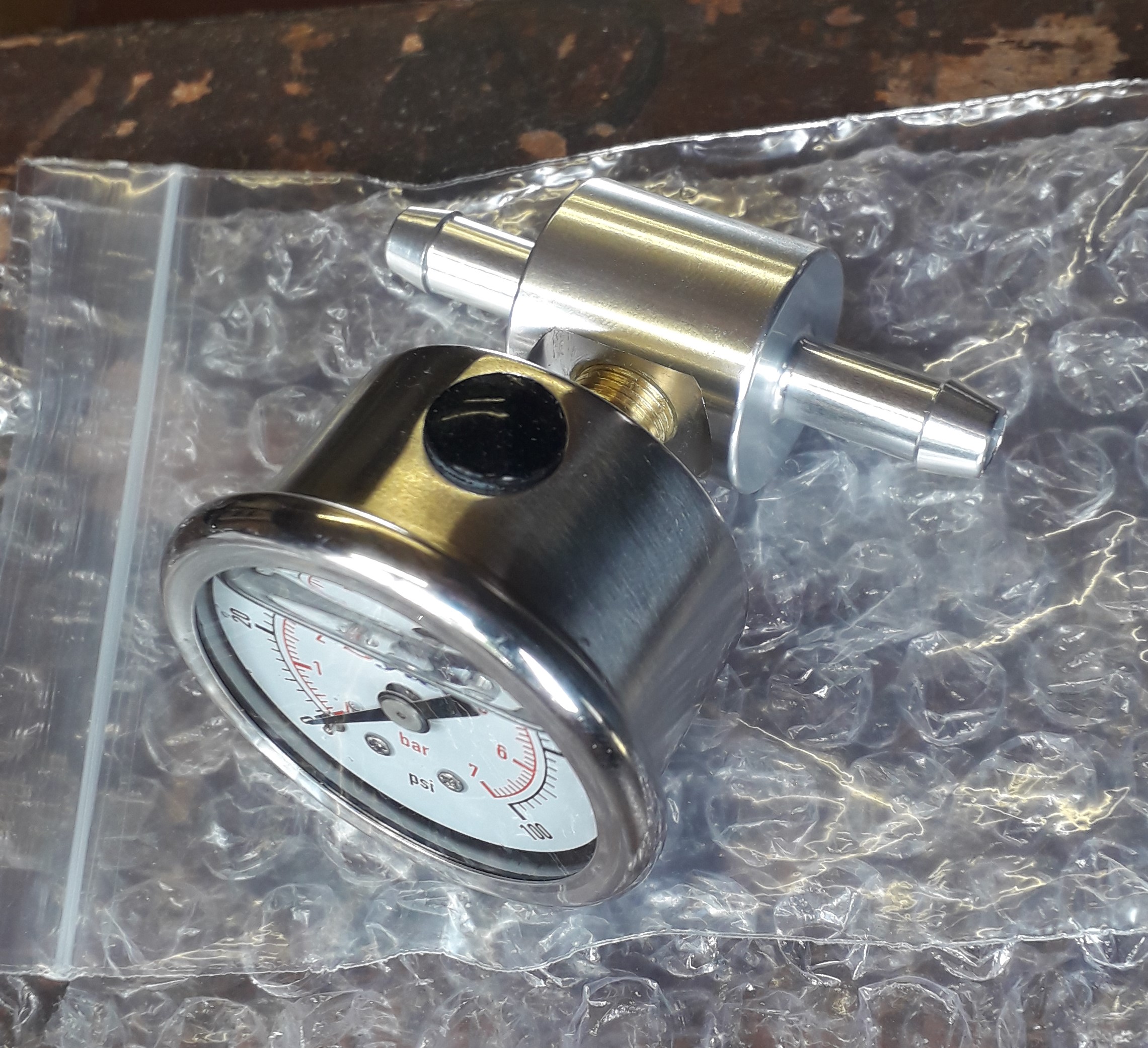

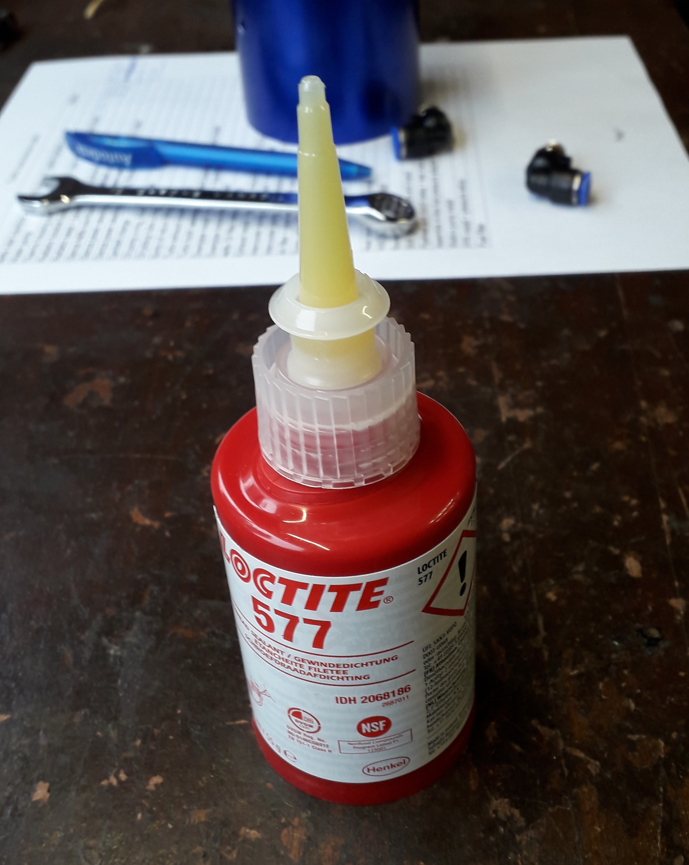

Claymore Posted March 6, 2021 Author Posted March 6, 2021 (edited) Tiny update, some of the fuel delivery stuff has arrived. The adjustable fuel pressure regulator arrived with the 8mm hose tails and gauge blanking plug already installed with sealer. Didn't fancy disturbing them and as the gauge is not meant to be permanently installed I left it alone and bought an in-line adapter to set the pressure and remove when done. Bought a Sytec gauge and adapter, tapered thread as usual, so lined the bench vice jaws with cardboard and nipped the adapter body in it. Added the loctite 577 to the male thread of the gauge and wound it in hand tight (don't turn the gauge, use the hex part of the body). Used an 11mm spanner to tighten it up the required amount. Got the gauge face to be horizontal to the pipework. Also managed to drill out and re-tap the 2 x m6 bolts I snapped that will hold the undertrays in place. 😀 Edited March 6, 2021 by Claymore Quote
Sam44 Posted March 7, 2021 Posted March 7, 2021 Very nice, which type/make of FPR did you go for. 3.6bar seems to be a sweet spot using the denso injectors seems to give better fuel atomisation. Quote
