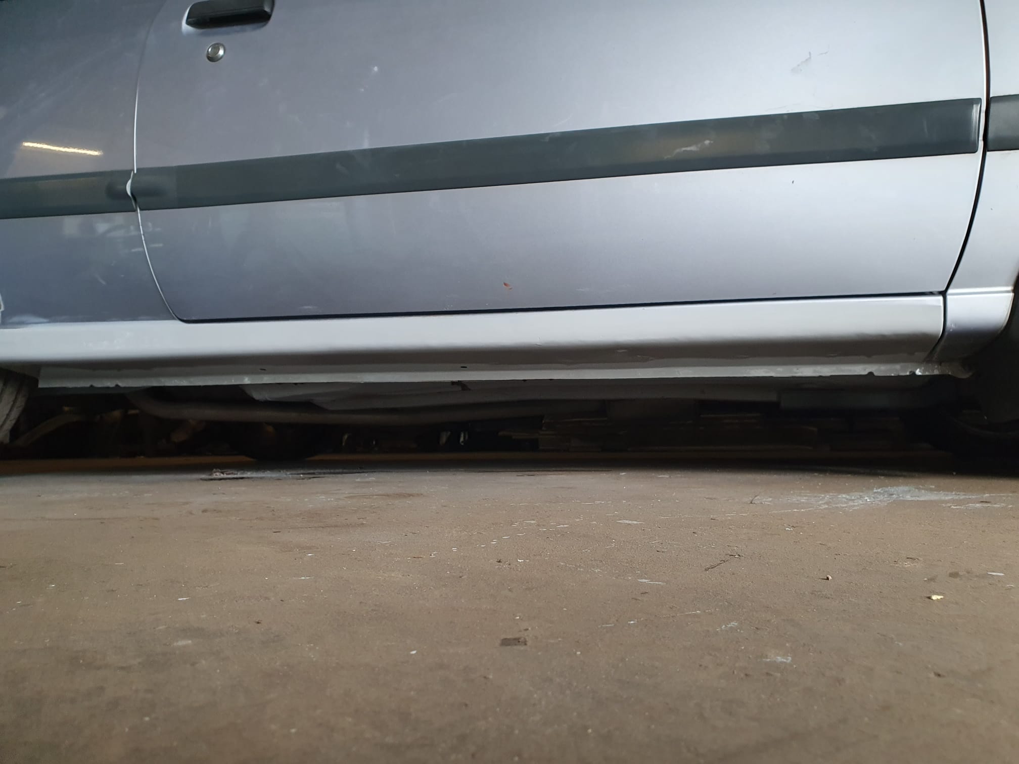

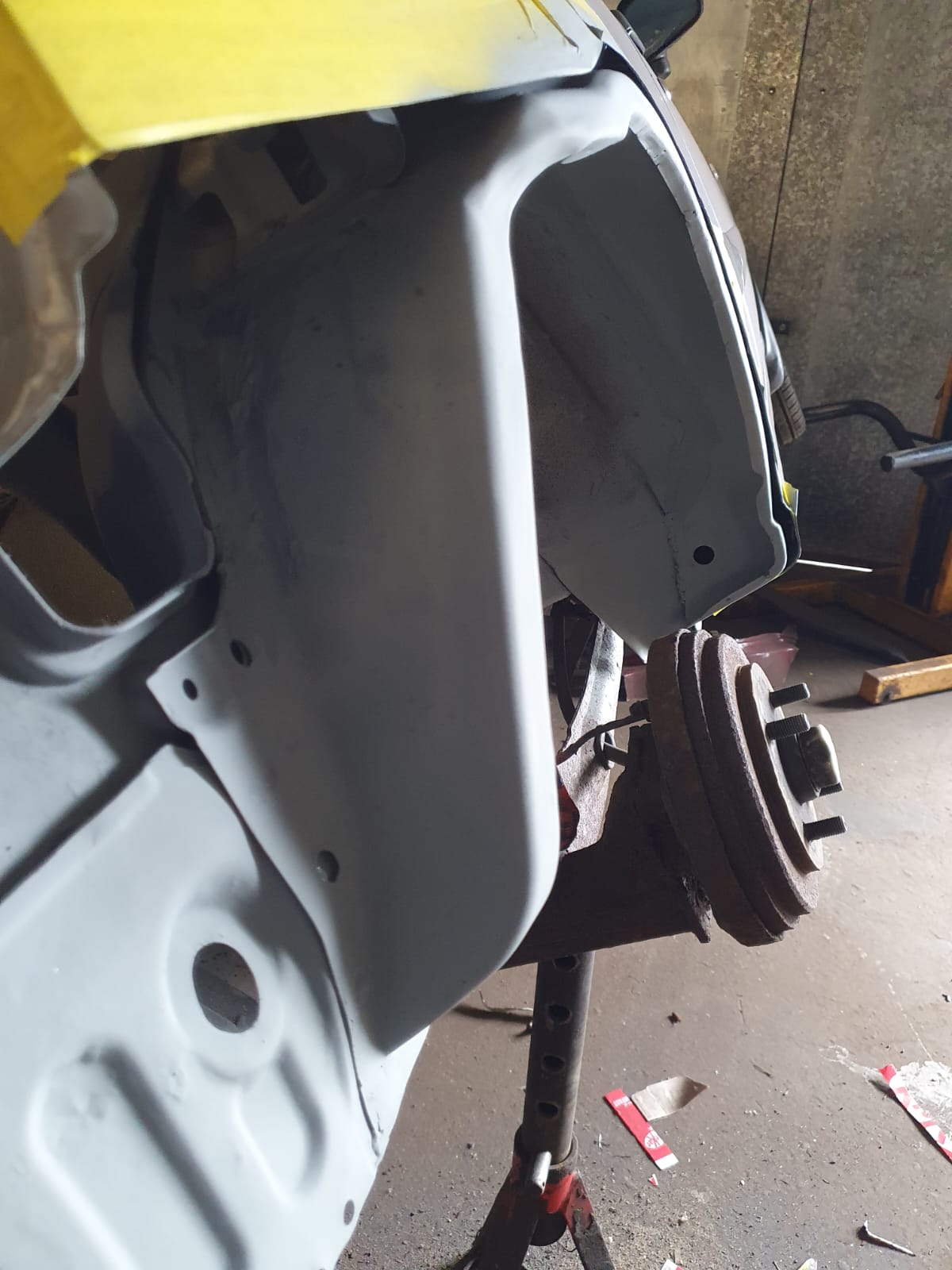

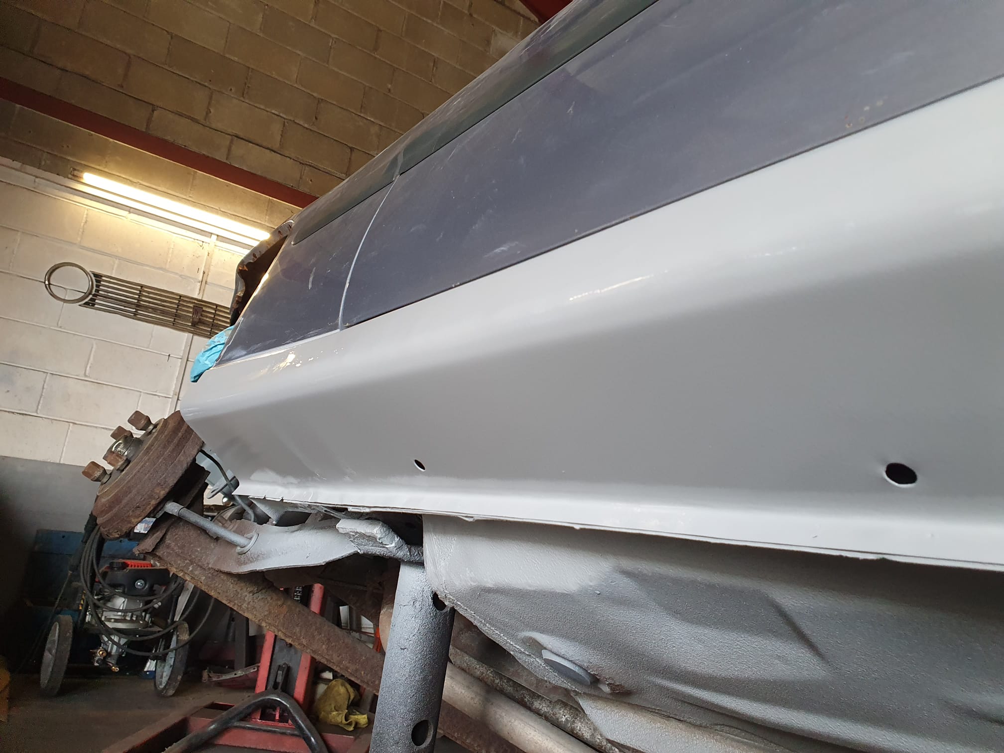

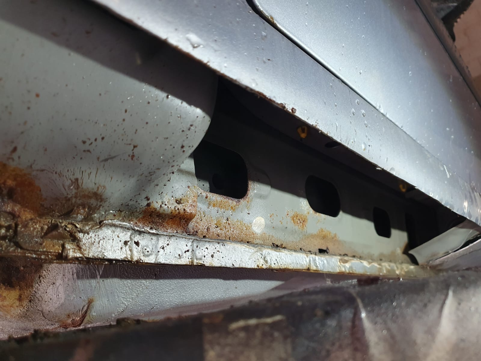

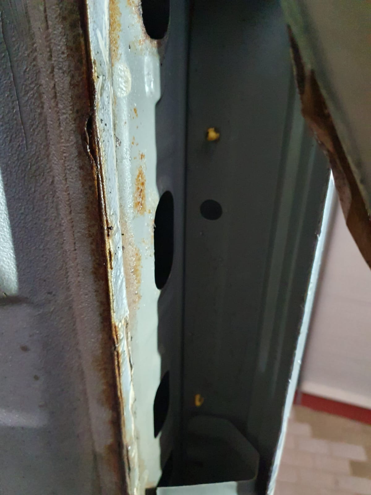

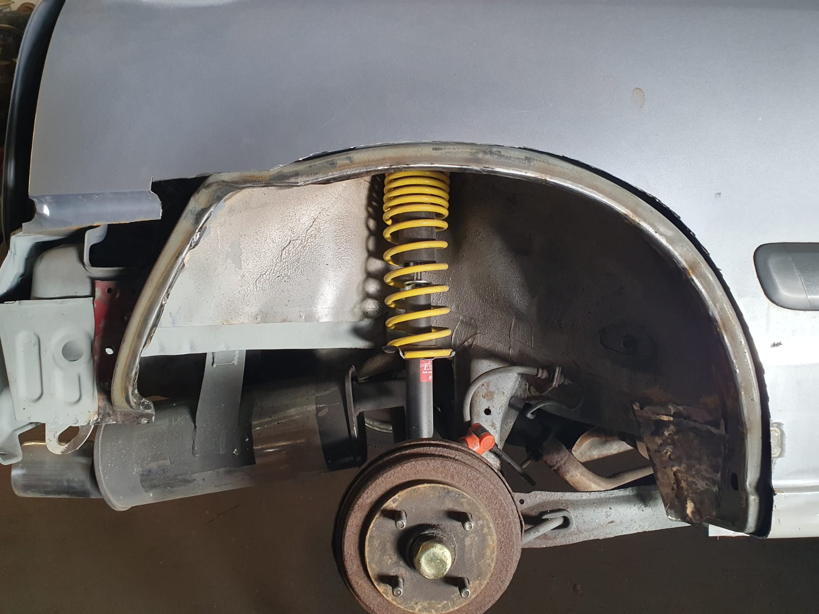

burty Posted June 8, 2024 Author Share Posted June 8, 2024 After that was completed it was onto the mammoth task of the drivers side sills and arches joe made a great job of this and it took a lot of time we repaired inner sills cutting away small rust patches replaced outer sills for new Quote Link to post Share on other sites

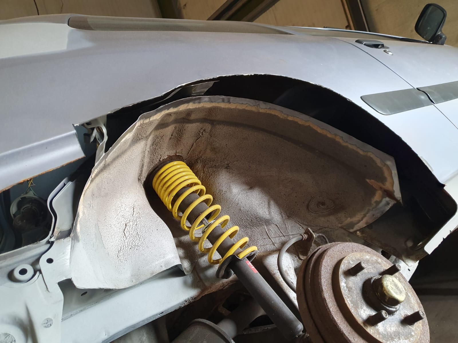

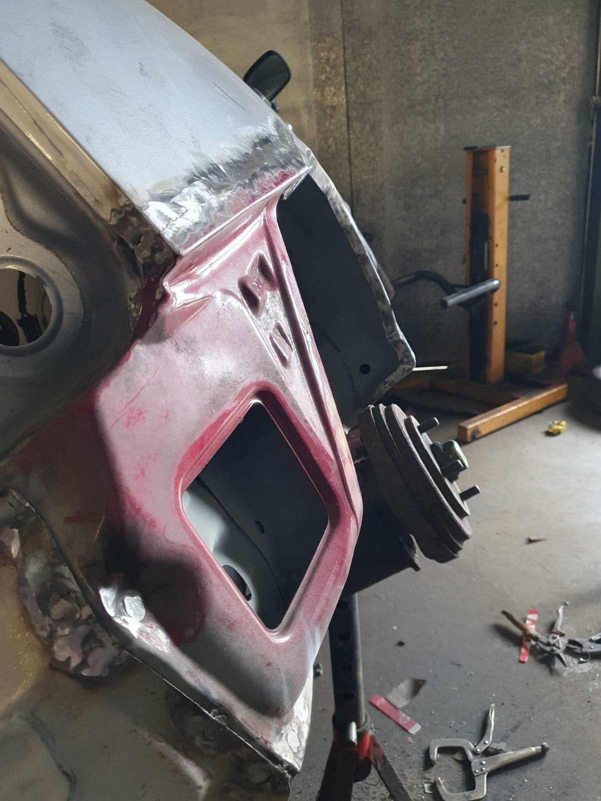

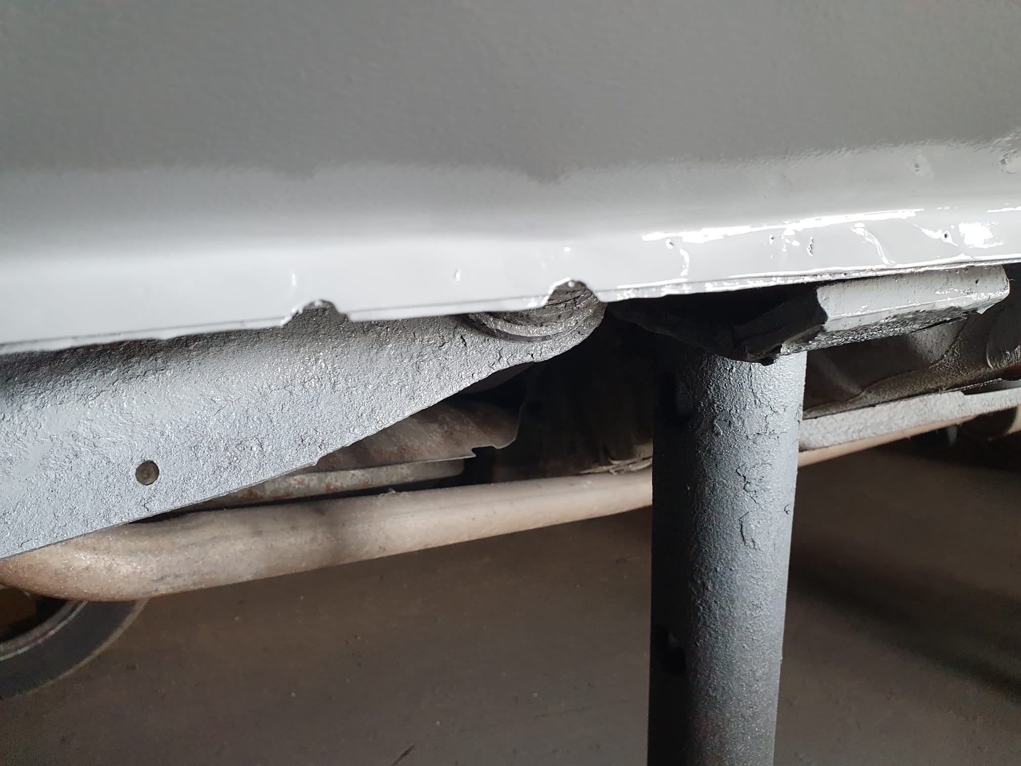

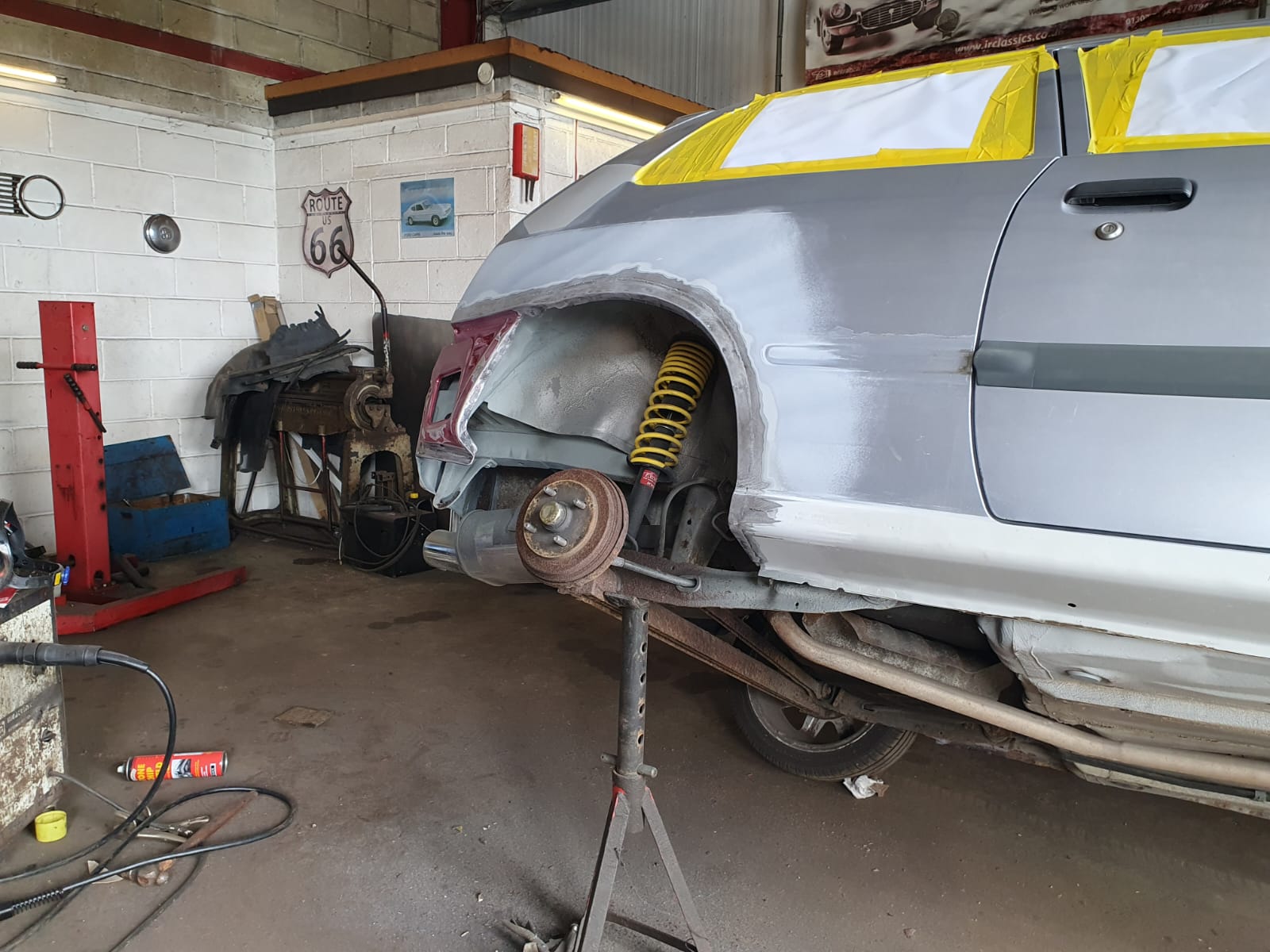

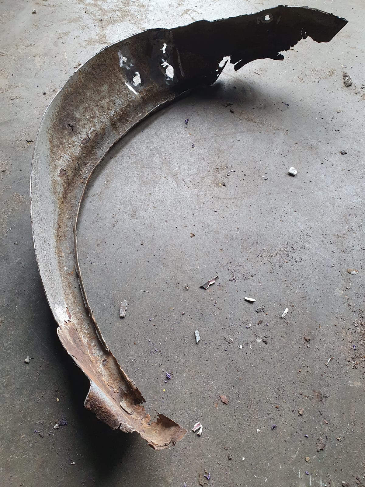

burty Posted June 8, 2024 Author Share Posted June 8, 2024 So onto the arch first off we cut out all the rust on the inner and outer Quote Link to post Share on other sites

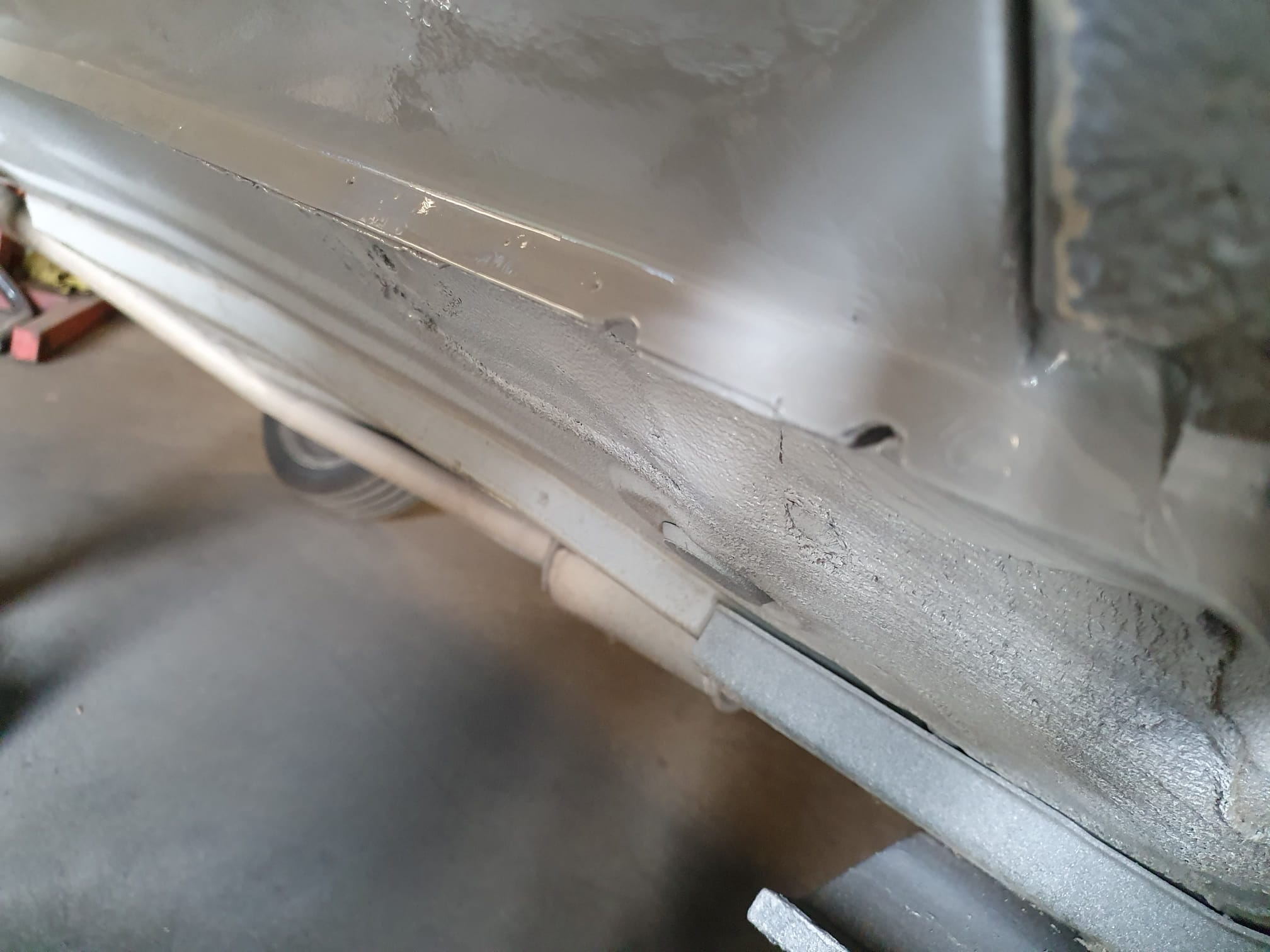

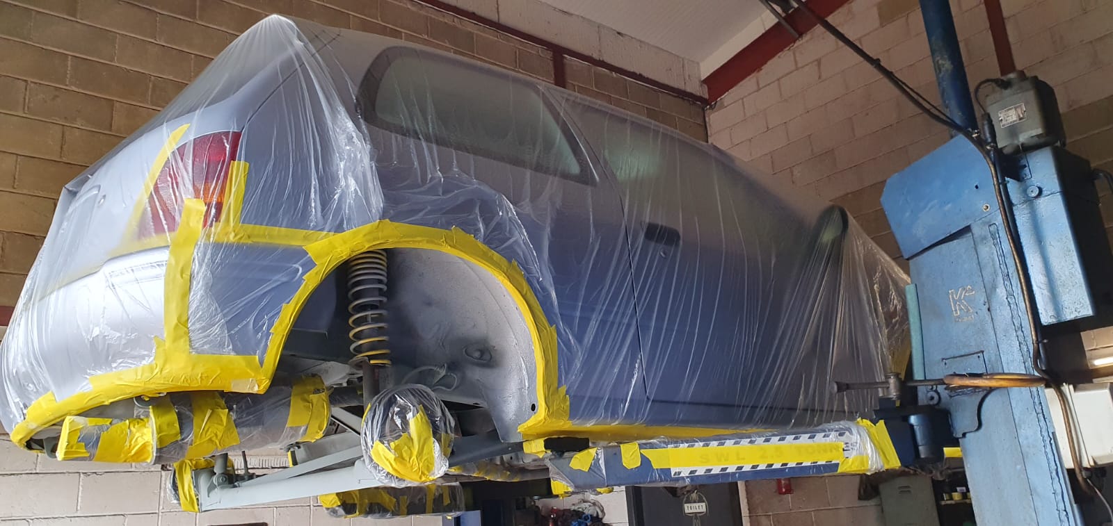

burty Posted June 8, 2024 Author Share Posted June 8, 2024 Then we cleaned everything up and started putting it back together and finishing off the rear sill Quote Link to post Share on other sites

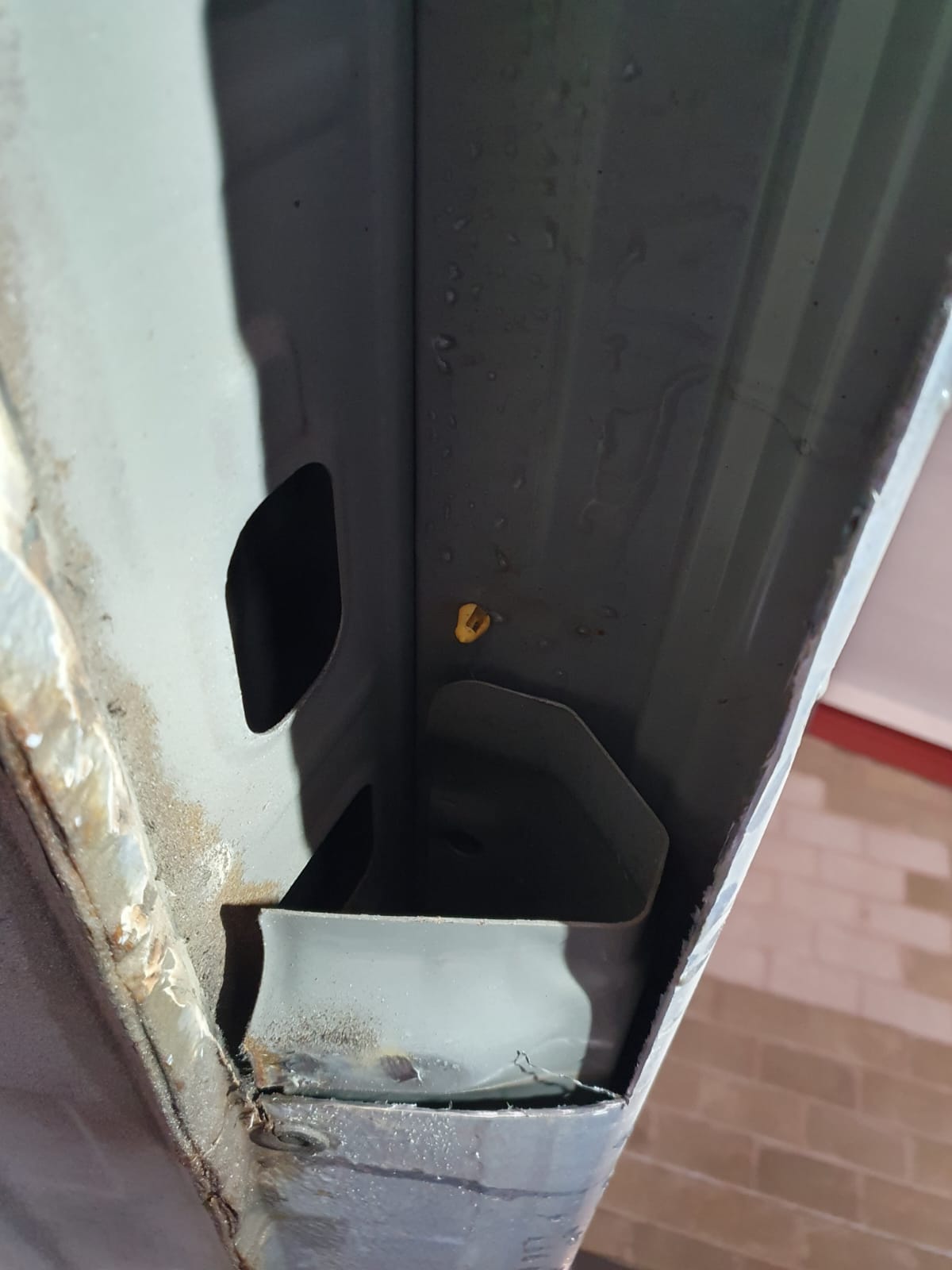

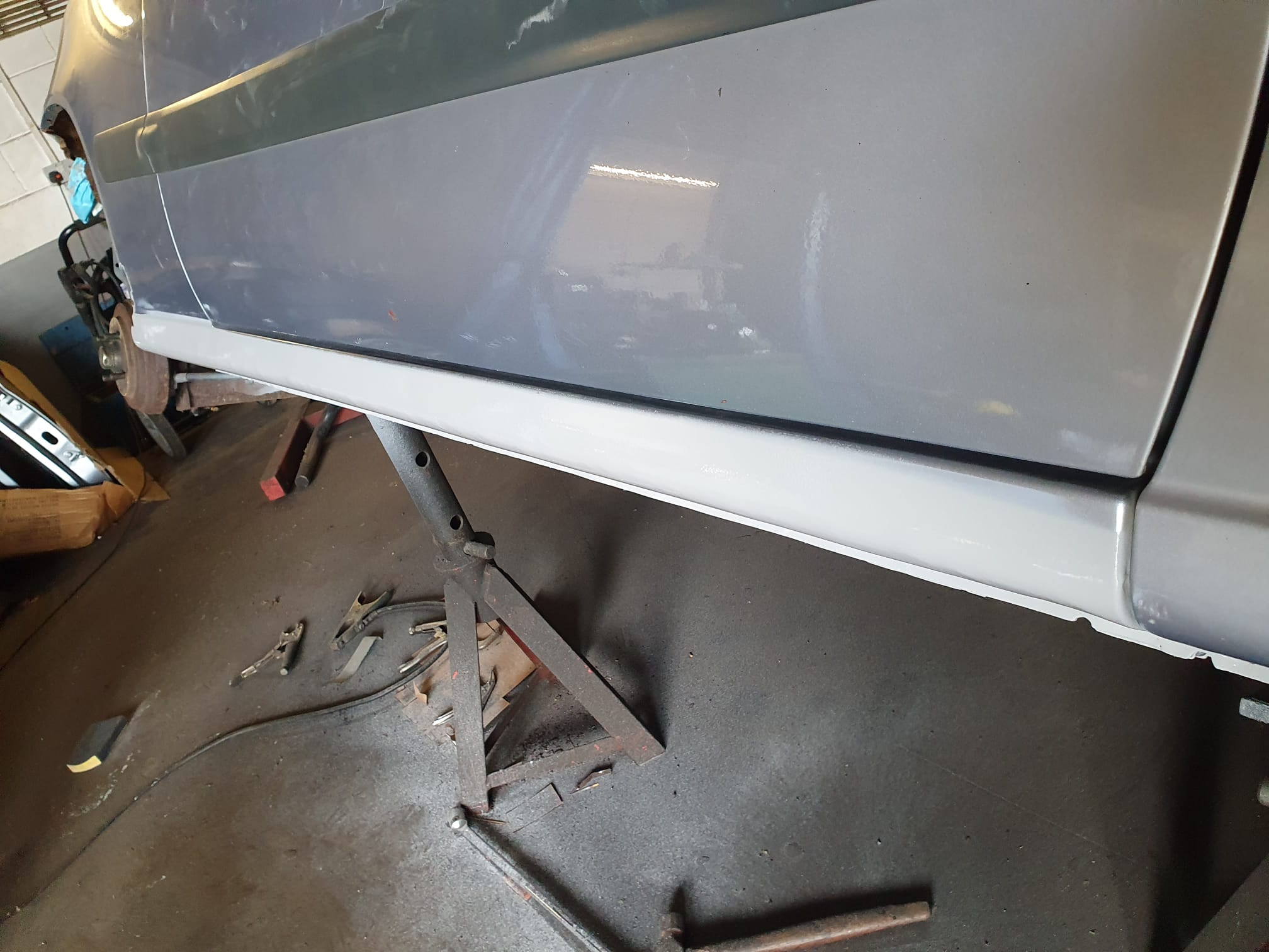

burty Posted June 8, 2024 Author Share Posted June 8, 2024 (edited) And here we have it an absolute milestone for me all welding is done and i cant tell you how good this feels No its not totally original anymore but its absolutely rust free now and solid on the body and ive used toyota metal where possible Edited June 8, 2024 by burty Quote Link to post Share on other sites
burty Posted June 8, 2024 Author Share Posted June 8, 2024 Where next ? to clean up the beams/axles supension components etc and replace worn bushes ...................watch this space might get it painted this year🤞 Quote Link to post Share on other sites

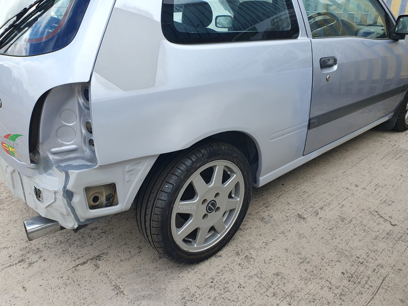

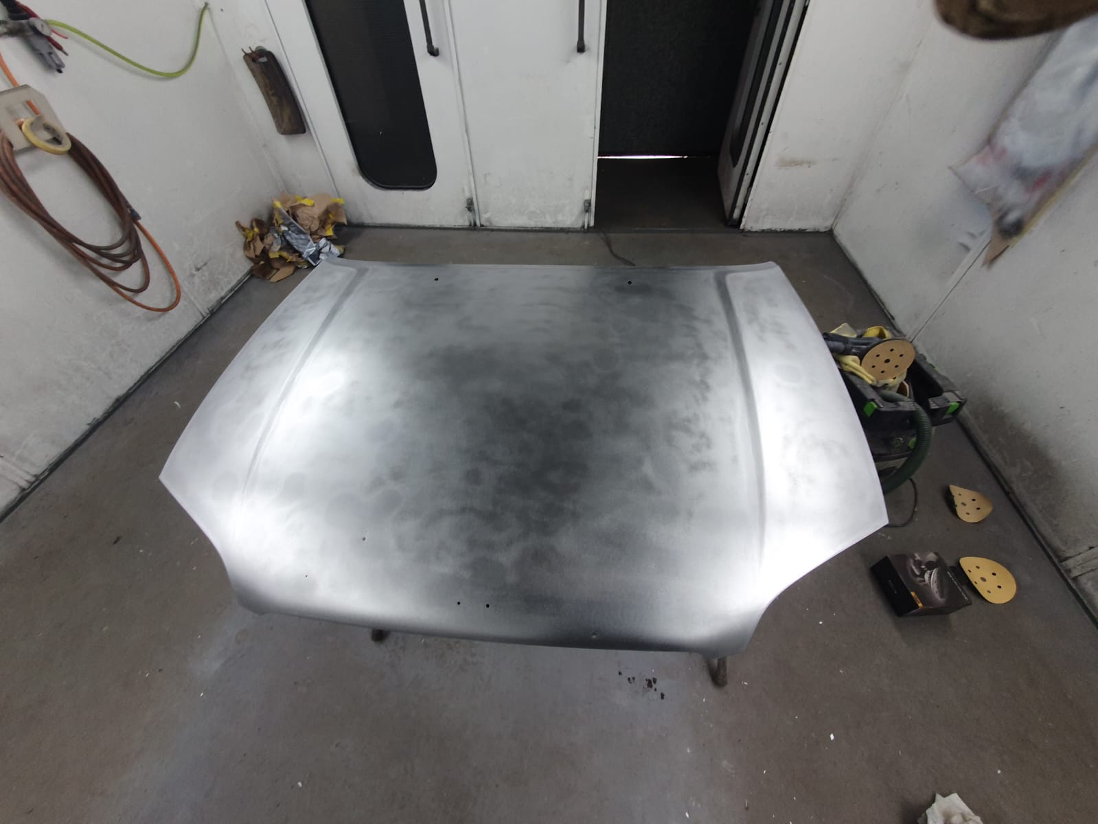

burty Posted June 29, 2024 Author Share Posted June 29, 2024 (edited) Been cracking straight on with the filler and blending another once over is needed then its glass out and onto primer in next few weeks I do have some nearly new glanza green tinted UV optional extra glass with brand new windscreen to go in some updated pics attached Edited June 29, 2024 by burty Quote Link to post Share on other sites

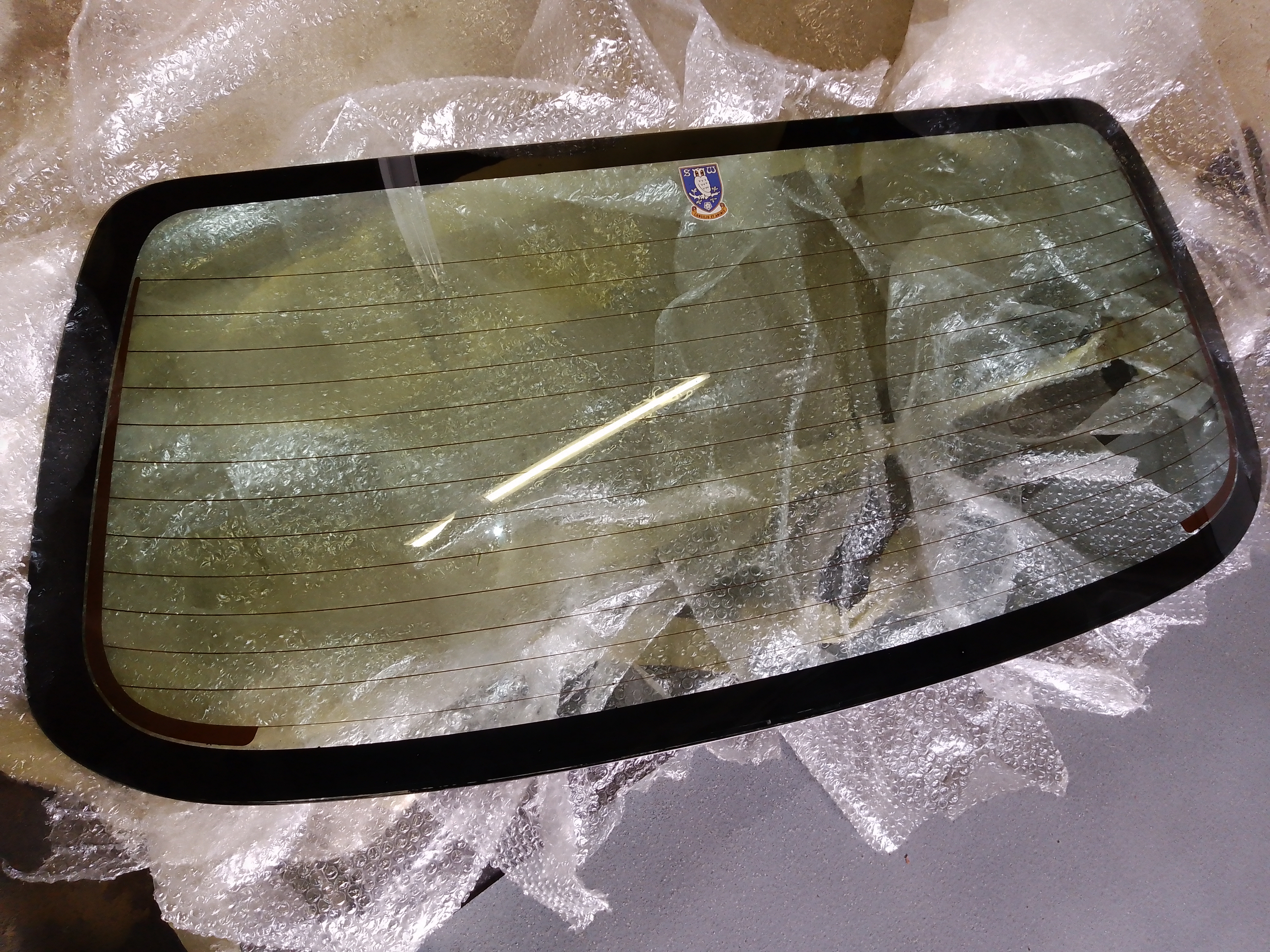

burty Posted July 18, 2024 Author Share Posted July 18, 2024 (edited) This is the glass from the JDM starlets with the UV glass it's etched into the corner it's in much better condition than mine so these will be going in You can really see the green unlike UK spec glass Edited July 18, 2024 by burty Quote Link to post Share on other sites

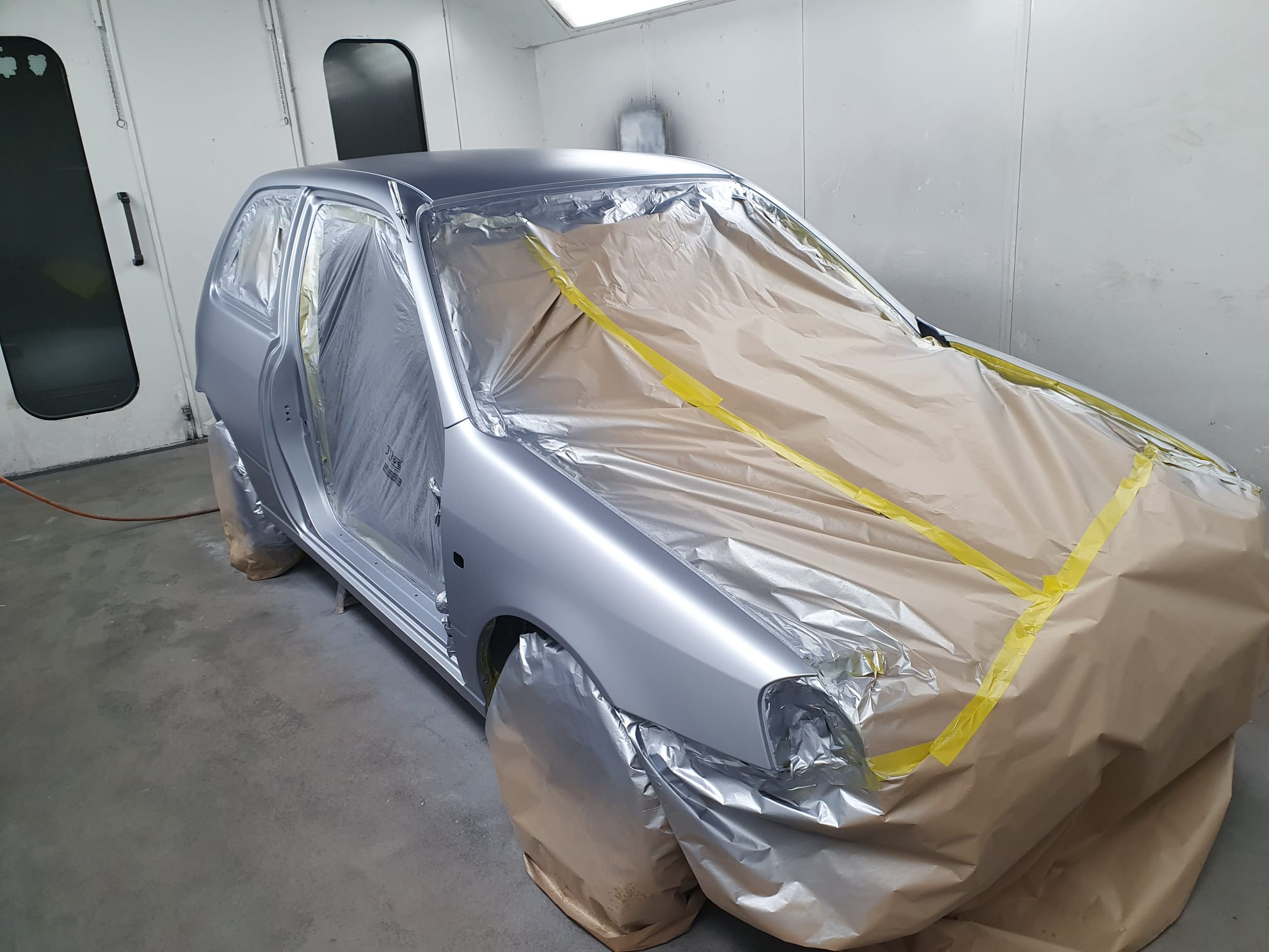

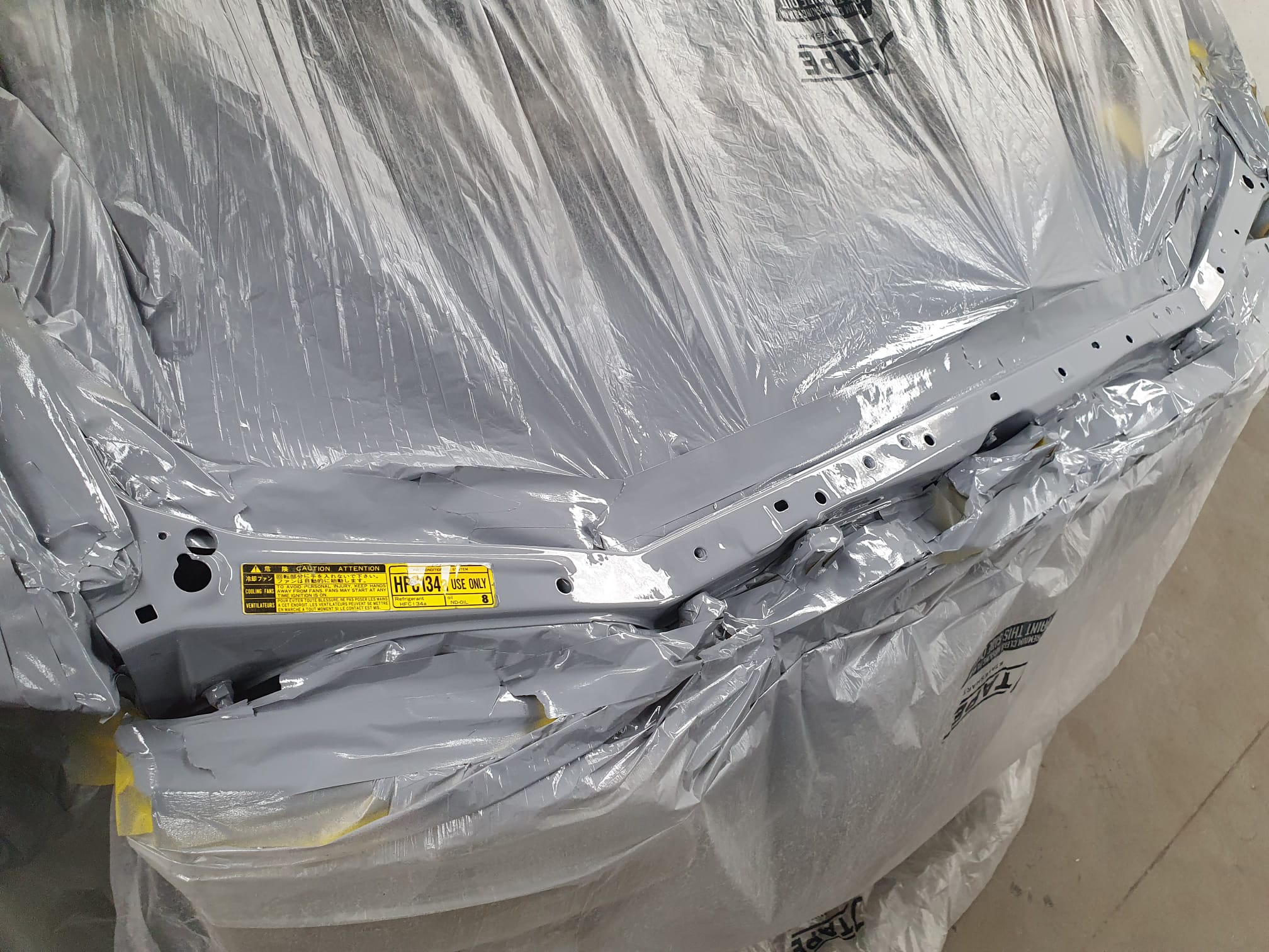

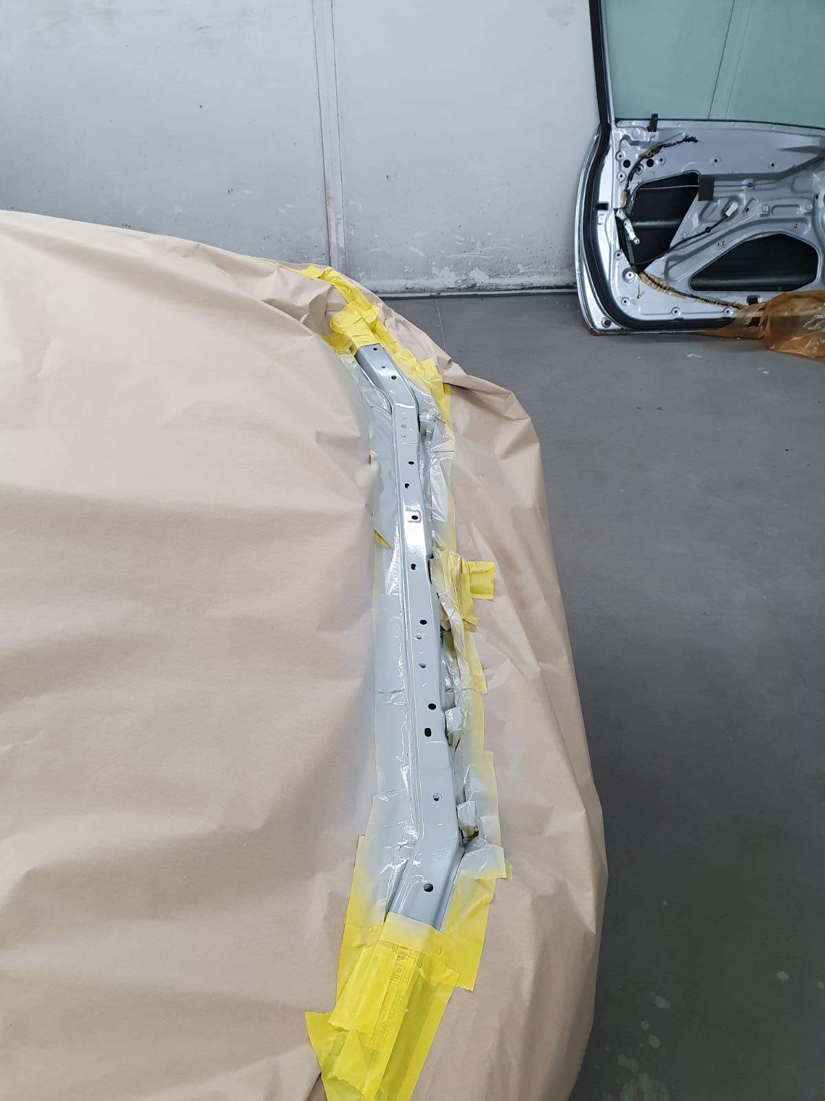

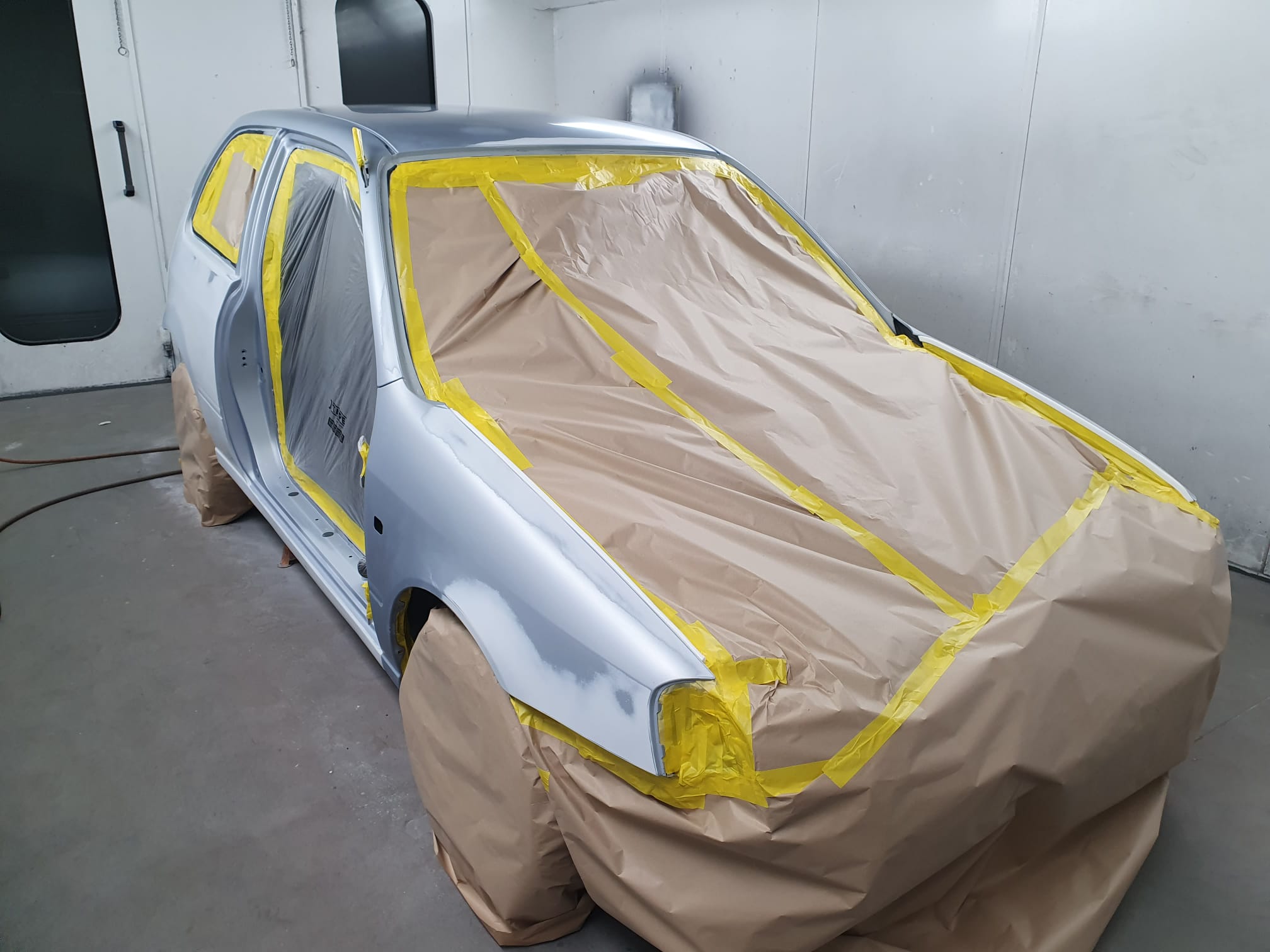

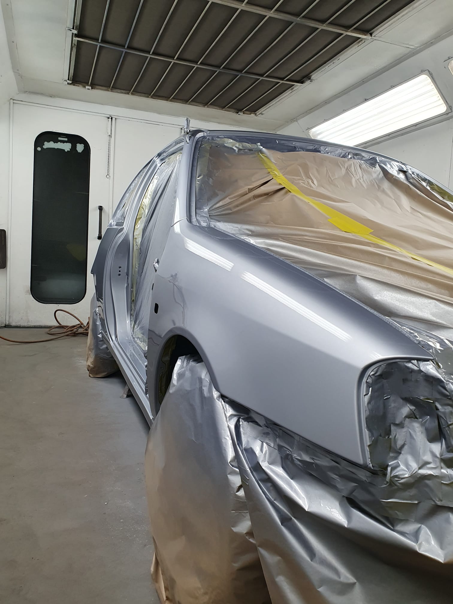

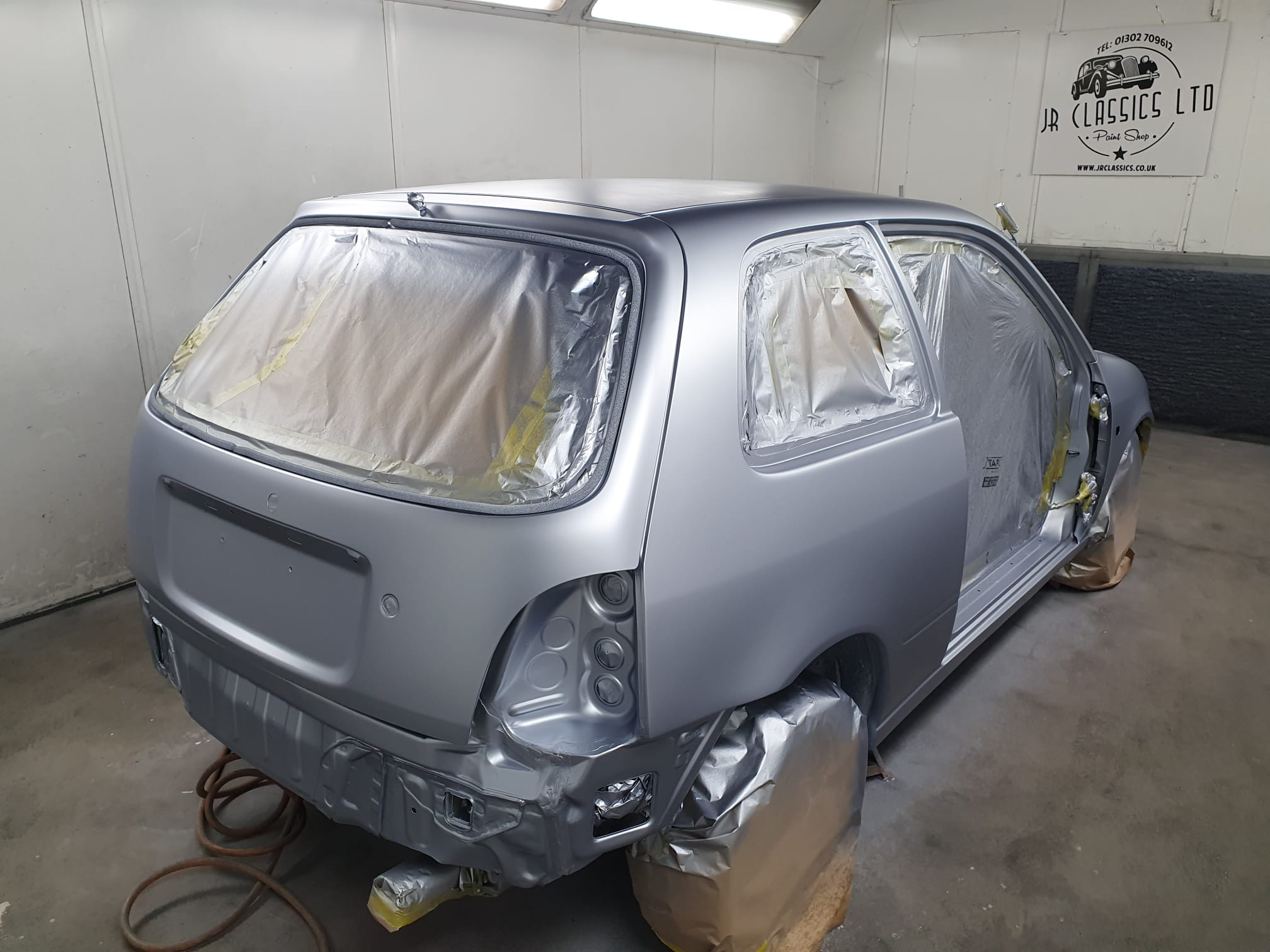

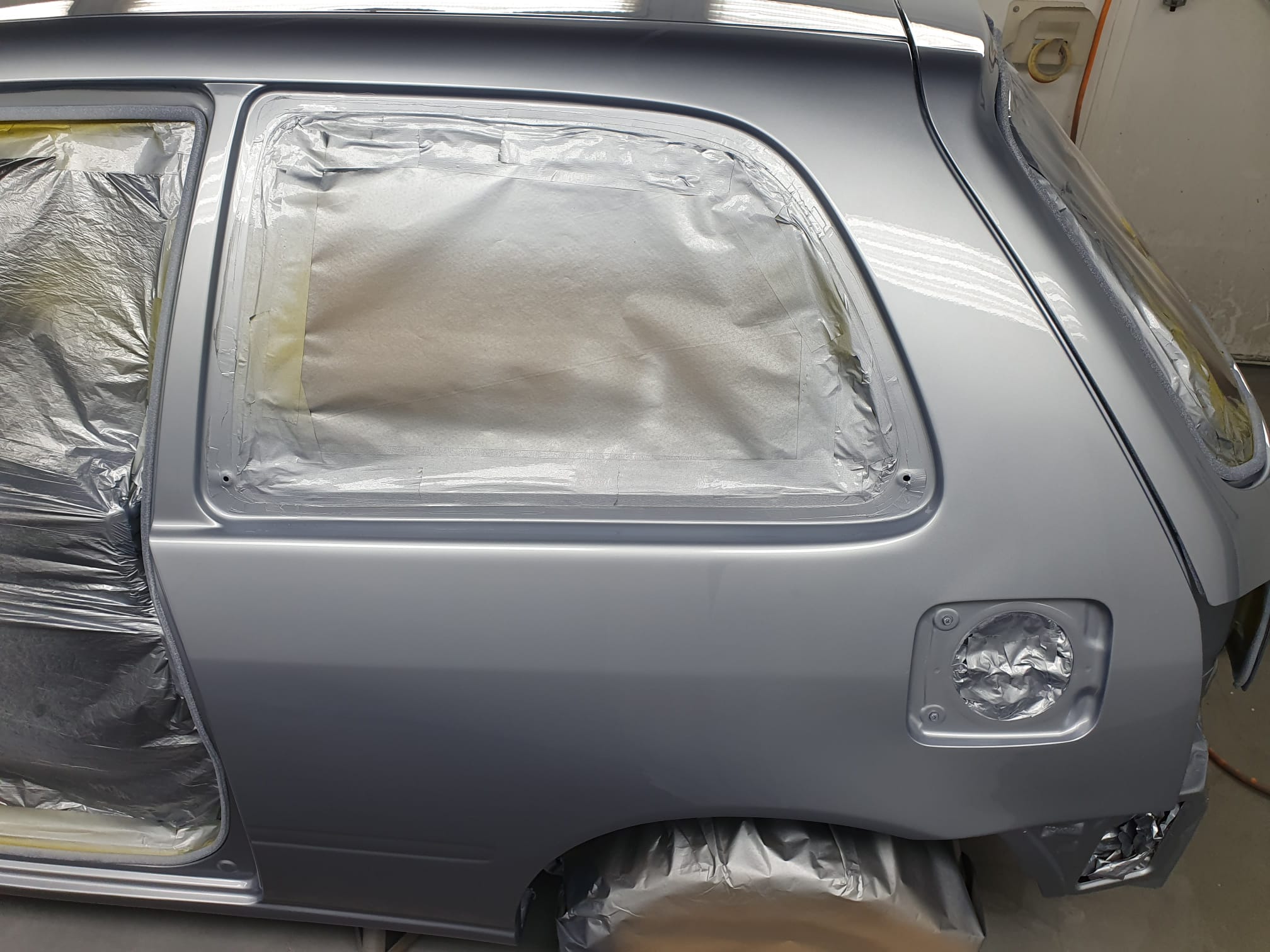

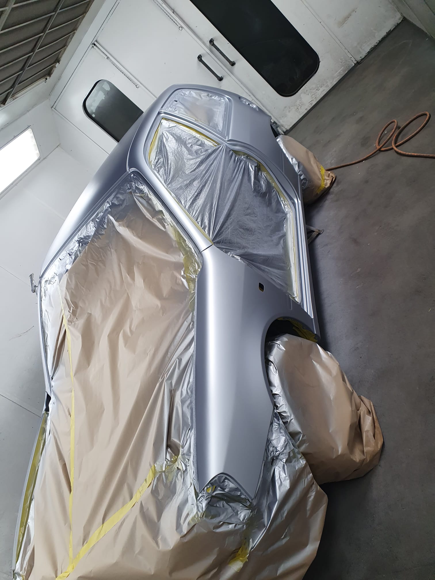

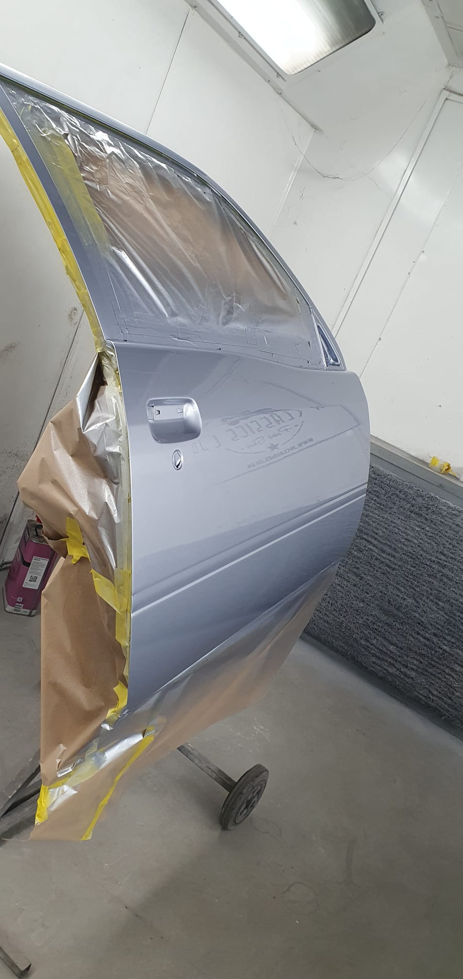

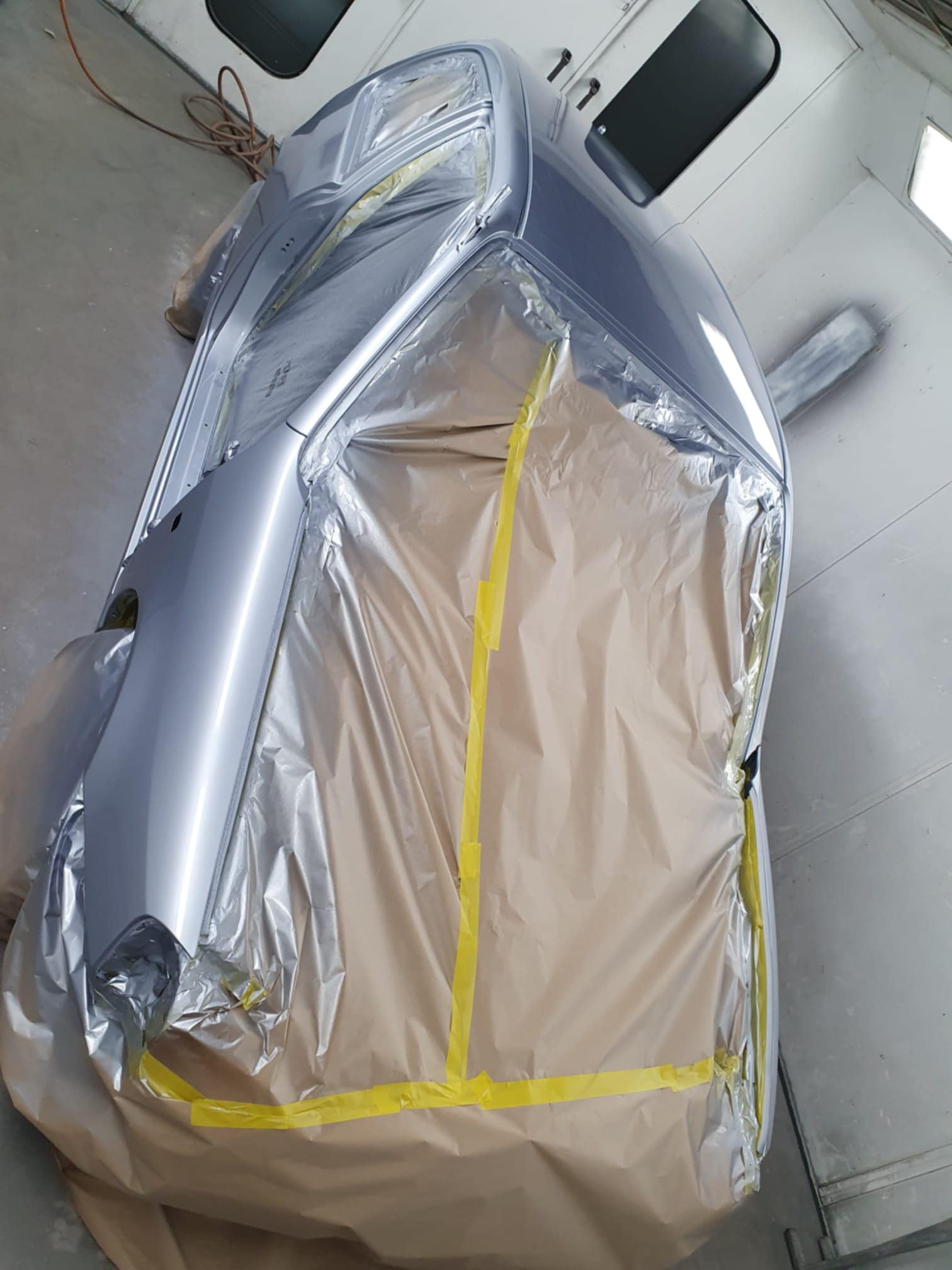

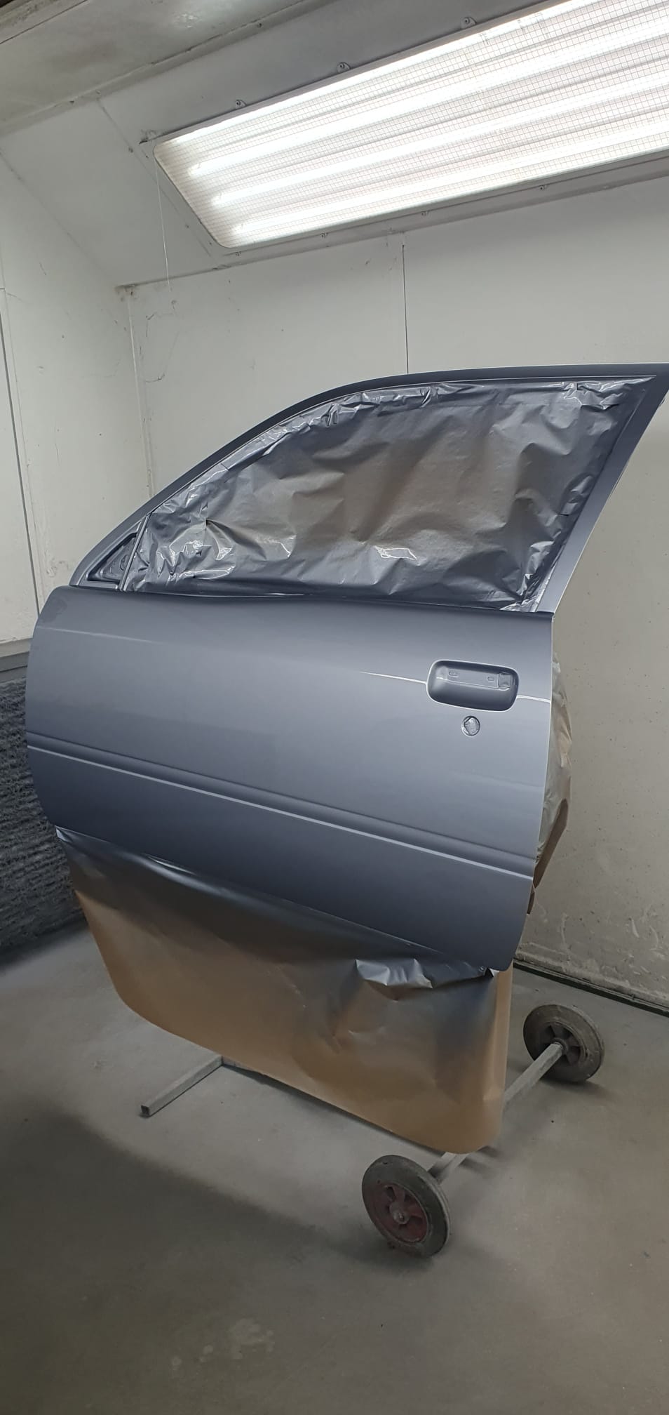

burty Posted November 8, 2024 Author Share Posted November 8, 2024 Quick update this was a month ago .....more detailed updates and pictures to come the car has finally had a full respray Quote Link to post Share on other sites

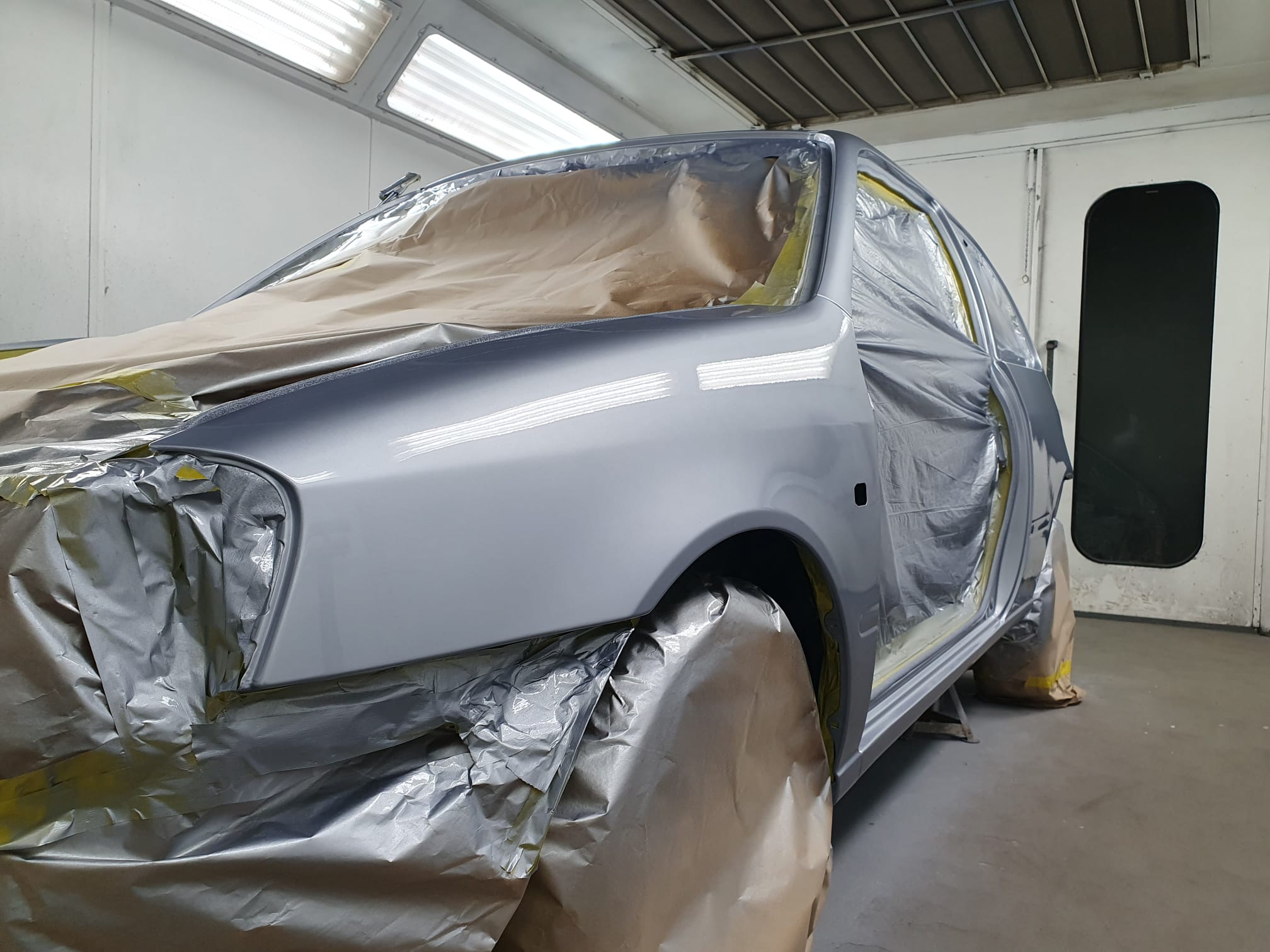

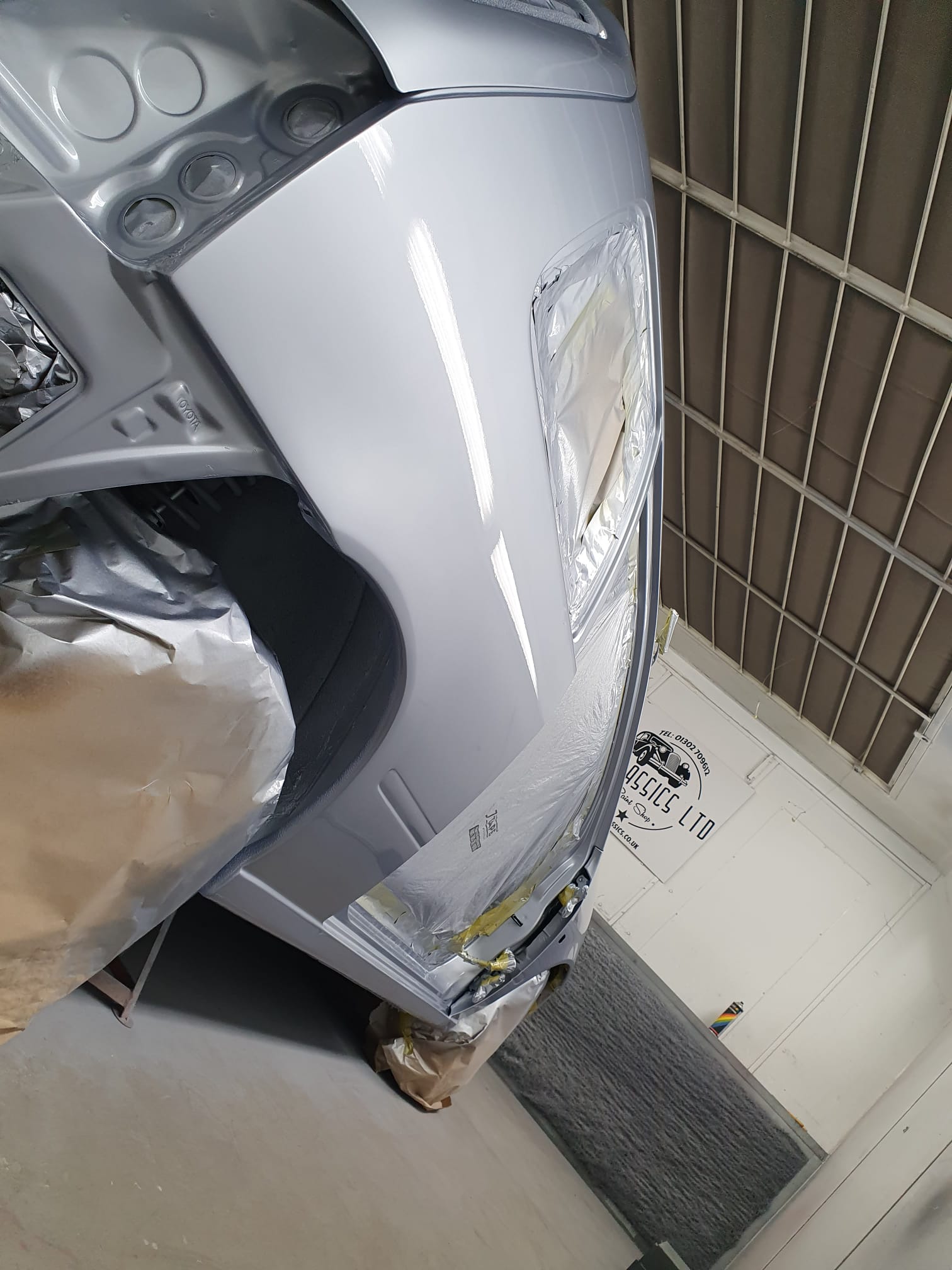

burty Posted December 5, 2024 Author Share Posted December 5, 2024 As promised more pictures of the respray looks unreal to the eye the fresh 1ao silver really does have a nice ice blue in comparison to other silvers Quote Link to post Share on other sites

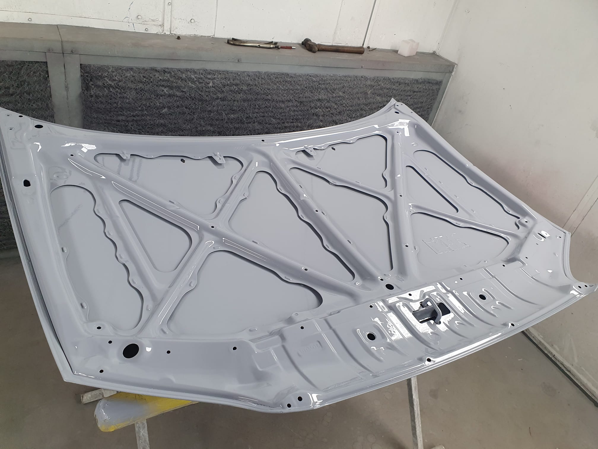

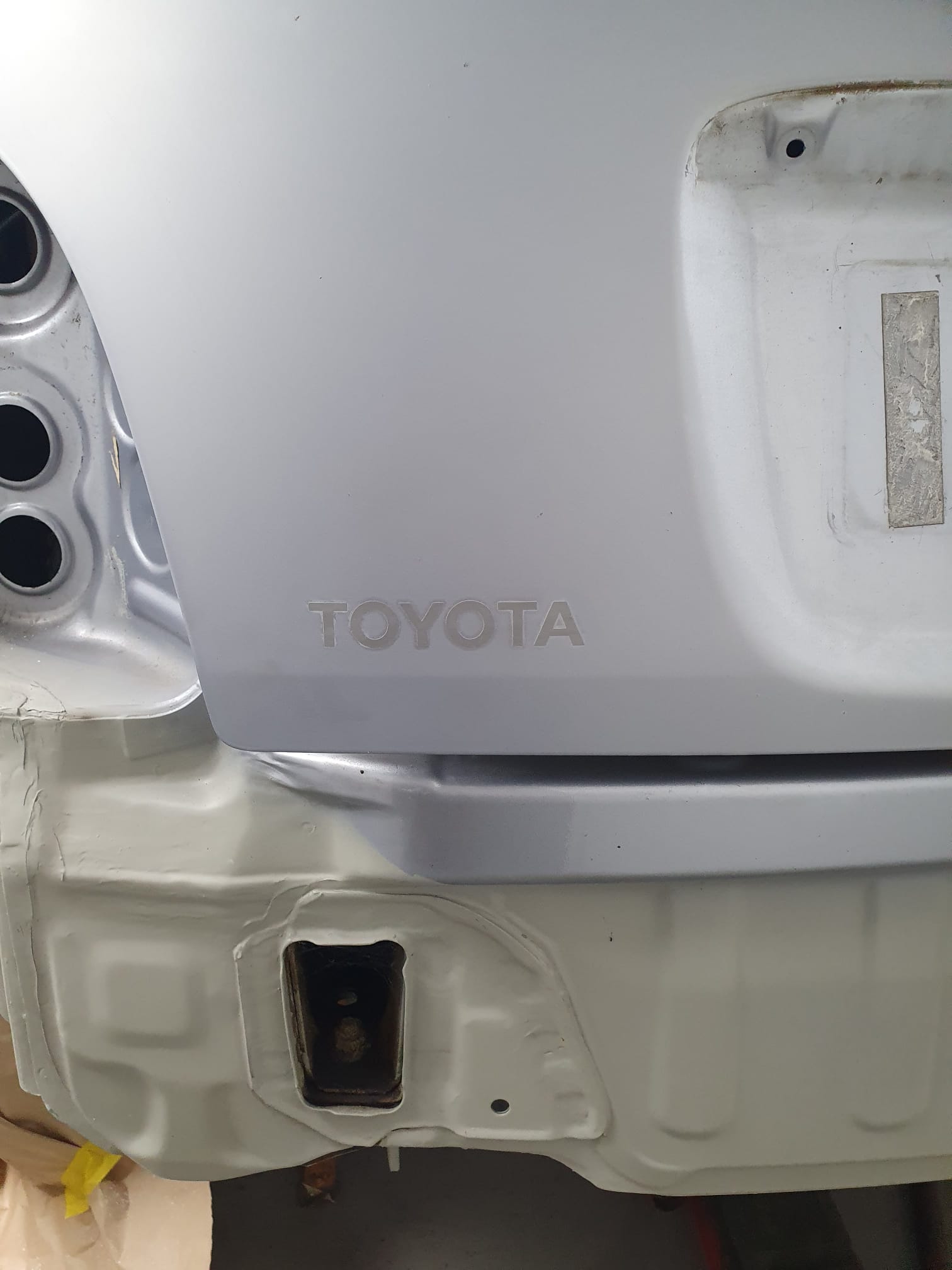

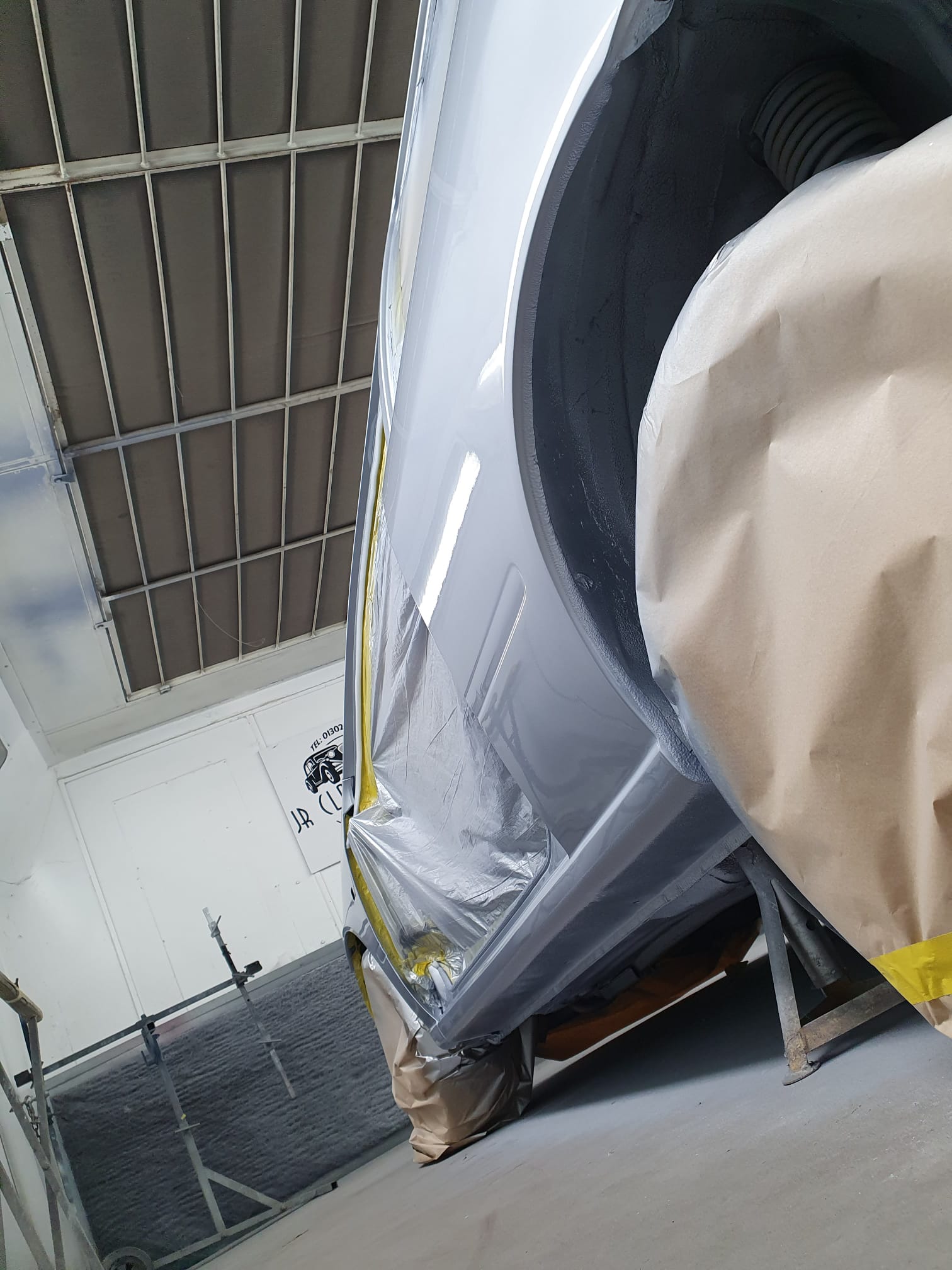

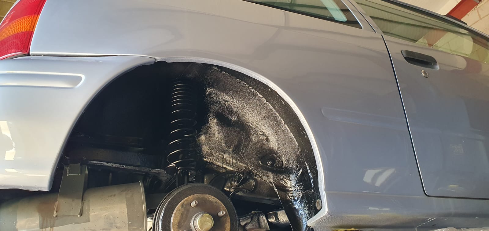

burty Posted December 5, 2024 Author Share Posted December 5, 2024 (edited) i also had the rear slam panel and sills and arch lips covered in raptor stone chip before the respray to prevent the rust happening again Original grey also sprayed inside of filler cap under bonnet boot area etc its the little things Edited December 5, 2024 by burty Quote Link to post Share on other sites

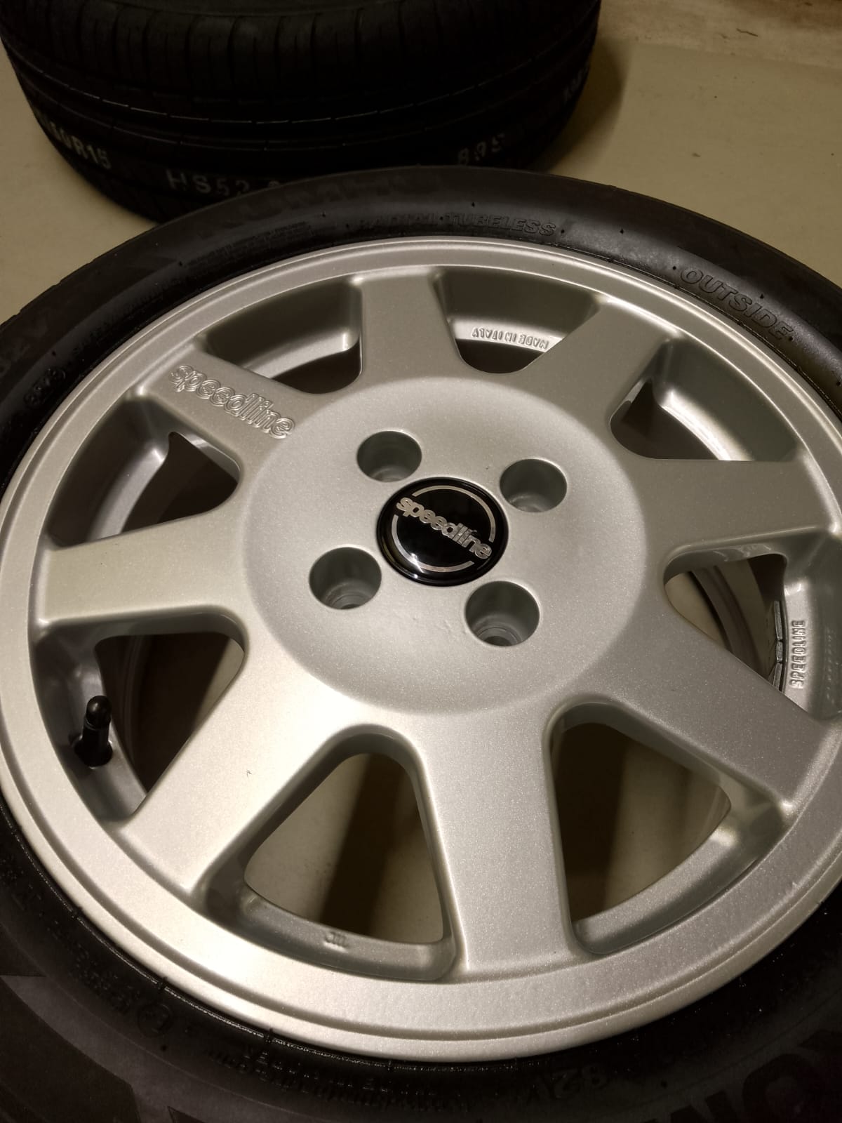

burty Posted December 5, 2024 Author Share Posted December 5, 2024 Also had the speedlines refurbed with new caps tyres and powdercoat Quote Link to post Share on other sites

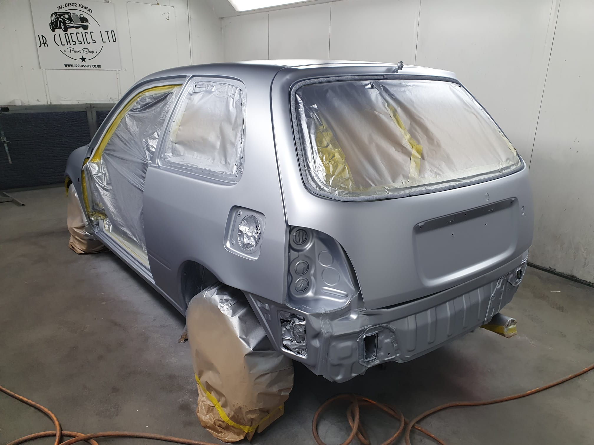

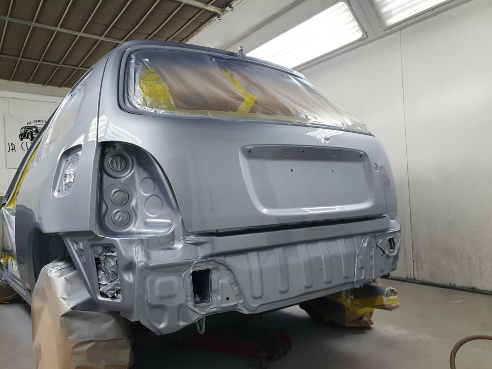

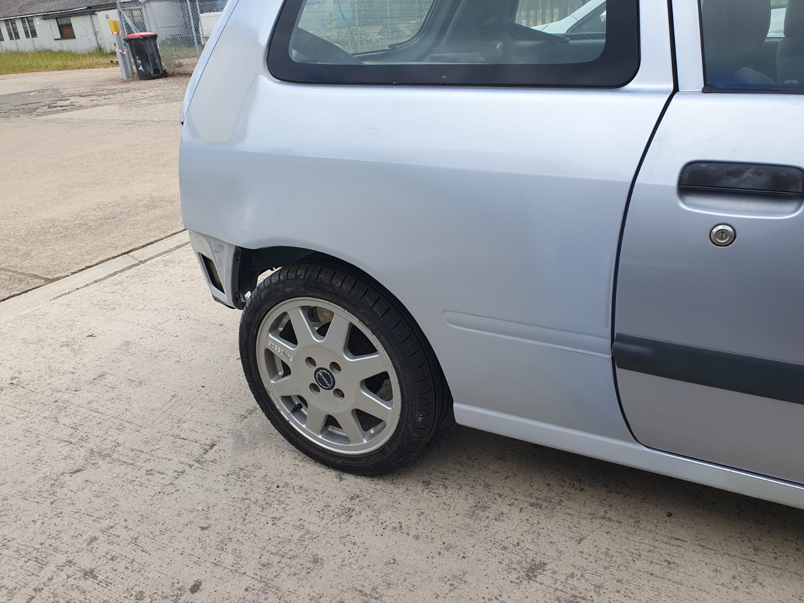

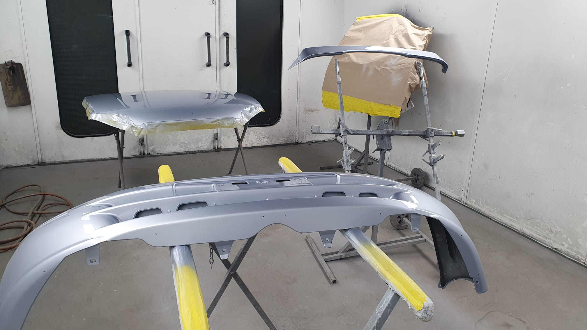

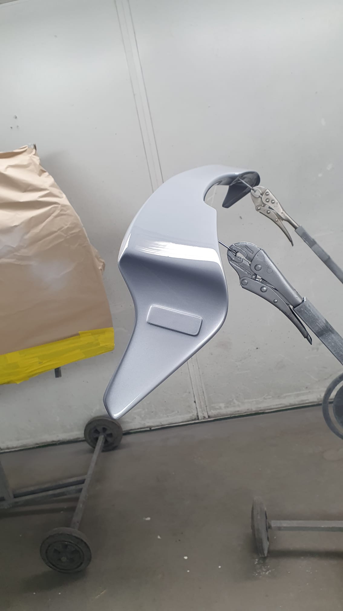

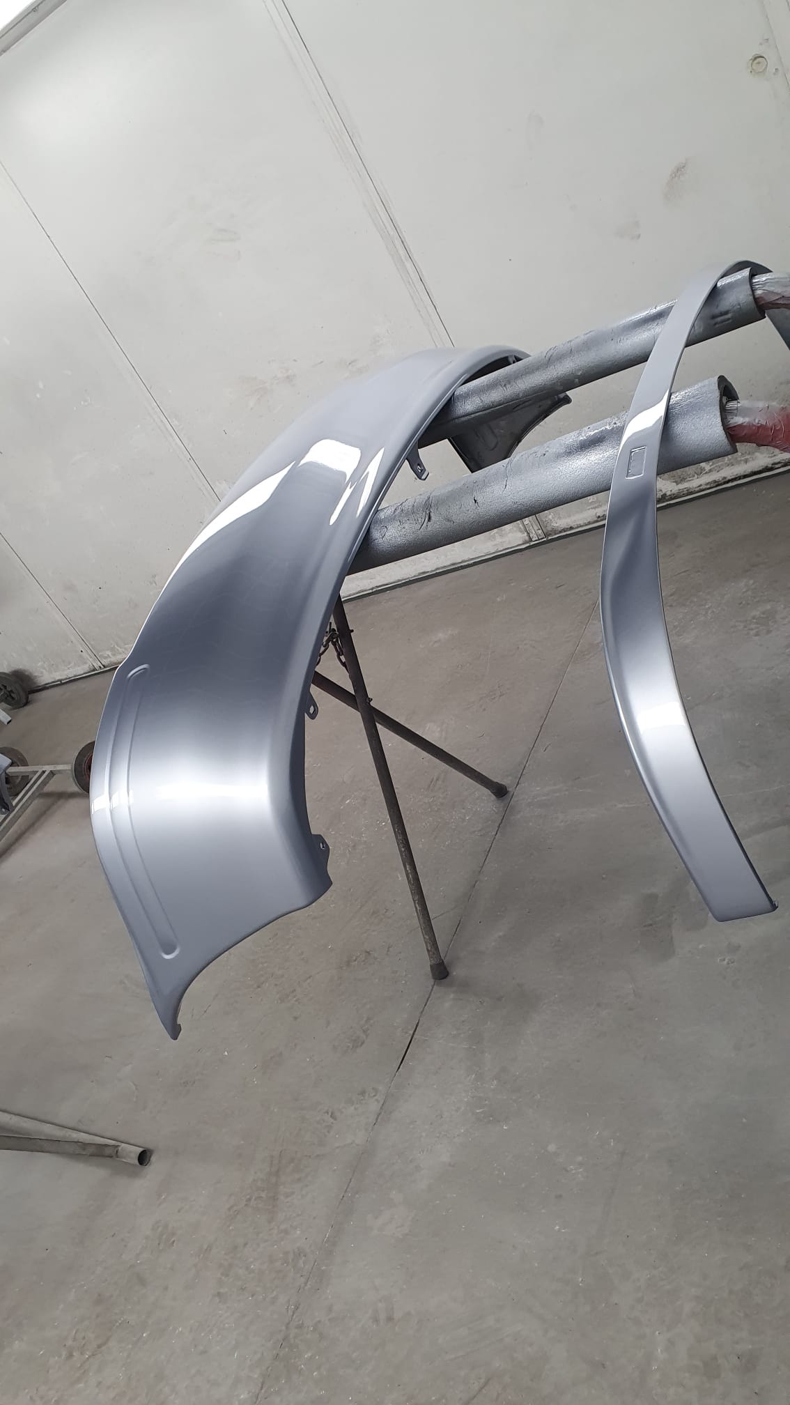

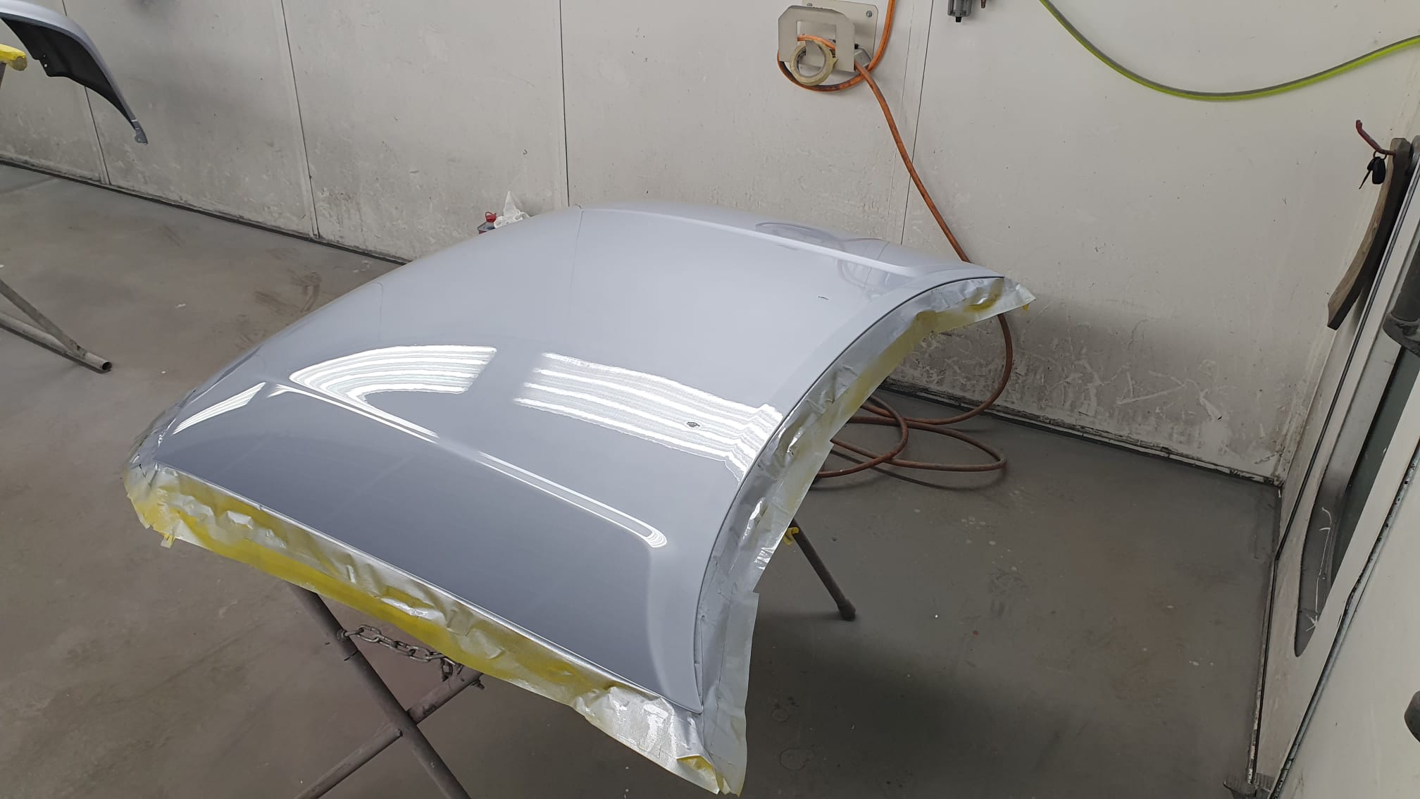

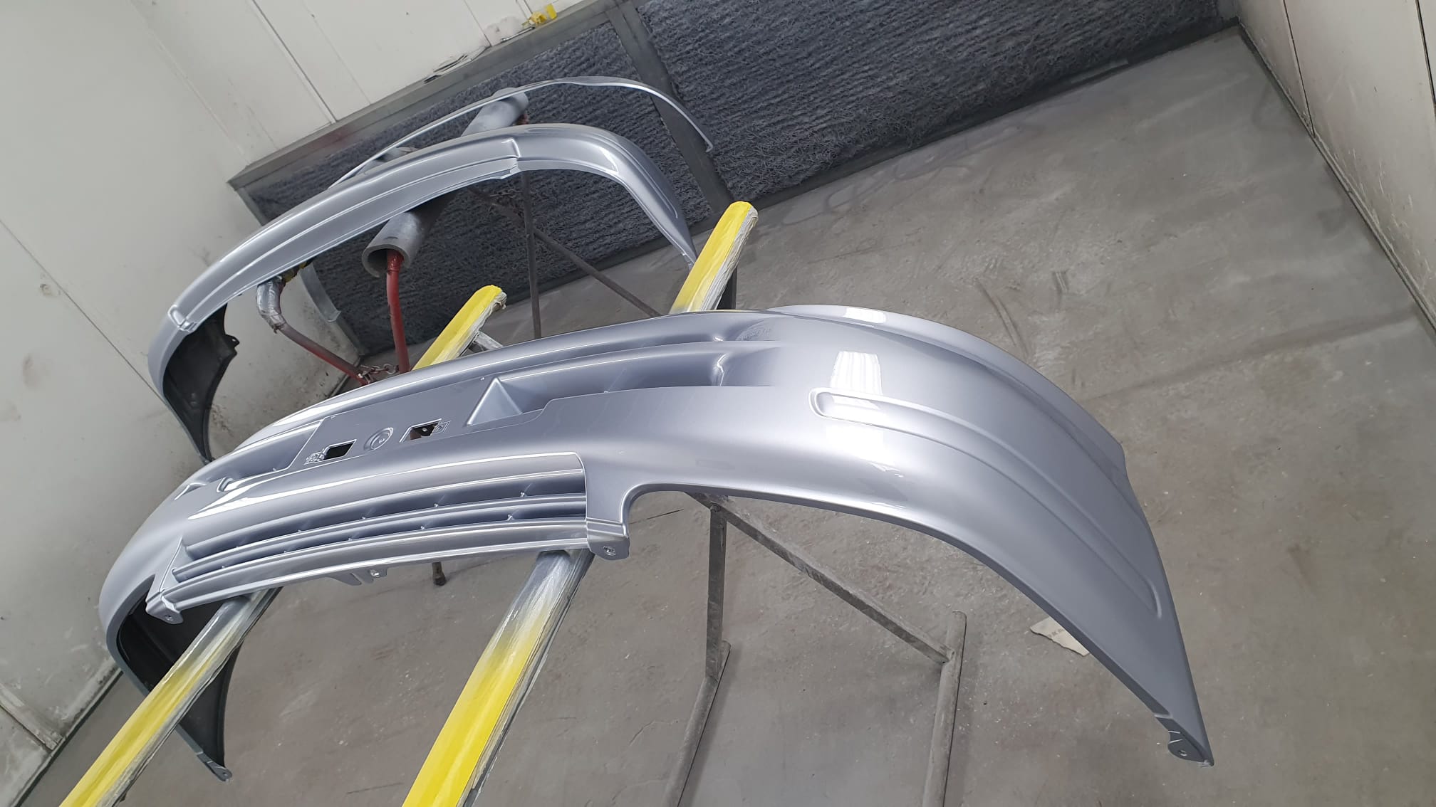

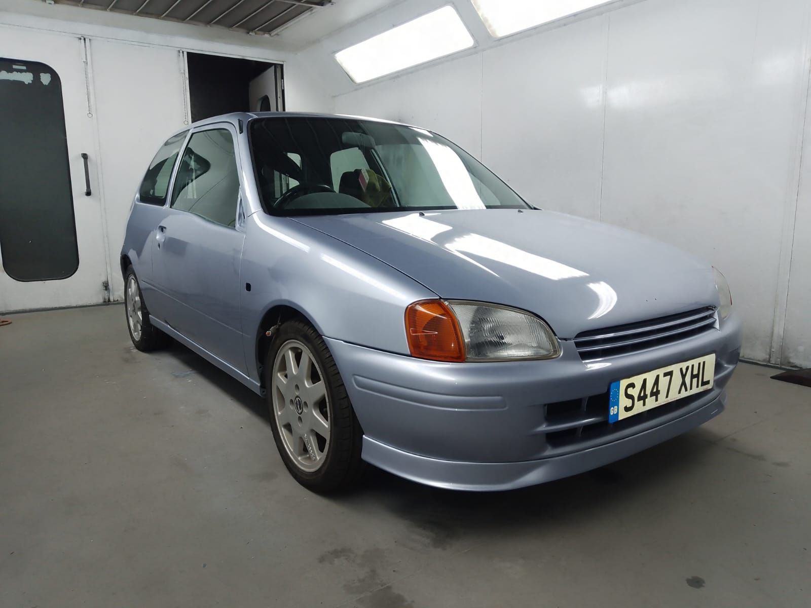

burty Posted Saturday at 04:29 PM Author Share Posted Saturday at 04:29 PM (edited) Been a long long time since i updated this on here as a few of you already know its been a very good few months of progress all the rest of the panels got the 1ao treatment Edited Saturday at 04:35 PM by burty Quote Link to post Share on other sites

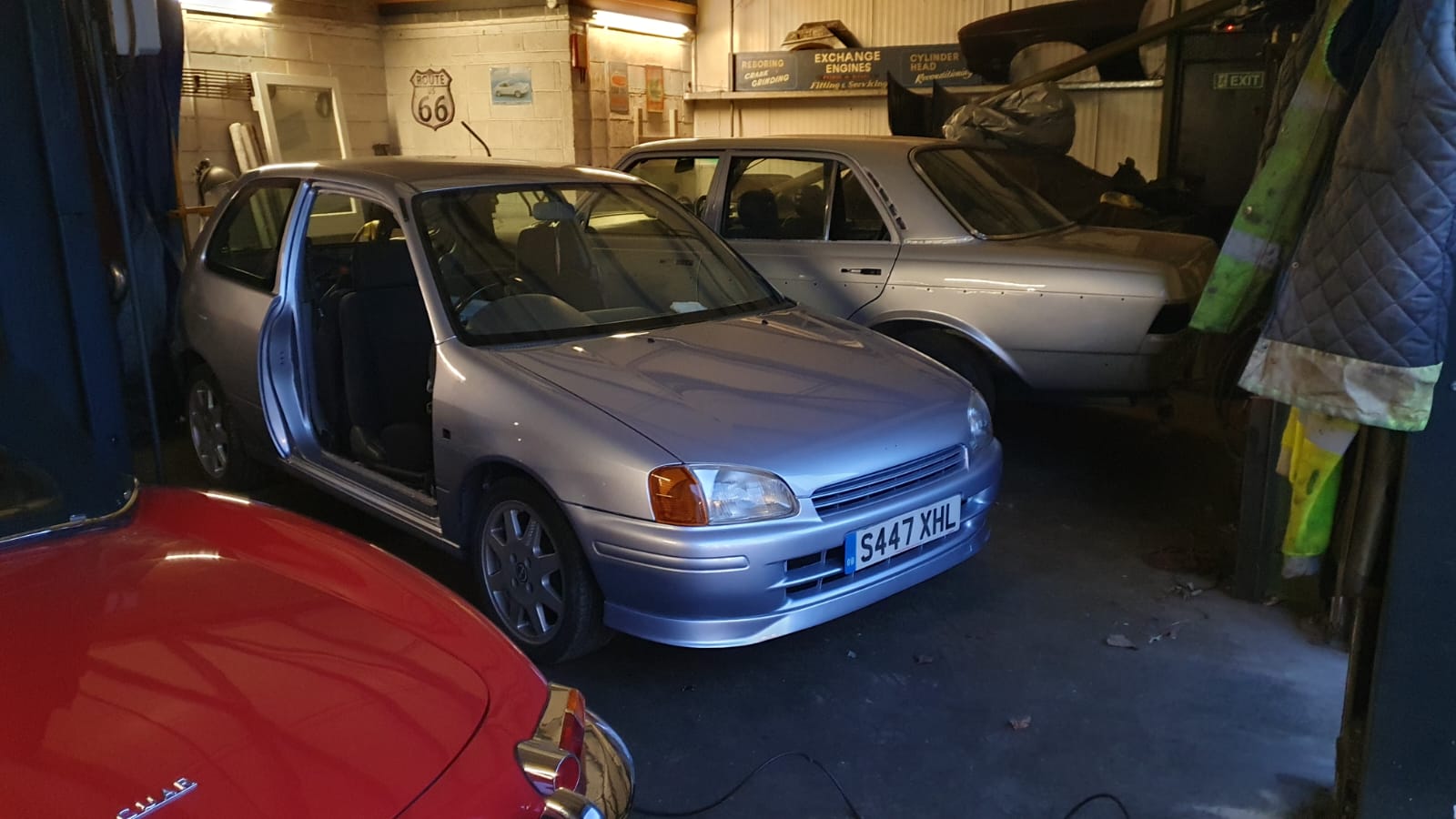

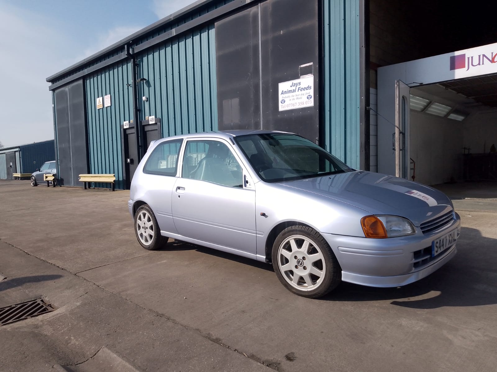

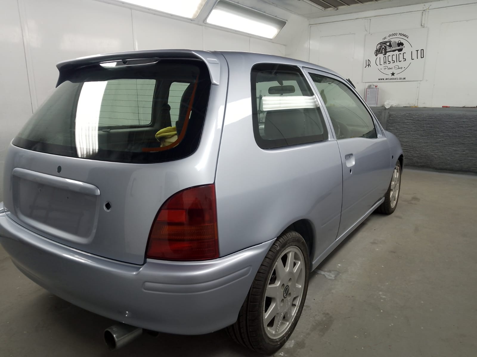

burty Posted Saturday at 04:34 PM Author Share Posted Saturday at 04:34 PM (edited) After this all the cars outside was re assembled minus the decals trims etc shes still sat on the non refurbed wheels at this point the new ones still to be fitted Edited Saturday at 04:47 PM by burty Quote Link to post Share on other sites
burty Posted Saturday at 04:37 PM Author Share Posted Saturday at 04:37 PM First time outside in a long while Quote Link to post Share on other sites

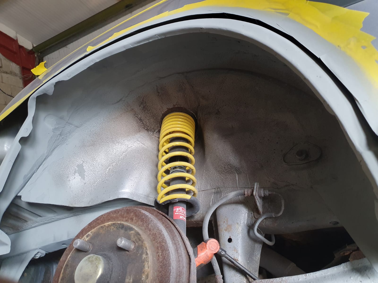

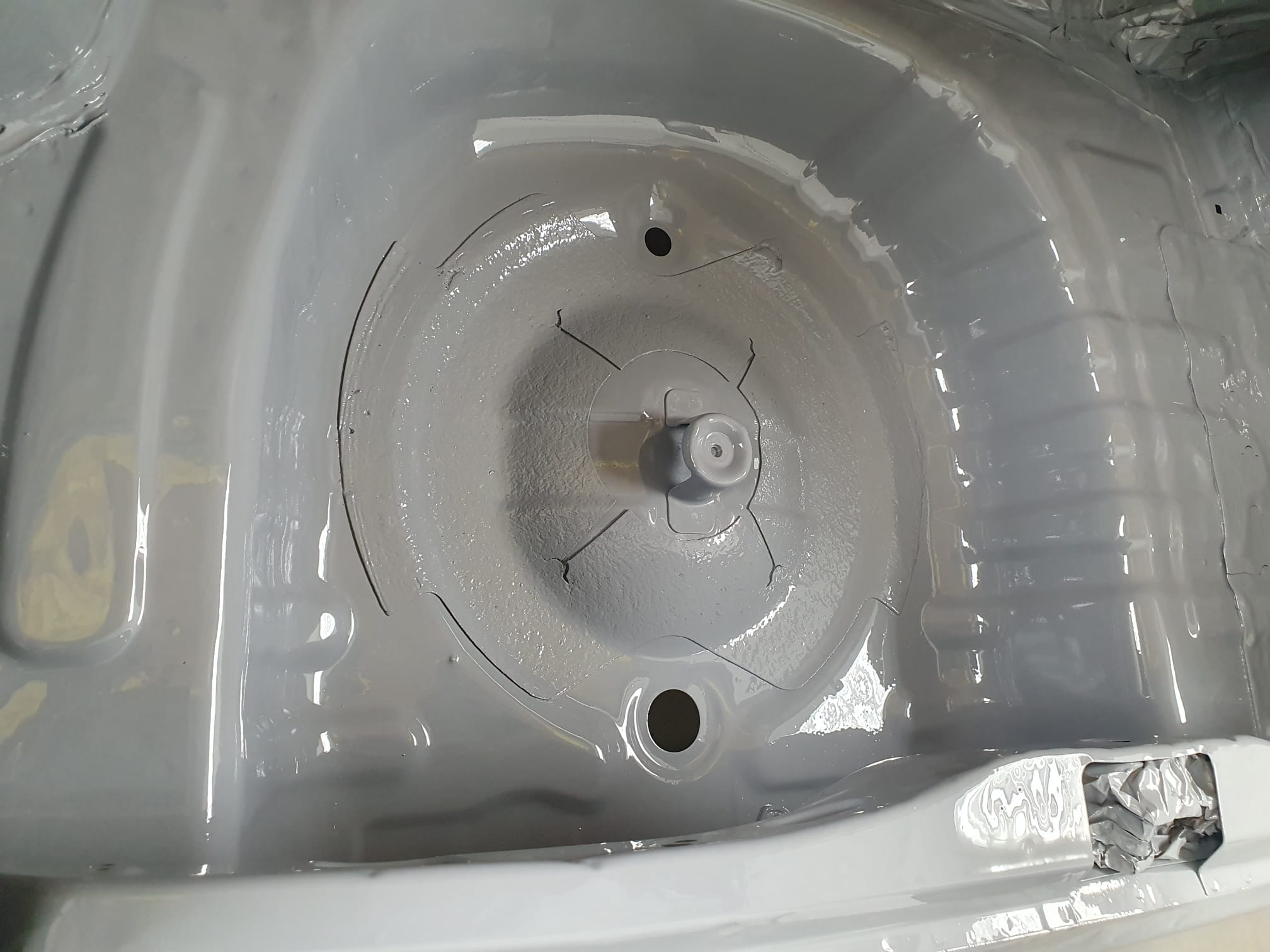

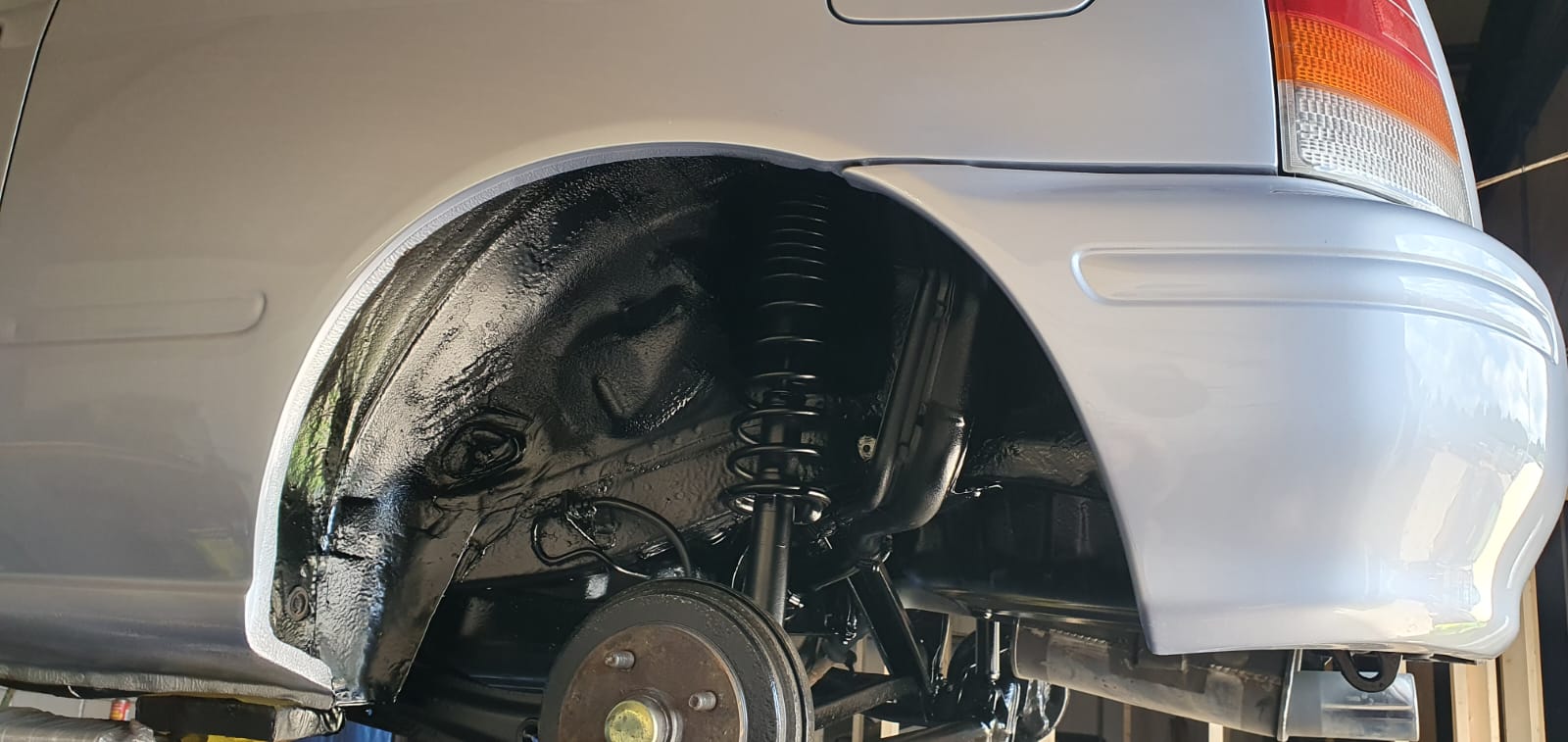

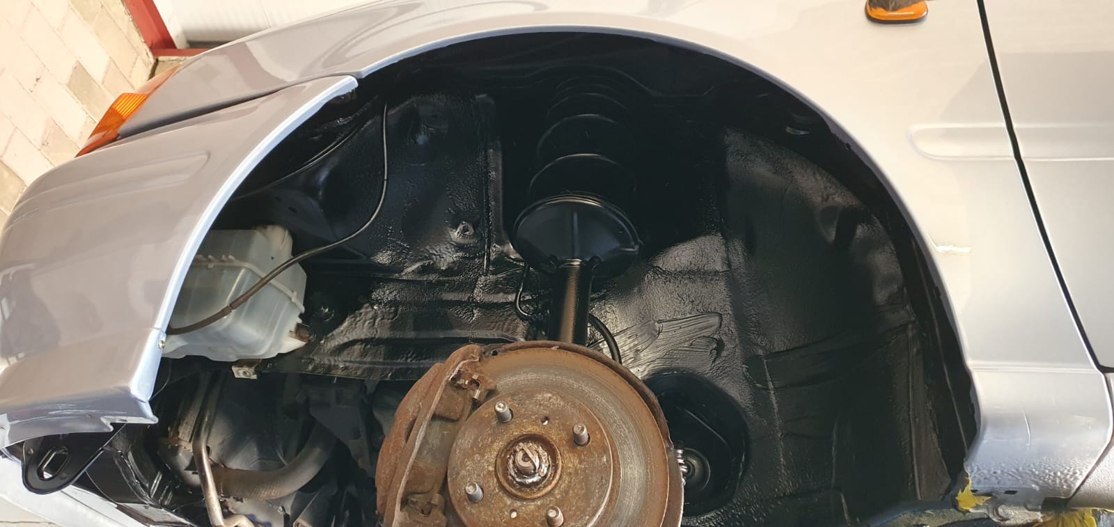

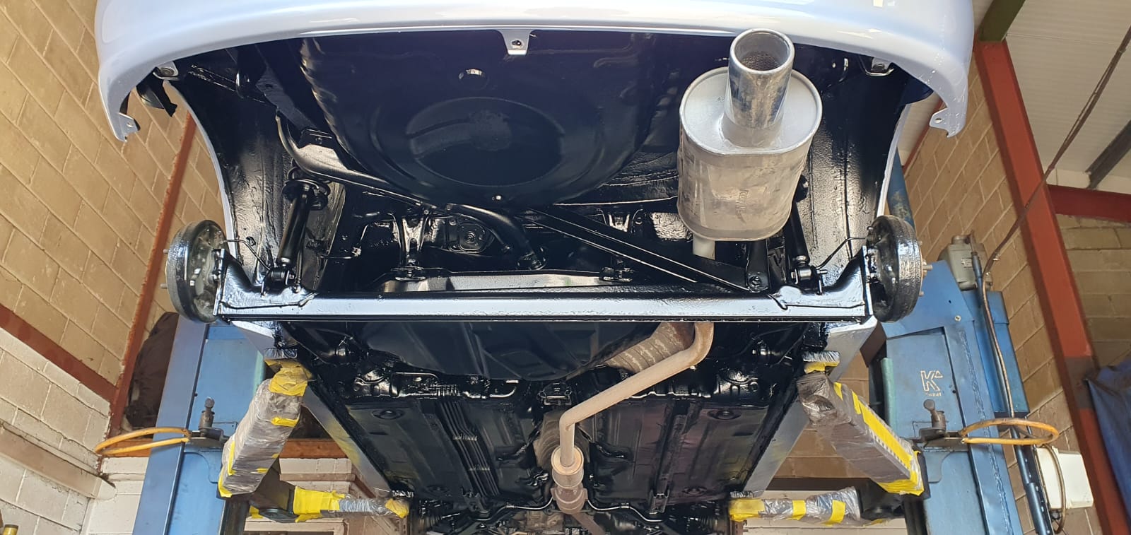

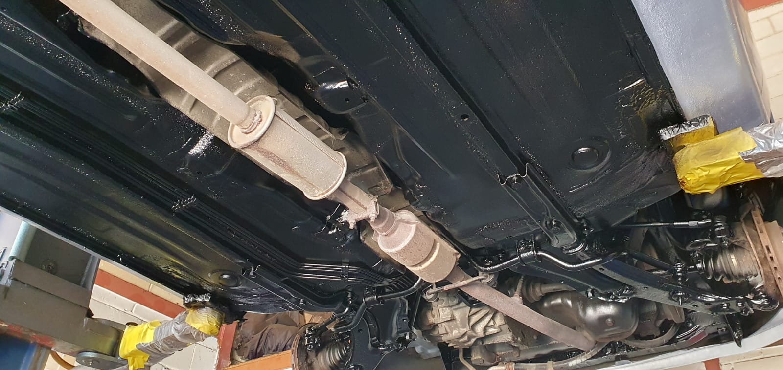

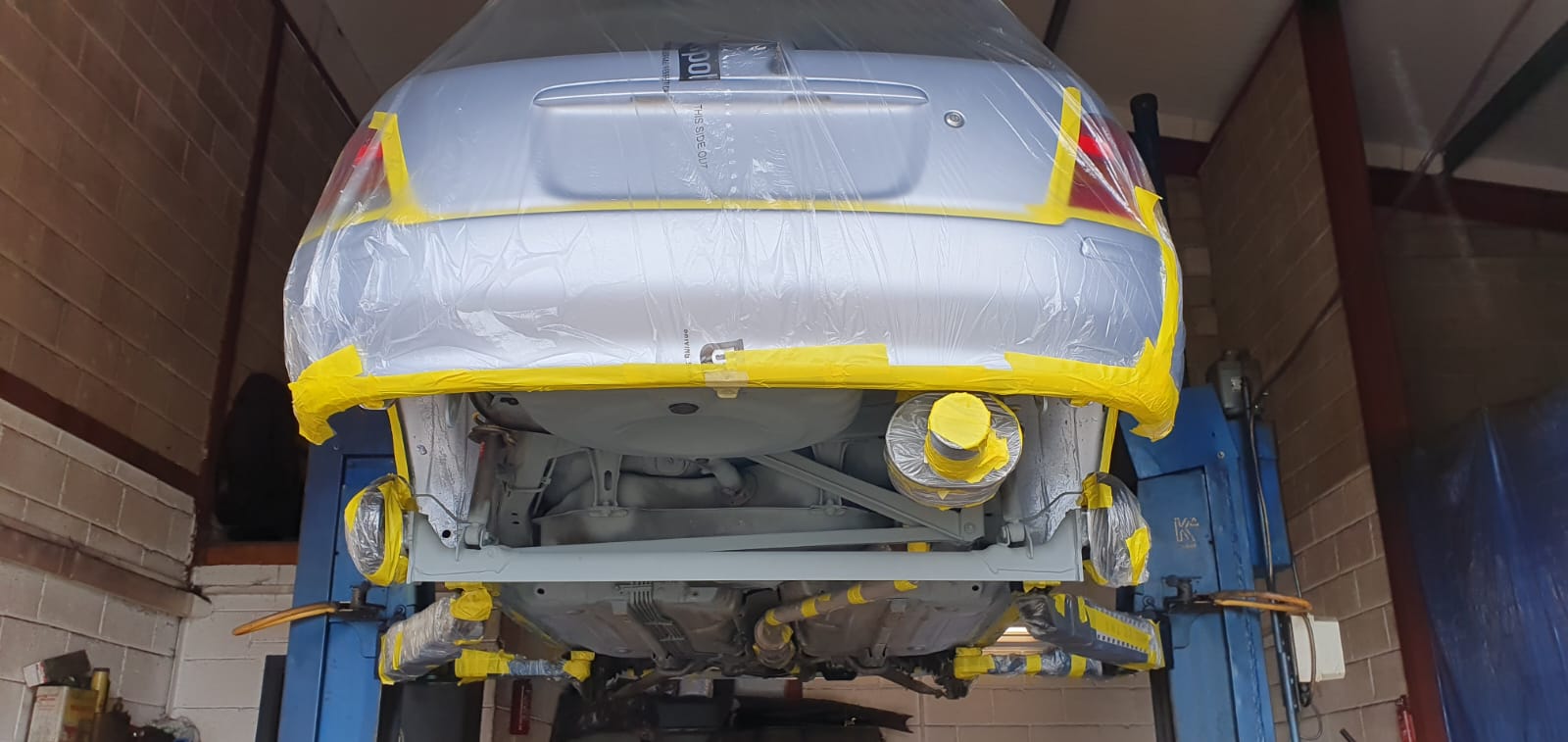

burty Posted Saturday at 04:41 PM Author Share Posted Saturday at 04:41 PM We then moved onto the underside all sheeted up surface rust ground back rust converter applied to be safe zinc primer and underseal this is a proper job and took a full week and was left to dry in the oven between coats Quote Link to post Share on other sites
burty Posted Saturday at 04:43 PM Author Share Posted Saturday at 04:43 PM il let the results speak for themselves getting ever closer to the finish line Quote Link to post Share on other sites
