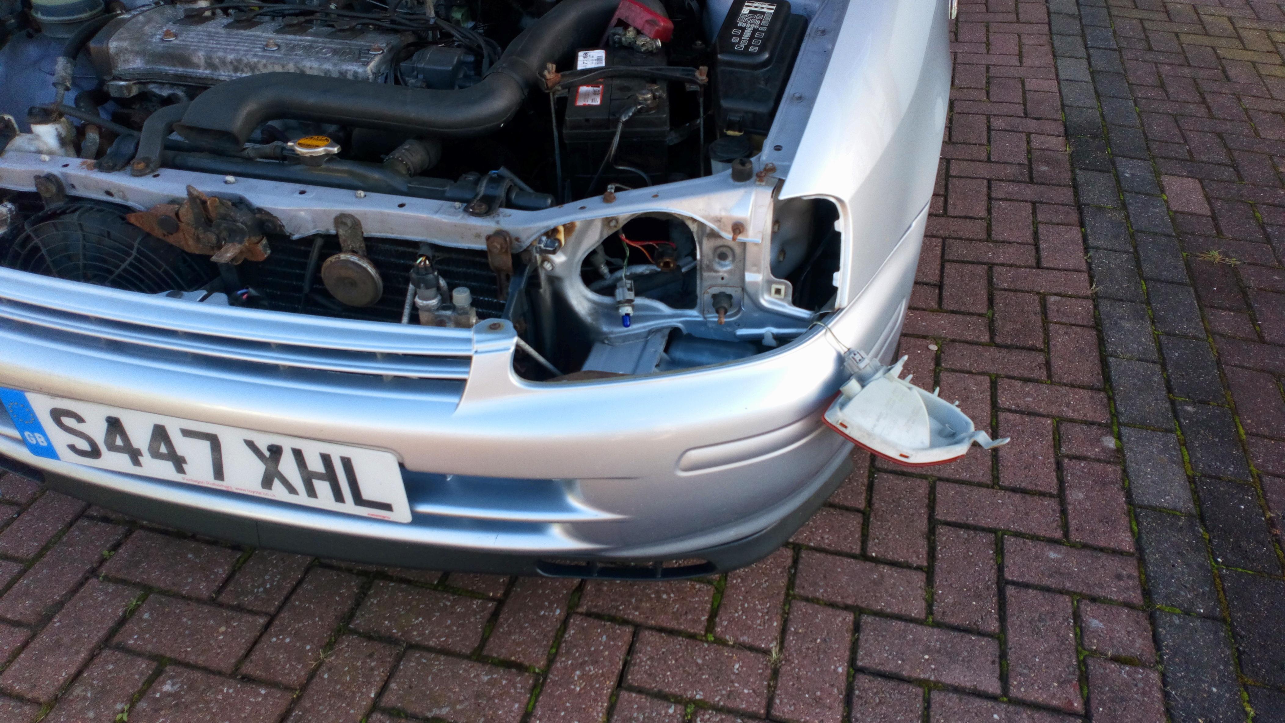

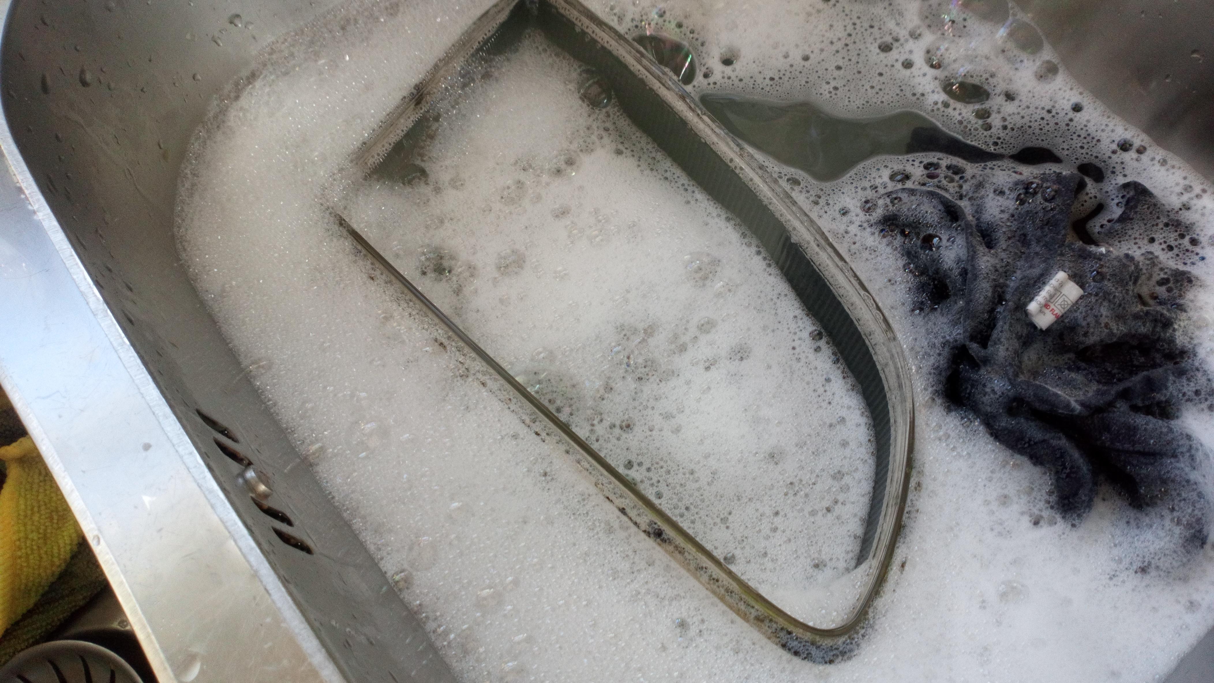

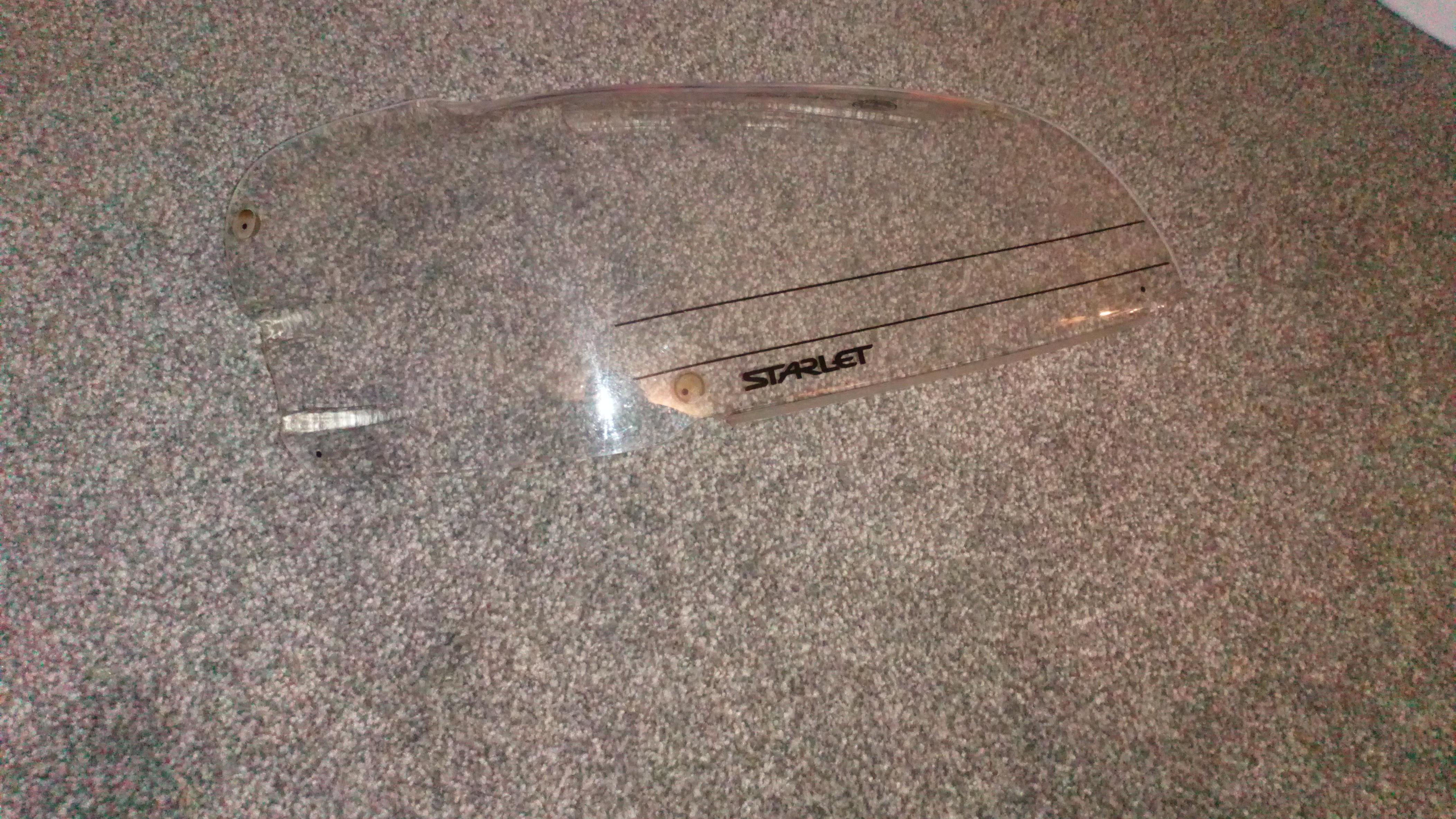

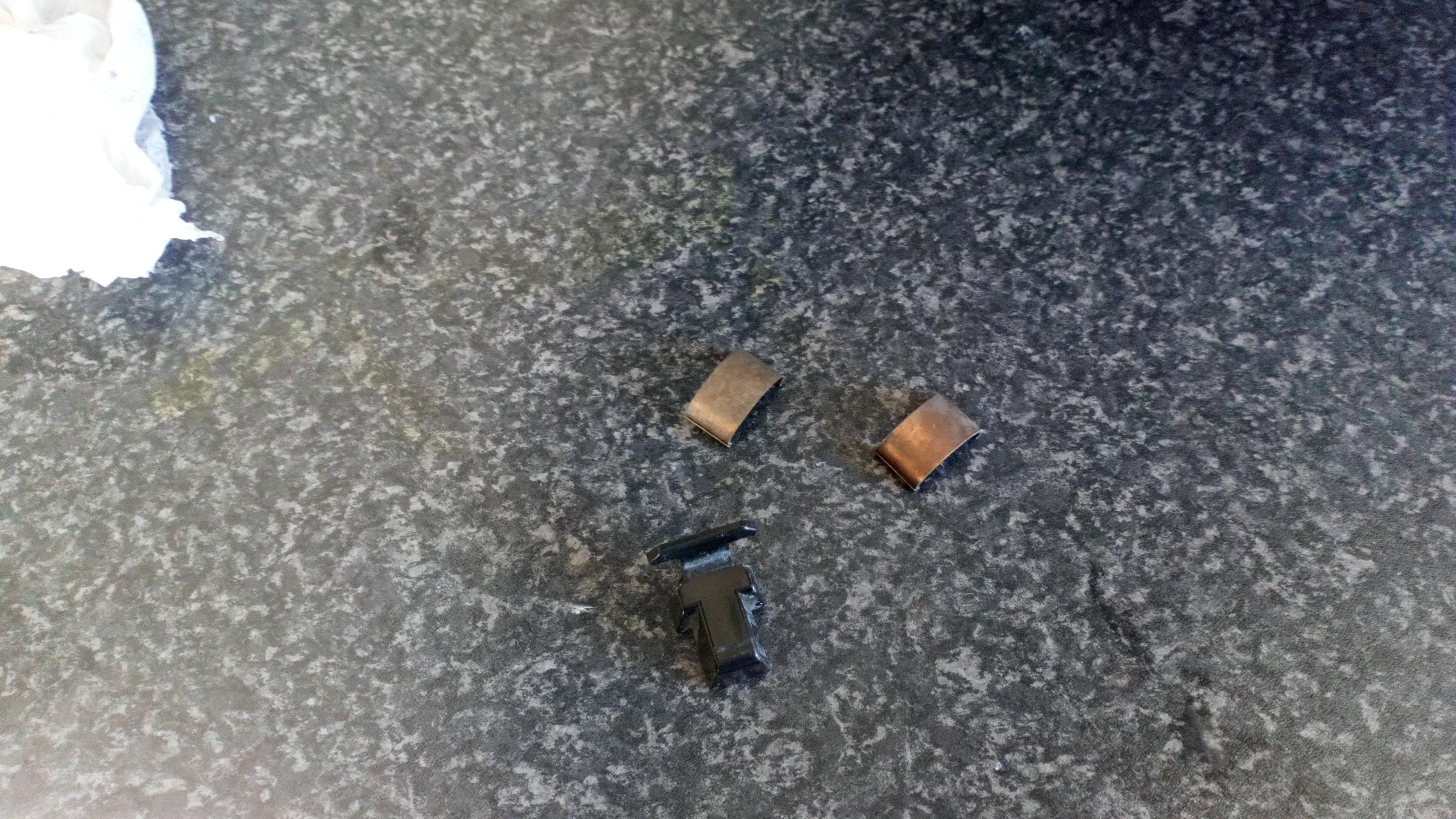

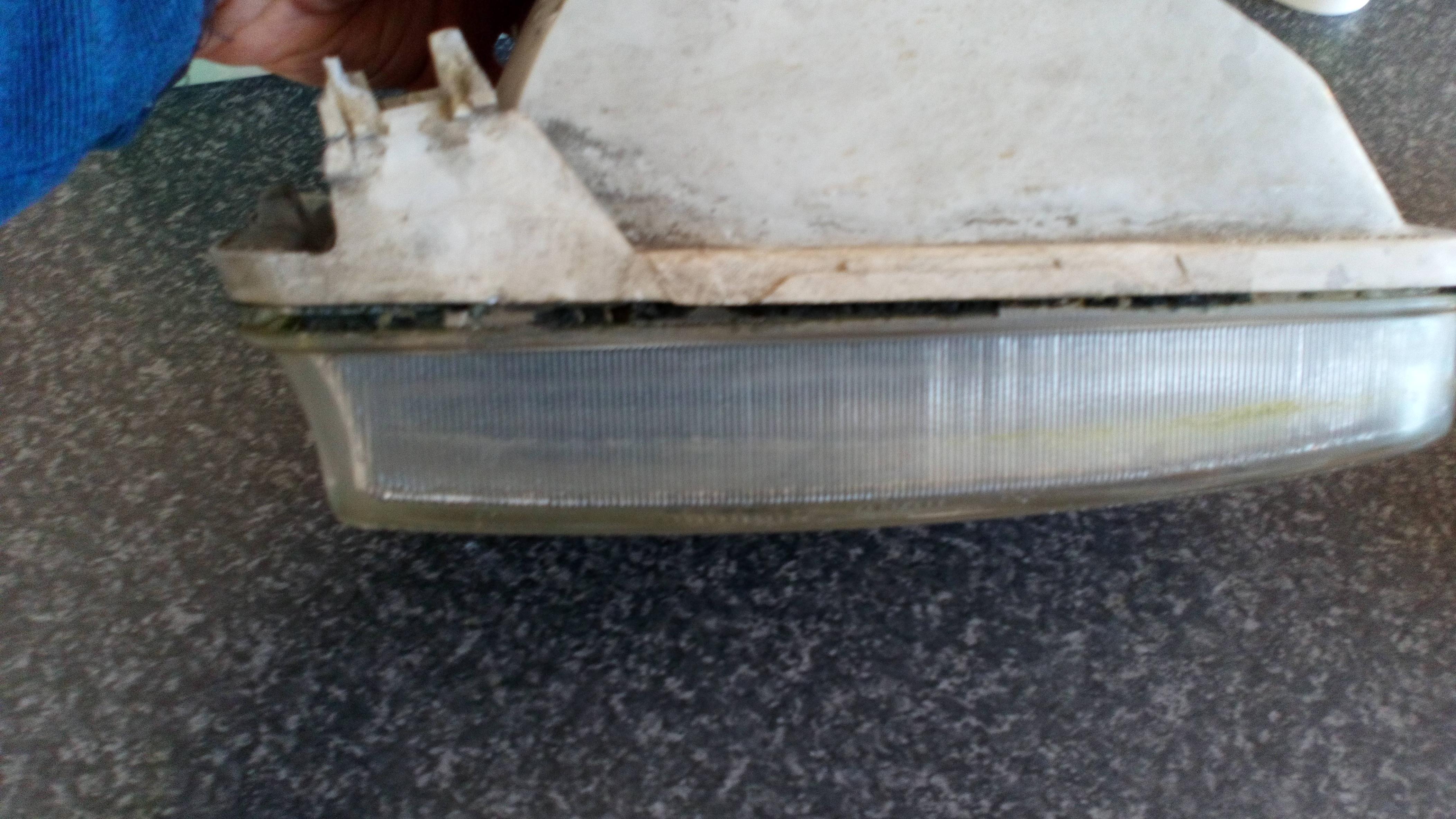

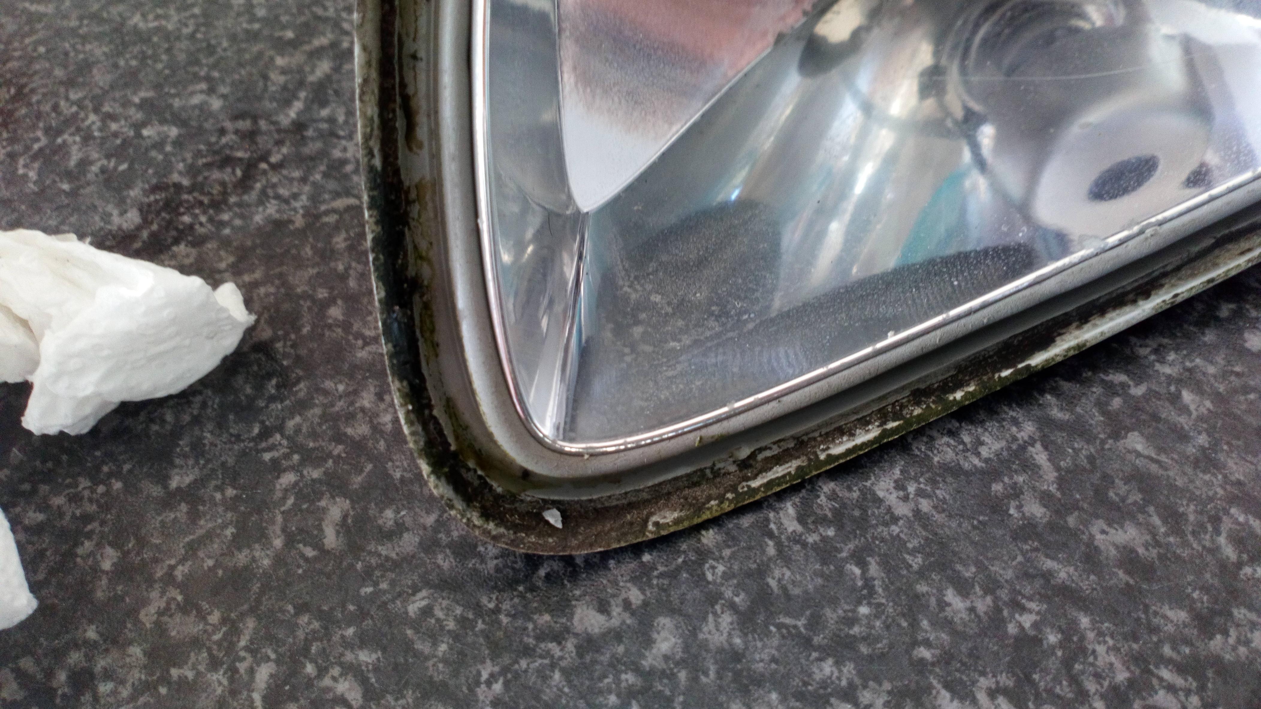

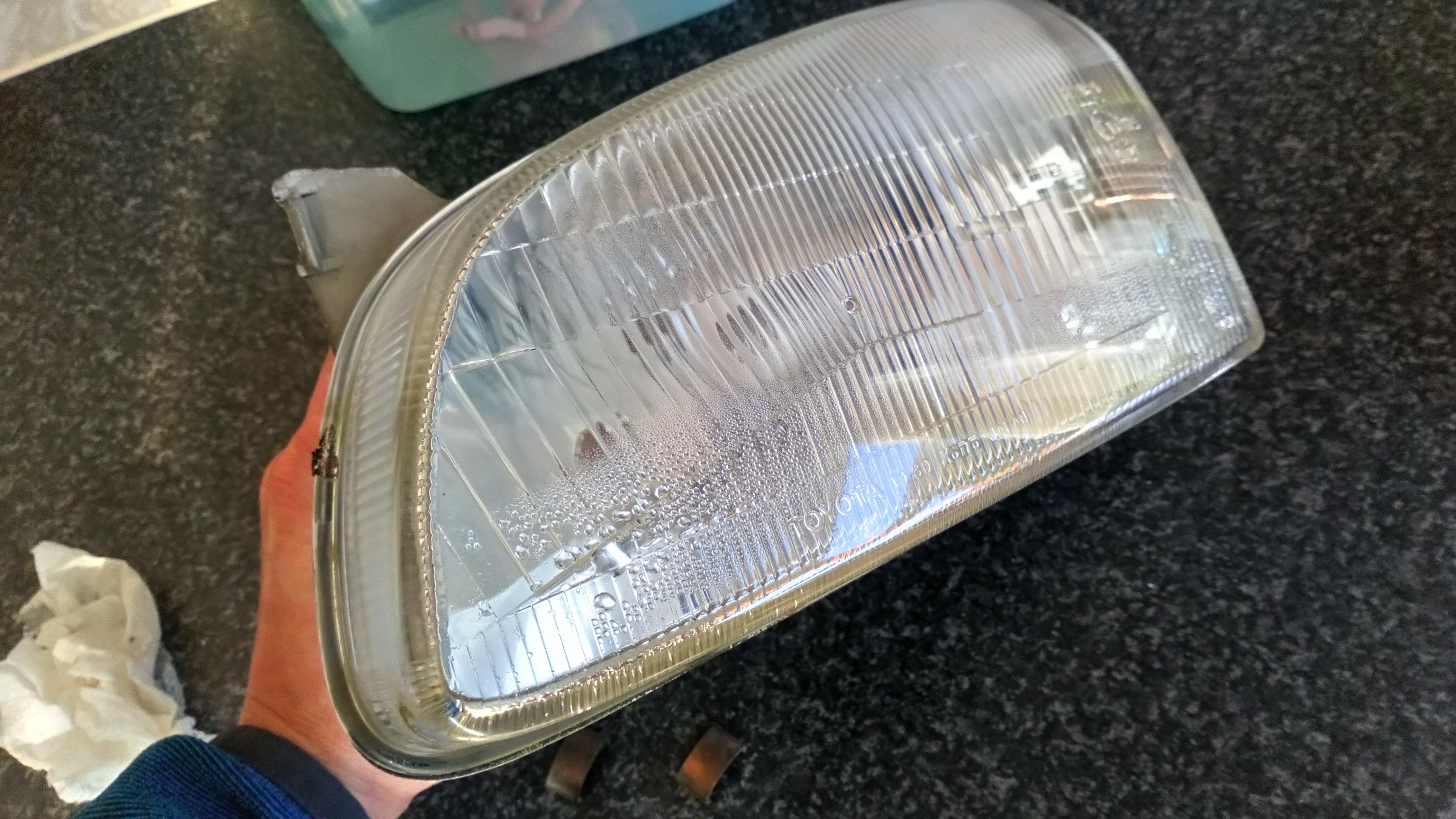

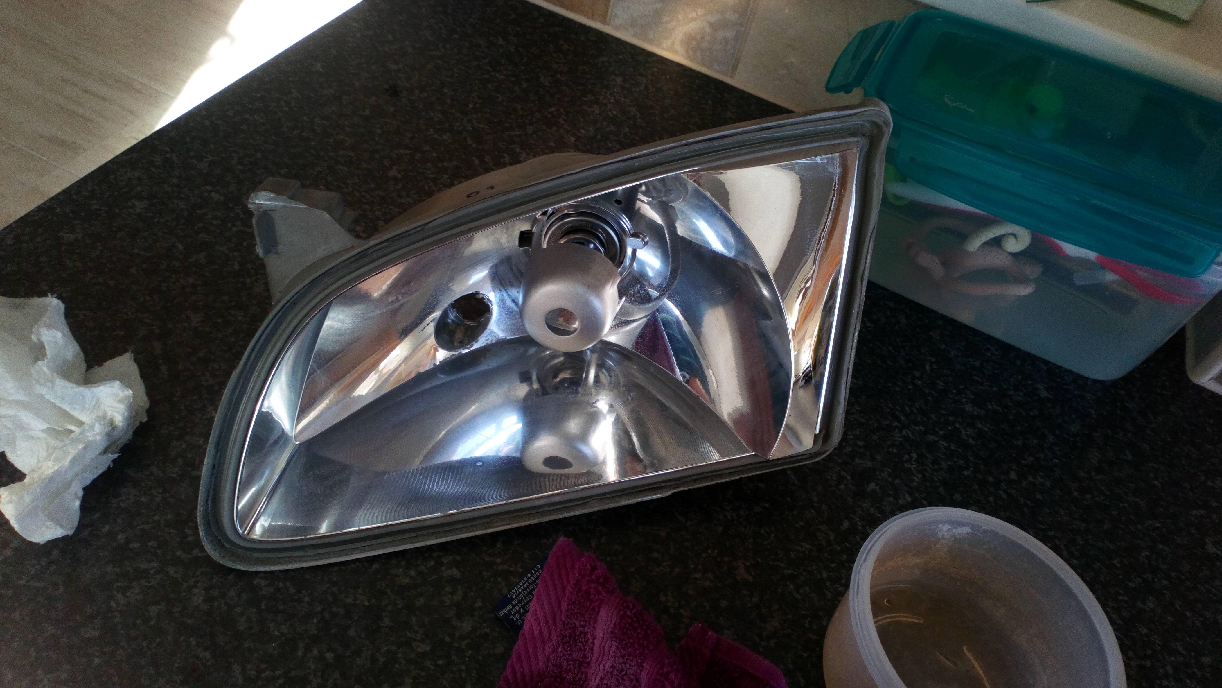

After successfully sealing the drivers side headlamp a few months ago I decided to tackle the passenger side today steps first remove indicator then reach under the headlight and push the black clip down and pull with force then repeat on the grill side you can see this clip don't be afraid of giving in decent amount of force as you pull the headlight towards you remove the two clips be carful not to chip the glass heat up with a hair dryer then split they are not sealed as such but use a rubber gasket
This time round the gasket was in a much worse state than the other so I used some sealant when I put it back together hopefully this will cure it or at least improve condensation

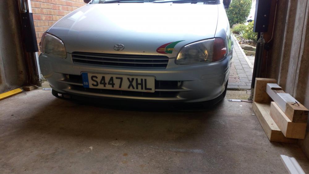

Well since its Friday and we can't go out I bought some oem optional goodies bit of a impulse buy saw them on a car on ebay rang up asking if I could buy them off him and came to a deal

1 hour ago, Pikey009 said:
Rarer than a rare thing, chuffed they will actually be on the car too
worth more than the headlight but yeah they will be going on need new rubber pads but ive measured them and sourced some replacements
Link to post
Share on other sites
42 minutes ago, Dale SR said:
Good find burty, I saw thease on the salmon pink starlet on ebay is that where you got them? There is a standerd starlet with optional fog lights on ebay however ones pretty smashed up.
That's the one mate even met me at a convenient place for me

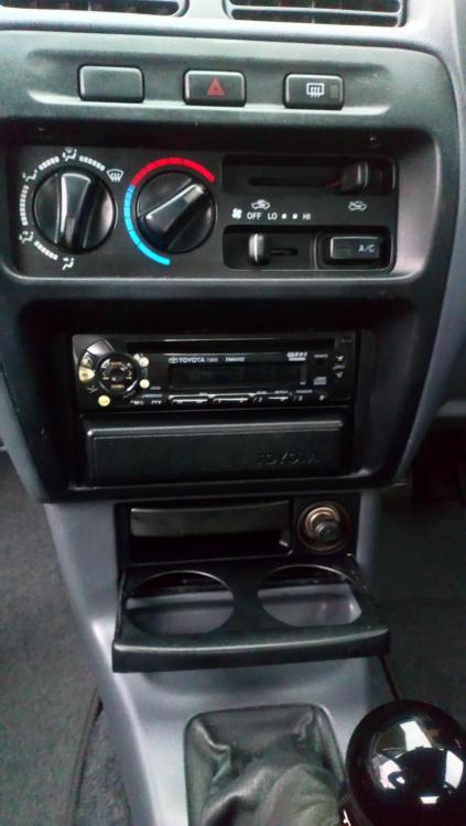

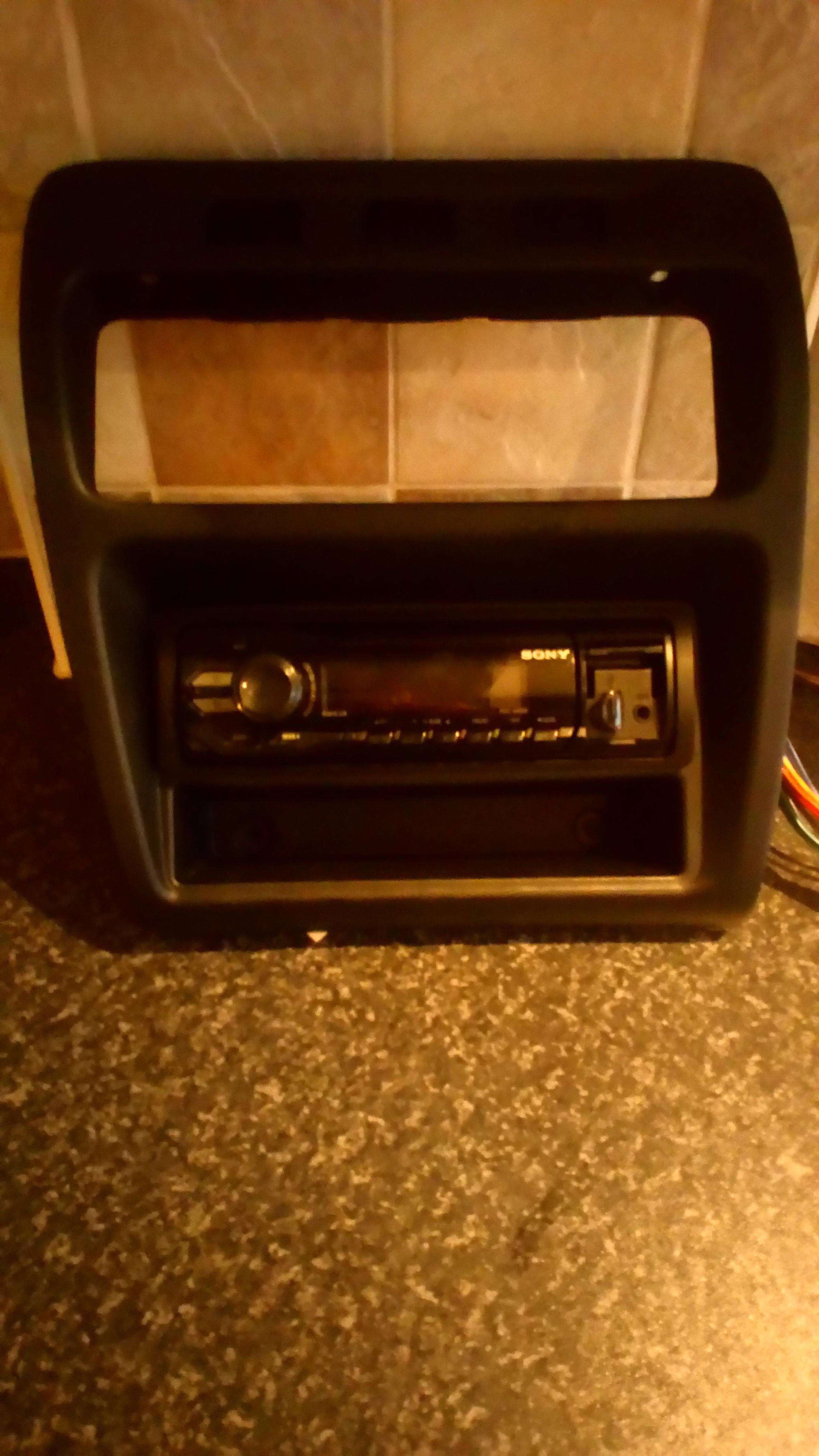

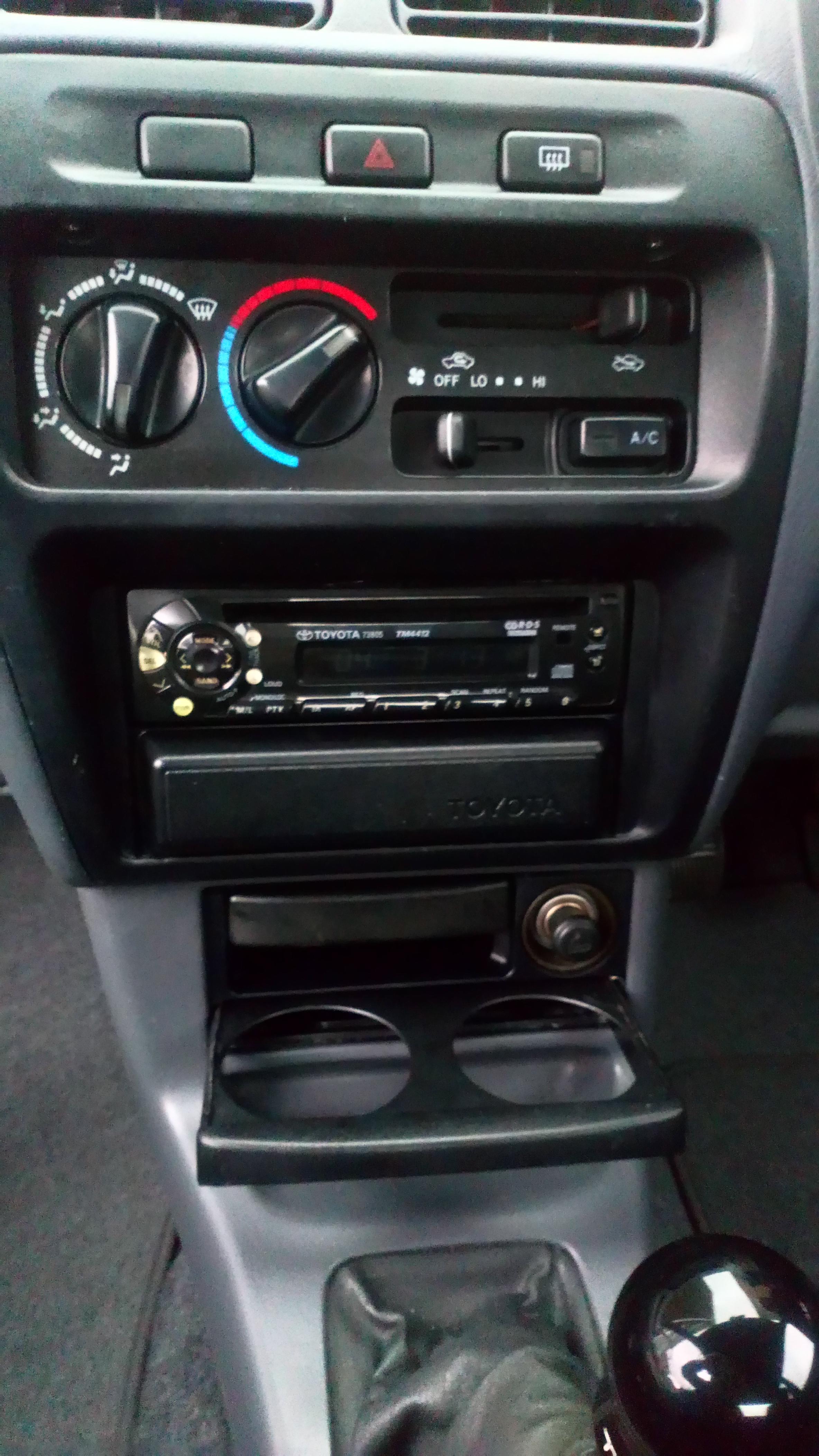

And also got my double din surround fitted with a factory toyota cd player I must say it sounds really good they are made by Panasonic must thank trevstar for this be sure to check out his build and a pic of the old one the SR's came with silver Sony ones after a certain date and are near impossible to find
Edited by burty

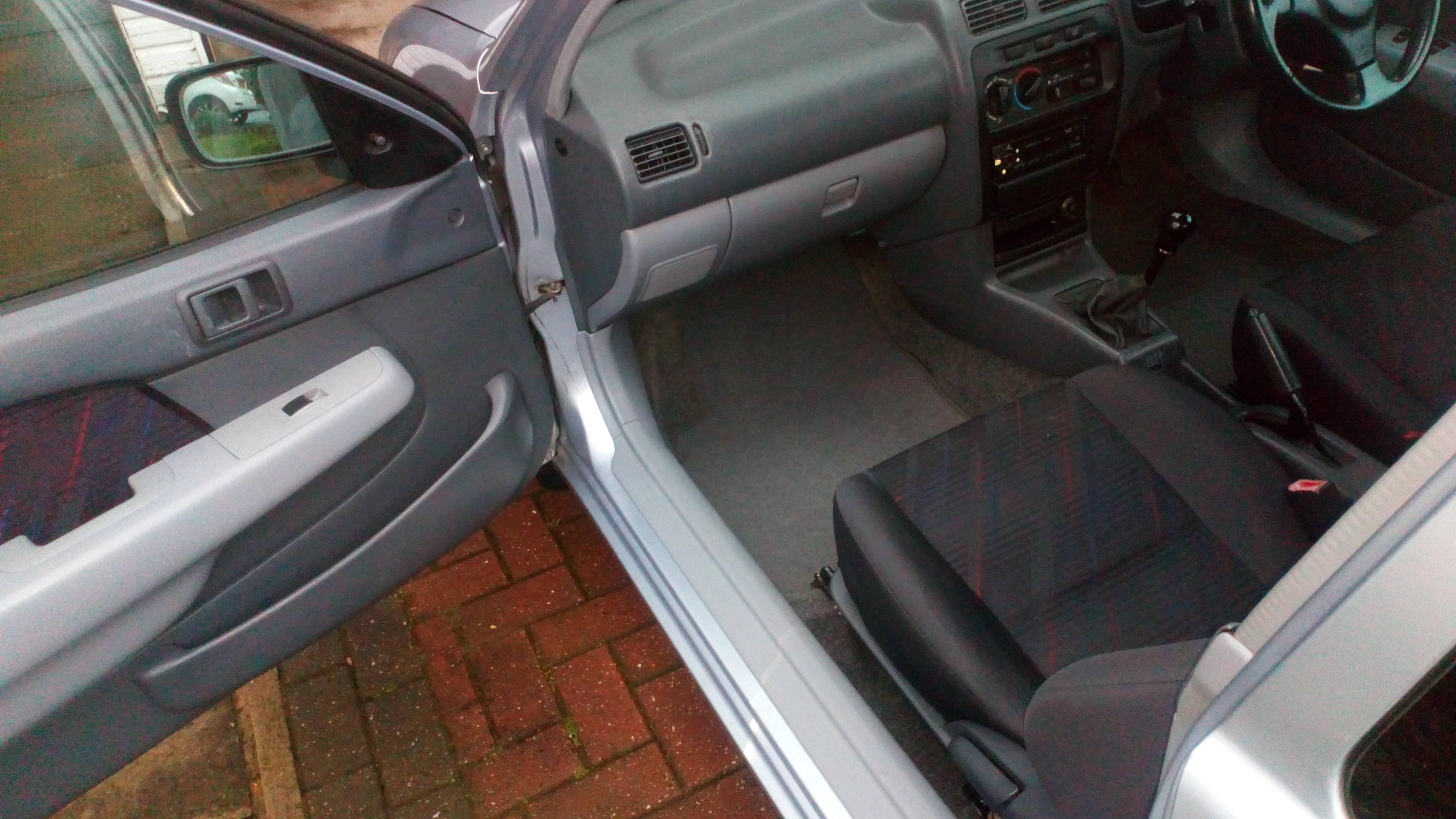

Not really a update as such but got some direct fit mats been searching for some oem ones but every set I found was in really bad condition so just went for these really good quality aswell

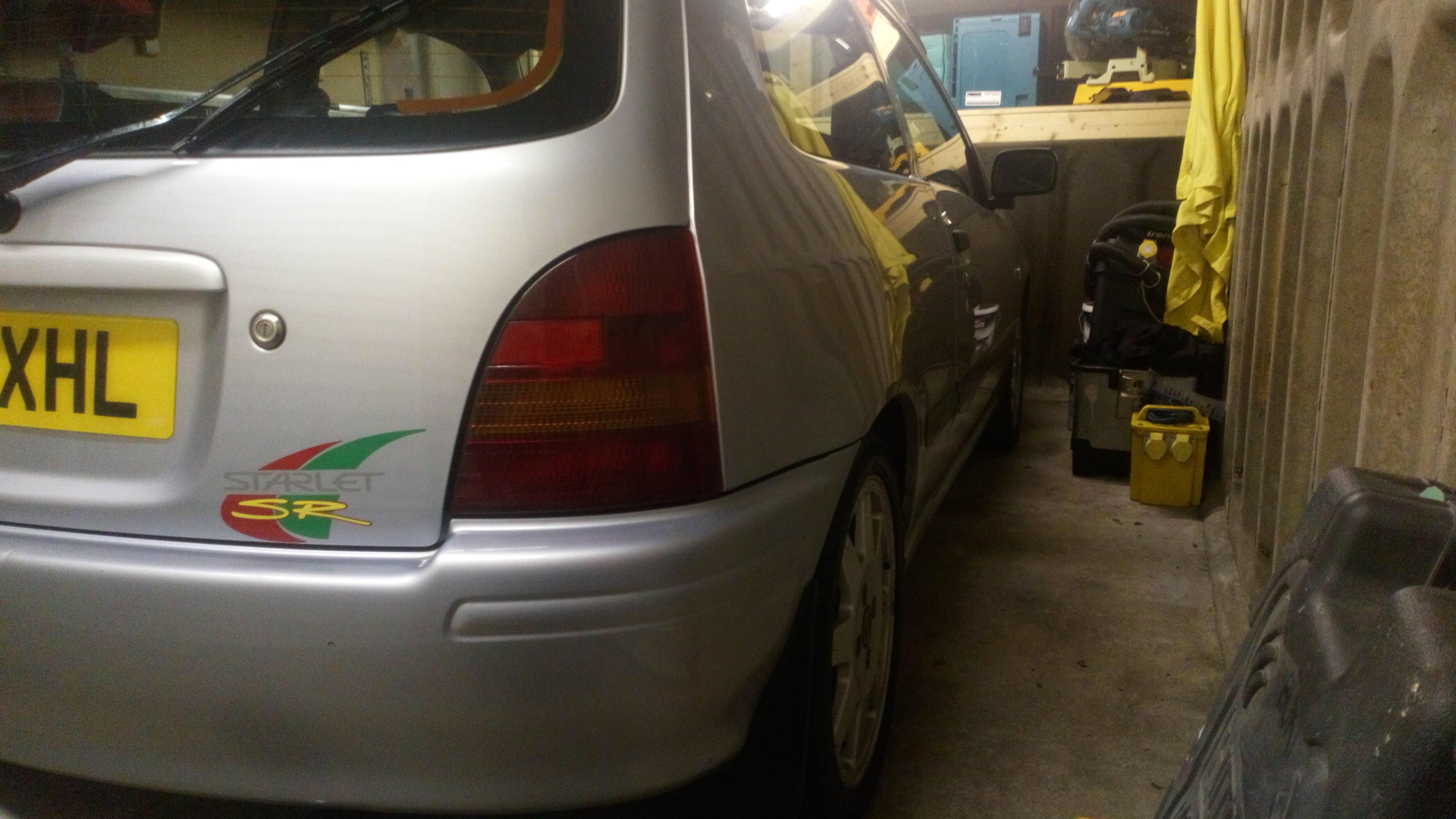

Right then big things happening starting Monday next week if you have been following this thread you will know for those of you that havent a quick recap
This was the first car I bought with my own money at 20 years old on 3500 miles always promised myself for for my 40th I'd give it a top to bottom (had it around 20years now) I've spent this year sorting the mechanicals out and the interior and if it wasn't for the lads on here I would of struggled you all know who you are!
So now its time for  bodywork
The list
New outer sills
New inner rear arches
New outer  rear arches
Full rust removed zinc primer and underseal inc all box sections treated
All rust cut out and replaced
New passenger door
All doors, rear quarters, bonnet and boot filled with rust prevention
Full respray in 1ao silver
New decals
And finally speedlines refurbished
Bodyshop want it for at least 2 months but il be taking photos all the way through of before and after progress so people can see any potential problems when it starts getting cut away
