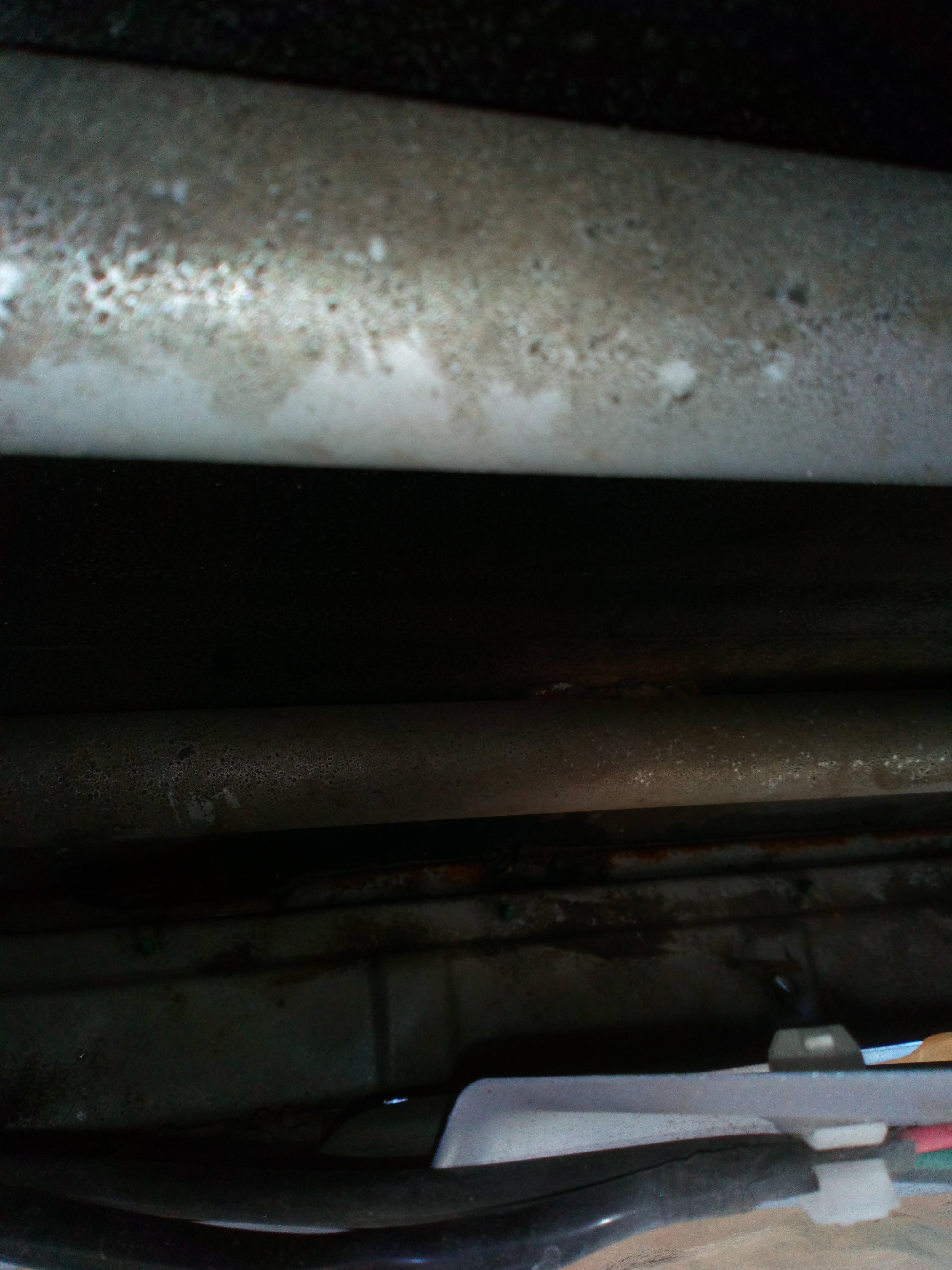

burty Posted October 20, 2020 Author Share Posted October 20, 2020 (edited) Not much of a update but earlier on in my thread I mentioned I'd have a look into why my passenger door has rusted so bad along the bottom well its hard to see in the pictures but the little drain holes were blocked and it rusted from the inside out so one to look out for lads Edited October 20, 2020 by burty Quote Link to post Share on other sites

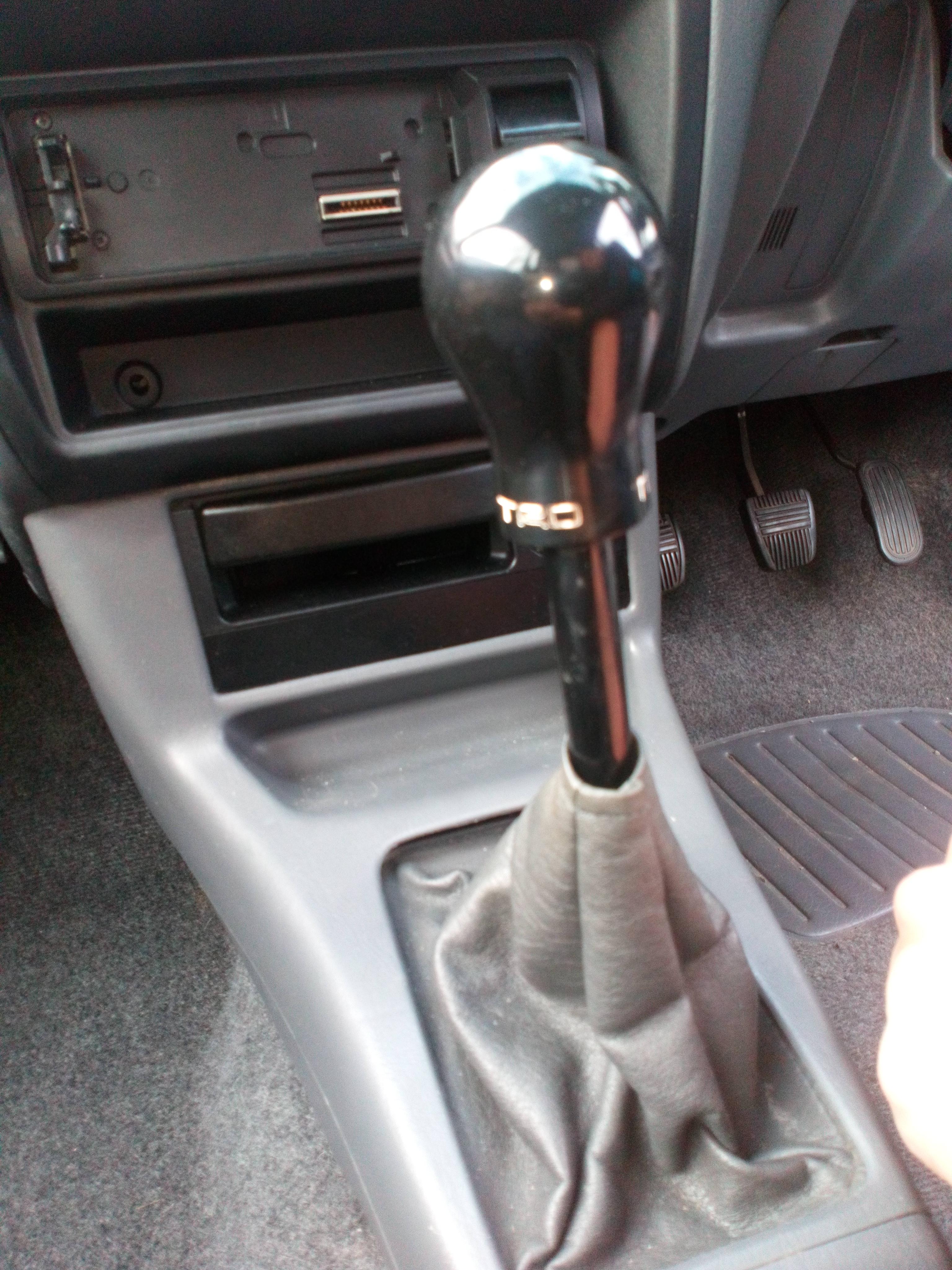

burty Posted October 20, 2020 Author Share Posted October 20, 2020 (edited) And a picture of my genuine trd gear nob now I bought the same week I picked it up pretty rare now as most bought the white one and the old interior ready to go to another members other SR Edited October 20, 2020 by burty Quote Link to post Share on other sites

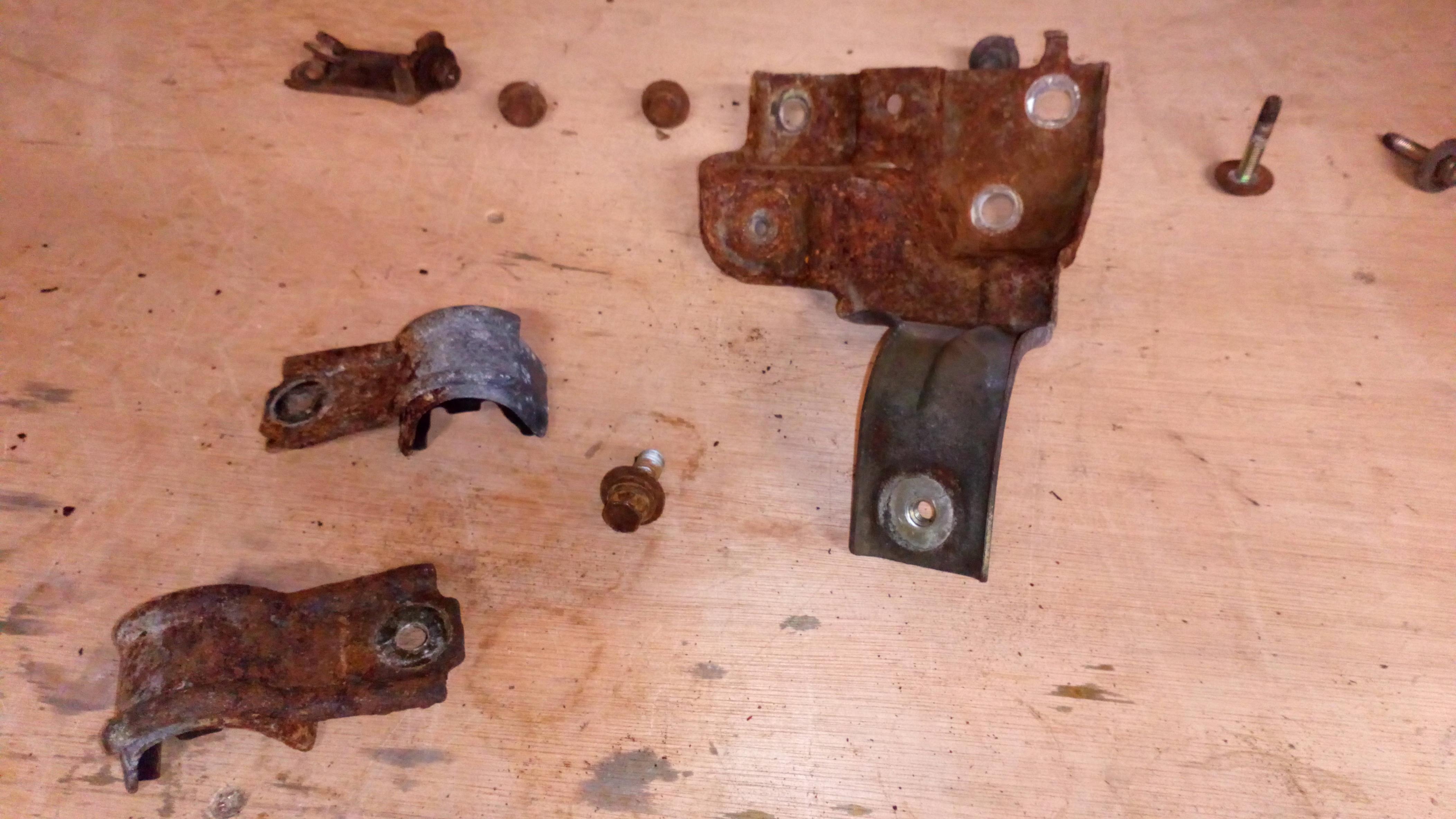

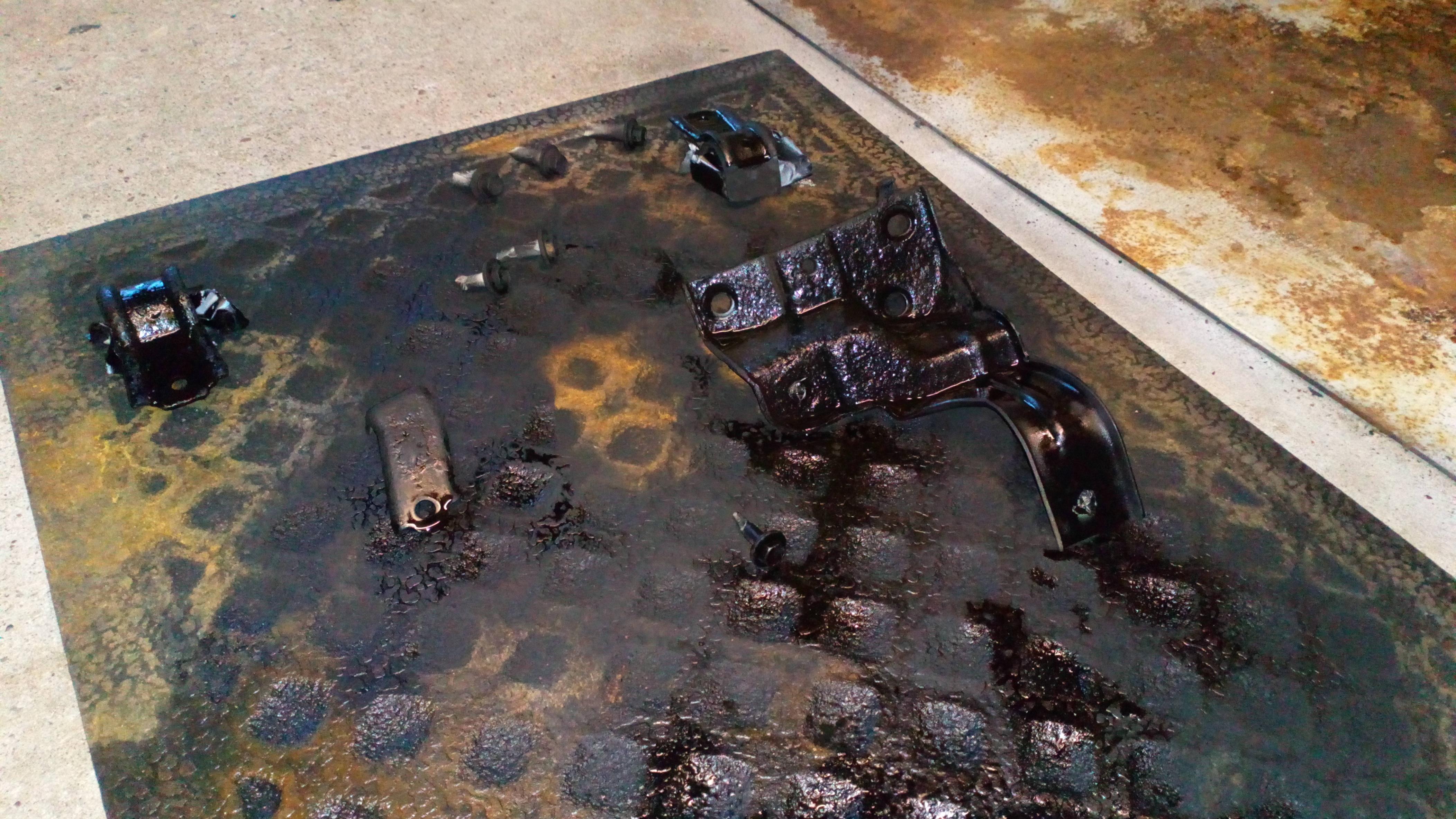

burty Posted October 23, 2020 Author Share Posted October 23, 2020 Few updates painted some rusty brackets and orded a k&n panel filter they sent the wrong one another item with the wrong fitment codes anyone else have this? Can anyone recommend a panel filter that actually fits Quote Link to post Share on other sites
Pikey009 Posted October 23, 2020 Share Posted October 23, 2020 Wow they really were crusty, have you wire wheeled them then sanded? Gives a really smooth finish. Scotch bright is also really good. Don’t bother with a panel filter, no gains available what so ever. Quote Link to post Share on other sites
burty Posted October 23, 2020 Author Share Posted October 23, 2020 (edited) 1 hour ago, Pikey009 said: Wow they really were crusty, have you wire wheeled them then sanded? Gives a really smooth finish. Scotch bright is also really good. Don’t bother with a panel filter, no gains available what so ever. I've sanded the ones you can see mate not perfect but much better just took the bulk off the big bracket removed the rust and used converter to stop it getting worse it's under the airfilter box so it wil stop it in its tracks, they was really bad the bracket it discontinued now aswell il be making a list of all bolts that need replacing and brackets if cheap enough amazing leaving a car stood for a few years how much rust can set in Edited October 23, 2020 by burty Quote Link to post Share on other sites
Pikey009 Posted October 24, 2020 Share Posted October 24, 2020 Yeah moisture would just occur in the same place over time and really have a go at things. Since mines been in the heated workshop though it’s got loads better even on its own accord or a quick wipe and all the surface stuff comes off. Rather than getting new bolts, try sending them to get zinc plated. Not that expensive and great results. Once mines driving around I’ll be sending most of my engine bay bolts away. Quote Link to post Share on other sites

burty Posted October 25, 2020 Author Share Posted October 25, 2020 Yeah I removed the door cards and had a really good look inside seems somehow mud/moss was in there so i assume is got through the window seals (I have a replacement anyway from the new door so il use that as a precaution) it's only a five min job to pop off the cards so well worth checking progress has been slow this month but I'm having a full weekend on it next week Quote Link to post Share on other sites

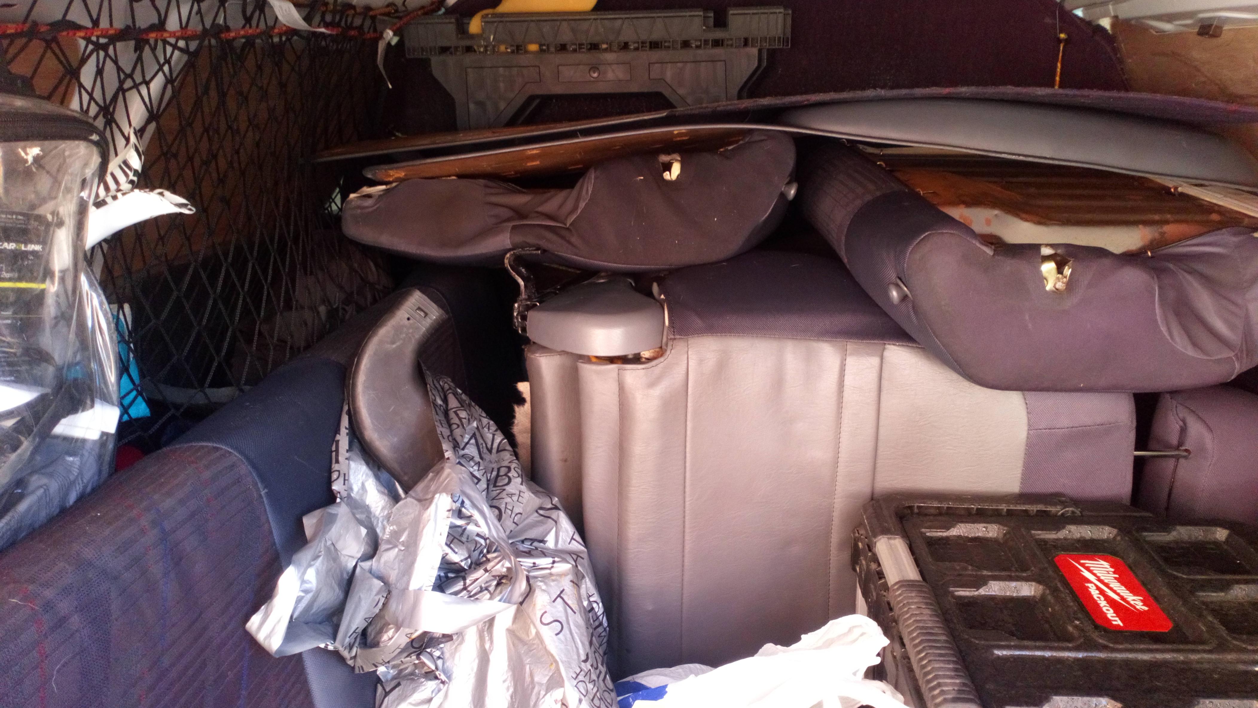

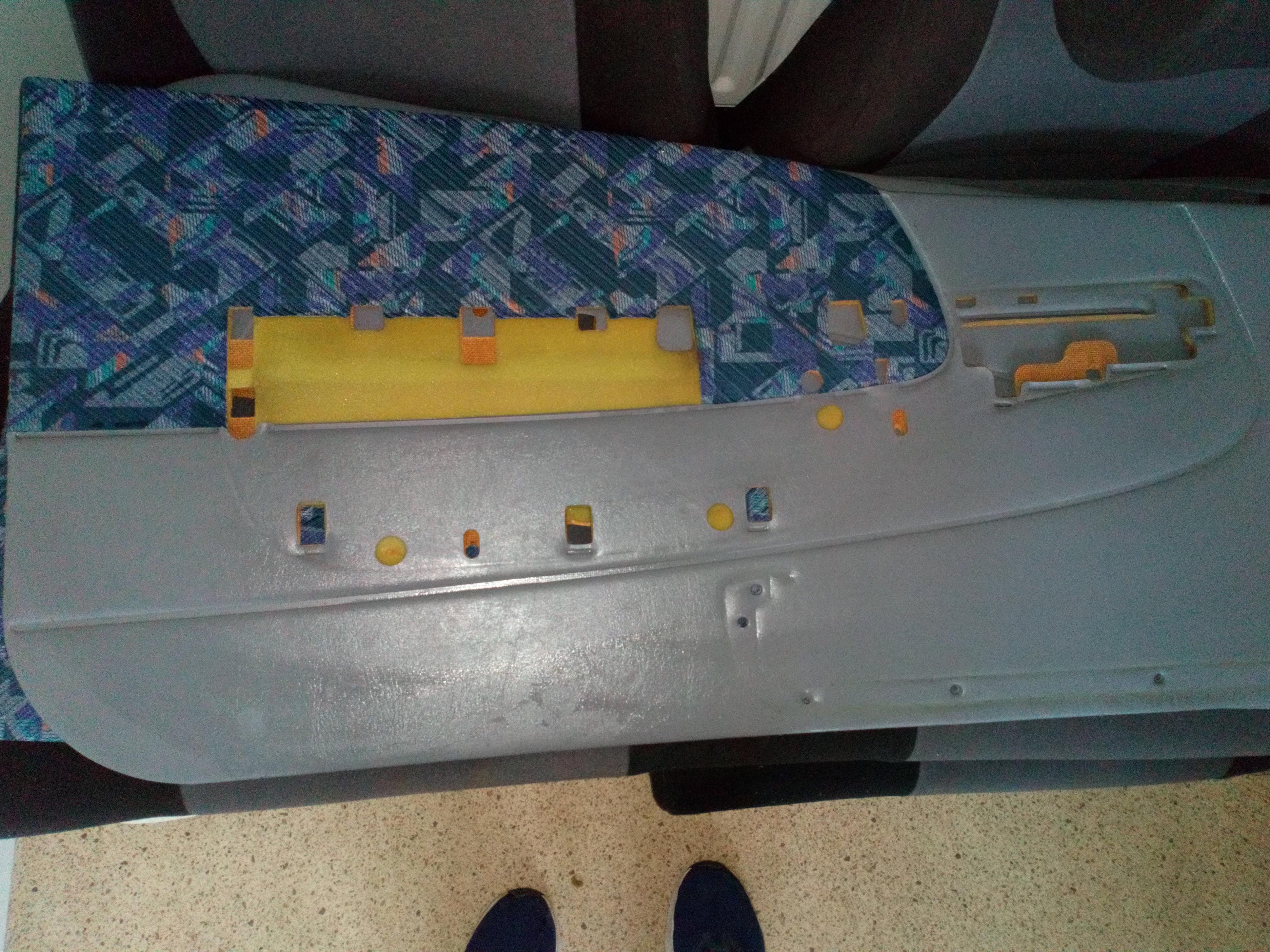

burty Posted October 31, 2020 Author Share Posted October 31, 2020 2 hours ago, stevie82 said: What did u get mate can’t really see from the pic ? Full 98 spec interior Inc door cards on custom lowered rails out of pikeys old sr that trav replaced with optional recaros black leather 98 spec wheel oem toyota cd player 5efe air filter inlet and a hks panel filter il post pics up soon it was a 7 hour round trip including a chat so couldn't be arsed to empty van put it straight in garage Quote Link to post Share on other sites
