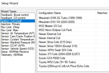

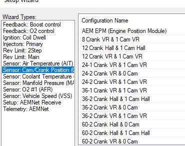

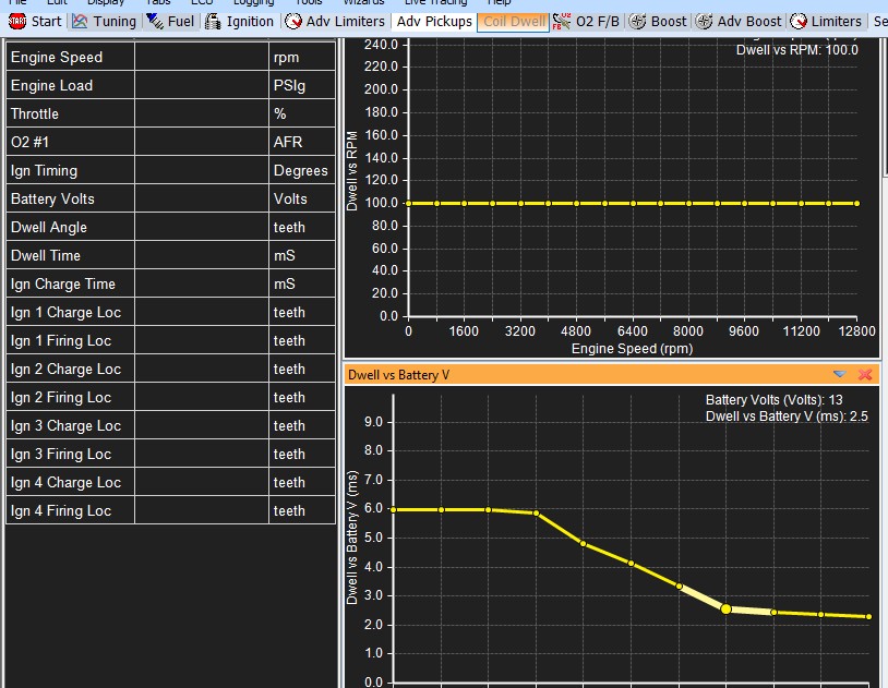

gibby1980 Posted August 5, 2021 Author Posted August 5, 2021 Hi all, I got this working finally. I changed my Dizzy, used the 24-1 Crank and Cam pickup, and lowered the coil dwell from 3ms to 2.5 ms(got that on a supra forum). While I had these settings in place earlier I was advised the dizzy might be going bad so hence the switch. The car is running much smoother and the issues seen before are now gone. I still have more work to do as I have the boost solenoid connected to the ems-4 and have the boost governed by rpm currently. Ideally I'll like to switch this to boost by speed. Quote
