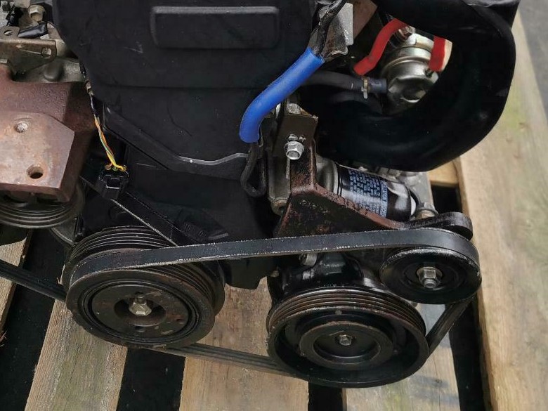

Continuing the theme of Weird ass 4efte / not a 4efte bitsa engines!?
https://www.ebay.co.uk/itm/374042202483?epid=652485202&hash=item5716a71173:g:JjEAAOSw2ypiZ6DI
Doesn't look too bad until you get to the PAS bracket "mod" to keep A/C and delete the pas pump, 4efe dizzy, coil, 2 plug 4efe ECU (other 2 ECU loom plugs appear to have been cut off and replaced with piggy back plug connections), forward facing thermostat cap from an auto?!
Think I'll pass on that :lol:
You could get a 4efte without PAS and with AC very weird option but it was available as its shown on the EPC and they are factory parts.

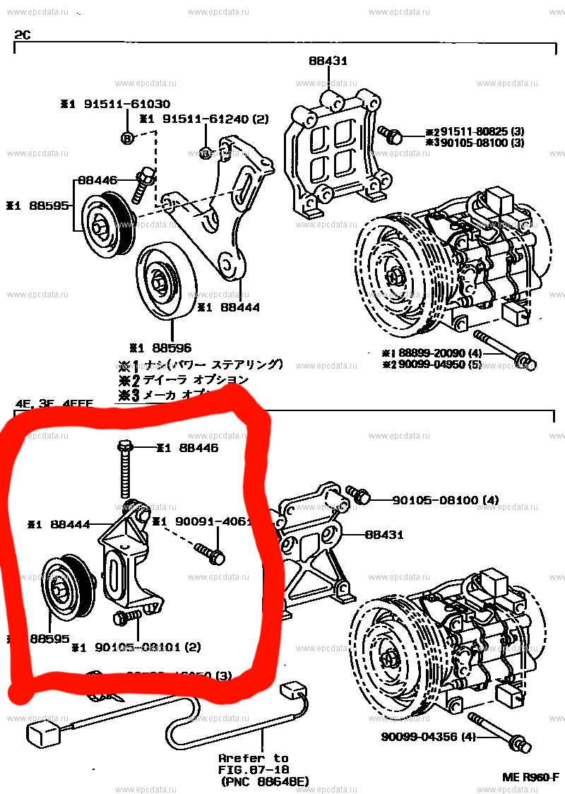

Nice one,
Found this in the EPC :
Can't find the parts page for the idler setup though, do you have a link?
Looks like a 'mare to adjust, do you just pull to tension or is it sprung loaded or eccentric bolt?

On 5/3/2022 at 8:55 AM, Claymore said:
Nice one,
It's a adjuster bolt that pulls the idler pulley upwards to tension the belt. Sadly the parts are discontinued as strangely I'd like to run this setup to keep AC but go electric power steering to get the air filter behind the drivers headlight.

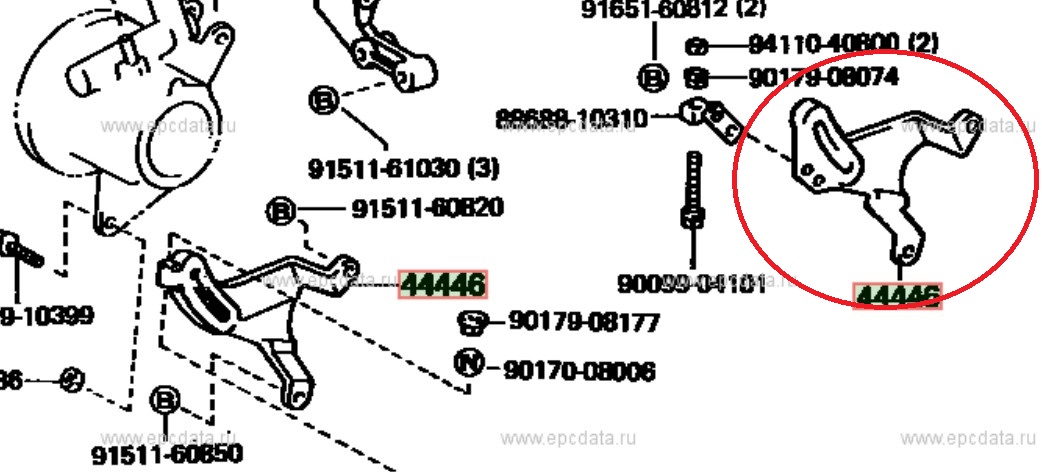

I did find that diagram in the EP91 4efte EPC https://toyota.epc-data.com/starlet/ep91/61052/electric/8719/88444/ but when you click on it the site said it was not compatible with the vehicle.
Checked the EP82 and it is listed but as you say NLA from the dealer.
However, when you look at the engine for sale in the eBay ad it doesn't look like the bracket above. It looks to me like an EP82 PAS lower adjuster bracket with an idler pulley bolted through. Not a vertical sliding pulley bracket with separate tensioner bolt.
I can't seem to find this setup in the Toyota EPC. Doesn't really matter I guess.
Think your right mate the more I look at it that is a home made effort and not the factory part.
I'd love to find the factory one but it must have been such a rare setup.
