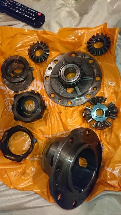

RoyalDutchie Posted January 10 Author Share Posted January 10 (edited) Small update. Recently got a set of wind deflectors in good condition with all the clips to complete the glanza once I get it back. After 4 weeks I visited the car this weekend to check on the oil leaks I have. Found 3 which 2 where known all seem to be around the sump so needs to be resealed since the rear seal is already replaced. The front seal will be replaced together with the timing belt once I get the car back. The oil stain on the bottom is from leaking grease of the chassis. Removed the catch can from the car to make a second revision of it with new internals soon to go in. Few parts had a bit of a reaction due to the sealant etc nothing too bad though since the oil prevents rust and galvanic corrosion. The PVC fuel line did go milky and was already losing it flexibility so a different type of hose may be used in the next revision. Also the liquid gasket didn't bond with the bottom half of the catch can so next time a bit more scorching is needed. Cracked on with disassembling a Helical LSD for the MR2 etc. Tried to open in by removing the screws but it seems to be held in by something so if anyone knows how to separate the 2 parts please let me know. I want to inspect the worm gears etc. Edited January 10 by RoyalDutchie Quote Link to post Share on other sites
