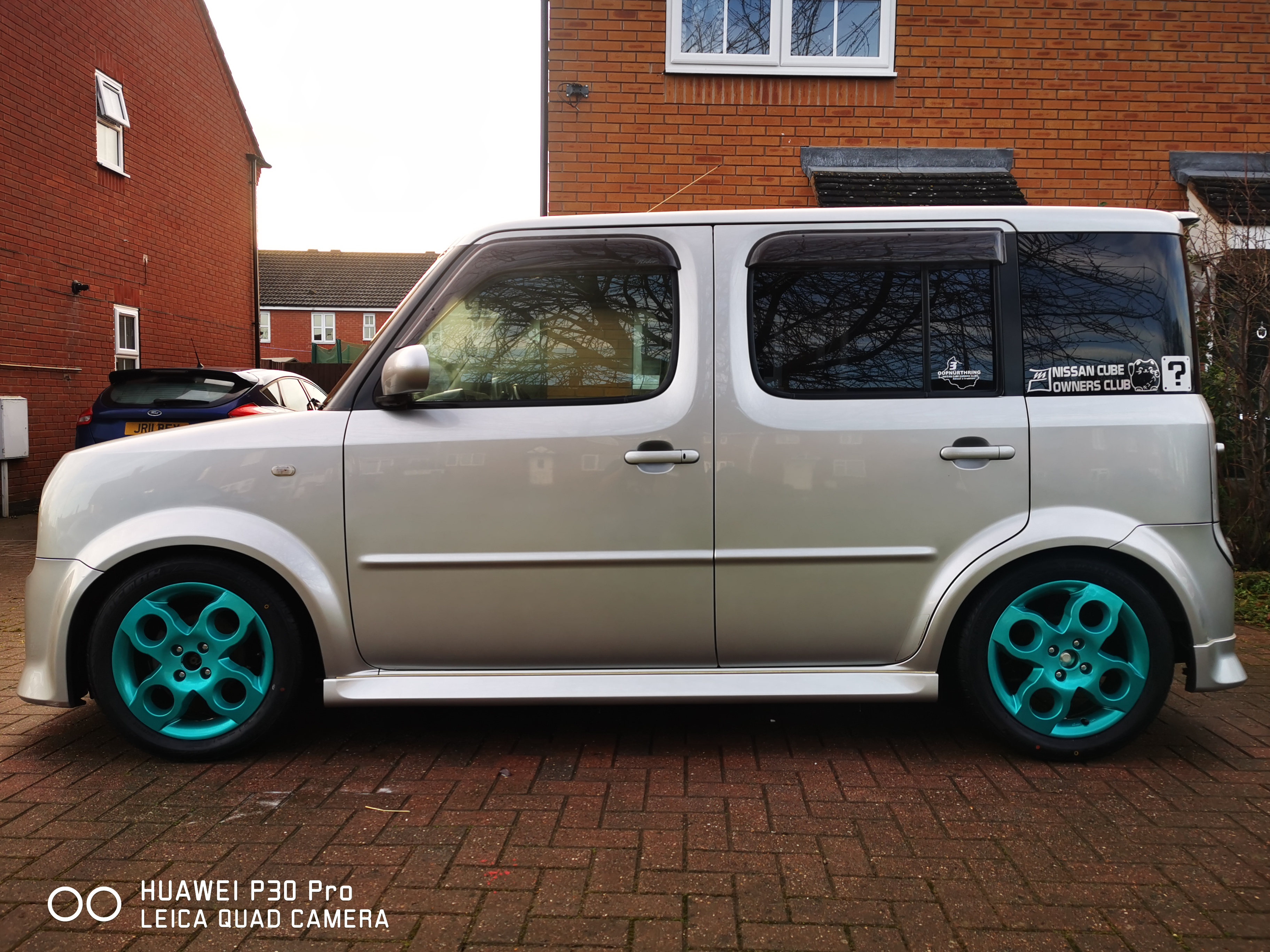

Haha yeah, neighbours all love German diesel rubish. My other car is a Nissan cube I imported a few years back. My first car was German (mk 2 jetta) but I have zero interest in the VAG scene or any other German makes.
Interested in the cube any pics of it seen some very tasty modified ones
Not overly modified as it's my daily/family car but they're cracking motors.

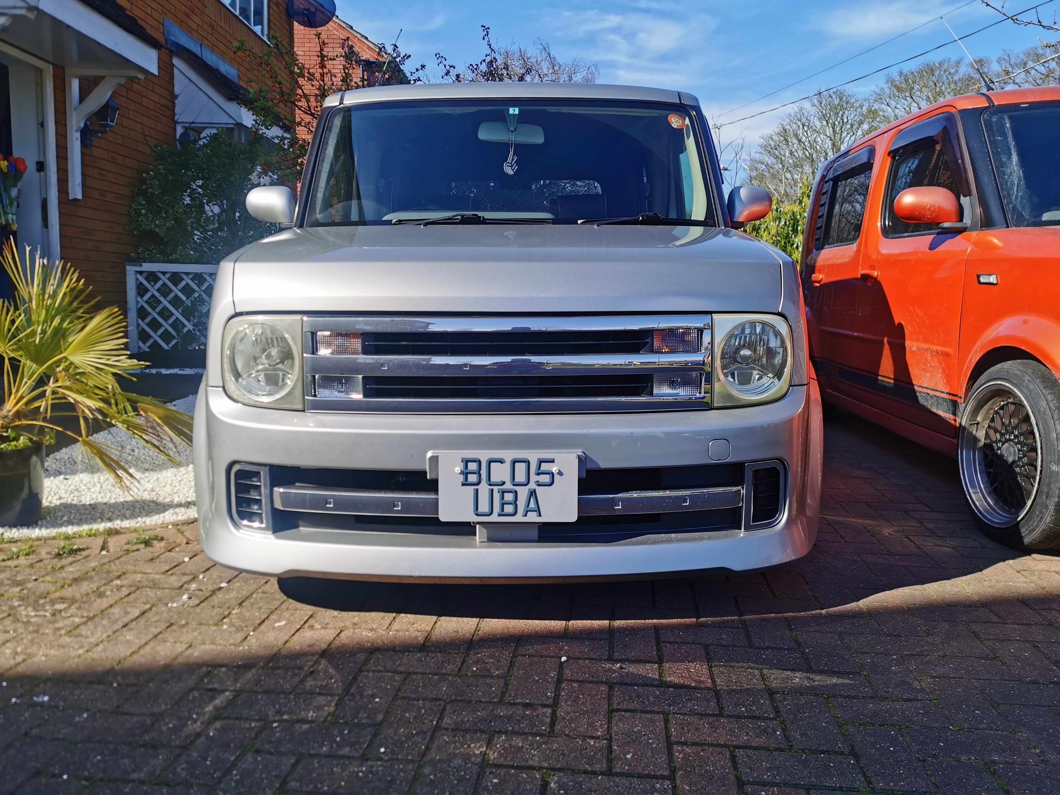

The orange one had to go to make room for the starlet
IMG_20201010_113411.thumb.jpg.dc55bf7ed147257b0fdc4896592370fa.jpg 2.15 MB · 0 downloads
Looks great that I have a proper soft spot for em and the suzuki alto works, starlet looking mighty fine aswell

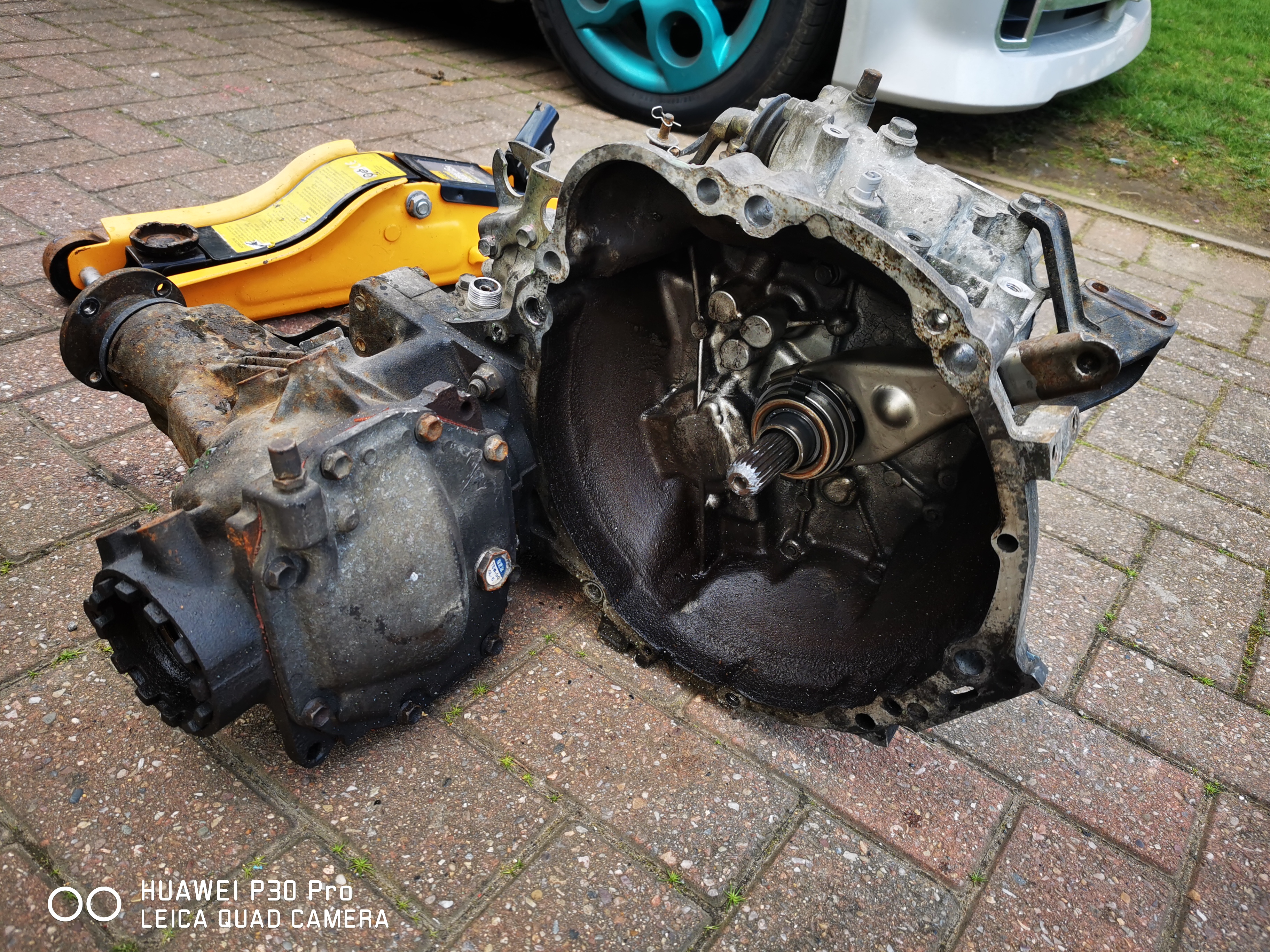

So a bit more progress, or not....

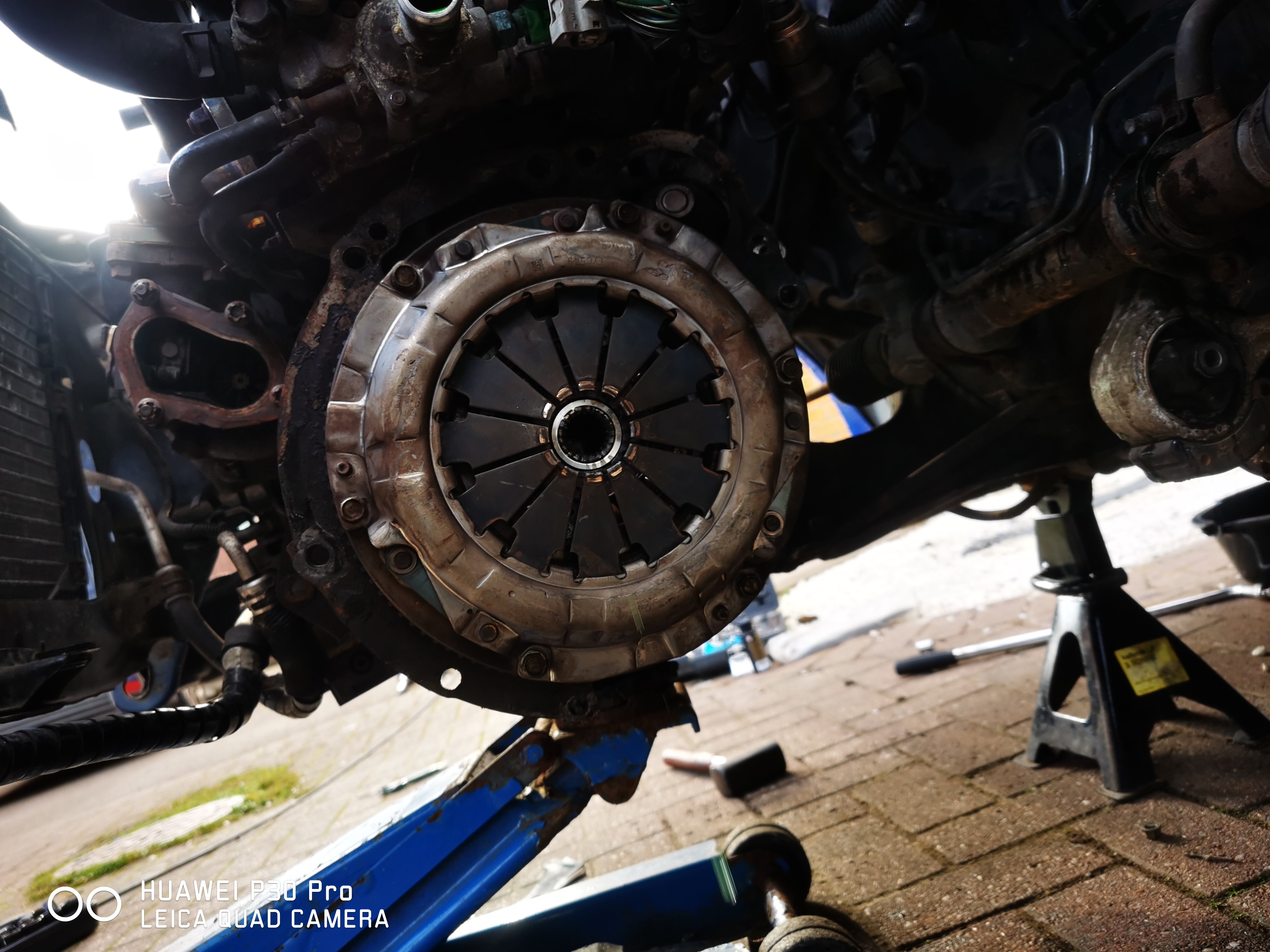

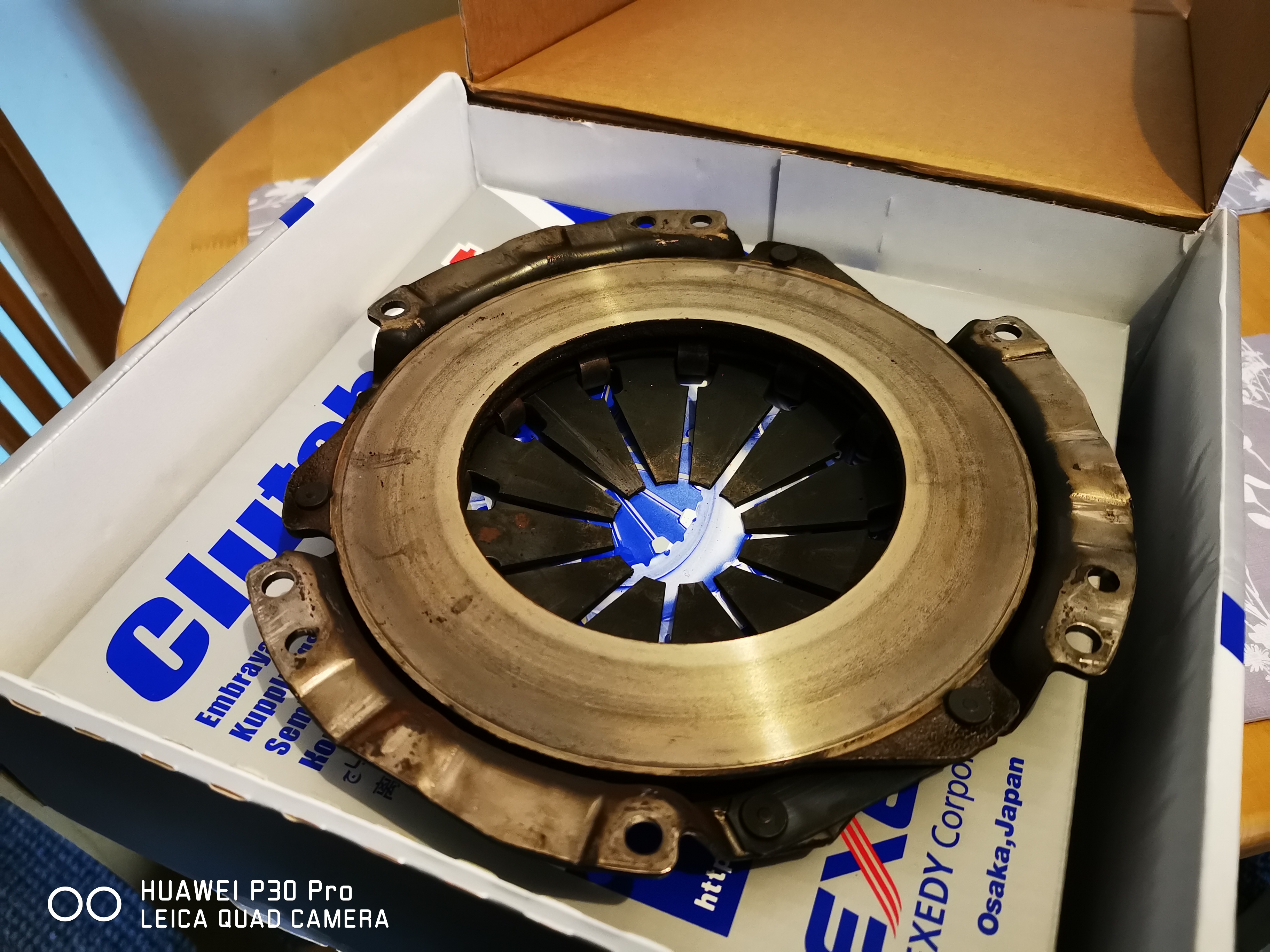

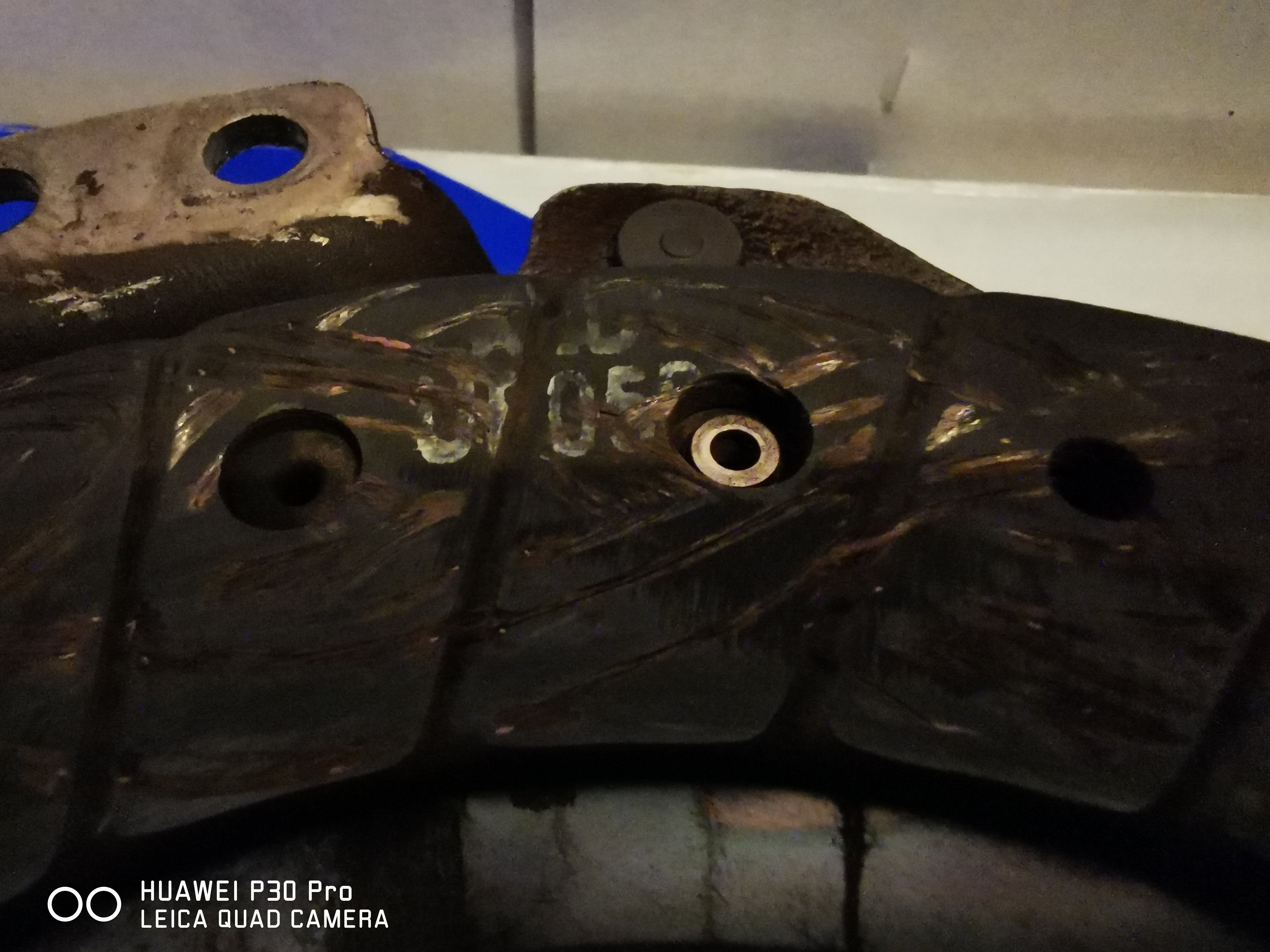

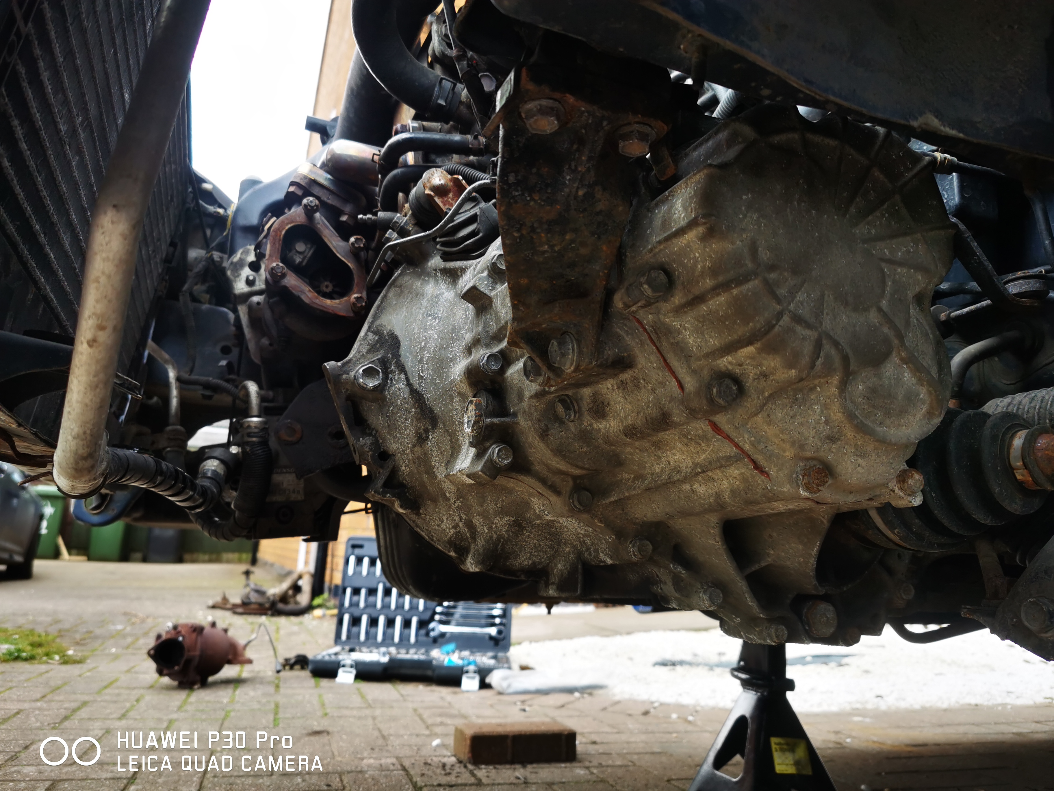

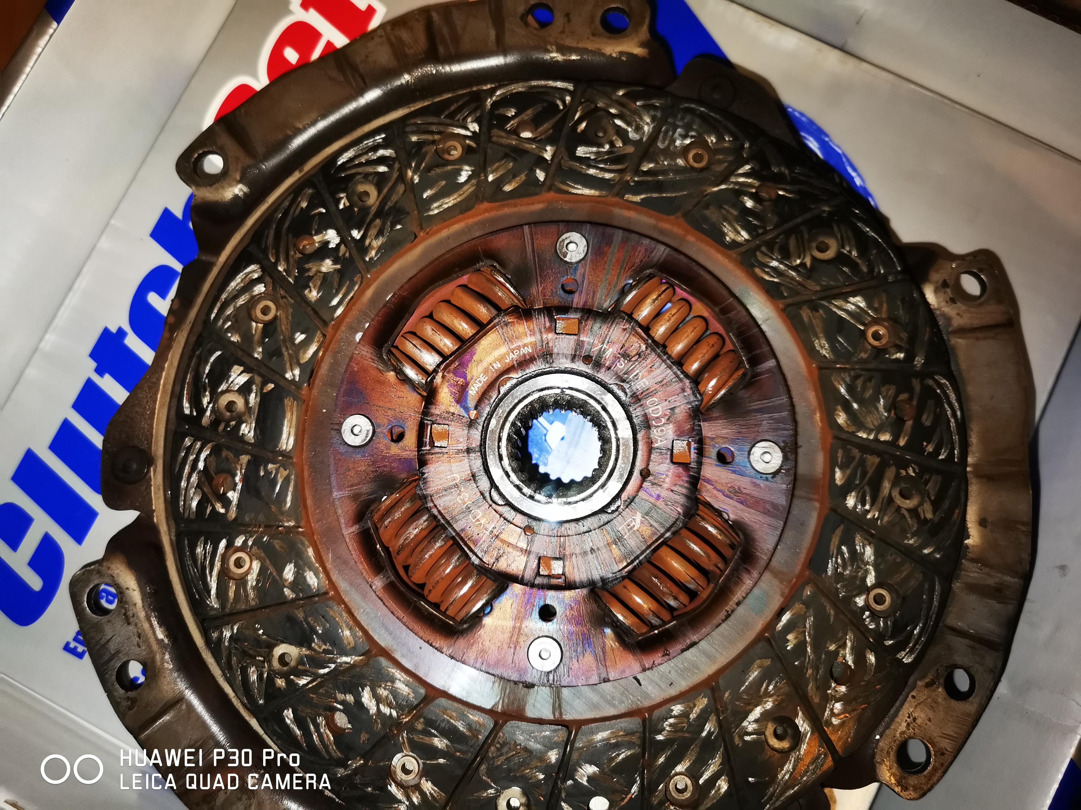

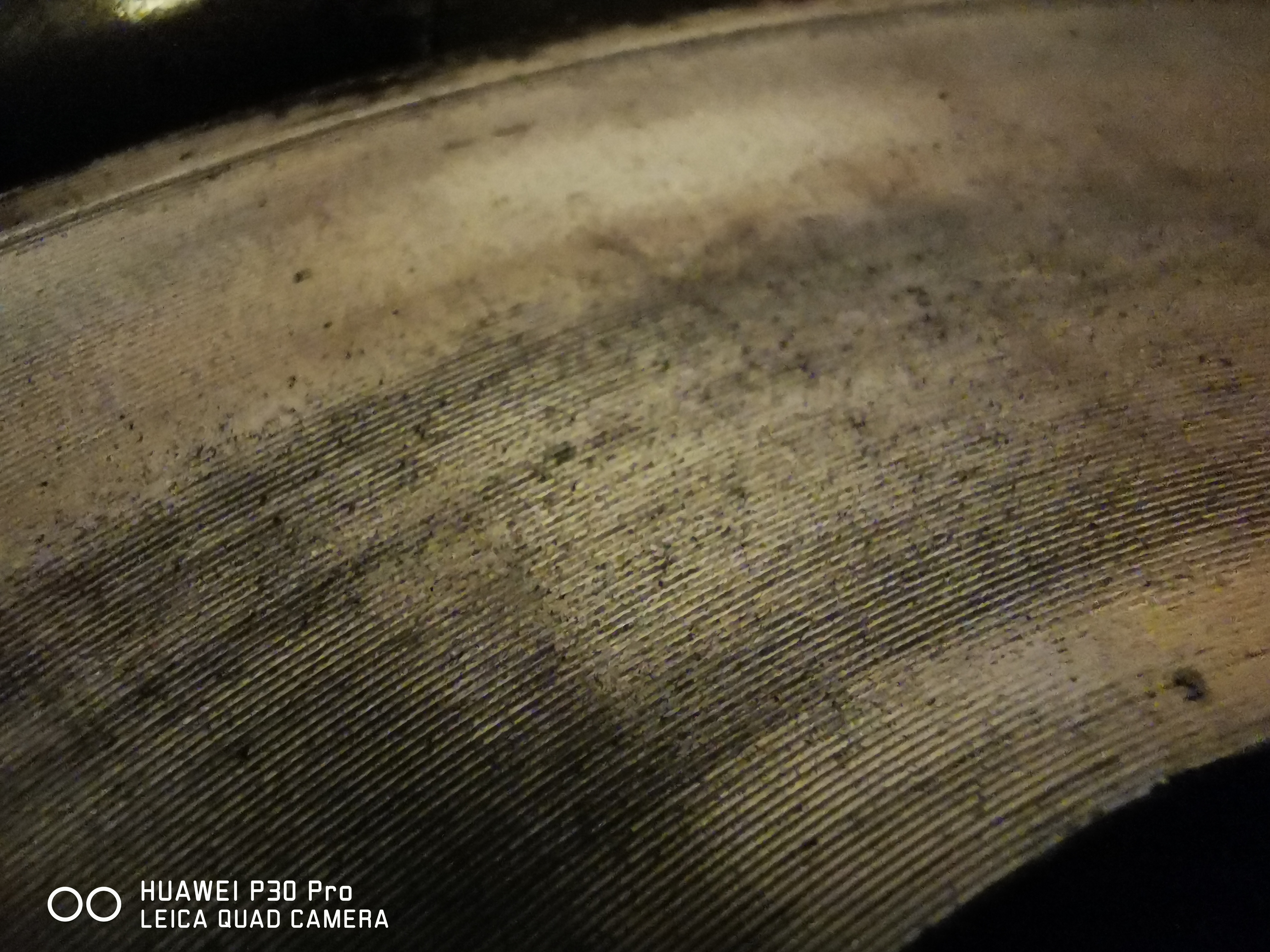

When I imported the starlet, my importer told me that in his opinion it felt like it needed a new clutch in the not too distant future. So that was today's job
Unfortunately it seems like a wasted day, as the clutch I removed looks brand new. Still at least I know now, and I've learnt how to change a clutch as its a job I've never tackled before.

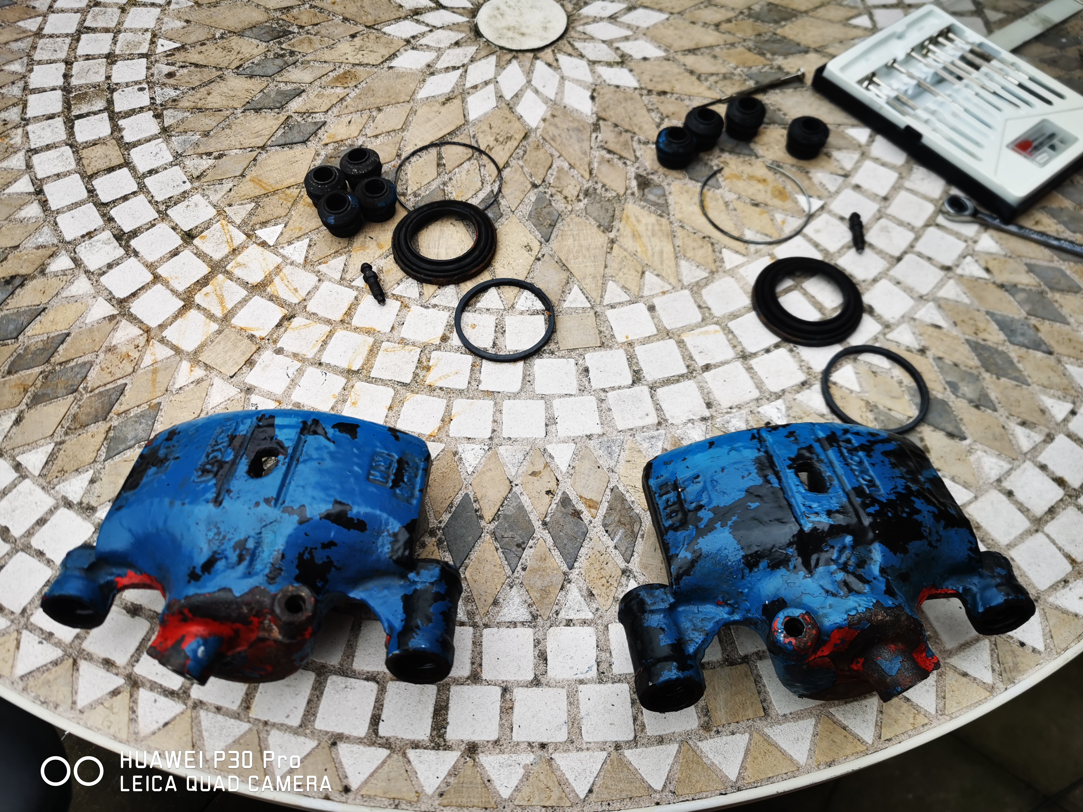

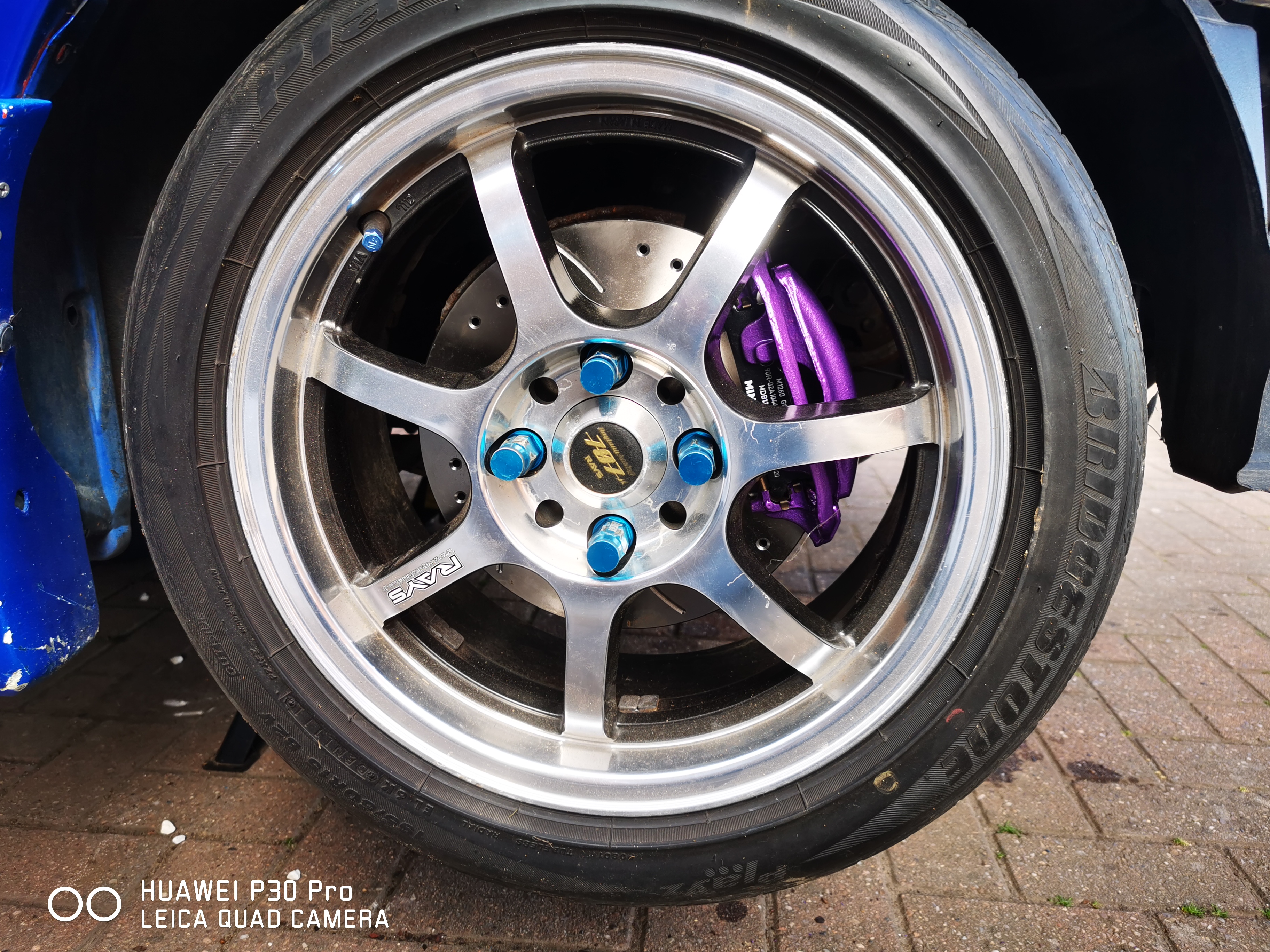

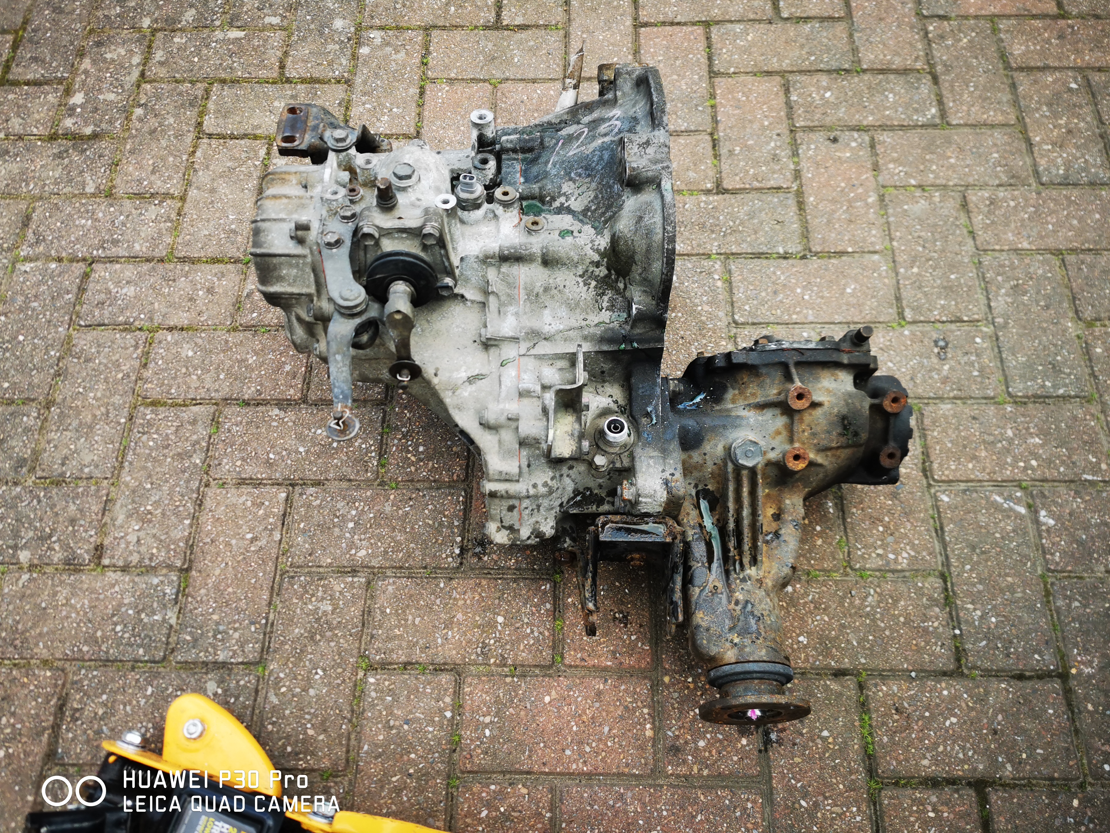

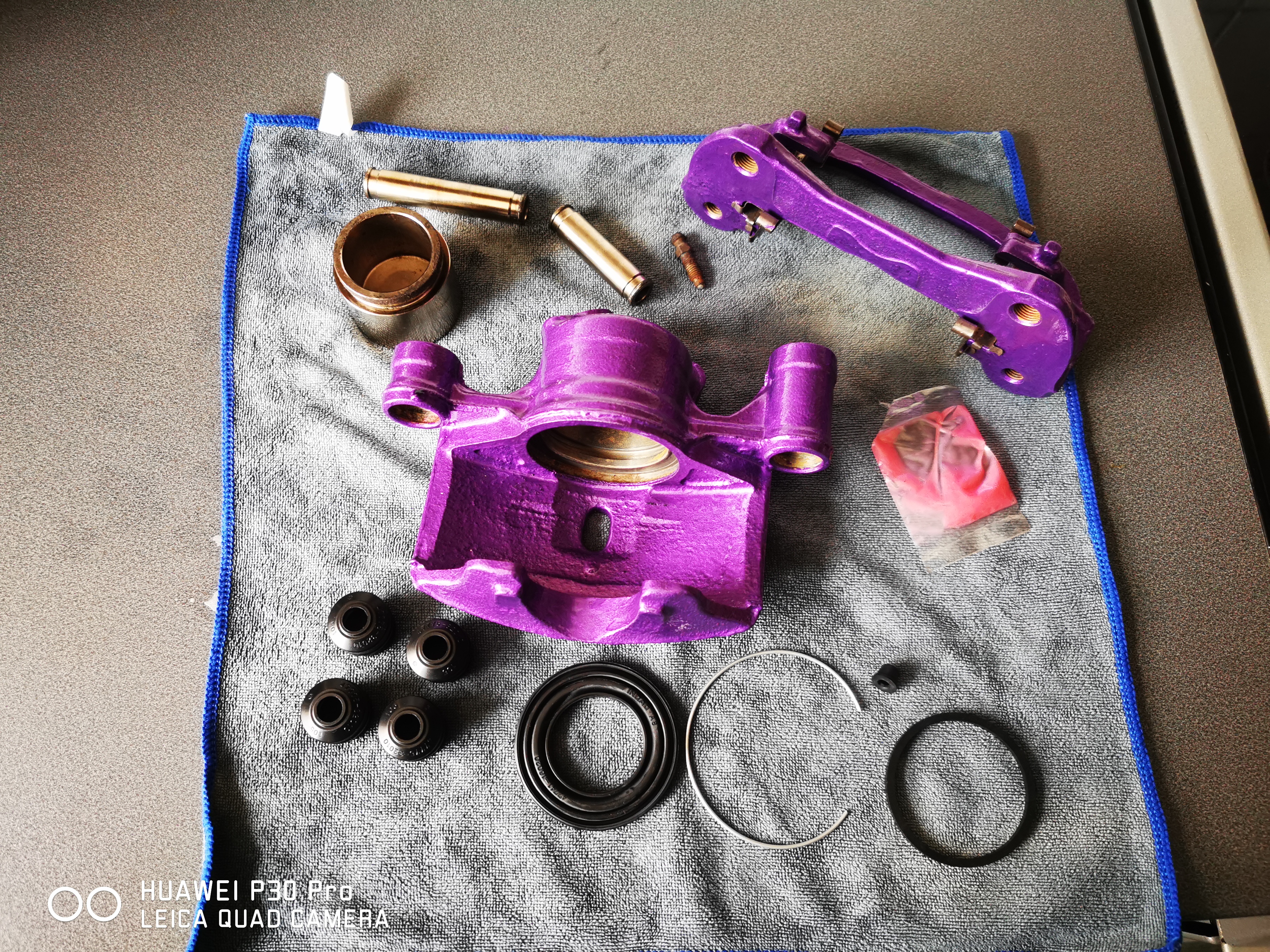

So anyway, it's nearly back together, I've had enough for today, clutch is in and box back on. The rest should be easy. I will be rebuilding these calipers IMG_20210320_145755.thumb.jpg.f070fab686479aeb81fdf8e0332315b9.jpg

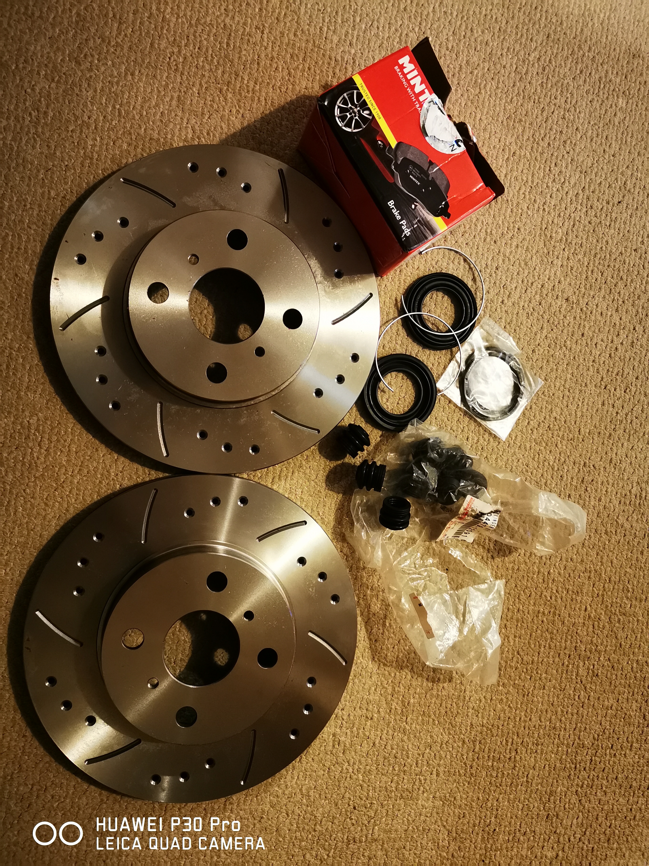

Got a rebuild kit from Id workz and currently striping all the many layers of paint away ready for a fresh coat. Will be having a fresh set of pads and new drilled and grooved discs.

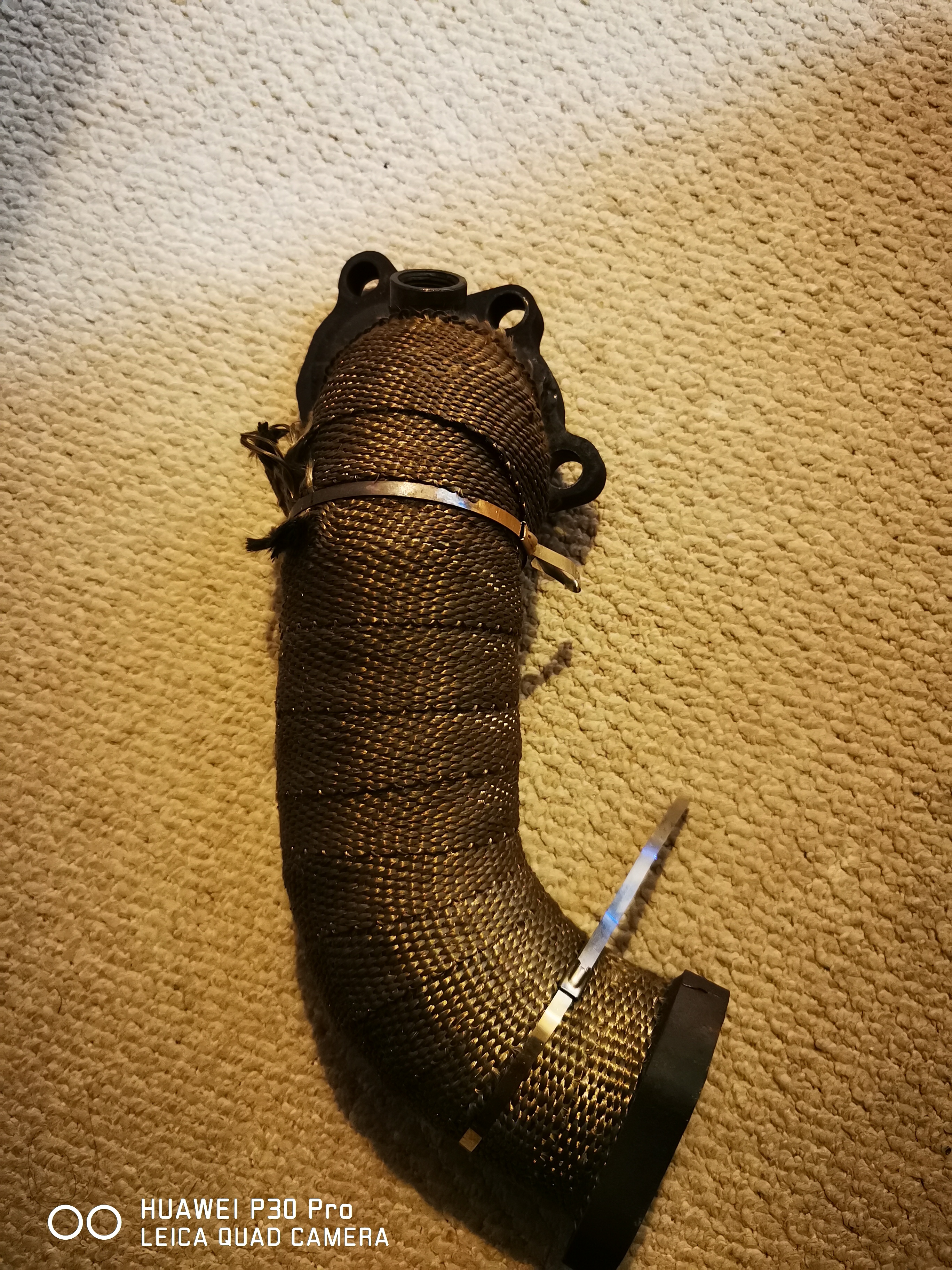

Will be refilling the gearbox and transfer box with fresh oil, and will do the rear diff at the same time. And I have a decat pipe for the ct9 that I will throw on as I piece it back together.

2 hours ago, Sam44 said:
Did you replace any oil seals, (rear main/gear input shaft) looks like oil on the old clutch + in the bell housing.
No, looks like old oil in the bell housing, and what looks like oil on the old clutch is actually the spline lube that has flung outwards, other than that it was totally dry.

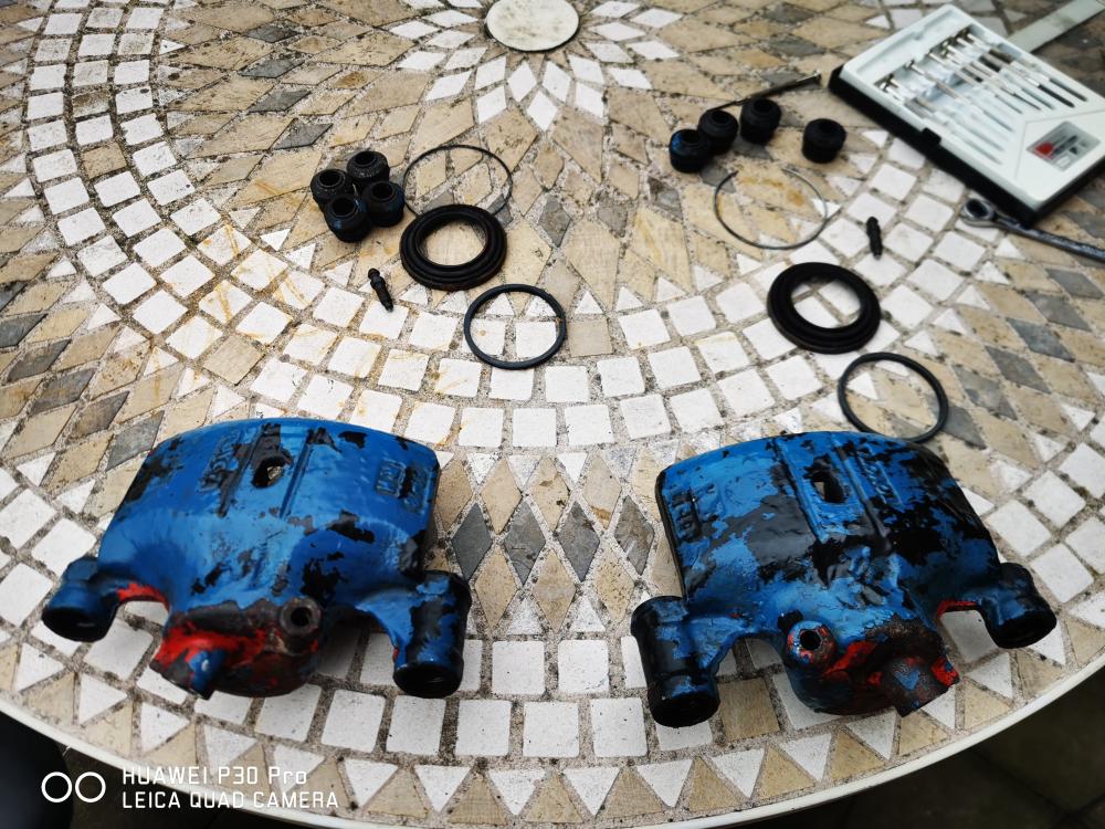

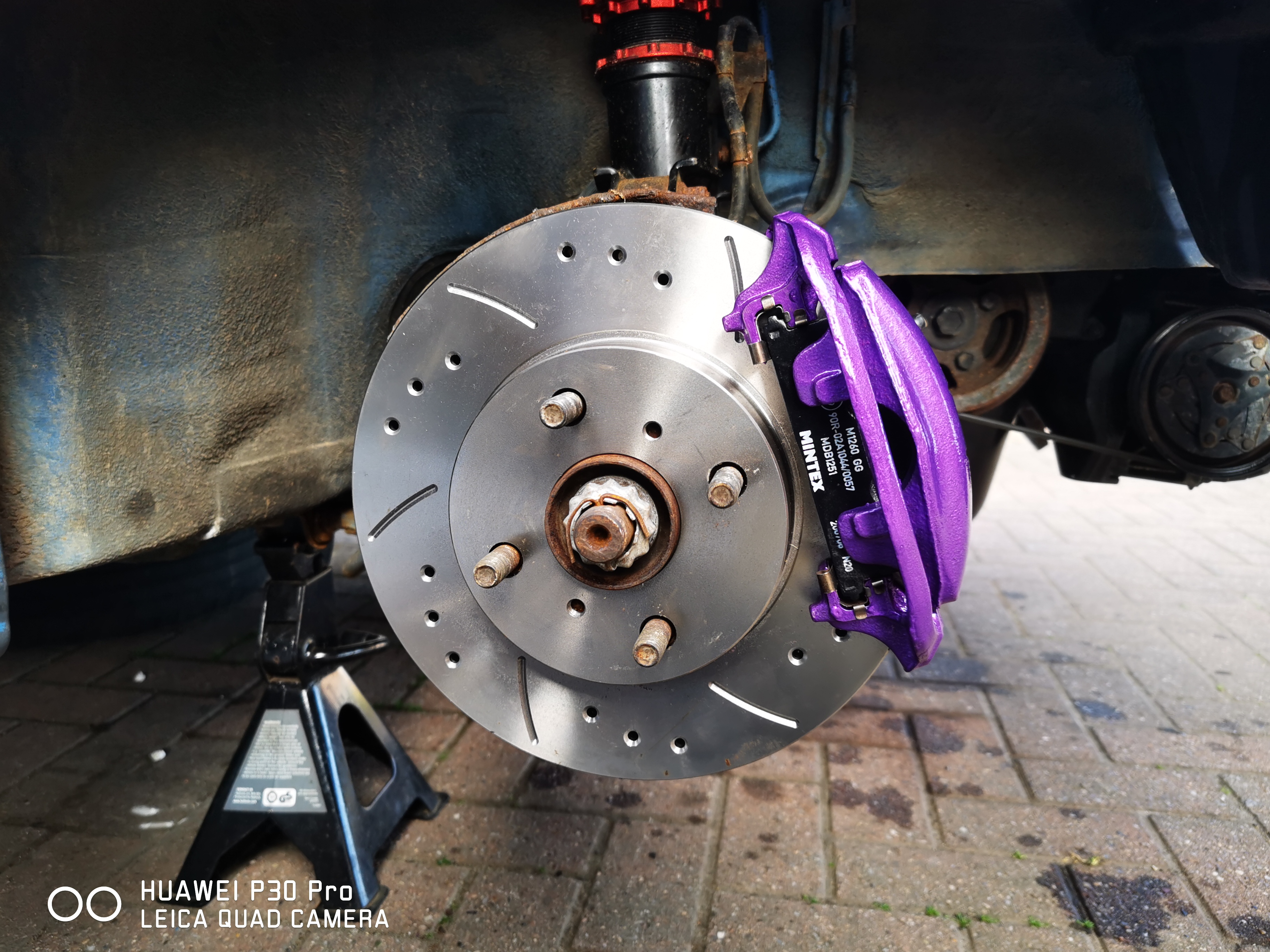

The o/s front brake was binding badly so a rebuild was in order, I nabbed a pair of used calipers on ebay and a genuine Toyota rebuild kit, along with new pads and drilled and grooved discs.
The colour might not be to everyone's taste but I like it. Nice easy job except for stripping the multiple layers of old paint off. And the wife was on hand to help bleed them up.

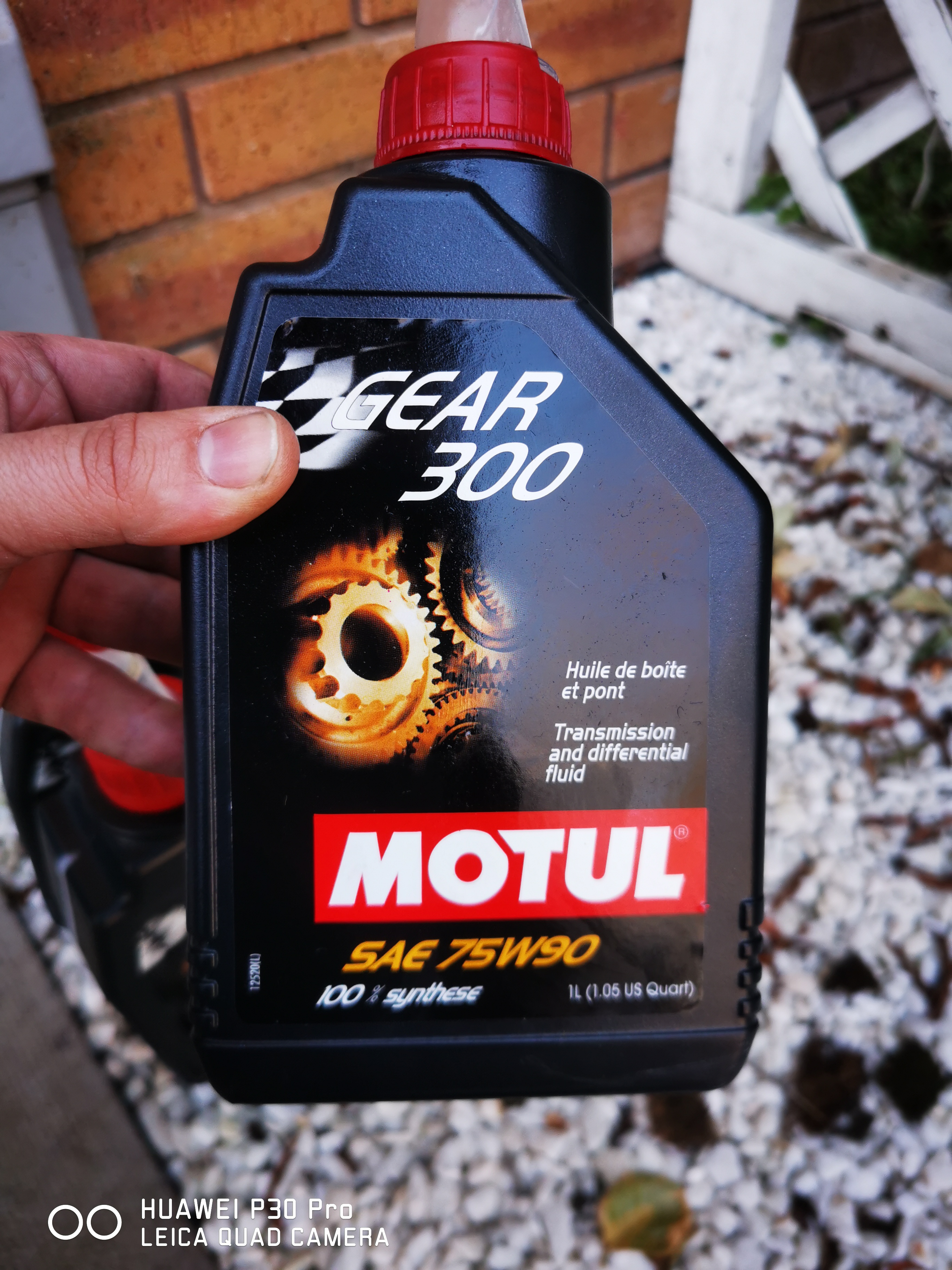

Also bled the clutch at the same time, refilled the gearbox and transfer box with some pricey oil, and will be using the same oil in the rear diff when I get round to it.
And after hours reading about engine oils I was more confused than when I started but settled on this as it looks to be good stuff, along with a genuine Toyota oil filter.

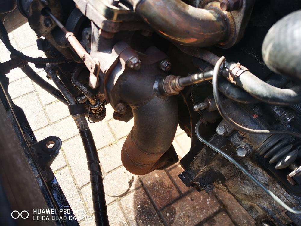

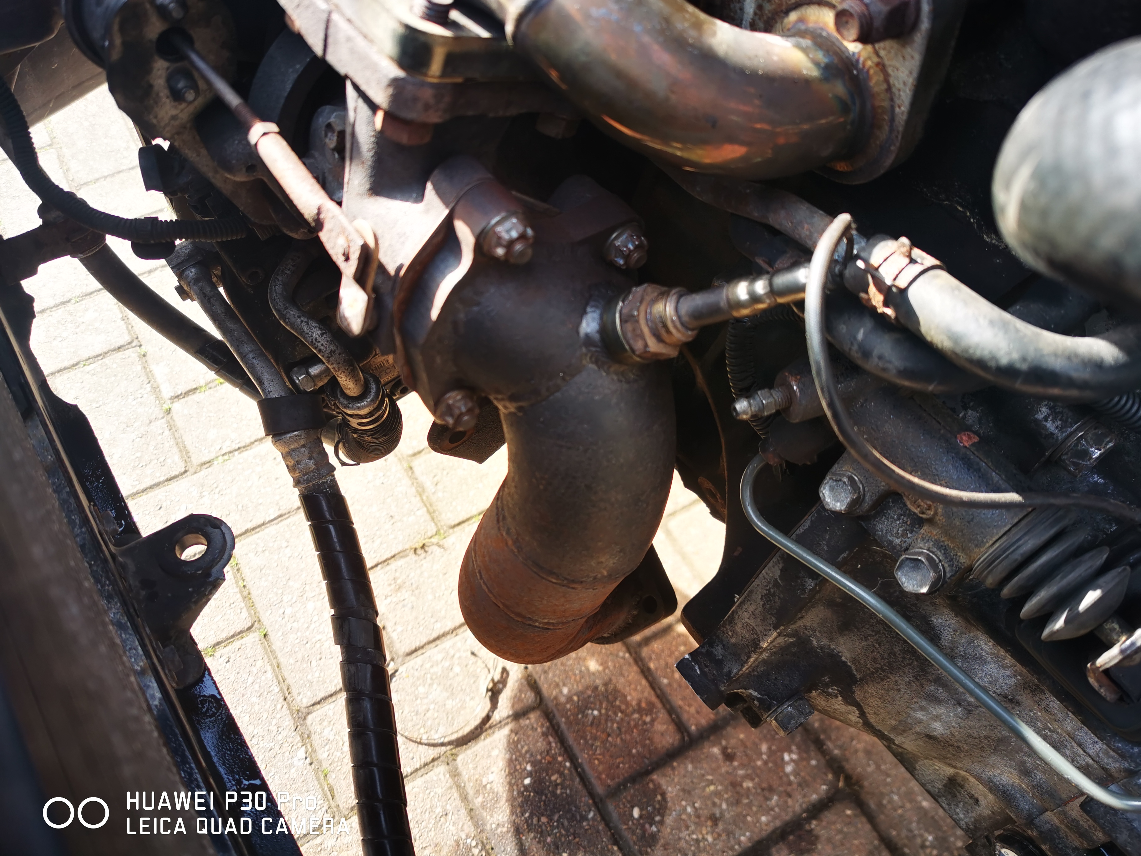

And decat on too

14 minutes ago, SKINY said:
Calipers looking sweet I think  :)
Cheers mate, main concern was to have them working effectively, but it would be rude not to tart them up at the same time.
12 minutes ago, daniel_g said:
What are you doing for an exhaust system?
Gona have to be a full custom cat back, there's a place near me that does powerflow so ill be giving them a call.
2 hours ago, daniel_g said:
A 2.5" custom system does physically fit over the axle but it there is no wiggle room whatsoever.
Mine is 3" the whole way lol, over the axl you can get a few skins in just
Cheers mate, I'll see what works when it's on the ramp
