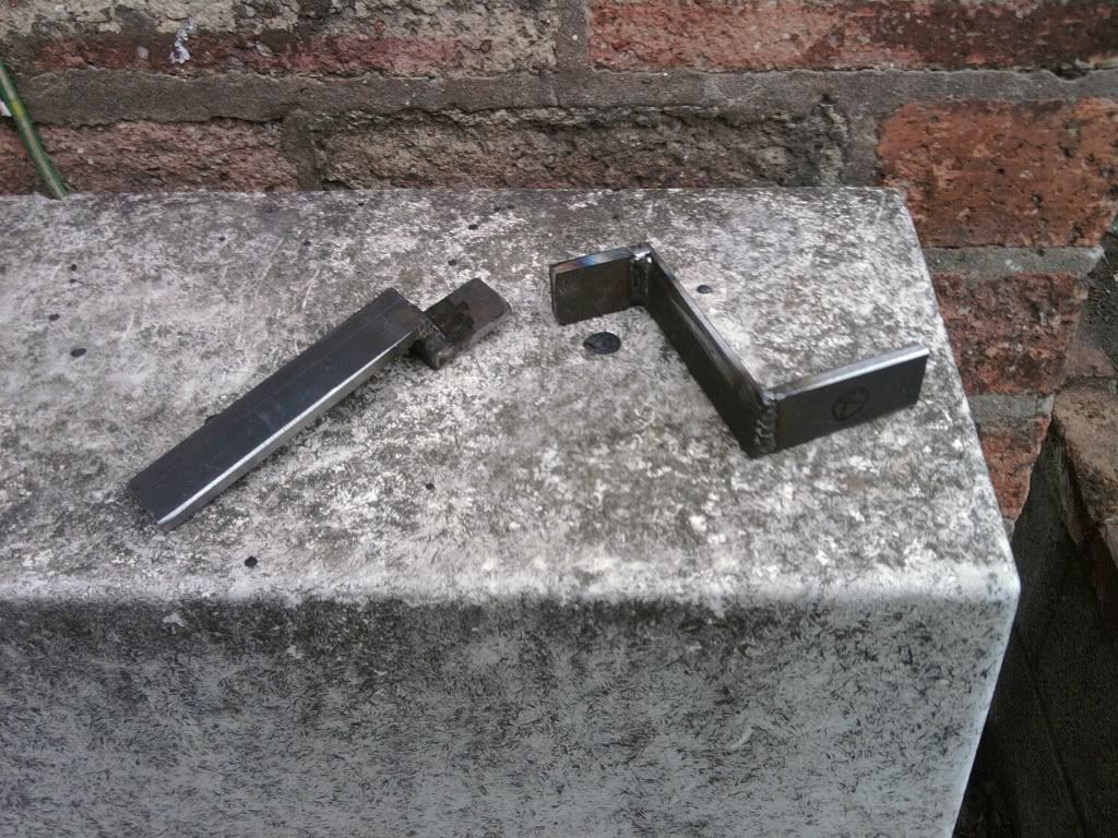

Braad Posted December 19, 2010 Posted December 19, 2010 just after reading the 23 pages, great build and keep up the good workX2, Coming along nicely mate. (Works quiet at the moment )On a side note, these brackets : I work in a Engineering firm and could knock stuff like this up in spare time, just wandering if anyone else would need some, or infact anything similar etc? Don't know if there's already a service like this, just seeing what's about really. (sorry to post it in your thread, just thought it would be easier!) Quote
Steve GT Posted December 19, 2010 Author Posted December 19, 2010 yeah mate thats finemight be an idea getting a gauging interest thread up for themget some made up to fit an intercooler and see if anyones interestedi for one would have been Quote
