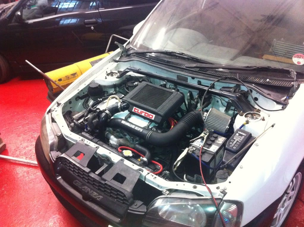

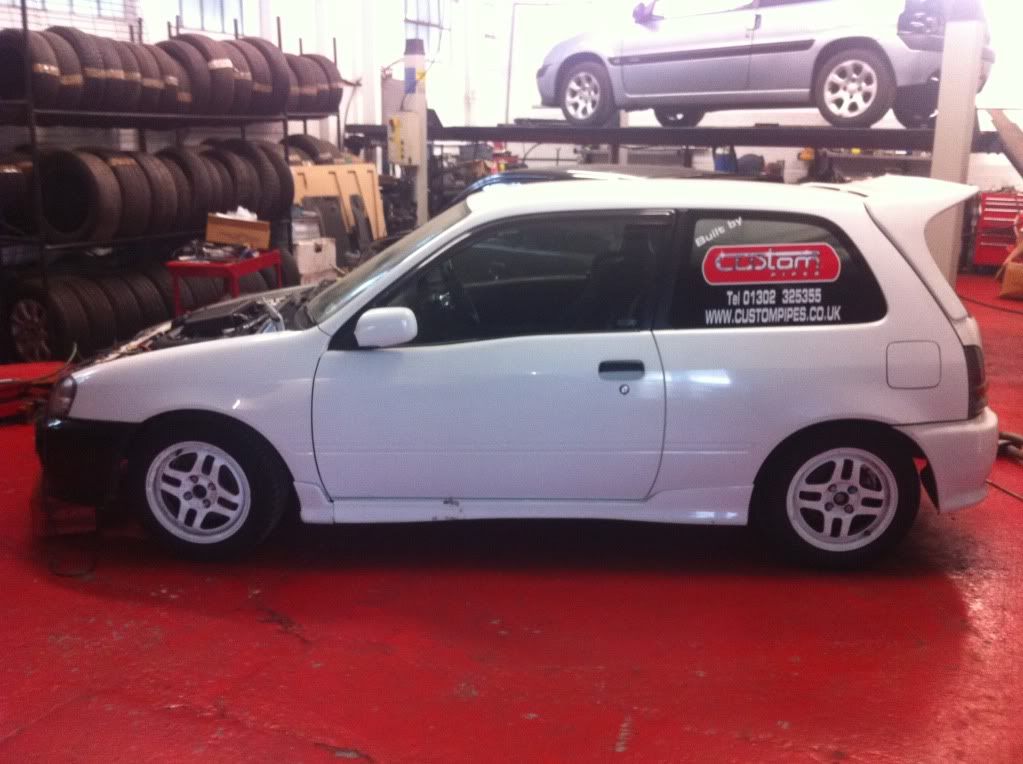

yaristurbo Posted March 3, 2011 Posted March 3, 2011 saw this today when i popped upto c/p, looking good mate, looks loads better in person Quote
whiteglanzav Posted March 3, 2011 Author Posted March 3, 2011 saw this today when i popped upto c/p, looking good mate, looks loads better in person haha u seen both of my babies now then buddy !! lol - it does look loads better in person the pictures i have taken so far non have been in natural light and with the i phone - so not the best.what do you reckon to the white one in its current form ? Quote
yaristurbo Posted March 3, 2011 Posted March 3, 2011 i actually really like it, once its finished it will look even better, i might know someone for it if its for sale eventually??? Quote
whiteglanzav Posted March 3, 2011 Author Posted March 3, 2011 yer i am gunna get the white on finished off with the stock engine in it and put it for sale in the next week or 2 i think around £2200 or somthing like that with tax and MOT Quote

lew777 Posted March 3, 2011 Posted March 3, 2011 that rocker and cap look awesome together mate Quote
whiteglanzav Posted March 3, 2011 Author Posted March 3, 2011 honestly couldnt say ed, i know the vf24 is smaller than the 23, think the 35 is a tad bigger than mine. im not too clued up on them tbh. bi interesting to see what it makes and also what mine and arron make as theres not to much info on banging the vf's on starlets realy.from what i researched the vf35 is similar to a vf34 put has a diffrent exhaust side and a different style of bearing in it - should push well over 300 bhp though that rocker and cap look awesome together matecheers mate although i think i am gunna end up with a different colour rocker i think with fittings welded to it Quote
