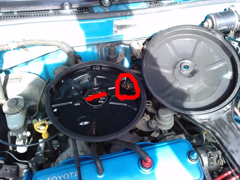

series70boy Posted September 7, 2010 Posted September 7, 2010 hi guys just seen this threadsorry to hijak it but i want to know what i should do as regards to fitting an induction kitmy options were stick a mushroom filter on top of the carb or a cone filteron a pipe to the side of the rocker coverhere is a pick of my engine bay with the current standard setup, if anyone wants to use paint on it to show where to put it thats great!!!!!if anyone has anymore ideas they are more than welcome Quote

series70boy Posted September 7, 2010 Posted September 7, 2010 is your radiator single core or double core?what size is the carb? could fit something like the K11 micrahttp://www.google.co.uk/imgres?imgurl=http...x=167&ty=68hope i dont sound stupiid but i dont actually know if its double or single, all i know is, its standardthe carb is also standard to the 2e engine!!!!but that pic of the micra is the sort of thing i was meaning when i said alongside the rocker cover!!! Quote

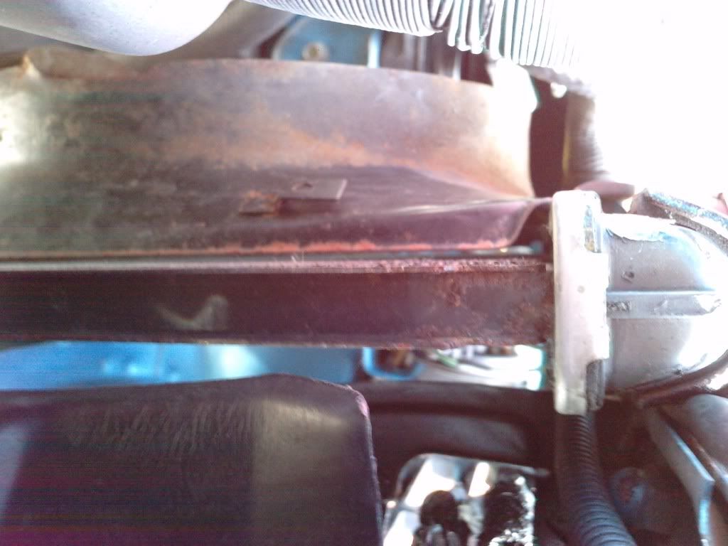

Asad Posted September 7, 2010 Posted September 7, 2010 Could you take a pic of the radiator for me? of the side of it if you get me?take the cover off and air filter im sure you can take the plate off where the air filter rests? then measure the intake diameter of the carb Quote

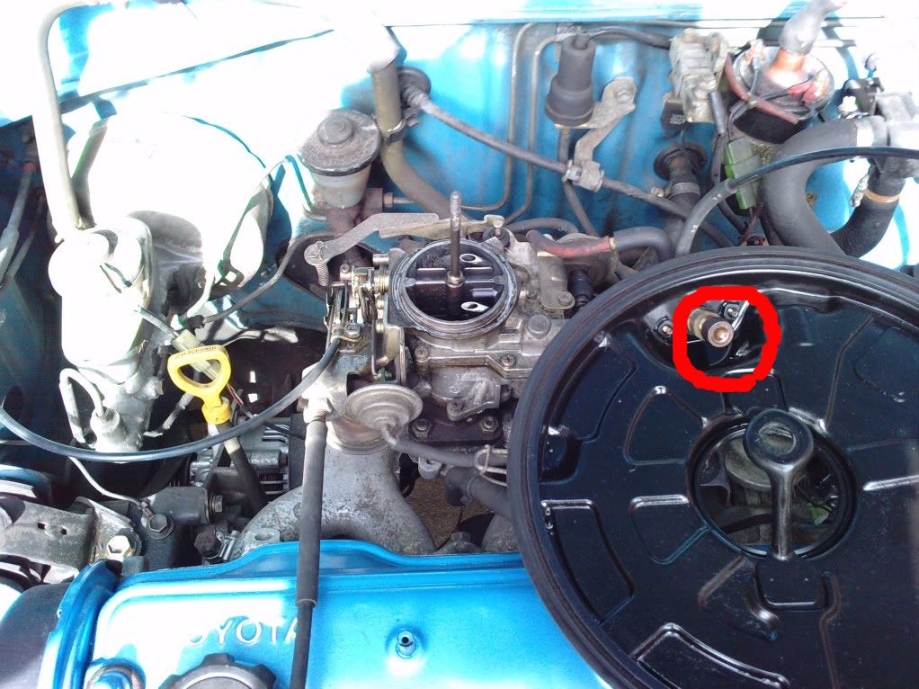

series70boy Posted September 8, 2010 Posted September 8, 2010 right ho theni belive the rad to be single coreand the intake at the top of the carb where the standard airbox fits is 63mminside the airbox was something that seemed like a fuel intake valve (not sure if its is, or what the correct terminology is!!!)it is highlighted in red, i am not sure but on second thoughts it might be something to do with the manual chokeif anyone could anyone shed any light on this that would be great as i am worried that it will stop me from having a new filter setup???????thanks for all your help guys Quote
Asad Posted September 8, 2010 Posted September 8, 2010 sooo, thats what you need a 63mm bend pointing towards the washer bottle and a cold air feed comming up from the gearbox....mind you wouldnt it mess with the fueling and stuff? guess it would be best to take it for a tune up Quote
series70boy Posted September 8, 2010 Posted September 8, 2010 thought sobut i could put a hole in the 63mm bend and fit the fuel thingy, but will find out what it is and of what importance before i do daft things like cutting holes, i am sure it could go in the bend after the cone filter as it actually sits under the current air filter, maybe mo harm would be done??i have a rather good mechanic next door but one so i might mug him tonight to get his opinion!!!!!! Quote
