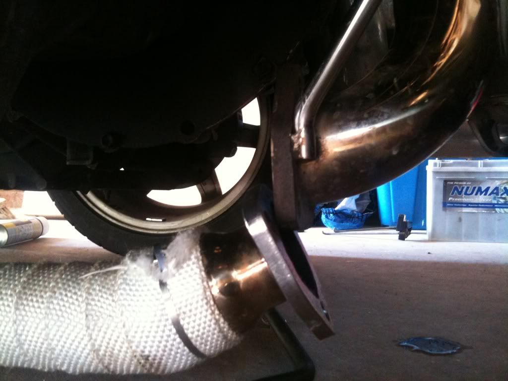

N80Jamie Posted June 9, 2011 Posted June 9, 2011 Well after the ball ache of getting the old manifold/turbo/downpipe off due to a snapped bolt, just lined up the new kit and the exhaust doesn't match up to the downpipe! So fu**ed off! What shall i do next..?! :| Quote

N80Jamie Posted June 9, 2011 Author Posted June 9, 2011 I don't get why it doesnt fit though if it was designed for the starlet? Unless i've been sold a gt kit and there not the same as the glanza kits? Quote
Starbuck Posted June 9, 2011 Posted June 9, 2011 Fuckin yell dude. Didn't someone say once its never easy nodding these cars..... always something comes up. Looks like 2inches or so needs to come off and new flange Quote
N80Jamie Posted June 9, 2011 Author Posted June 9, 2011 Fuckin yell dude. Didn't someone say once its never easy nodding these cars..... always something comes up. Looks like 2inches or so needs to come off and new flangeTell me about it! I text Quadcorecraig a few days ago asking what the actuator was set at but he didnt reply.. So if i text asking about what he had this fitted to i probably won't get one!What downpipe is it?It was sold to me as a 'WEPR' td04 kit so it should be a WEPR downpipe Quote
Lee_EP82 Posted June 9, 2011 Posted June 9, 2011 The downpipe looks to be for a custom exhaust? Quote
Sparky Posted June 9, 2011 Posted June 9, 2011 WEPR do a full exhaust system so its more than likely to be made for that specific exhaust.Most people make the downpipes/kits so they are stock exhaust position friendlyNothing but a ball ace modding cars mate I would either get a racetech decat or go to a local exhaust fabricator shouldnt cost to much to modify to fit. Quote
DavidAshton Posted June 9, 2011 Posted June 9, 2011 Wepr kit designed for a wepr exhaust, all the older wepr kits were like this. Did the seller not state? Quote
Amjad Posted June 9, 2011 Posted June 9, 2011 I was wondering if it was WEPR, I think it's suited to their Sidewinder exhaustMay as well get the Japspeed modded too, 2.25" front section isn't a lot. I'm planning to get mine made to 2.5" when I go TD04 Quote
Sparky Posted June 9, 2011 Posted June 9, 2011 Amjad speaks sense, get a 2.5" centre section made up Quote
GlanzaJim Posted June 9, 2011 Posted June 9, 2011 me mate had same kit and to fit his he cut his pipe off (the flange bit or what ever you call it) and weld the exhaust straight to the down pipe. this worked for him lol.Uploaded with ImageShack.usUploaded with ImageShack.usme bro cut it off cause he thinks his will bolt on straight to it, but dont know yet, Quote
Russleh Posted June 9, 2011 Posted June 9, 2011 had the same issue when i done this dude. got a jperformance exhaust and it didnt fit as i had the old wepr downpipe for the wepr exhausts.you probably best of buyin a new downpipe Quote
Lee_EP82 Posted June 9, 2011 Posted June 9, 2011 I had a WEPR sidewinder exhaust and it fit straight up to my zisco td04 kit, only modification was the flange needed to be changed. That looks to be wrong angle and everything. Quote

bucketep91 Posted June 9, 2011 Posted June 9, 2011 can the center section be removed and fitted upside down? it might fit then? Quote
N80Jamie Posted June 9, 2011 Author Posted June 9, 2011 can the center section be removed and fitted upside down? it might fit then?Thats the first thing i tried but there's no way that will work unfortunately :| Quote
bucketep91 Posted June 9, 2011 Posted June 9, 2011 well the flange on the decat is upside down any way. looks to me if the exhaust was cut, rotated round and rewelded it might just fit. If not im sure a decent fabricator could make it fit Quote

N80Jamie Posted June 9, 2011 Author Posted June 9, 2011 I don't want to cut and weld the exhaust or the downpipe tbh. I'm either going to get a new decat or a new kit. Do you think it would fair for me to ask quadcorecraig for a refund considering he didn't explain this issue to me? Quote
