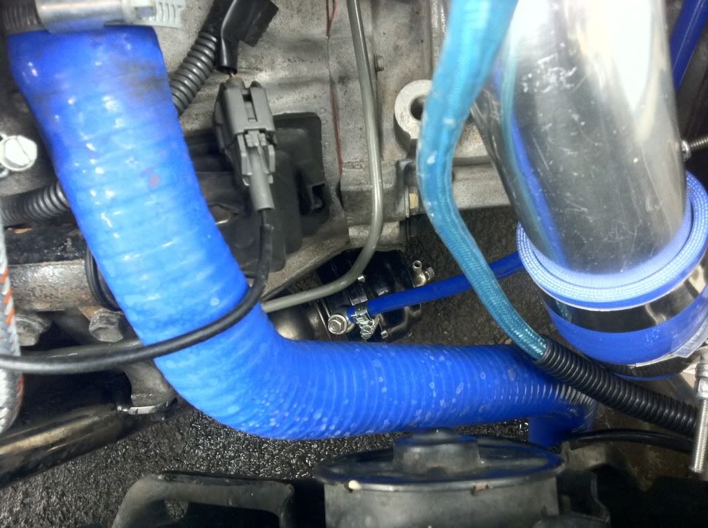

ollie ryan Posted September 4, 2011 Author Posted September 4, 2011 right can anyone confirm that my wastegate is correcti have it connect to the throttle bodyblue pipe is the wastegate one and the black pipe was orrginally connected there but have just blocked it offis that okay?and conected to the side of the wastegate Quote
N80Jamie Posted September 4, 2011 Posted September 4, 2011 Try putting the black pipe back where it was on the TB then T piece the blue hose into the black. You may be blocking something off that your not supposed to be. I;m sure someone can confirm that though! Quote
ollie ryan Posted September 4, 2011 Author Posted September 4, 2011 okay mate will try thati wast told that black pipe is to do with aircon? Quote
N80Jamie Posted September 4, 2011 Posted September 4, 2011 Im not too sure about that dude. I T pieced mine in on one of the thinner black lines on the top right of your picture. Mine seemed to work fine. Might as well give it a go, nothing to loose! Quote
ollie ryan Posted September 4, 2011 Author Posted September 4, 2011 okay cheers matewill give that a go Quote

ktl Posted September 11, 2011 Posted September 11, 2011 how come you havent connected the blue pipe to the turbo and gone for the inlet ? im guessing theres no t-off from the turbo ?and if this problem has happend since you put your new turbo kit, you could possibly blame the wastegate/turbo Quote
