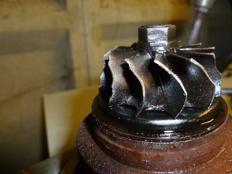

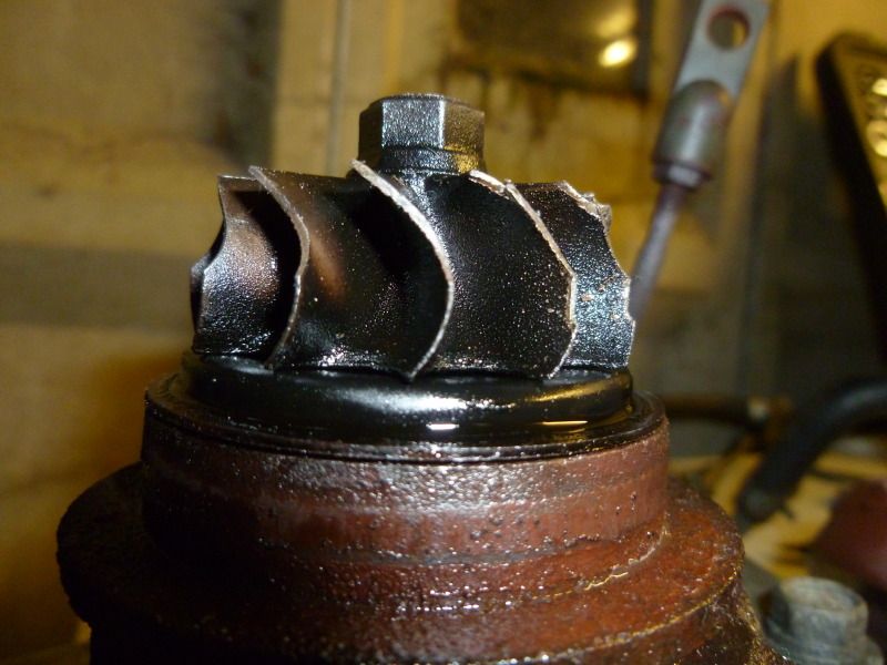

aaddzz123 Posted October 11, 2011 Posted October 11, 2011 I bought a td04 off ebay (don't tell zoe, i hope she doesn't see this lol) and I was dismantleing it to rotate everything into place, split it in half and what d'ya know, the compressor wheel is chipped on some of the fins. Also, it has a "curve" to it but the edges of the blades where it "curves" looks fresh, like its been skimming.... Just wondered if its really that bad and I should use it anyway, or if I should complain and open a case on ebay to send it back and get a refund? This is what it looks like...As you can see if you enlarge the picture, its covered in metal filings too :/....Here is the listinghttp://www.ebay.co.uk/itm/130582497155?ssP...984.m1497.l2649 Quote
aaddzz123 Posted October 11, 2011 Author Posted October 11, 2011 is there play in the shaft ?yeah mate lol about 3-4mm. Listing said "slight shaft play but works fine" Quote
nazzurro19 Posted October 11, 2011 Posted October 11, 2011 nah fins shudnt look like that ill get a pic of mine so ya can see the difftheres always slight play in a dry turbosorry pic aint the best , they are curved but they shudbt be all bashed about like yours the wheel should spin freely with minimal effort , if it doesnt then take the housing off an try re aline it Quote
Lukew360 Posted October 11, 2011 Posted October 11, 2011 3-4mm shaft play might mean it's been scrubbing on the housing? I'm not sure how close the housing is to the blades but it seems logical to me seeing as there's metal fillings in there.Personally I would email him and ask him for a refund before opening a case against him. He might be fair and give your money back. Try that first Quote

keirz Posted October 11, 2011 Posted October 11, 2011 thats the shaft not a compressor wheel mate. I wouldnt fit it mate, hard to tell from pic but seems like there has been exess play. Also it has had impact damage or overspeed. That will whisle its tits off and not last 5 minutes. Quote
aaddzz123 Posted October 11, 2011 Author Posted October 11, 2011 thats the shaft not a compressor wheel mate. I wouldnt fit it mate, hard to tell from pic but seems like there has been exess play. Also it has had impact damage or overspeed. That will whisle its tits off and not last 5 minutes.Touche'! cheers mate haha .Thanks for the replies and advice guys, opened a case (because I'm a heartless bastard) and gave them some abuse.... But I was nice at the same time... See what happens I guess. Wouldn't mind a replacement if they have one lol... Considering postage n that I could just keep it and sell it on... But that'd make me a shitty person.Anyway!Thanks. Quote
5T4R7ET N/A Posted October 11, 2011 Posted October 11, 2011 3-4mm is too much play. if there is any it only should be 1-2mm.SEND IT BACK & get one off scooby.net. Quote
aaddzz123 Posted October 11, 2011 Author Posted October 11, 2011 If you dont fit it you'll just have to bin it. You'll never win an ebay case because you opened it and there no proof you didnt do the damage And I never opened it mate.... can see the damage through the exhaust housing Quote
