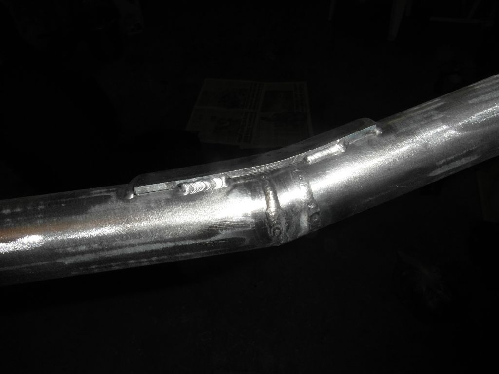

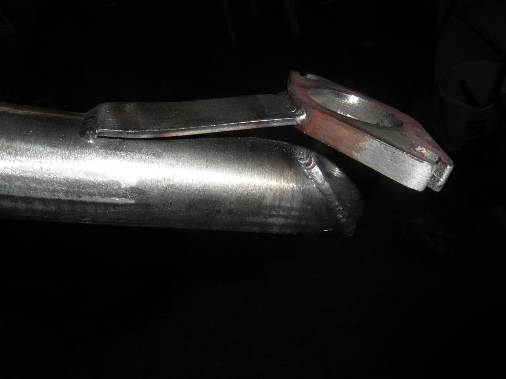

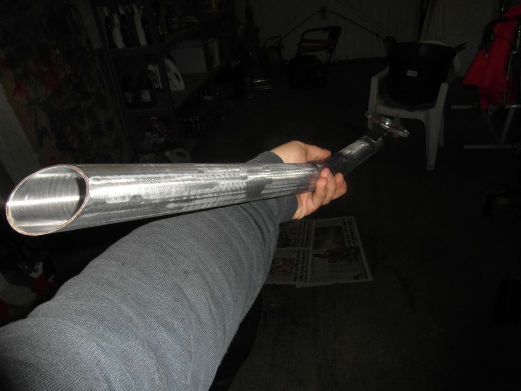

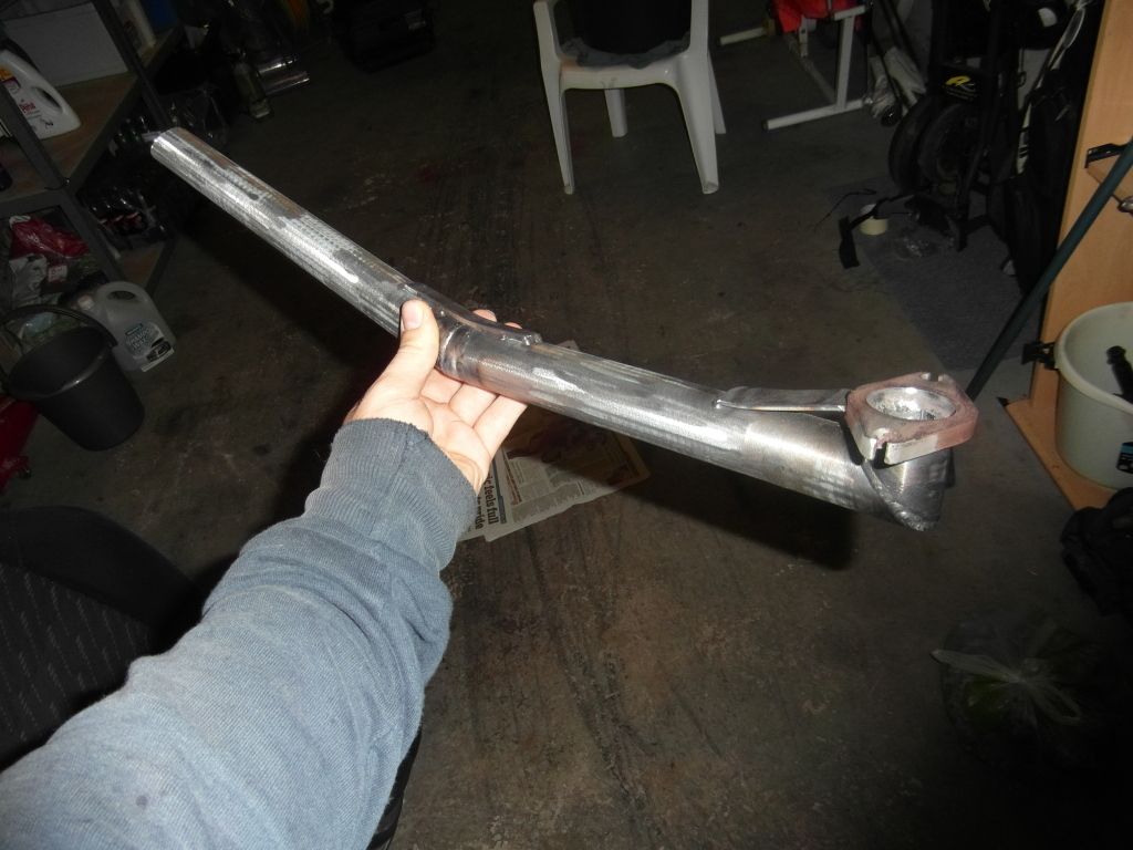

mark1991 Posted September 11, 2012 Posted September 11, 2012 I was left with a mild steel screamer pipe from my zisco kit after i make up a stainless steel one \/\/\/\/\/So i made up thisIt is pritty light and i put in a few braces just incase. It is made of mild steel as there was plent of pipe and plate at work.I wanted the screamer coming out of the bumper (passenger side)... well to be fair to scare pedestrians and any car i may over take lol and the odd puff of black smoke or flame when she hits the limiter i duno if she will fit first time i might need a wee tweek pics coming soon! Quote

Driver Posted October 4, 2012 Posted October 4, 2012 Don't like the look of the 90* turn after the wastage, looks quite restrictive and may cause boost creep. If I was you I'd remove that and put in a 90* mandrel preferably or even pie cut a 90* bend out of your remaining pipe. Quote

ste91 Posted October 22, 2012 Posted October 22, 2012 That 90 degree "bend" looks fucking awful lol. Quote
