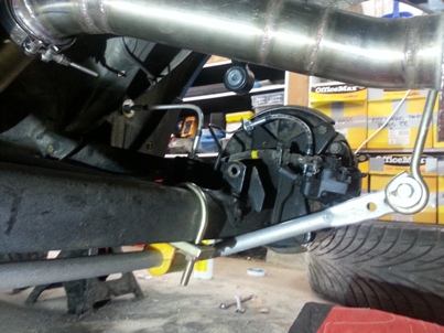

So in the search for more low I broke out a grinder...
All just tacked in place at the moment, will tig it up(inside and out) tomorrow. Also planning on running a couple of braces back to the floor and then modifying my cusco strut brace to suit. All in the aid of having full suspension range and not having to run the coil overs at max low.
Thanks - will make more sense when its done. Will eventually tie into the cage when I finally get around to doing it

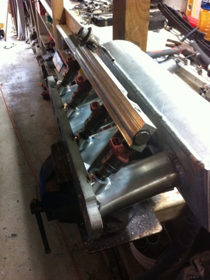

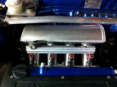

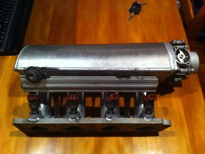

So this is kinda where I got to with the inlet:

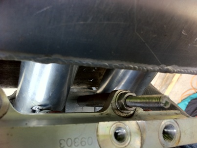

Sat the fuel rail in place and set the angles for the boses
Setting the angle

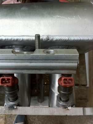

Made up some tabs and dummy bolts to hold the rail in position
Another shot
Welded it all up

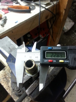

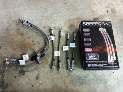

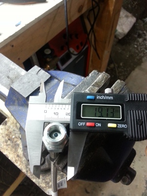

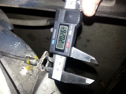

Moving to the brakes, I had a look around for brake lines and due to the cheapness had a bit of a gamble with a set from Safebrakes just over the ditch in Oz. Nice lines and they pass all the required specs says Mr Certman
Ah, but its not plain sailing. When measuring an issue has arisen
The old ones measure...
And the new ones measure...
And the body mounts measure...

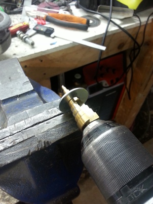

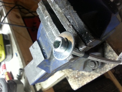

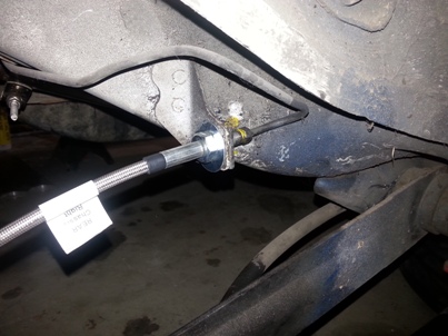

But some stainless washers came to the rescue. Just needed a bit of a hone out
And they fitted like this to the lines
And fitted to the body like this

So what else has been happening? Well currently the gearbox is out again for a double check and to fix a small leak - got it back together tonight and will fit in the next few days as I'm taking the opertunity to work on a few things while its out. Rear strut towers need completing then the back is finished fingers crossed. I've started on the wiring and bough new HEC715 coils for each plug. Will update again once photo worthy

Noticed you're using a 16v fuel rail, always thought they were a bit ott for an n/a motor, you just going to block off the outlet for the 5th injector or do they not have them on the models down under?
Thanks dude - pretty slack with updates, have done heaps but too lazy to post anywhere.
Yeah small port red top 16v fuel rail - port spacings match the 20v head so handy to use. I think it should be good enough - its got an 044 bosch pump throwing fuel into it so there shouldn't be any issues. Yeah will weld up the cold start injector and machine it smooth. Probably end up running and external reg - will see when I get to it. Tempted to centre feed the rail and loop returns to a reg below the inlet - still pondering at this stage.
Edited by Stu
That's handy to know, I've got one sitting about if I ever go boost lol
If you've got it on a machine to clean the weld up you may aswell center feed it at the same time surely? Plus it would look cool ;)
Haha yeah, would look cool. Would be relatively easy, just need a tap to the same thread as the banjo bolt really
