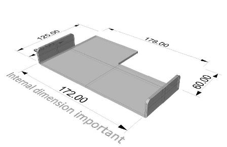

Stu Posted September 30, 2014 Author Posted September 30, 2014 It was years ago but I think this is the stuff http://www.blackwoods.com.au/part/04126906/urethane-putty-devcon-flexane-80-454gm CAD is a good skill to have - I've just drawn up a basic coil mount bracket but I'd drawn up all sorts over the years - so handy. Quote
