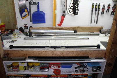

steve-gers Posted November 15, 2012 Posted November 15, 2012 I made my own adjustable panhard rod for under £30 and it works perfectly. Quote

Stu Posted November 16, 2012 Posted November 16, 2012 I cut weld adjusters into the middle of the stock units Quote
Broony Posted November 16, 2012 Posted November 16, 2012 i like that!!can it be adjusted on the car? if so i might make one#! Quote
