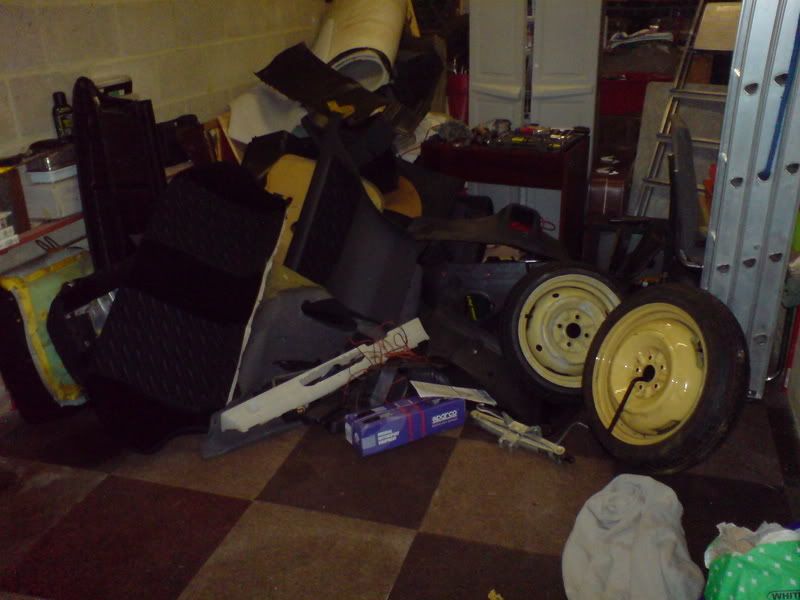

Nick_p Posted August 27, 2007 Posted August 27, 2007 Glad to see im not the only person who likes weight saving as well. Good job on the weight saving Nightspirit and Enzo, cars always look better stripped. love the Rally slag look Heres a couple pics of mine, will prob take the carpet out and door cards off next.And a big pile of trims from my starlet and my mates gt4One of the best mods and best of all its Free!! Quote
