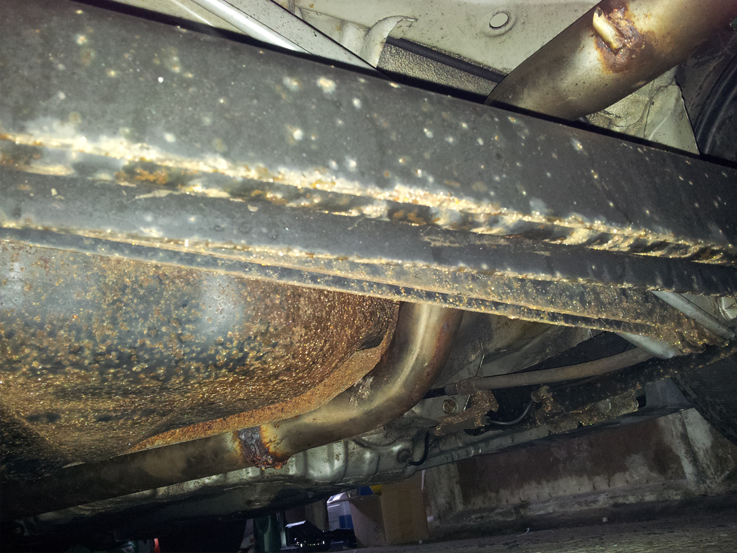

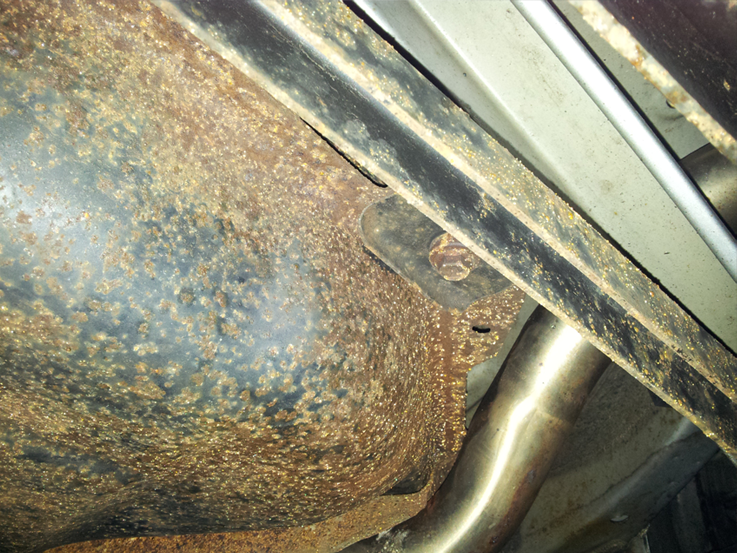

Critic Posted May 30, 2013 Posted May 30, 2013 (edited) Basically my exhaust is quite close to my petrol tank on my glanza, and my friend says its a bomb waiting to happen. :/ I'm just wondering is this the case?Could my exhaust heat the petrol up enough to go boom? After him saying this I'm pretty nervous about driving my glanza. Edited May 30, 2013 by Critic Quote
jimmymac101 Posted May 30, 2013 Posted May 30, 2013 Surly all glanza's have the same exhaust route from the engine? Even a custom exhaust or a premade after maker exhaust follows the original route! I've never heard of a glanza exploding due to the exhaust being to close.I think your mate is having you on so your sell it to him James Quote
Critic Posted May 30, 2013 Author Posted May 30, 2013 Surly all glanza's have the same exhaust route from the engine? Even a custom exhaust or a premade after maker exhaust follows the original route!I've never heard of a glanza exploding due to the exhaust being to close.I think your mate is having you on so your sell it to him James It honestly wouldn't surprise me if they were having me on like, as there twats. xD And yeah it follows the normal route, only difference is it was made for a ep82 and I've only had to change the hangers on the back box which I doubt would make a difference to where it sits in the middle. Quote
jimmymac101 Posted May 30, 2013 Posted May 30, 2013 To be fair mate unless a qualified professional says its a danger which after year and years of glanza's being around I very much doubt they will say that Stop stressing about it and tell them to fuck off as they are talking shite AND enjoy the boost!! (unlike myself who is unsatisfied with suzuki NA power ) James Quote
Critic Posted May 30, 2013 Author Posted May 30, 2013 To be fair mate unless a qualified professional says its a danger which after year and years of glanza's being around I very much doubt they will say that Stop stressing about it and tell them to fuck off as they are talking shite AND enjoy the boost!!(unlike myself who is unsatisfied with suzuki NA power )James Thing is my mate who said it, is a mechanic, that's why I'm kinda worried and do believe him. >.< Quote
jezza Posted May 30, 2013 Posted May 30, 2013 The ignition temp of petrol is about 280 degrees Celsius so that's never going to happen. Quote
Critic Posted May 30, 2013 Author Posted May 30, 2013 The ignition temp of petrol is about 280 degrees Celsius so that's never going to happen. Even if the exhaust was touching it? Quote
jezza Posted May 30, 2013 Posted May 30, 2013 Yes, A small contact point is never going to generate enough conductive heat. I'd be more worried about it vibrating and creating a hole which is again very unlikely. For peace of mind, try adjusting the back box hangers to gain some clearance. Quote
jimmymac101 Posted May 30, 2013 Posted May 30, 2013 The tanks will be made to withstand the heat from an exhaust otherwise they wouldn't make it like that, remember the Japanese know what they are doing! HahaIf I was you I wouldn't beleave him James Quote
Critic Posted May 30, 2013 Author Posted May 30, 2013 Ok, thanks for the reply's. That's put my mind to rest now haha.. Quote

H_D Posted May 30, 2013 Posted May 30, 2013 Lol this made me laugh! No offence dude but it looks like your car desperatly needs some undersealing on the tank and rear beam. Quote
Critic Posted May 30, 2013 Author Posted May 30, 2013 Lol this made me laugh! No offence dude but it looks like your car desperatly needs some undersealing on the tank and rear beam. It does mate, I have the underseal sitting here, I just haven't had time or cant get anyone to do it for me right now. And the weather isn't helping either. -_-' Quote
templar2007 Posted May 30, 2013 Posted May 30, 2013 just think of when your drivin.....air is keepin things cool.......yaeh that ture Quote
davehart Posted May 30, 2013 Posted May 30, 2013 There should be a heat shield there but by the looks of yours it seems to be missing. Quote
Critic Posted May 30, 2013 Author Posted May 30, 2013 There should be a heat shield there but by the looks of yours it seems to be missing. I see... Hrm. :/ Quote
StuDoc 72 Posted May 31, 2013 Posted May 31, 2013 LOL You should seal the underneath of the car before you worry bout the rear axle haha. Thats only surface rust aswell its not even bad! You put any regular UK car up on a ramp I could almost garuntee it would be worse. Quote
morgey Posted May 31, 2013 Posted May 31, 2013 (edited) Beams not that bad but the tanks seen better days, i'd get a 2nd tank wire wheel it and go to town on anti rust paint chip resistant stuff and underseal and wait till urs splits and replace it.But thats just me lol Edited May 31, 2013 by morgey Quote
