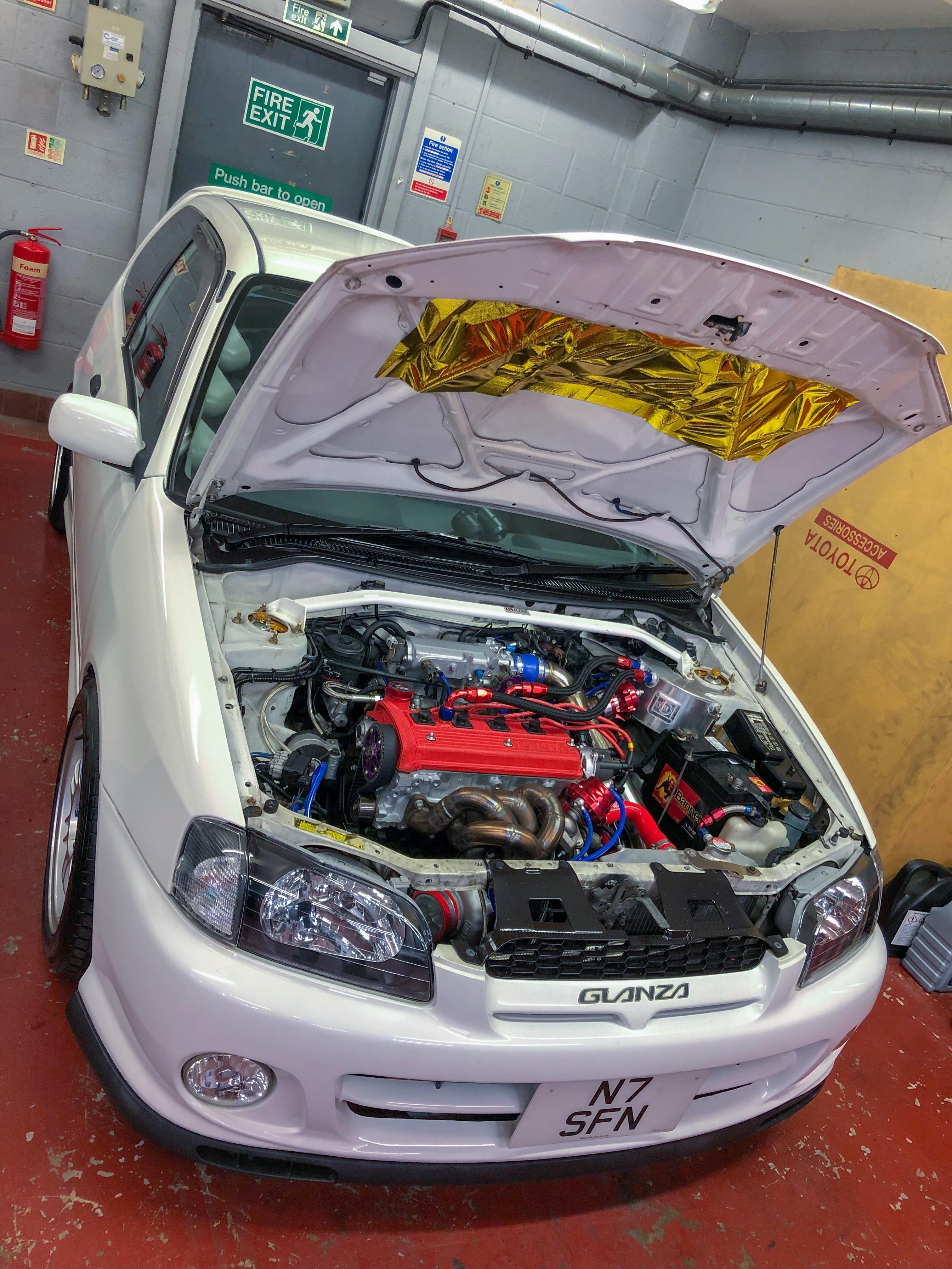

Sefton-EP91 Posted February 2, 2019 Author Posted February 2, 2019 Gave her a little wipe over to get the dust off! God I miss this thing! On another note, the Clifford alarm I had on the car decided to pack up so I’ve got her booked in for a new Sterling CAT1 alarm and immobiliser on the 14th Feb. So that should keep her protected! Small photo of how she sits. Quote

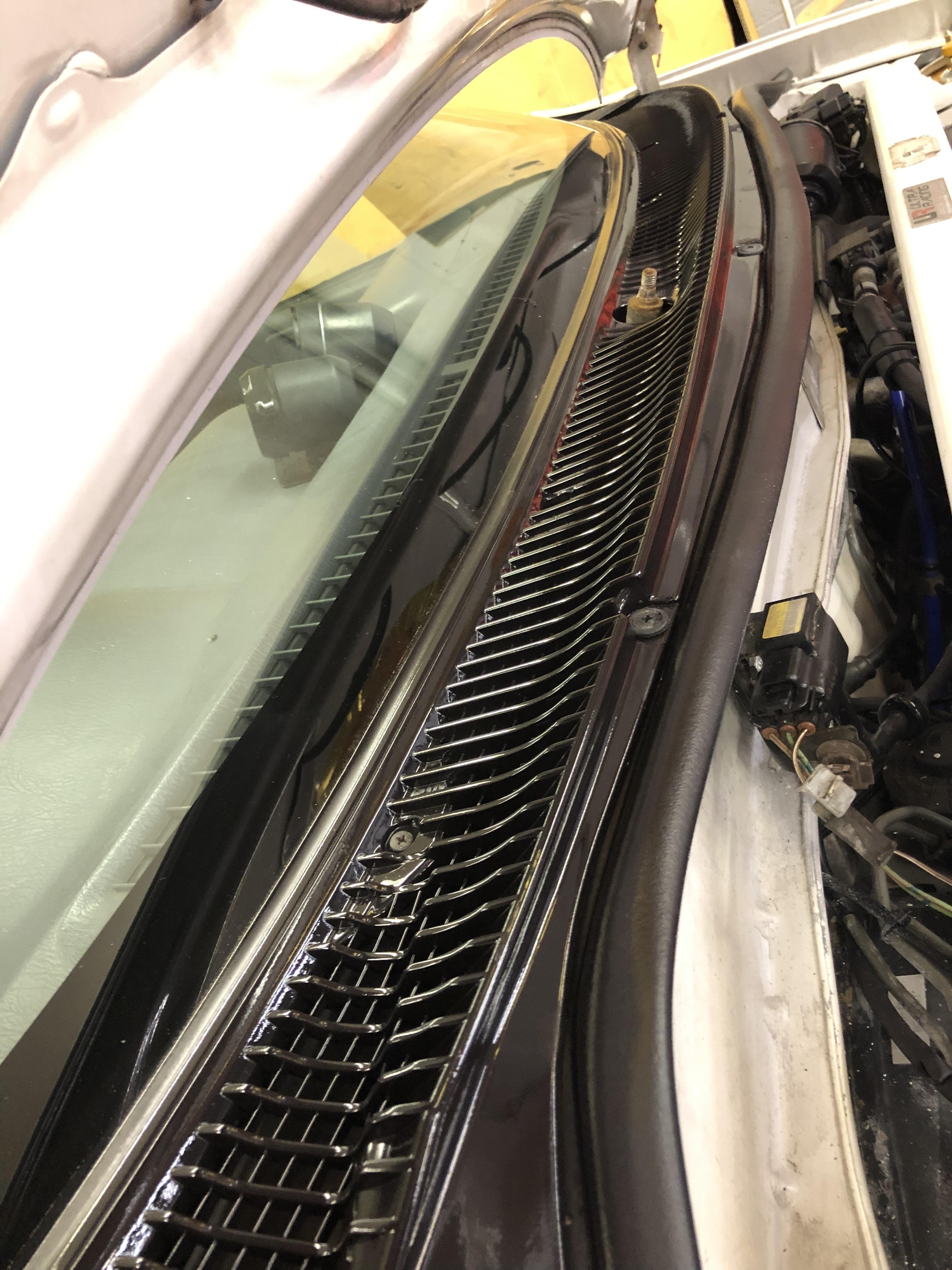

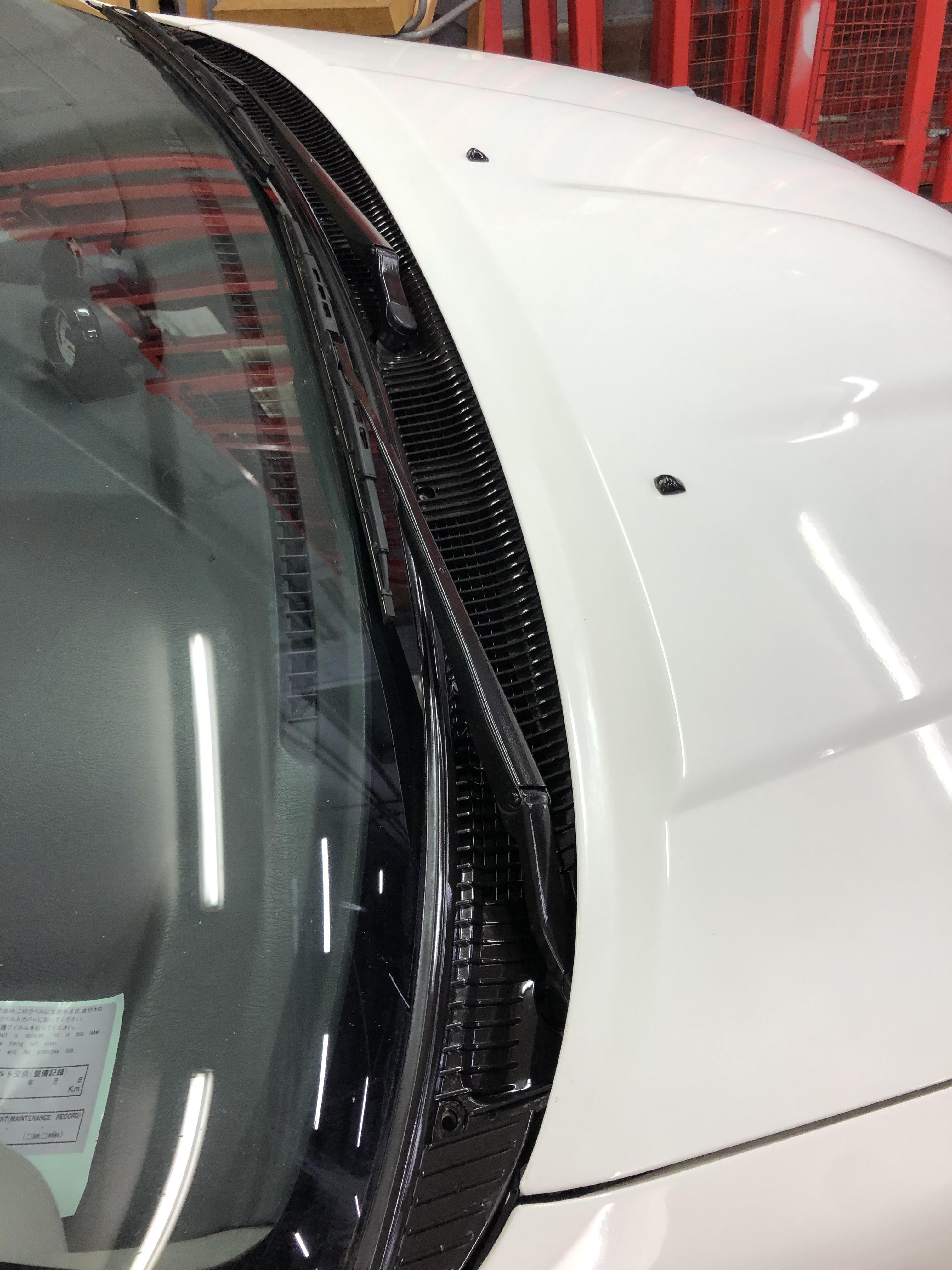

Sefton-EP91 Posted February 5, 2019 Author Posted February 5, 2019 (edited) Gave the wiper arms and scuttle panel a refresh as they were looking faded! Now good as new.. Edited February 5, 2019 by Sefton-EP91 Quote
garbs Posted February 7, 2019 Posted February 7, 2019 Nice! Have they been re sprayed or had a special plastic back to black treatment? Quote
Sefton-EP91 Posted February 7, 2019 Author Posted February 7, 2019 2 hours ago, garbs said: Nice! Have they been re sprayed or had a special plastic back to black treatment? They have been painted mate Quote

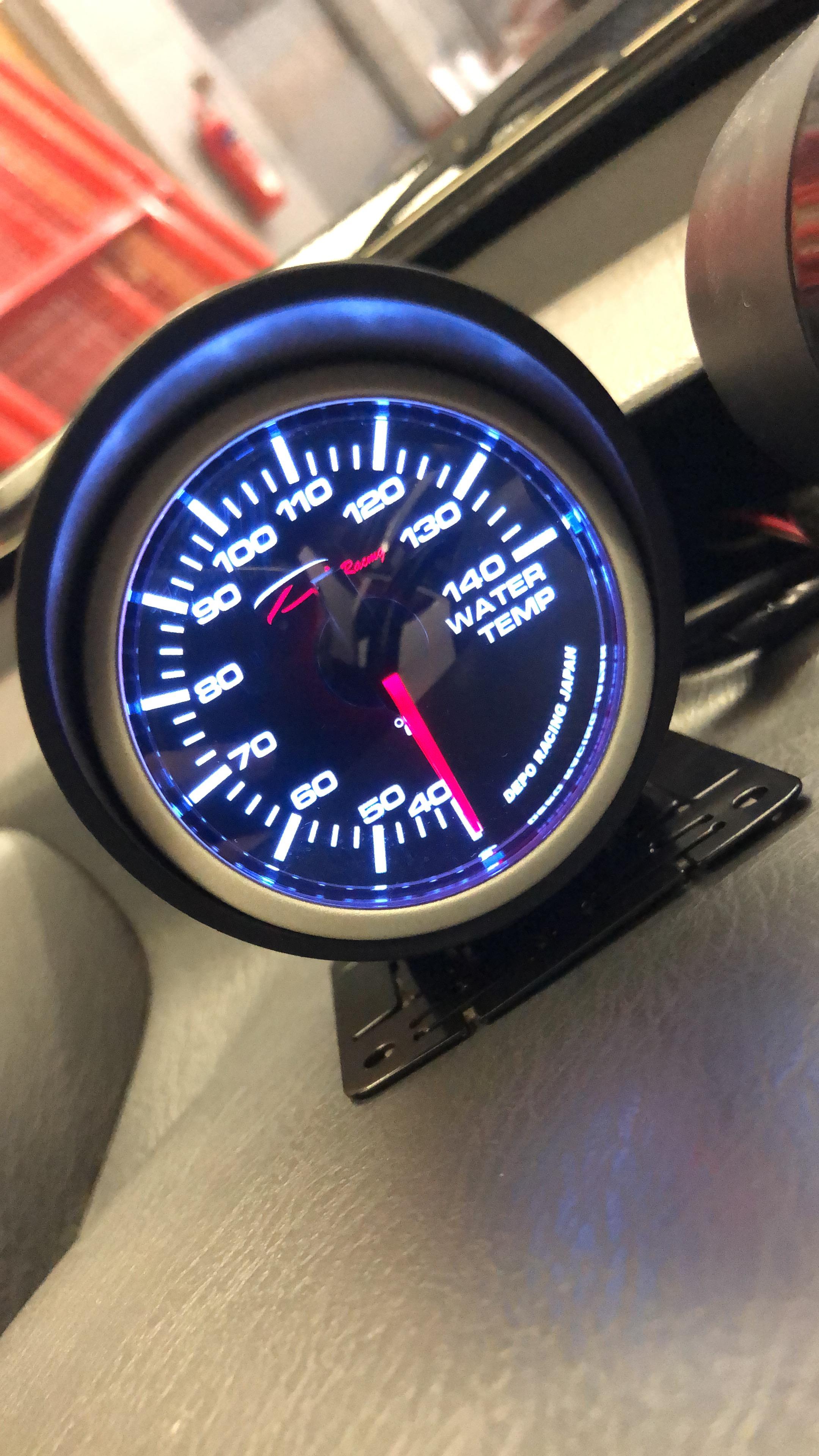

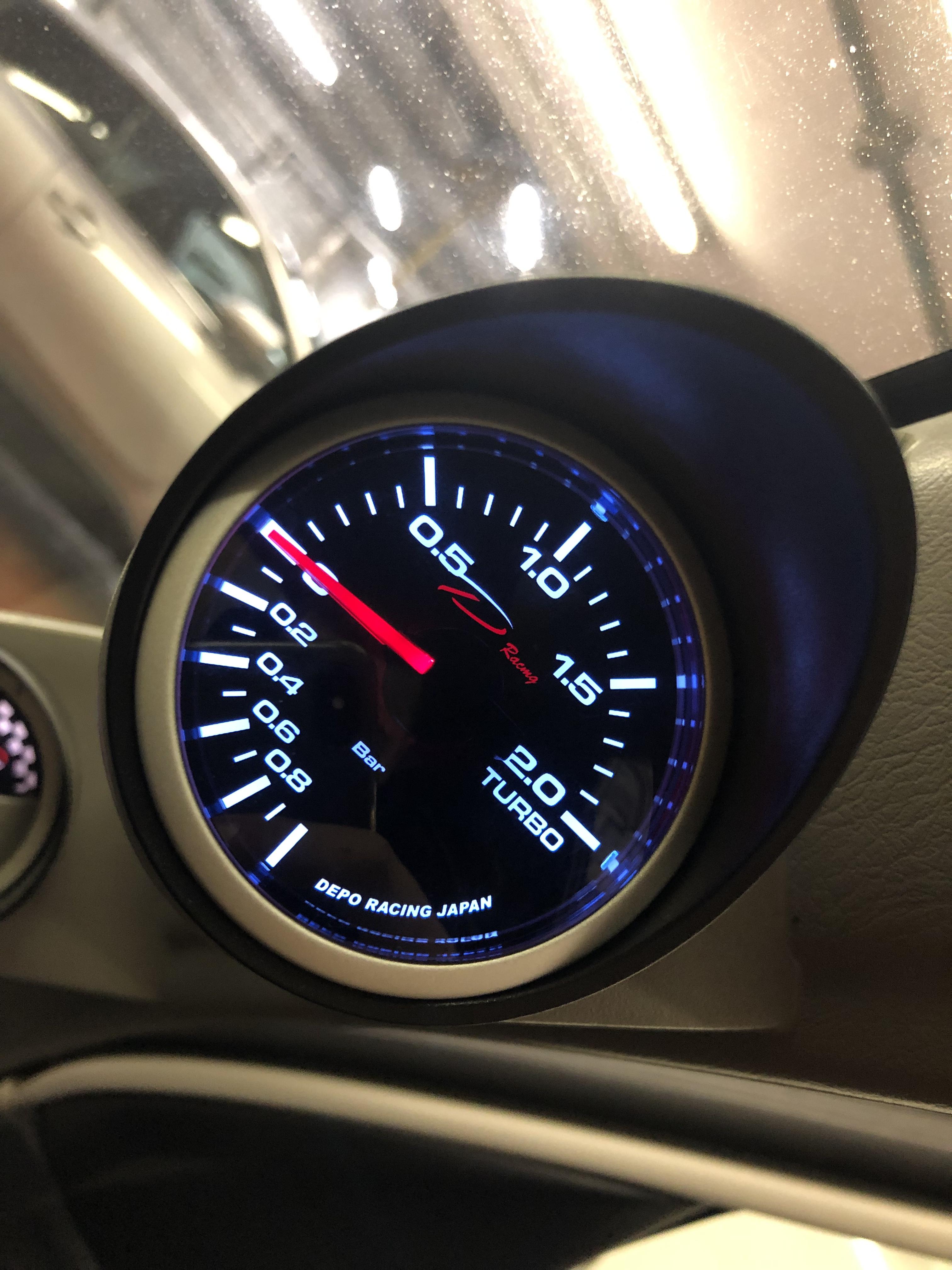

Sefton-EP91 Posted February 12, 2019 Author Posted February 12, 2019 So I managed to get the new boost gauge and water temp gauge wired in, the boost gauge is plumbed up aswell although the water temp gauge I’m waiting for an adaptor to arrive so will be sorted on Thursday/Friday. Quote
Sefton-EP91 Posted February 13, 2019 Author Posted February 13, 2019 Gave the Glanza a wipe over today, general tidy up inside aswell. She’s having a new alarm fitted tomorrow, I will give her a small drive to have it fitted then back into her space, this is how she is currently standing! Quote

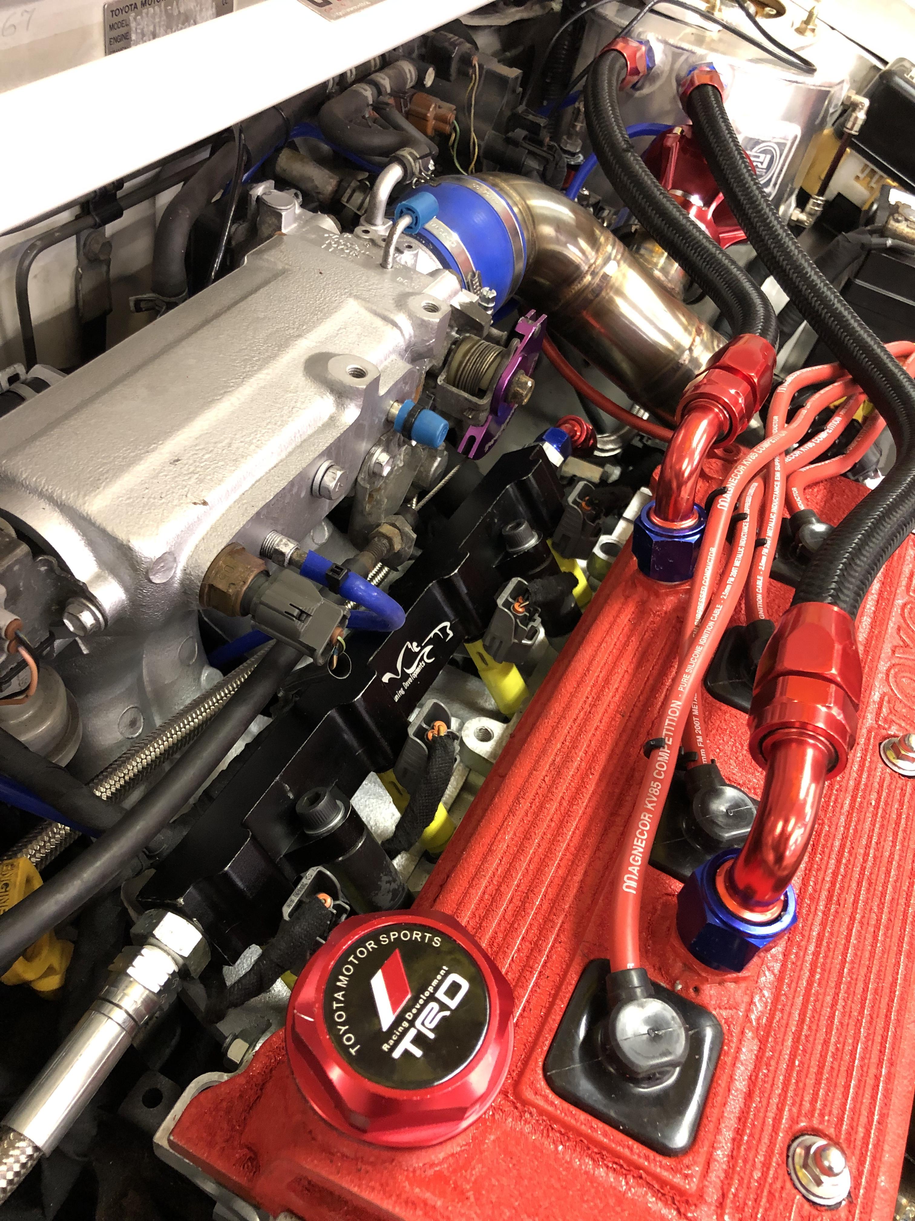

Sefton-EP91 Posted February 19, 2019 Author Posted February 19, 2019 New TD fuel rail and TD 430cc injectors fitted, I sent the ME221 Standalone back to ME to have a base map loaded and received that back, so I set at fitting that today. U unfortunately no photos of that! Although here’s the rail and injectors fitted! Quote
