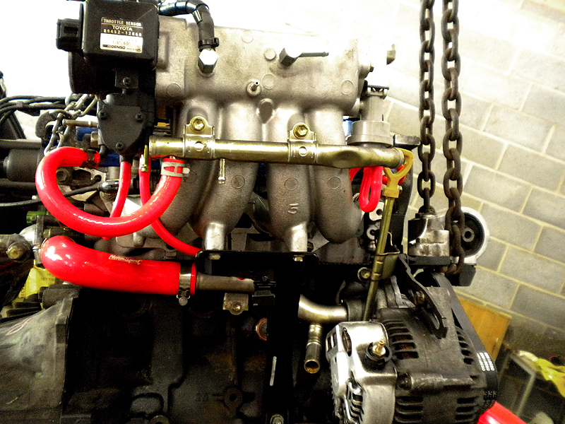

Socks Posted July 30, 2013 Posted July 30, 2013 Decent pic of back of a fte... Make sure all the ports are either blanked or go somewhere! Quote
LukeH Posted July 30, 2013 Posted July 30, 2013 the icv pulses air back through the rail at the back of the inlet, as picture shows above.have you tried unplugging it or blocking it off? to me it sounds like it would be that causing hunting rather than a leak.would have thought a vac leak would give you constant high idle. Quote
Amjad Posted July 30, 2013 Posted July 30, 2013 Wierd that a faulty Idle Control Valve, wold lead to an uncontrolled idle ;) Either that or TPS lol can't remember Quote
PaulStarletSR Posted July 30, 2013 Author Posted July 30, 2013 (edited) so the areas I've circled in blue...i thought both these went down to the power steerin vac lines near the rack? Edited July 31, 2013 by PaulStarletSR Quote

PaulStarletSR Posted July 31, 2013 Author Posted July 31, 2013 hmm. still think its my pipes, the FTE aboves pipes are routed different Quote
LukeH Posted July 31, 2013 Posted July 31, 2013 In that pic the empty vac port on the rail goes to the rack. U can just make out the otherjust to the left Quote
daniel_g Posted July 31, 2013 Posted July 31, 2013 The vac lines to the PAS rack are quite useless anyway, well they have a small purpose but never mind that. Take the vacs off the rack and make a loop for the ports. And do the same with the lines up top next to the inlet, loop the ports so none go to the rack just to see if it goes away. Also is the inlet mani, or vac rail cracked at all, even the tiniest hairline crack can cause hunting. Vac leak causes hunting, not constant high idle Quote

Idrees Posted August 4, 2013 Posted August 4, 2013 Air won't be leaking from the TPS screw holes..Those bits you've circled in blue don't connect to the PS rack either. There's 2 vacuums at the bottom of the throttle body that connect to the PS rack. What have you done with those? There's 4 vac pipes at the bottom of the TB in total. Where have you connected each one? Quote
