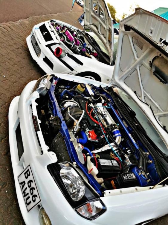

ok so ive been meaning to type this out for a long time. But everytime i come on i get glued in reading other build threads, i have owned my glanza for about 10months roughly.im all the way in botswana.and this site is what made me go buy one.ive owned evo 4 and 7s but honestly having a glanza is just more pleasurable. any way enough chit chat i will post up what i can and if it all goes well doing so.
ive purchased some parts over time been collecting and still am.so heres a list and some pics.appologies if its not all in order :) .

a few pics from what i have at the moment and will update with time. and also hopefully will be re posting everything in order once i get to know how.
hopefully this post comes through and you all like. :D

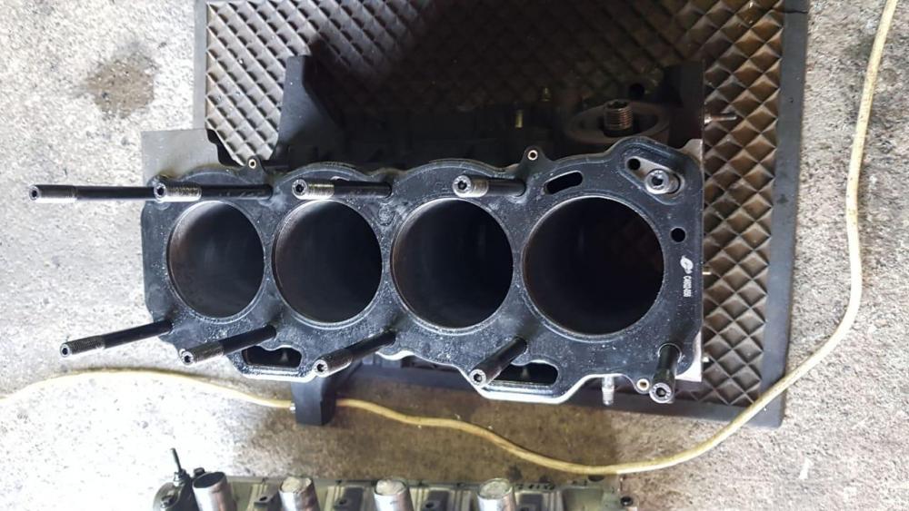

ok so finally got time to post this up, progress will be slow as builders are 400km away across the border. bottom end has been sent it to get all the forged parts fitted.
heres a few pics of the stripping. havent taken pics of everything but something i guess.
parked away ready to get stripped.
im scared of confusing bolts so i tried taking out everything in one piece.
My friends ismail and shafeeq at work.(they got fedup of me wasting time) so they came and pulled the engine out themselves.
engine on stand waiting patiently for my friend Alain ,strict warning not to touch.
And then i come home to see Alain has totally butchered everything ,again strict warning to lock up and not touch his lay out :p
good help from friends to take out engine. waiting on a few more parts so i can get cracking with the bottom end.

This update was long overdue, the block is nearing completion , car needs to get prepped for full re-spray. Then assmebly and then ummm send it 1200km away to get tuned lol
