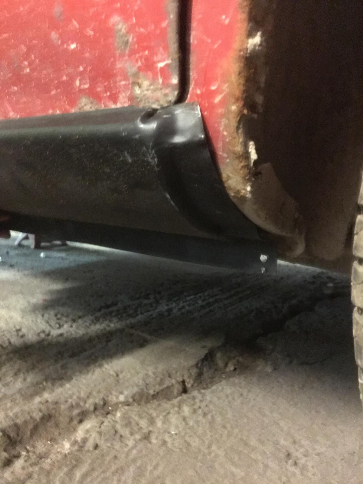

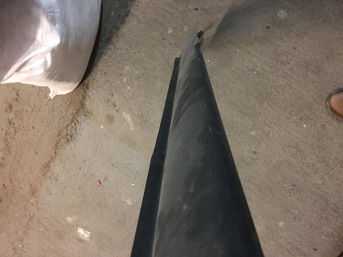

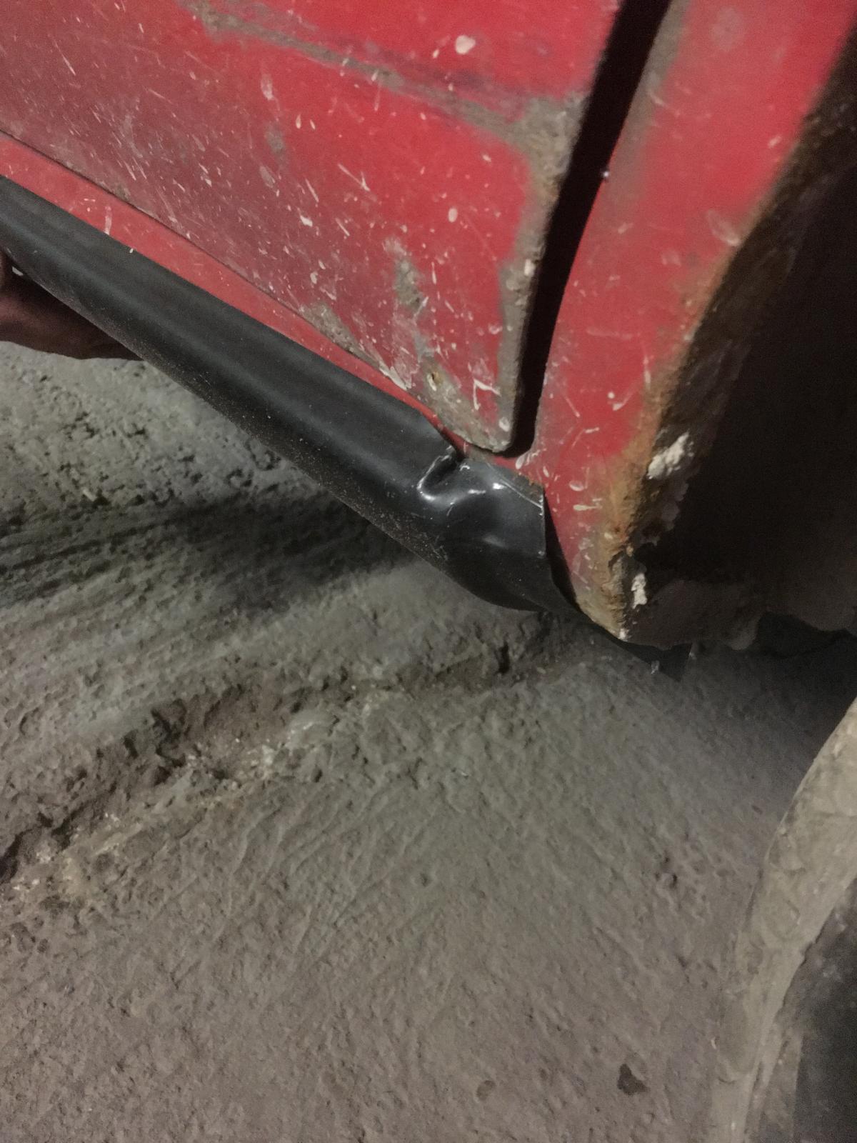

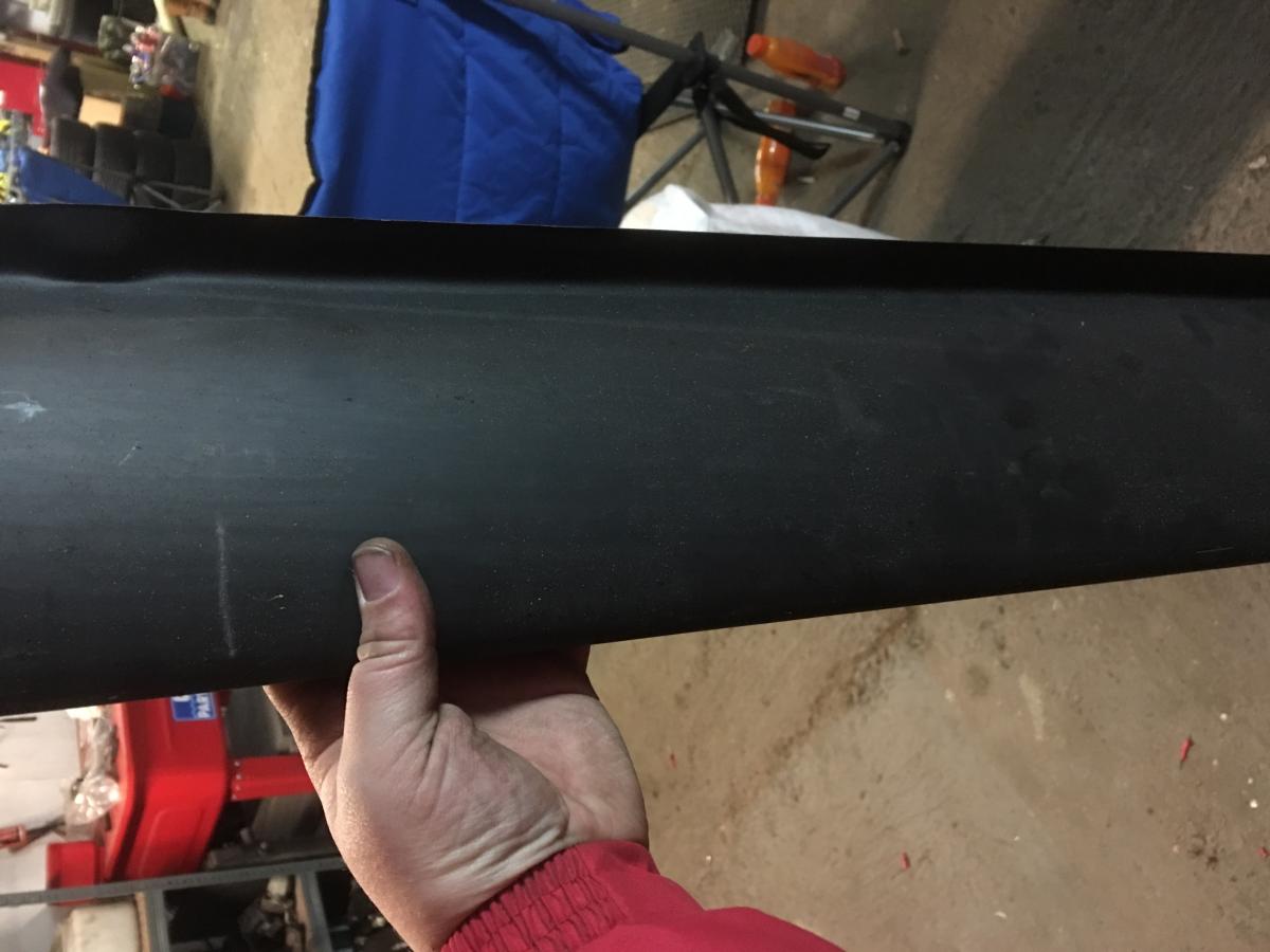

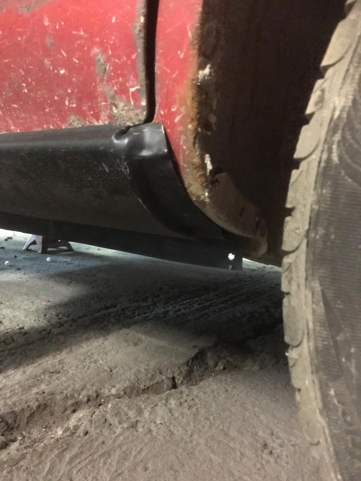

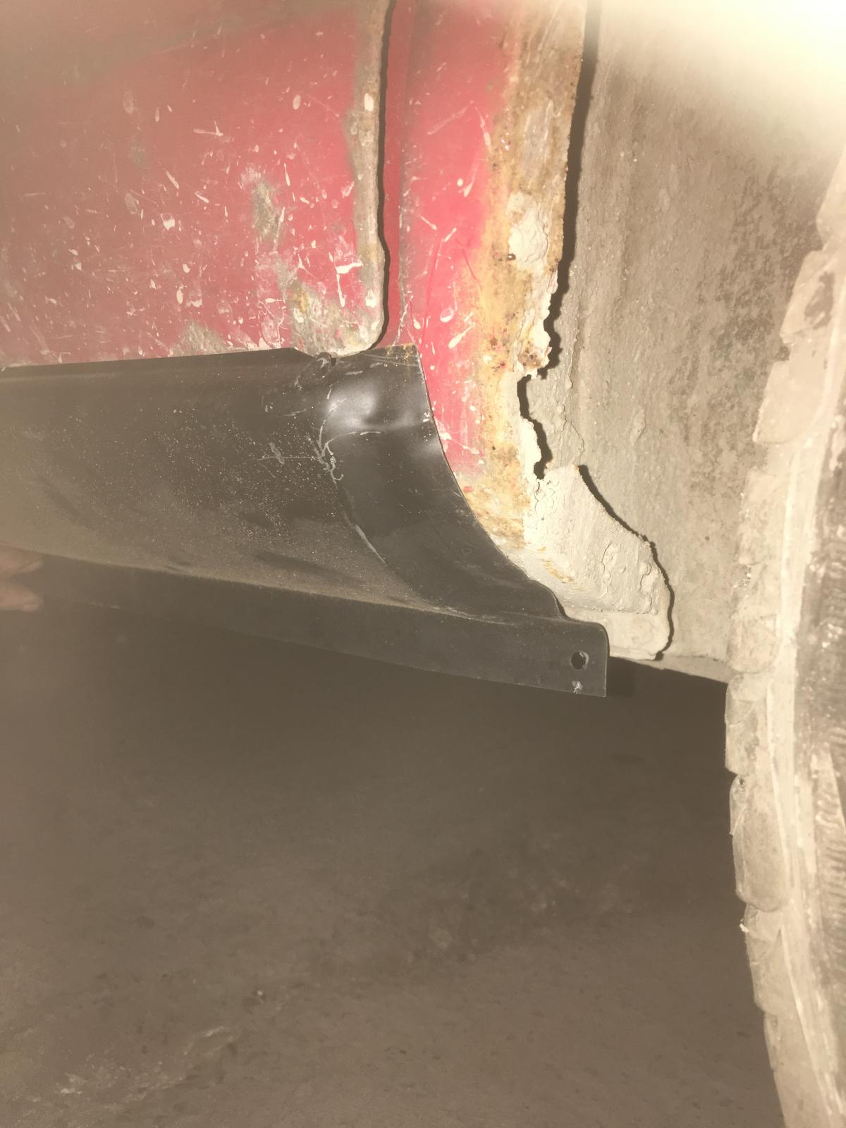

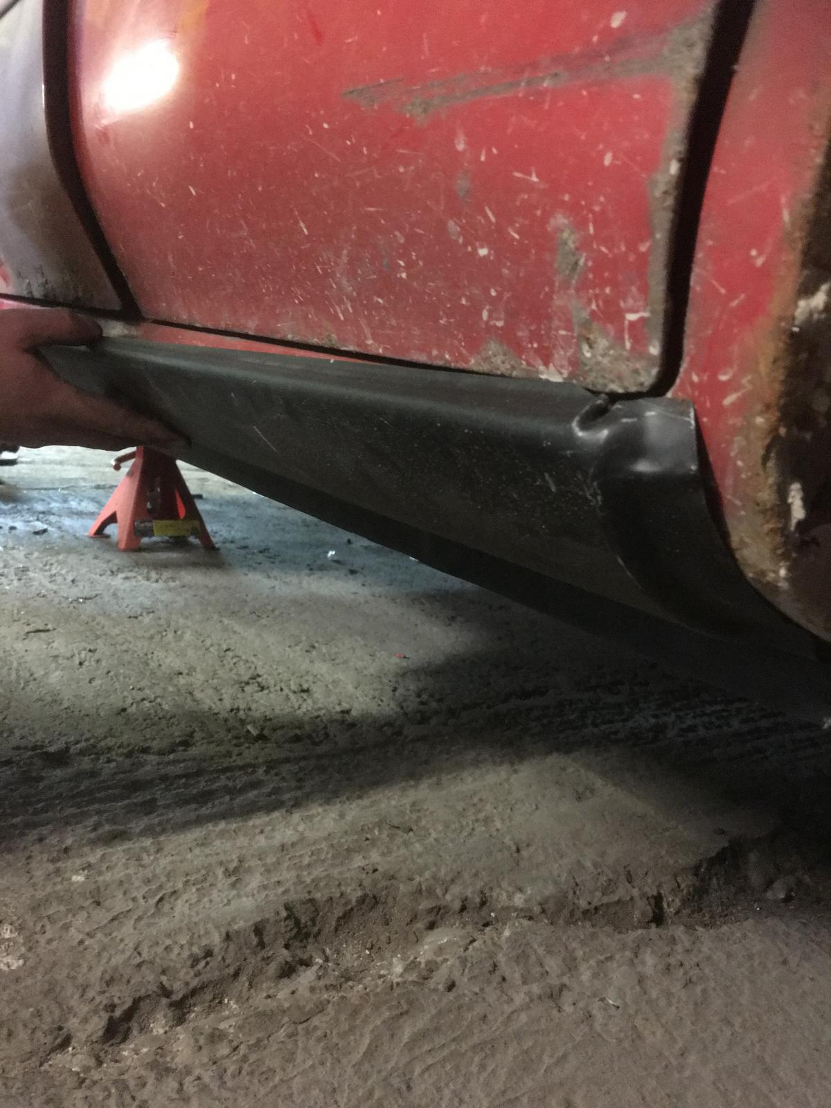

blob212 Posted October 20, 2016 Posted October 20, 2016 (edited) I know this is an old post but thought id post confirmation that Toyota have discontinued glanza sills and yes fiesta Mk 3 5door sills do work as a replacement with a little cutting and beating. I stumbled on this post a few months ago trying to find a solution to my rusty sills so hopefully this will help anybody in the same boat Few picks of my v before and after fitting the fiesta sills Edited October 20, 2016 by blob212 Quote

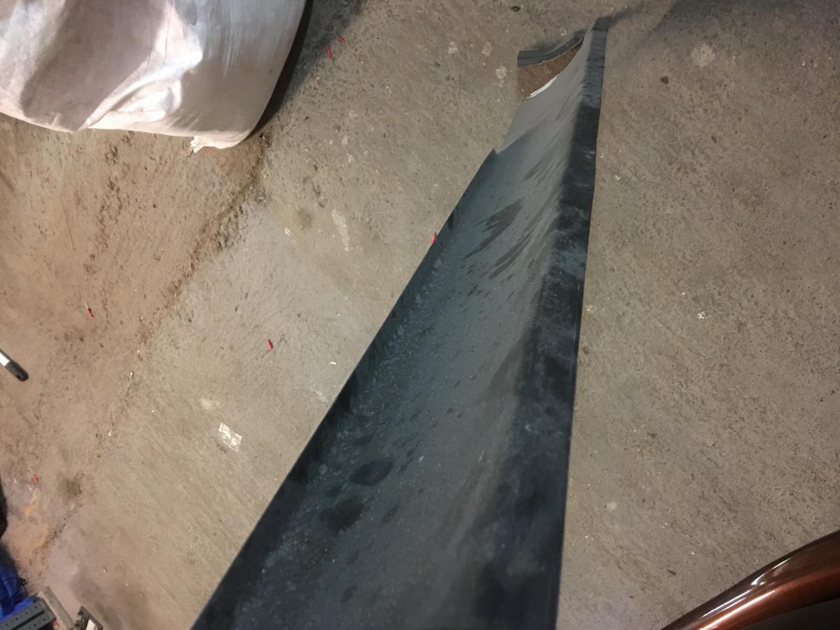

funny onion Posted October 20, 2016 Posted October 20, 2016 Ford KA sills also have a similar profile and are pretty easy/cheap to come by. they're a little longer than a starlet sill too which gives you a bit of room to play with Quote

funny onion Posted November 7, 2016 Posted November 7, 2016 Is that for a glanza charl?What are the GT options Sorry no Ford KA sills fit the ep8* chassis, should've mentioned that... Quote
funny onion Posted November 11, 2016 Posted November 11, 2016 Ford KA Sill held up against an EP80 Sill for anyone interested. Profile is nearly a perfect match to the P8 chassis Quote
