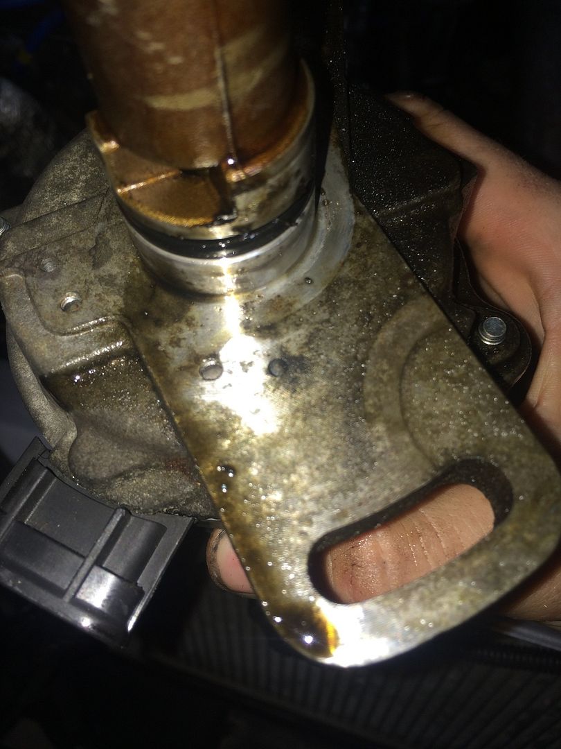

Bussey Posted August 7, 2015 Author Posted August 7, 2015 I run trd hg becuase of the stories of athena headgaskets..James another thing to check..The o ring on the distributor that sits inside head, is prone to failure and i had a similar mess to what youve got and i thought was headgasket till i read somewhere in tgtt.Woah, never thought of that!! Cheers man I'll check that later Quote

maddox710 Posted August 7, 2015 Posted August 7, 2015 Mine used to look like it weeped oil turned out to be the valve cover at the back then it would run round when it got hot. Since I re sealed it it's dry as a bone Quote
Bussey Posted August 7, 2015 Author Posted August 7, 2015 Cheers will, I'll have a good look shortly, hopefully it's not the HG, oil was defiantly getting thin last night, so more than likely it's been running onto the block from somewhere,Fingers crossed Quote
maddox710 Posted August 7, 2015 Posted August 7, 2015 Cheers will, I'll have a good look shortly, hopefully it's not the HG, oil was defiantly getting thin last night, so more than likely it's been running onto the block from somewhere,Fingers crossed Mine leaked on the left hand side where the cam caps went over the camshaft Quote

Bussey Posted August 7, 2015 Author Posted August 7, 2015 Mine leaked on the left hand side where the cam caps went over the camshaftHopefully this is THE problem, it was defiantly A problem either way, big box of spare O rings came in handy All back on, cleaned up and obviusly a new rubber on there.Gonna let that sit for a bit on some sealant them I'll find out. Quote

jayc-glanza17 Posted August 7, 2015 Posted August 7, 2015 James let me know if the o ring fixes it? Quote

Bussey Posted August 8, 2015 Author Posted August 8, 2015 Great news! Cars all sorted, myself and weeman checked the head bolts today, all still fine at 60nmTurns out it was indeed the dizzy O-ring, and I think a tiny bit was contributed by the rocker cover , all sorted out though, so no more oil leaks here Still on for Japfest 2 then!Oh and cheers for mentioning the dizzy jay Quote

jayc-glanza17 Posted August 8, 2015 Posted August 8, 2015 Glad was the o ring buddy..Sometimes its an easy fix.. Quote
Bussey Posted August 9, 2015 Author Posted August 9, 2015 hail the lord thank god im happy for u kid :) :) Trust me man I'm happier Glad was the o ring buddy..Sometimes its an easy fix..Yeah cheers man, was afraid I was gonna have to drain the bank account again! Quote
jiggaman_16 Posted August 9, 2015 Posted August 9, 2015 Glad its only that....that o-ring always fails over time Quote
Bussey Posted August 9, 2015 Author Posted August 9, 2015 Glad its only that....that o-ring always fails over timeOr when the guy putting the new one on manages to nip a chunk out Quote

Bussey Posted August 11, 2015 Author Posted August 11, 2015 (edited) I dare tempt fate by saying this. But everything's sorted and she's running perfect at the minute.No more oil leaks, stepped up the O-ring size on the dizzy and that sorted the oil escaping from there.Changed all 4 injector O rings as 1 decided to make itself into 2 yesterday. Also had a fiddle with my suspension today, I know people say don't touch the preload. But it seemed no matter what I did with the BC's the back would stay bouncy as hell. Lowered the preload slightly on both sides then set them to 20. Already miles better! Back feels a lot more in touch now!Tommorows aim is to bleed brakes again, clutch again and check all engine mounts bolts are still in the same location. Then she's all good for JF2. Edited August 11, 2015 by Bussey Quote
