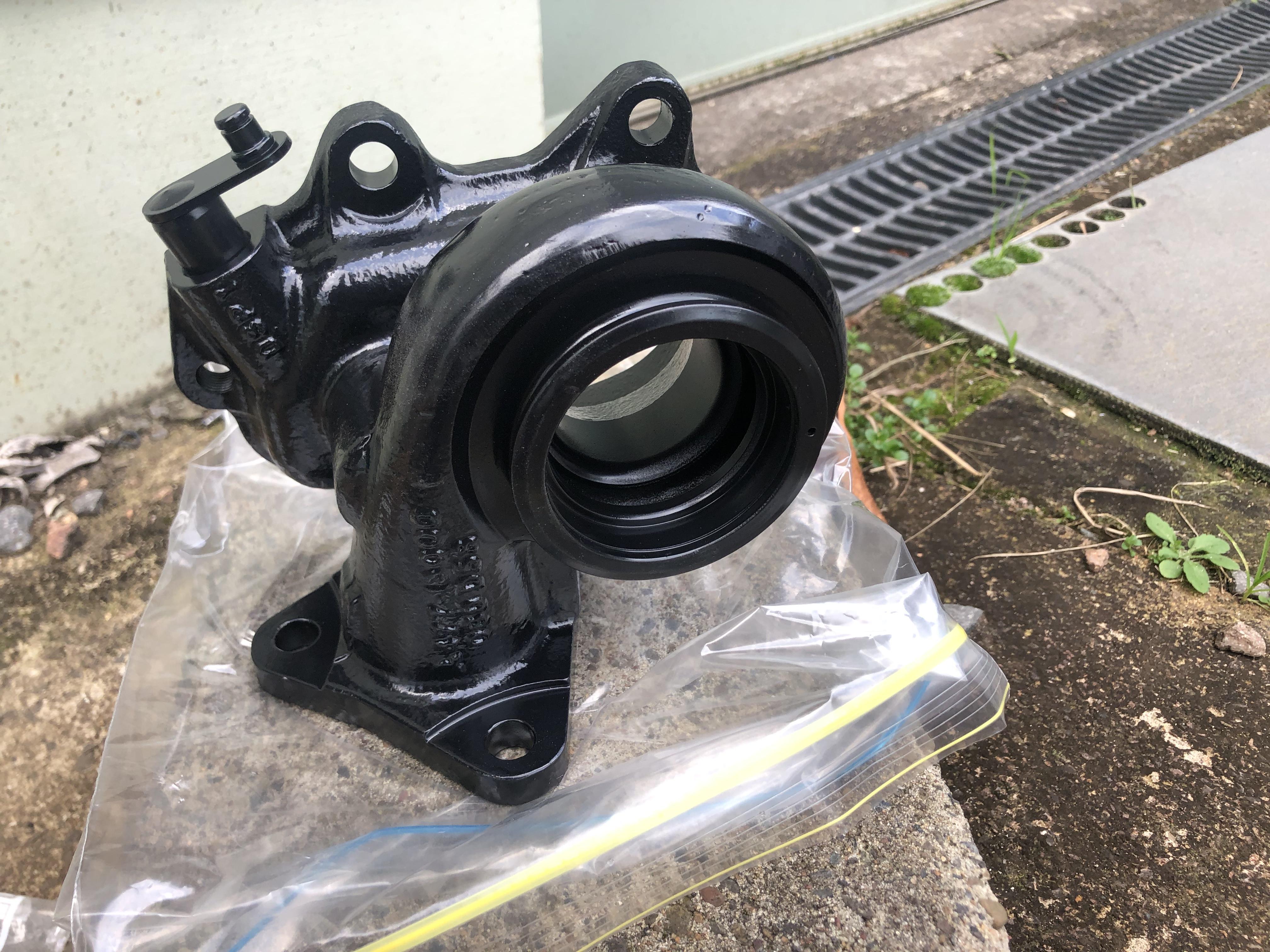

Im going to get the original 6cm housing Ceramic coated and then swap it over essentially making it a stock TD04L again.

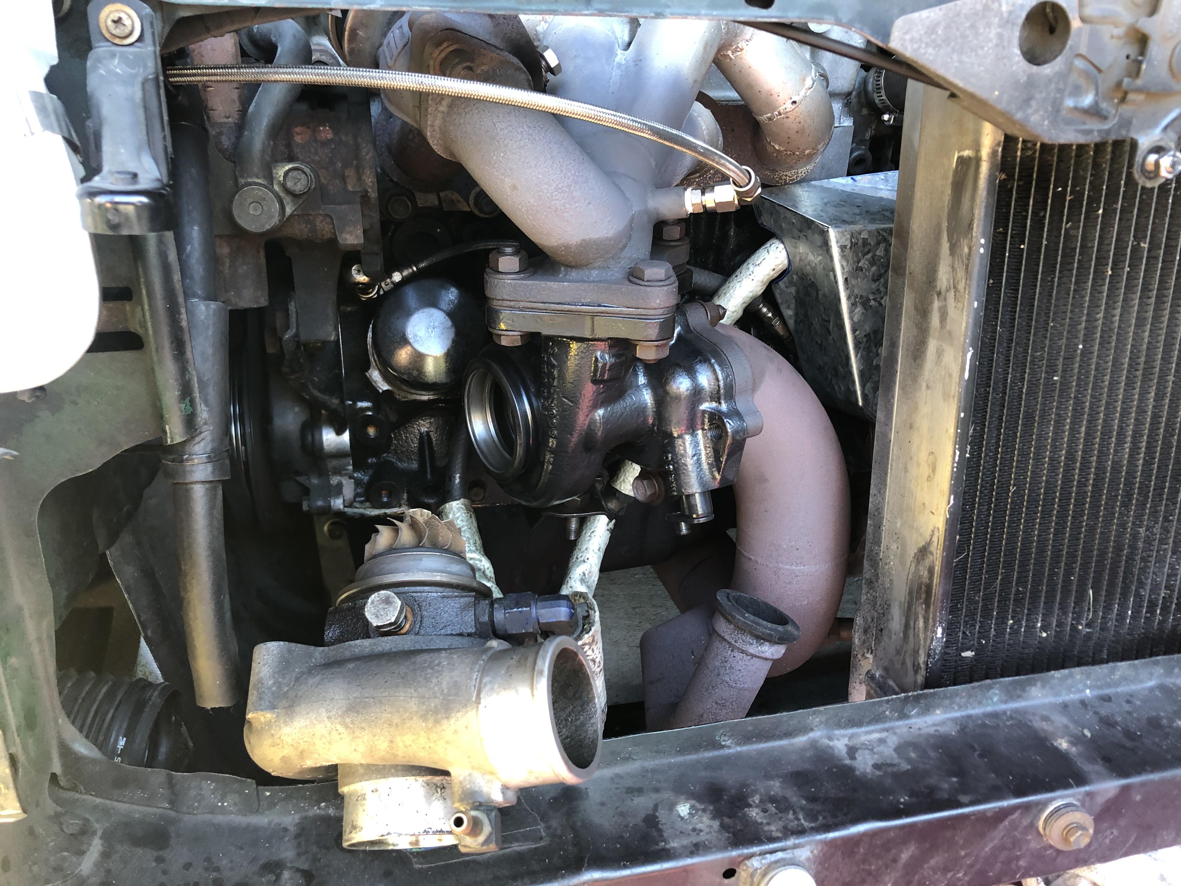

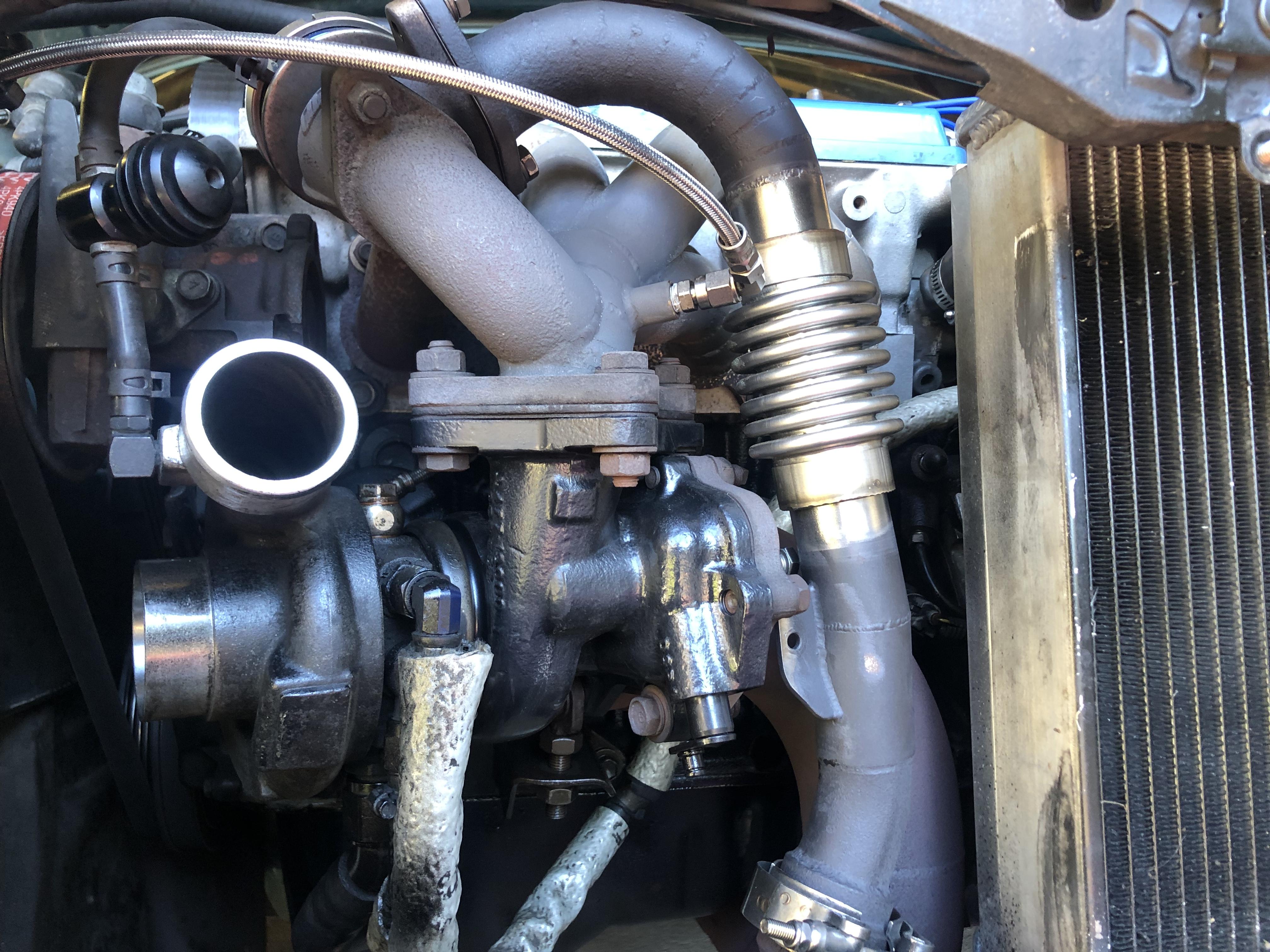

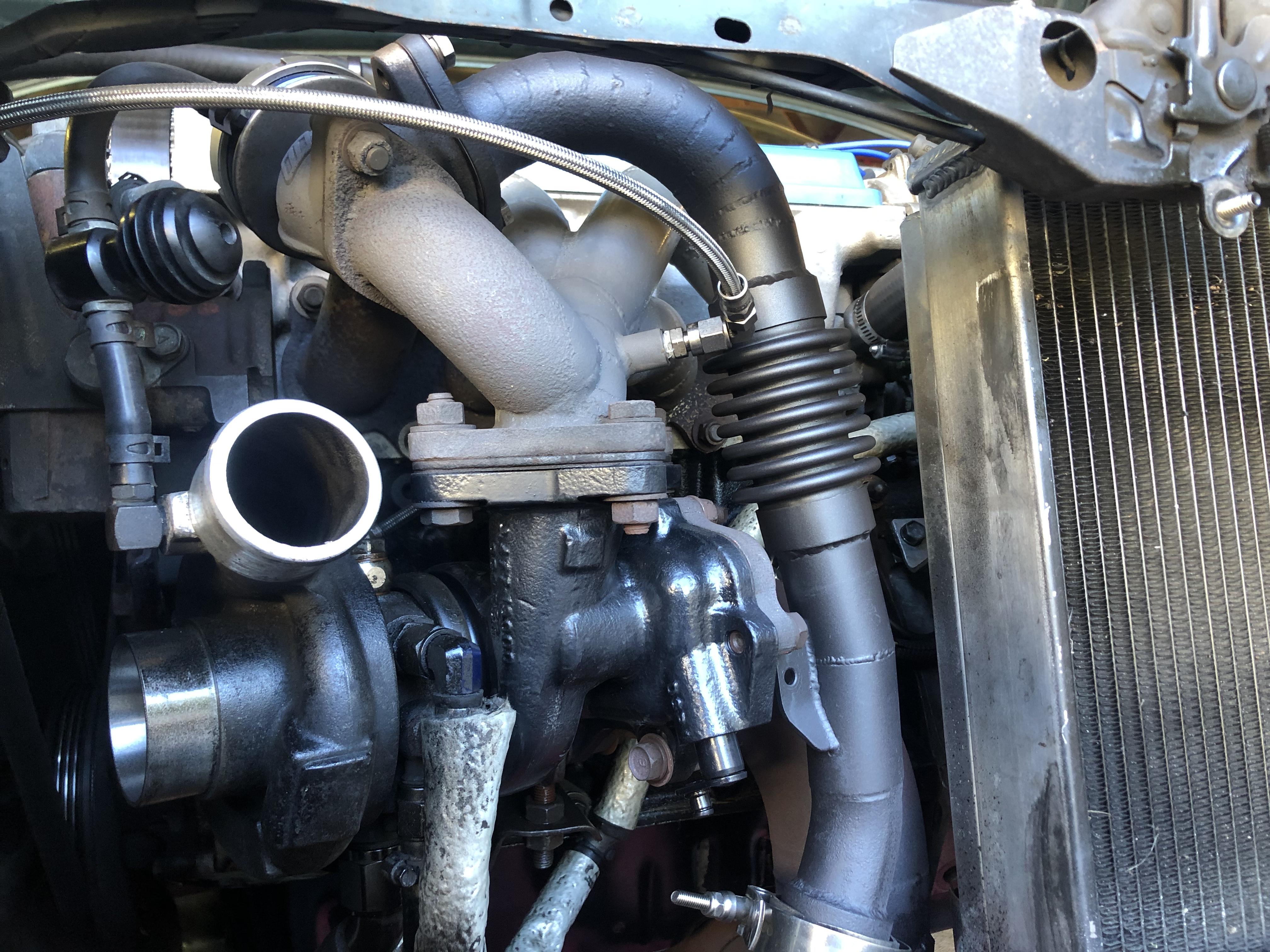

Just a couple pics from last weekends turbine housing swap. With any luck I’ll be able to get som data logs done today . I also added a flex joint to the external gate recirculation pipe.
As promised ive got out and done some testing on the new setup with great results.
Swapping over to the stock TD04 6cm rear housing has seen a big drop in turbine back pressure over the 4cm unit I had been using.
18.75% reduction in back pressure. From 32psi down to 26psi Making the ratio now 1.33:1 as before it was 1.68:1   (Intake manifold saw 19-19.5psi)

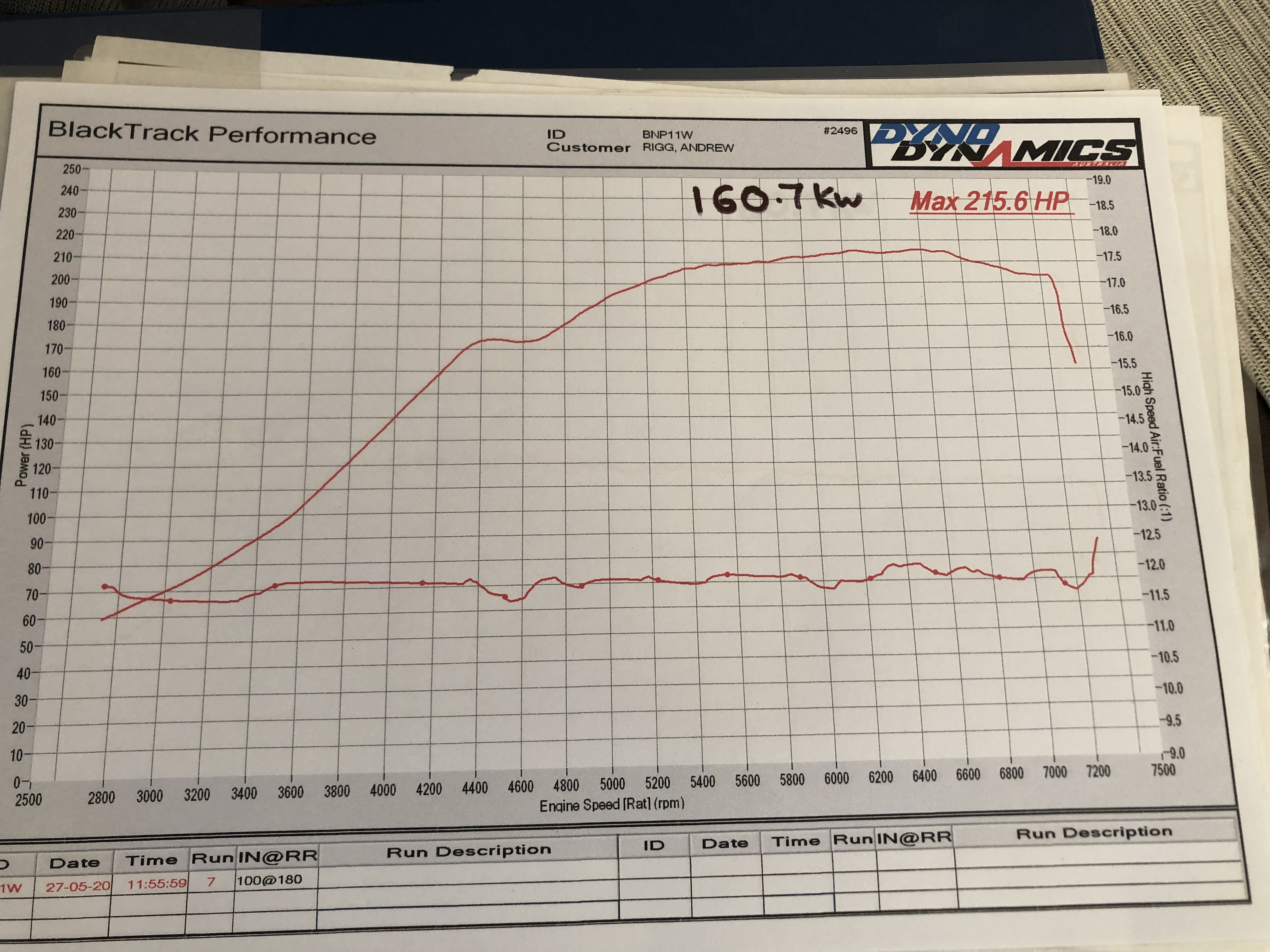

would have thought. Option this with a billet compressor and or step it up to a 15T/19T. Im really not after any more power as it was tuned with the small housing and still made 160kw to the wheels but less back pressure will make for an overall more efficient setup.
Im going to try get this on a dyno again if i can , see what the numbers are.
