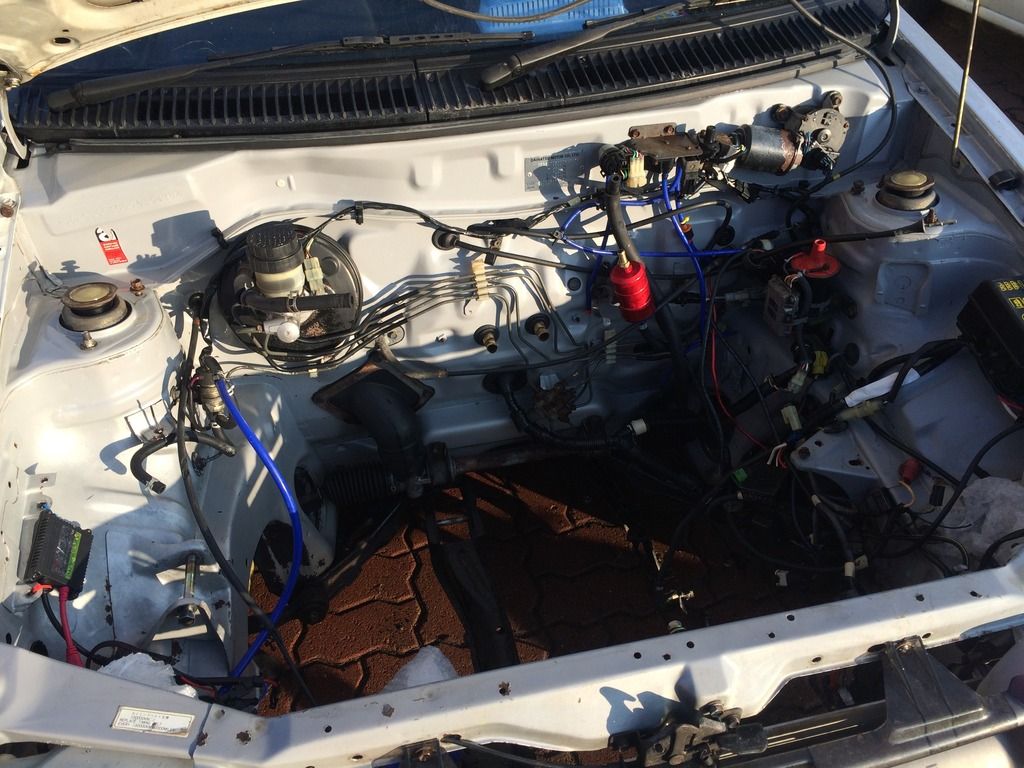

Ollieh17 Posted March 14, 2016 Author Posted March 14, 2016 Bay washed this weekend, came up really well with screwfix no nonsense degreaser, slight touch up in a few places but real happy with it: Also got the bits back from the powdercoating, real happy with the finish and colour. Just a bit annoyed they have done inside the sump and rockercover which is gonna be a pain to sort out. Quote

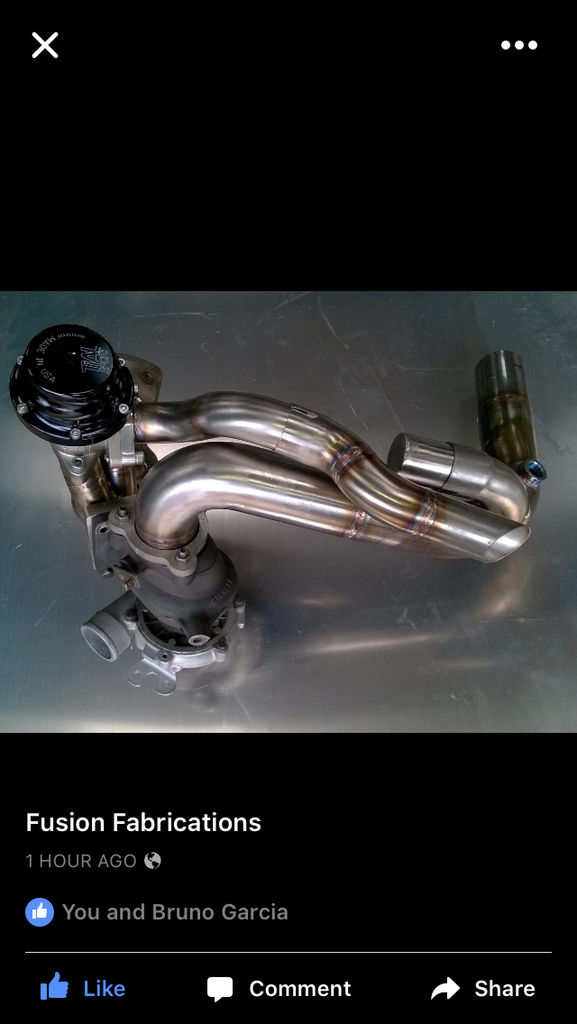

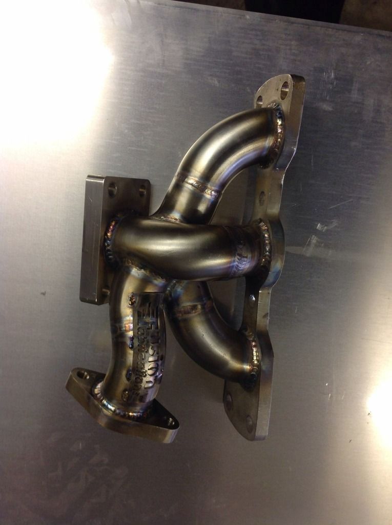

Ollieh17 Posted April 28, 2016 Author Posted April 28, 2016 (edited) Car is now in for the custom turbo kit at fusion fabrications. Omex 600 in the pipeline too. Cant wait! Edited April 28, 2016 by Ollieh17 Quote
Ollieh17 Posted May 15, 2016 Author Posted May 15, 2016 Turbo kit done, waiting on custom double diaphram clutch then choice wether to map on emanage or go all out on a omex Quote

Ollieh17 Posted May 25, 2016 Author Posted May 25, 2016 Finally got the kit all fitted and the turbo was duff car is seriously missing the action this year. Do have a custom double diaphram clutch custom drive plate on the way, good up to 200lbft. Also yellowspeed coilovers and 440cc injectors on route. Almost ready for mapping see if it can break 200hp mark Quote
Ollieh17 Posted June 1, 2016 Author Posted June 1, 2016 Turbo kit all fitted and running at 0.8bar after a simple fix. Sounds insane! Will be routing back into the downpipe as i prefer the induction chatter noises.similar power delivery to a starlet with a td04. Should make good power with some proper boost Brand new delphi 440cc injectors for a mustang etc. These are pretty cheap and just need a bit of trimming to fit the standard plugs. Maybe a cheap available option for starlets too? Quote
