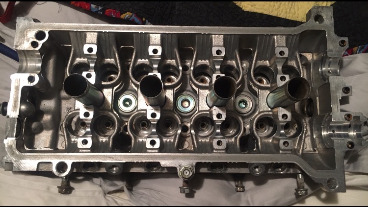

SpikeyJp_68 Posted December 5, 2016 Author Posted December 5, 2016 did you dry hone them ????Used a shit tonne of wd40. I thought myself they looked a bit 'flakey' almost Quote

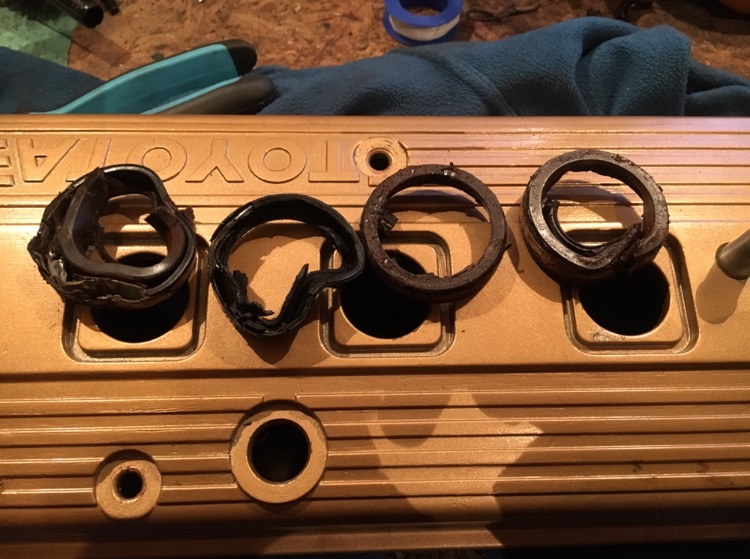

SpikeyJp_68 Posted December 18, 2016 Author Posted December 18, 2016 Didn't think spark plug tube seals would be so hard to remove.. Quote
5e colin Posted December 18, 2016 Posted December 18, 2016 you really went to war on them ha ha Quote
SpikeyJp_68 Posted December 18, 2016 Author Posted December 18, 2016 you really went to war on them ha ha Hammer and a chisel I tried the pliers and that just broke the brittle rubber off so I thought right you're in for it now hahahaha Quote
EP70-PT Posted December 19, 2016 Posted December 19, 2016 I use a trick that involves an allen key, put the "L" in the spark plug hole and above the seal, give it a tap with a hammer and off they come Quote

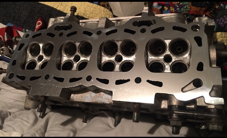

SpikeyJp_68 Posted December 20, 2016 Author Posted December 20, 2016 Mmmmm fresh..Will be doing a final check on the valve seats tonight then I can bring it into work and clean it all up then assemble it Quote
SpikeyJp_68 Posted December 20, 2016 Author Posted December 20, 2016 nice face that is Was pleasantly surprised when I got it Quote

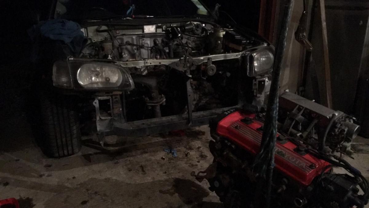

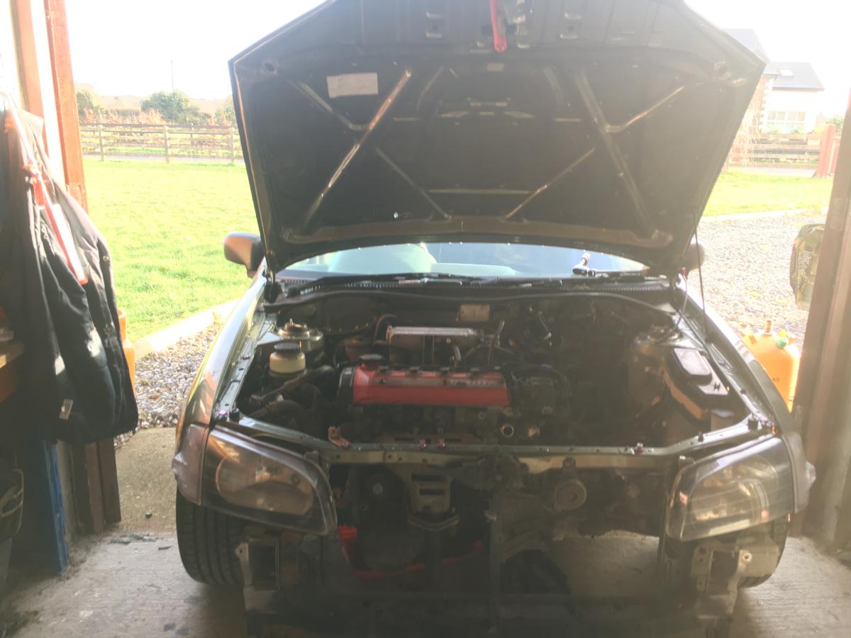

SpikeyJp_68 Posted December 24, 2016 Author Posted December 24, 2016 Decided to take the engine out today becuase how hard can it be.... About 9 hours, many many many swear words and plenty of cuts later it's finally removed. Quote

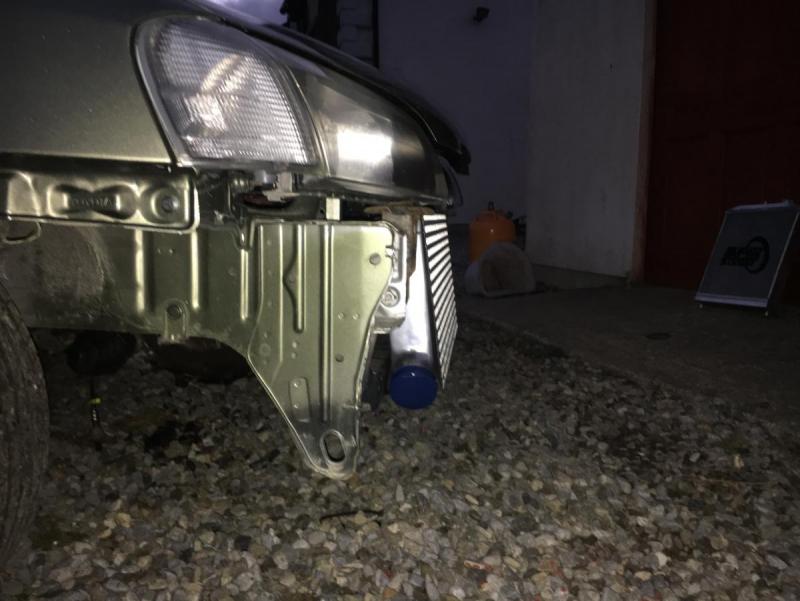

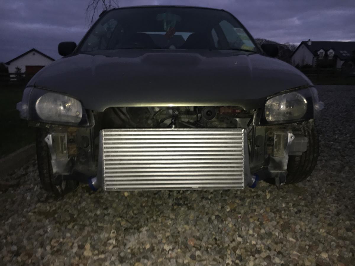

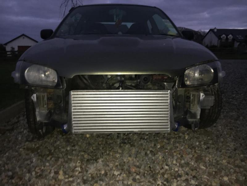

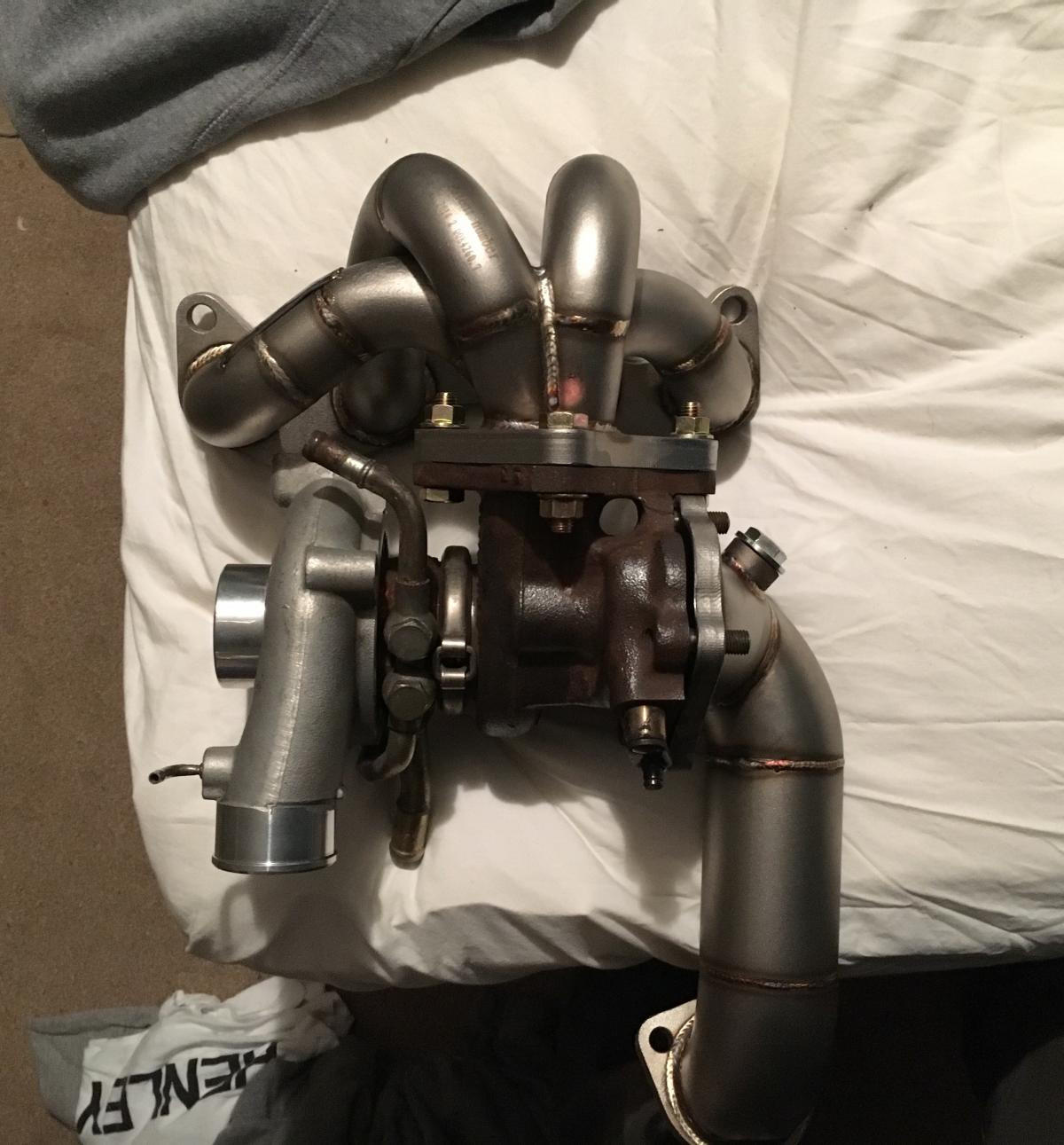

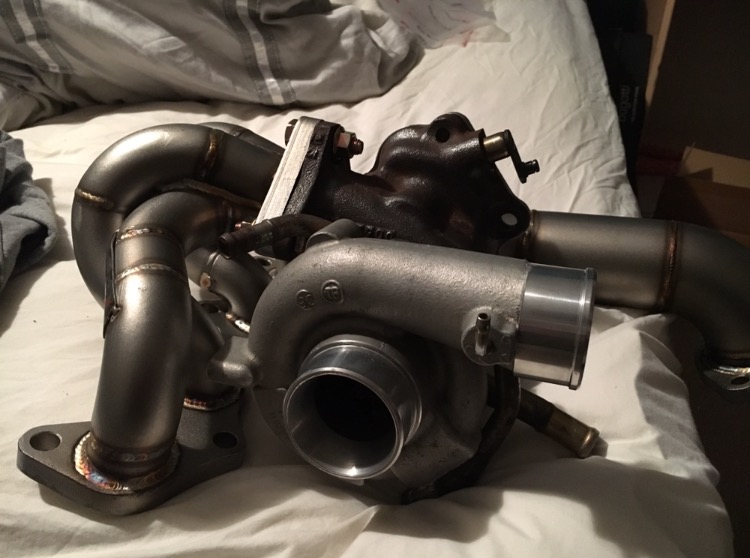

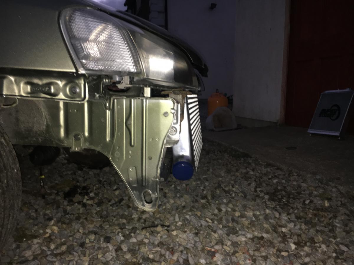

SpikeyJp_68 Posted December 27, 2016 Author Posted December 27, 2016 Intercooler has been mounted... bumper needs a tiny bit of cutting and the crash bar needs shaving on the rhs but fits really really wellTurbo kit mocked up aswellJust need to get bolts to attach the engine to the mount then I can build the bottom end. Just waiting on a valve spring compressor to get the head finished off Quote
5e colin Posted December 27, 2016 Posted December 27, 2016 the 2 middle top bolts of the manifold flange might be tricky i had to cut my nut down to squeez it in there where the runner shoots up you will see there the indentation Quote
SpikeyJp_68 Posted December 27, 2016 Author Posted December 27, 2016 the 2 middle top bolts of the manifold flange might be tricky i had to cut my nut down to squeez it in there where the runner shoots up you will see there the indentation Cheers Colin have you got yours braced ? Quote
glanzadude Posted December 27, 2016 Posted December 27, 2016 where did you get the turbo kit ( manifold & decate Quote
SpikeyJp_68 Posted December 27, 2016 Author Posted December 27, 2016 where did you get the turbo kit ( manifold & decateOff eBay it's a Jperformance kit. Seems to be good quality. Very heavy piece of kit Quote

MR-2 Posted December 28, 2016 Posted December 28, 2016 Wow, nice turbo/manifold setup. What are plans for oilfilter, relocated system with cooler maybe? Very big that intercooler, almost too big for Your boost Quote
5e colin Posted December 28, 2016 Posted December 28, 2016 (edited) FTE loom + standard management @4 -5 psi for the time being 0.8bar 10to 12 psi no bother !!!! yes manifold braced Edited December 28, 2016 by 5e colin Quote
SpikeyJp_68 Posted December 28, 2016 Author Posted December 28, 2016 Wow, nice turbo/manifold setup. What are plans for oilfilter, relocated system with cooler maybe? Very big that intercooler, almost too big for Your boost I will be upping it to maybe 1 bar with management when I can. I'm just breaking it in on low boost 0.8bar 10to 12 psi no bother !!!! yes manifold braced Spot on Colin will look at getting that done Quote
EP70-PT Posted December 31, 2016 Posted December 31, 2016 Your build is awesome mate, really biting me to go turbo before paint now ahah are you using the fte thermo housing to cool your turbo? Cheers Quote
SpikeyJp_68 Posted December 31, 2016 Author Posted December 31, 2016 Cheers guys I appreciate the kind words I have a complete FTE head with the thermo housing except I'll be looping the lines and not running coolant through it Quote
5e colin Posted December 31, 2016 Posted December 31, 2016 that will be fine im running like that to fully stock management 0.8bar no lines to turbo i get 10.8afr in 3d at wot so fcd on order to see what stock ecu really can do ?? .9 or 1 ???? have an bits ordered tho for the waters Quote
SpikeyJp_68 Posted December 31, 2016 Author Posted December 31, 2016 that will be fine im running like that to fully stock management 0.8bar no lines to turbo i get 10.8afr in 3d at wot so fcd on order to see what stock ecu really can do ?? .9 or 1 ???? have an bits ordered tho for the waters I still have to order my afr & boost gauge before I fire it up Quote
