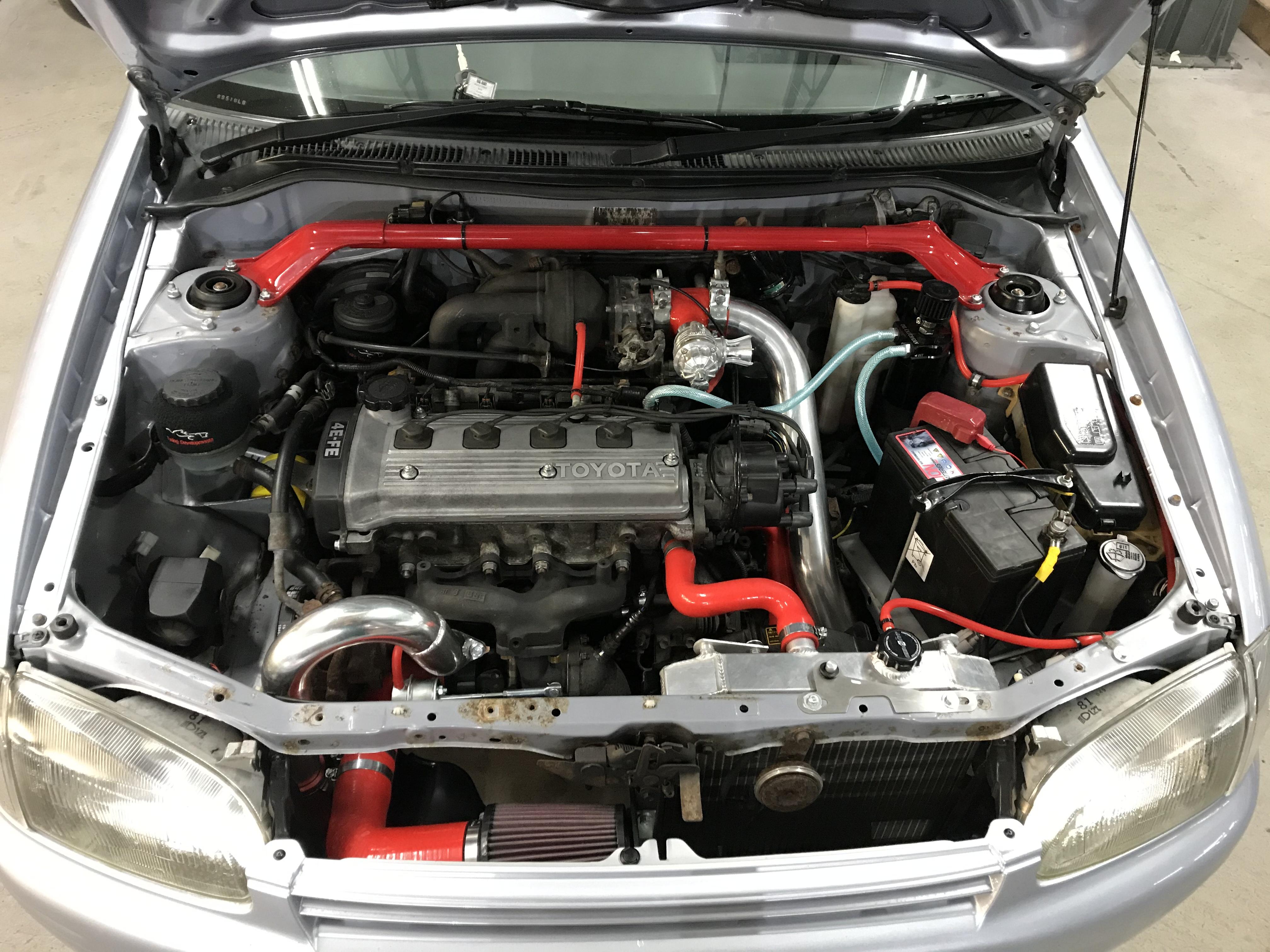

JamesG Posted November 28, 2020 Posted November 28, 2020 Looks great this, nice work . Has the wastegate been ported at all or is it standard size? Be interested to see how it does on the dyno at td. Quote
stevie82 Posted November 28, 2020 Author Posted November 28, 2020 11 minutes ago, JamesG said: Looks great this, nice work . Has the wastegate been ported at all or is it standard size? Be interested to see how it does on the dyno at td. Its been ported to help prevent boost creep Quote

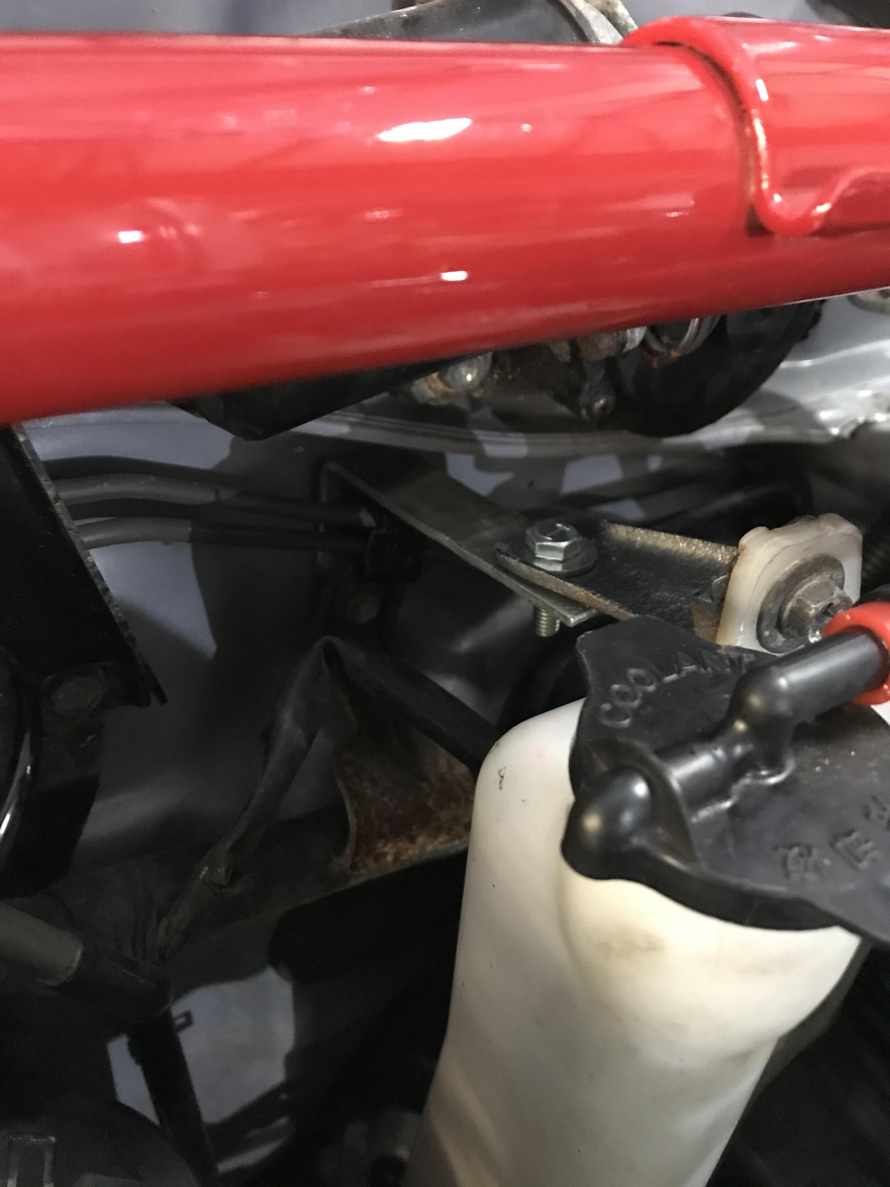

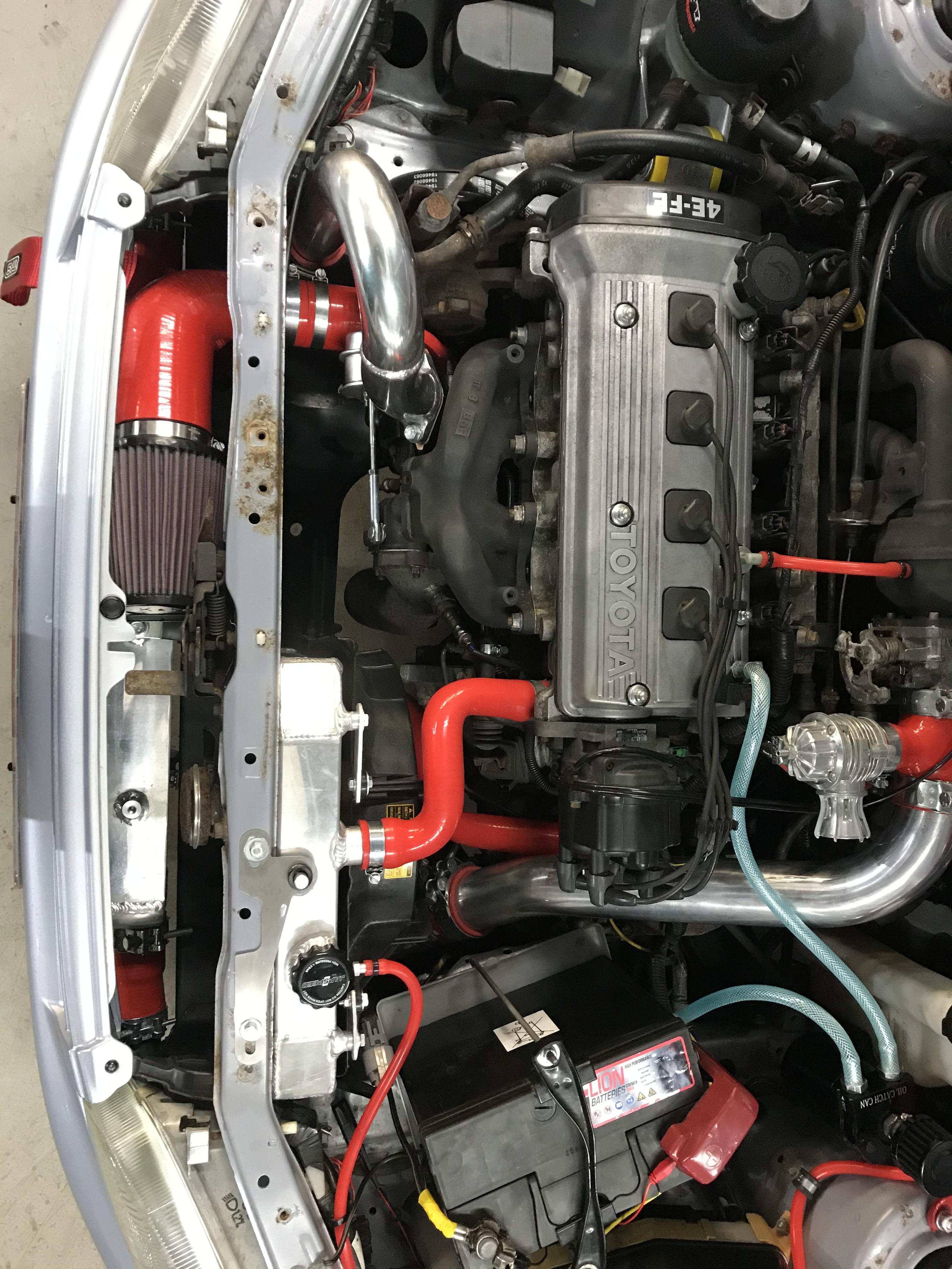

Pikey009 Posted December 1, 2020 Posted December 1, 2020 I might have a spare map sensor mate, will look tomorrow. How did you set your actuator up? Also, can you post a pic of the header tank bracket?- need to make one and it might save me a little time seeing another. Can you post a full size pic of your avatar? As it looks like a nice one. Really neat and tidy install with the fmic. Quote
Pikey009 Posted December 2, 2020 Posted December 2, 2020 Sorry, I’ve got an ignition module and ignitor unit Quote
stevie82 Posted December 4, 2020 Author Posted December 4, 2020 On 12/1/2020 at 8:54 PM, Pikey009 said: I might have a spare map sensor mate, will look tomorrow. How did you set your actuator up? Also, can you post a pic of the header tank bracket?- need to make one and it might save me a little time seeing another. Can you post a full size pic of your avatar? As it looks like a nice one. Really neat and tidy install with the fmic. It’s cool I’ve got a map sensor on the way 😀, I’ll get u a pic of the bracket tomorrow mate but it’s just literally a 90 degree piece of steel I bolted to the brake line bracket. I haven’t set the actuator yet Mike at td will do it when it’s mapped Quote

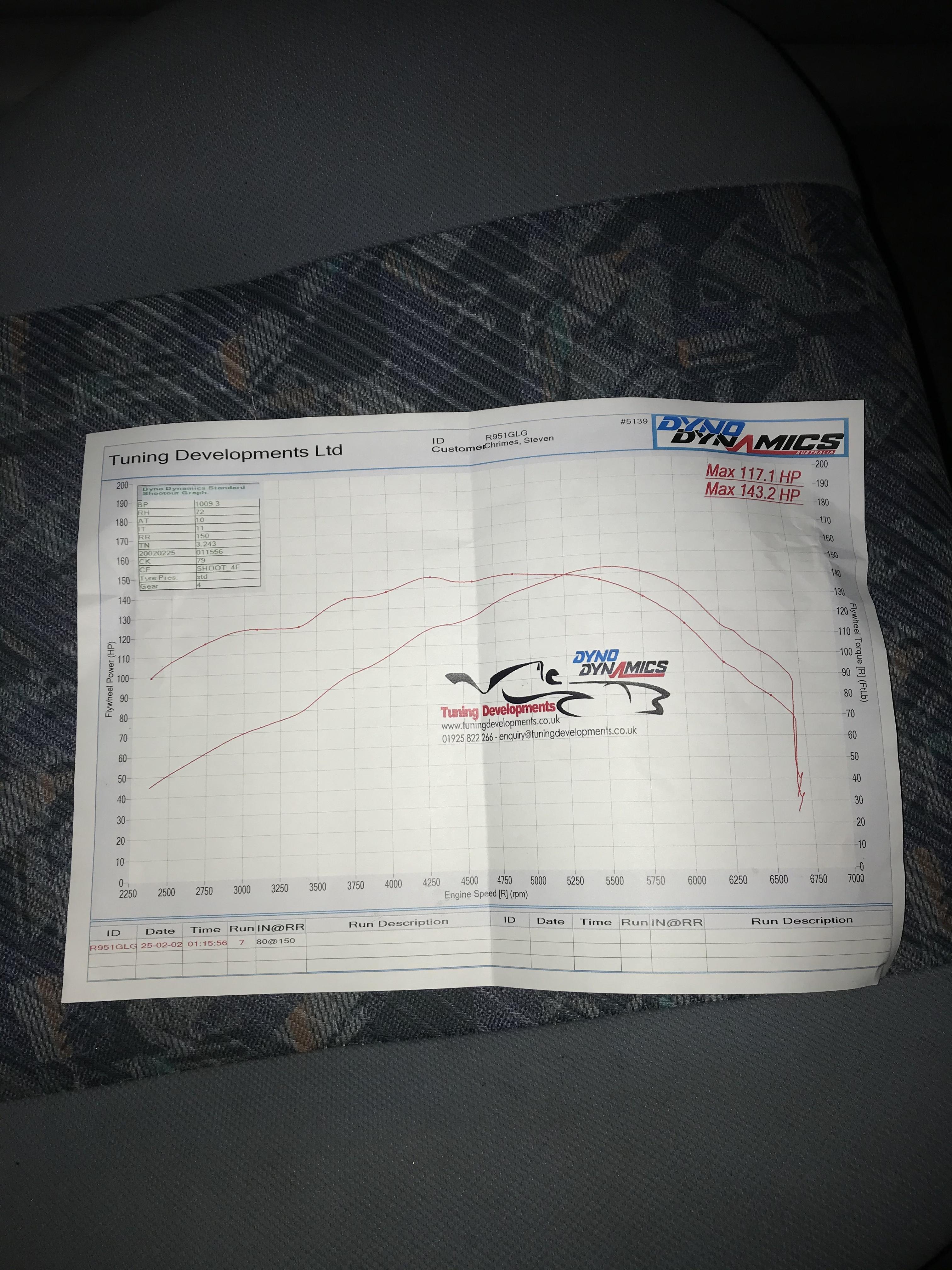

stevie82 Posted December 11, 2020 Author Posted December 11, 2020 (edited) Cars all done and I’m really happy with how it drives, it picks up boost quite quickly and is funny to drive. Boost was wound back from 10 psi to 7 as it was having some valve float at high rpm due to na valve springs. A high flow fuel pump was needed as it began to lean off too much. I want the car usable and reliable so I’m happy with the boost levels and power it made I’m not chasing figures and I feel it’s on the money for what I intend to use it for. I can’t recommend tuning developments enough, they’ve mapped both my sr and glanza v and im more the happy with both results they know what they’re doing and are just genuine people 😀 Edited December 11, 2020 by stevie82 Quote

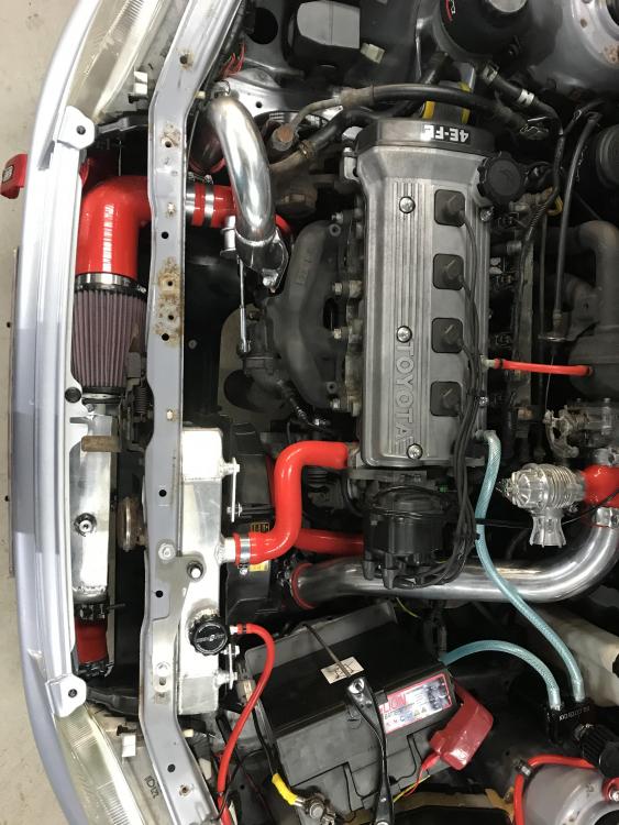

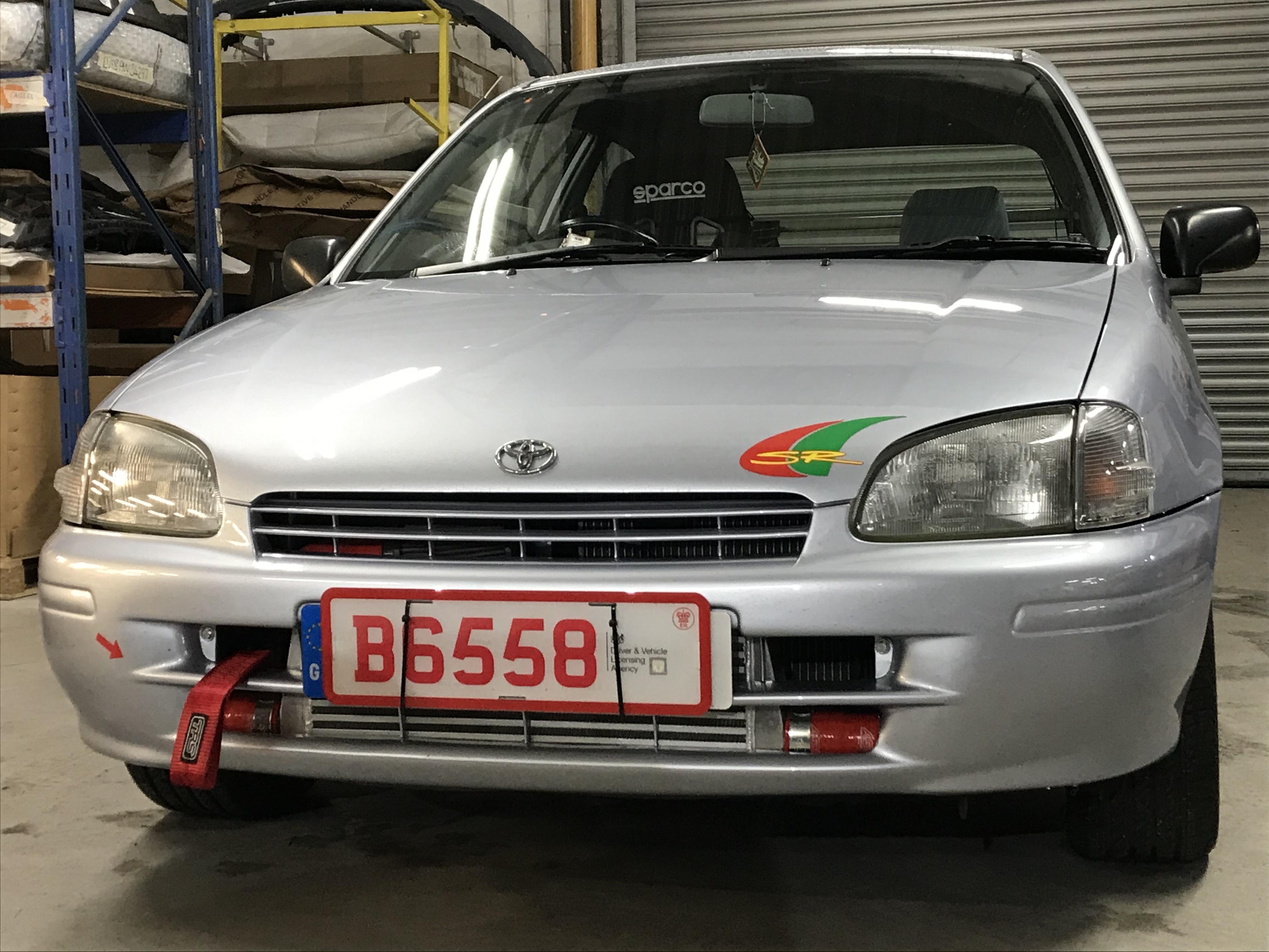

Claymore Posted December 12, 2020 Posted December 12, 2020 2 hours ago, stevie82 said: A few more tidy up jobs to do and a few more bits to buy and an mot to sort then it’s off to oulton park in January for a shake down Looks great mate . Nice smooth power delivery too, no sudden surprises in the curve, should drive predictably. Had a few questions about the setup, how did you mount the intake air temp. sensor? Also with the intercooler piping did you go under the front lower cross member or out and round in through the sides? Any pics with the bumper off? Also were you using the 4efe fuel pressure regulator or a 4efte unit? Good job, looks like a nice clean install. Quote
stevie82 Posted December 12, 2020 Author Posted December 12, 2020 4 hours ago, Claymore said: Looks great mate . Nice smooth power delivery too, no sudden surprises in the curve, should drive predictably. Had a few questions about the setup, how did you mount the intake air temp. sensor? Also with the intercooler piping did you go under the front lower cross member or out and round in through the sides? Any pics with the bumper off? Also were you using the 4efe fuel pressure regulator or a 4efte unit? Good job, looks like a nice clean install. Hi thanks for the comments, firstly the air intake temp sensor is just tied up in the engine bay as it’s not an issue, I’m using the stock 4efe fuel pressure regulator but did have to change the fuel pump as it ran lean top end and I first ran the intercooler pipework under the front crossmember but it looked shit with the na bumper as the bumper fouls the pipes massively so I went for 51mm pipes round the sides and it’s much better I’ll try find a pic Quote

Claymore Posted December 12, 2020 Posted December 12, 2020 1 hour ago, stevie82 said: Hi thanks for the comments, firstly the air intake temp sensor is just tied up in the engine bay as it’s not an issue, I’m using the stock 4efe fuel pressure regulator but did have to change the fuel pump as it ran lean top end and I first ran the intercooler pipework under the front crossmember but it looked shit with the na bumper as the bumper fouls the pipes massively so I went for 51mm pipes round the sides and it’s much better I’ll try find a pic Thanks for that. Been eyeing mine up to see about the intercooler routes and thought the same, would need big slots in the underside of bumper to clear the pipes. Quote

Sam44 Posted December 12, 2020 Posted December 12, 2020 Fantastic result. looking really smart also. It's good to see a graph on the tubular inlet and 4efe cams. Look at all that low to mid end torque. When do you start to build boost I bet it's very low rpm. Quote

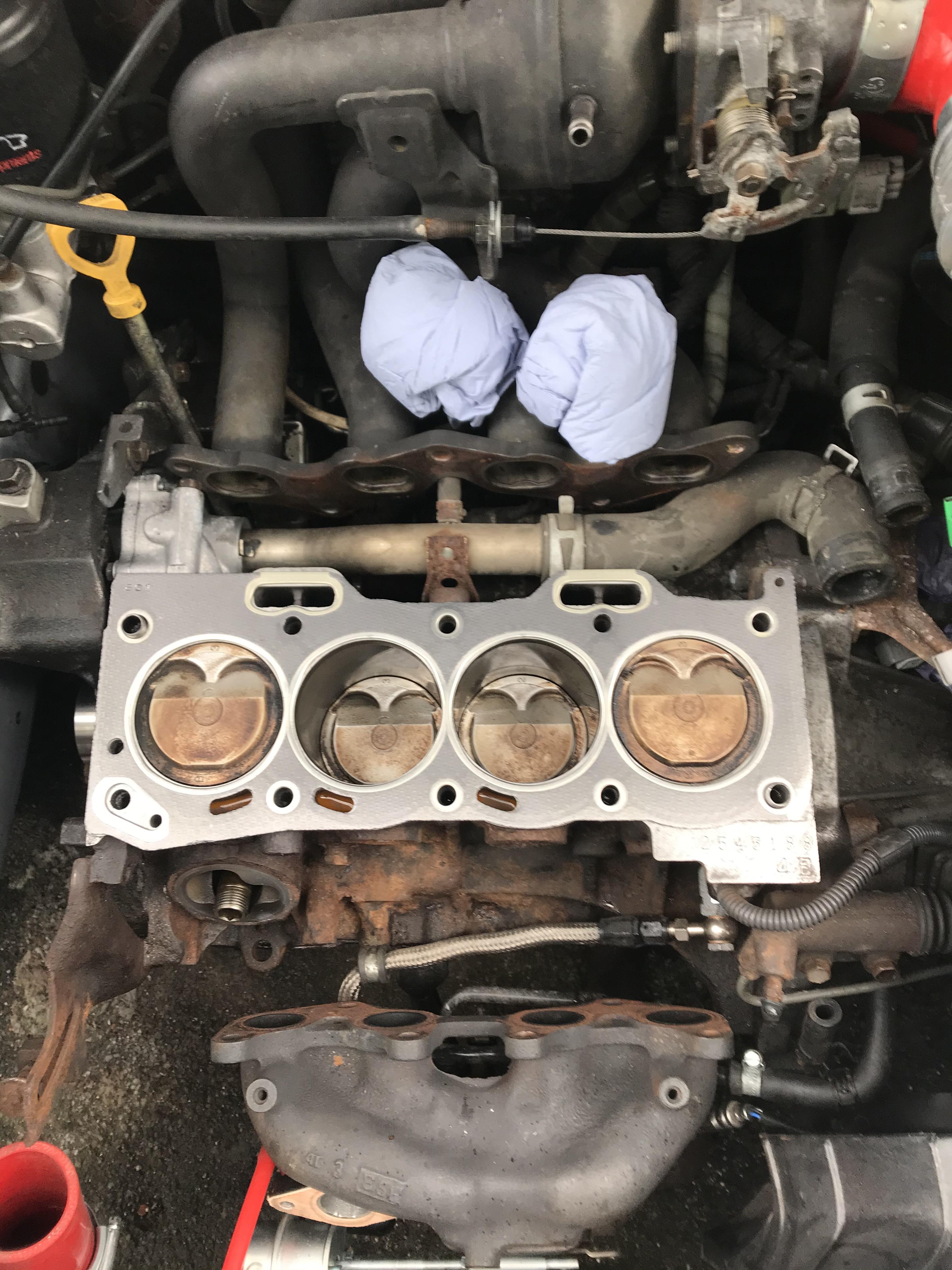

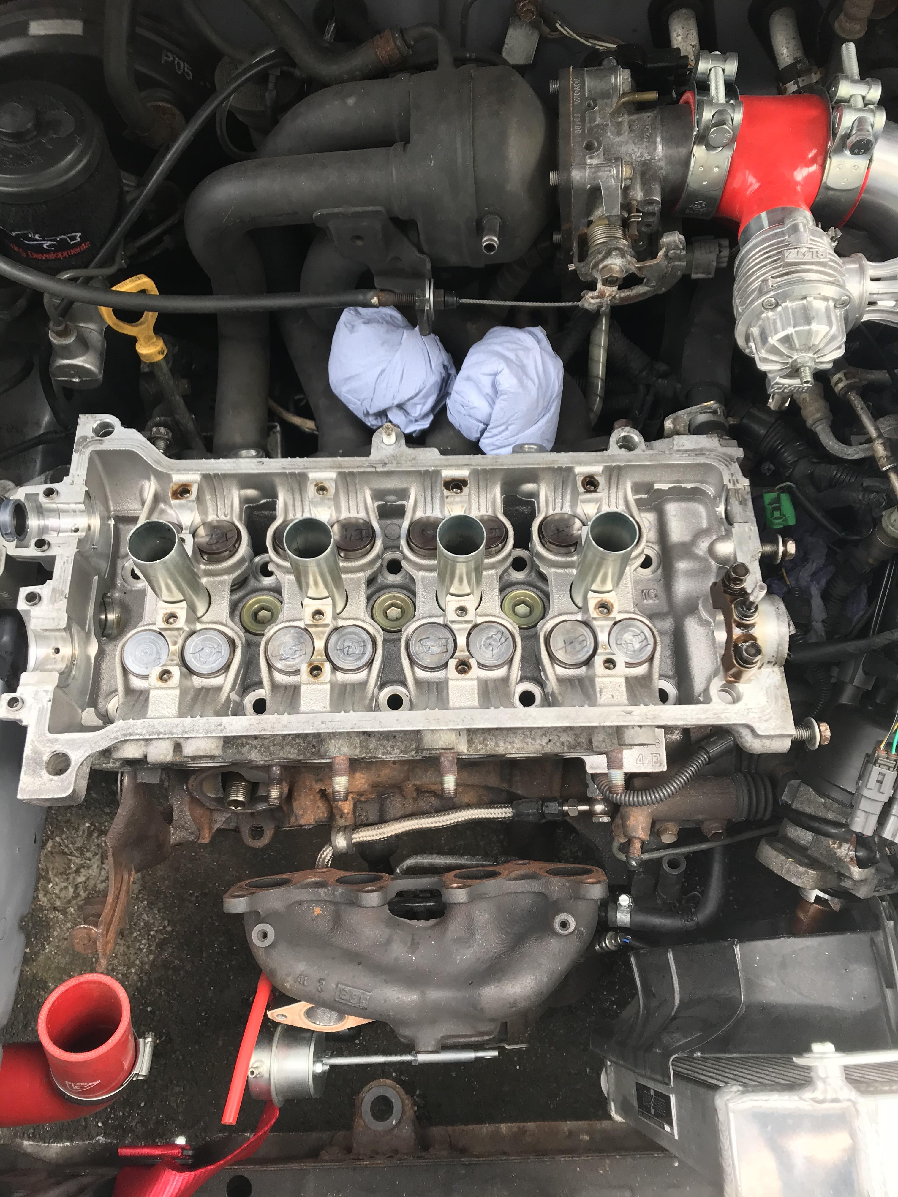

stevie82 Posted November 20, 2021 Author Posted November 20, 2021 Not updated this in a while, work and life in general has been hectic so not a lot has happened over the last year really. The sr passed mot first time 😀 and then just sat in a corner of the unit at work unfortunately. Started her up about a month ago and noticed a small amount of blue smoke when it had warmed up ? Bugger ! That combined with a slightly milky oil cap was enough to pull the head and do the gasket as I’m positive it will be the original gasket. Quote
