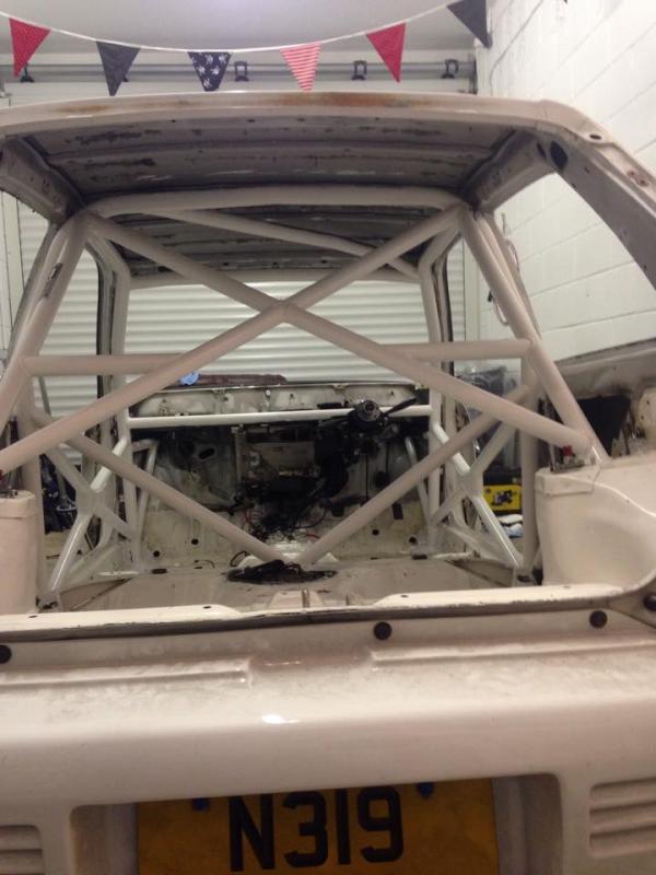

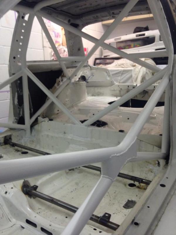

Flynn Posted April 25, 2017 Share Posted April 25, 2017 Only the best for that little car! Here's a pic to keep you going. Quote Link to post Share on other sites

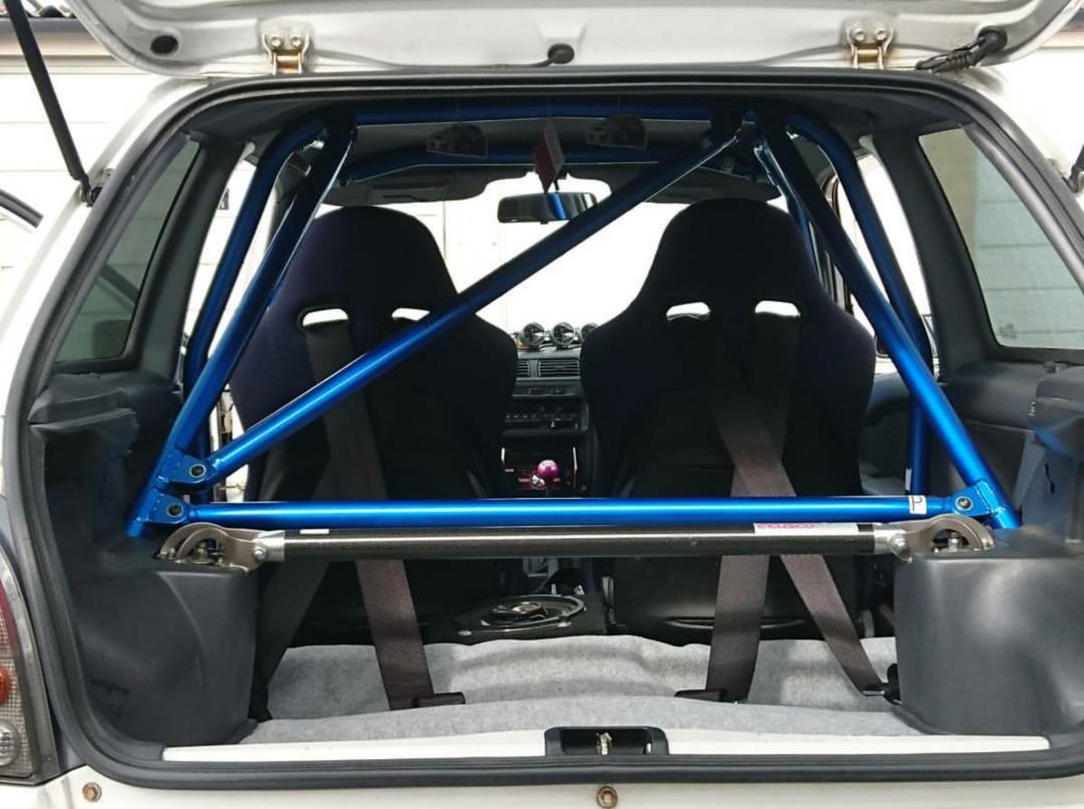

akyakapotter Posted April 25, 2017 Share Posted April 25, 2017 One of mine just to tempt you even more Cheers nick. Quote Link to post Share on other sites

Gainzy Posted April 25, 2017 Share Posted April 25, 2017 Only the best for that little car! Here's a pic to keep you going.Howay Flynn sell me it for half price Quote Link to post Share on other sites
