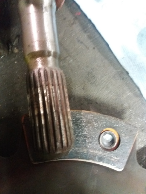

Mike84 Posted September 26, 2018 Author Posted September 26, 2018 Well alots happened after my last post I did get gearbox all together again along with suspension & ecu . I even managed to fit a new hybrid turbo as Well which I had rebuilt by Midland turbos . It turned out to be a TD12 hybrid happy days . On refitting of gearbox i found a terrible noise from gearbox area which stopped when clutch depressed. Aaaaargh wasnt happy after spending 2 weeks doing box and turbo , so thought bugger it sent it to rolling road to get map tweak for new turbo and if it survived i would take it to race . The rolling road went well making 224bhp now at the same boost of last hybrid which only made 206bhp. This was the day before race i decided to give it a road test and wasnt happy with noise . So wangled a double entry of my Auldmans clio. After race weekend I removed box and found the problem the clutch plate had worn the splines on input shaft . I was annoyed I hadn't noticed previously Anyway swapped out another gearset Some pics of updated turbo TD12 Which is basically a td04 with ct9 housing and fully spooled by 3500rpm but pulls all the way to 7000rpm Quote
