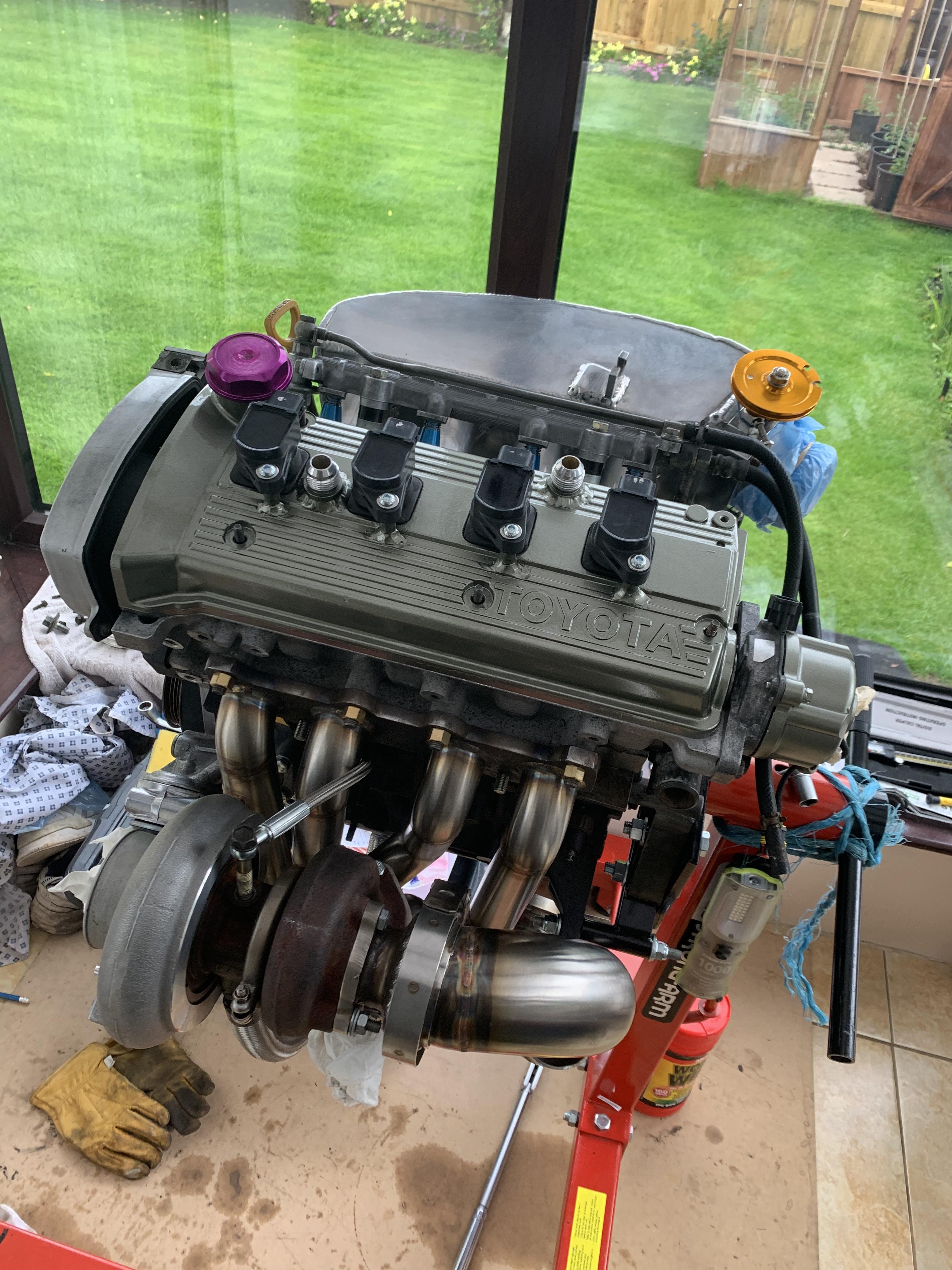

9-10th November 2019, Weekend update
So after getting my engine back last week Ive made some nice progress over the weekend,
Got the bottom end ready for the head to go on,
Fit headgasket, apply head, remove cams.
torque head on, torque cams and cam caps on.
Fit oil pump & Water pump, then apply cambelt.
Then after many attempts i got the engine timed up correctly.
Last but not least; THE SNAIL HAS ARRIVED!
20191103_122606403_iOS.thumb.jpg.74f0bd5fcccfddfdacf8ed11c1fcc0ca.jpg20191109_120949748_iOS.thumb.jpg.60fe7308ac9493fac28585428f71e64c.jpg
20191108_160939979_iOS.thumb.jpg.1661ba99437dc8c500416b3f4bf70652.jpg20191110_113210580_iOS.thumb.jpg.d940208ba32464c7943237f548aecf8c.jpg1347601115_20191109_132248171_iOS1.thumb.jpg.8c7d23f916ee486d4f955dd0307fe4f0.jpg
Super happy with the turbo, Like new.

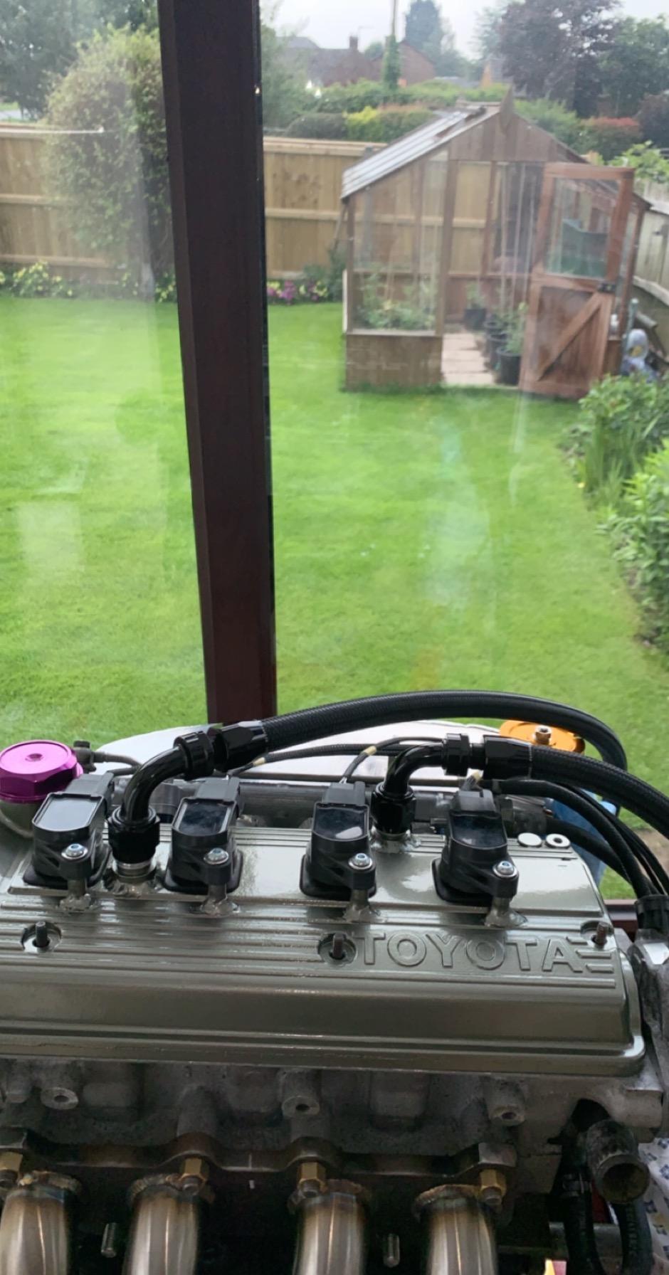

Here are the pics of where im currently upto with the engine
          20191110_214011195_iOS.thumb.jpg.5517c79f02cd8e35a0957d1813669683.jpg20191110_213955190_iOS.thumb.jpg.de2a4e17d8943747832c3517f5d8c518.jpg
20191109_115515455_iOS.thumb.jpg.1126bb330eff1ba38d0f129f59443b66.jpg20191110_213941155_iOS.thumb.jpg.8c40b935f79a8ca89005a94432537ff8.jpg20191110_213955190_iOS.thumb.jpg.de2a4e17d8943747832c3517f5d8c518.jpg20191110_214011195_iOS.thumb.jpg.5517c79f02cd8e35a0957d1813669683.jpg20191110_213201369_iOS.thumb.jpg.580ce61cc3d5261df2ba16bdfb49649c.jpg20191110_213207184_iOS.thumb.jpg.69c3cb49cf6071b981c333ae55a6ab85.jpg20191110_213211274_iOS.thumb.jpg.149fce0e09f1912da65aa75df342adf0.jpg

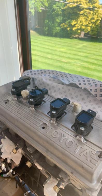

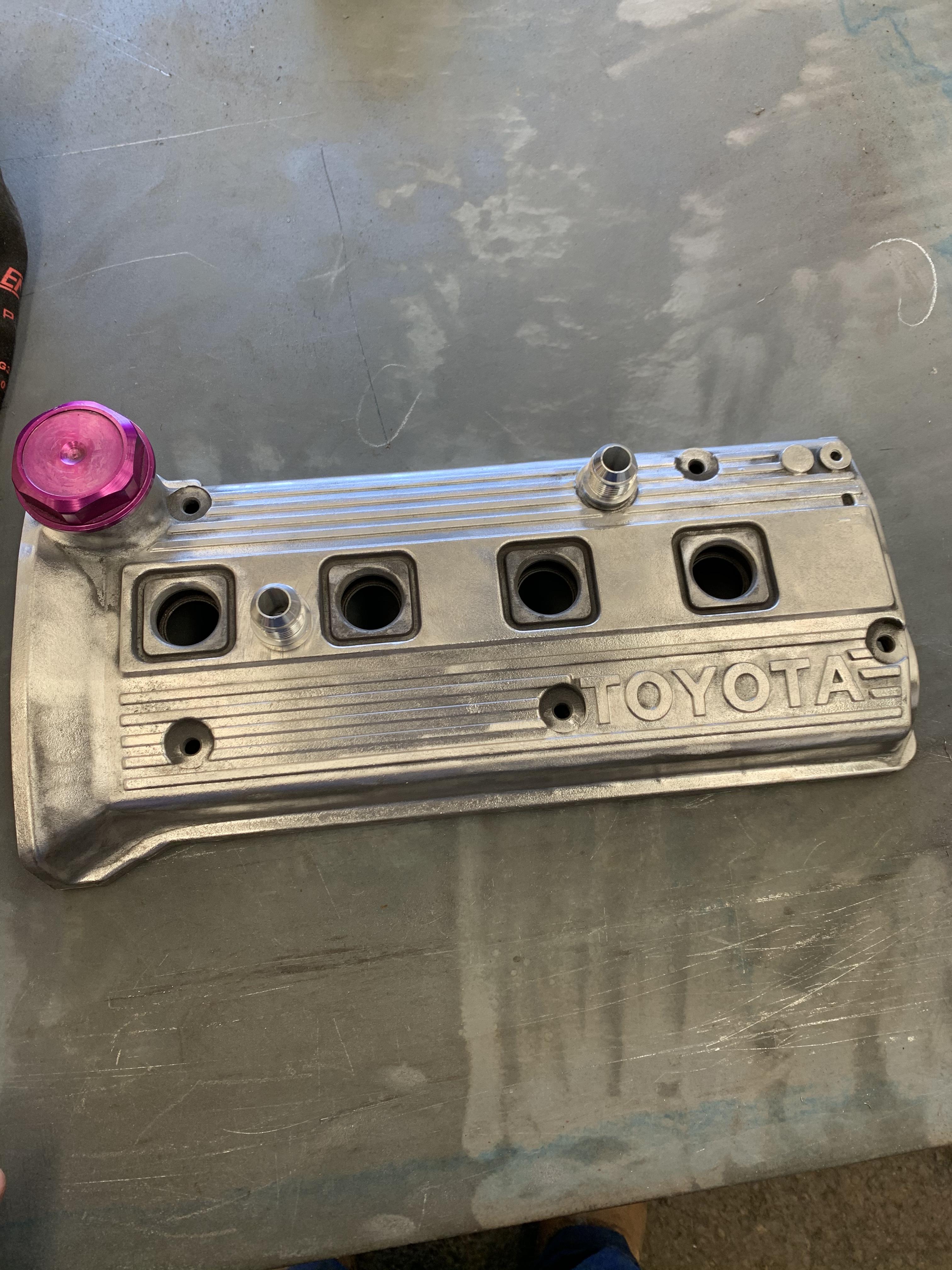

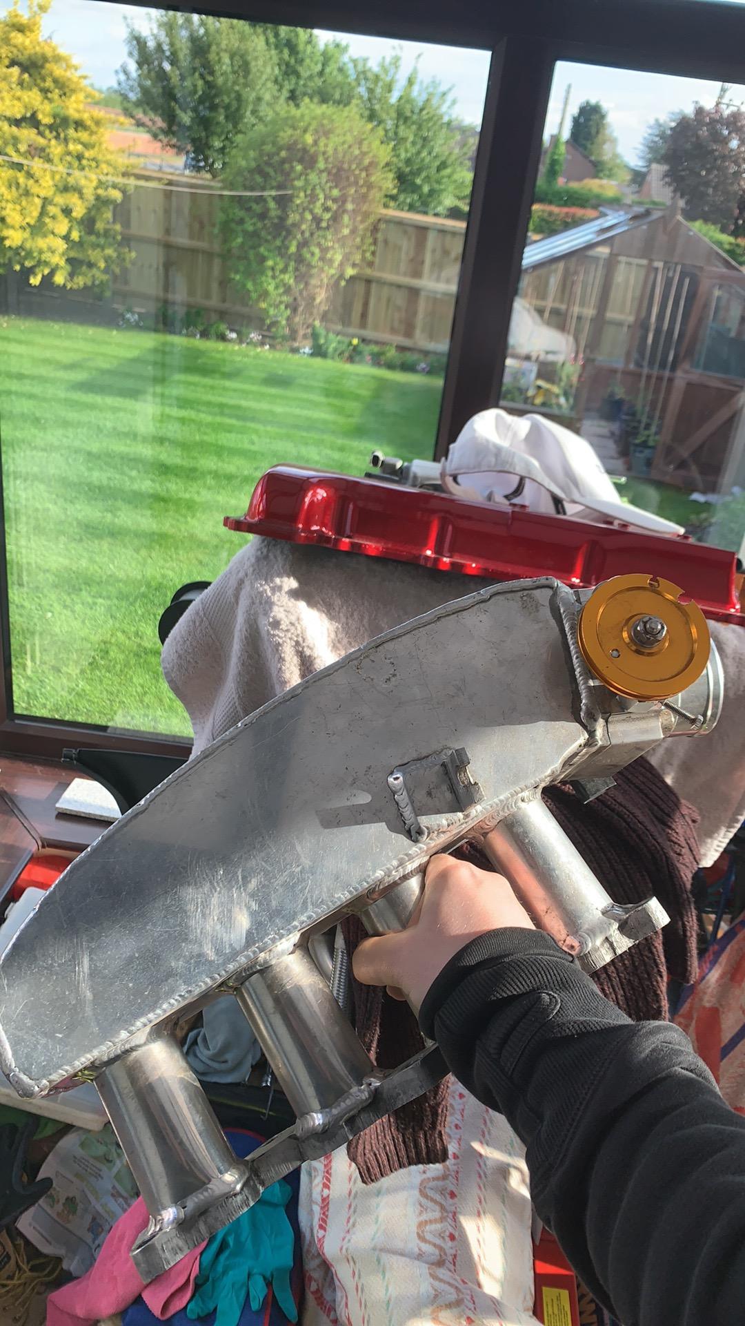

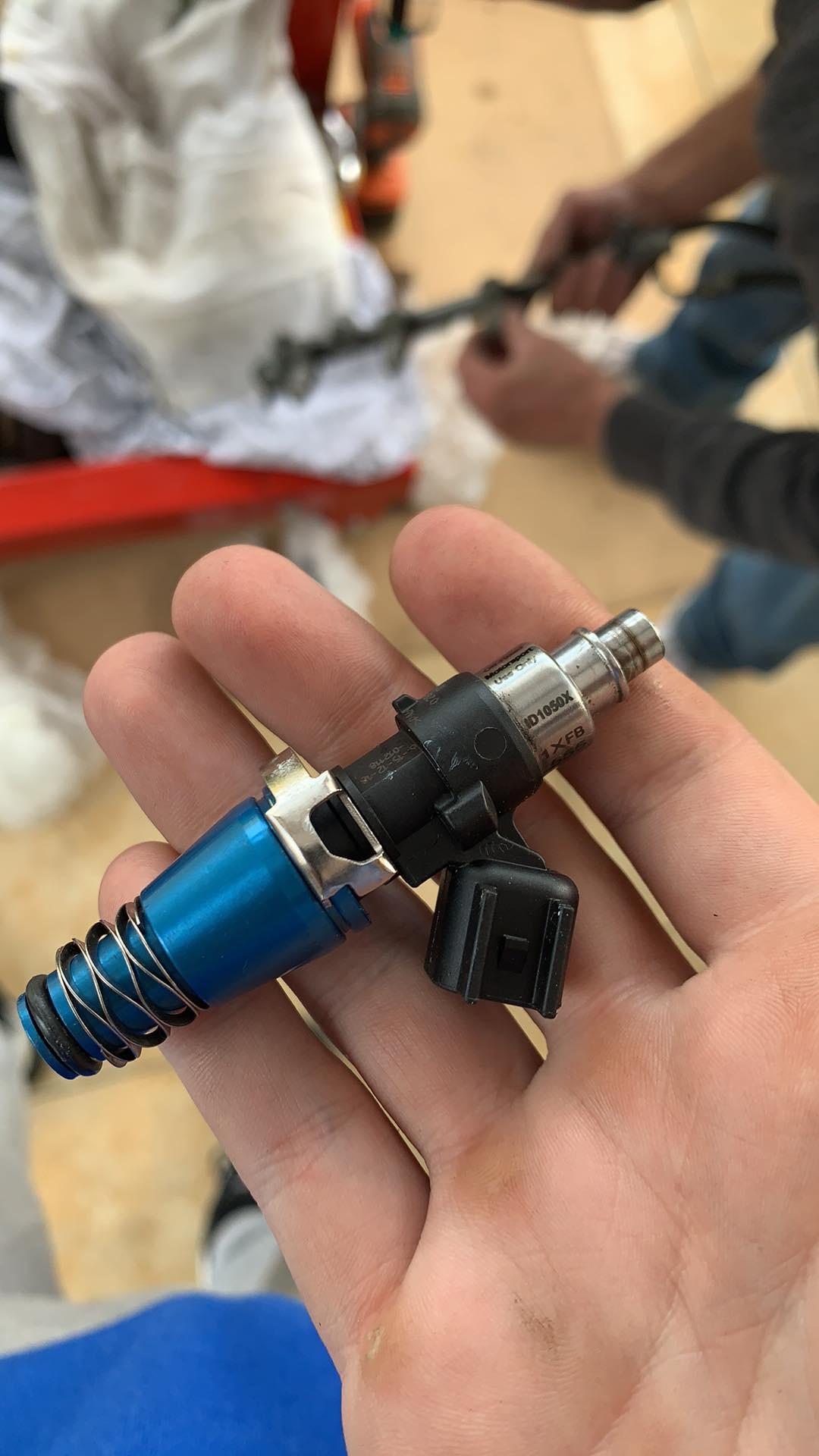

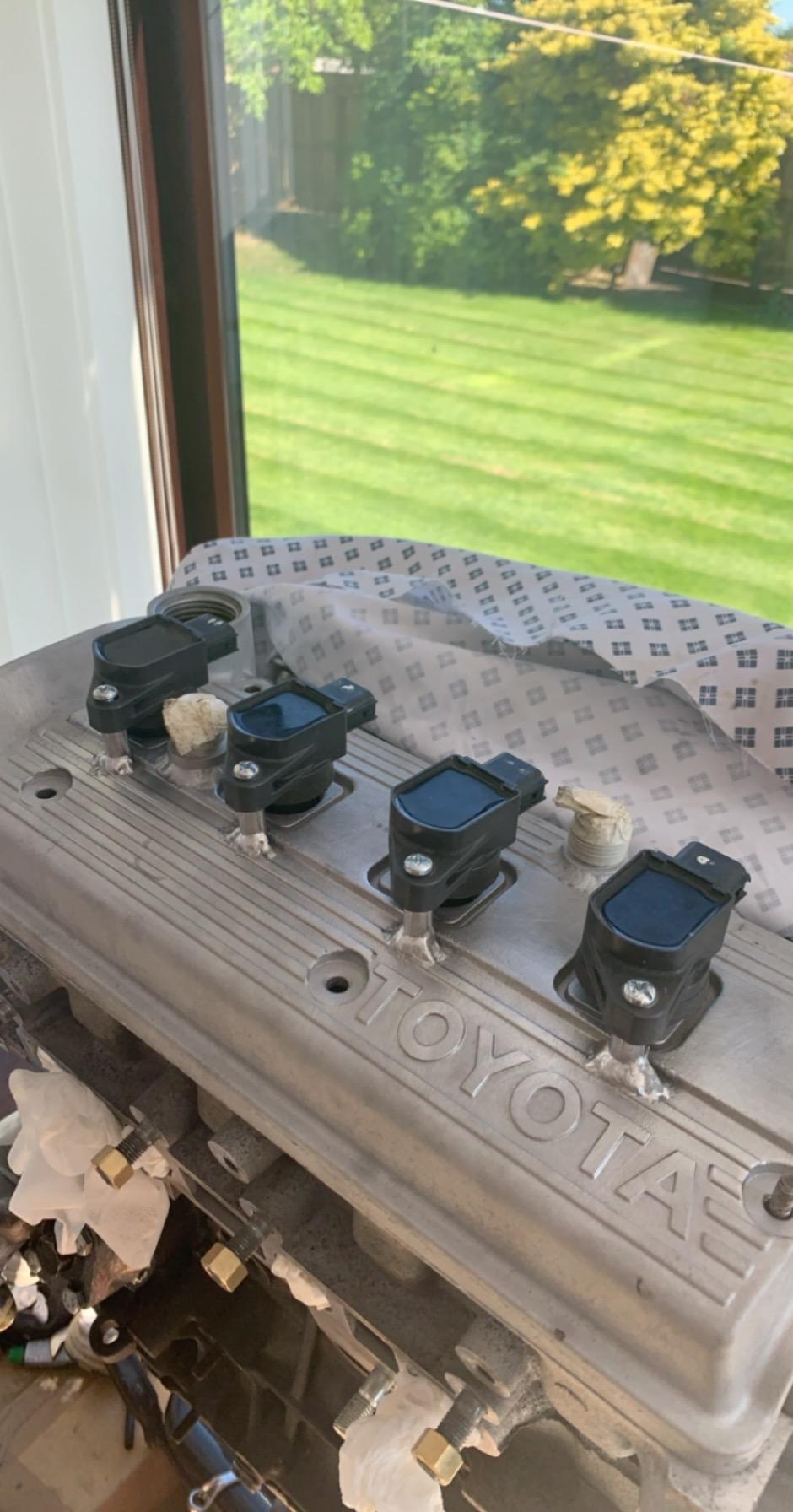

Towards the end of the evening we had gotten all the hard stuff out the way (timing mainly), I thought had have a quick look at how the turbos going to sit, fair to say it looks amazing and it motivates me to finish it more and more so I can make some booooost! The last hurdle for the turbo now is the manifold flange doesnt fit, ( I did take this into account when buying but spoke to several exhaust companies who have confirmed they're able to change the flange on the manifold for me).
    20191110_153235092_iOS.thumb.jpg.6adde0523997276f60f5995dc707d82e.jpg20191110_153227811_iOS.thumb.jpg.963ca6d716bfda72816c4ff27847d317.jpg
  20191110_160036408_iOS.thumb.jpg.17bb2e8e157bb4f88421b1ac2bf52a78.jpg20191110_160110292_iOS.thumb.jpg.7618c0b04eef6741b5151da3610e0bd2.jpg

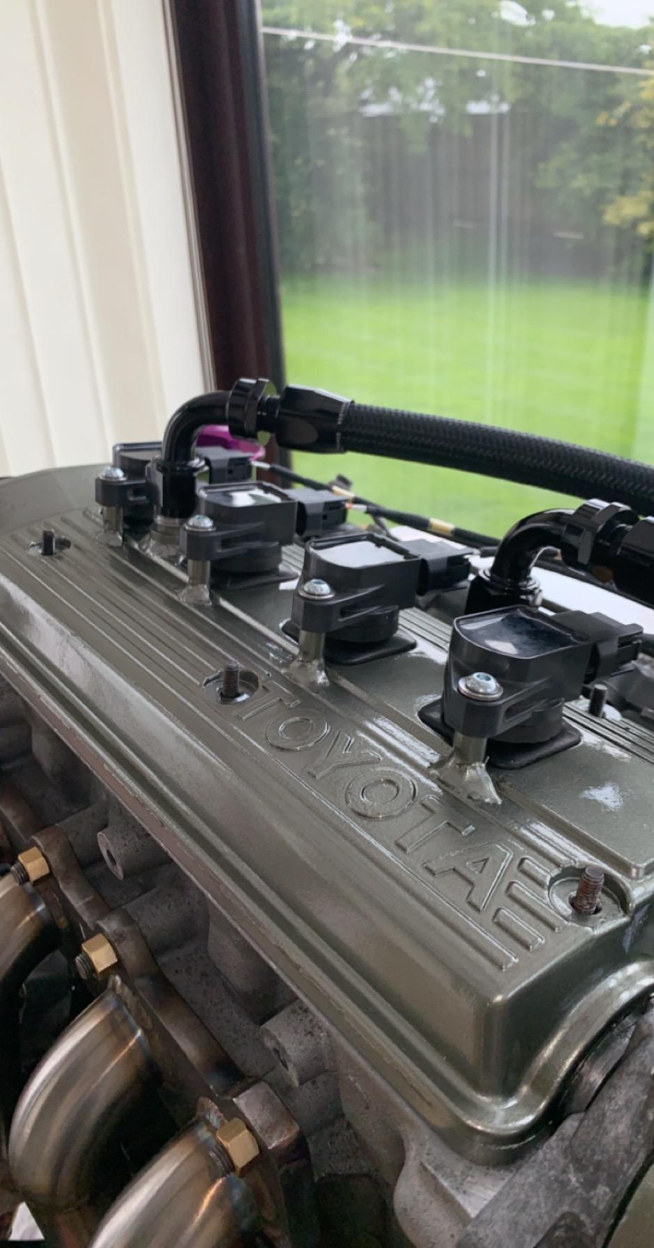

To say I had only a bottom end assembled just the other day, I feel like the motor is ready to go back in the car and the key turning, which would be nice but in reality I'm a long way off.
I still need; Exhaust (downpipe also), Engine mounts, Power steering blanking off, Inlet manifold cleaning and painting, AN Fittings welding to the rocker cover, External Wastegate, oil filter/oil cooler setup, a few intercooler pipes making. The list goes on haha, and the car only gets worked on at the weekend so...
