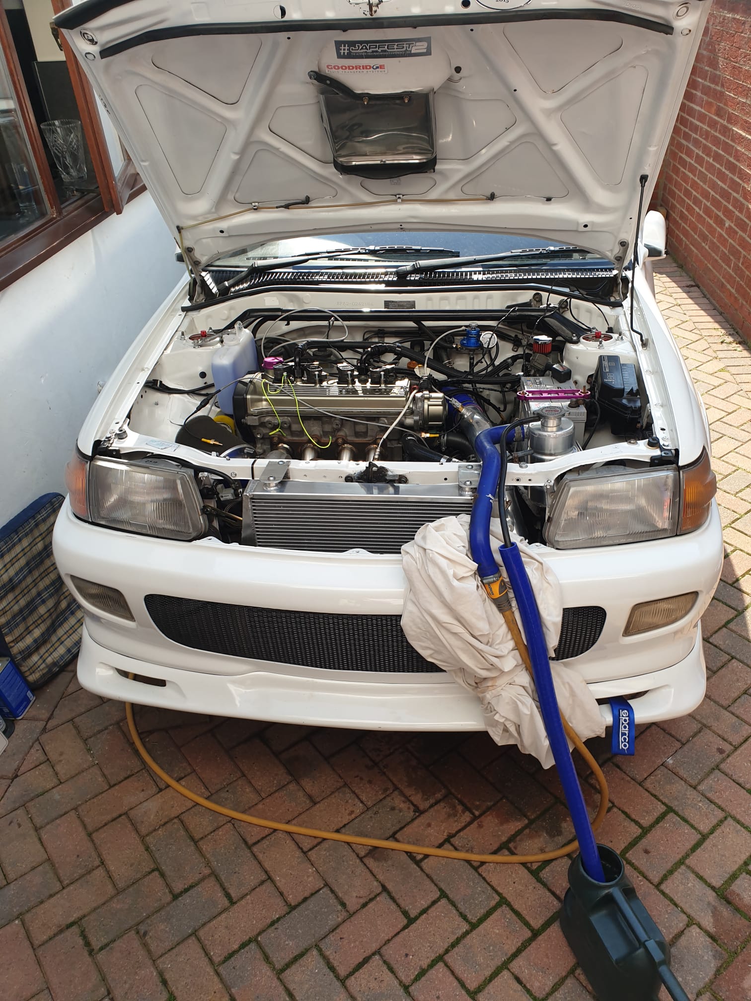

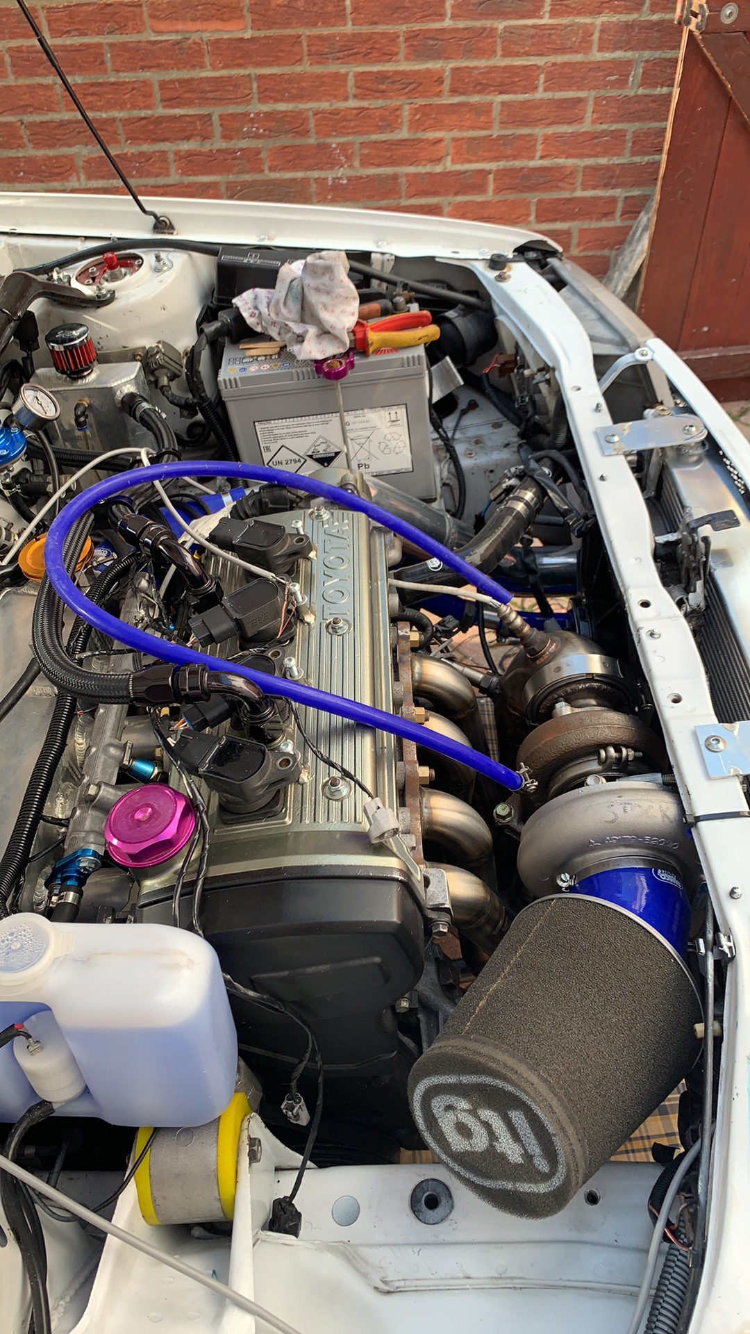

Still here chipping away, cars had lots of wiring done, ecu can now be read on the laptop and the car turns over and builds oil pressure relatively quick🤞🏽. All it needs is tps adjusting and a quick double check then she’ll run.
Managed to hook the hosepipe up to pressure test coolant system, leaked like a sieve at first but managed to stop them. Left to run for 2 hours under quite a substantial amount of pressure and not a drop leaked🤣 ghetto but works.

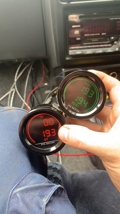

Also got a pillar pod with a wideband, oil pressure and oil temp.

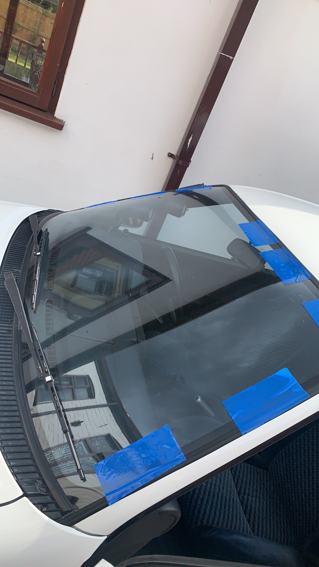

and another setback was car needed new windscreen as developed a crack out of nowhere which was a pain.

1: she’s getting very hot very quick. Water temp was circa 82degrees after 5-6 minutes on idle with throttle blips. System bled properly so hoping it’s due to the timing being out still.
2: as mentioned timing is out and it needs sorting ASAP before I start running it up properly.
3: exhaust blow, there is more sound coming from the downpipe area than at the back of the car which is concerning. Will have to Jack it up tomorrow to see as this shouldn’t be happening.
4: my aem wideband is stuck in a reboot cycle which is blagging me, after a quick read it can be due to wiring or potentially damaged in transit. I did buy this as a New but used item so😯. But was still sealed in the box when I got it.
anyway, these are not major and I’ve got no leaks. Overall very happy 😁.

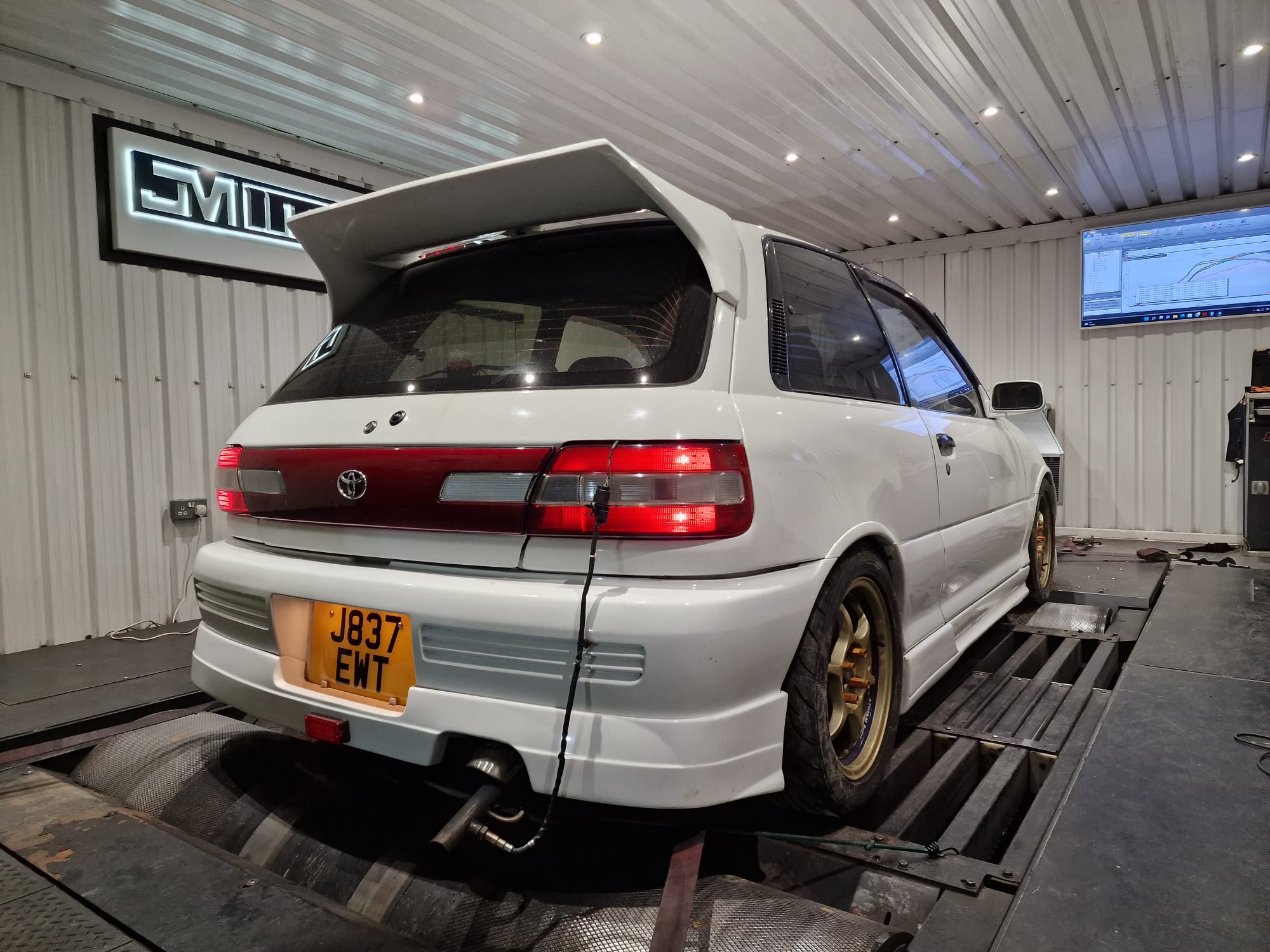

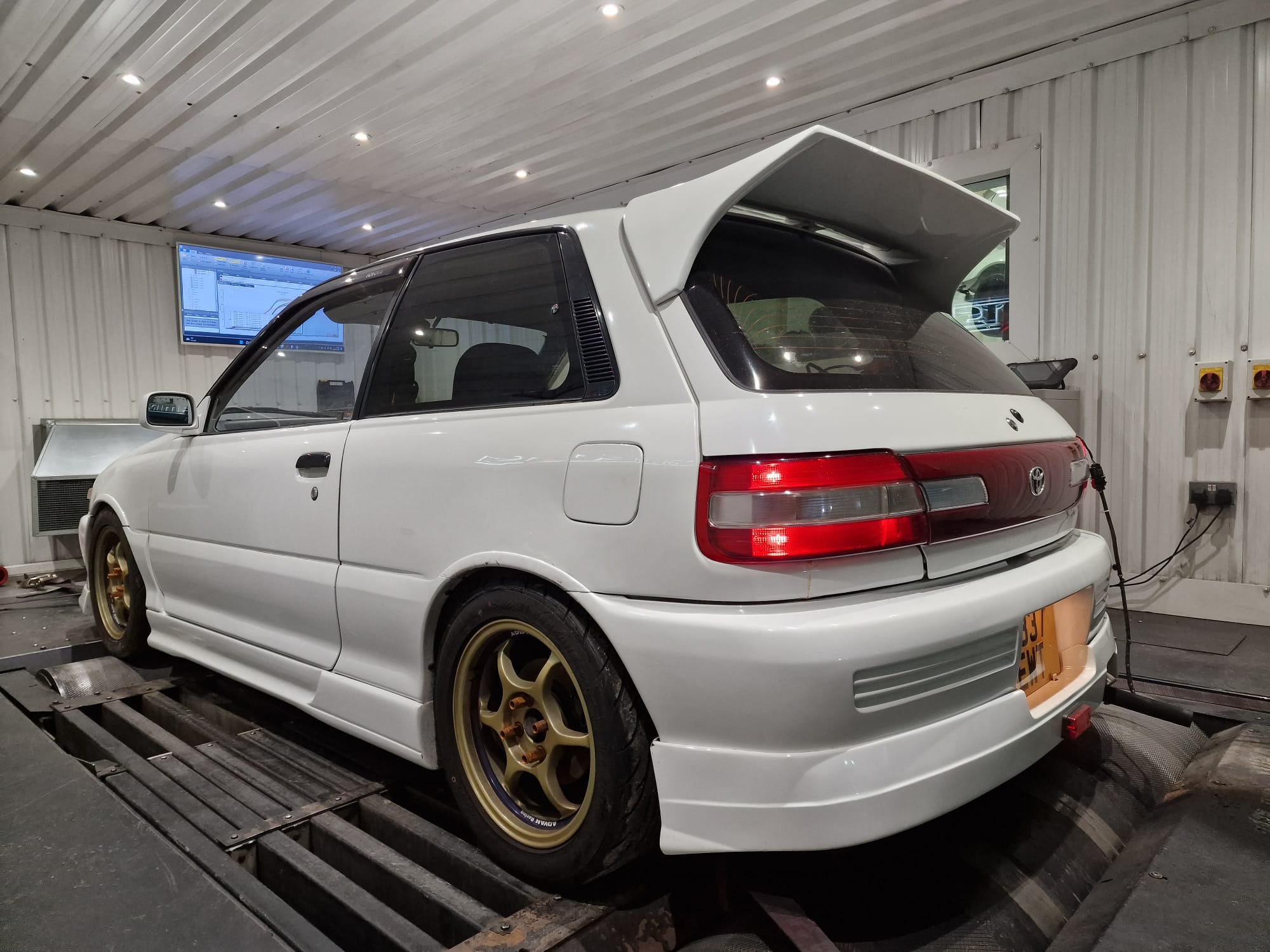

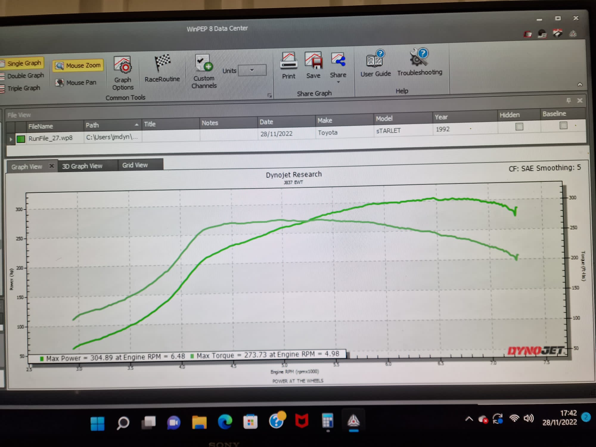

So bit of an update pretty much ironed all the creases out and motor is almost bedded in. Been doing some gentle boosting today and loading up on the dyno to finalise the basemap off and she’s coming onto boost earlier than expected. Can’t wait to go for full power on this thing.
Link to post
Share on other sites
  • 3 weeks later...

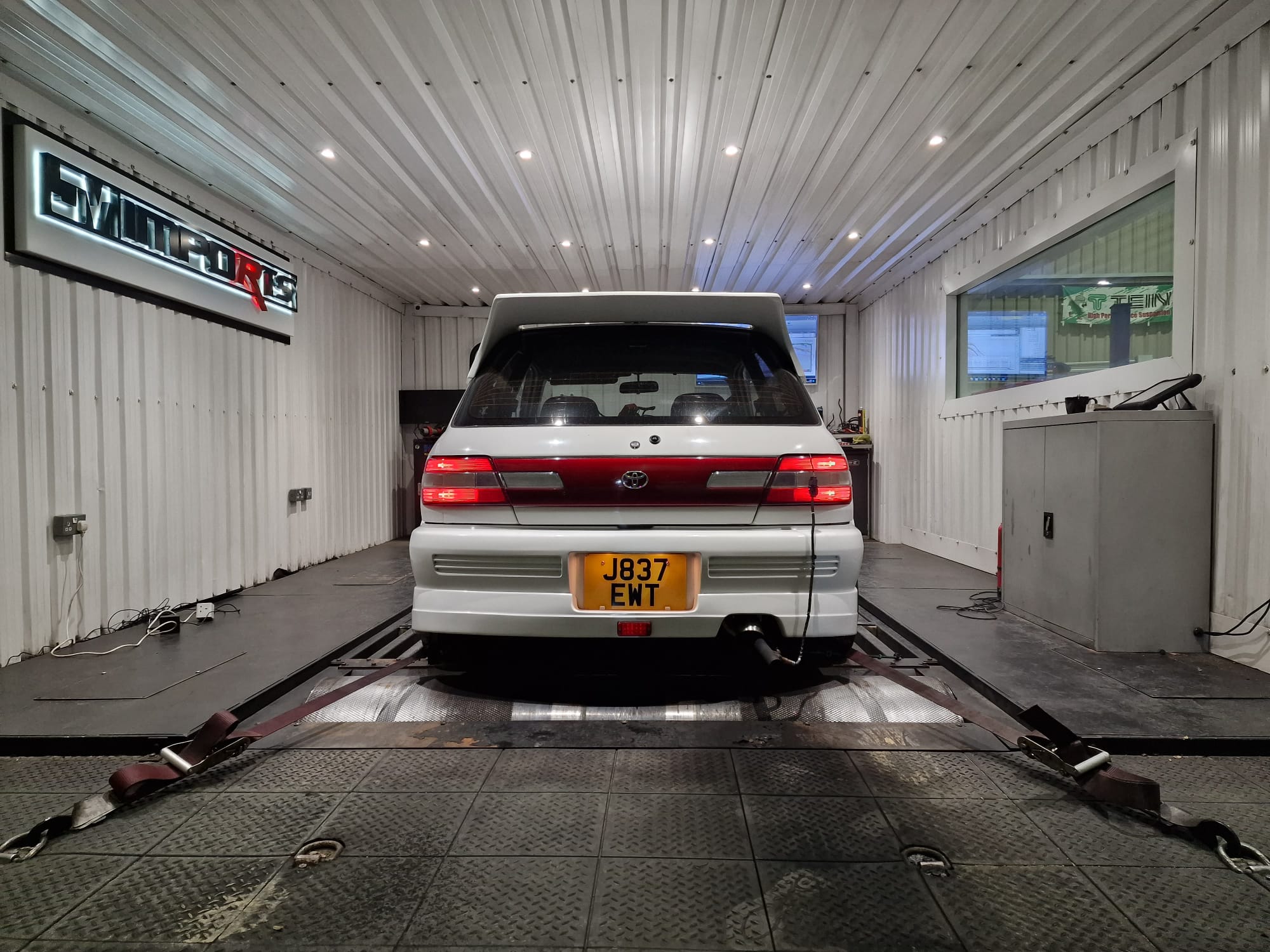

Finally after pretty much 3 years, I finally get to drive this thing again!
still on a basemap tuned to suit gate pressure 0.8/9 bar, 5k safe rev limiter still until I do a few more hundred miles bedding the motor in but it feels so good to be back :) advans straight on and time to clock up some miles.
