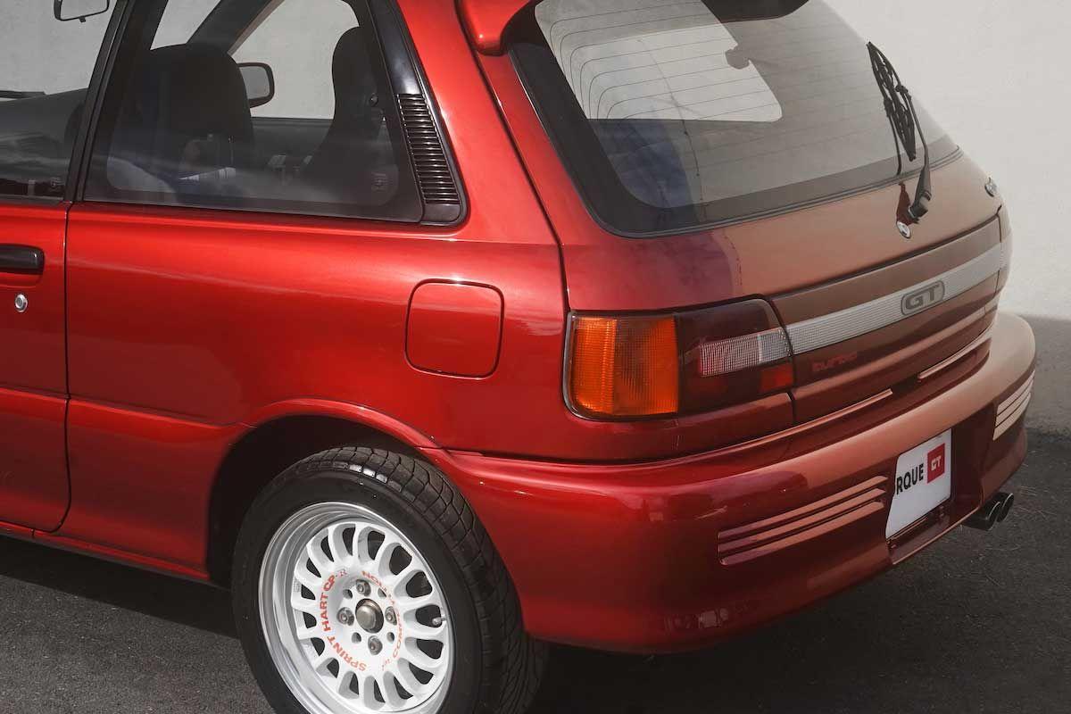

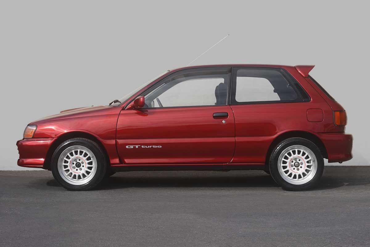

Sam44 Posted April 6, 2020 Author Share Posted April 6, 2020 What model is this and is this a factory colour Quote Link to post Share on other sites
JamesD89 Posted April 7, 2020 Share Posted April 7, 2020 It is a mk1 gt and yes it was a factory colour code 3h4. Quote Link to post Share on other sites
Sam44 Posted April 7, 2020 Author Share Posted April 7, 2020 1 hour ago, JamesD89 said: It is a mk1 gt and yes it was a factory colour code 3h4. Thanks for that. How rare are these. Quote Link to post Share on other sites
