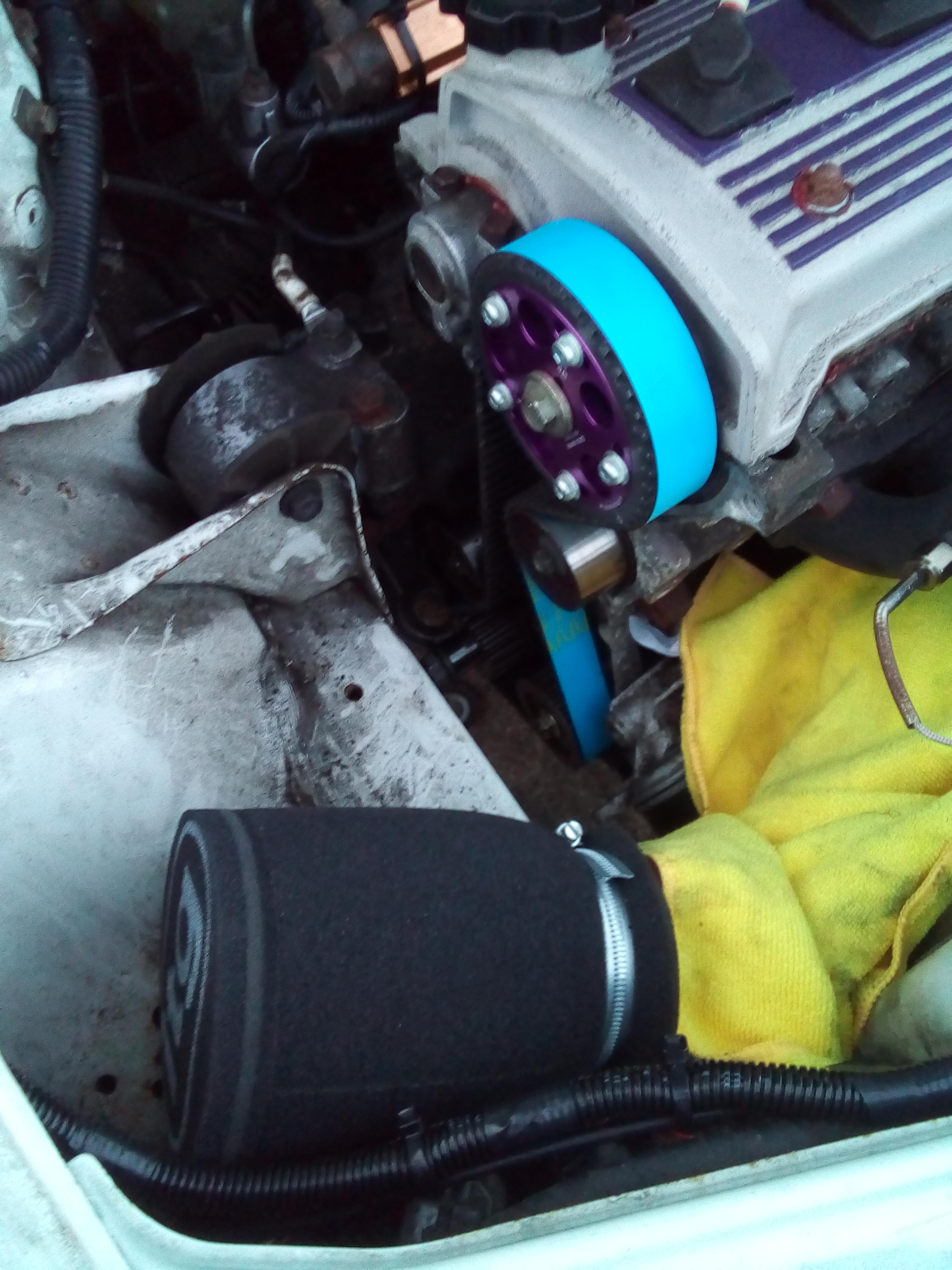

So a family member has done me a solid favour, and replaced the old cam belt with the new Kevlar race belt.
Process to do it.
I can't wait to be back.
I'm hoping this will minimise the flex of the belt helping the crank position sensor located in the 4efe distributor driven off the camshaft be more accurate.

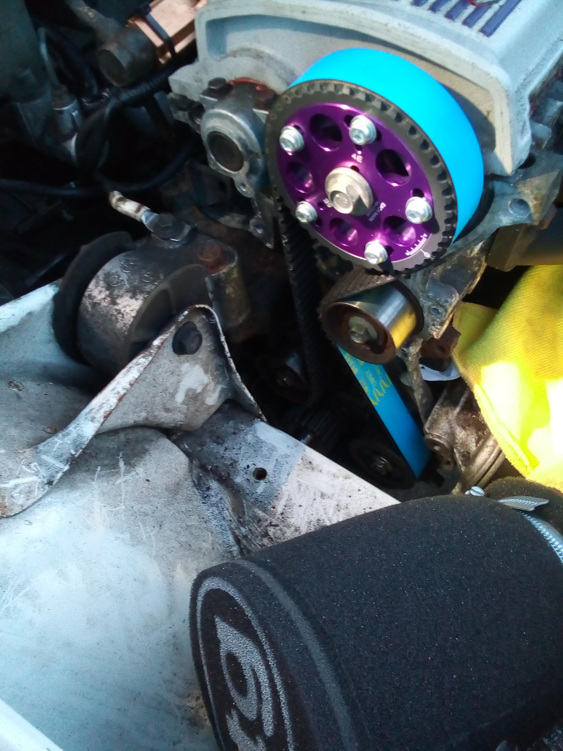

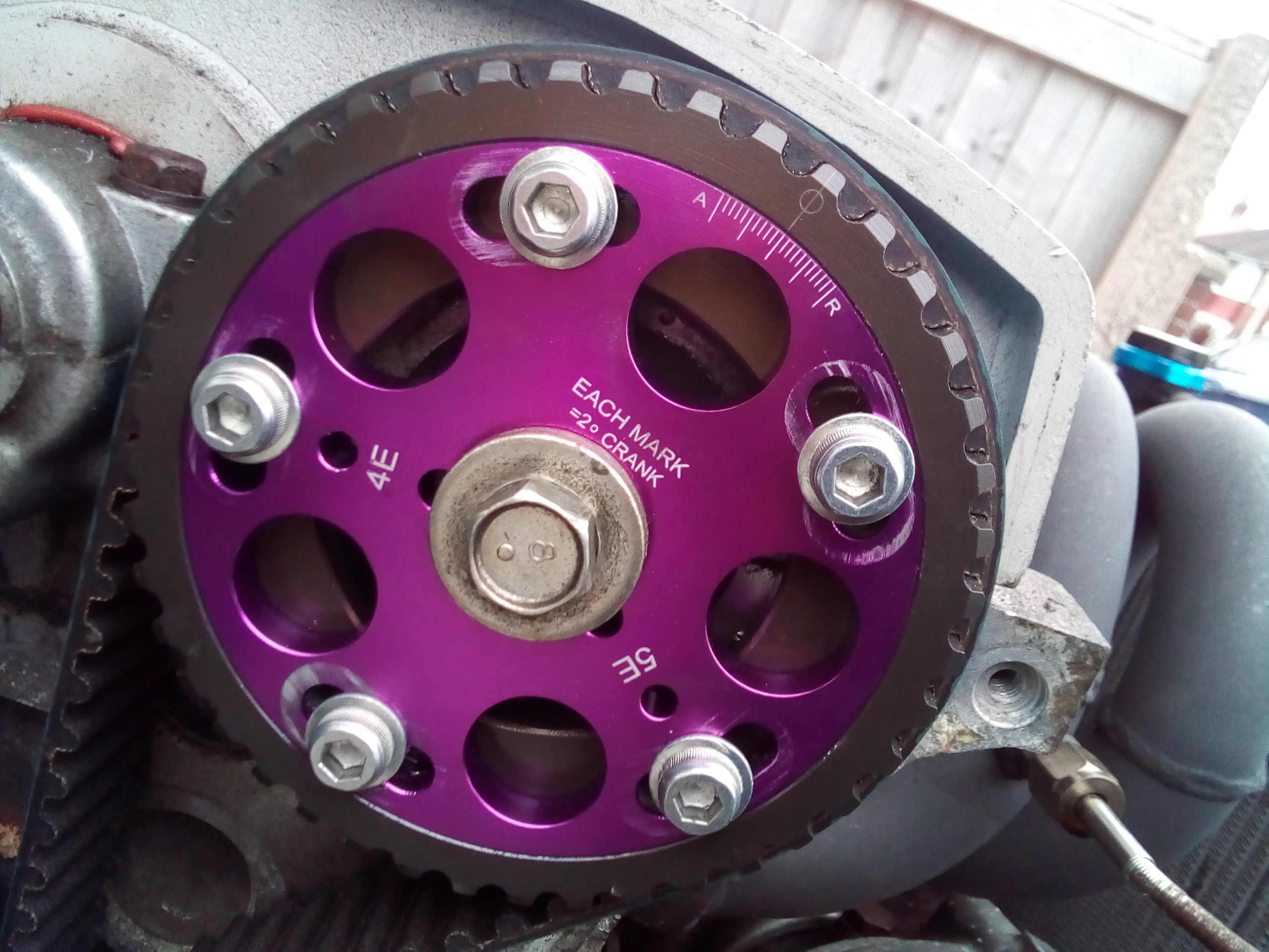

I forgot to inform Daniel about the cam pully bolts requiring lock tight, I totally forgot. Then this happend. In The picture you can see were the adjusting bolts have slipped position altering cam timing as the engine was running.
I was warned about these pulys and to thread lock (lock tight) them once adjusted. No damage done!!, more frustrating for him, and a full day wasted. Standard race car stuff I guess!!.
I also would like to repeat this to anyone how has one, or is thinking about getting one.
He has had abit of a nightmare with fuel leaks and timing belt pulley bless him. We are having to get all compression joint fuel lines made up with running high fuel pressures.

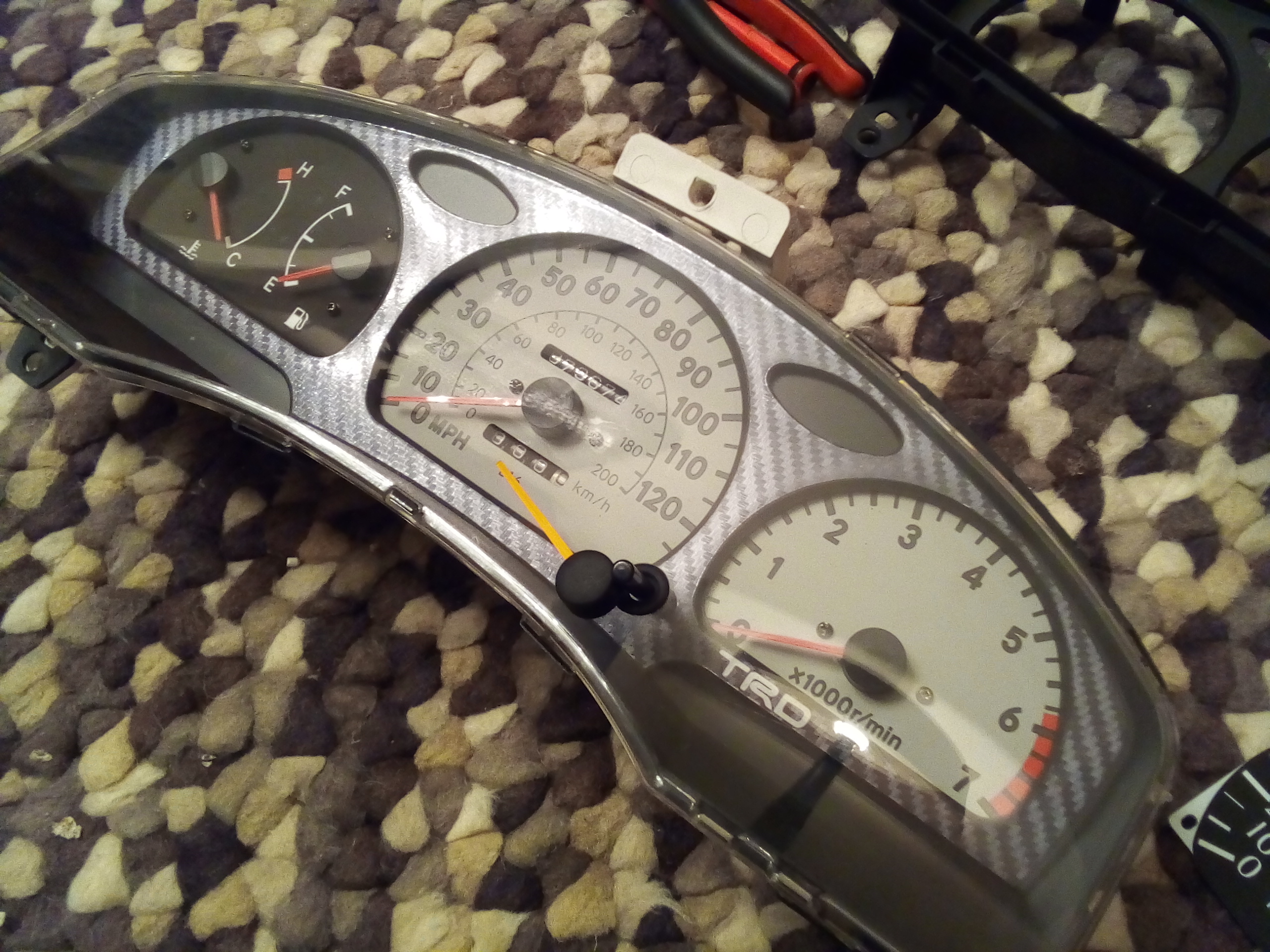

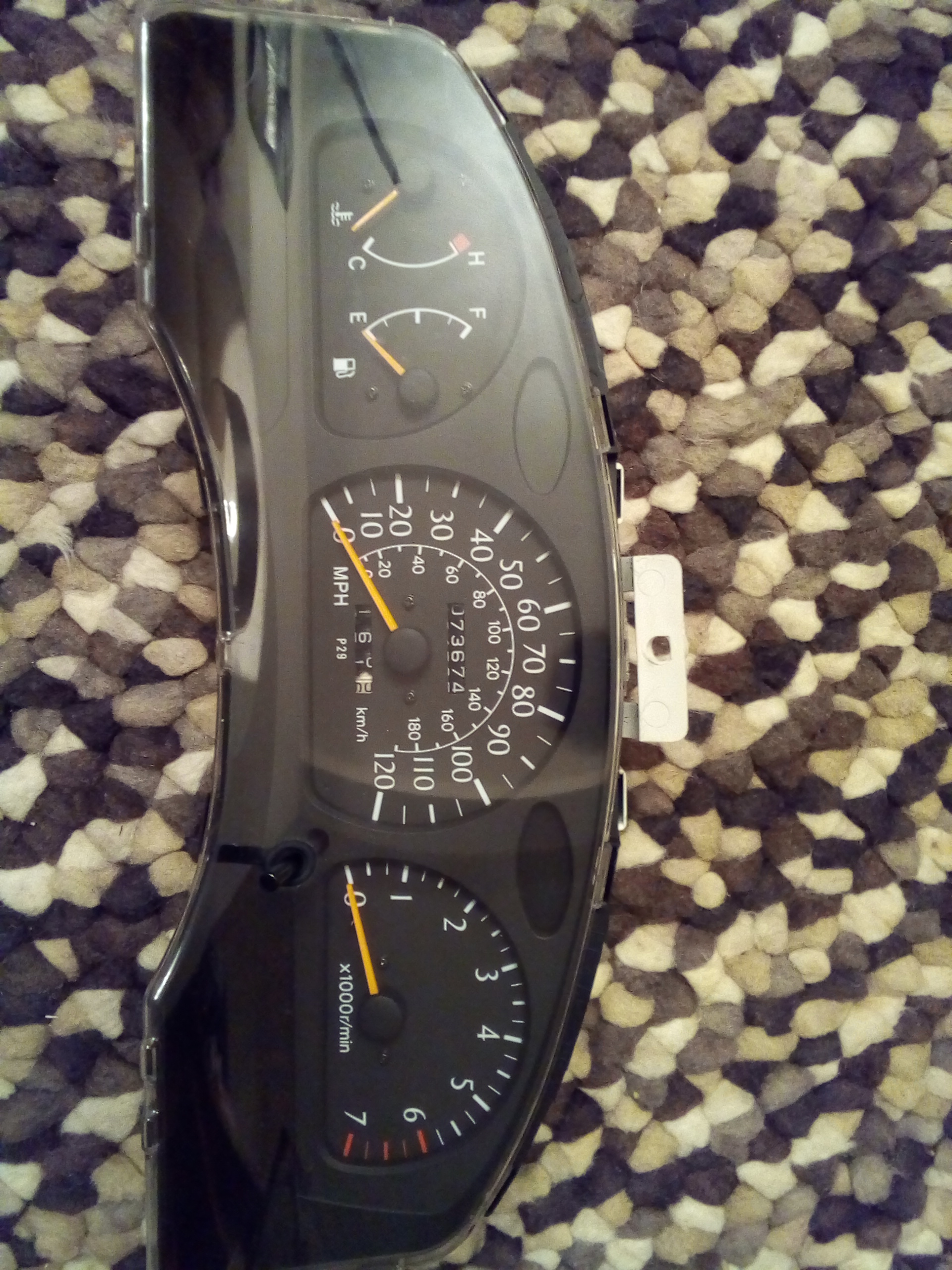

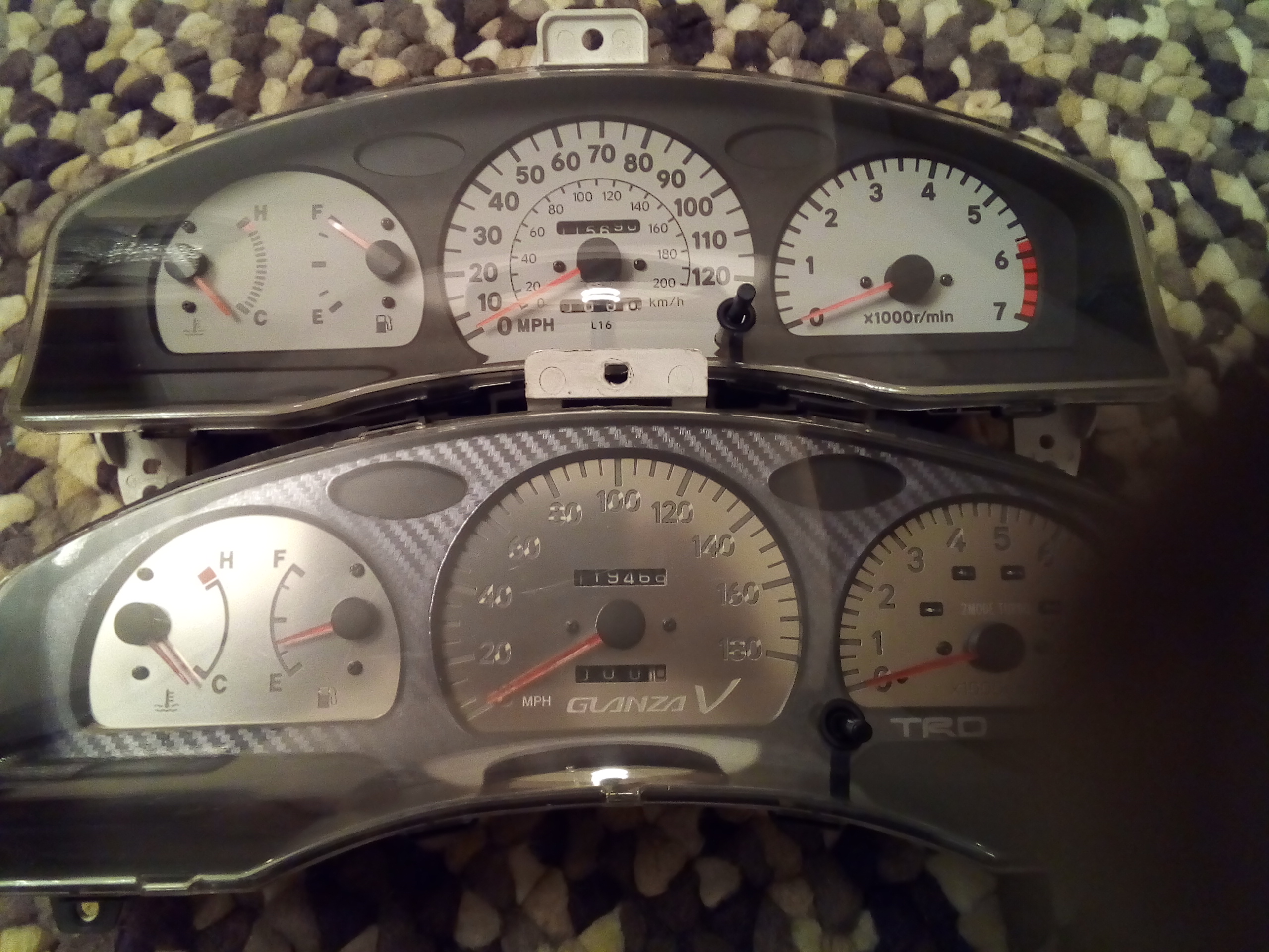

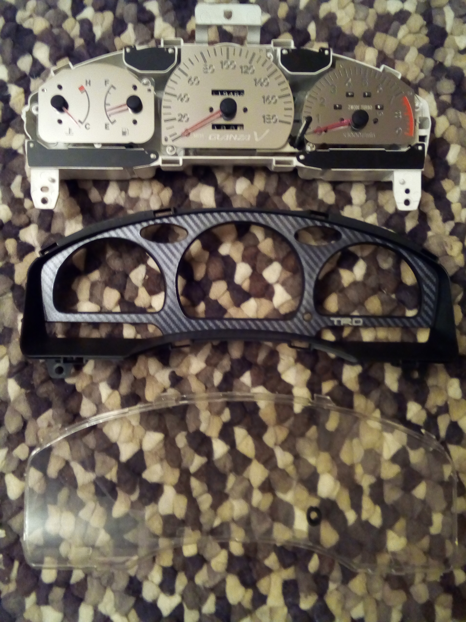

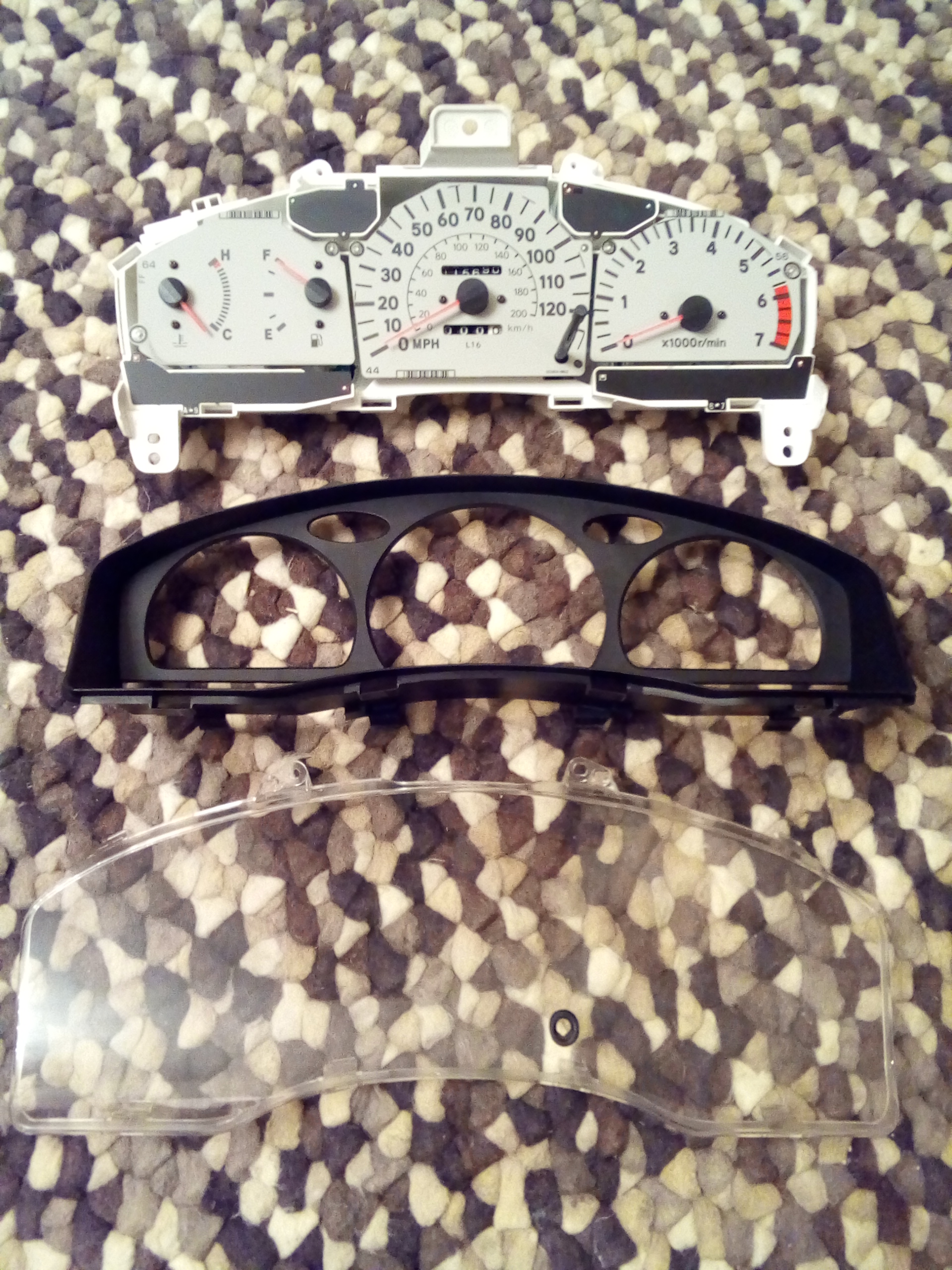

Decided to go with the lighter easier to read and wire in paseo clocks, it also has the near correct red line for my engine setup, also the gearbox Speedo drive mates with these clocks.
Just sat here working out the wiring. Think I have it sorted. Time to swap afew things around.
I'm using the perfect paseo screen cover.
I'll post on here the pin out conversion for
Starlet spotife, cd to paseo, glanza clocks.
Edited by Sam44
And the TRD glanza v surround.
Ep91 ukdm starlet cd clocks
Pink paseo needles. And mixed it up alittle. The orange ep91 needle is just there as reference.
The white clocks have purple led back lighting and the black has white led back lighting. Nice and visible.
This and the cup holders is the start of bringing the interior as upto date as possible. I'm going to get the seat belts done in red as well as replace the rear bench seat with something alittle more sporty. I'm also after an MR2 spider steering wheel For it.
In the end I didn't need to rewire the ep91 cd dash, I just swapped all the required clocks and faces + needles around installing them onto the cd clock  base.
I've posted them back to the my UK home, were Daniel will install it.
I'llget a video up of them dash + dash gauges + boost control + progressive shift lights in action.
Edited by Sam44

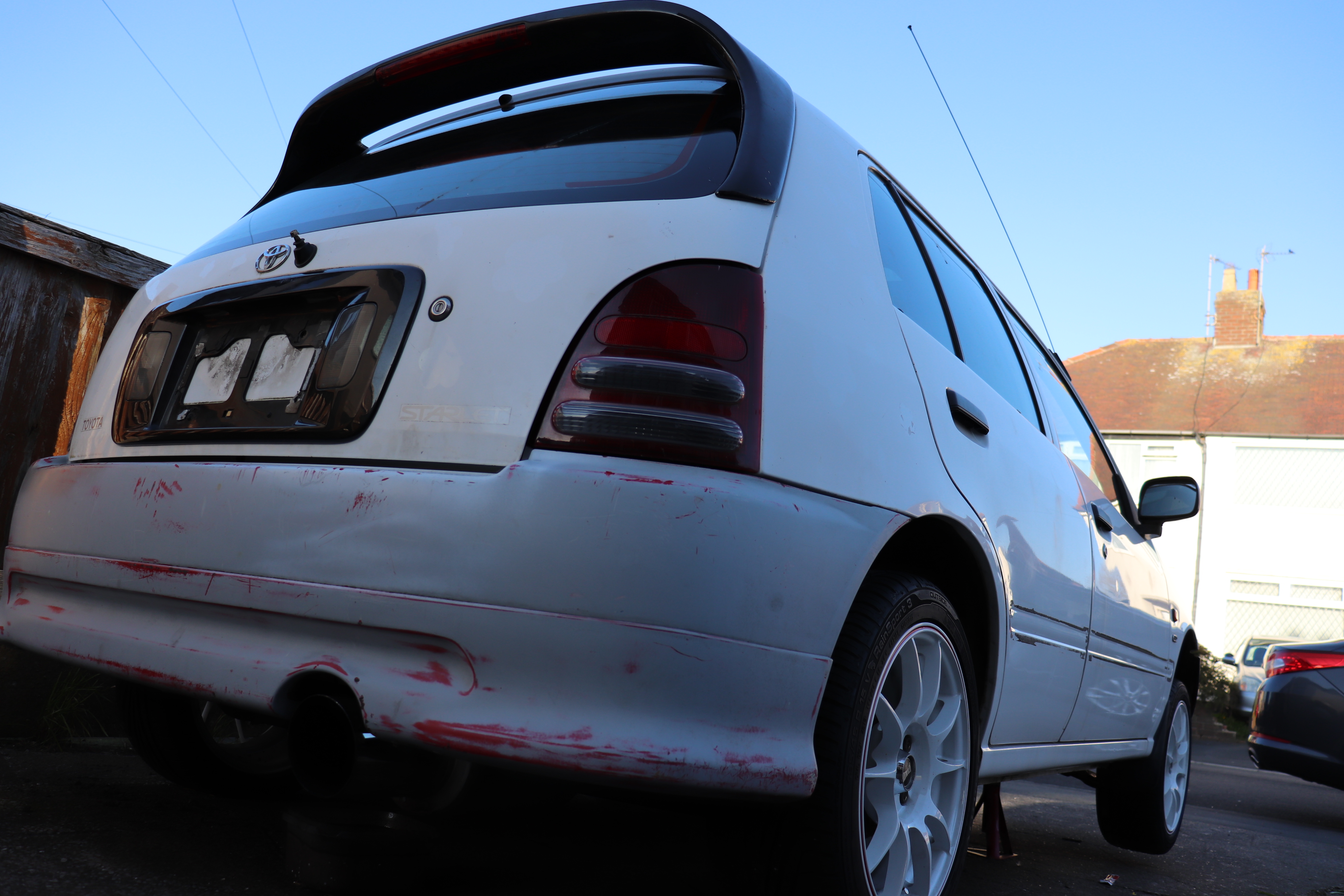

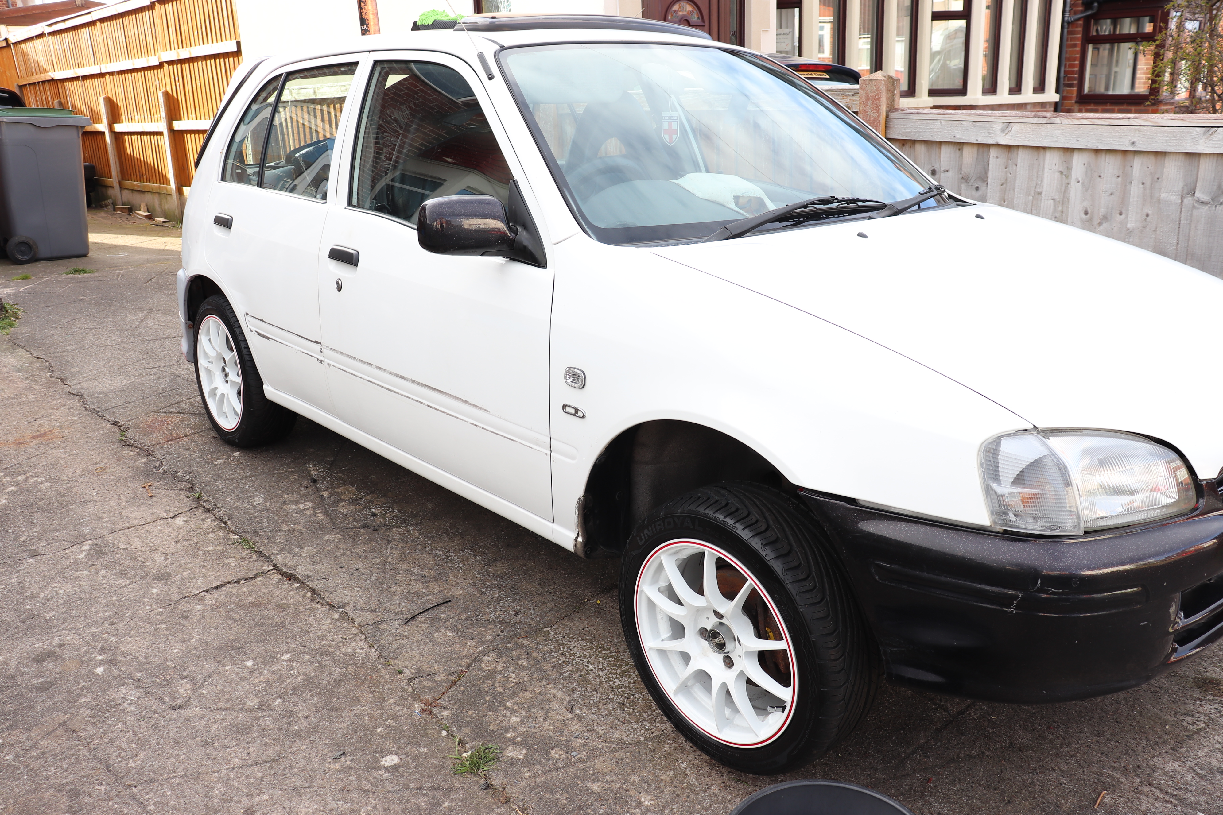

thanks. i didnt want to put the pics up of the body until it was painted, but i do like the rear lights.
here is 1 of the front  taken awhile ago the bumper has been smoothed over were the cut outs are.

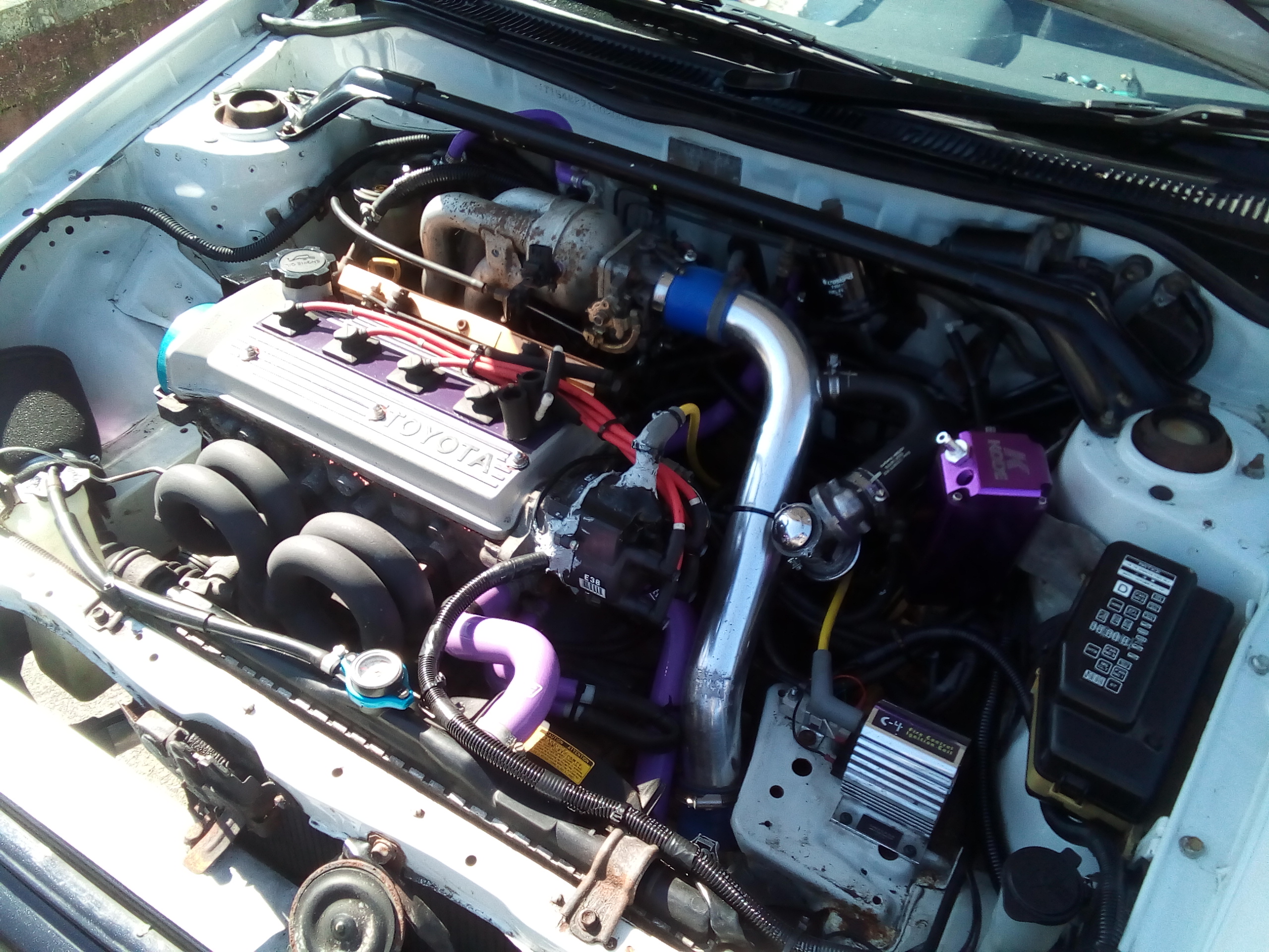

excuse the sealant on the dizzy cap (its certainly sealed) dans new to engine instant gasket.
I'm after a dizzy bag/cover but the only one's i can get at the minute are for v6,v8,v12 engines (a bit big)
The idea here with the cam belt top cover is to use fine stainless wire messing to neatly cover the cut out. Then I'll fit high visibility led light inside the cover to make the blue cambelt and purple top pully visable/highlighted/POP.
This will then give protection and I'm hoping look smart.
Edited by Sam44

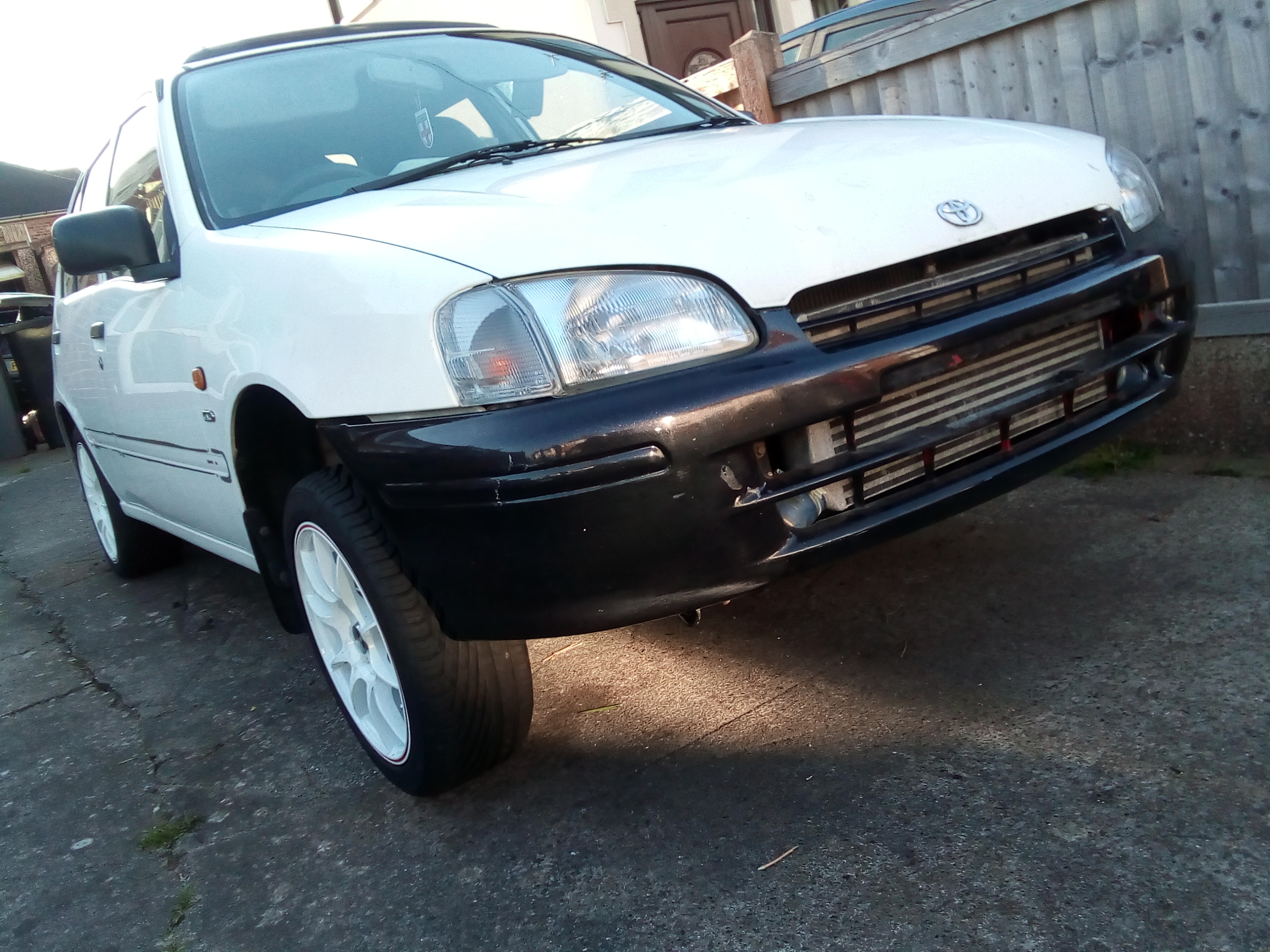

the front bottom cross member has been modified with 2x arches wielded in 1 on the off side 1 on the nearside its a neat job it looks like it came with these in there. the inter-cooler literally fits in the space behind the bumper crash bar, its still in there.
i do how ever need a good bumper dam (splitter) to reduce the air going under the front of the car. the rear bumper being larger brings a large aero drag zone, like a big old air brake. i need to reduce this with the front ground clearance if anyone can give me any suggestions.
Edited by Sam44
Nice work! Seems you have the same size intercooler as myself. Its such a perfect fit, I dont know why people havent done it before.
Those clocks look great mate much nicer than the dull ones in my SR nice touch

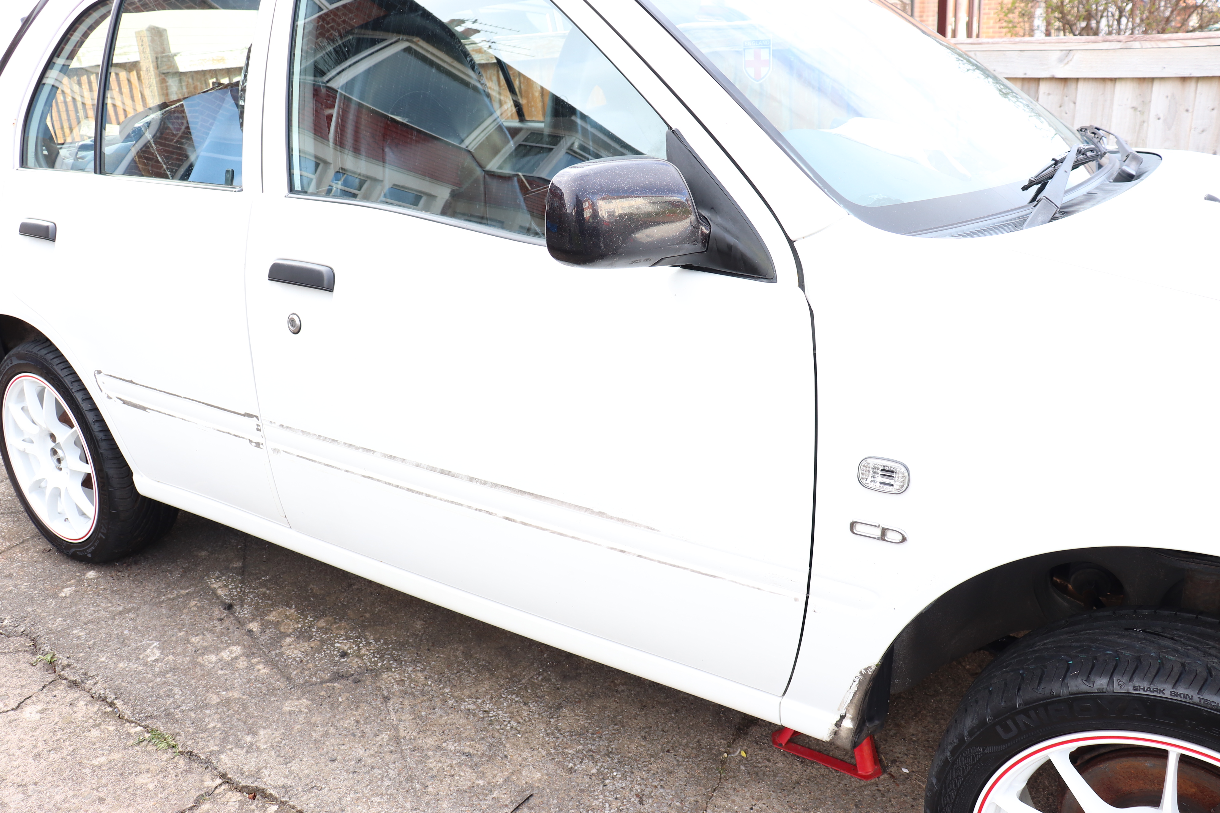

so today dans last day he has fitted the glanza electric mirrors and made/run a harnessed loom to the dash. i must admit these even still very basic are much nicer than the standard ukdm starlet mirrors as can be seen in the previous picture
fitted the clear wing side repeaters.
removed the toyota molded mud flaps ready for the side skirts.
and made a start on and removing the side bump strip tape left on the doors.

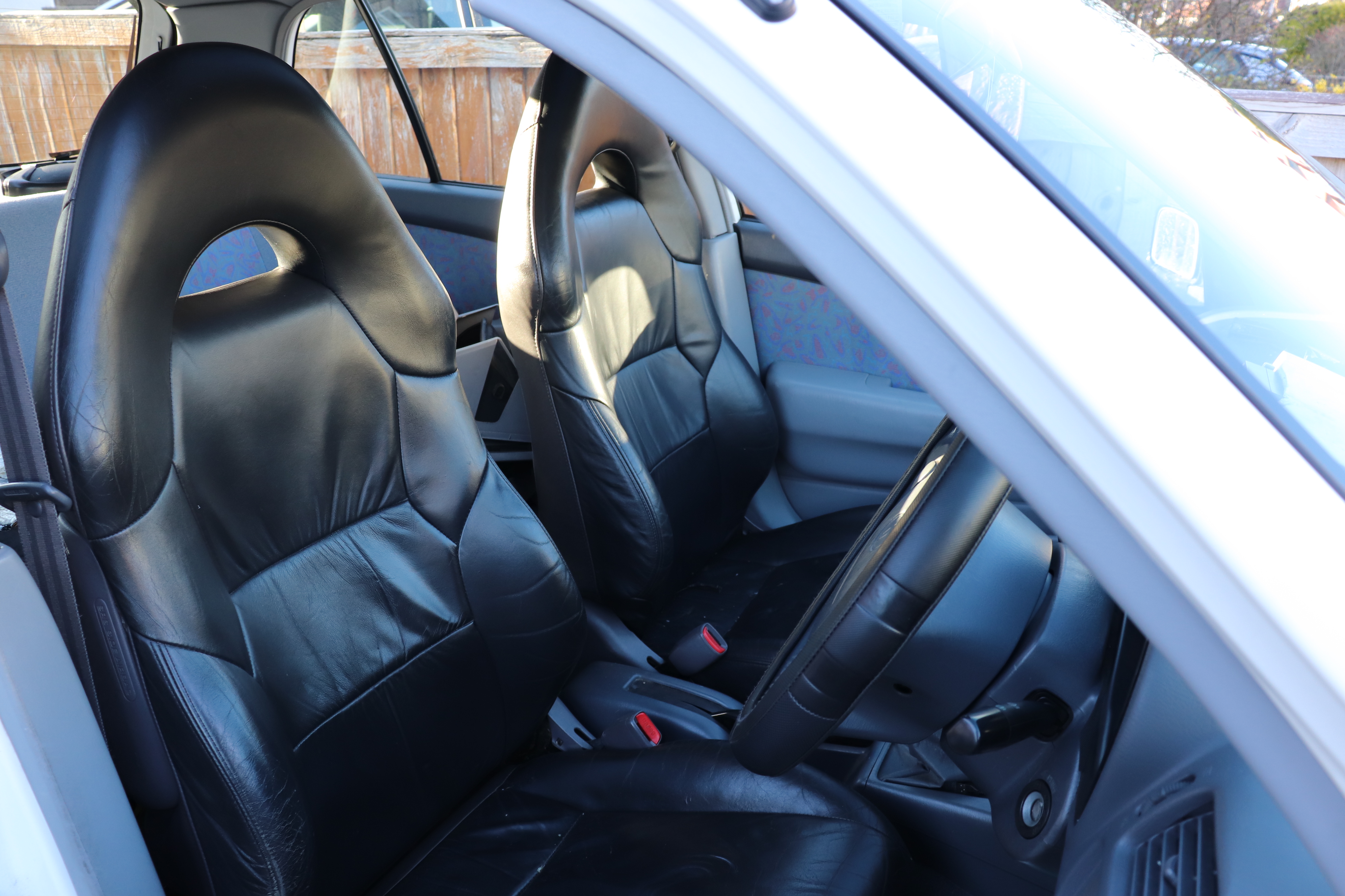

i believe the seats  are out of a celica (fully adjustable).

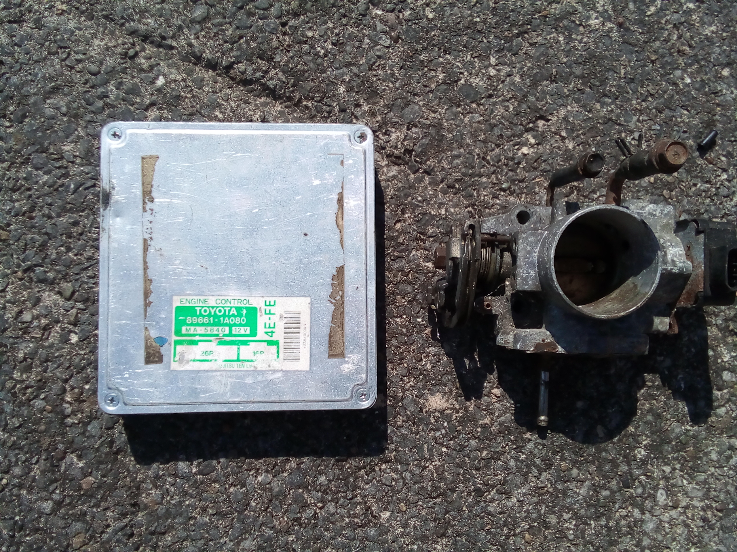

So it seems I can't keep dan away from the starlet.

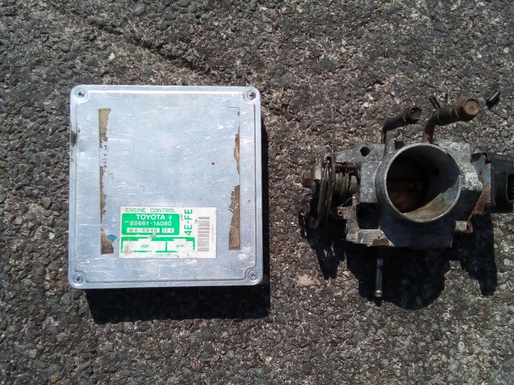

 we have decided to install the e11  88hp corrola tubular inlet manifold running along side the 4efte higher lift inlet cam.
The engine torque does not drop off like seen on so many 4efe due to the 4efte cam, but it does flatten out at around 5krpm. This is due to the manifold limiting air volume delivered to the engine.
we are going to install the bigger 4efte throttle body to allow more air volume threw. because of the difference in tps we are going back to the gen1 4efe ae101 ecu
Also we can achieve a better mpg using the ae101 88hp ems, plus the lamba closed loop operation is not as responsive allowing us to run it constantly.

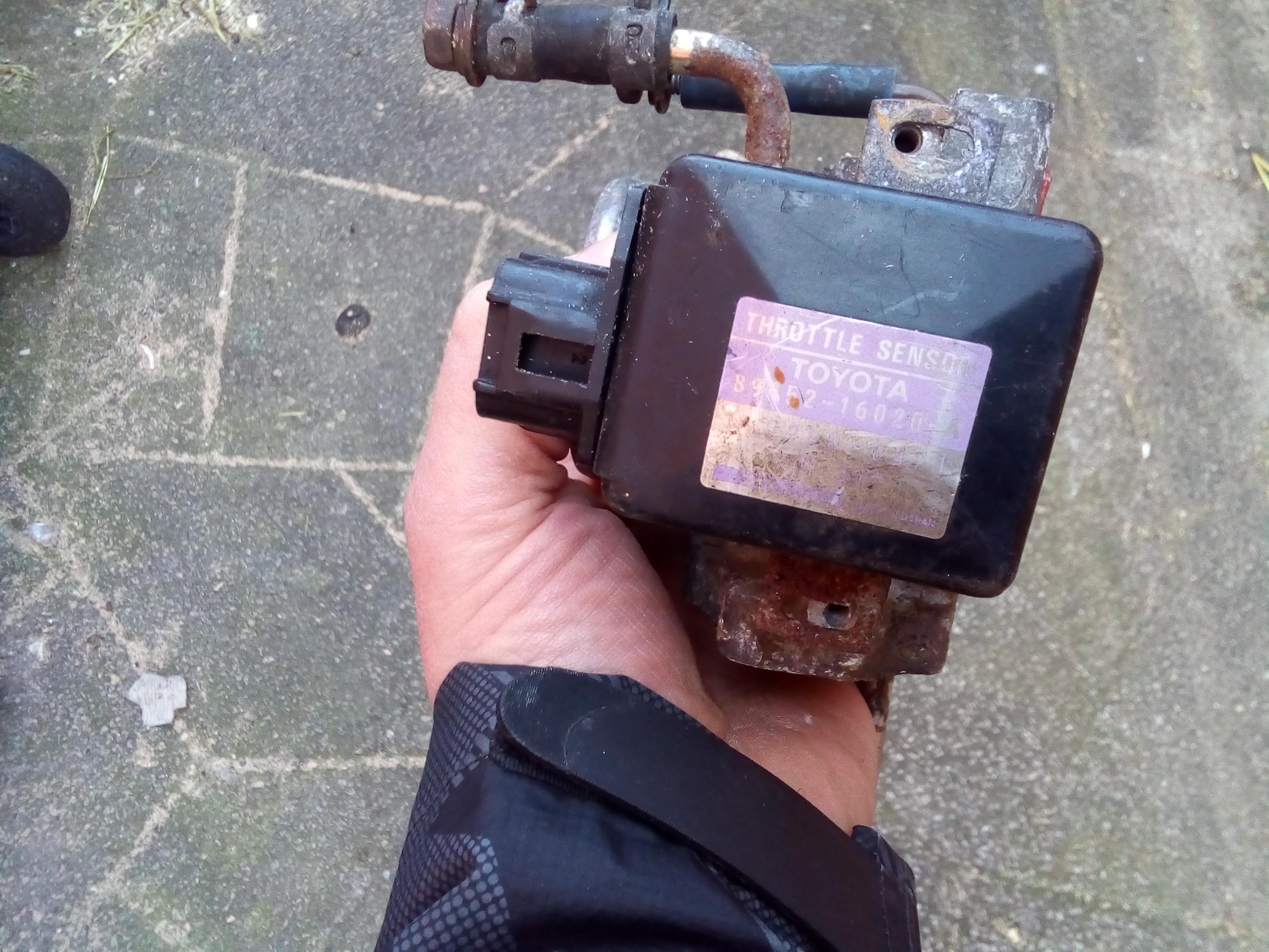

Installation of the ae101 4efe 88hp ems and bigger 4efte modified throttle body.

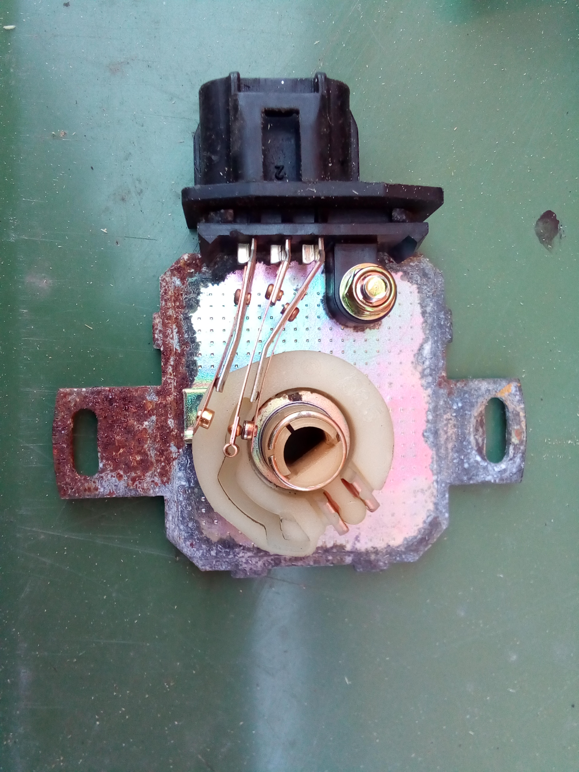

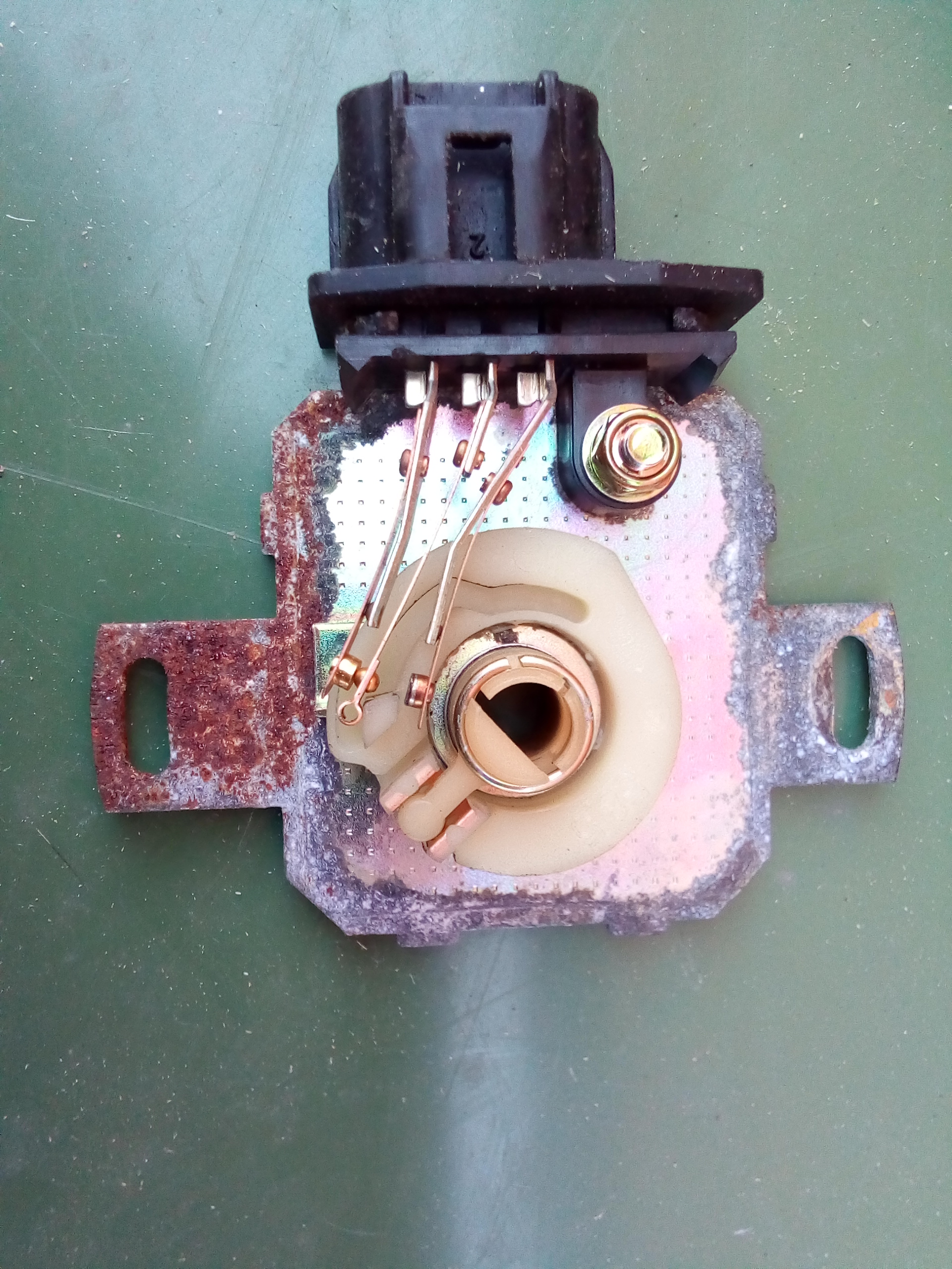

This ems uses a switch type tps rather than a potentiometer type which affects the fuel table/map. (fuel trim)
The UK ep91 4efe ems 78hp low torque,  has the same plugs there's just 1 wire to swap. I'll put up the how to on here.
we do not use the idle switch position on the tps (because it has a noticeable delay going into acceleration mode) i simple cut this wire green and red at the tps plug.
Below is the early gen1 ae101 corrola ems around 1991 to 1994 88hp, and larger 4efte throttle body. also in need of a good clean.
Here you can see the adjustable switch type sensor. Look at the mounting points. Also note the plastic cam type operating base that switches the center pin output to either bottom pin = idle mode, or top pin = input wot conditions.
The wot conditions do come in early not exactly on wide open position of the throttle valve so we will modify the cam on the base plate so to sink in the throttle valve and switch.

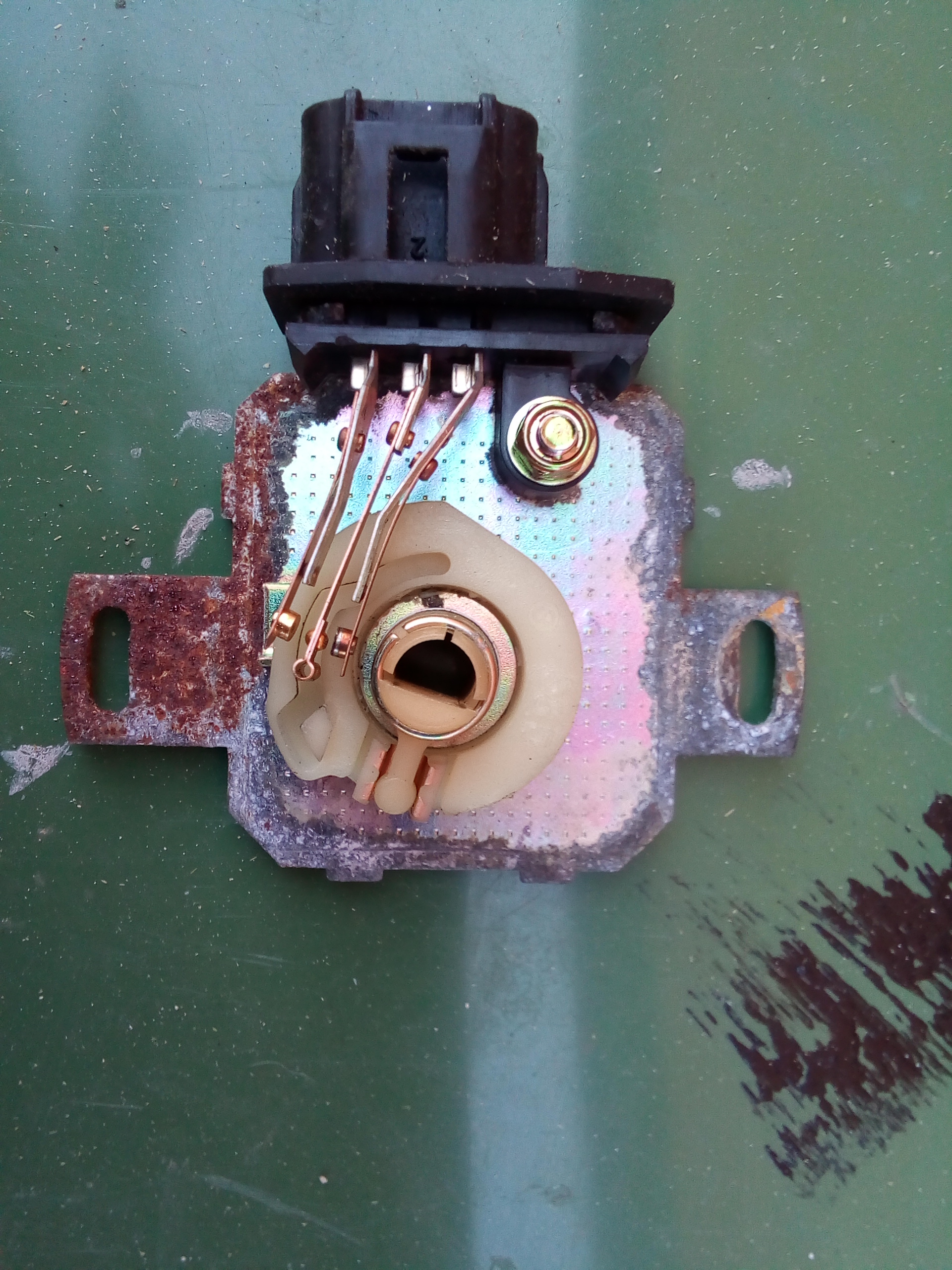

Idle position
Wot conditions

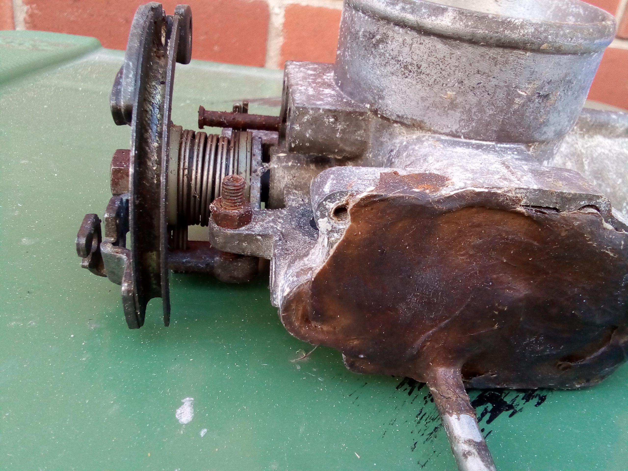

Bigger 4efte throttle body modified.
Here is the factory idle screw which we will use because the throttle idle up heater element has been removed and blocked off
Plus the throttle stop screw which we setup to reduce the pressure difference between pre throttle and post throttle running conditions, this will limit the chance of intake air stall (flat spot on initial throttle drop).
There is some modifications needed to the manifold throttle mount (opening out of the main intake port internal diameter), and a base plate needed making for the throttle body in order to use this combination.
this relatively easy install will help lead us in the direction of how we will need to design the manifold/power box using the 61mm larger twin throttle body. im trying to keep the small plenum chamber. its fantastically responsive.
the audi twin throttle also has a switch type tps.  with no idle switch.

Now set the tps using a multimeter so the idle position just touches. And plug the tps plug in.
We have found a timed delay between idle mode and acceleration mode/map on these ems types. So to increase response again you can set the tps so it's just off the idle switch this keeps the ems in acceleration mode. Setting up the tps/ems to stay in acceleration mode has no real affect on the idle, but does have an affect on mpg & emmisions, it still idles nice.
You will how ever need to drimmel/modify the tps base cam at the wot position, because you have now advanced its position. the wot position is now going to switch on early before throttle flap wide open position. You need to synchronise these 2 elements. On the factory ems the wot position switch once activated overfuels for safety killing peak hp. This is set to come on just before the throttle valve is in the wide open position.
Be warned this is a critical area of the map. Use the wot switch, never delete it, but good gains are achievable in this area of the map.
