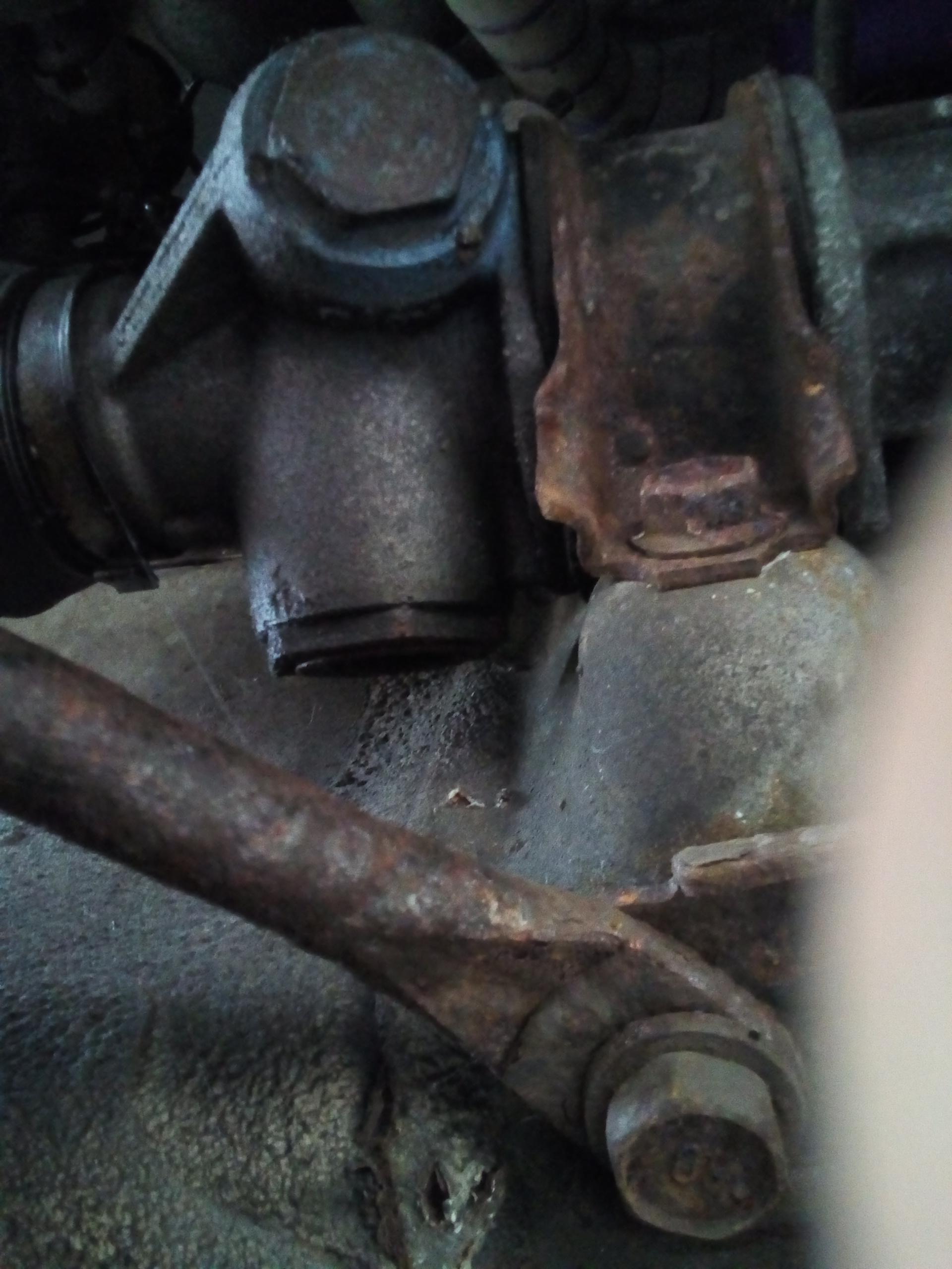

Im waiting on the front droplink roll bar arms and new bottom ball joints and top standard mounts. I can refresh the suspention.
I've also tightend up the steering rack (rack to pinion gear preload) to give more road feel feed back and steering response. Makes a hek of a difference.
At the minute it has the powerflex antilift kit which has started to wear so I'm going with the whiteline 1 this time round. It was used on track for 2xyears things are alittle worn.

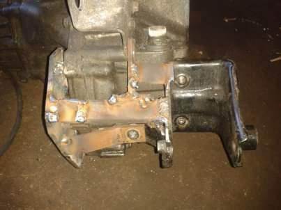

Ive just knocked this up on one of the gearboxes I have here.
Strengthend rear center engine mount. I'm going to paint and fit it to the 6speed starleto.
Productive 2days back to work tomorrow.

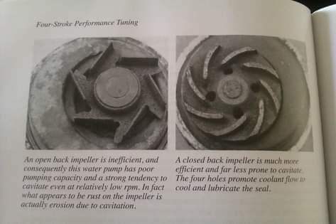

Also some information I've been sent about the water pump impeller I'm running.
This and a low temp thermostat really allowed some good boost pressure to be put threw the n/a engine

I was wounded when the rear gearbox mount simply ripped out of the c160, such a good gearbox. Im going to add a engine shocker located central/inline to the differencial.
The water pump mod is really very simple adding a closed back impeller to a standard pump and getting it balanced.

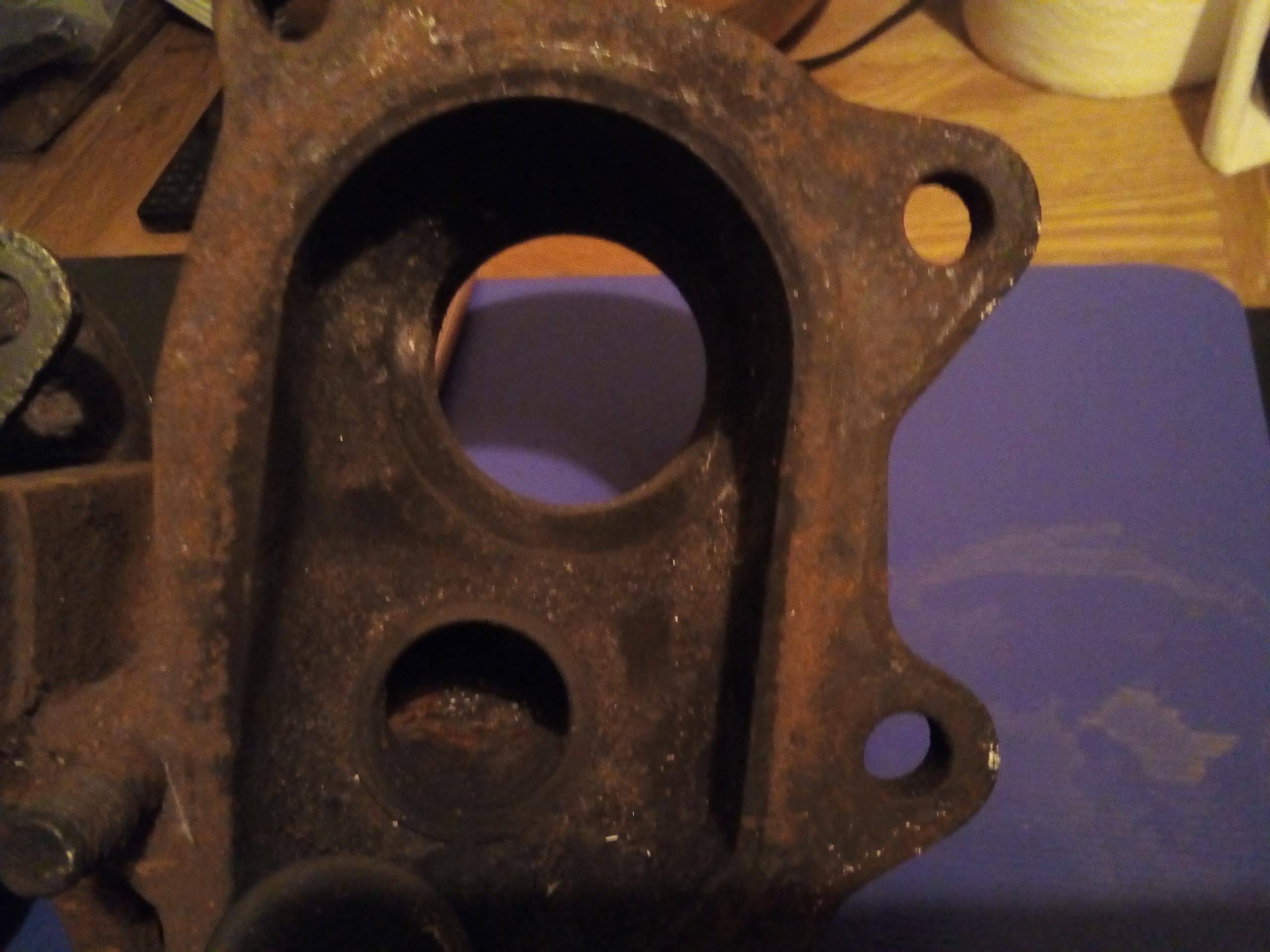

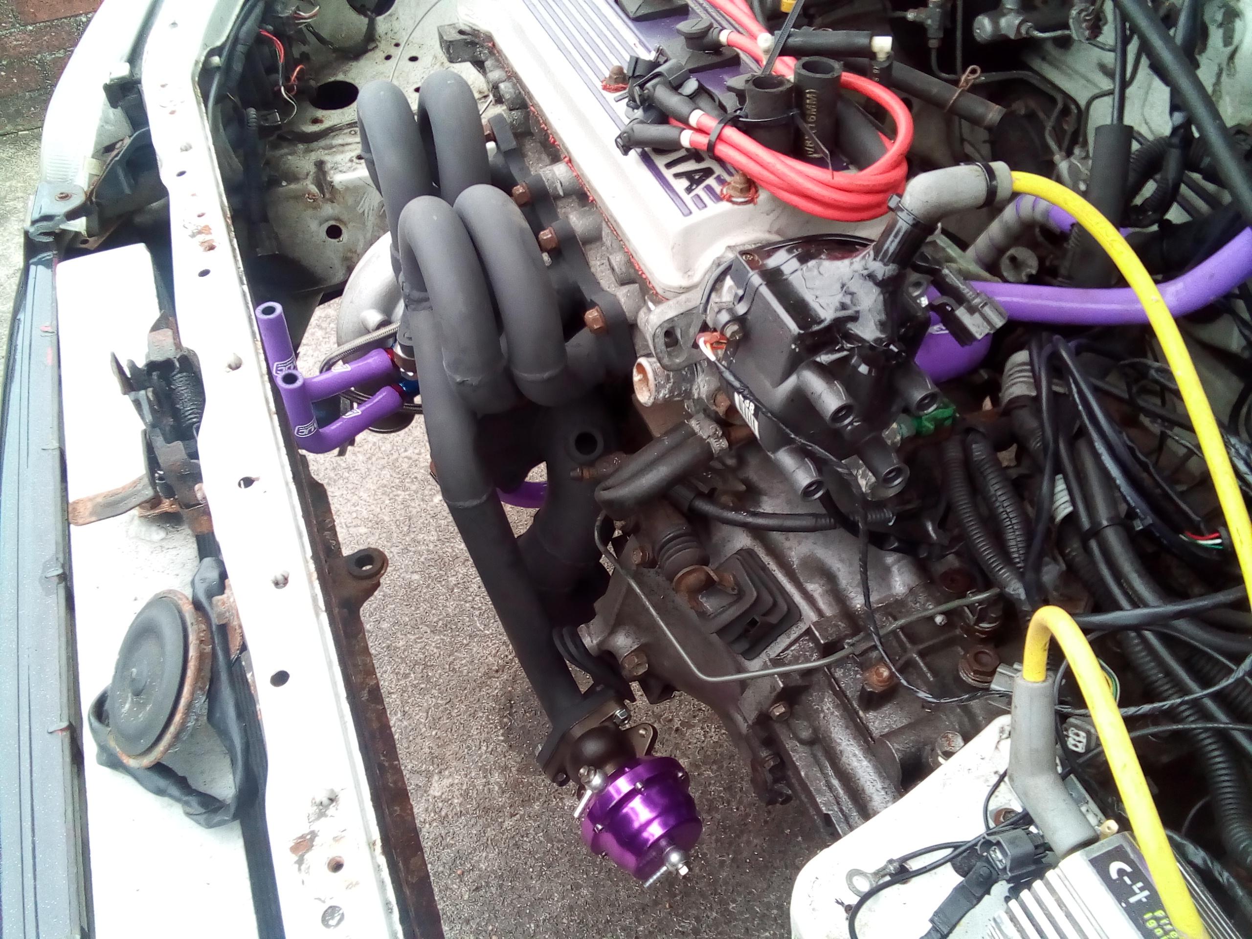

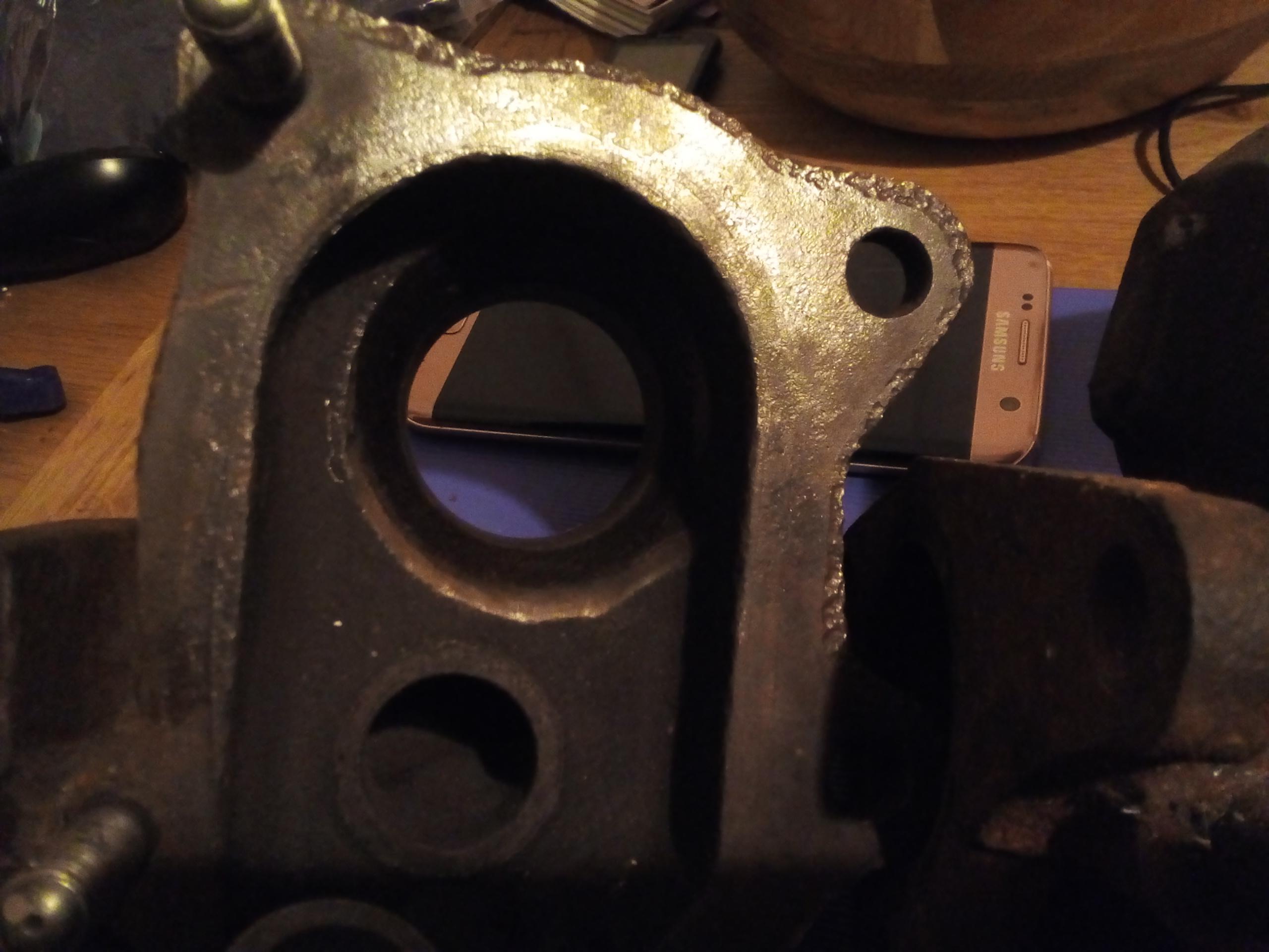

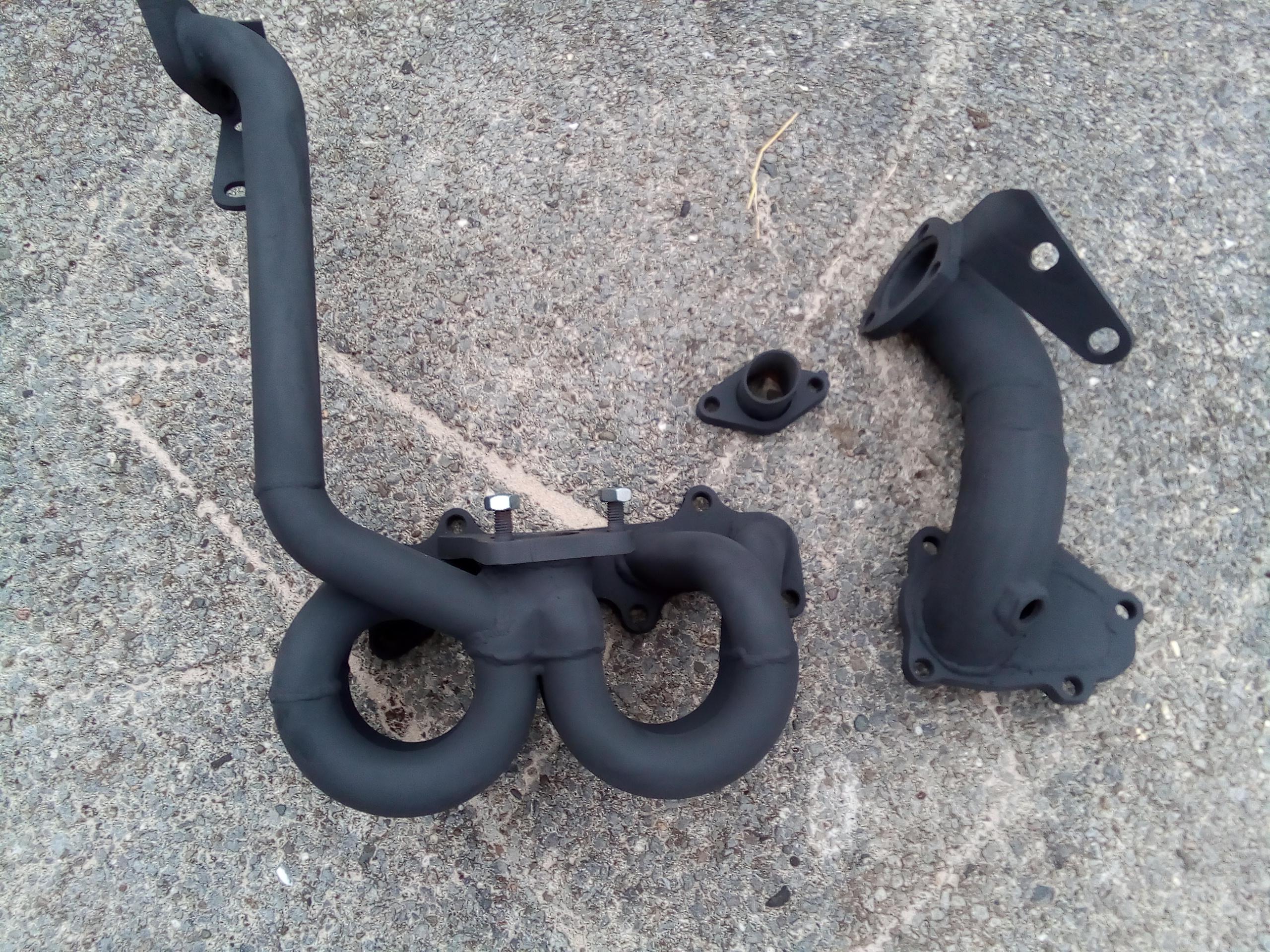

A good friend of mine has used the old zisco manifold and made a jig for this a new manifold/turbo kit.

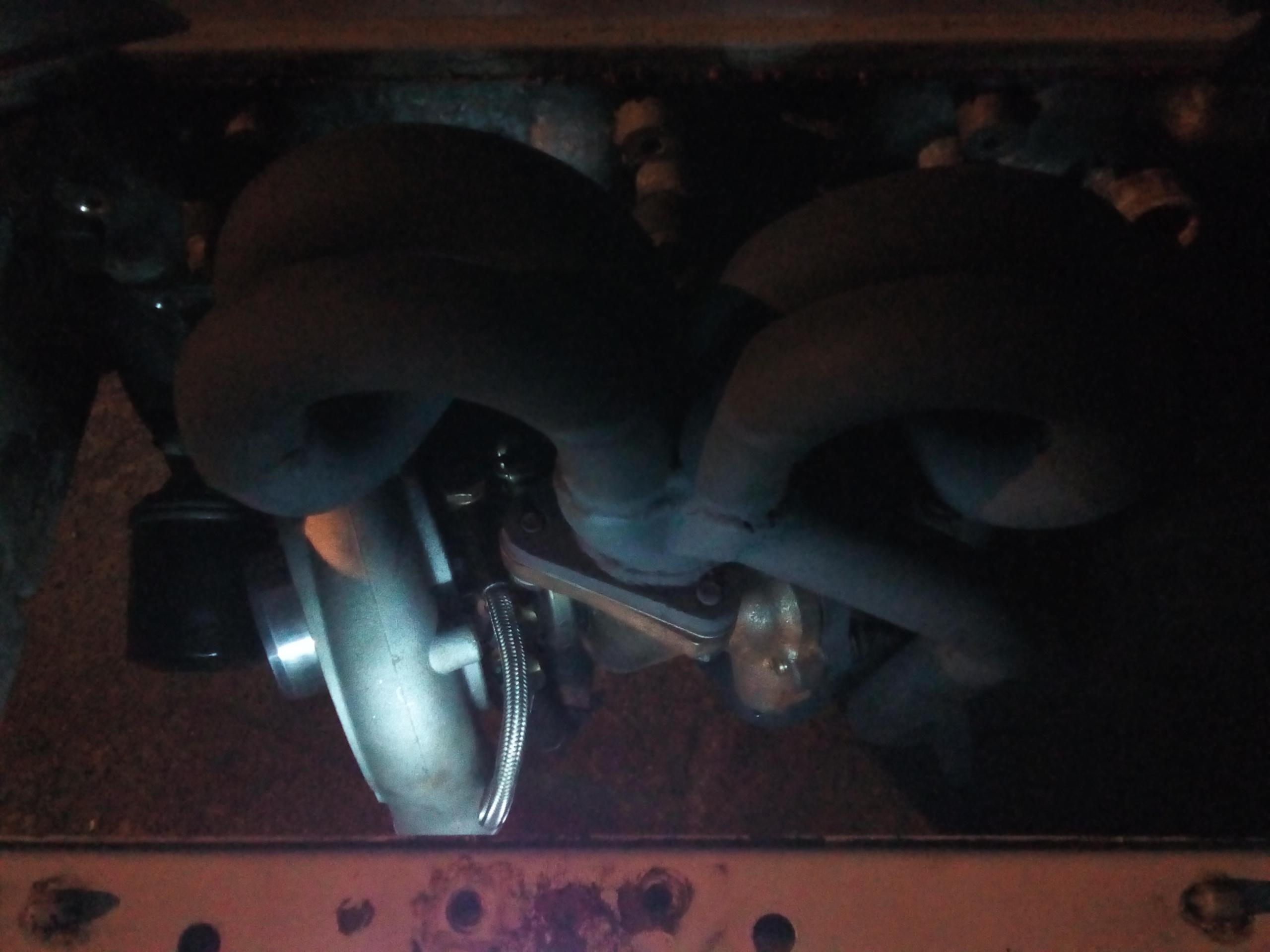

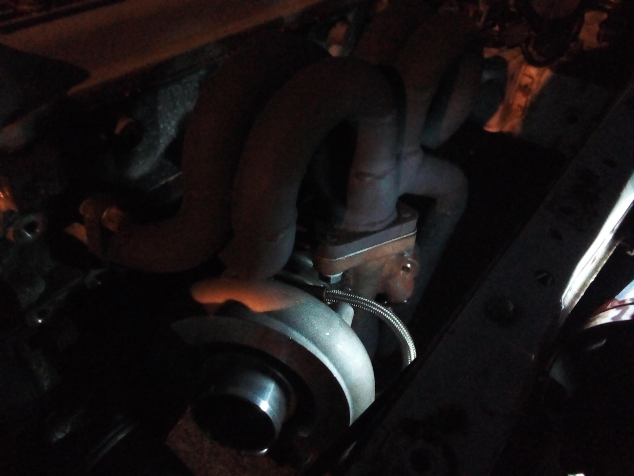

The turbo has evolved again this time using a td05 20g antisurge compressor housing modified to fit the 13t hybrid. I could not trust the surge I was getting with the 4e skinny rods. This should also pump more volume of air but at a smoother rate in the rpm band.
The old 1 was good just heavy corrosion.
He is fitting this new kit to car whilst I'm away.

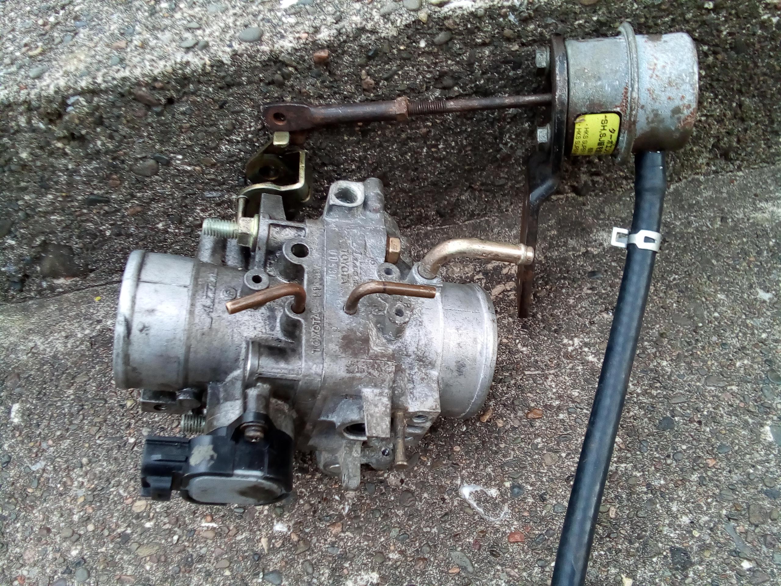

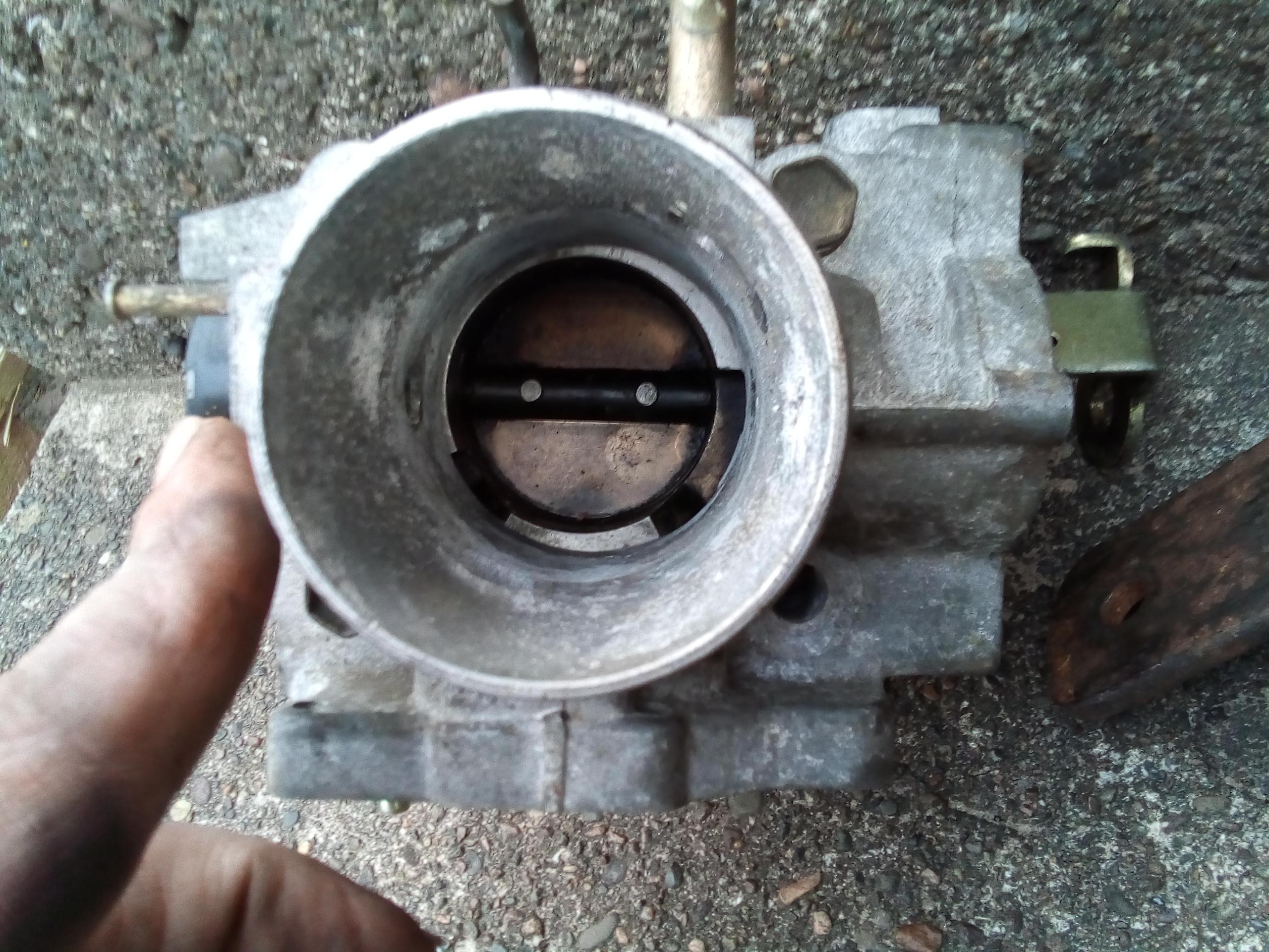

I'm currently making the pre turbo throttle body.
Made up of 2x back to back 4e series throttle bodies 1x 4efe and 1x ,4efte striped out using a hks actuator to operate/open with turbo boost pressure.
Time to start fabrication.
All new nuts bolts and gaskets used.
Refreshed.

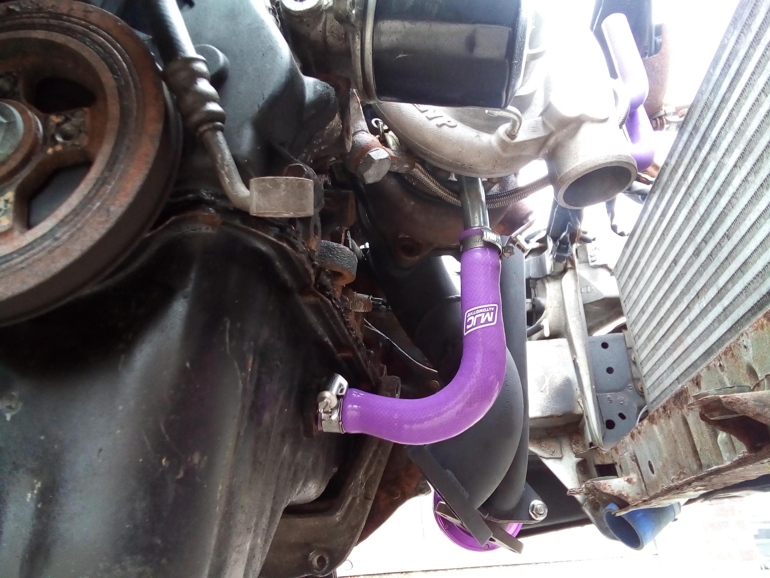

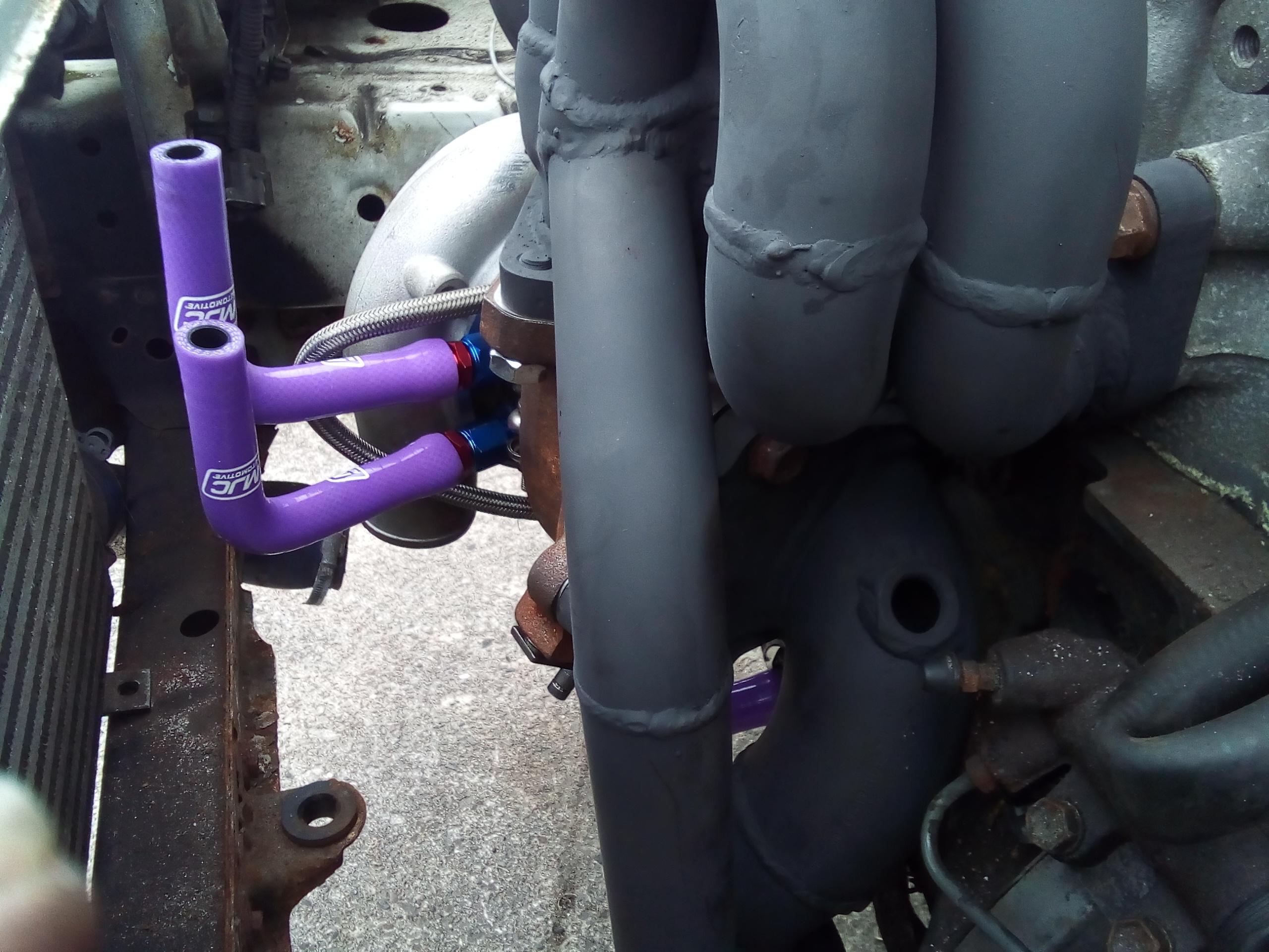

1 word :         PURPLE
If this is to lazy I've have a rare tdo4hl exhaust housing and I'll use an 11 blade turbine. That's is alot lighter than the 9 blade option I'm running now.
Bigger tdo4hl exhaust port.

Your quite correct on the throttle body before the turbo. Gordini first introduced these on the Renault engine in the late 1980s F1 era to reduce turbo lag. It simple removes load/air from the compressor wheel allowing it to free spin. As the throttle opens slowly it increases air velocity into the compressor inlet.

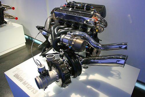

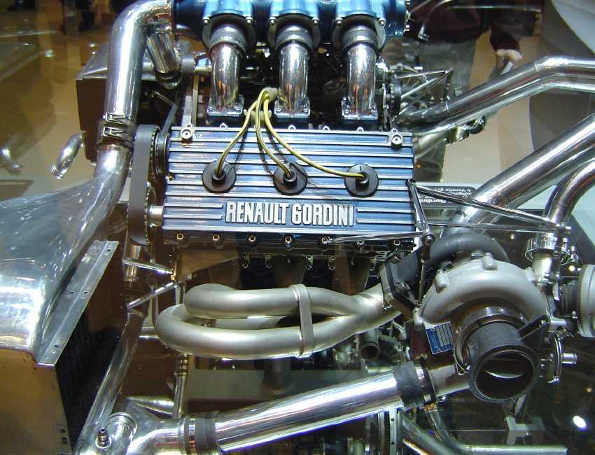

Massively mighty and equally impressive BMW 1.5 four cylinder 1980s F1 era 1500hp turbo engine sporting the before throttle body as seen.
Also the V6 1.5 1500hp Renault gordini engine 1980s F1 also
Other engines: honda & Porsche tag turbos also ran throttle bodies.
Yep it's still the original 4efe engine, we have carried out full comprehensive test on the health of the engine, hydrolic test to check ring seal compression tests, oil pressure tests, leak back test to check valve seal. All came back spot on. The engine has been looked after, it was rebuilt with extras 2years ago.
The oil will be tested for grade and contamination levels after the full setup is complete, mainly to check water, fuel, grade levels after 1 complete winter and summer cycle.

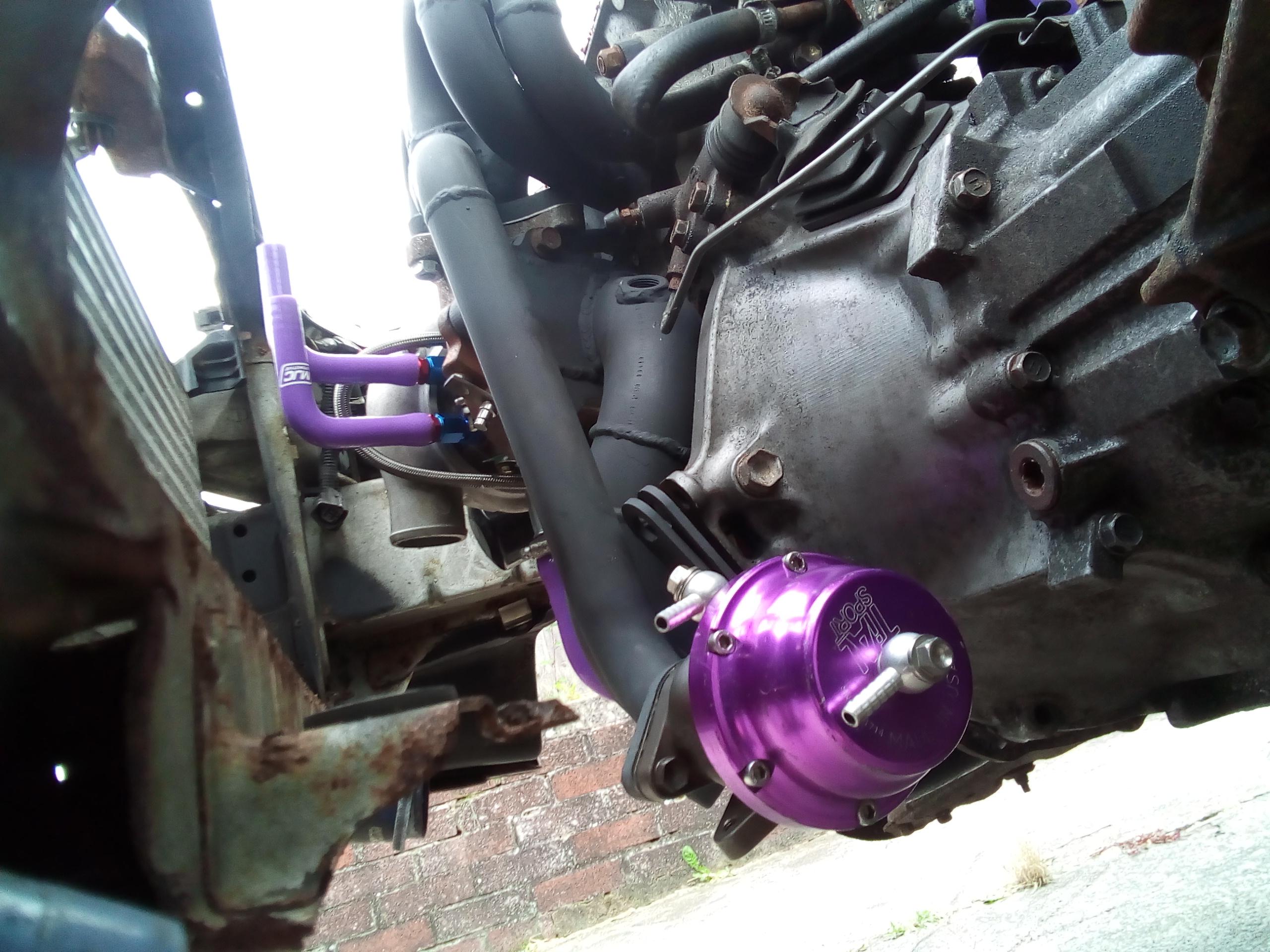

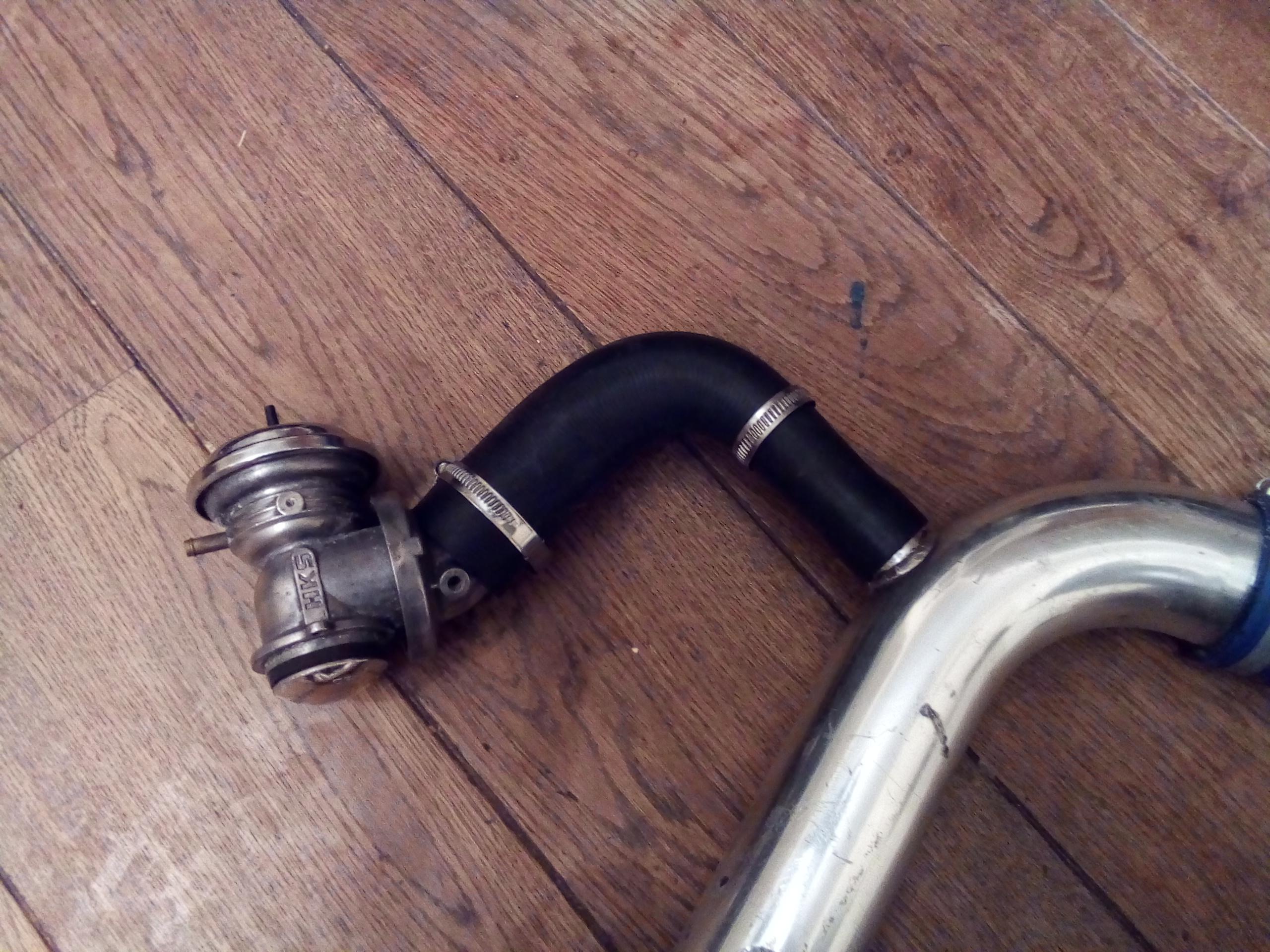

The additional pwm table on the aem ECU will operate the hks blow off valve located just before the engines throttle body it will run operate off the 4efe tps (potentiometer) on the pre turbo throttle body which opens off the hks adjustable actuator. The blow off will open at set low turbo pressures in relation to rpm/engine load. This will remove load on the turbo compressor wheel (both removing back pressure and incoming air to pump, creating a vacuum) and allow more air to enter the engine and drive the exhaust turbine.
The hks actuator is plumed directly into the turbo compressor housing pipe (direct boost build).
The car came with the Baily's bov valve (bucket type) I was warned about high maintenance if you do not run a oil catch can and good engine air filter, after some research I found the early hks blow off valve was the 1 for me very robust.
The system might sound complex but it's really quite simple, the only real hard part is setting up the pwm table.
The aim is to get the turbo spinning and keep it spinned. (Anti lag)

The importance of coolant engine block pressure.
https://haynes.com › tips-tutorials
Understanding your car's coolant pump | Haynes Publishing
https://professionalawesome.com/how-to-make-your-street-car-cooling-system-track-day-and-race-ready/

Steering rack (rack and pinion gear) preload at the bottom of the picture, locking nut and Allen key capbolt. Not the large bolt facing in the top of the picture. Great handling mod.
