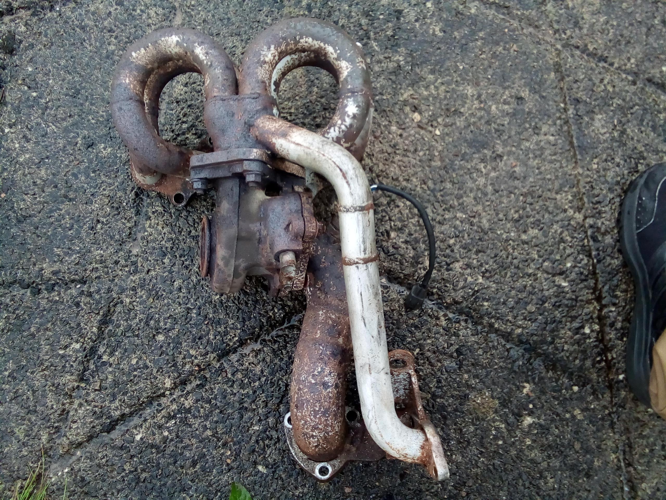

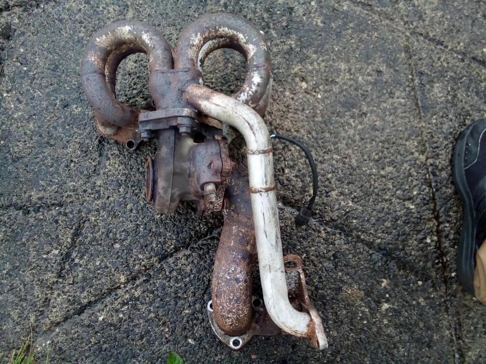

Older turbo kit that came with the car. (Just alittle squabby) against new kit setup

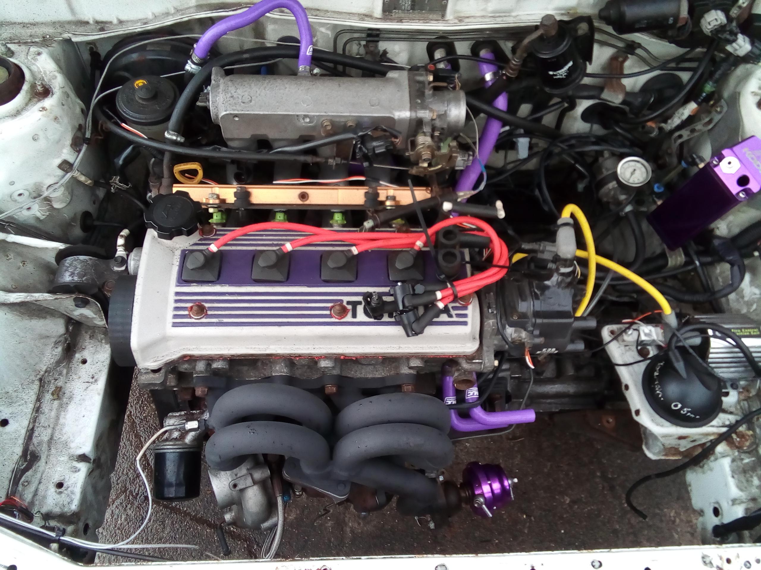

This was as all the sensors was being positioned and wiring installed.
2x egt.
Intake temp repositioned.
2x nock monitoring sensors.
Wide band 02
Repositioned original O2 sensor.
Repositioned map sensor close to throttle to achieve a 1 to throttle against map response.
Pictures to follow
Fuel pressure sensor.
Low coolant level warning sensor.
Battery relocation
Twin fuel pump relay setup and wiring.

Is there a reason why you fitted your pre turbo EGT in the runner of Cylinder 1, seeing as you only have one pre turbo wouldn’t it be better to take an average in the collector?
It's mainly because cylinder 1 runs the hottest. the inlet design (position of cylinder 1 in relation to the throttle), and fuel rail. with cylinder 1 also the last injector on the rail. There's a possible link as to why this cylinder runs the hottest.
Also with it running the hottest im foucing onit.
Using cast pistons this cylinder is the 1 to watch (expansion in the bore)

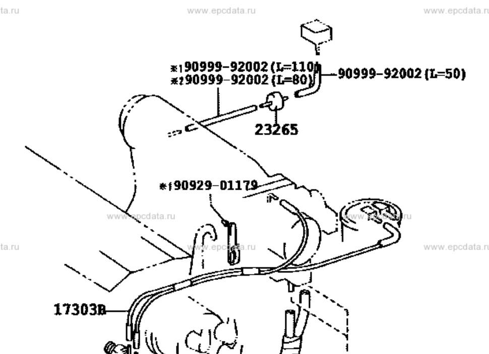

I'll put up a picture of the Toyota fix using a antisurge check valve on the delivery side of the rail. That was introduced on all later e series engines across the range.
In the picture notice the additional valve on the delivery pipe/side of the fuel rail.
This is a inline check valve to maintain rail pressure and reduce pressure surges, a Toyota factory item.

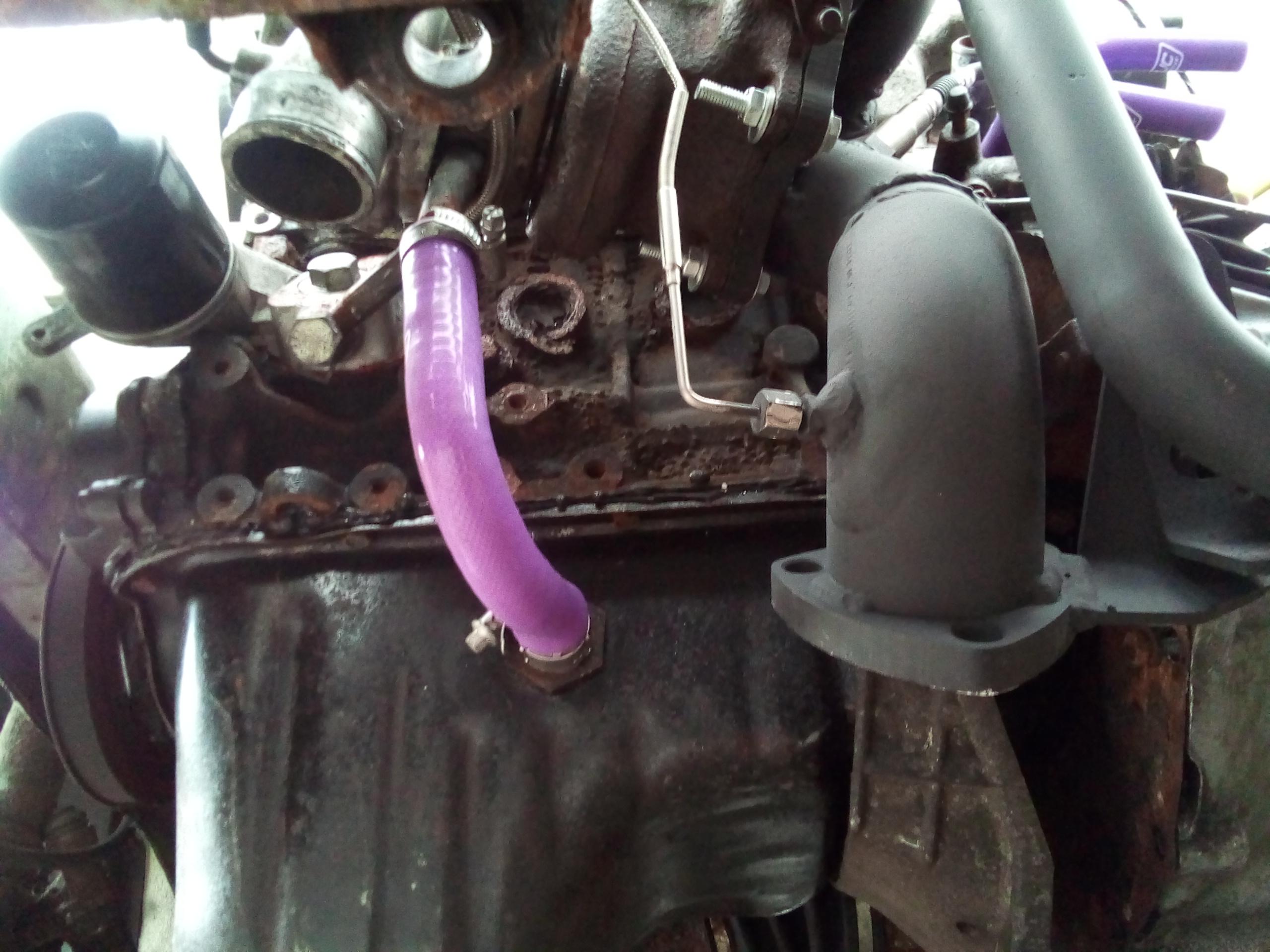

Look at the real length of this map sensor pipe above, it literally creates its own plenium chamber (it create a pressure delay compared to the manifold pressure). This gives a loss in throttle response and delay in the map lookup/reference tables. Lost hp.
Another very good basic mod along side this is to use a aftermarket engine earthing as well as placing an additional earthing line to the vehicles bulk head, this is were all the in vehicle earth's run to (return to battery). It's important to place a earth line to the cylinder head for the sparkplug (return to battery) and one on the inlet manifold this is were you will find the engine sensor earthing bank (return to battery).
This sharpens up the main fueling sensors inlet map/temperature sensor to an impressive point.

I meant an actual filter in line (as fitted by toyota 23265) which has the effect of smoothing the map sensor fluctuations.
I had a fuel pulse damper on my old weekend toy and I removed it with no ill effects when it failed and was NLA from the dealer. I understand its function and sometimes its is only fitted to reduce NVH into the cabin rather than a weird conflict that can cause lean spots or fuel delivery problems. Quite a few aftermarket FPR's have this feature built in nowadays any way.
I've checked the online Toyota parts catalogue and it is only listed for the very early 96 model 4efe and not listed for the 4efte at all. Maybe Toyota realised it wasn't necessary on a stock car.
