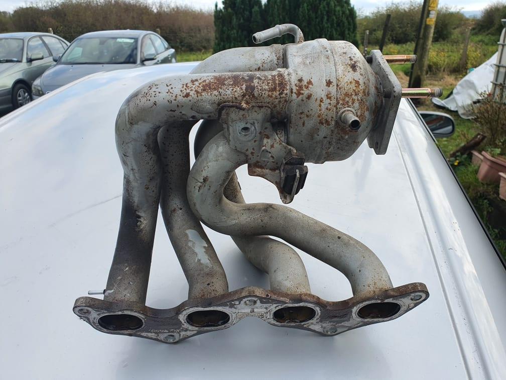

RoyalDutchie Posted October 3, 2020 Posted October 3, 2020 (edited) Found a corolla inlet. If you are interested we could sort something on the other forums since pm's still do not work here. Edited April 9, 2021 by RoyalDutchie Quote

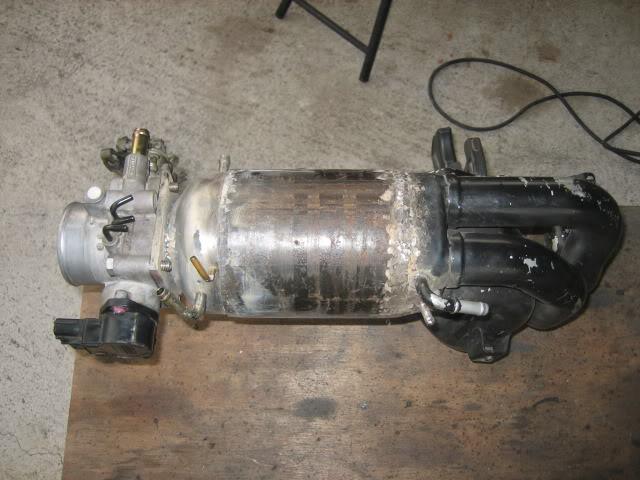

Sam44 Posted October 4, 2020 Author Posted October 4, 2020 I've just seen this now. Thank you, I'll be on shortly to sort that out. It is by far the better manifold for boosted engines 250hp and under. Quote

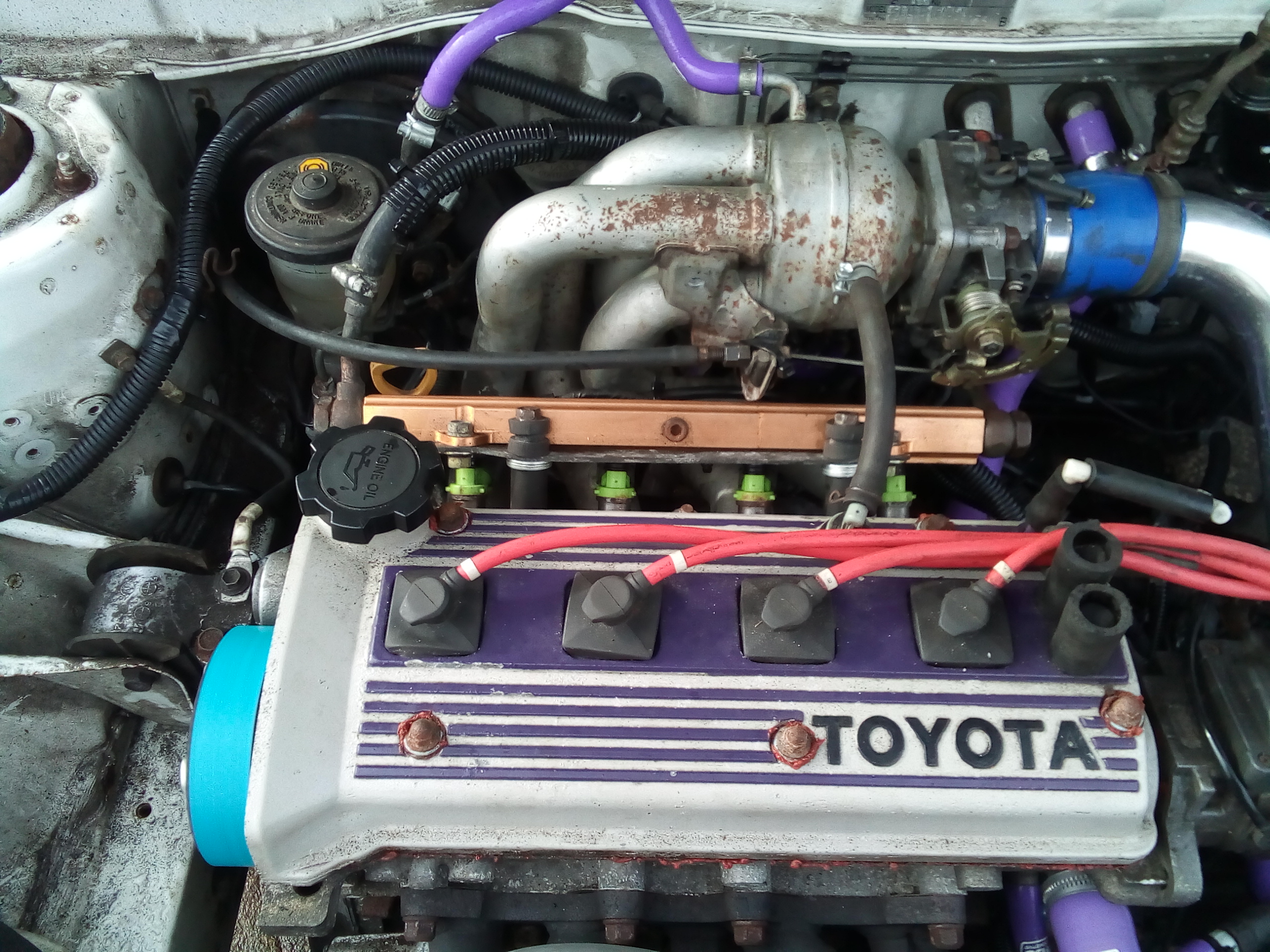

Sam44 Posted October 25, 2020 Author Posted October 25, 2020 (edited) Some interesting developments today on the starlet, the first day we have managed to take the car out for afew weeks. We have really managed to shake down the turbo lag/boost deliver system with great results. We have delivered additional hp/torque in the 2000 to 3000rpm band with reduced turbo lag on standard td04l unit. 3000rpm is the point boost pressure is delivered to the engine. We have also had to use the external waste gate to help regulate turbo rpm before peak boost to keep intake charge temps down (the turbo just wants to run away with its self) @ .5bar it's hitting an estimated 200hp on a standard tdo4l unit. The fueling figures read: 4bar constant fuel rail pressure 372cc 3sge green injectors running at 70% duty. Reduced from 80% with the additional walbro fuel pump in the system. We have then used the pre turbo throttle to control boost pressure against increased turbo rpm to deliver a gradual power delivery safer for the 4efe engine. I'll post up diagrams of the system very soon. I'm a happy chap today. Further developments to come: Box in the hks blow off valve (original intercooler piping position) adding a small bonnet scoop and air filter. (This valve remains open out of turbo boost to allow the engine to breath to its full potential) the scoop and box will bring in cool filtered air. The boost/torque control system is starting to become complex. A Fail safe system/devices will be introduced incase of a fault happening. We are currently looking to design a electrically controlled veriable geometry exhaust side of the td04 hyb also housing an rpm sensor. I also have a corrola tubular manifold on its way thanks to dutchie that will be modified with a increased plenum chamber volume/size this will increase set off engine torque and deliver a even cylinder power delivery. This graph is off a 4efe ep91 starlet using the tubular manifold to great affect from 0rpm to around 3000rpm you can see the constant torque delivery this manifold delivers (increased air velocity/inlet gas flow) increasing low to mid engine rpm cylinder volumetric efficiency. The aim is to achieve an almost table top torque curve. (This is 1 of the best 4efe graphs I've seen running this manifold compliments of skinny). you can see the immediate engine power/torque delivery from this manifold, and also the sharp power drop off around 5krpm. this enlarged plenum chamber and the twin audi 55mm+ throttle and also the normally open bov will deal with this area keeping it up with the turbo amplifying the graph. here is a recently turboed 4efe running the tubular inlet (look how the drop off remains and the boost build is very hard to spot) amplified by the turbo. there is also the option of using the 4efte inlet cam to again help mid to high rpm power/torque. this manifold and cam combo. Bellow is a picture I was sent as to how the lads in Jamaica modify there inlets to achieve better 4400 to 6000rpm power. A good tip on saving money and using great air filters is to get an itg sock filter For a side draft card or itb. These cost around 25quid and are used in top class motor sport. Temp fitting to get a feel for the increased turbo spool and lowdown torque. Makes a hell of a difference on the tdo4l hyb, knocking a good 500rpm off the start of boost build. Edited March 8, 2021 by Sam44 Quote

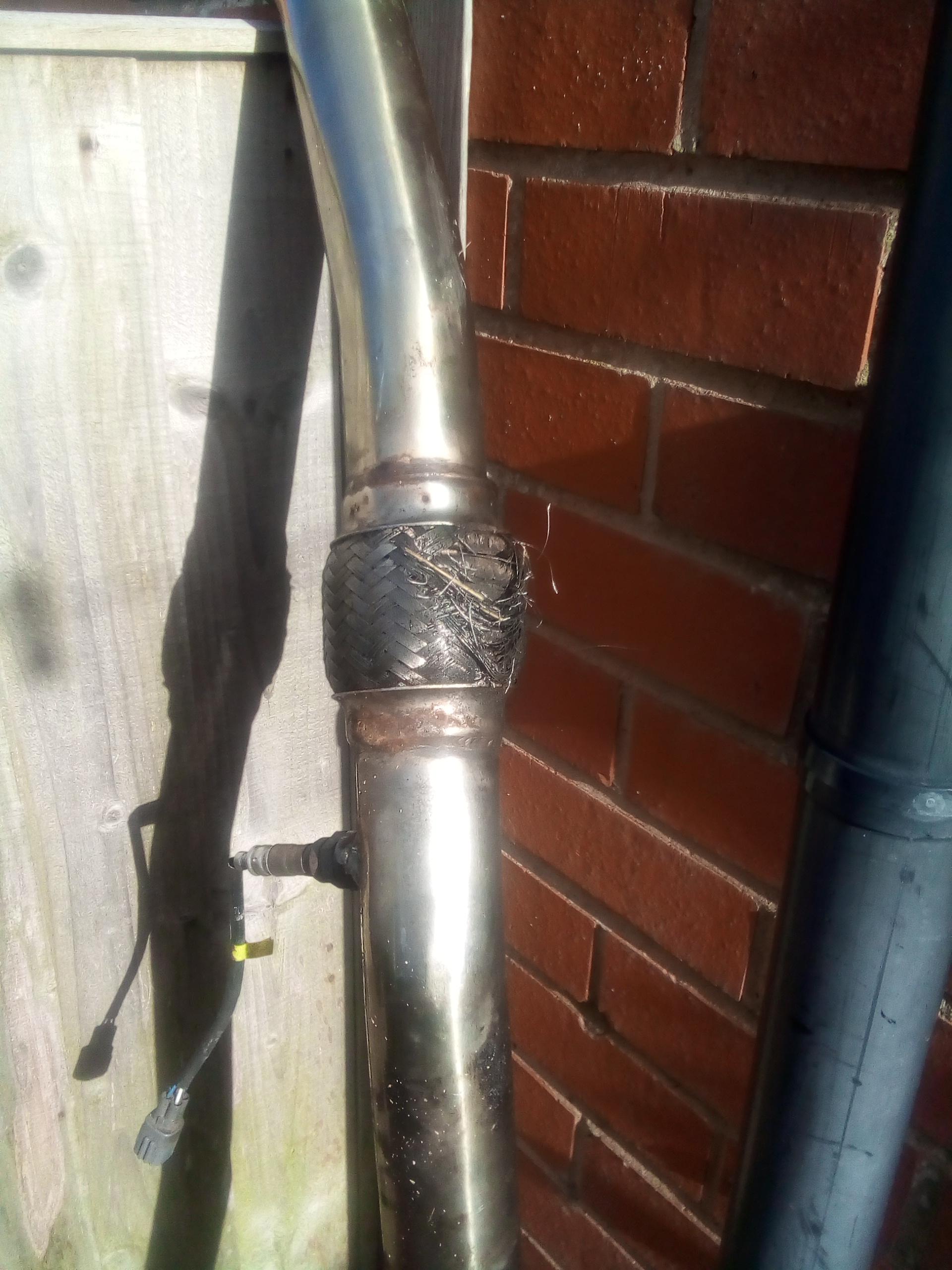

Sam44 Posted October 26, 2020 Author Posted October 26, 2020 Oh dear. I think the ride height is alittle low. Daniel hit the exhaust Flexi whilst setting up over the weekend. New longer Flexi on order. Does any body know were I can find gaskets for the early japspeed exhaust I've emailed them in the past with no reply. Quote

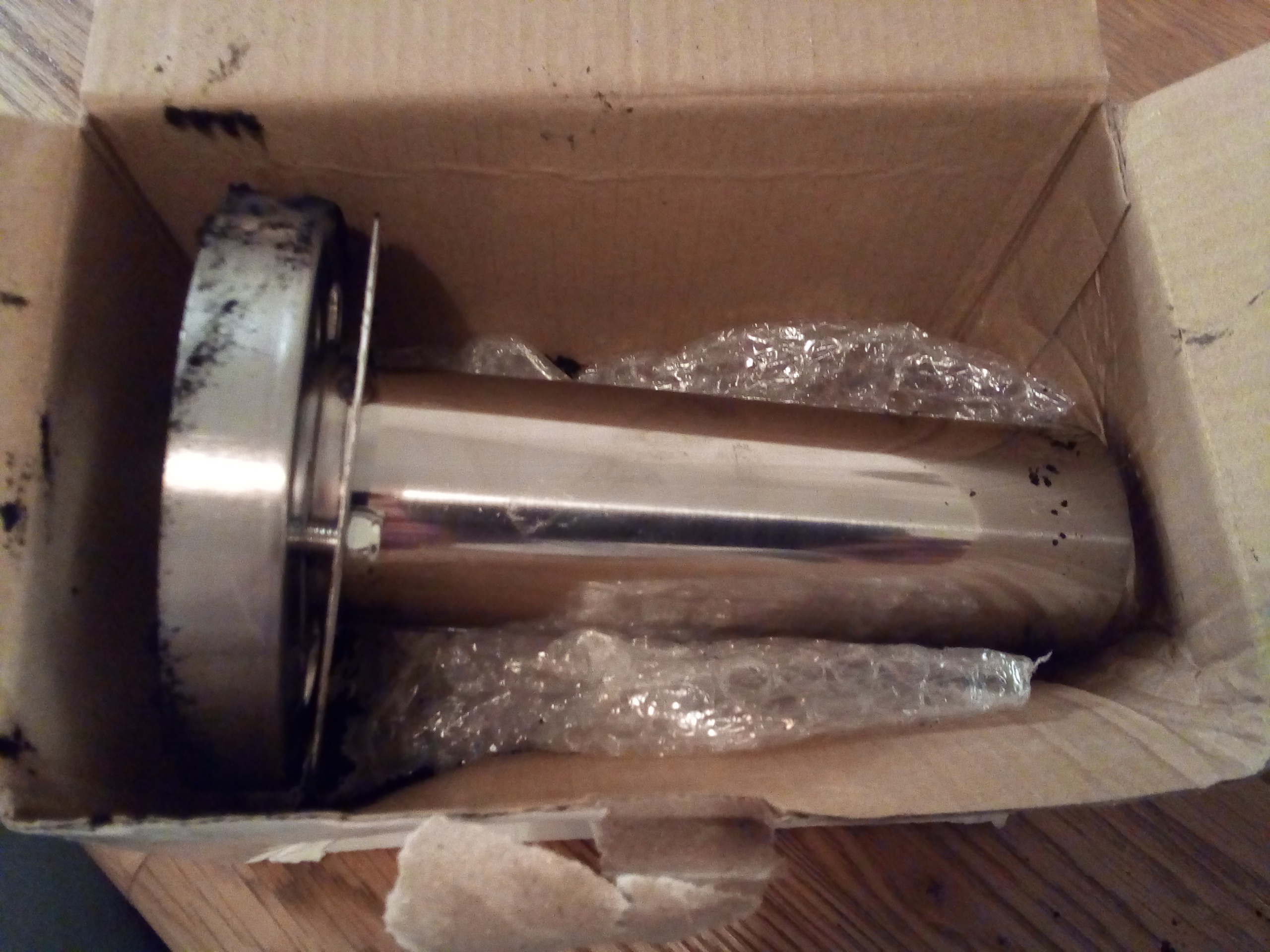

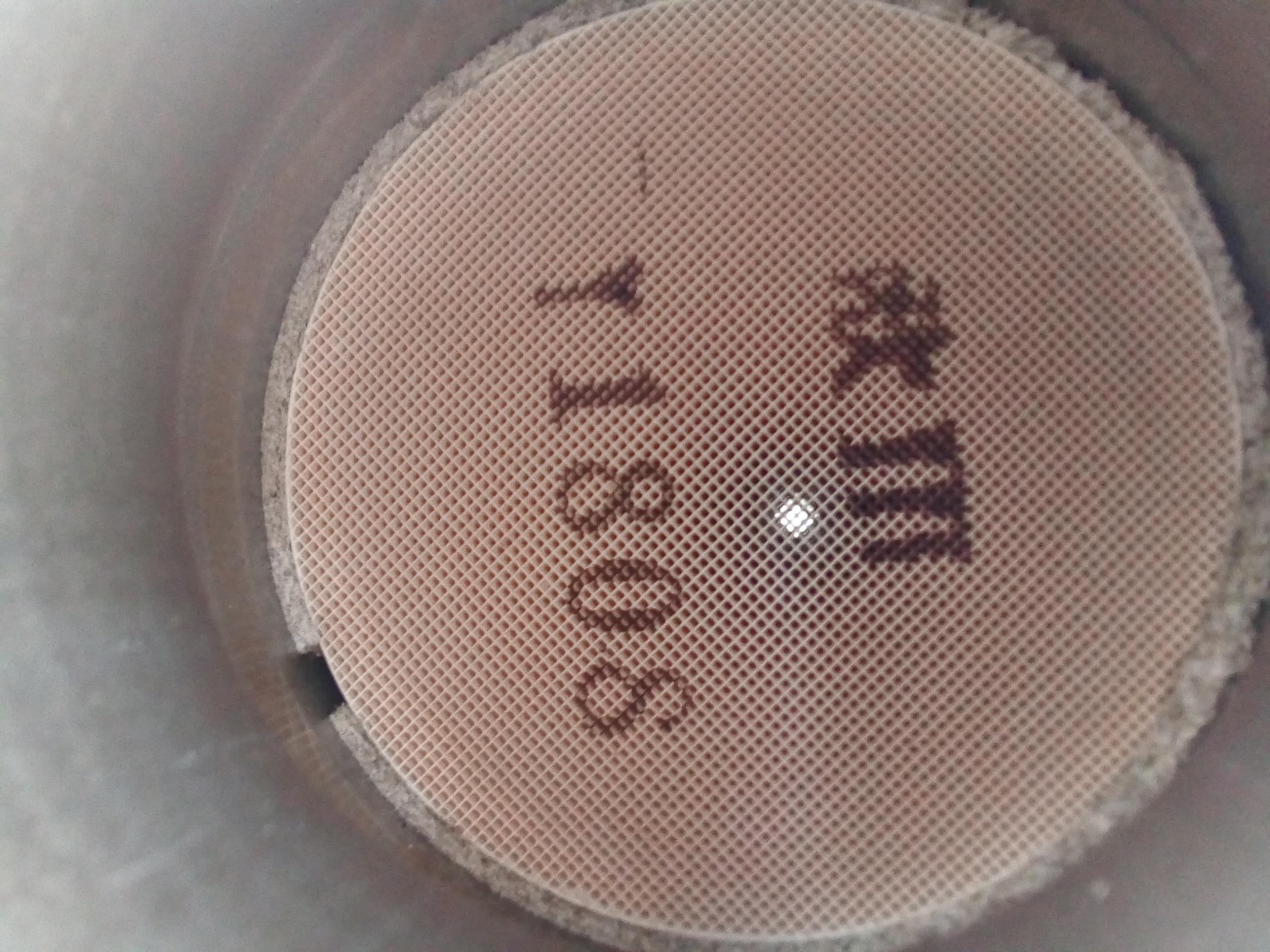

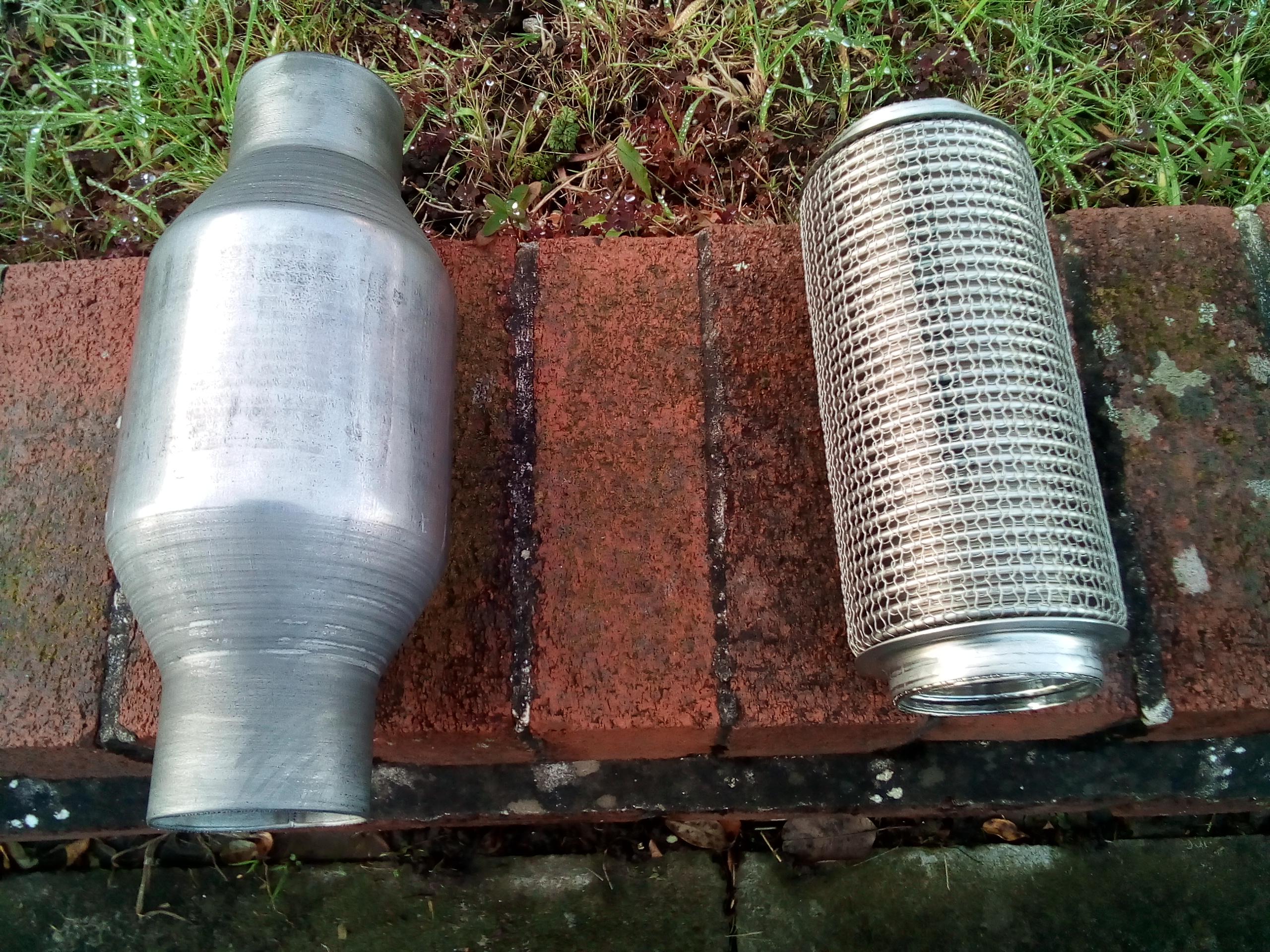

Sam44 Posted October 30, 2020 Author Posted October 30, 2020 (edited) Some new exhaust parts turned up today. New longer exhaust Flexi and new high flow catalytic converter both damaged after an exhaust ground strike. 4.5 inch exhaust bung to reduce the low noise from the map speed exhaust system. Edited February 6, 2021 by Sam44 Quote

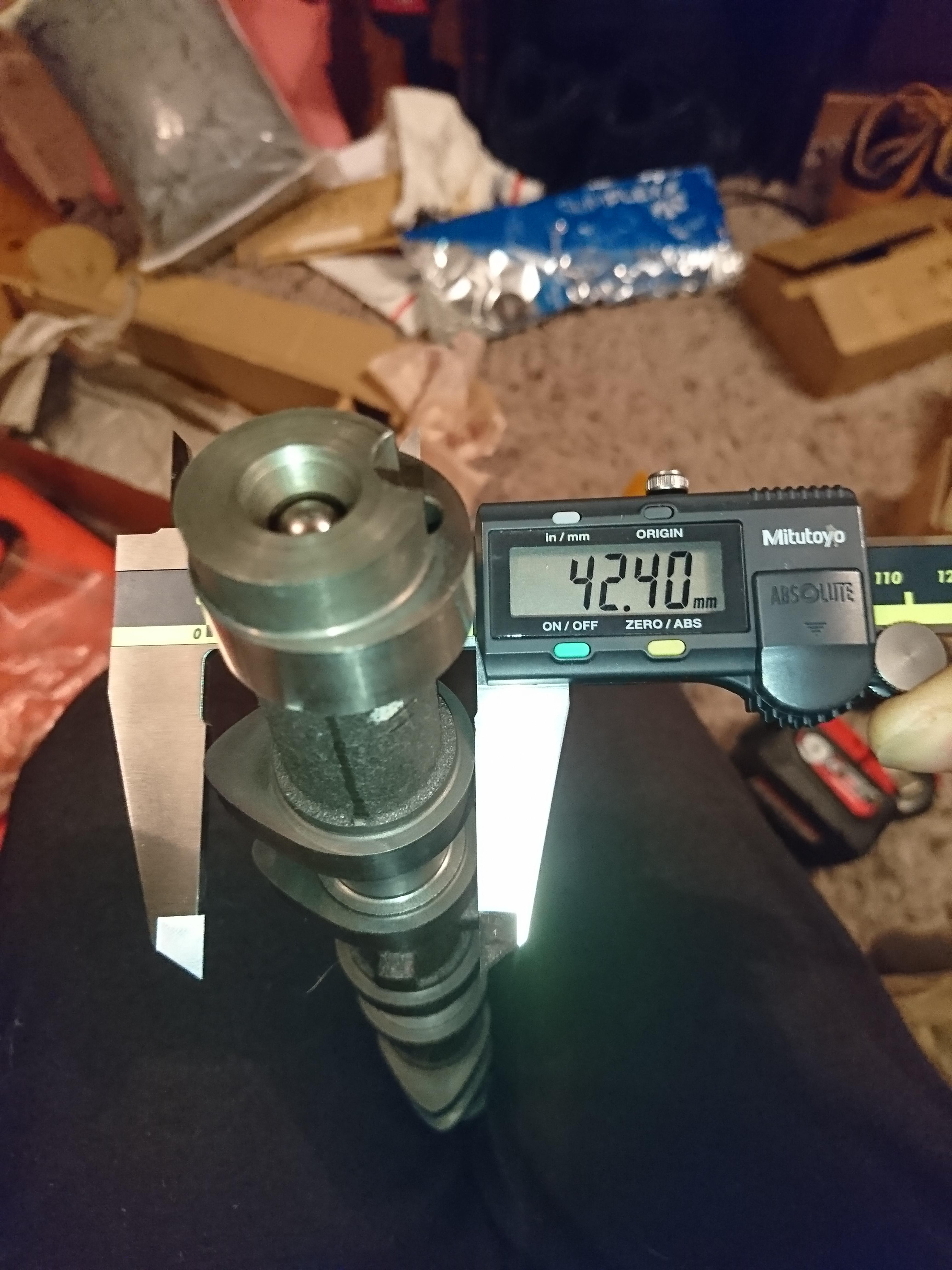

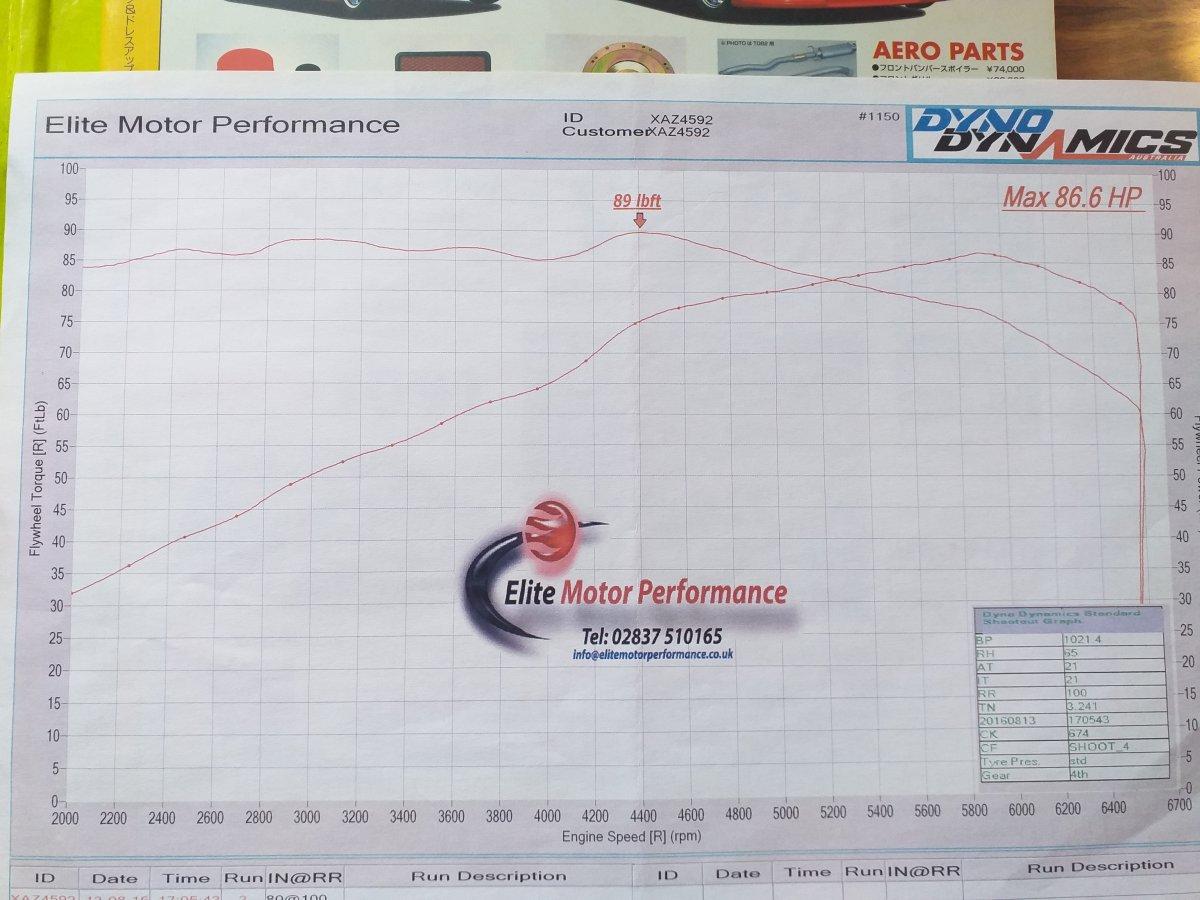

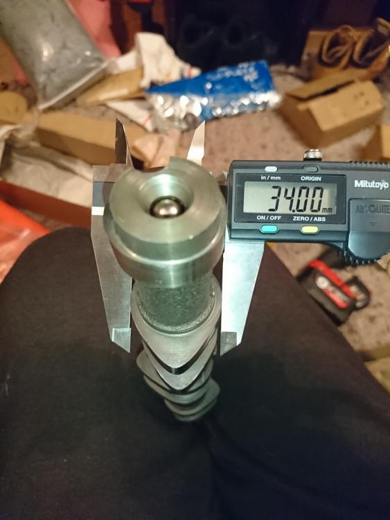

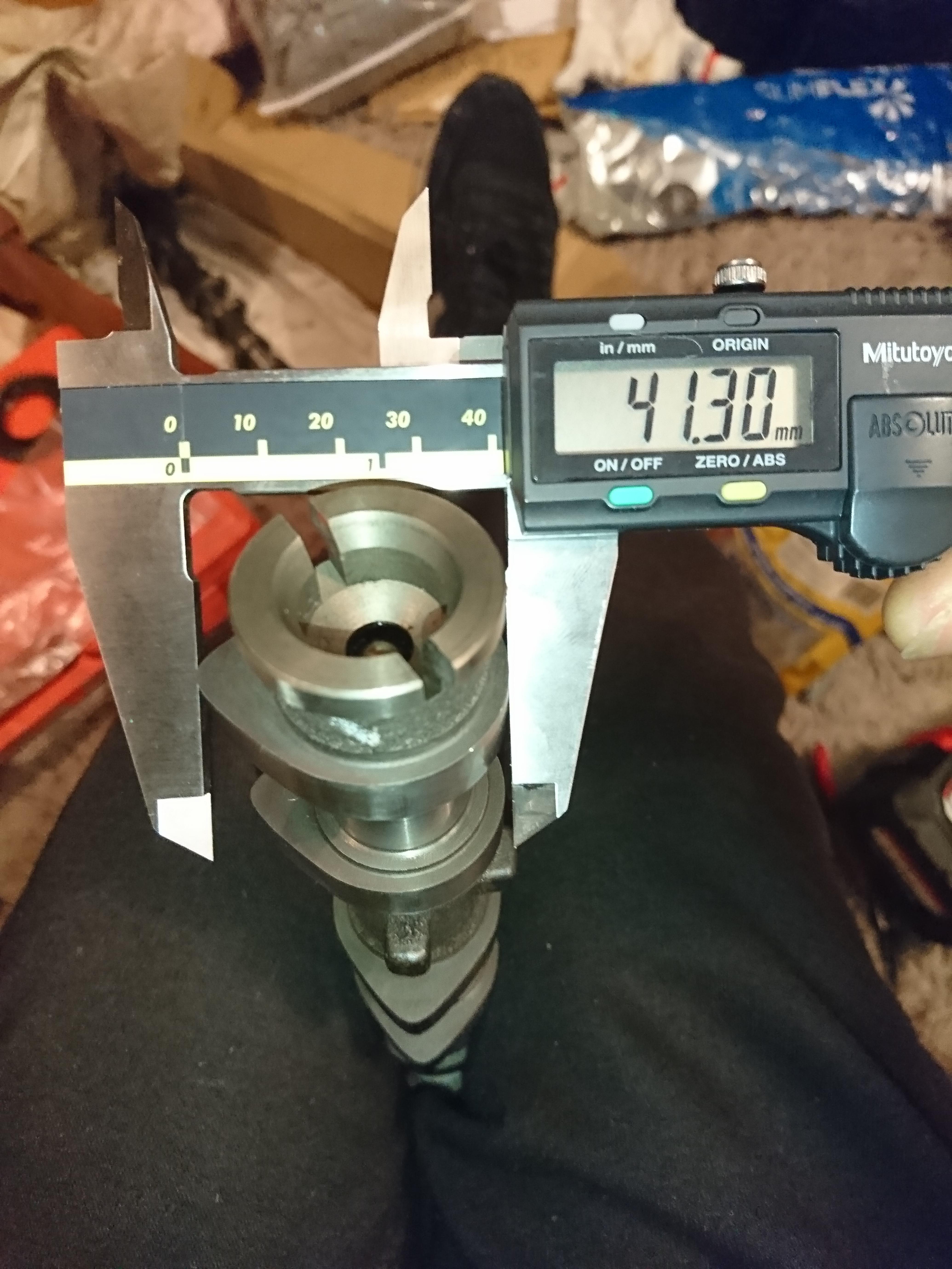

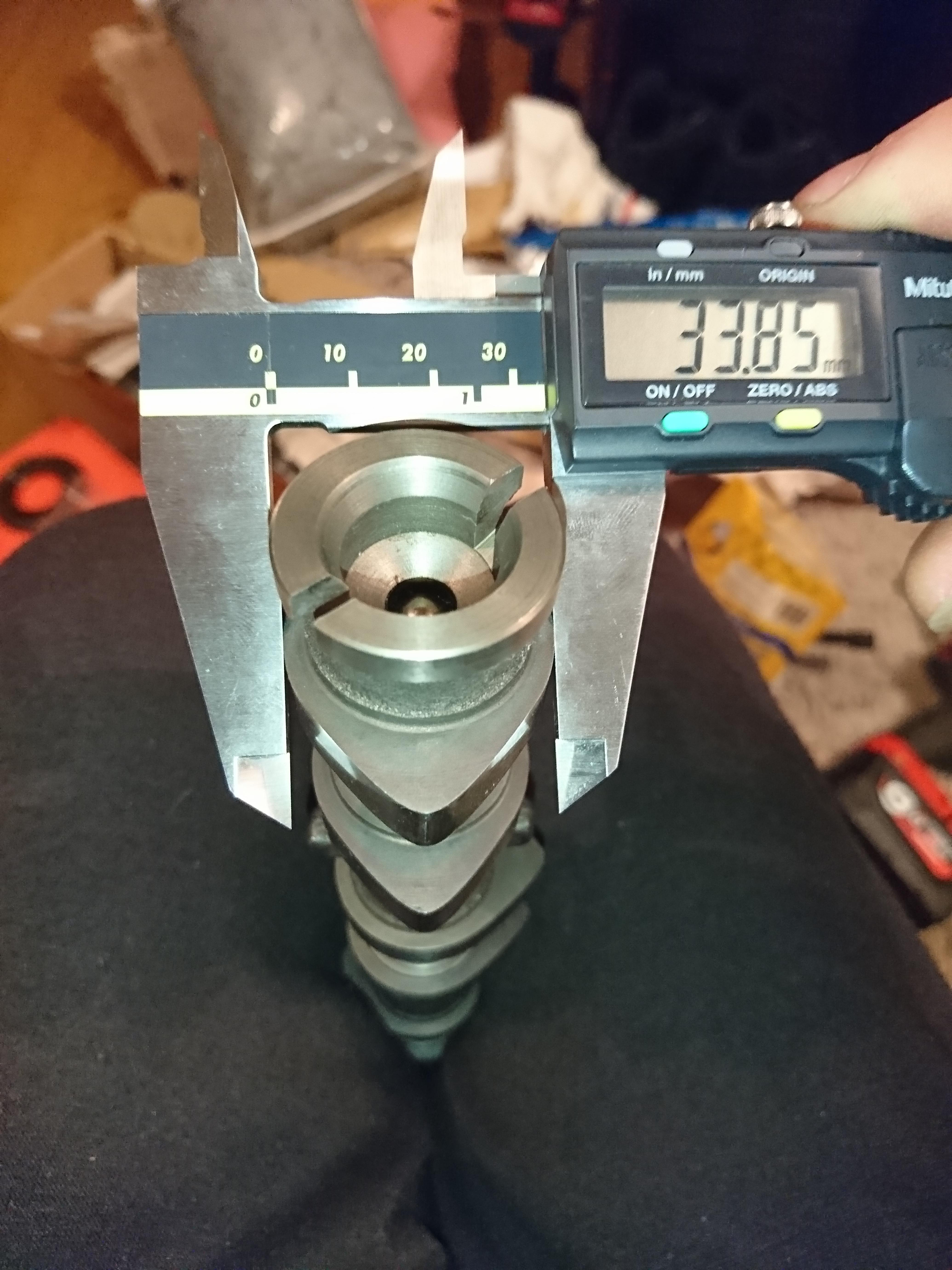

Trevstar Posted November 17, 2020 Posted November 17, 2020 (edited) On 9/15/2020 at 1:34 PM, Sam44 said: The lift difference between the UK ep91 4efe and 4efte inlet cam. 1st up 4efe 4efte inlet cam bellow. .8mm more lift on the 4efte unit. Which can clearly be seen on the Dyno graph torque peak and length. I'll update this with duration and other cams I have here (5efe, 5ehfe, gen1 JDM ep80, gen1 4efe E11 corrolla. Took some pictures of my 5E-FHE cams while I had them out the box today, thought they might be some use to you or anyone else Inlet: Exhaust: Also I'm not sure how true this is but from what I read somewhere today suggests the durations are all the same across the 4efe/4efte/5efe cams but slightly different for 5efhe cams 🤷🏼♂️ Edited August 12, 2021 by Trevstar Quote
Sam44 Posted November 17, 2020 Author Posted November 17, 2020 (edited) thanks. yeh lift on these engines is were the power is. i suspect because of the large lift on the 5ehfe cams this will affect the duratiopn slightly were did you manage to get them and if there new were from. love this: thanks. Edited November 17, 2020 by Sam44 Quote
Trevstar Posted November 17, 2020 Posted November 17, 2020 (edited) Stole them out of a 5efhe I bought a few years ago and regrettably sold the bottom end, these might have some work done on them though for even more lift, not sure yet because of the cost involved. But I'd like to look into and hope to have them reproduced/copied in the near future! 🤞🏻 Edited August 12, 2021 by Trevstar Quote
Sam44 Posted November 17, 2020 Author Posted November 17, 2020 keep me posted ill defo have a set Quote
Trevstar Posted November 17, 2020 Posted November 17, 2020 (edited) I certainly will 👍🏻 If you check out this video HERE, 9:33 onwards you can clearly see how much lift there is to be had, the valve relief cuts in the pistons pretty much serve no purpose by the looks of it Edited November 17, 2020 by Trevstar Quote
Sam44 Posted November 21, 2020 Author Posted November 21, 2020 (edited) I just used putty on top of the piston, to measure the gap. 1 thing to watch out for is the valve springs going coil bound (spring coils touching). When going higher lift. Also under bucket Shims on the cam followers. Edited November 21, 2020 by Sam44 Quote

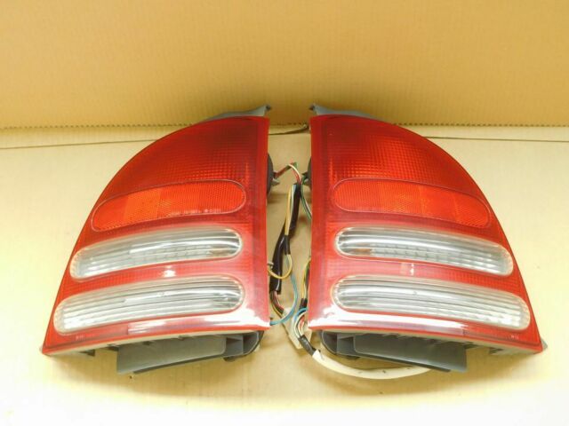

Sam44 Posted December 14, 2020 Author Posted December 14, 2020 (edited) after seeing a set of these up come up for sale recently ive decided to purchase them to go on the starlet. reflex rear lights. i had no idea these little cars could look as well as they do. these are crazy easy to install. Edited December 14, 2020 by Sam44 Quote
