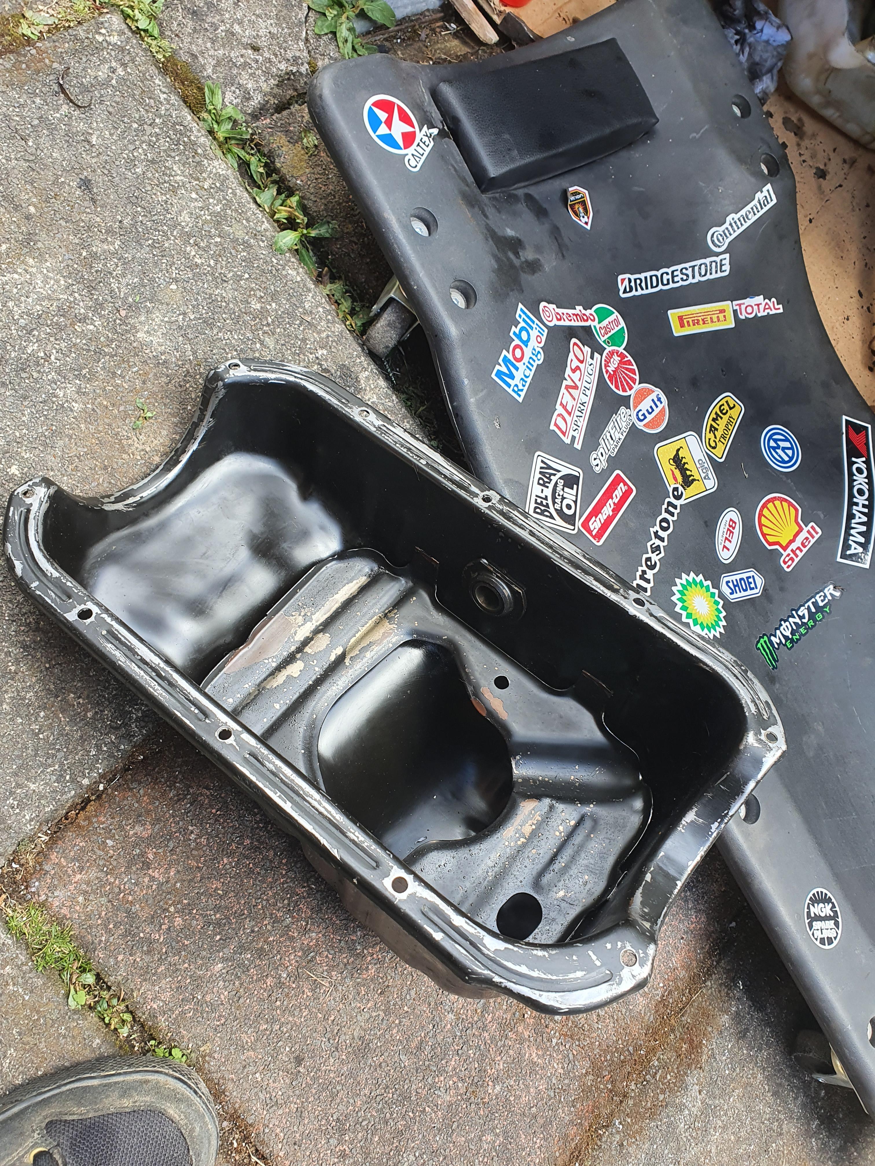

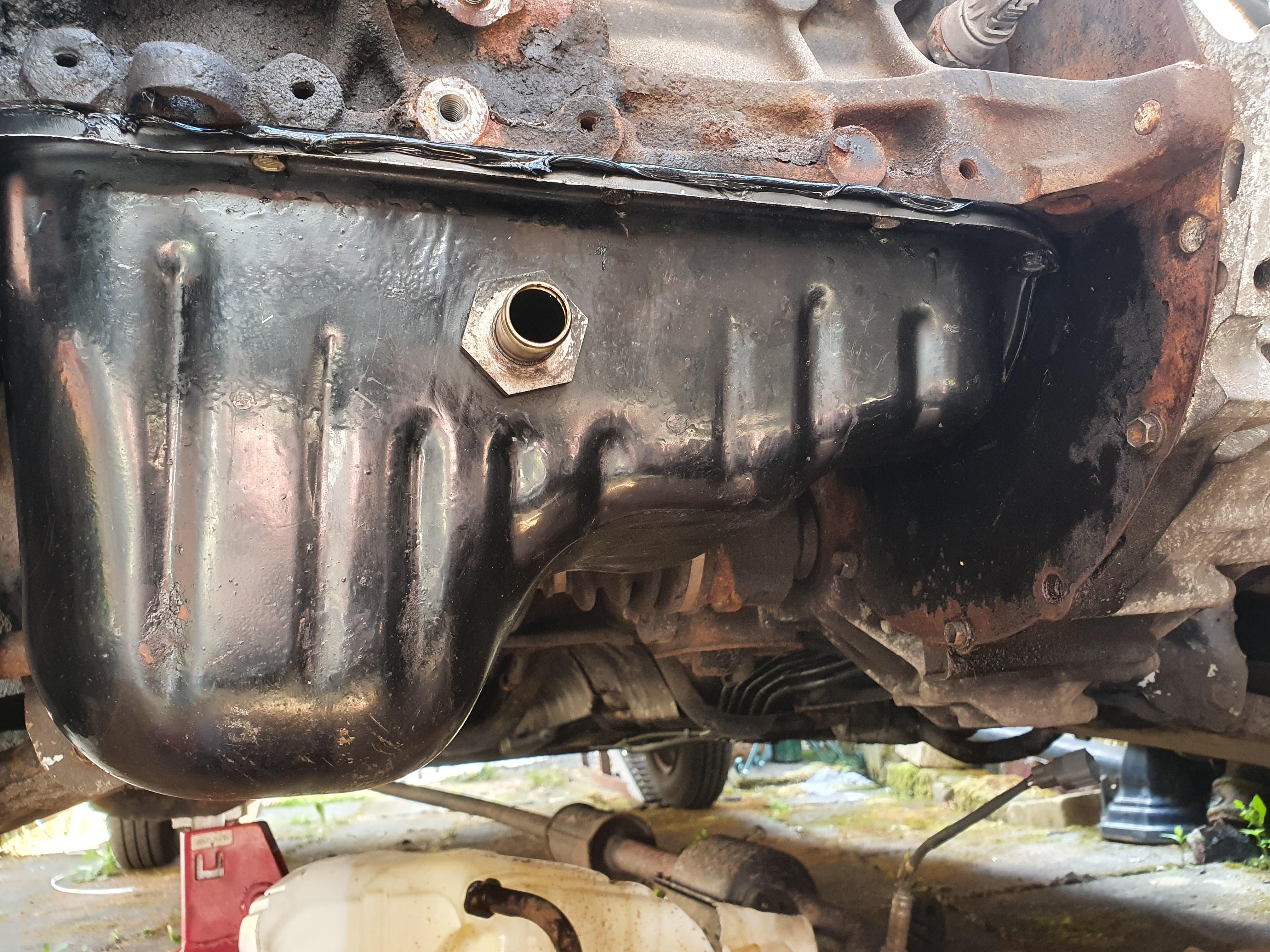

Patches Posted April 22, 2020 Posted April 22, 2020 Wee cost saving tip, you can keep the sump you have and put a fitting on it for oil return as you can see in this video, this full video series is pretty good at explaining what you need to convert na to turbo Quote
Claymore Posted April 23, 2020 Posted April 23, 2020 Unfortunately drilling and tapping for a screw in drain boss only works for aluminium sumps of a reasonably thickness. Thin steel sumps don't have enough material thickness for the threads and require a different approach. There are bolt through / bolt on solutions available with gaskets. Best to remove sump before drilling as you don't know whats behind it and could drill into something important like a con rod. Or you might place the outlet of the return too close to something choking the flow. Quote

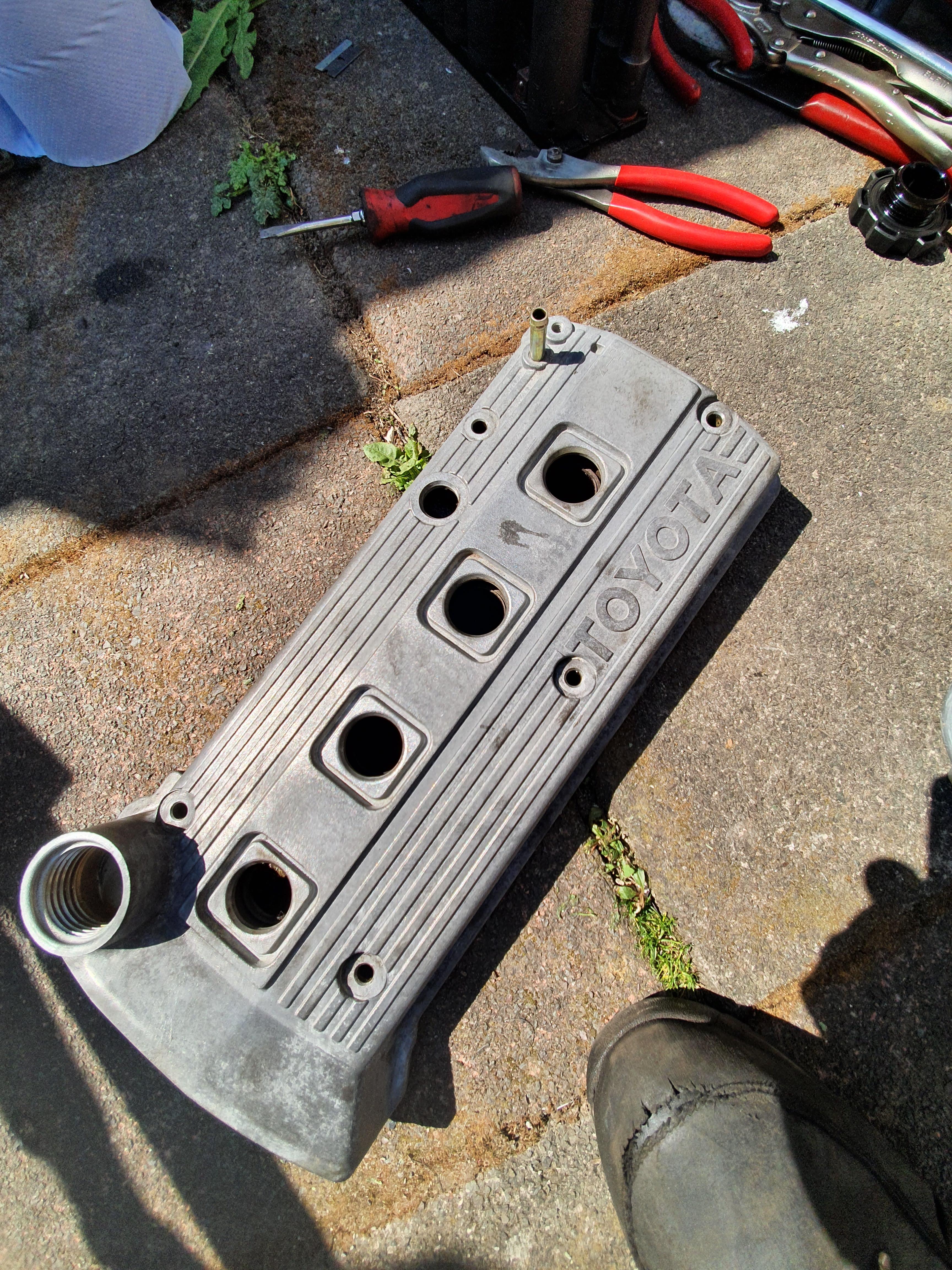

Sam44 Posted April 23, 2020 Posted April 23, 2020 (edited) I've also been told about using the 4efte rocker cover with the bigger breather outlet. Alot of people seem to have an issue with crankcase pressure affects crank front and rear main seals. I run 2x extra breather valves that open over a certain pressure and vent to atmosphere. I believe there has been people in the past that use a Renault sport oil filter that allows you to run a turbo kit and they use the oil journal that feeds the crank and oil pressure switch to supply oil feed to the turbo. You can find how to videos on YouTube 4efe turboed. I worry about delivery rates and pressure drop at the crank using this method but if you do it right it should be ok. I hope this helps. Edited April 23, 2020 by Sam44 Quote

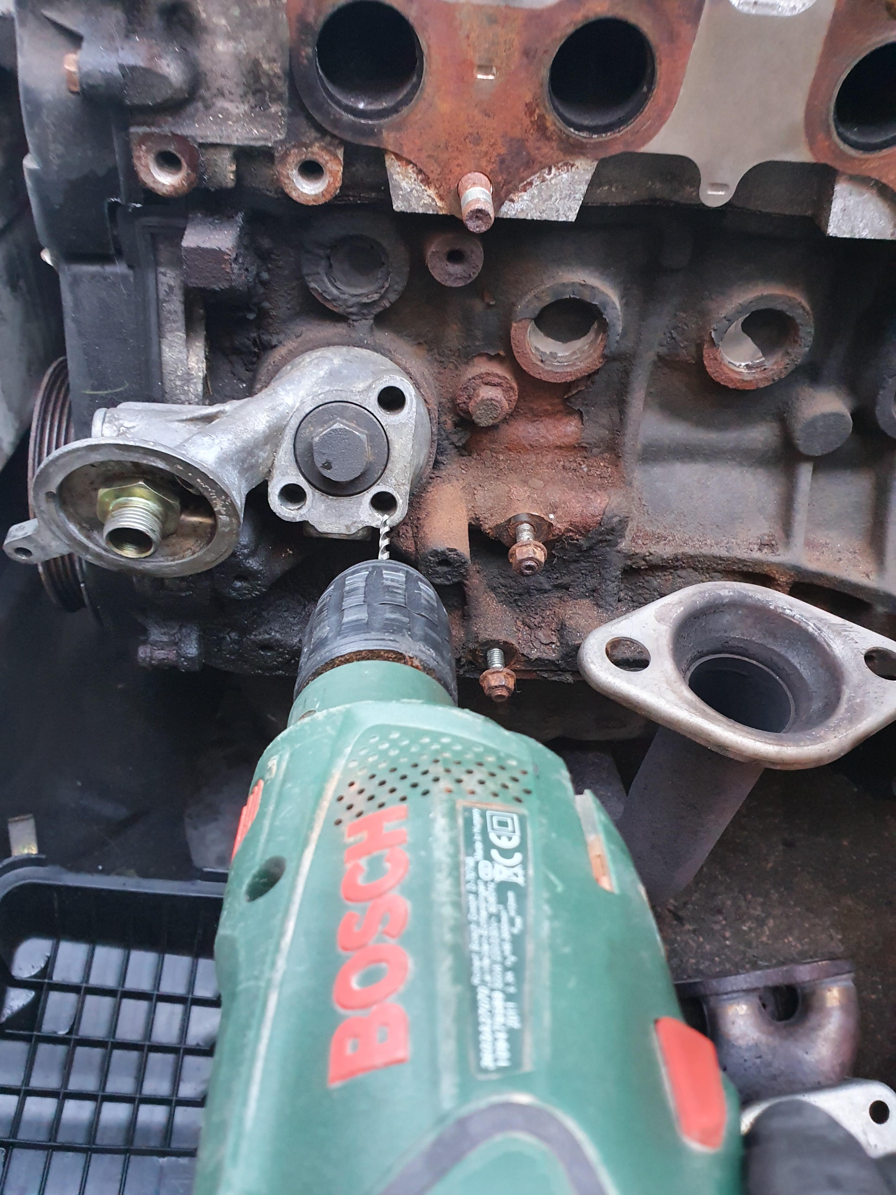

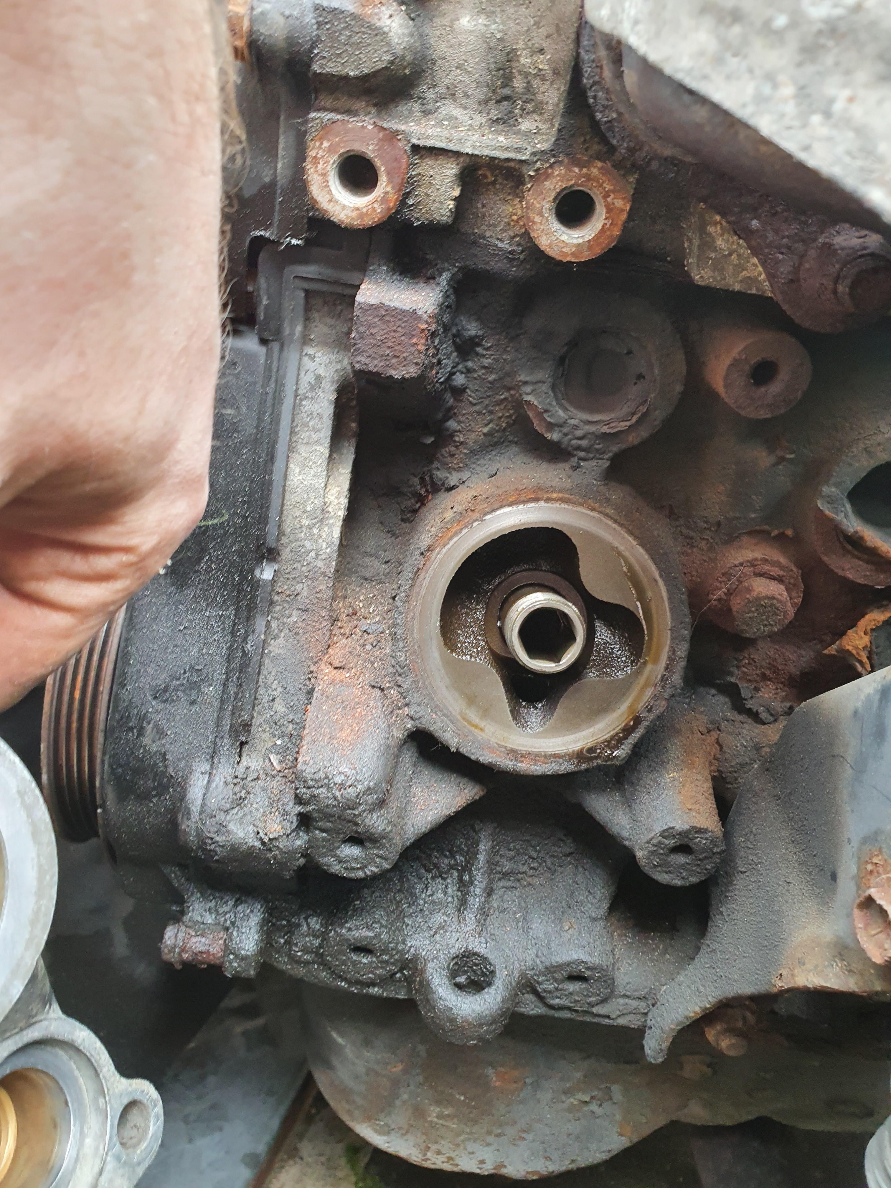

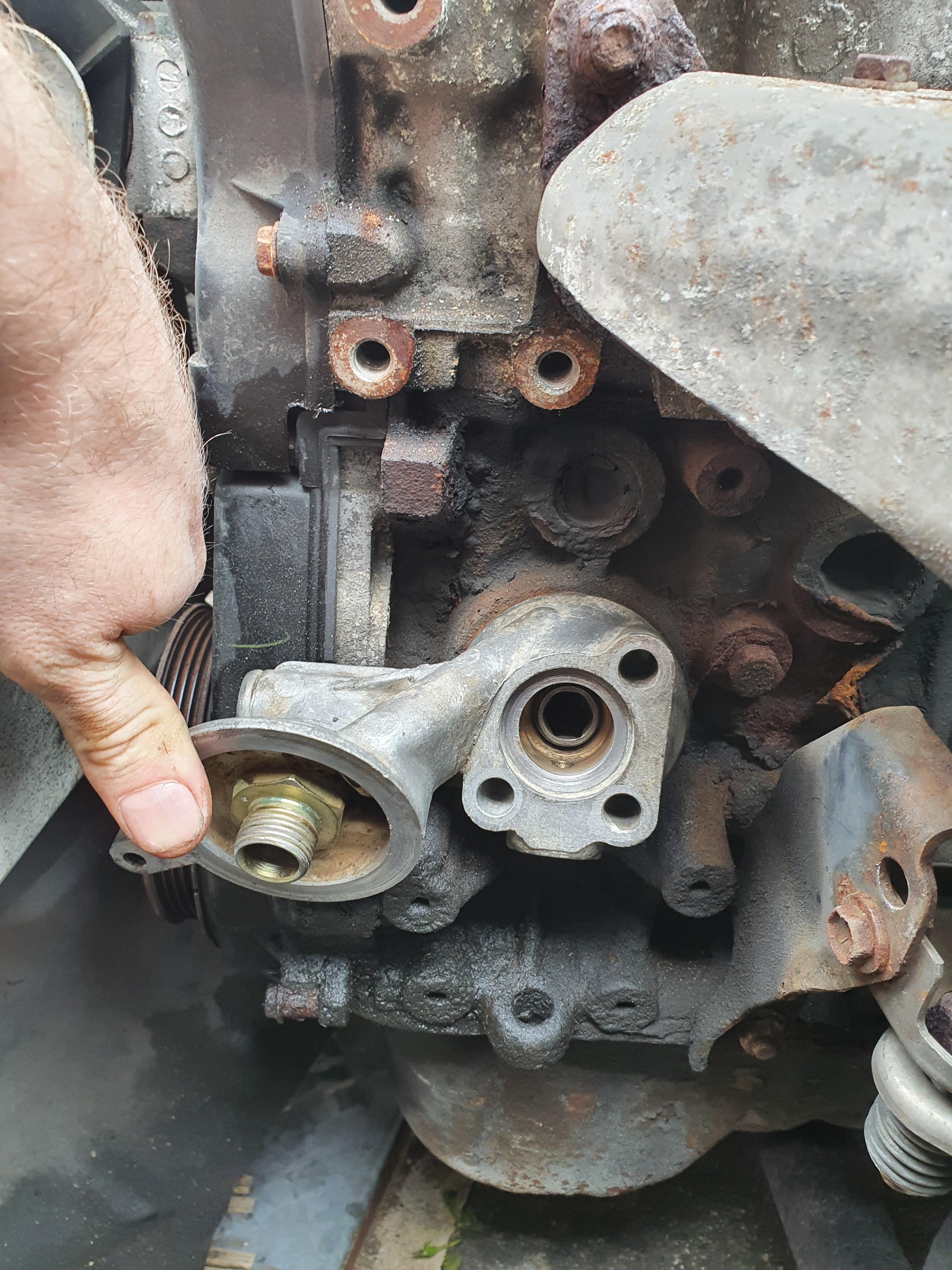

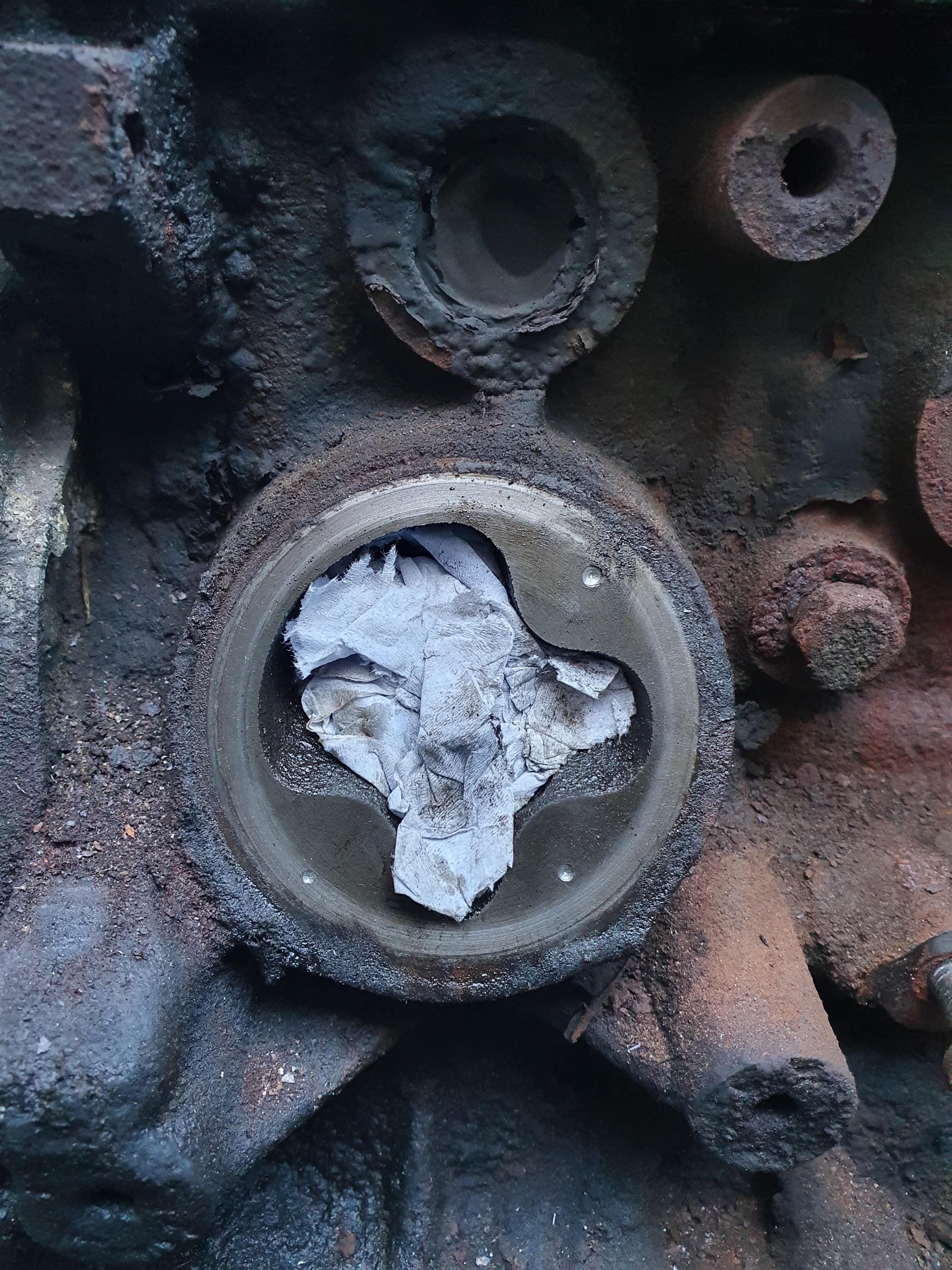

CaroleBaskin91 Posted April 23, 2020 Author Posted April 23, 2020 Afternoon, so I've got to see what job it is to fit the relocated oil filter housing. I bought this with no bolts, so I will have to scavenge some. I cant see it being an issue with the three outer bolts but will I need to source the main big bolt? Anyone know where to get it? And I'm guessing the three will need drilling in the block and tapping? Quote
Sam44 Posted April 24, 2020 Posted April 24, 2020 (edited) Morning, yeh you remove the filter stud in the center and get the relocation housing big center bolt from Toyota you just need a GT or glanza chassis number. You need the sealing washer also. And housing gasket. The outer three studs are there to stop the housing turning on the center bolt, the filter\weight sits off center. They also give good clamping force. I've not got these fitted just at present. The center bolt does a good job at holding it tight just make sure you aline the housing with the block journals. Edited April 24, 2020 by Sam44 Quote

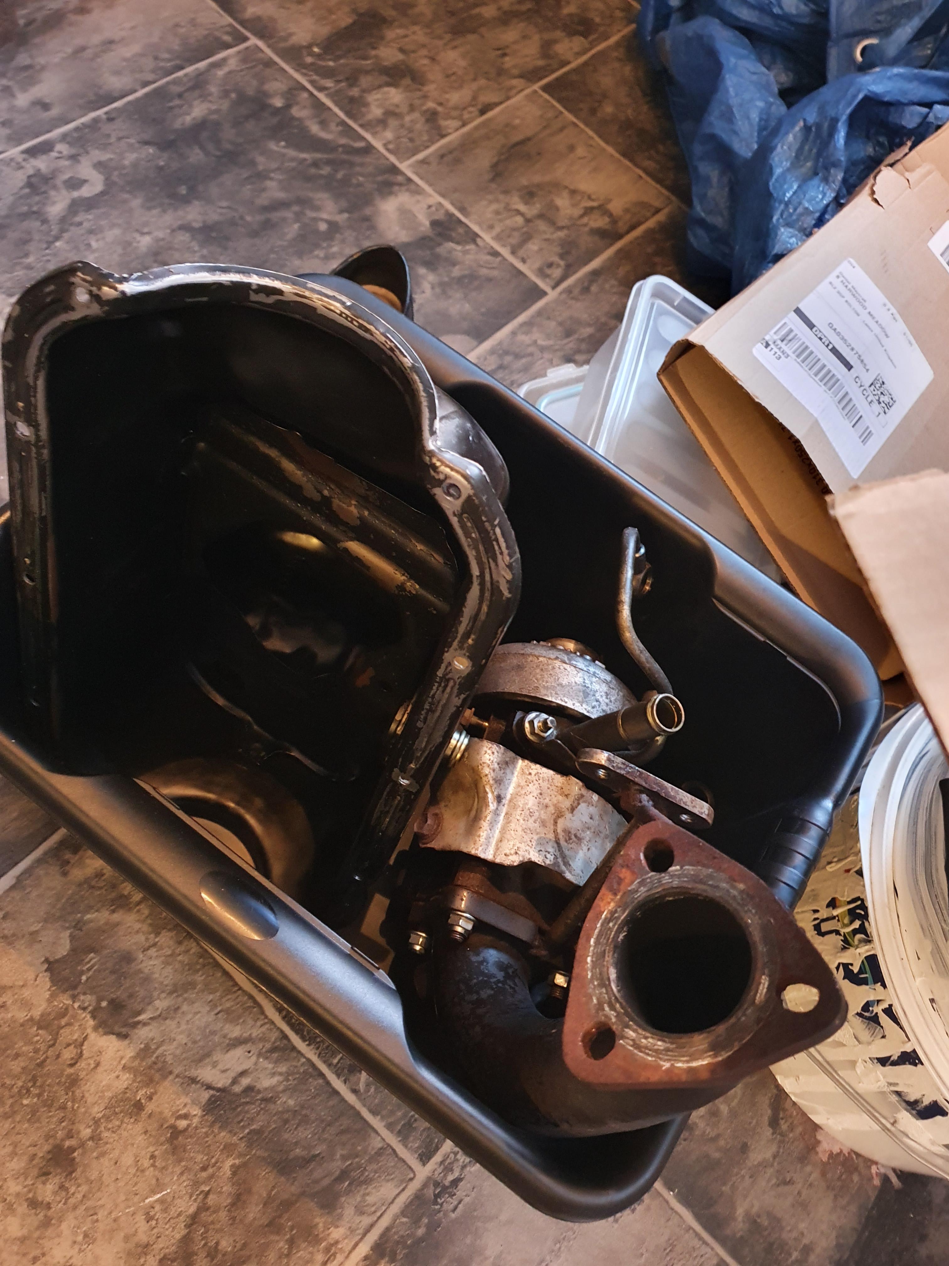

SKINY Posted April 24, 2020 Posted April 24, 2020 I have a glanza sump available when I was going to turbo my Rep the parts list was, Ct9 + Mani and downpipe, oil feeds etc, the electrical side my choice was a 2 plug GT ECU and engine wiring loom and a few sensors, I was on the way to do it for 300ish quid but then I sold it and bought a GT lol Quote
CaroleBaskin91 Posted April 25, 2020 Author Posted April 25, 2020 22 hours ago, SKINY said: I have a glanza sump available when I was going to turbo my Rep the parts list was, Ct9 + Mani and downpipe, oil feeds etc, the electrical side my choice was a 2 plug GT ECU and engine wiring loom and a few sensors, I was on the way to do it for 300ish quid but then I sold it and bought a GT lol Well I was going to go for the td04 but last night this popped up on facebook market place near me 😁 so ct9 turbo it is! How much would you want for the sump? Quote

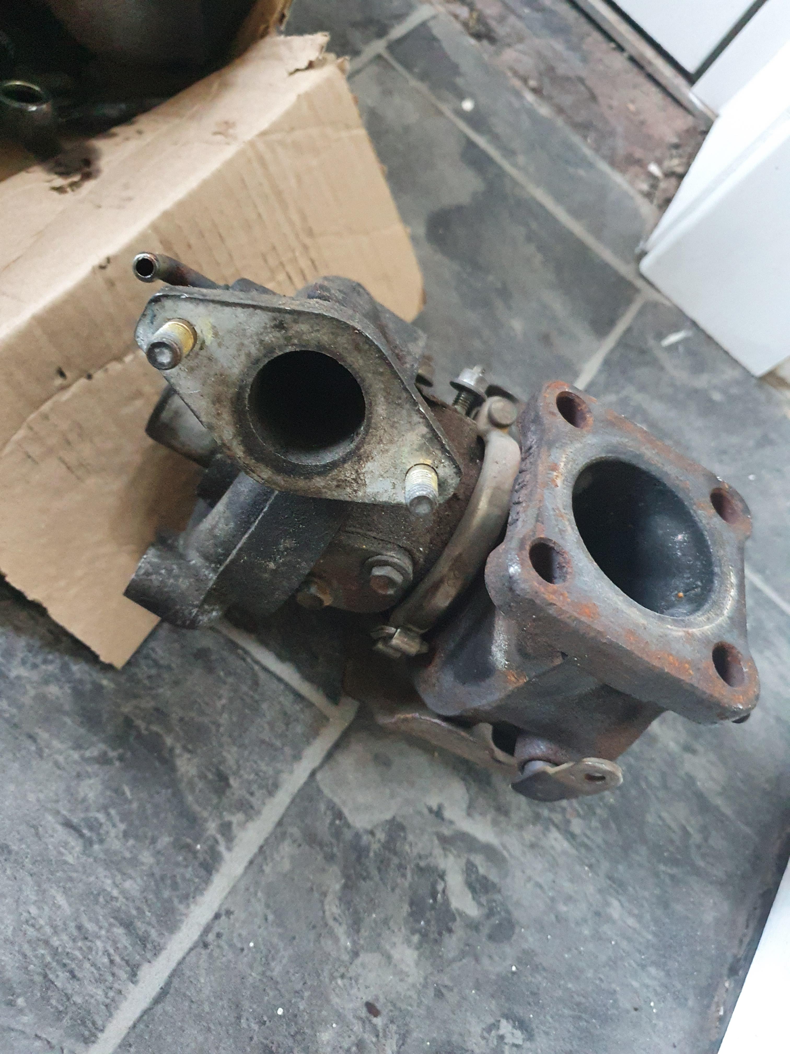

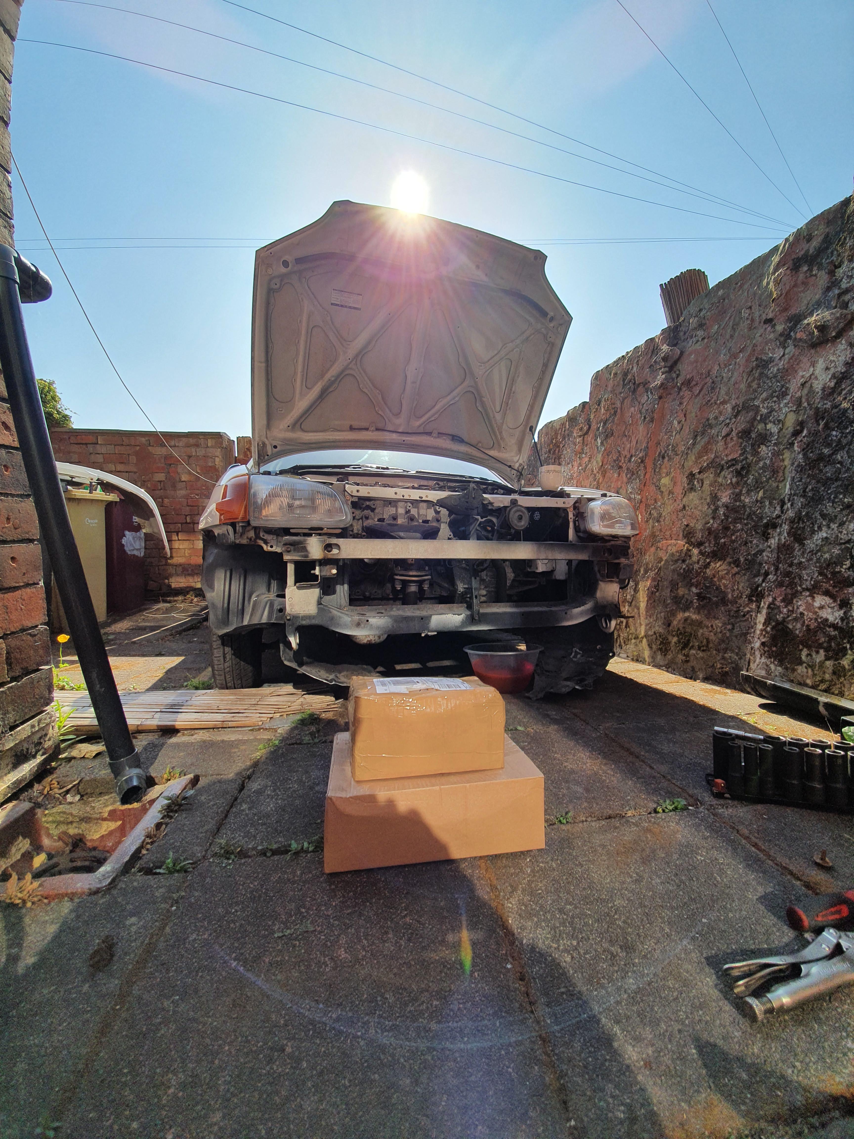

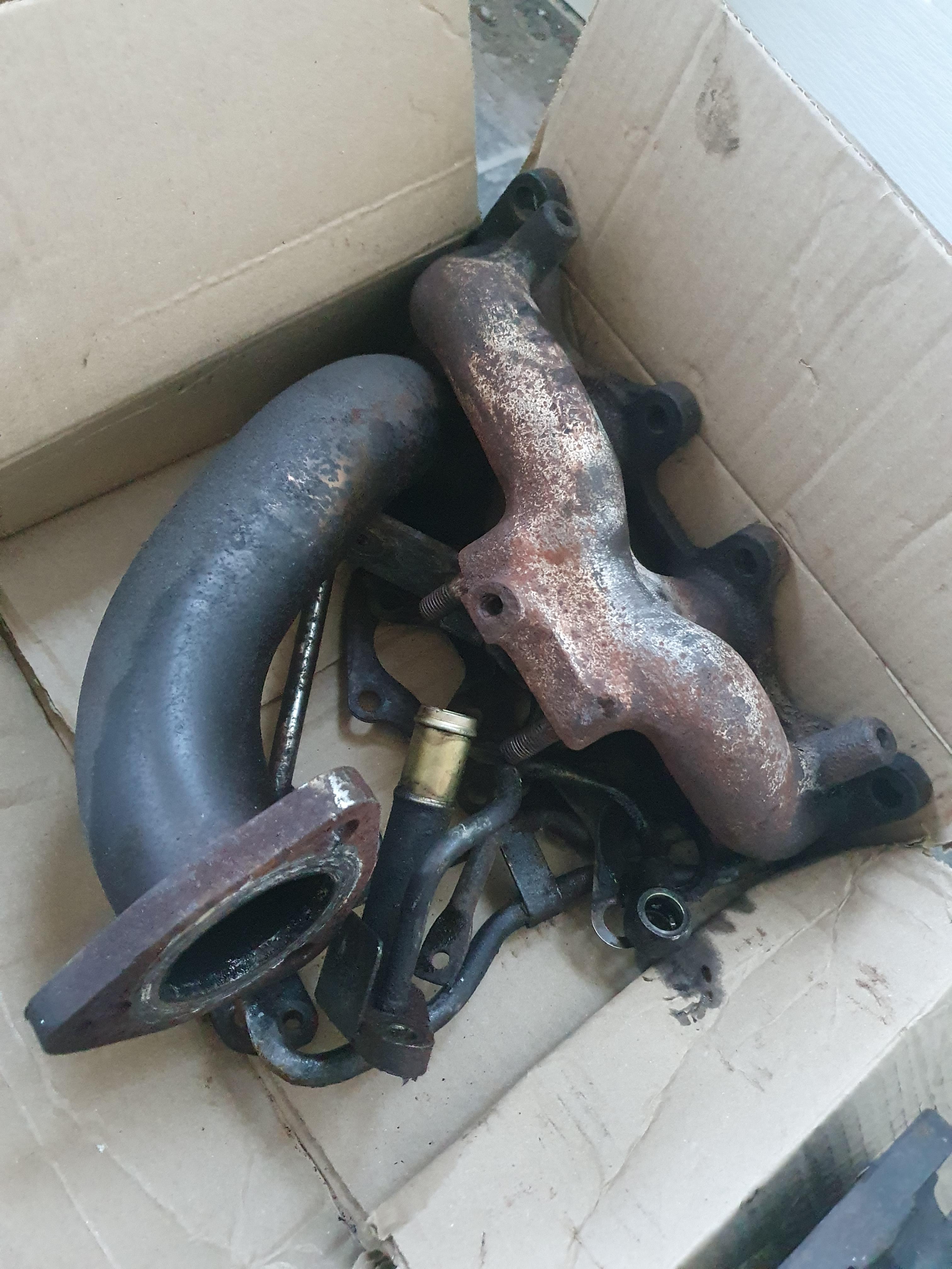

CaroleBaskin91 Posted April 25, 2020 Author Posted April 25, 2020 Parts delivered and perfect day to get started on the turbo build 👍 Quote

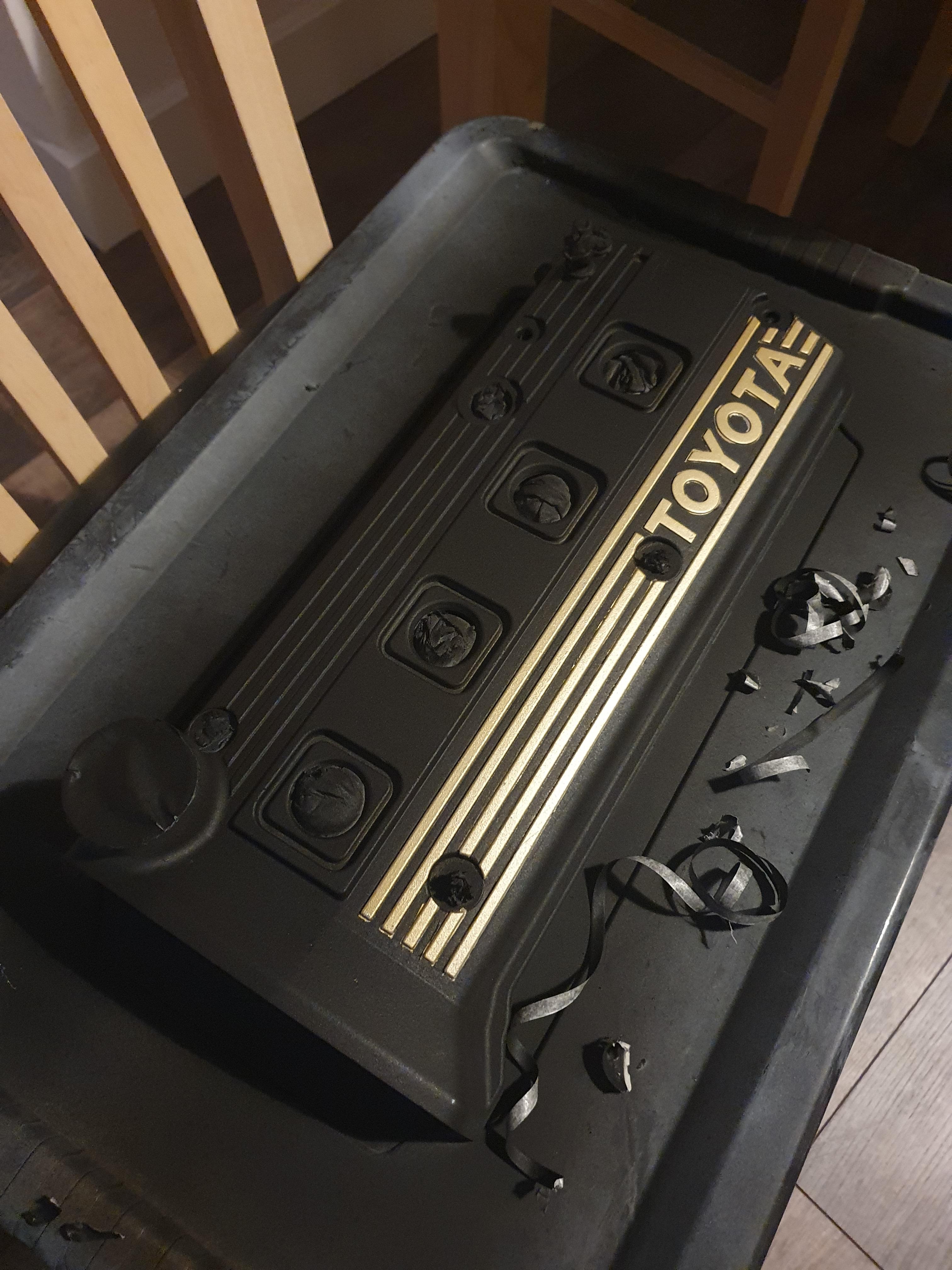

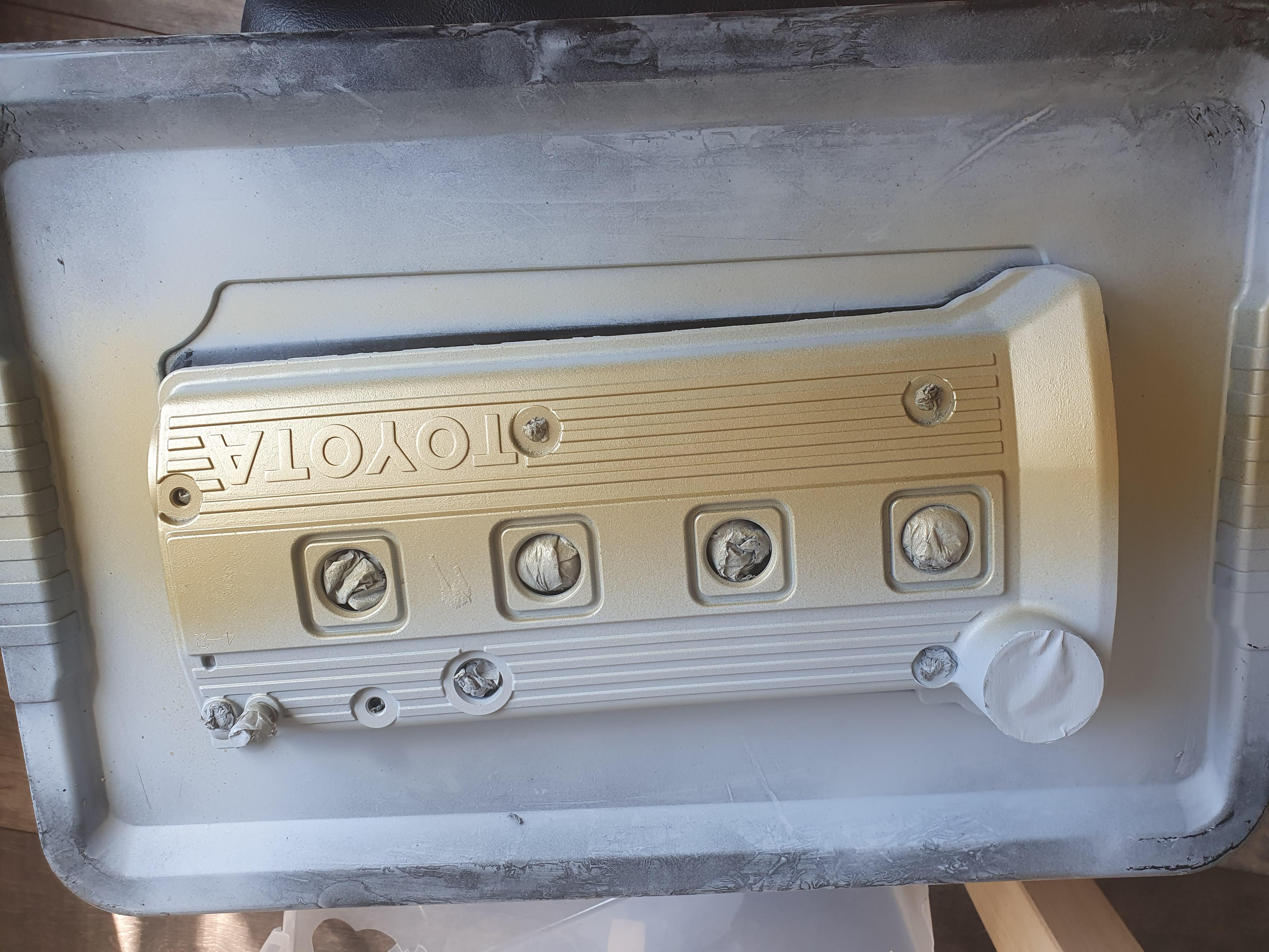

CaroleBaskin91 Posted April 25, 2020 Author Posted April 25, 2020 Going for gold toyota badge and lines on that side and black the rest Quote

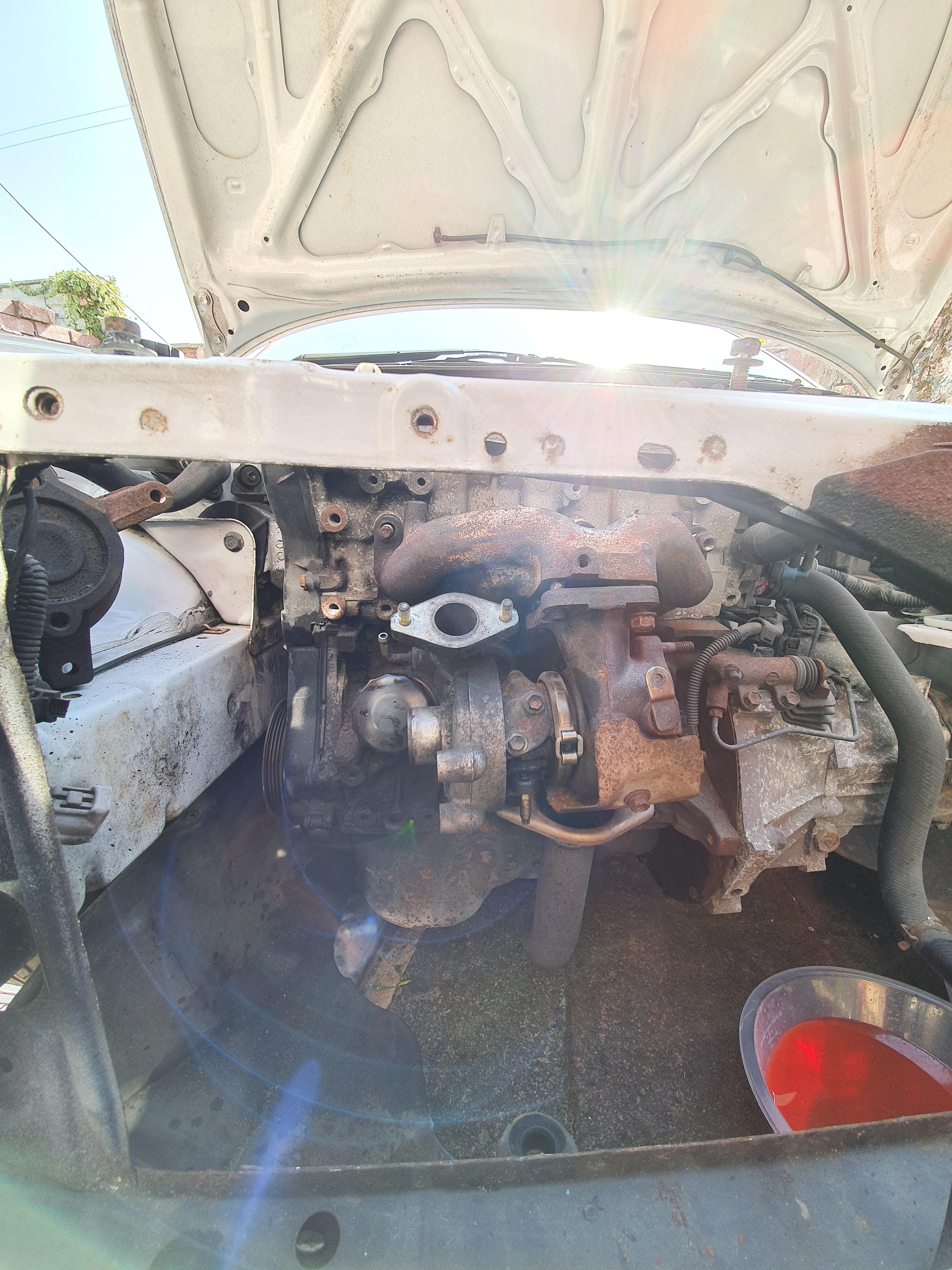

CaroleBaskin91 Posted April 25, 2020 Author Posted April 25, 2020 Test fitted turbo, all fits snug. Just need to source a bolt for the oil filter housing and I will be drilling and tapping the three other bolts on that, along with a gasket to go on. Quote
Sam44 Posted April 25, 2020 Posted April 25, 2020 (edited) you will not be disappointed. Great weather for moding. It might be worth while to port out the waste gate port on the turbo. As engine breathing is increased these turbos are known for boost creep. Edited April 25, 2020 by Sam44 Quote

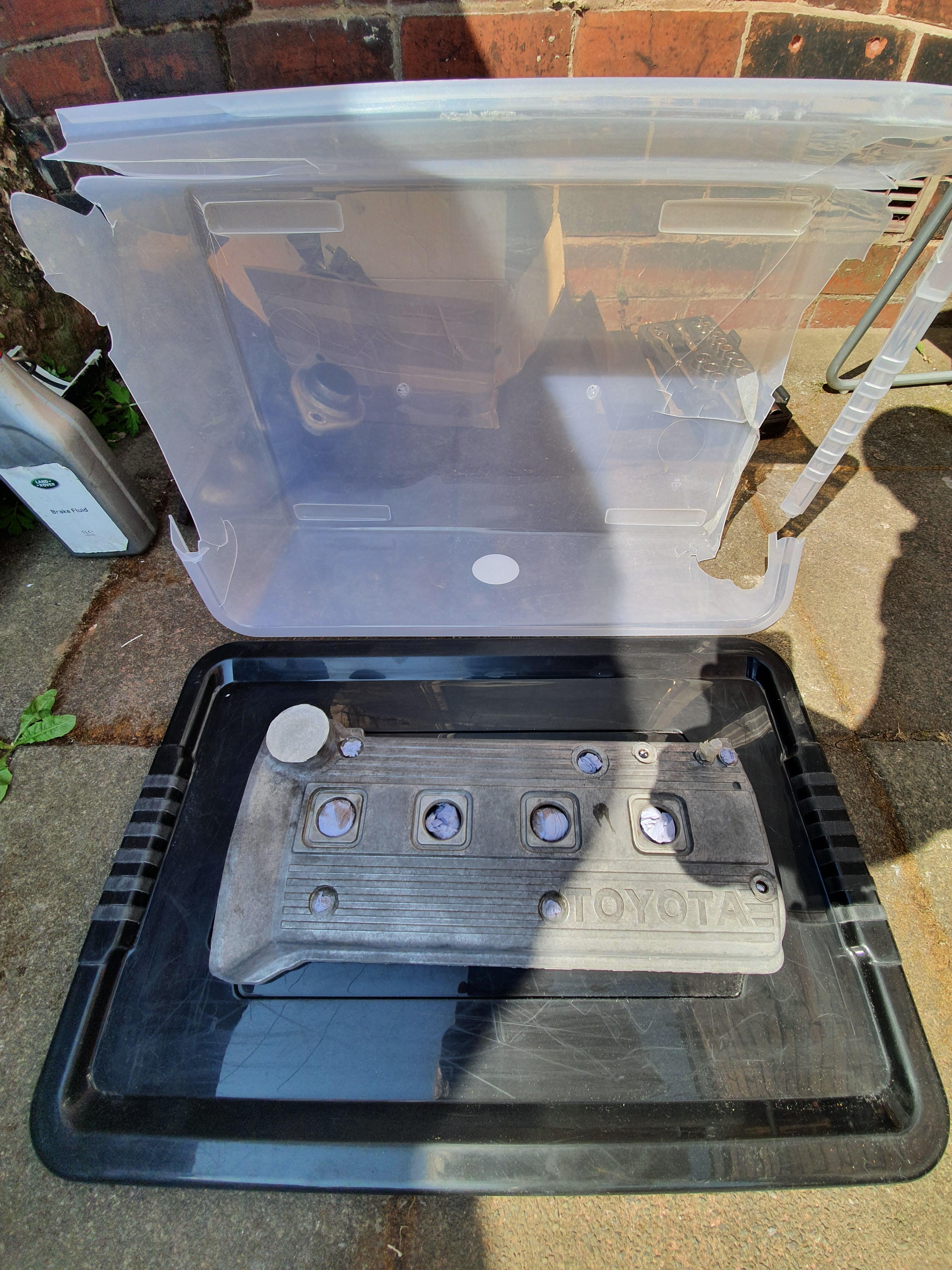

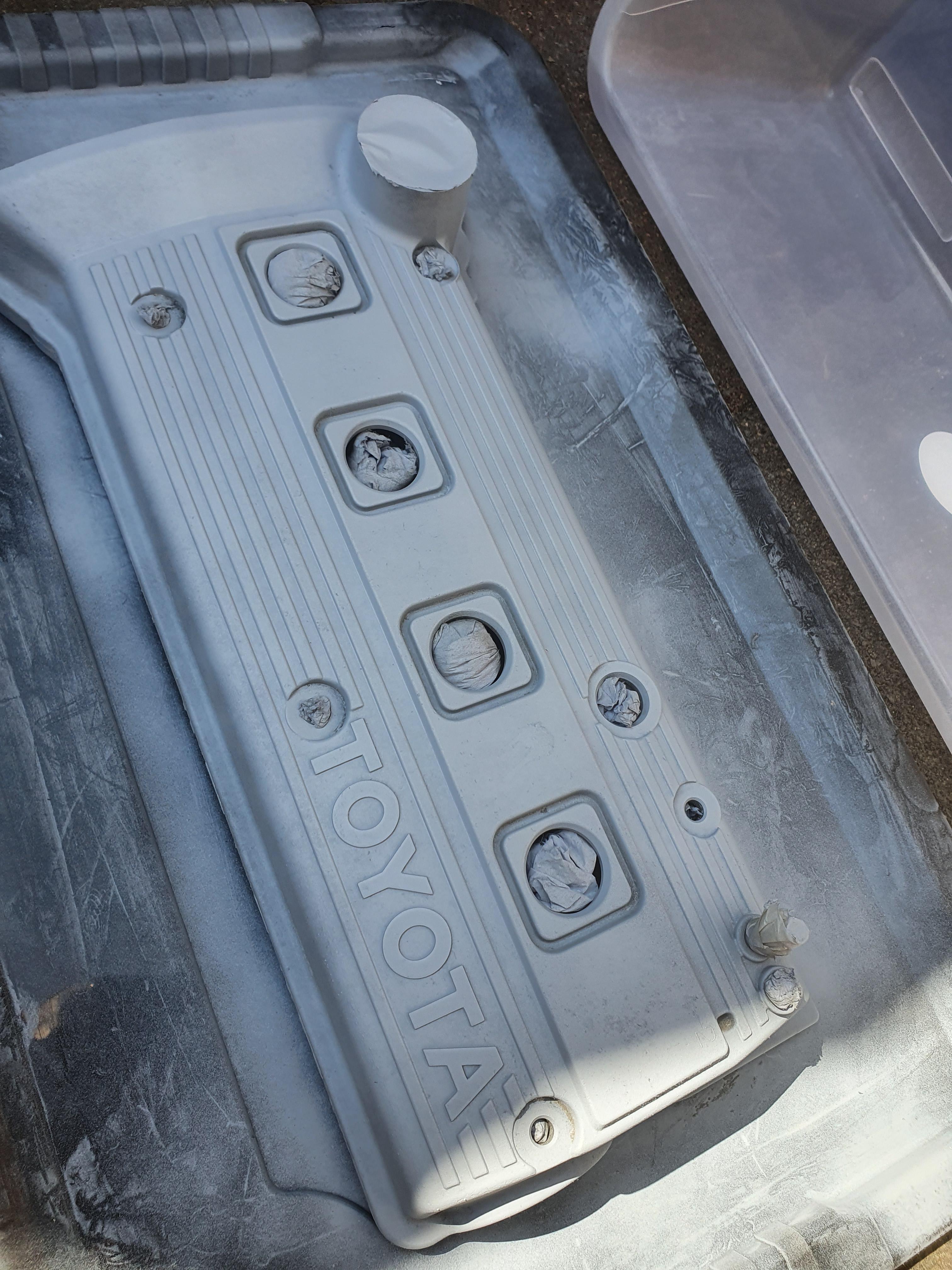

CaroleBaskin91 Posted April 25, 2020 Author Posted April 25, 2020 Got stuck in to spraying the rocker cover this afternoon too Quote

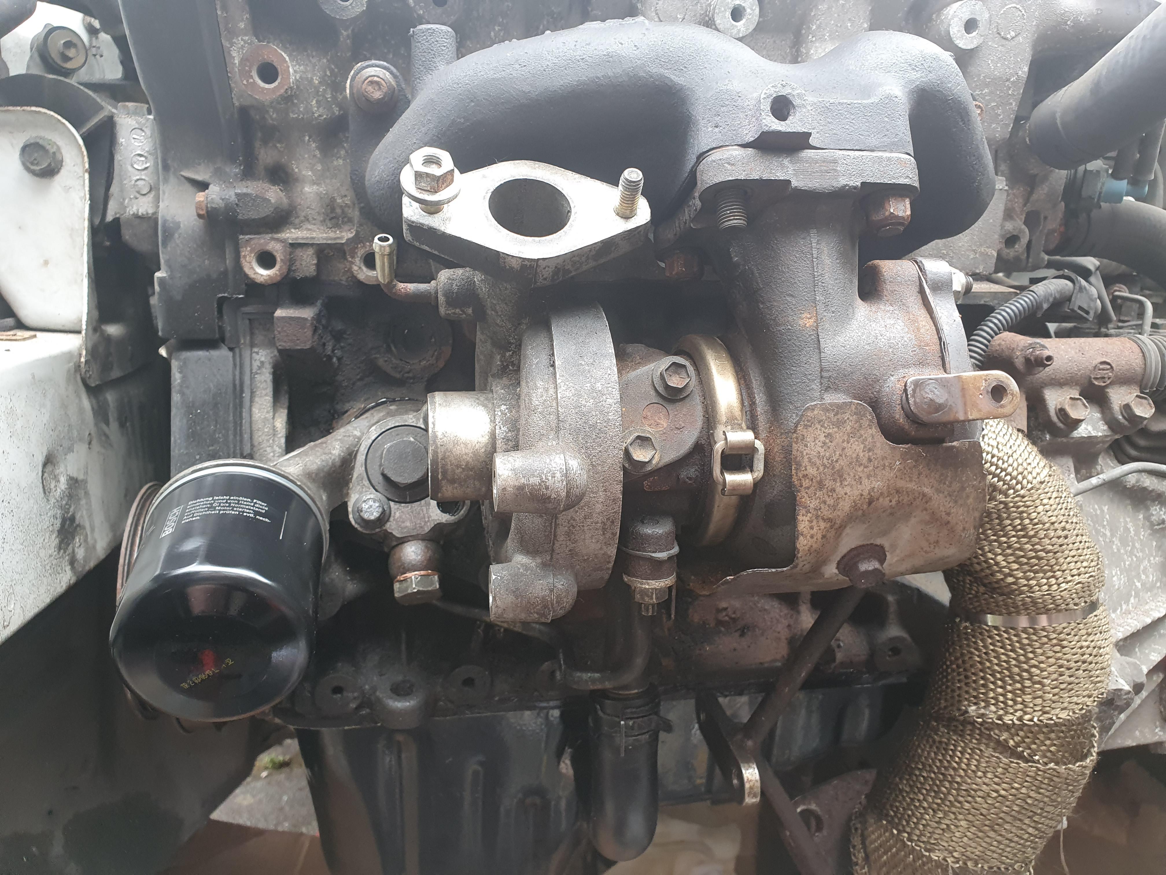

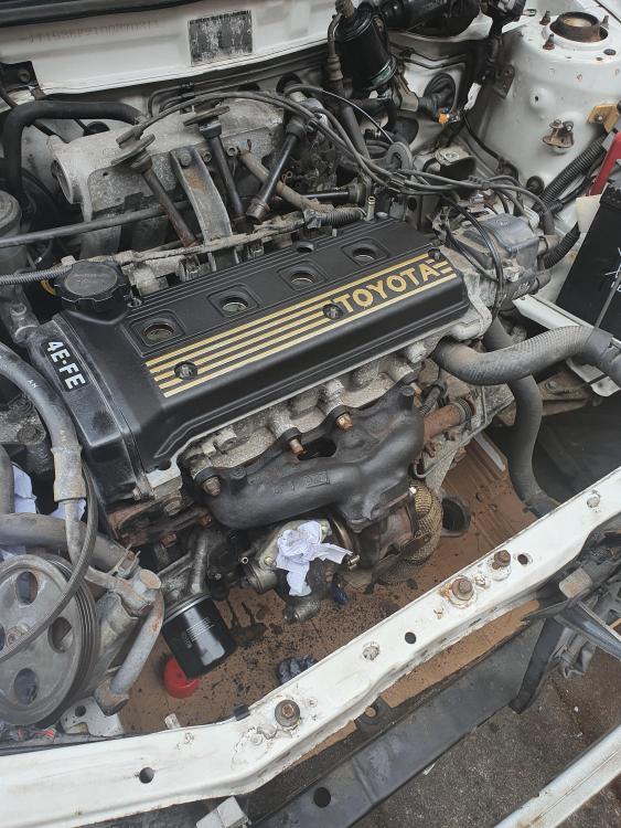

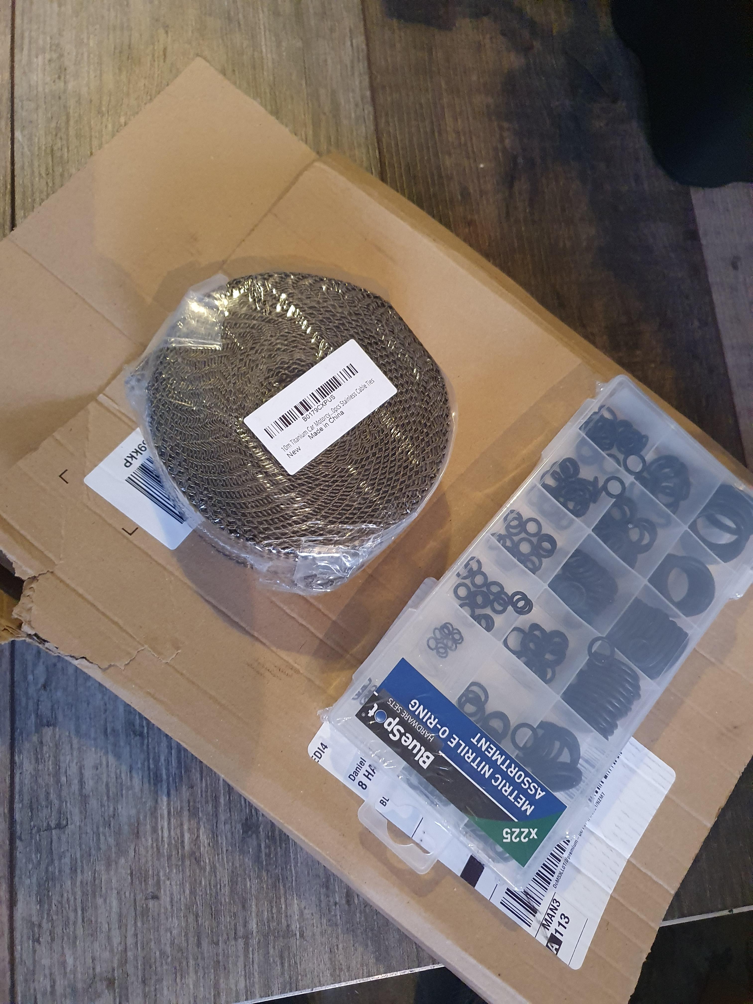

CaroleBaskin91 Posted May 2, 2020 Author Posted May 2, 2020 Update on the build : Today I spent the morning on the starlet, I had gathered a fair chunk of parts. Firstly I drilled the holes for the oil filter housing to sit and tapped them. Heat wrapped the decat pipe, I did want to wrap the manifold but the standard glanza one is small and you just cant get anything on it haha, so sprayed that with VHT paint black. So then fitted the manifold and turbo, glanza sump oil feed and return. Rocker cover went back on and I started her up, just to see if it still ran 😂 it does 👍👍 Quote
