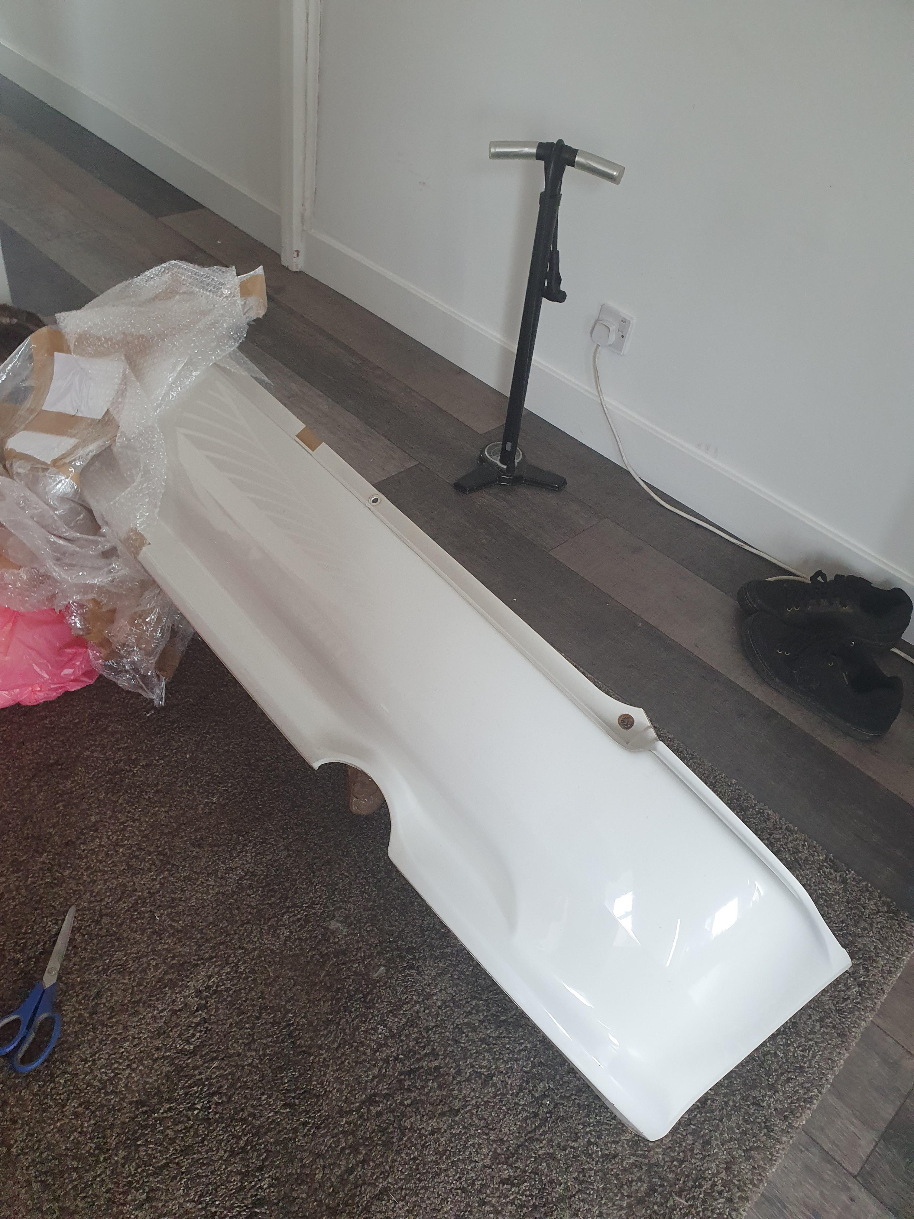

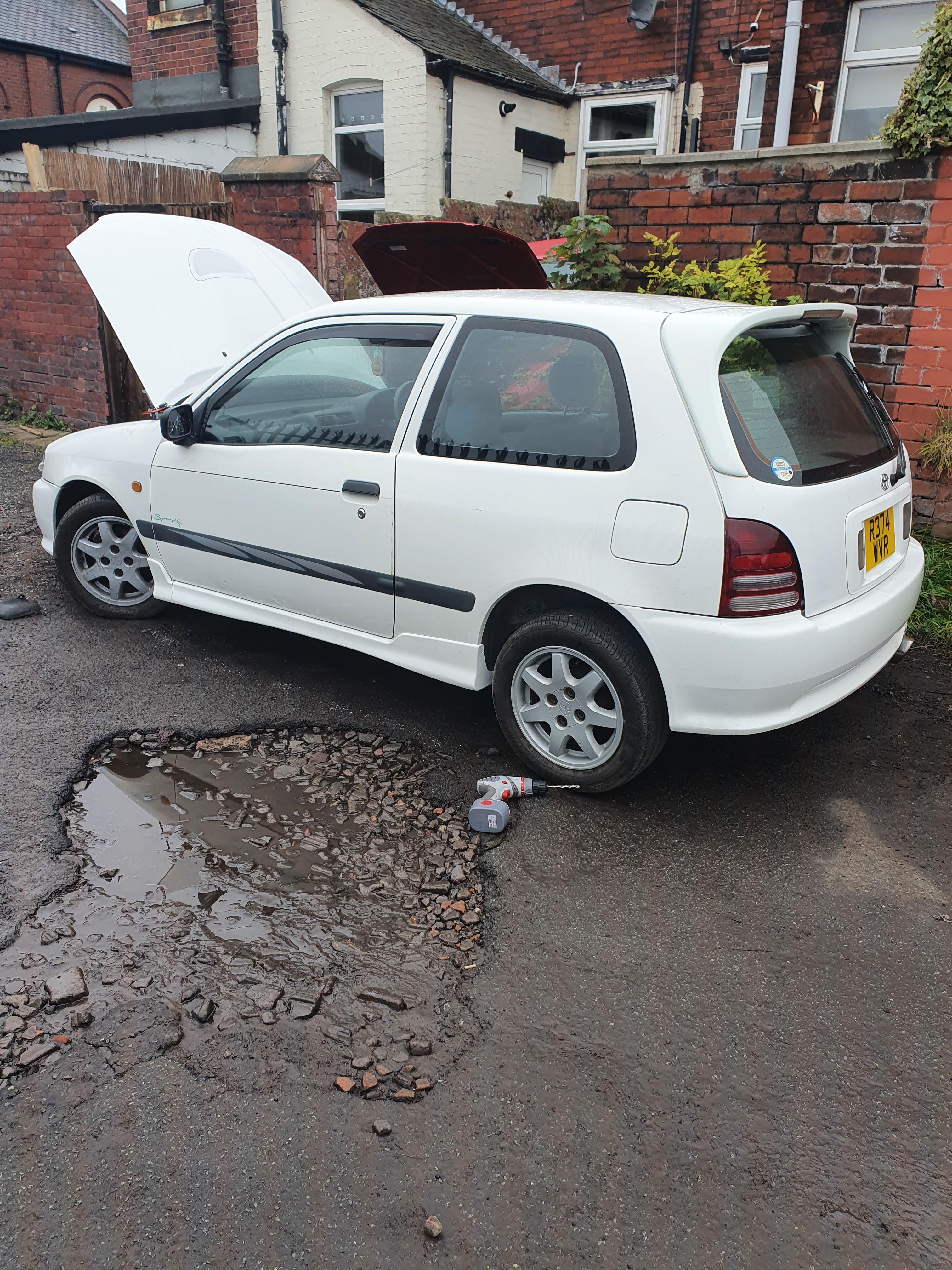

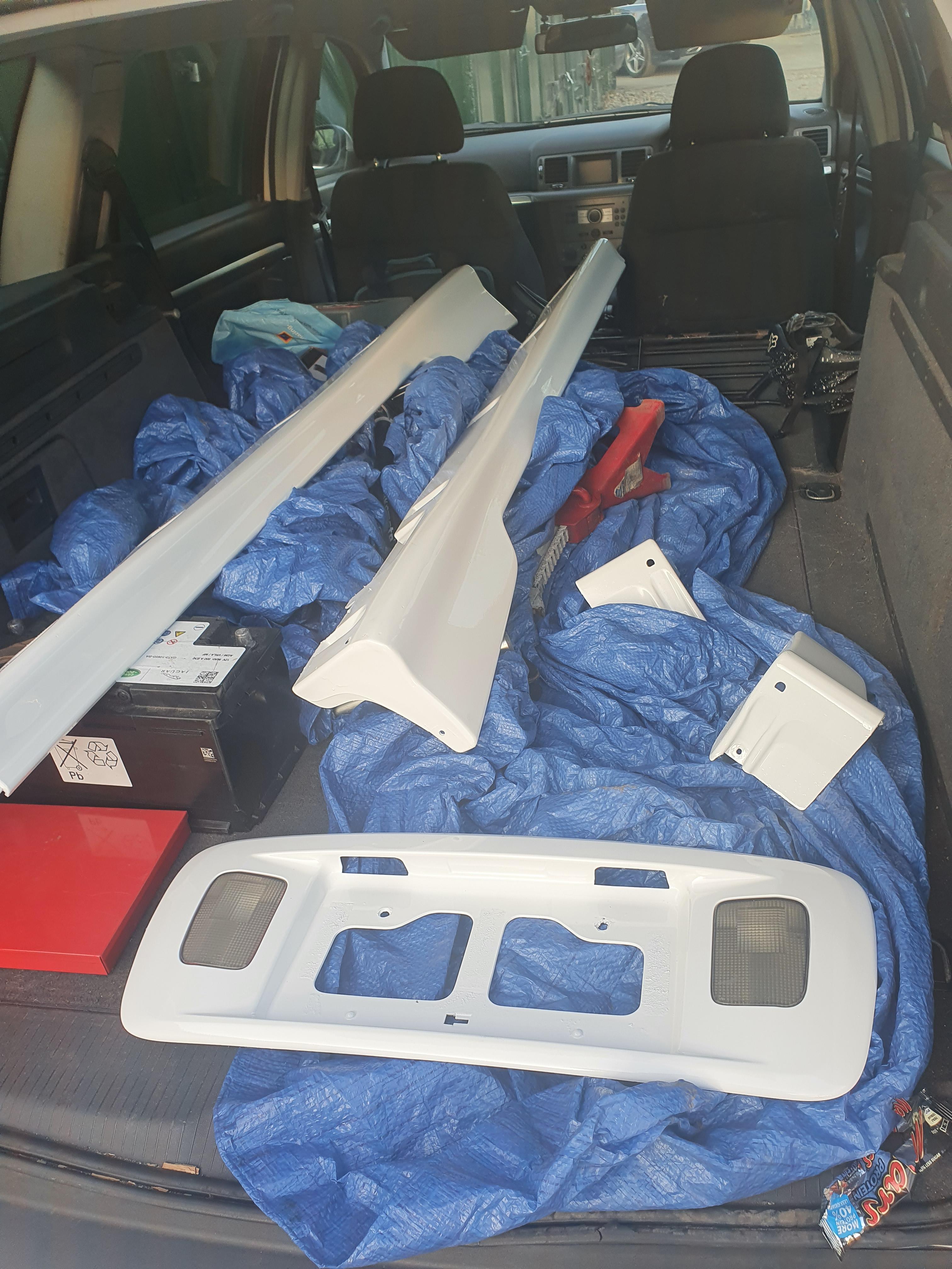

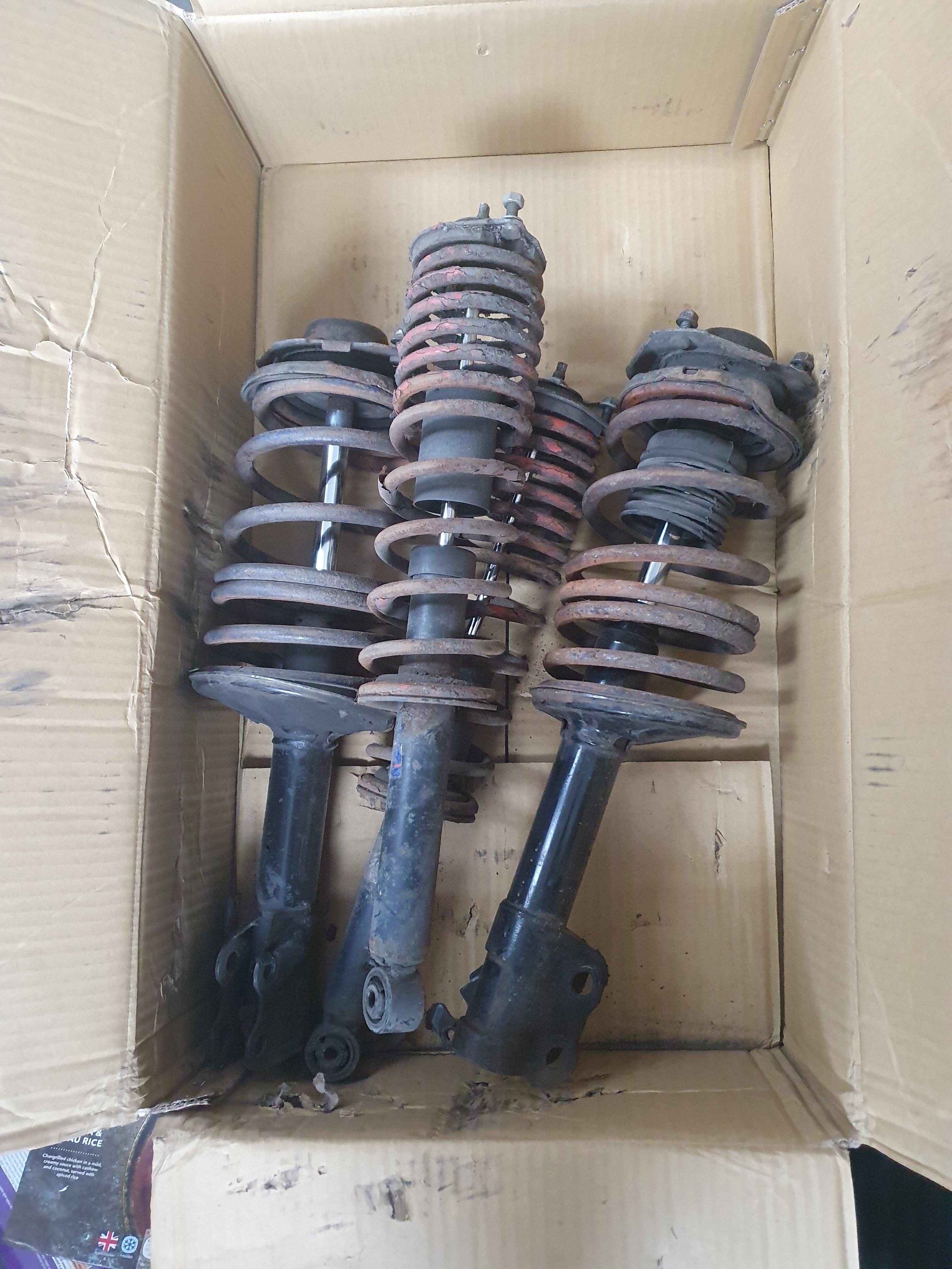

CaroleBaskin91 Posted February 11, 2021 Author Posted February 11, 2021 Got hold of some lowering springs and got my skirts and numberplate surround freshly painted. Ready to glanza the outsideย Quote

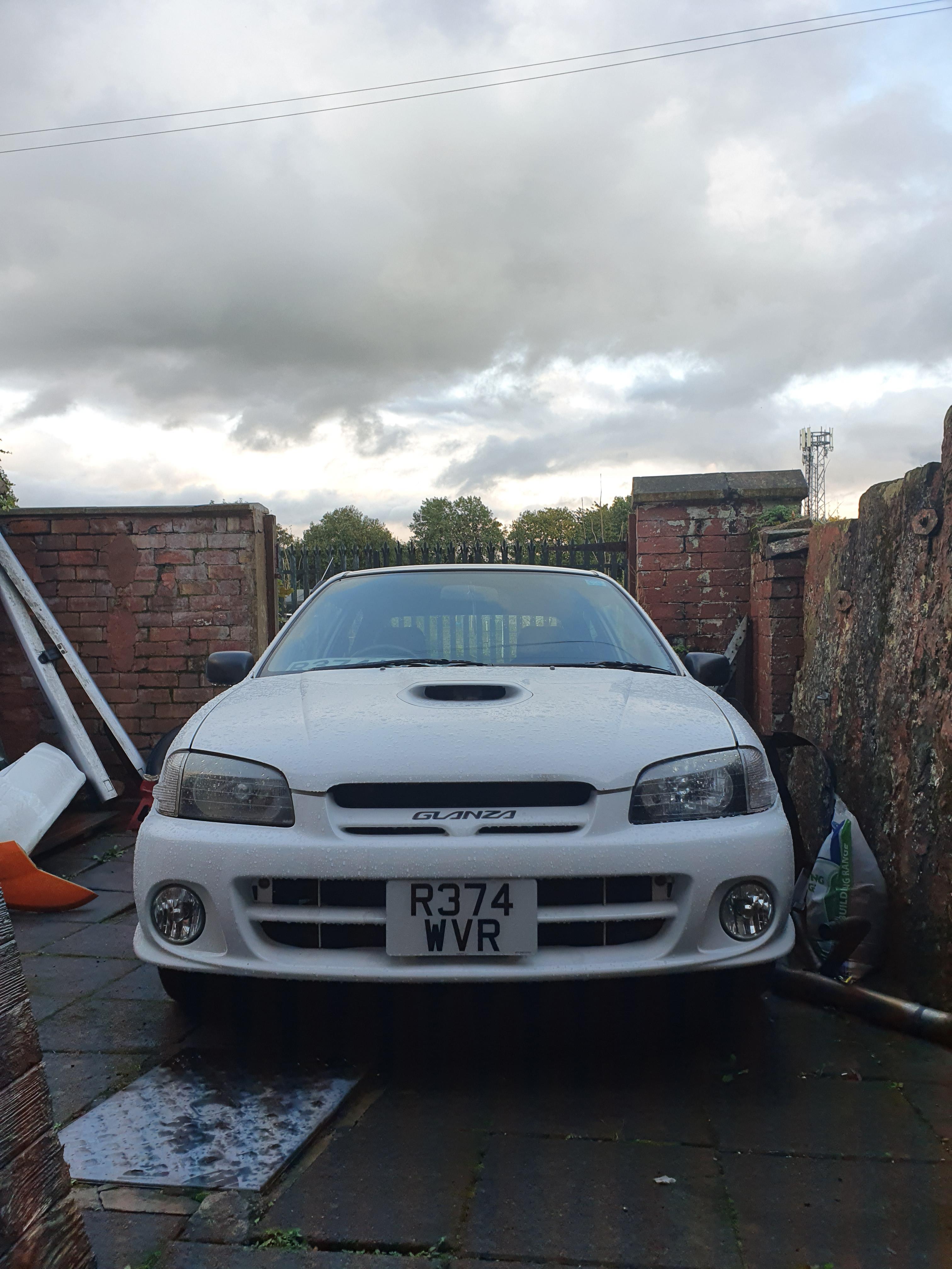

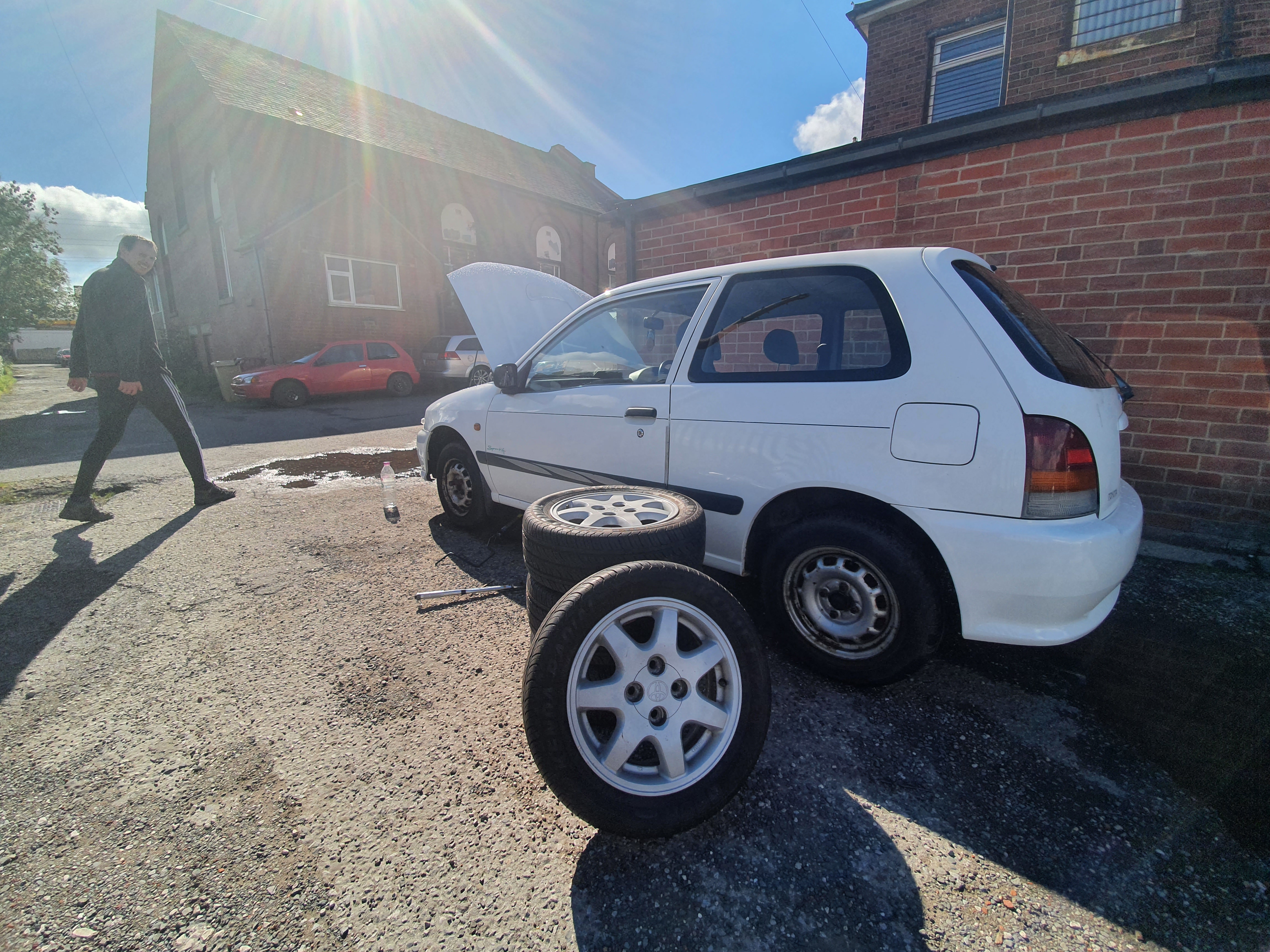

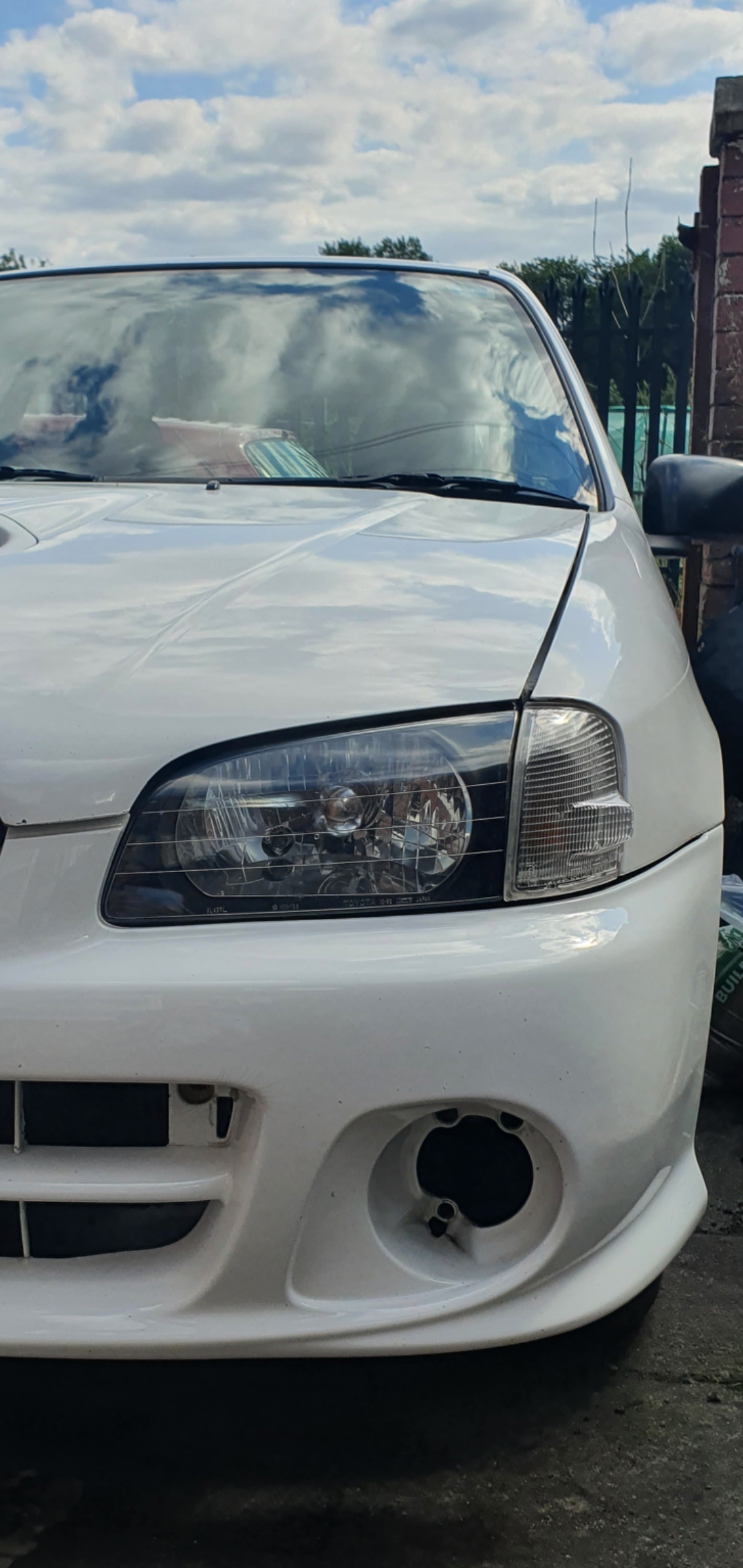

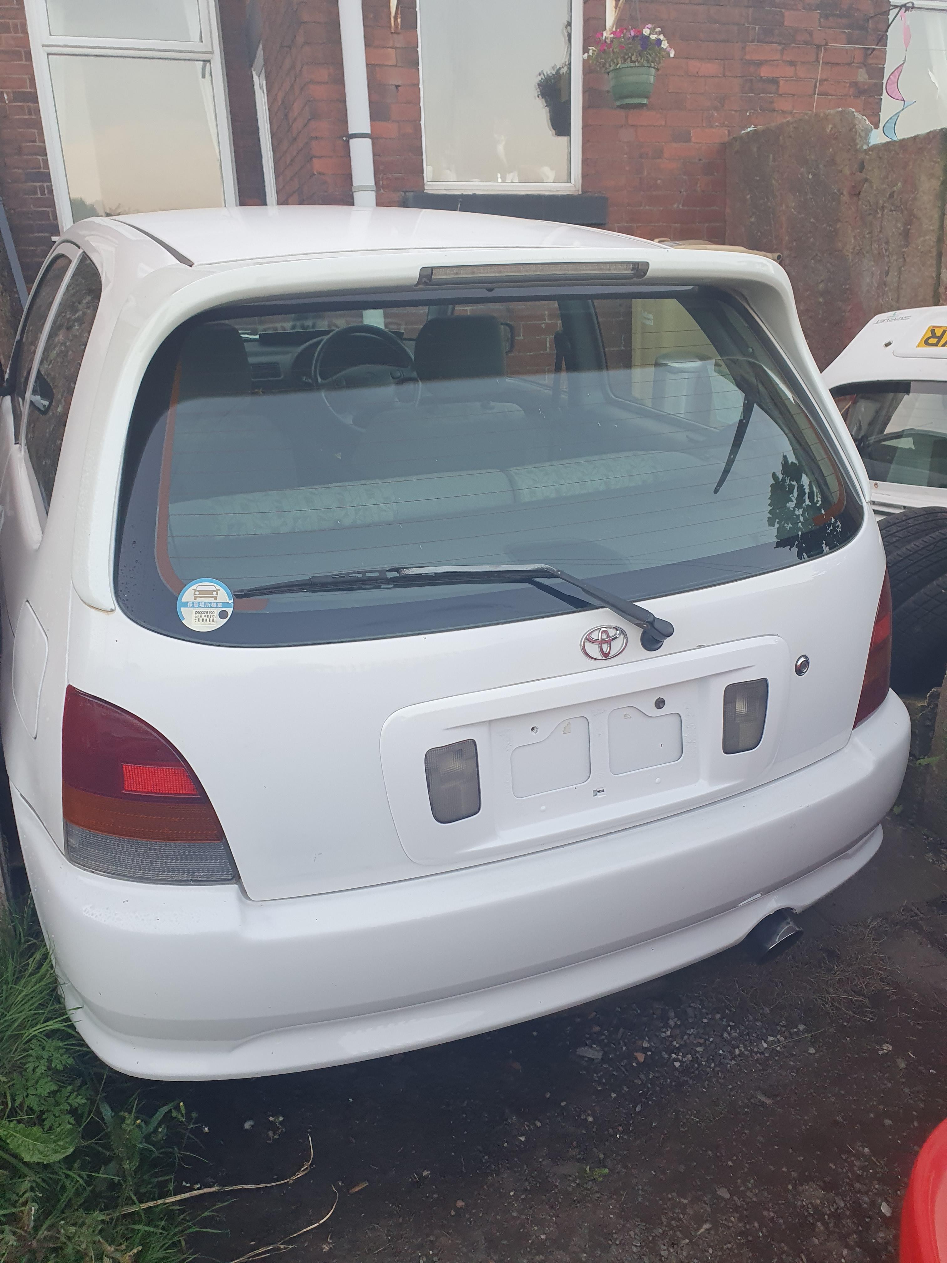

CaroleBaskin91 Posted February 11, 2021 Author Posted February 11, 2021 So the side skirts I had to drill the sills with an 8mm drill bit to fit my clips for the skirts, and then screwed in the end caps, they fit really well tbf, impressed myself!ย Fitted the tailgate and numberplate surround with new clips. And sourced a 98 spec front bumper along with headlights and a bonnet!ย Quote

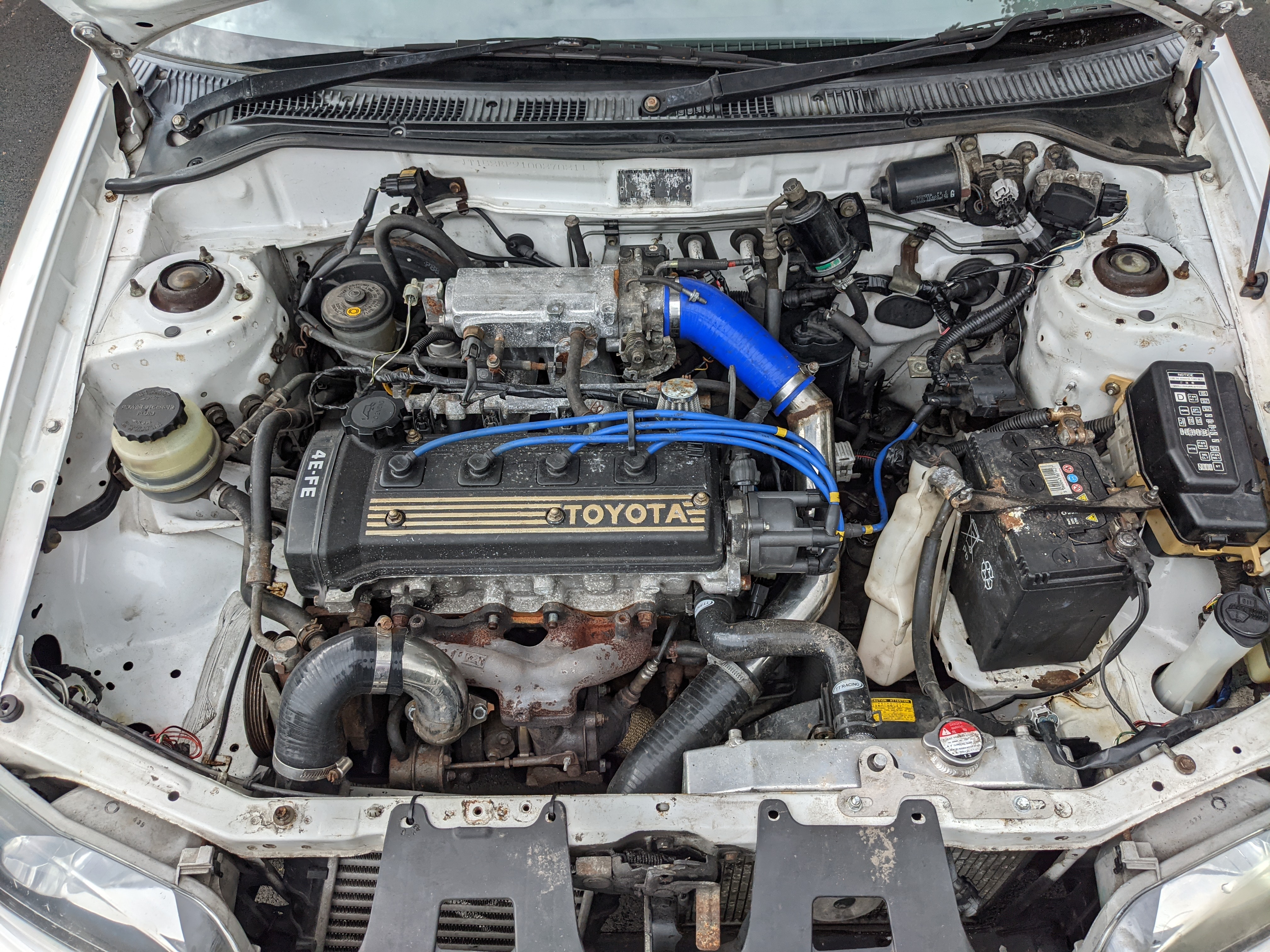

Claymore Posted February 12, 2021 Posted February 12, 2021 8 hours ago, CaroleBaskin91 said: Little snap of how it sounds, personally I love the sound of it!ย Good stuff. Any info on the engine setup? Engine management, intercooler pics etc? Quote

CaroleBaskin91 Posted October 17, 2021 Author Posted October 17, 2021 Just now, CaroleBaskin91 said: ย Snapchat-225265176.mp4 4.96 MB ยท 0 downloads ย UPDATE : October 2021 Finished the project, and have sold the starlet 1.3+Tย For those asking the specs of it, it went like this: - Ct9 turbo and manifoldย - 4efte oil filter housingย - 4efte intake manifoldย - 4efte map sensorย -Blue flame backbox with custom mid pipe - Decat - 4efte injectors and rail - Na box and 4efte clutchย - 4efte dizzy - 4efte ECU running bit more than stock around 150bhp - 4efte coolant housingย Glanza body kit with lowering springs and glanza V alloys!ย As I say I've now sold the car as a finished project and have bought a rolling shell glanza 97. I am going to start a build page on that one. I've had it a while already so will update with what I've done up to now!ย ย ย ย ย Quote
