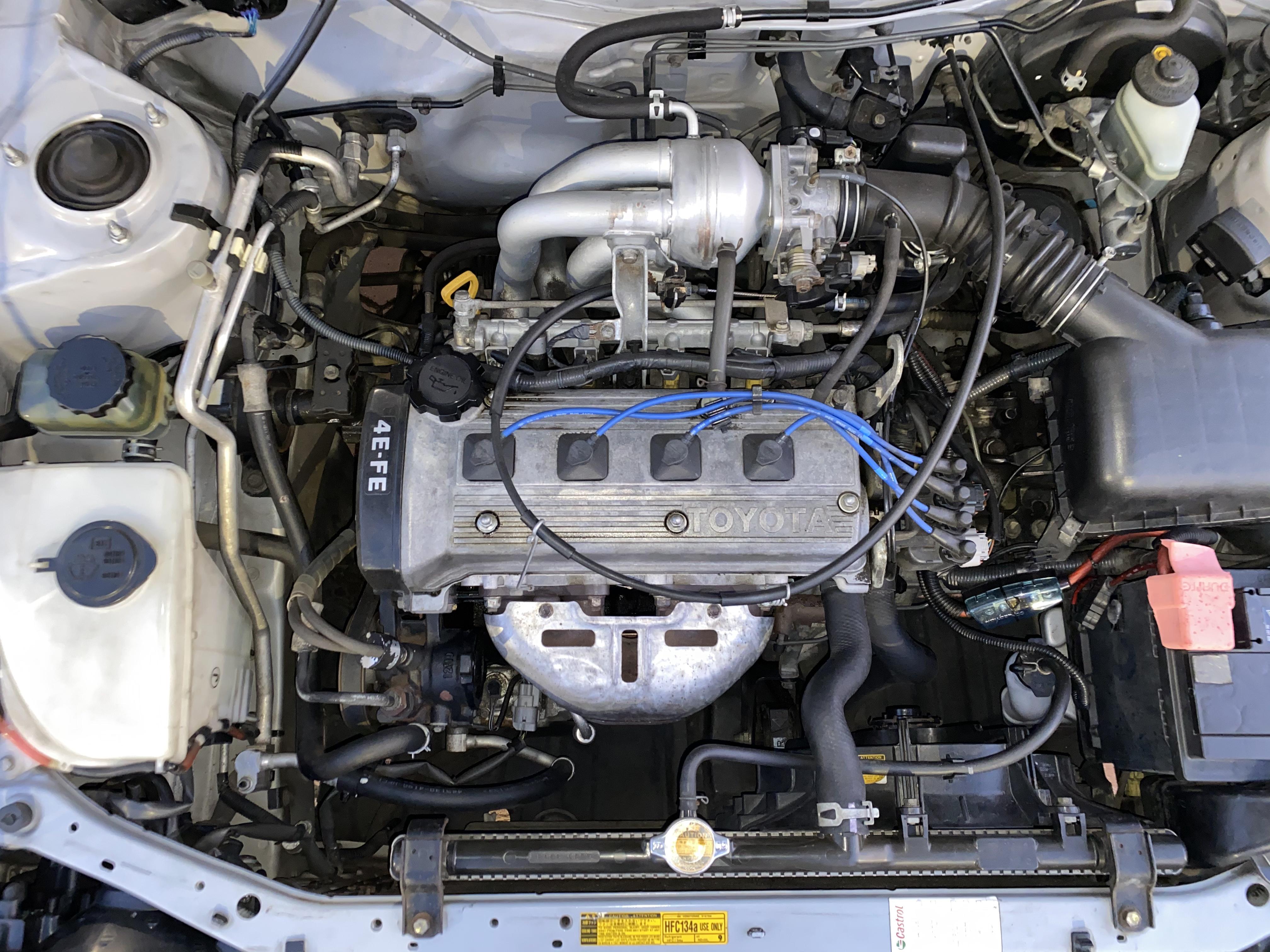

Sam44 Posted October 18, 2020 Posted October 18, 2020 (edited) Tidy bay. From what I'm reading yours is a c57 The c54 came In the early Yaris 1.5 vvti from what I've read. I'm not sure if they accept the c52/c56 lsd. From what I've read it's requires swaping the bell housing. I'll find out all information on this. I'll just look into it more for you to pinpoint your box. Im under the impression it's a c57. 200000km is big milage. Some info on the g6 swap https://www.toyotaownersclub.com/forums/topic/136040-e11-five-to-six-speed-gearbox-swap/ From what I can see the c56 also came in the corrola. This box will come with a glanza engine. The difference between the c56 and c57 is the gearbox end caps, the c56 is cast aluminium, the c57 is folded formed steel black in colour. If you have a aluminium end cap get a gearbox with the 4efte engine there the same gearbox. I got this information that yours could possibly have a c56 box. I got this information off wikipedia!!!. So for me personally I'd be very surprised if it has a 4efe corrola would struggle with this box. I'm expecting you to tell me you have a black end cap. Alot of the ratios are wrong also on Wikipedia. What is the price difference buying the engine with/without the gearbox. Edited October 18, 2020 by Sam44 Quote

Frankieflowers Posted October 18, 2020 Author Posted October 18, 2020 4 hours ago, Sam44 said: tell me you have a black end cap. Yes as you can see in the picture. Black cap. Am I right? Quote

RoyalDutchie Posted October 18, 2020 Posted October 18, 2020 (edited) The oem lsd for the 4efte should be out of the picture getting a complete unit with the custom mount and driveshaft is not an easy task. The viscous style is pretty much an open diff now and won't function like a lsd without a refurb imo. A helical lsd would be the best maintenance free LSD on the market as far as my knowledge goes. 1 hour ago, Frankieflowers said: Yes as you can see in the picture. Black cap. Am I right? The black cap would be a reference to the endcap of your gearbox if I'm not mistaken. The 4efte ones are made completely of aluminium and the gearbox in the Corolla has a sheetmetal endcap coated in black paint. Gainzy is still selling a nice 4efte gearbox for about 150 gbp if you want a complete 4efte without paying the 500-700 gbp for a gearbox. Edited October 18, 2020 by RoyalDutchie Quote

Frankieflowers Posted October 18, 2020 Author Posted October 18, 2020 4 minutes ago, RoyalDutchie said: The oem lsd for the 4efte should be out of the picture getting a complete unit with the custom mount and driveshaft is not an easy task. The viscous style is pretty much an open diff now and won't function like a lsd without a refurb imo. A helical lsd would be the best maintenance free LSD on the market as far as my knowledge goes. The black cap would be a reference to the endcap of your gearbox if I'm not mistaken. The 4efte ones are made completely of aluminium and the gearbox in the Corolla has a sheetmetal endcap coated in black paint. Thank you for the info. The only 4efte engines available now are without LSD. Just trying to figure out if I should buy the engine without the gearbox or not. Sam44 is helping me figure out if I can adapt my Corolla 4efe gearbox to a 4efte. What do you think? Quote
Sam44 Posted October 18, 2020 Posted October 18, 2020 (edited) Yep it will bolt up. 4efte to your E11 standard box. Thanks for the picture dutchie. Yeh the drive shaft length is different from the starlet factory lsd box it will not fit the corrola. Edited October 18, 2020 by Sam44 Quote
