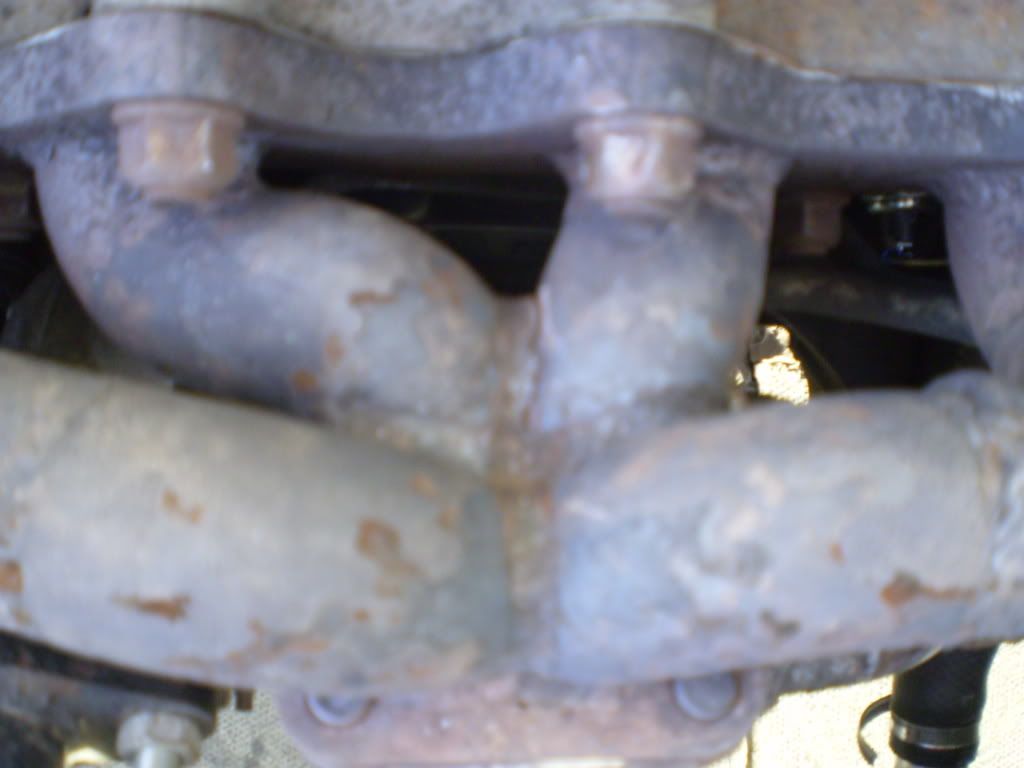

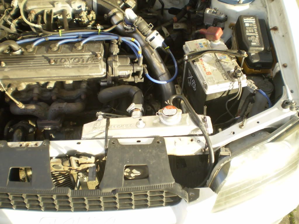

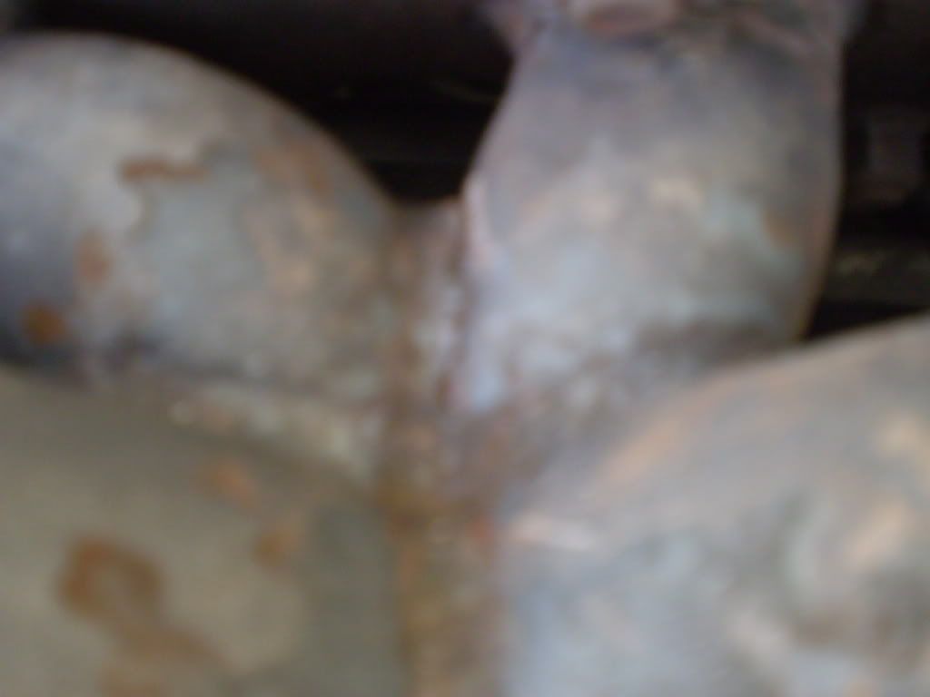

Russleh Posted October 5, 2009 Author Posted October 5, 2009 couple little updates. no decent pictures yet though. got my half sized rad fitted ( although it isnt mounted in a very secure way ) and blitz sus filter on and relocated with a cusomised s bend pipe. got some new tires too. found a few problems though 1.brake drums were making terrible noises , had a look and i have no pads and when i pull up the handbrake it barely moves so i wanna change to discs instead of fixing it 2. backbox has a hole in it ( was there already but i dont like it ) 3. dumpvalve appears not to want to dump 4. roadrunner mani has a crack at the weld where the 4 pipes come together and is leaking a small amount of air. soo a few things to fix. will take some pictures of good and bad bits tomorrow Quote

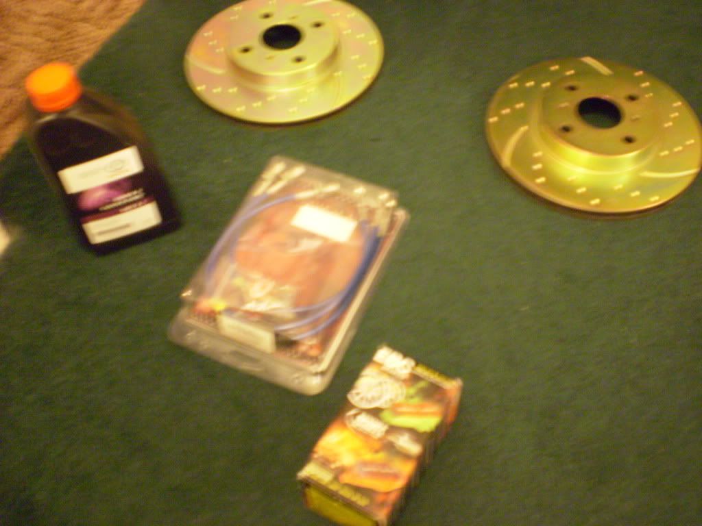

Russleh Posted December 3, 2009 Author Posted December 3, 2009 time for a little update. brake time. got my rear brake setup today so i can get rid of drums. not very pretty looking but it will be ;). cleaned up one caliper and painted most of it and just need to paint the other side once thats dry. new setup for the front also. the td fast road brake package.ebc drilled and grooved discs with yellow stuff pads. braided lines and brake fluid. will also be doin the front calipers in the same gold colour as the back ones. and what would my update be without a question lol whats the best way to get the piston back into the caliper because when i was cleanin it i was movin a part around not thinkin that it was moving the piston ? knew they were stiff but i cant get it to budge. should have another update around xmas with my 2 weeks off. should see the completion of my other car 2 Russell Quote
micky boy Posted December 3, 2009 Posted December 3, 2009 Them back discs look sweet mate ;) as for the pistons on the calipers are you pushing them? if so you are doingit rong lol they need to be turned Quote
ToyotaTech15 Posted December 3, 2009 Posted December 3, 2009 Ye mate, as Micky says, they need to be wound back, just really need pushed and turned either left or right depending on side.You may need a tool depending on how tight they are,Just remember when you put them on, pump the foot brake fully before touching the handbrake as thats the adjustment.Everything looks good thouGary Quote

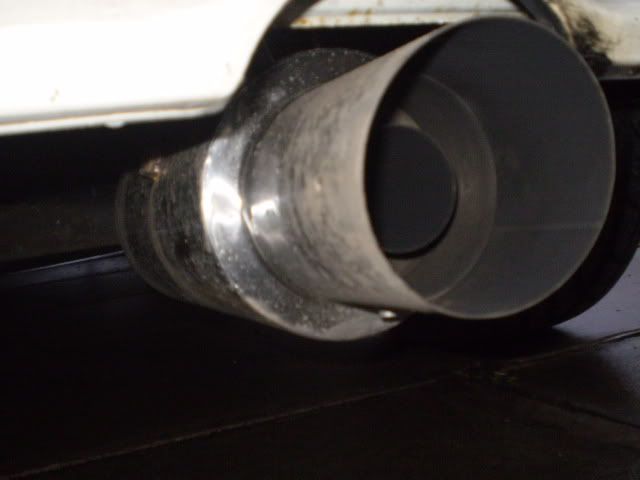

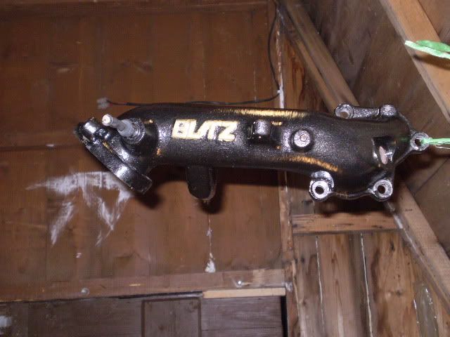

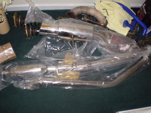

Russleh Posted January 23, 2010 Author Posted January 23, 2010 little update had to buy a new exhaust because my decat is falling to bits and its an old style wepr sytem so decat i bought didnt fit it soo got me a jperformance exhaust. and got this for it could have painted the blitz better but brush was rubbish lol. now i need to go out in the rain and fit these Quote
Sparky Posted January 23, 2010 Posted January 23, 2010 Should sound immense!! I spy some Tein coilys aswell Quote
Russleh Posted January 23, 2010 Author Posted January 23, 2010 lol they the ones of the silver car that used to be the sleeper. took them off as was gonna put it back to standard but decided against it and gonna sell the car as is once its runnin again. the exhaust has a mega baffle in it but i think it will be stayin in becuase i use the car to take my dad to work in and you have to shout. Quote

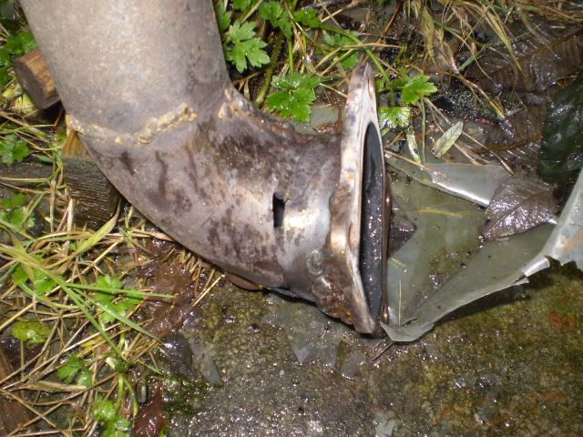

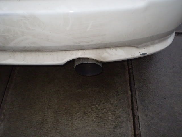

Russleh Posted January 24, 2010 Author Posted January 24, 2010 fitted the decat and exhaust yesterday in the rain and it looks old already after drivin for 1 day doesnt sit right with the bumper but it will do the now lol. now for the pictures of the old downpipe lol didnt sound the greatest. Quote
Sparky Posted January 25, 2010 Posted January 25, 2010 They are Type HA's if they are damping adjustable Sell me Exhaust will look good when adjusted to sit in the bumper nice What does it sound like? Quote
Russleh Posted January 25, 2010 Author Posted January 25, 2010 lol no deal how will i get it to sit right? just bend the hangar a bit. well sounds alot quiter in the car because the noise isnt coming from the front anymore lol but sounds great with the window open. Quote
Sparky Posted January 26, 2010 Posted January 26, 2010 Open cheque book mate name your price** **Between 1p and £150 May need to get the hanger rewelded if its out too much not a hard job though Quote
