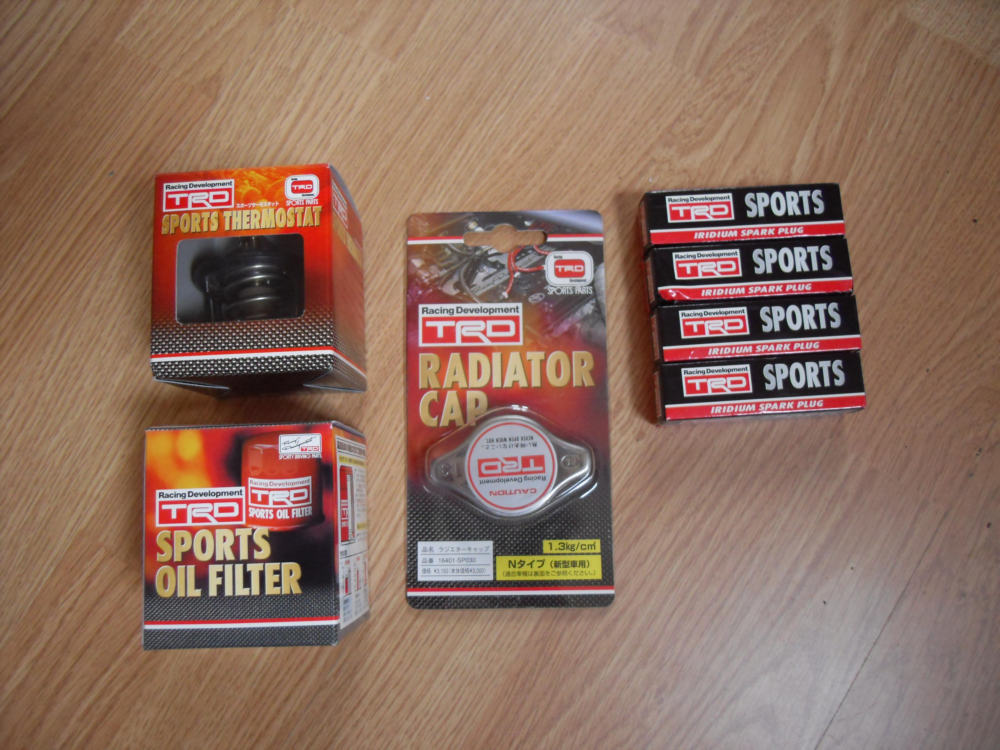

TRD Oil filter, Rad Cap, Low Temp Thermostat and Spark Plugs

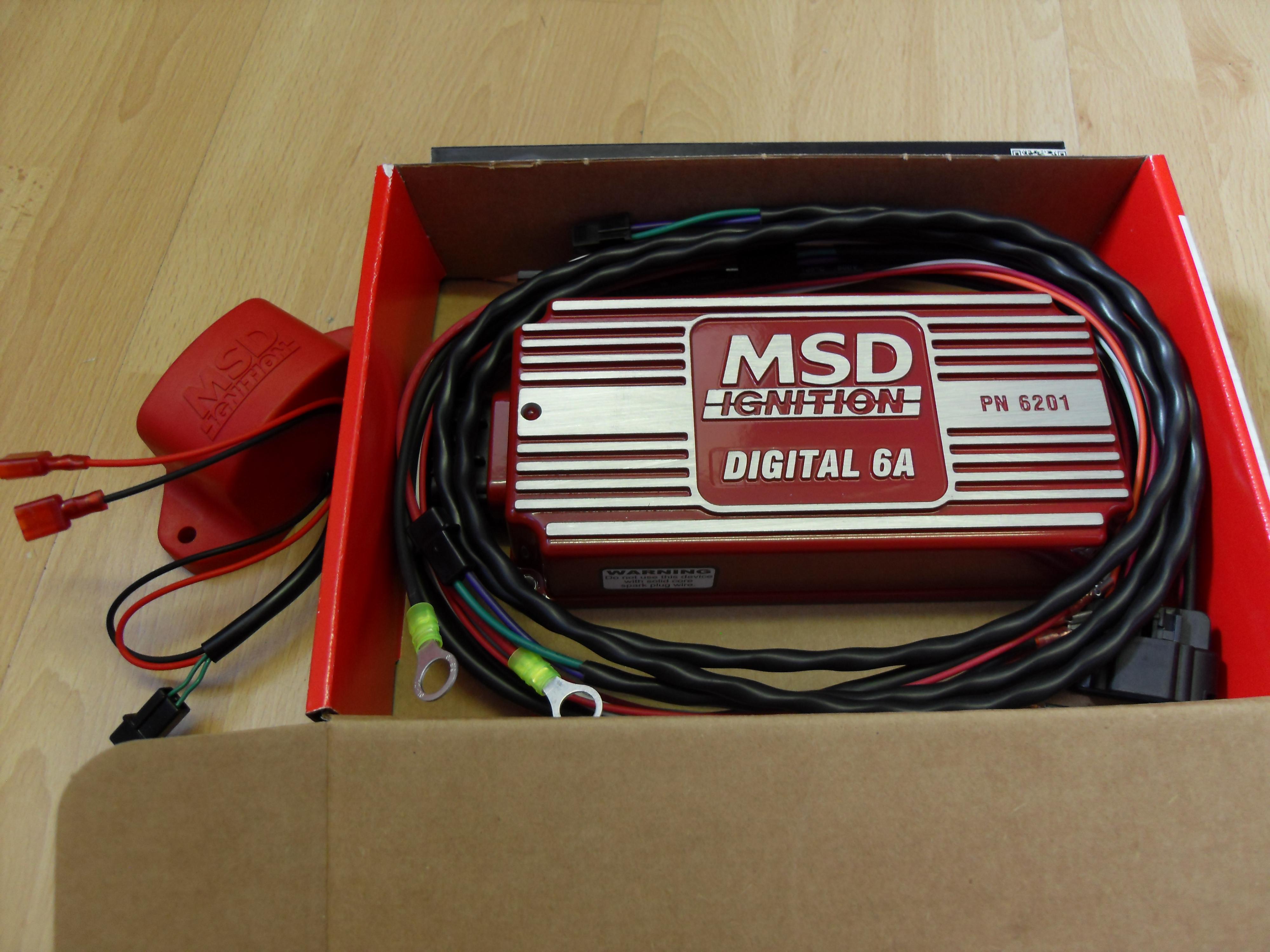

MSD Digital 6A Ignition and Tach Adapter

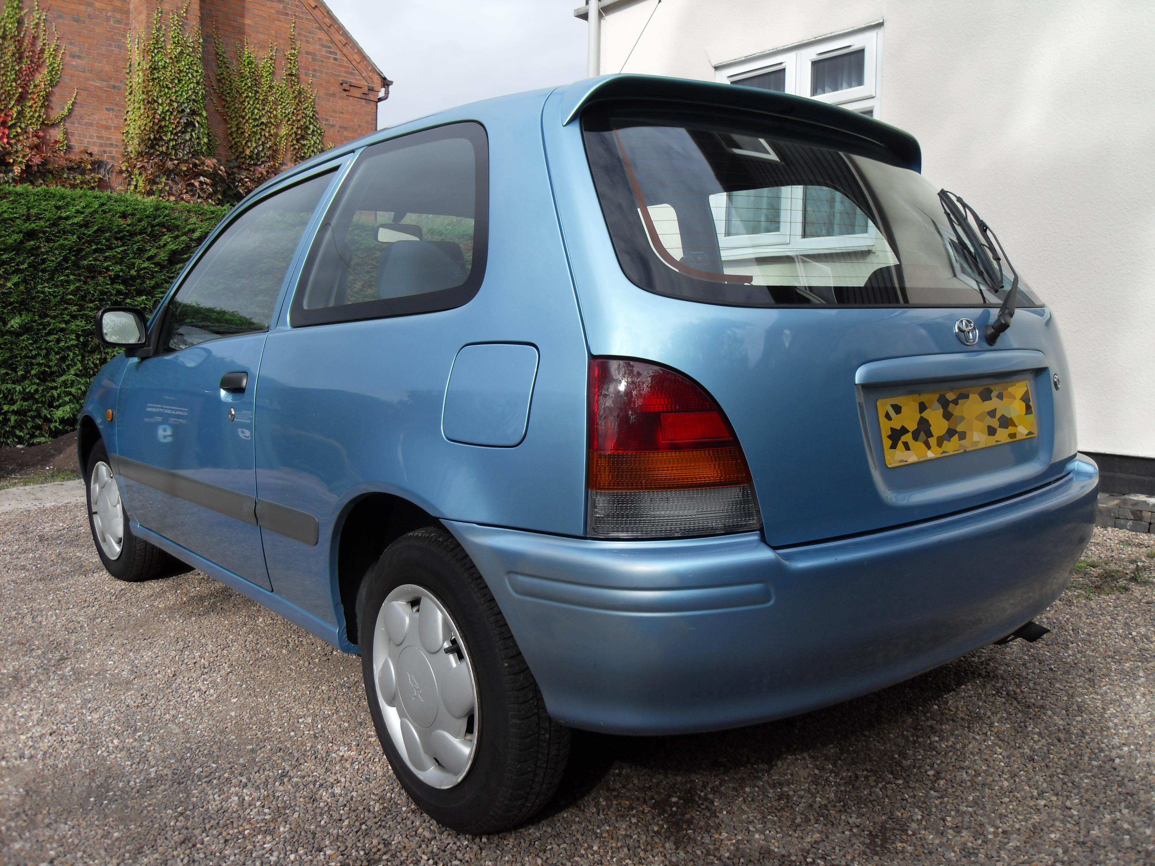

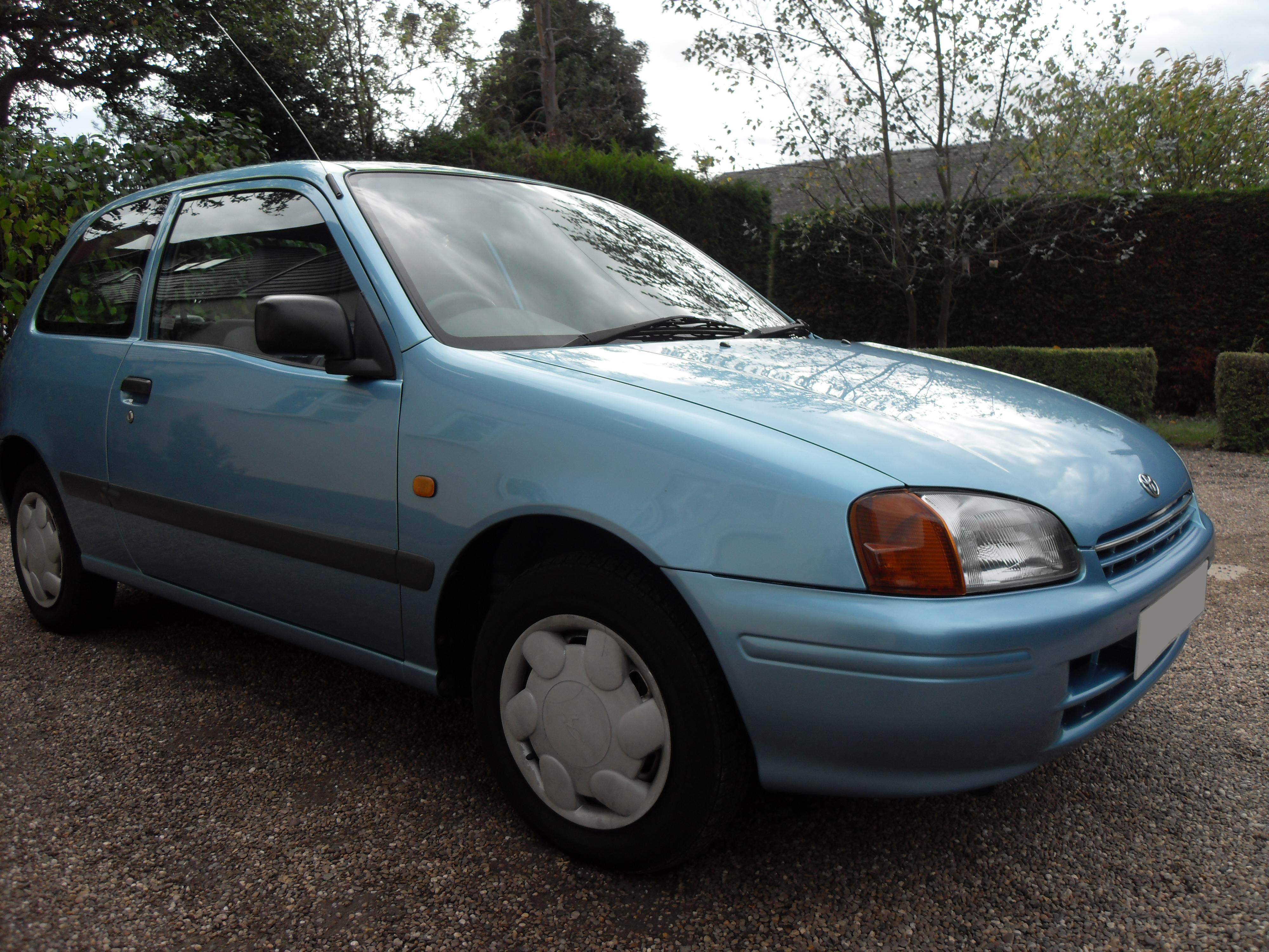

Plans have changed or should I say the car has been changed. I came across a 1998 Starlet S with 53K on the clock in a colour that I have been after for a long time. It was a good price for the condition and came along at the right time so I bought it. The plan now is to drive the new starlet over the winter and at the same time get the new/old upgrades and Gi engine from my old starlet ready for swapping over in the spring.

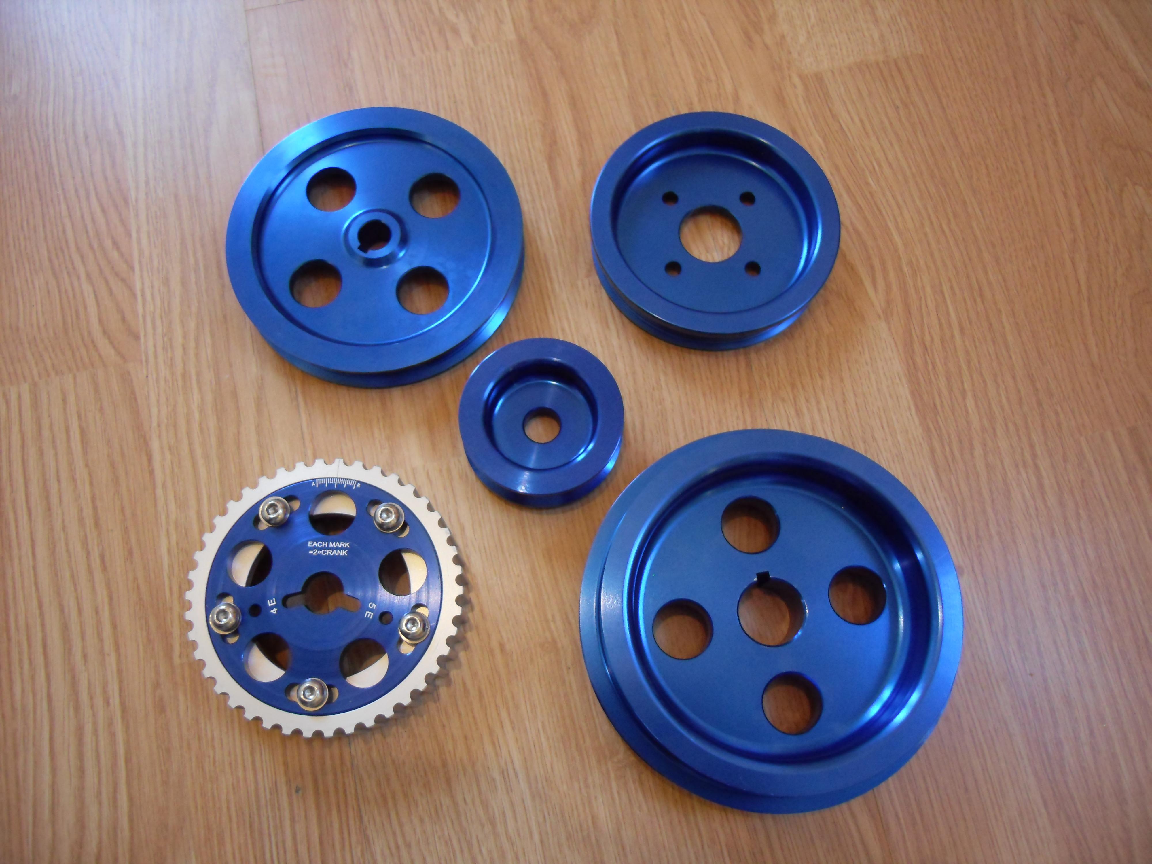

C J Performance adjustable cam gear and lightweight pulleys

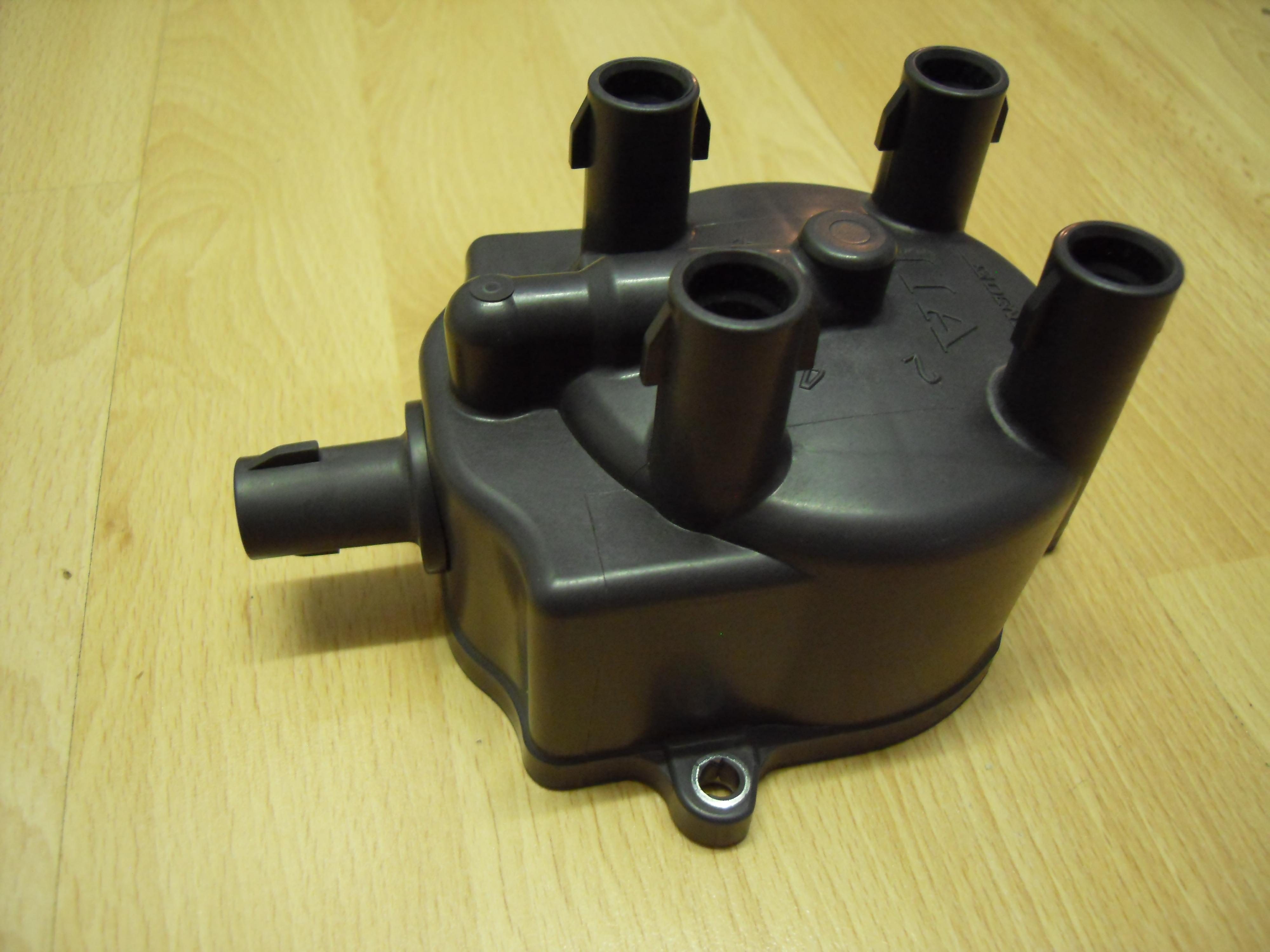

Custom distributor cap for use with an external coil when runnig the MSD Ignition.

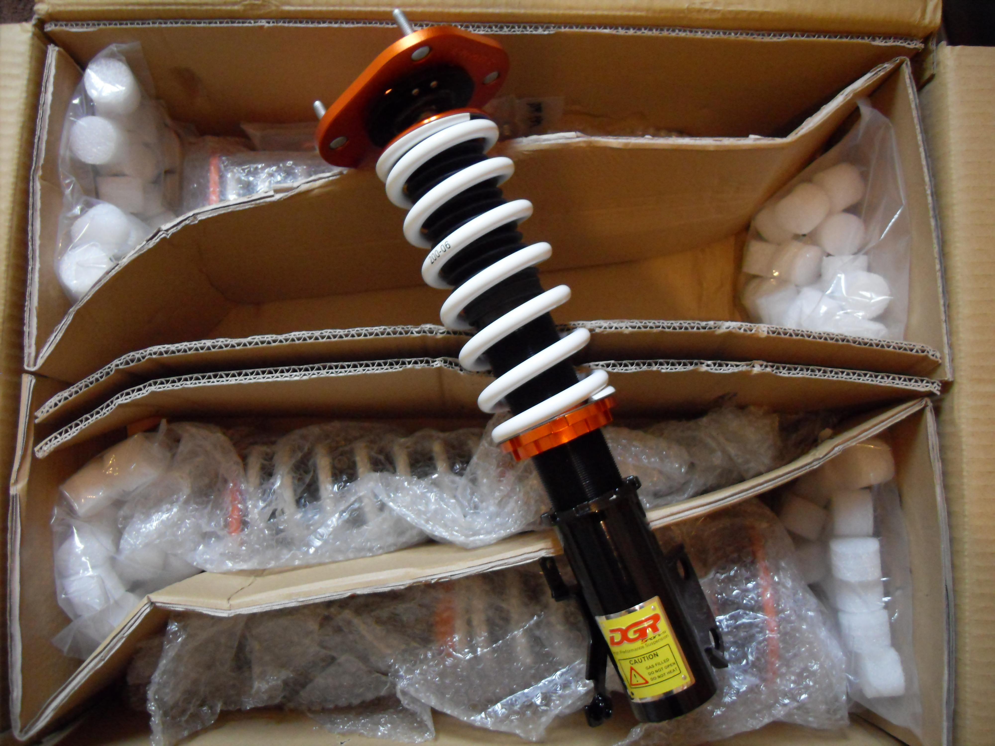

DGR Coilovers

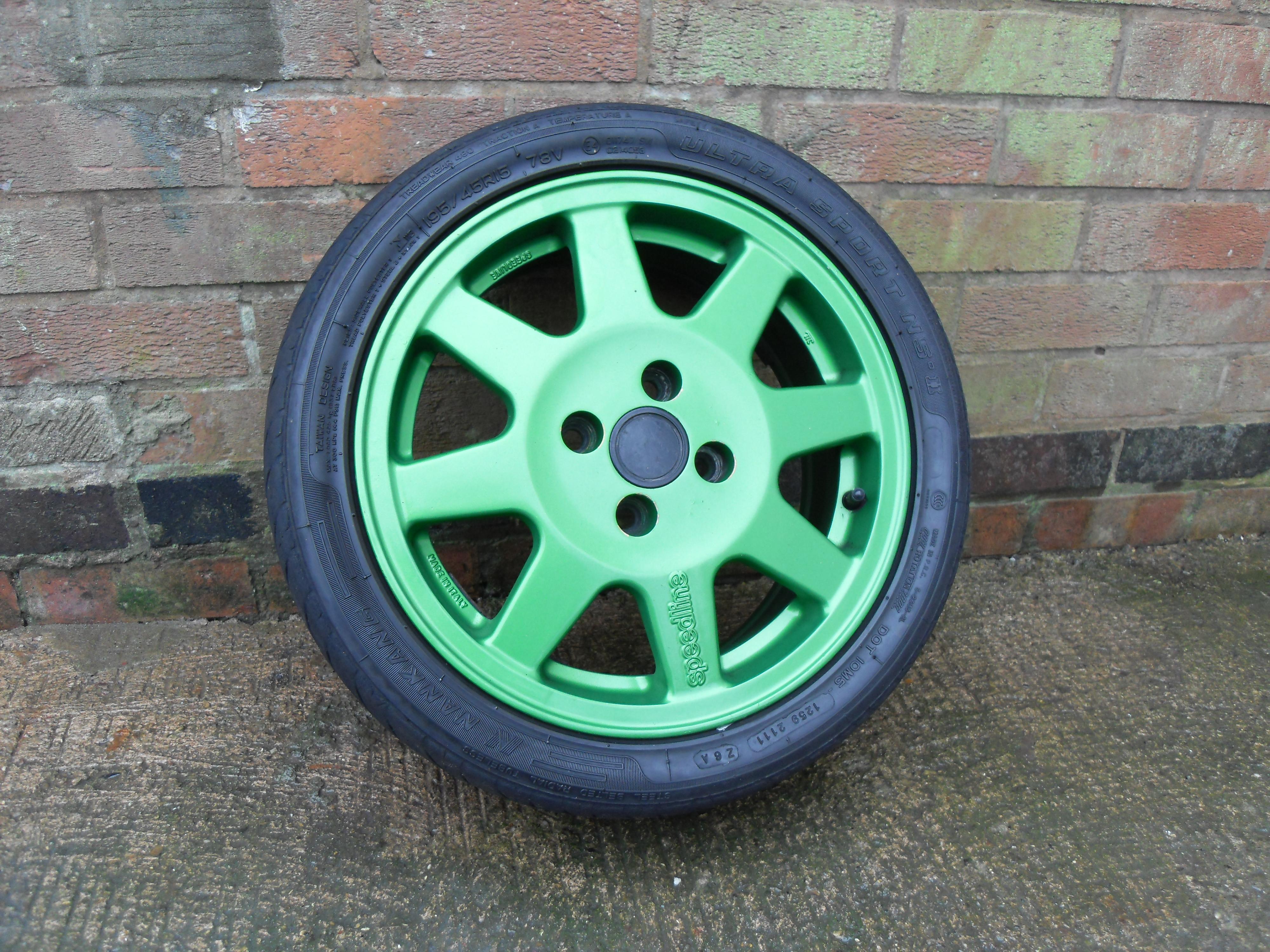

SR Speedline Wheels

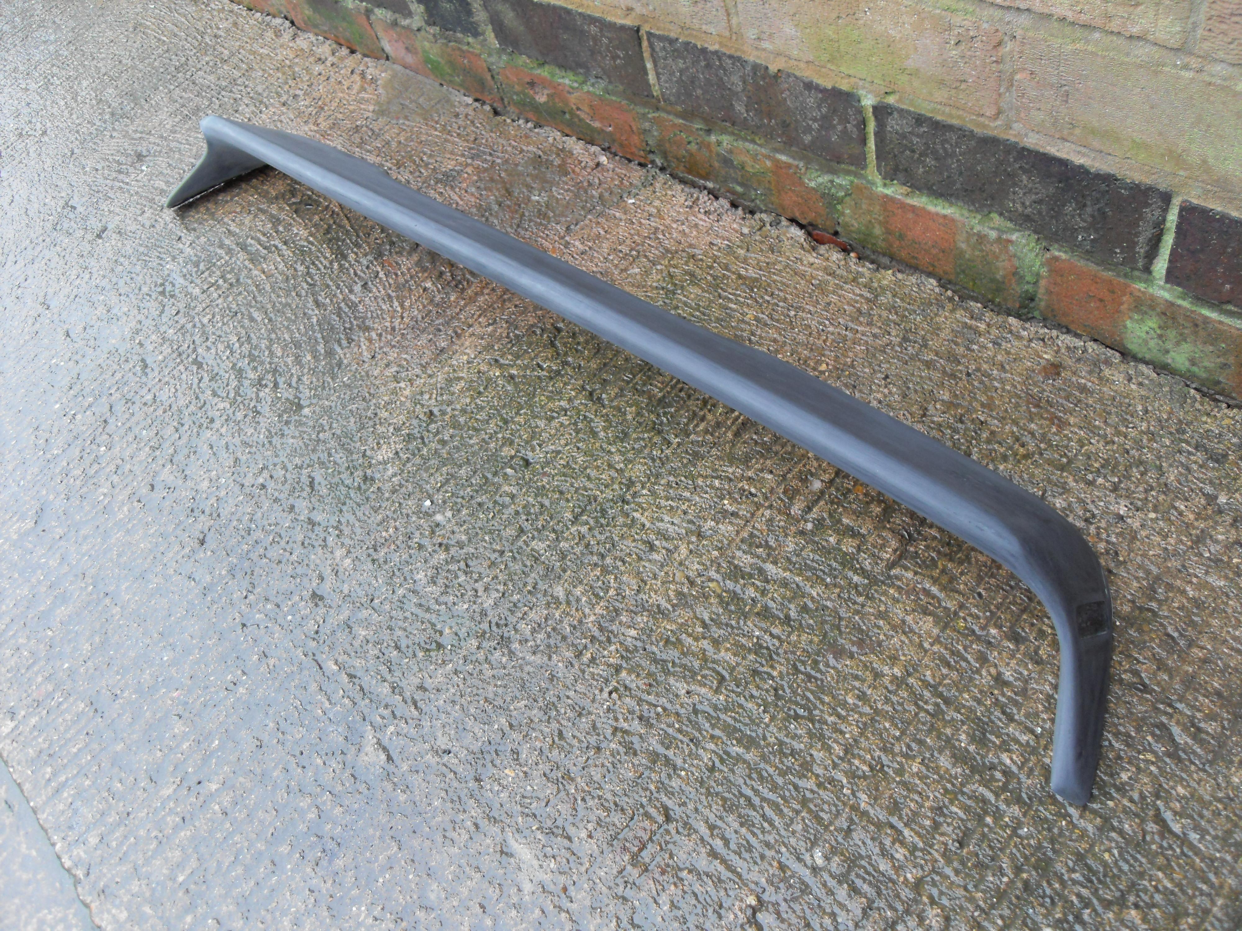

SR TTE Spoiler (stripped and ready for priming)

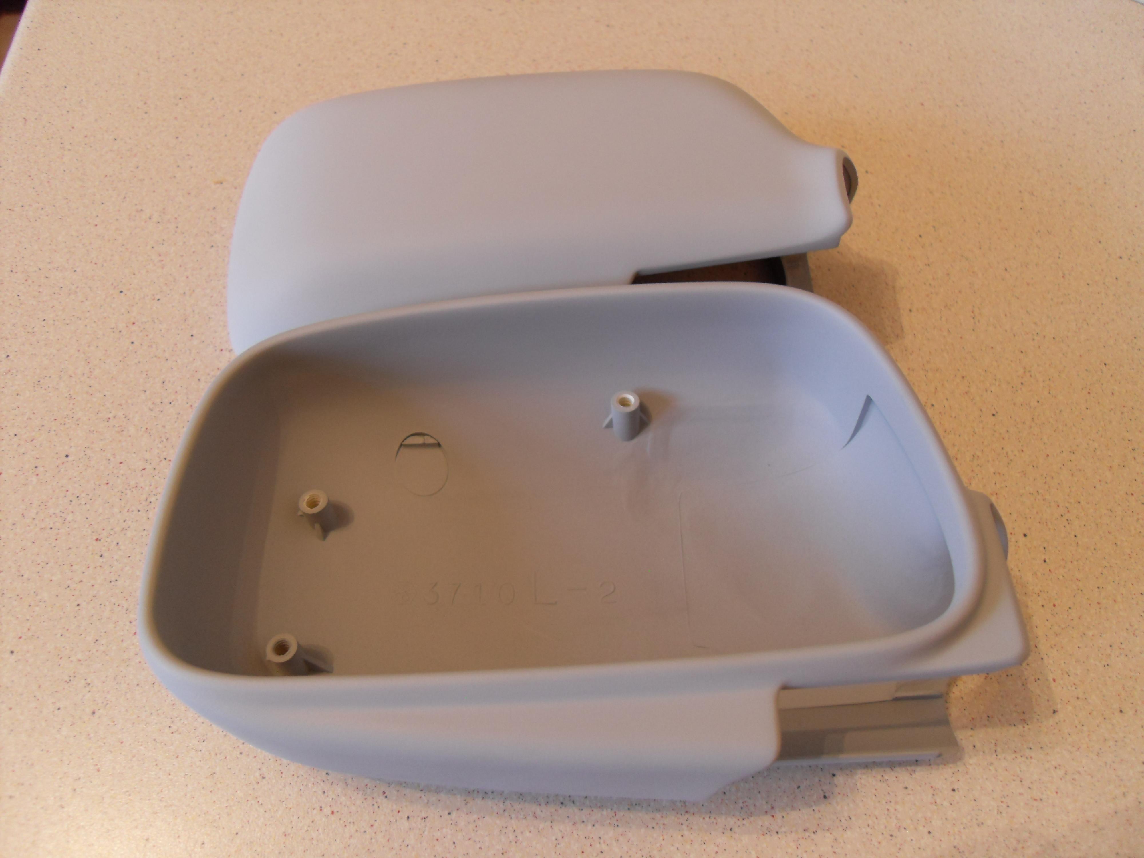

Glanza Electric Mirrors (primed and ready for painting)

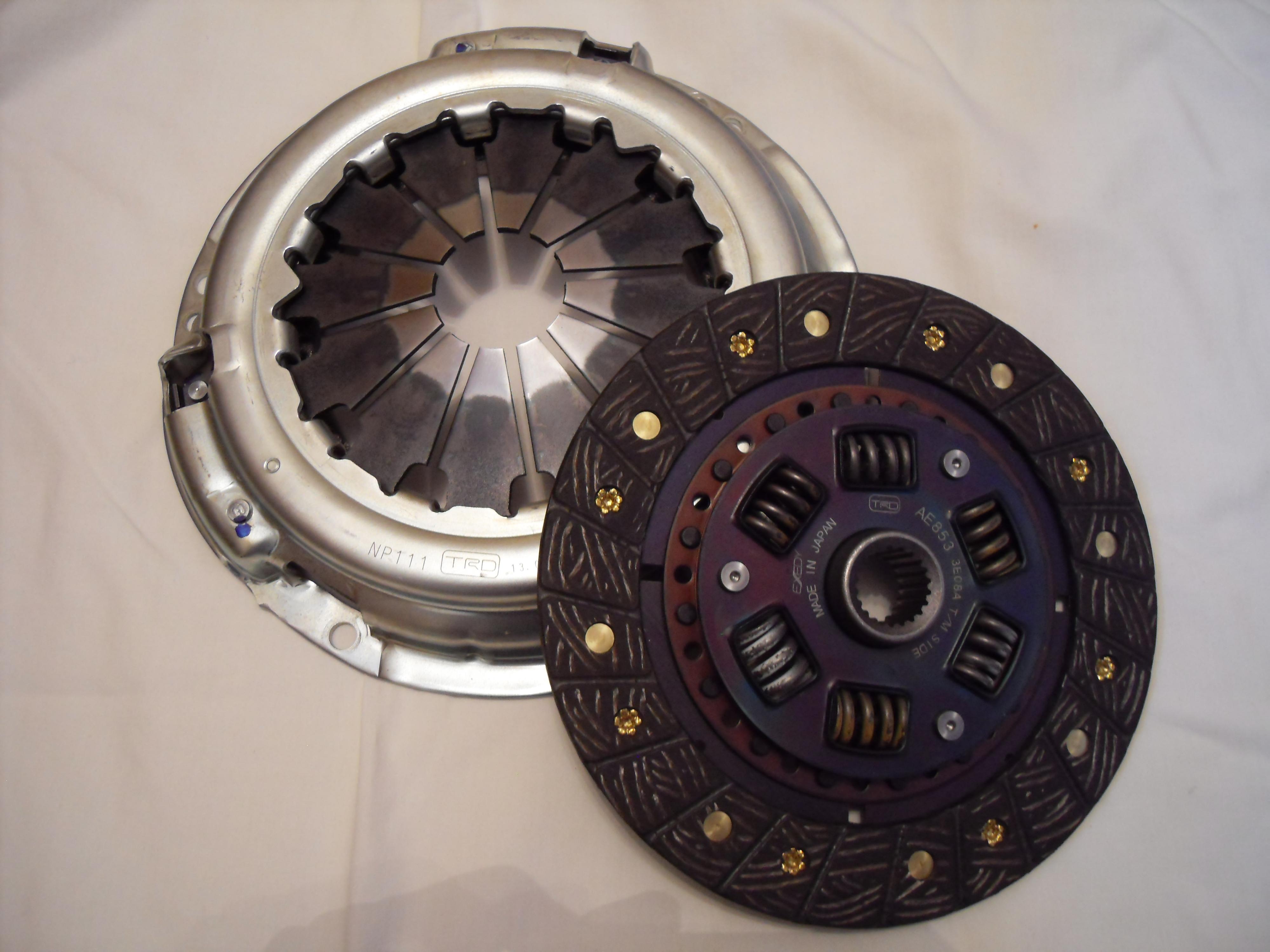

TRD N/A Clutch and Pressure Plate (small version for N/A, less weight)

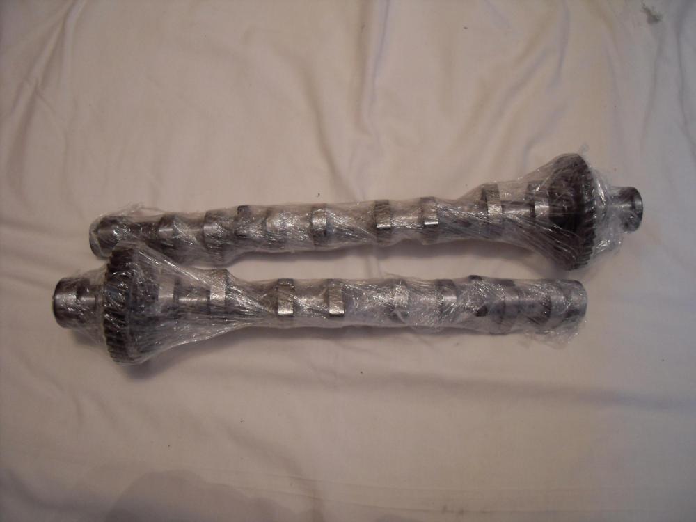

5E-FHE Camshafts

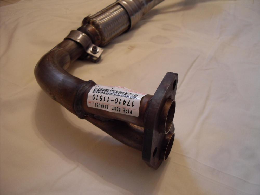

Lower Half of Corolla 4-2-1 Exhaust Manifold

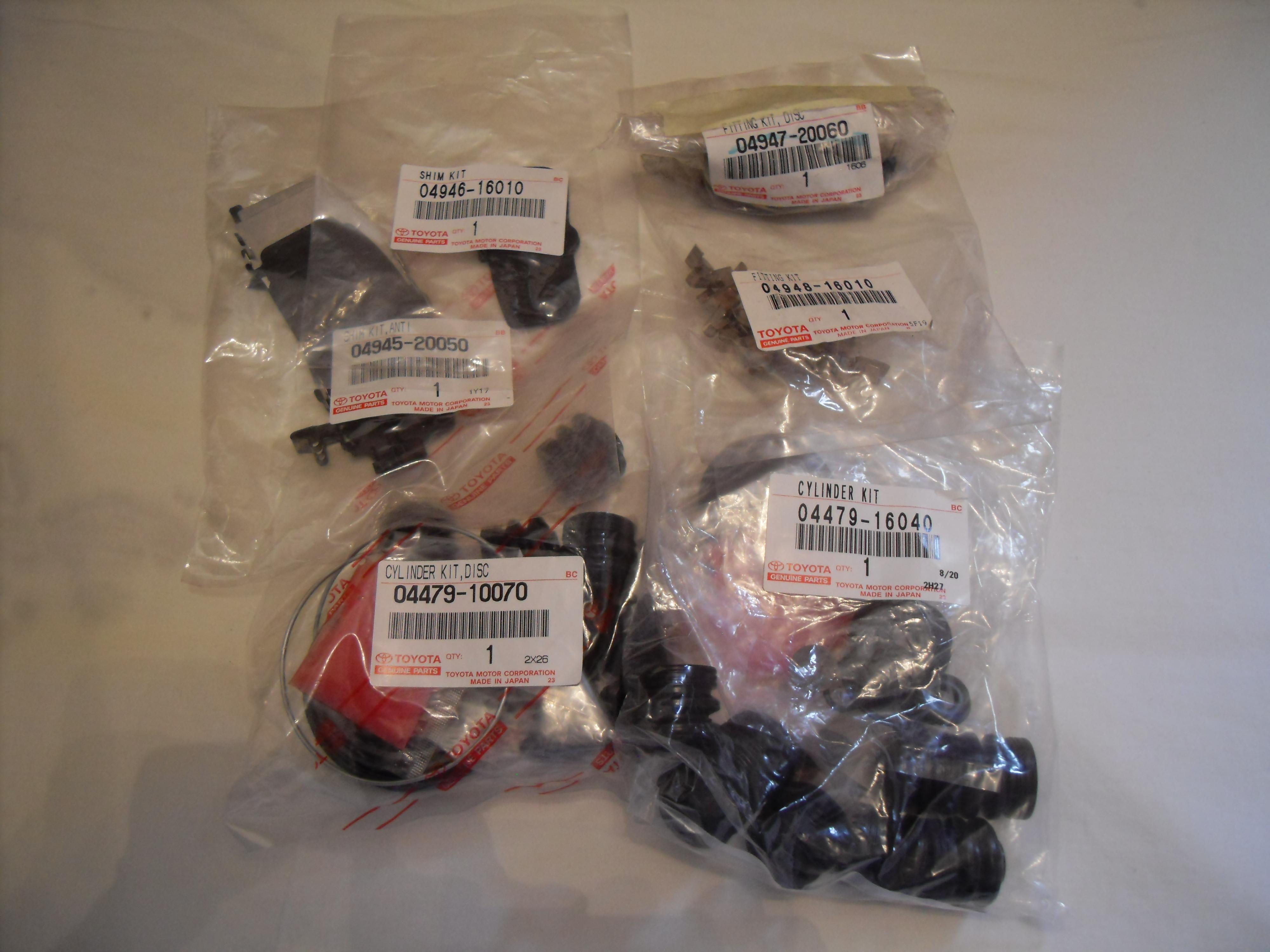

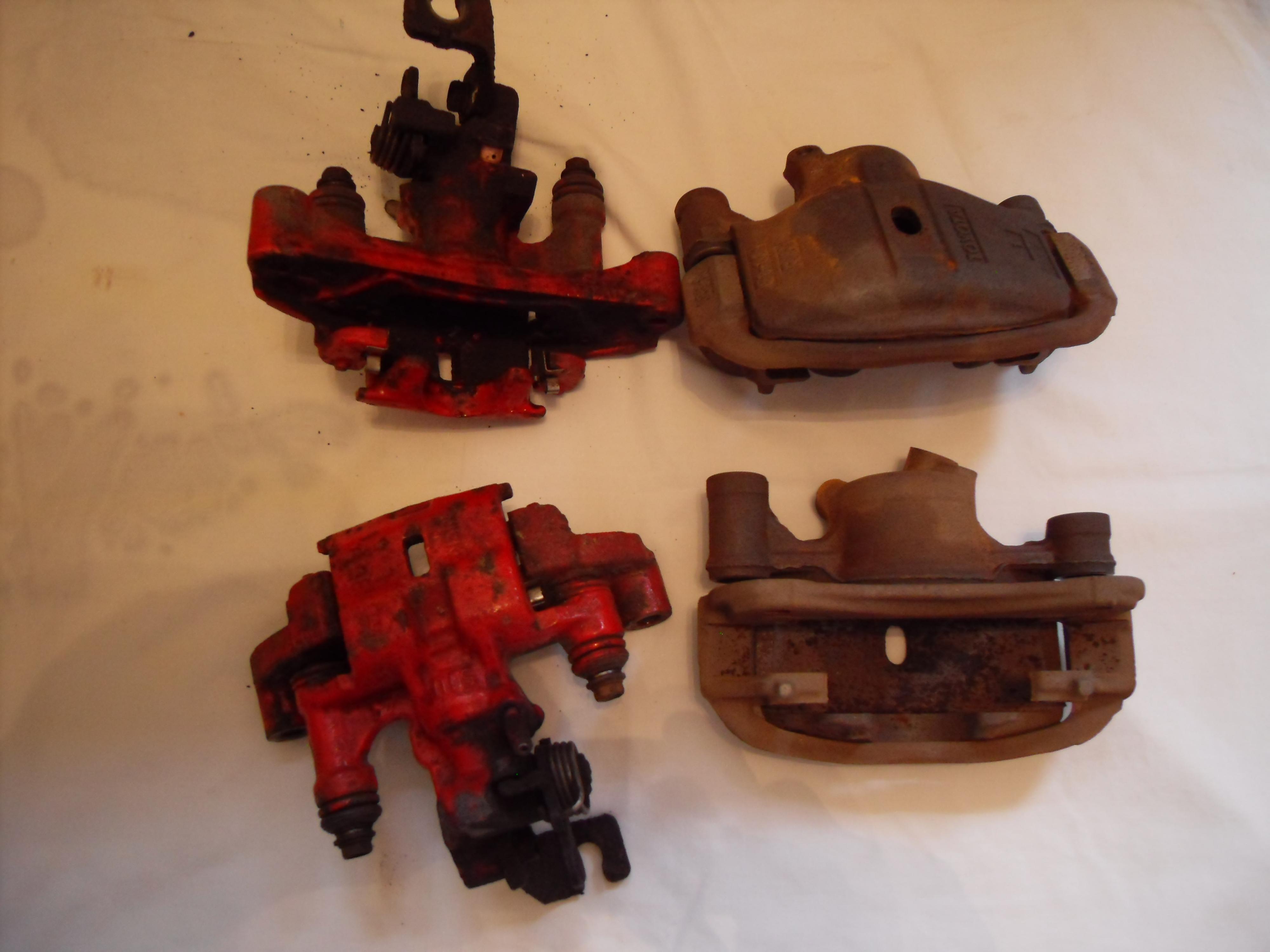

Full Set of Glanza Calipers (waiting to be rebuilt)

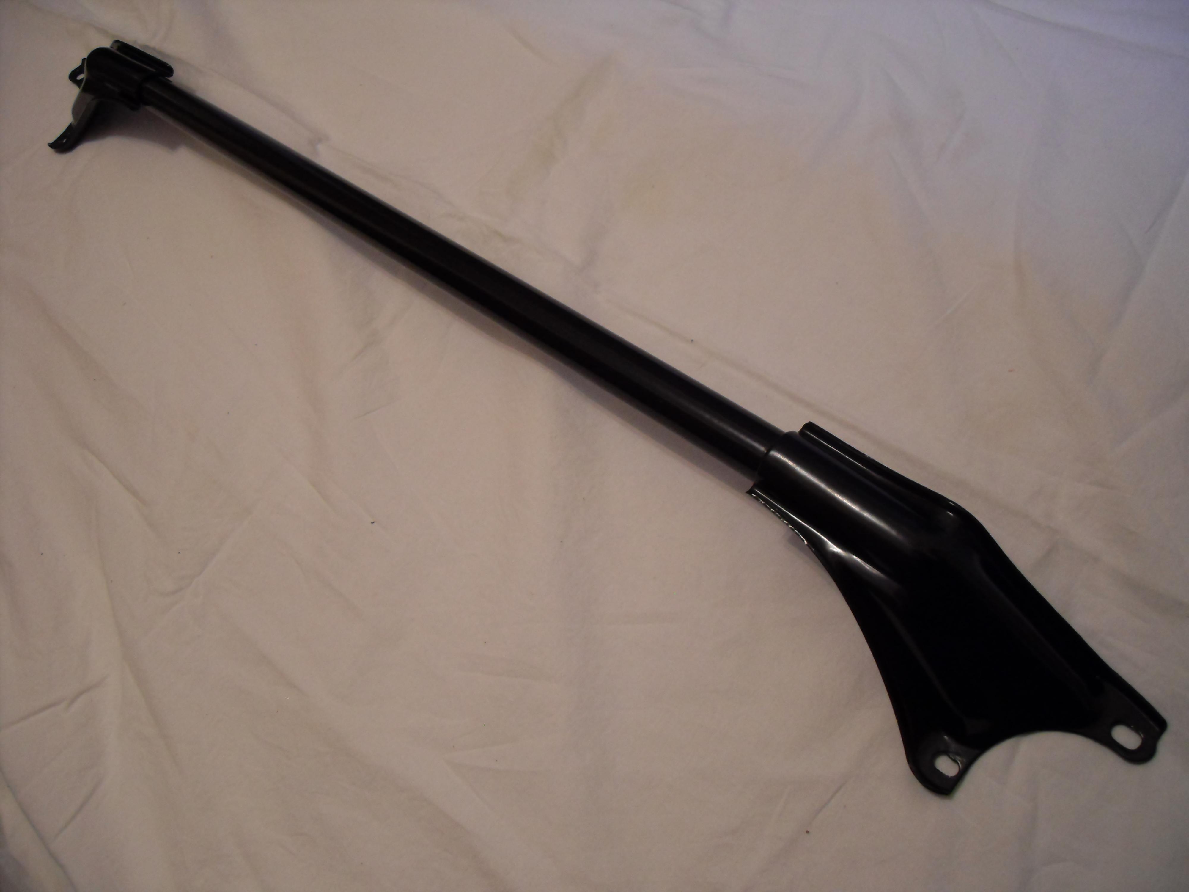

Standard Front Strut Brace (just back from the powder coaters)

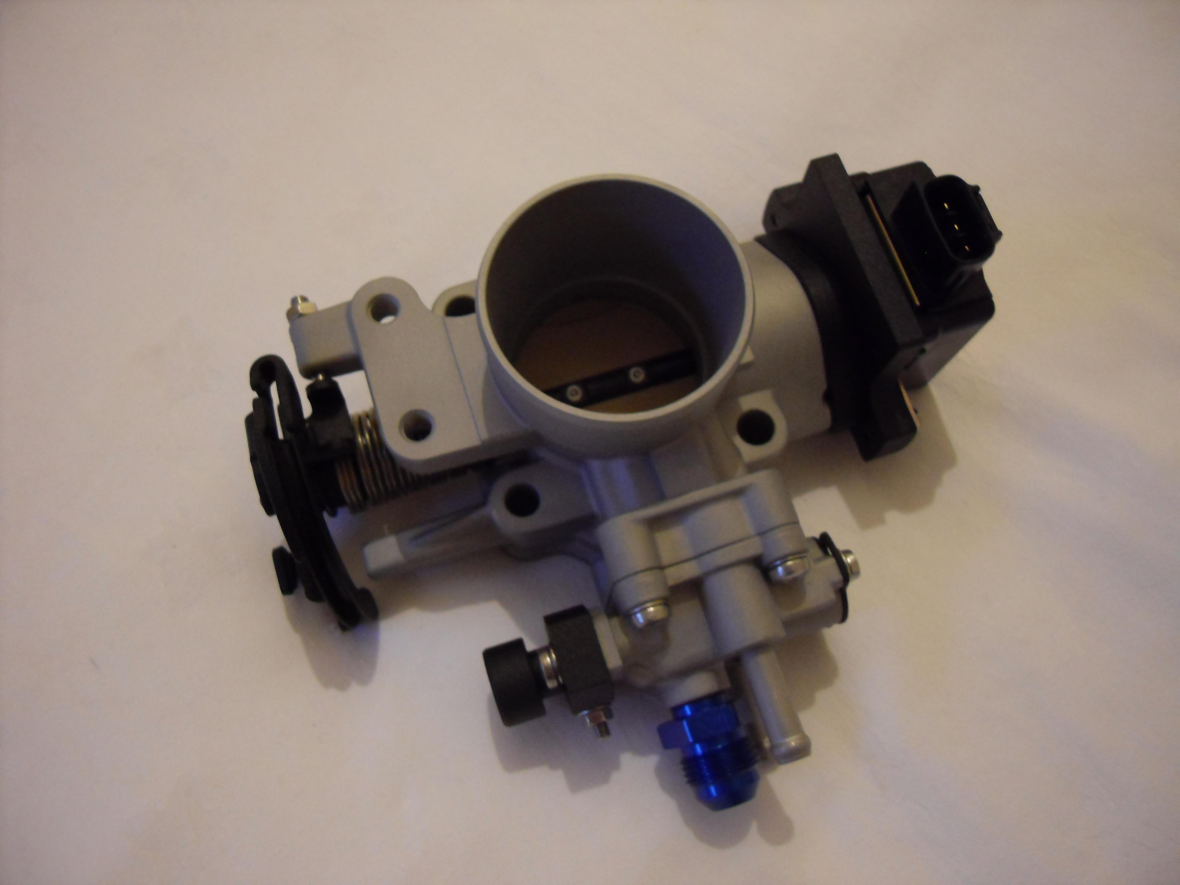

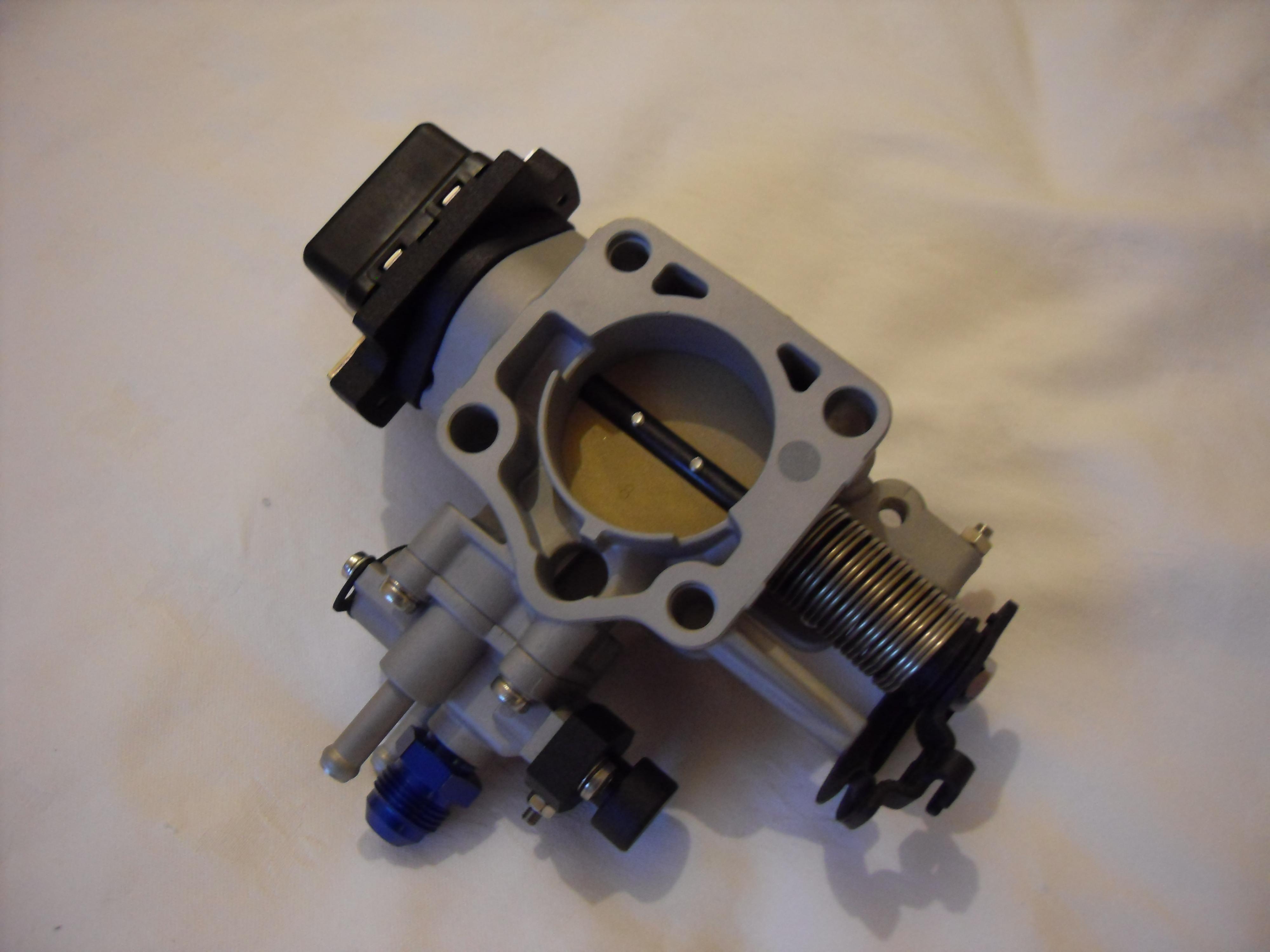

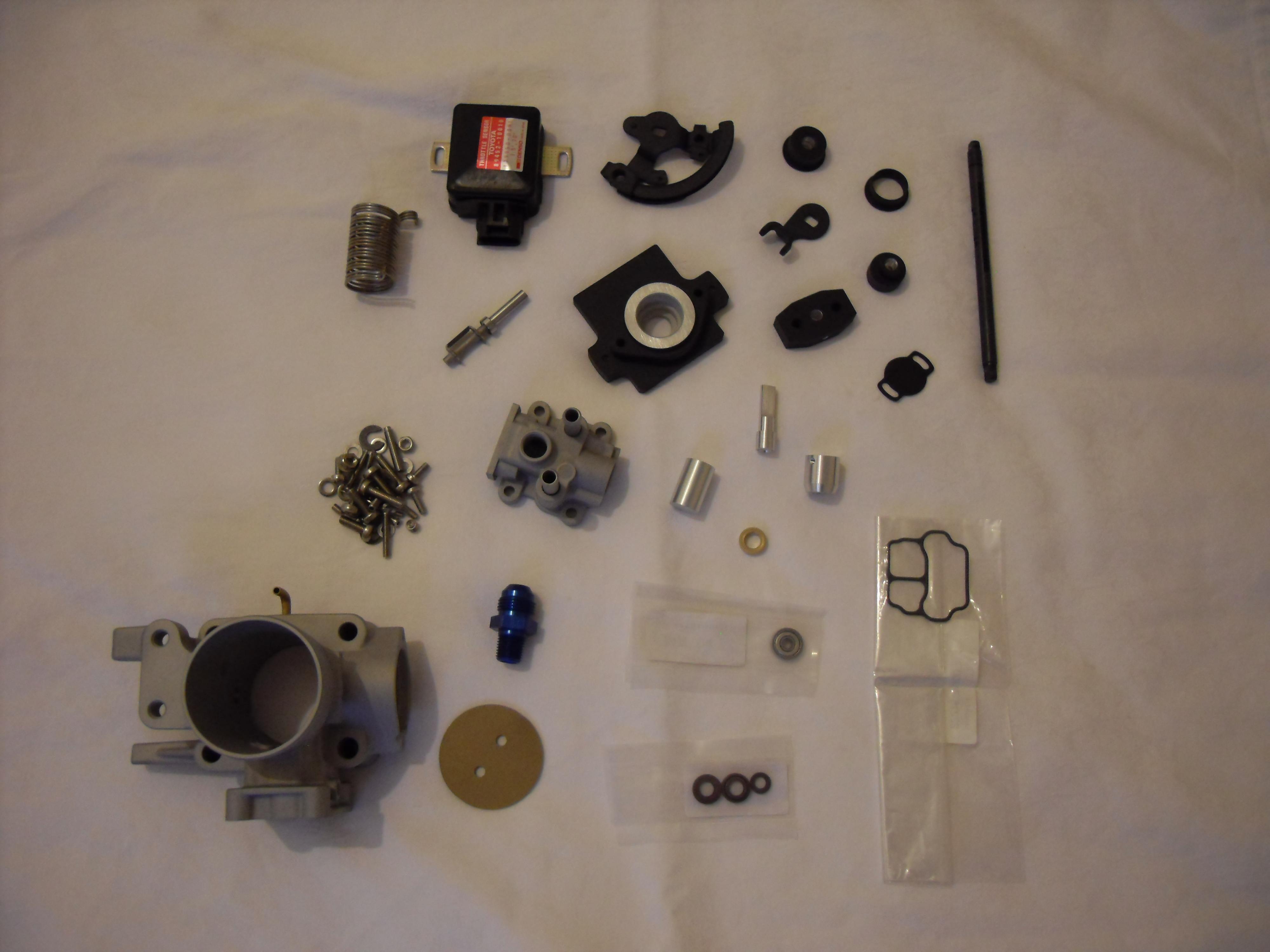

Rebuilt Carina E 50mm Throttle Body (showing the custom diy TPS adaptor with a new TPS and the custom diy idle adjustment valve)
SDC12021.thumb.JPG.0c3e72ecedc031632bbcb865682fc9cf.JPGSDC12023.thumb.JPG.683f672542444809d91c3217541d9d4a.JPGSDC12027.thumb.JPG.33e11136c14b0701e153e1160291d4e3.JPG

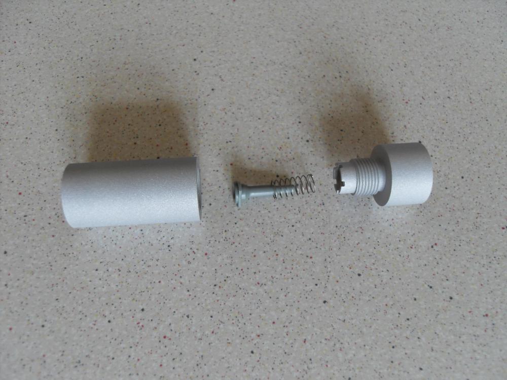

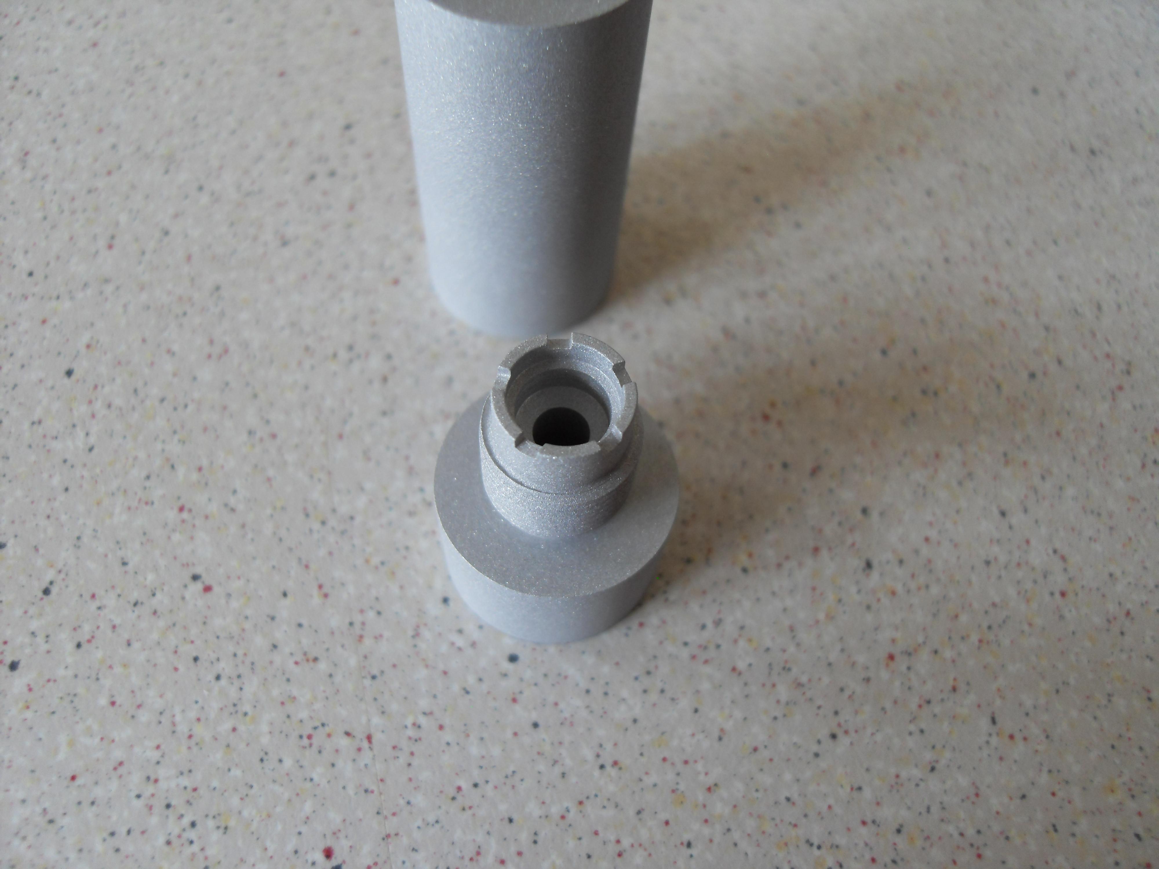

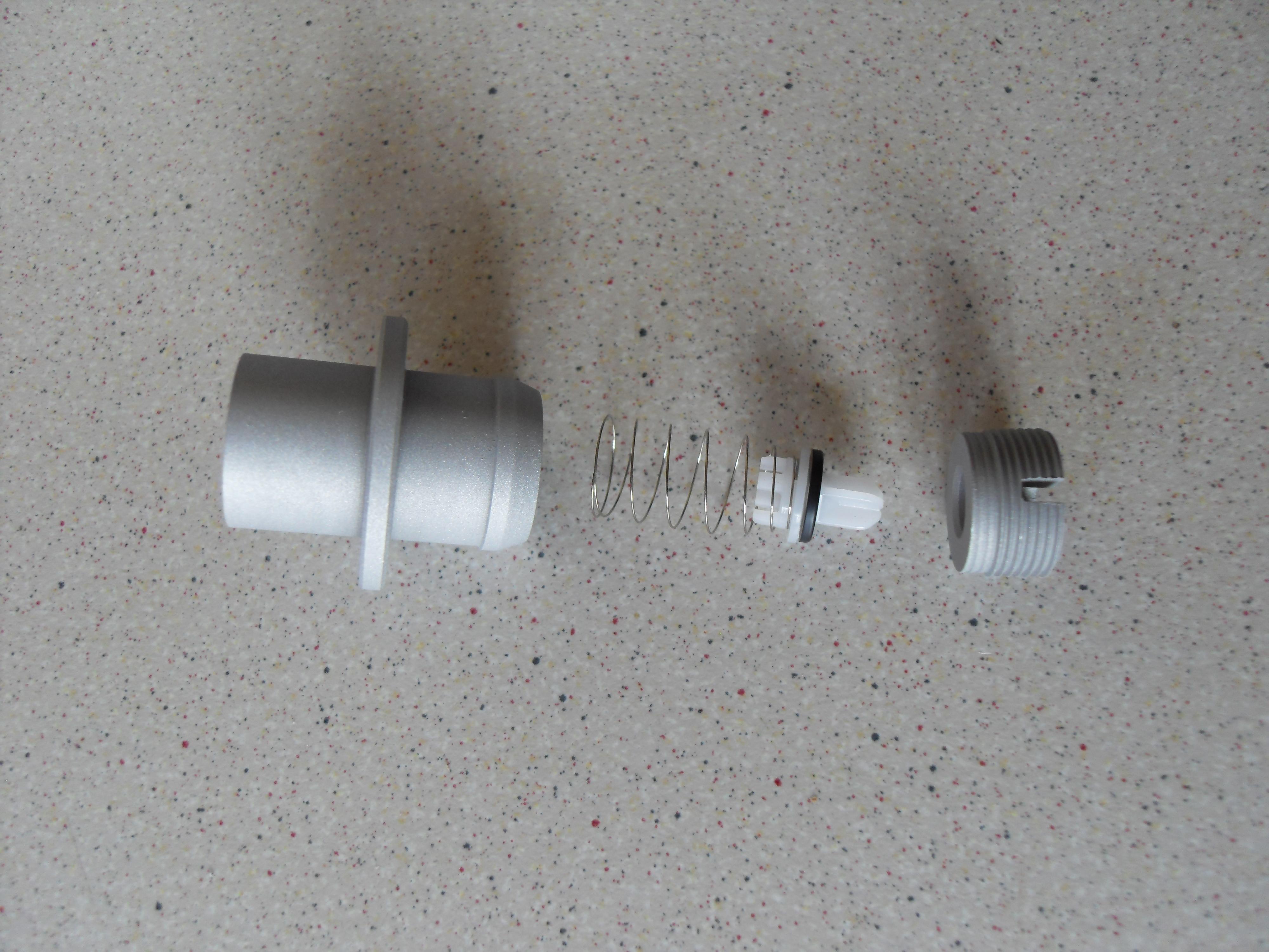

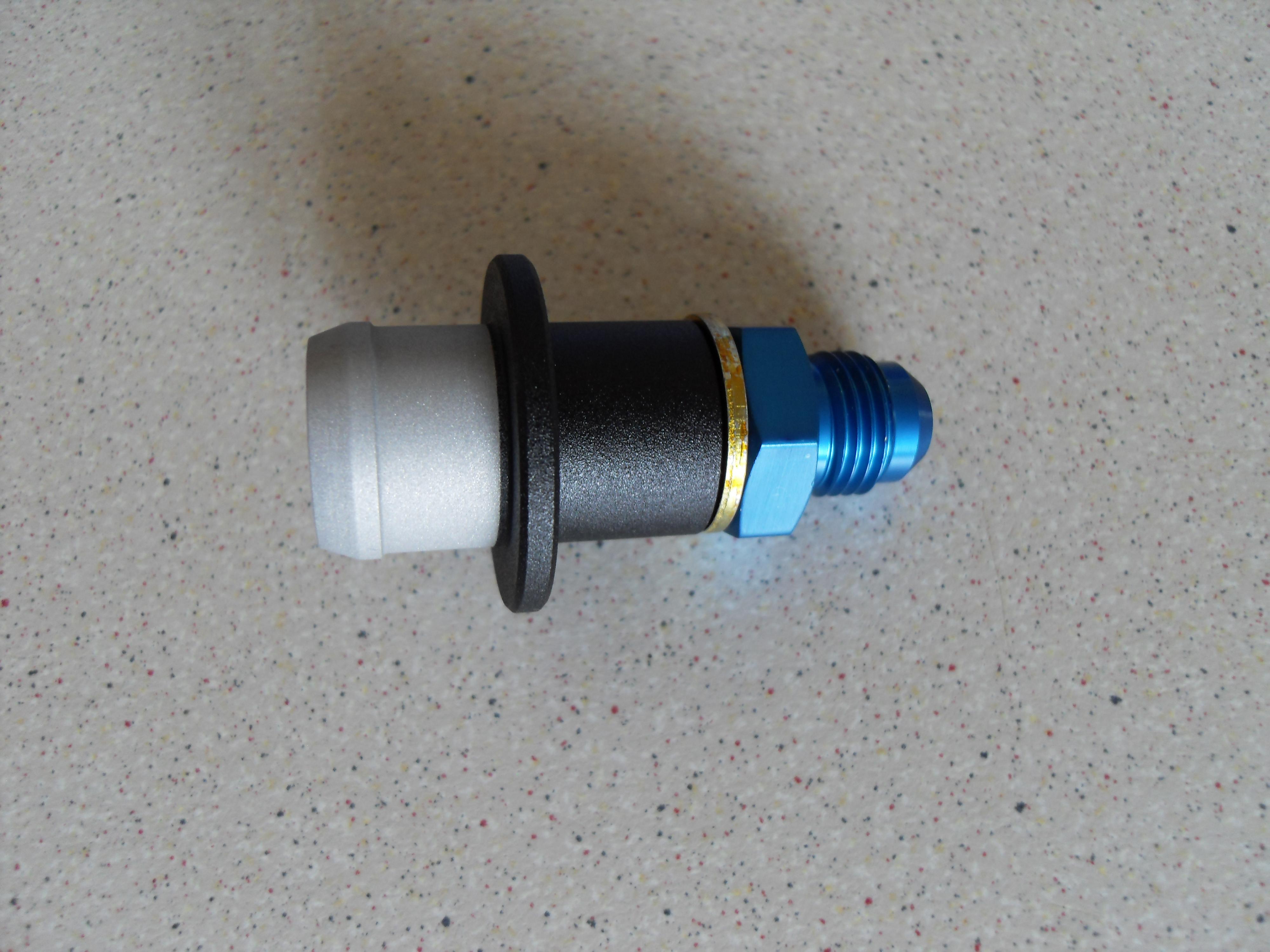

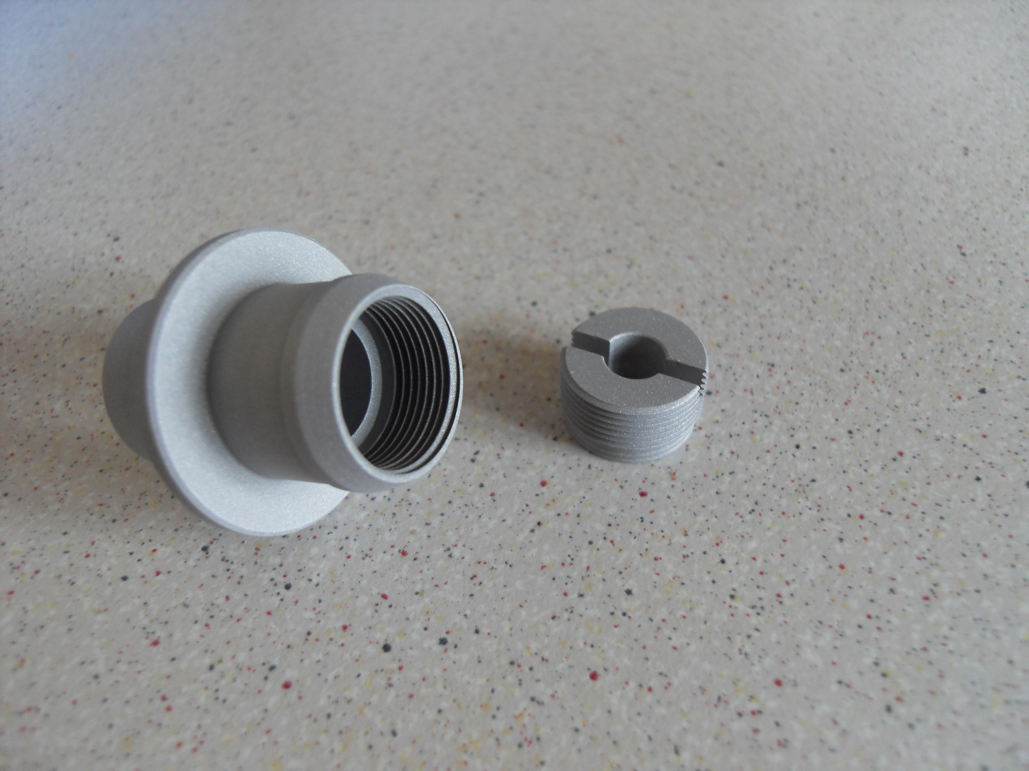

Custom DIY Inline Threaded PCV Valve
SDC12071.thumb.JPG.312a1588002e571e907028454b47fd27.JPGSDC12070.thumb.JPG.cf2d978255c8b4beb2491b11630f1c0f.JPGSDC12082.thumb.JPG.12dfb4c944e8e38c1b9bed7a98928efc.JPG

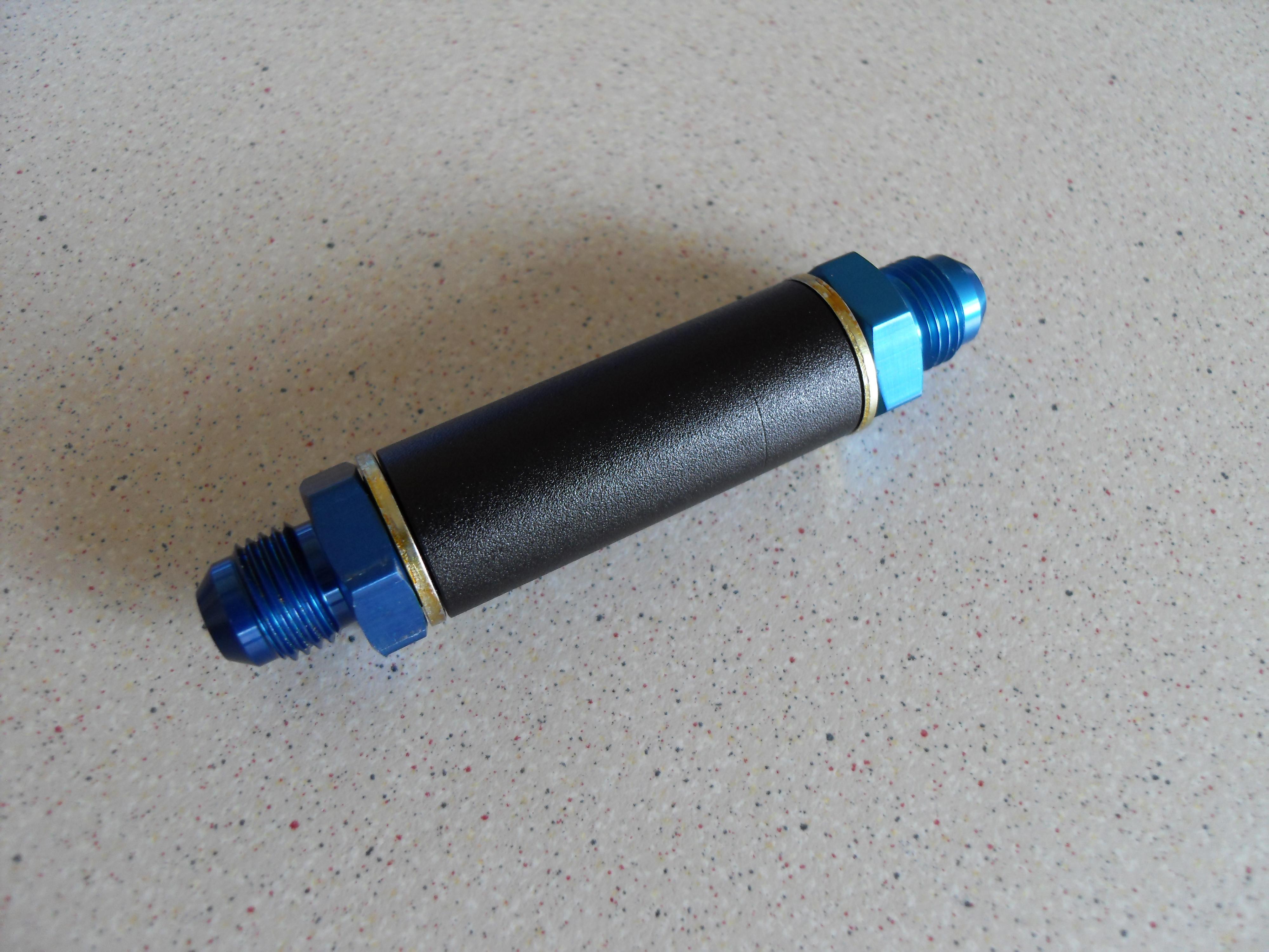

Custom DIY Threaded Brake Servo Non Return Valve

I really have no idea what colour to paint the wheels or the calipers so any suggestions are welcome. I was thinking black wheels with orange calipers?
