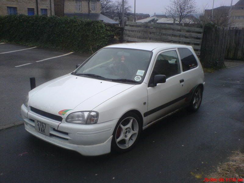

Idrees Posted December 21, 2006 Author Posted December 21, 2006 Thanks lads, in fact Raffi, your car was the first i saw with the Reflet clusters!! Quote
Blue Icarian Wings Posted December 21, 2006 Posted December 21, 2006 Looks good, daft question arn't the bulbs the same? or the pin fitments at least? Try one of the old indicator bulbs to see if it fits (if want I've got my old bulbs lying around if you don't to taken your indicators apart to try a bulb) Quote
Idrees Posted December 21, 2006 Author Posted December 21, 2006 Thanks mate. The bulbs are the same, all you need to do is replace the clear foglight bulb with a red one and get some amber indicator bulbs. The screw holes which wasnt needed was heated and flattened so that the lens could fit on properly. Then I just used a sealent to stick the lens down. Quote
Sparky Posted December 24, 2006 Posted December 24, 2006 Loving the picture mate you are one young talented individual.... and those skirts look awesome!!!!Liking the reflets....gona have to get me some of those ;) keep up the good work Quote
Idrees Posted December 24, 2006 Author Posted December 24, 2006 Thanks Sparky, still need to take some better pics of those reflets though..Yeah grab urself some, well worth it and piss easy to fit!! Quote

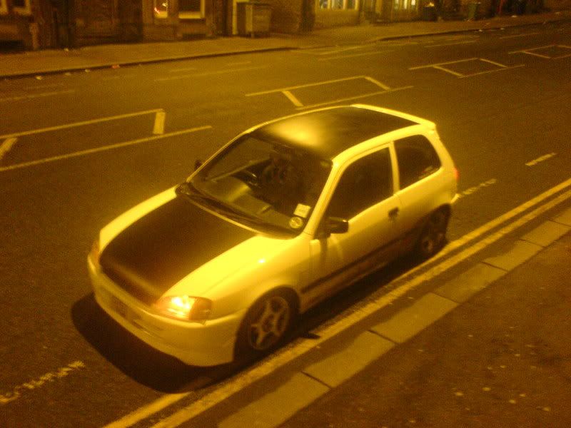

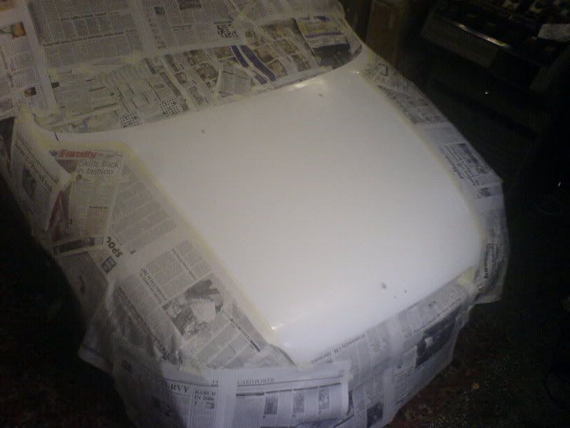

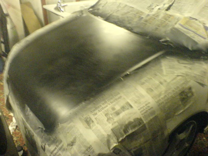

Idrees Posted December 27, 2006 Author Posted December 27, 2006 Cheers Phil!As some of you may know, i'm the guy who will finish a job when he starts it. No but's, it's or BULLSHIT!Well lads - its DONE!!!!!Heres how it all went: Me and my brother decide whether to do the whole bonnet black, or just in the centre from where the curved grooves are. I suggest we try out the middle section, if rubbish then spray it all!Firstly get a last snap before the big mod! Then I get it all masked up, while he sands down the bonnet. This seriously is the first time he helped me mod the car properly!Then i get a nice few coats of primer, using wet and dry paper on each layer for a smoooth finish, while he goes to the paint shop for the equipment:Left that do dry for around an hour and attacked with 2 coats of Satin Black!Did the final coats, then just remember about the lacquer business. Shops were closed by now, so the lacquer will be applied tomorrow. Will also get better pics tomorrow, need to wash the rest of the car too!Well thats the big mod done for now, comments WANTED whether to do the whole bonnet Black or leave it how it is?OOPS...Did i say the big mod was done? Ah i must have meant half of it ;) ;) Always had an undercover plan for the black roof, the thing is i never thought i would do it myself!!!Hopefully i will do a Grey pinstripe between the Black and White to give it that edge! Also going to spray the bumper black around the mesh, so it all fits in nicely with the bonnet's BlackAlso, thinking of doing the top of the bootlid and spoiler Black in line with roof...but still deciding.. Quote
Guest JigSaw Posted December 27, 2006 Posted December 27, 2006 i thought you were only going to do the bonnet black lol. Doesnt look to bad at all, will look even better once lacquered and the area around the front is painted. i think doing the full bonnet would be too much now seeing as you have done the roof aswel. It looks nice like that, maybe do the spoiler to finish it off ;) Quote
Idrees Posted December 27, 2006 Author Posted December 27, 2006 Thanks for comments! I think i'll leave the bonnet like that then, just get it lacquered now...and spray the top of the spoiler and bootlid tomorrow maybe.Probs will leave the mirrors and handles Black now, and might even spray the door strips black.. Quote
Nanglebadger Posted December 27, 2006 Posted December 27, 2006 I really like it mate awesome job!!!! Some laquer and hey-presto she'll look even better!!!!!!!! Like the sounds of your spoiler and bootlid plans too dude, sounds cool!! I say leave the bonnet as she is, as Jigsaw says its spot-on with the roof!!! Looks fab!Phil. Quote
Sparky Posted December 27, 2006 Posted December 27, 2006 hhhhmmmm ;) Not too sure on the bonnet to be honest....maybe look better if it was all black, but maybe itl just grow on me The roof looks wiked and you should do the tailgate and spoiler now.... if you do the tailgate just do the centre like you did with the bonnet ;) Good job buddy Quote
Idrees Posted December 27, 2006 Author Posted December 27, 2006 Thanks ;)Lacquer is a bastard! Gave it a first coat just now and its a right cunt to use. Leaving it to dry for 30mins then will go and finish it off.Ill hopefully be doing the spoiler and the top of the bootlid tomorrow. Also plan to do the grille to be in line with the bonnet. Need some ideas for that! ;) Quote
