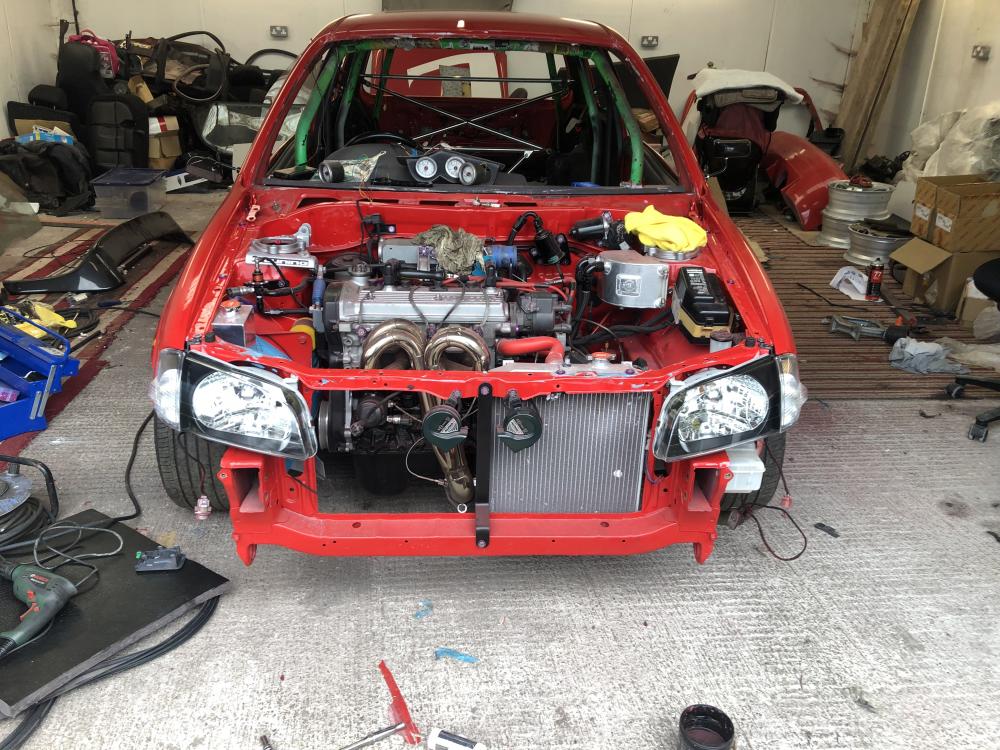

Thanks burty,
Hey Sam thanks for taking the time to read it all, yes I was running a 100ps intake manifold from a 1st gen 4efe (same as a 4efte manifold but without the sensors) and a ported 4efte throttle body was a pain to get the TB to work on the stock ecu badly over fuelling, but that’s how I made the most power, but yes on this current engine I’m running the stock intake for run in purposes so the ecu can read everything properly, then I will be going onto 45mm ITB’s from a 4age blacktop  and aftermarket ecu, I have a hks vpro gold sitting it’s old tech but it’s a good ecu for all the functions I will need.

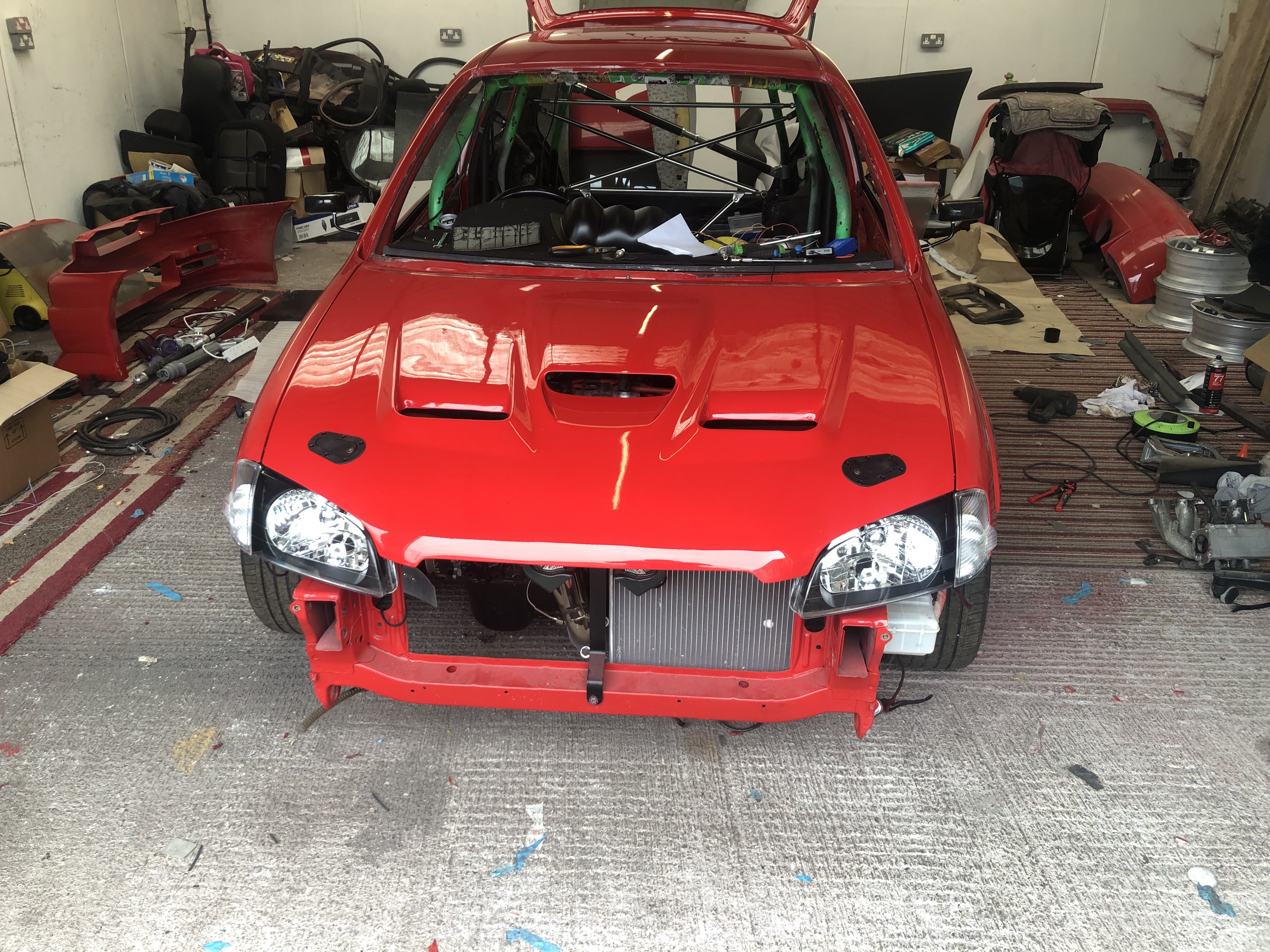

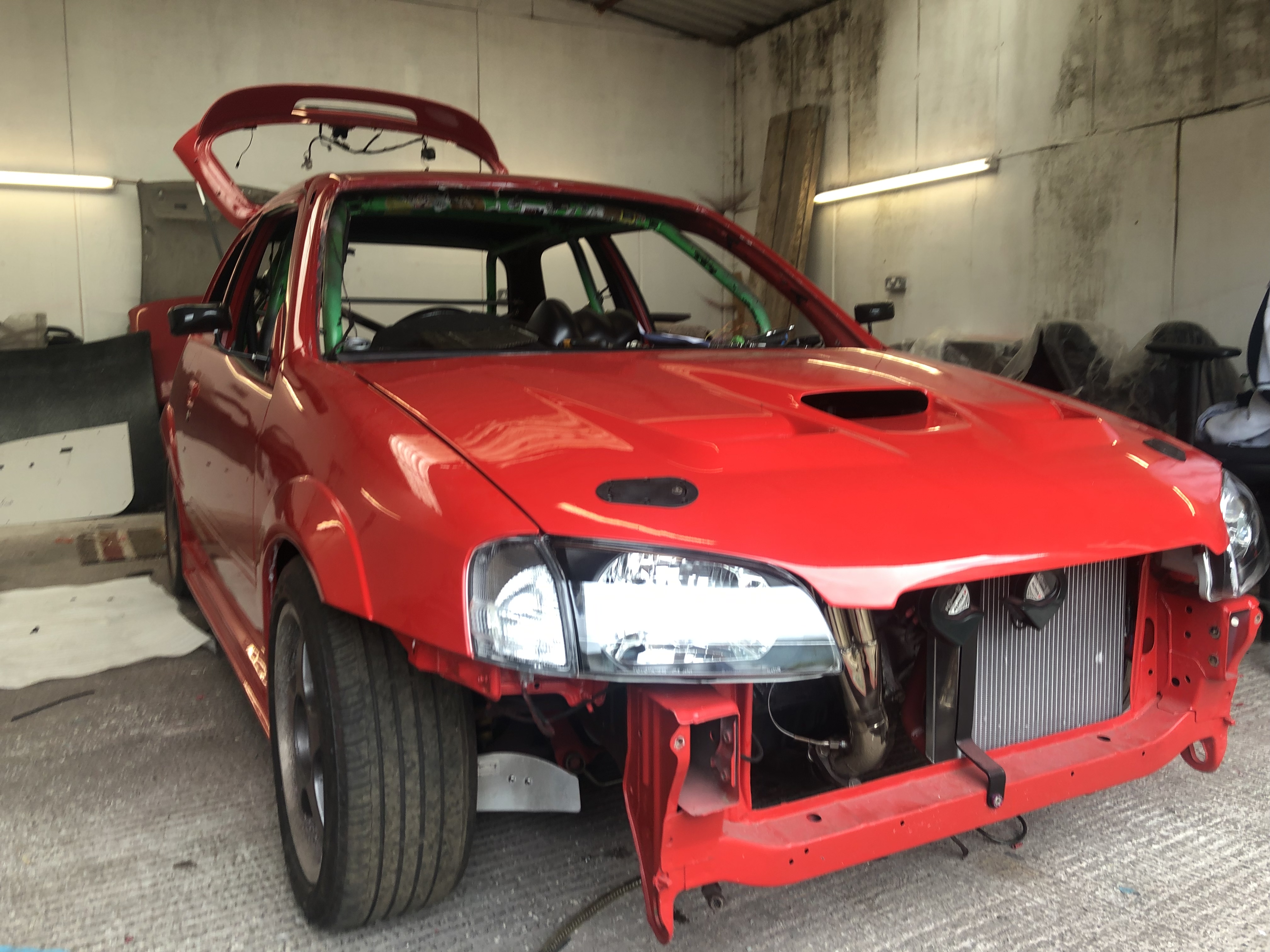

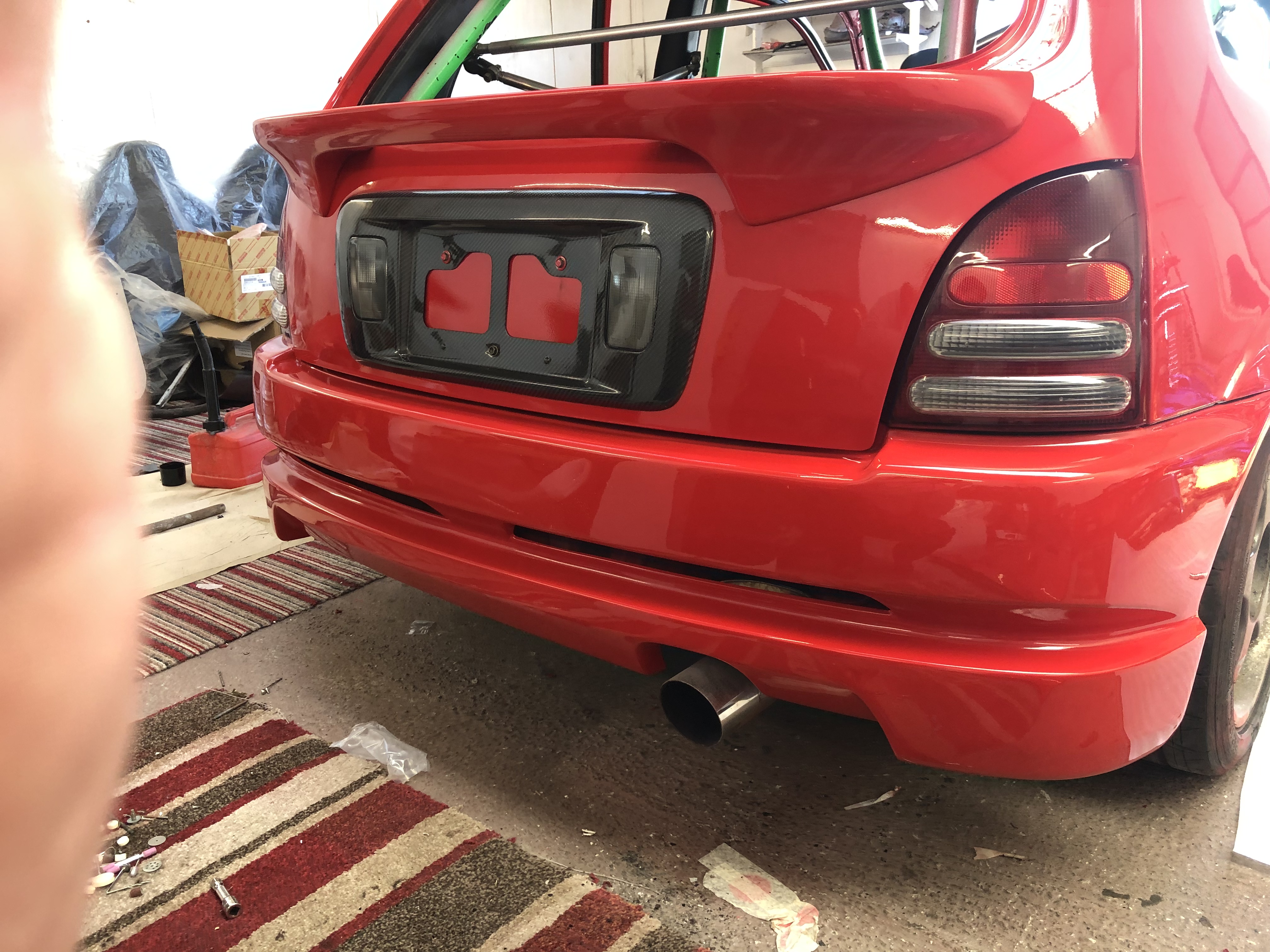

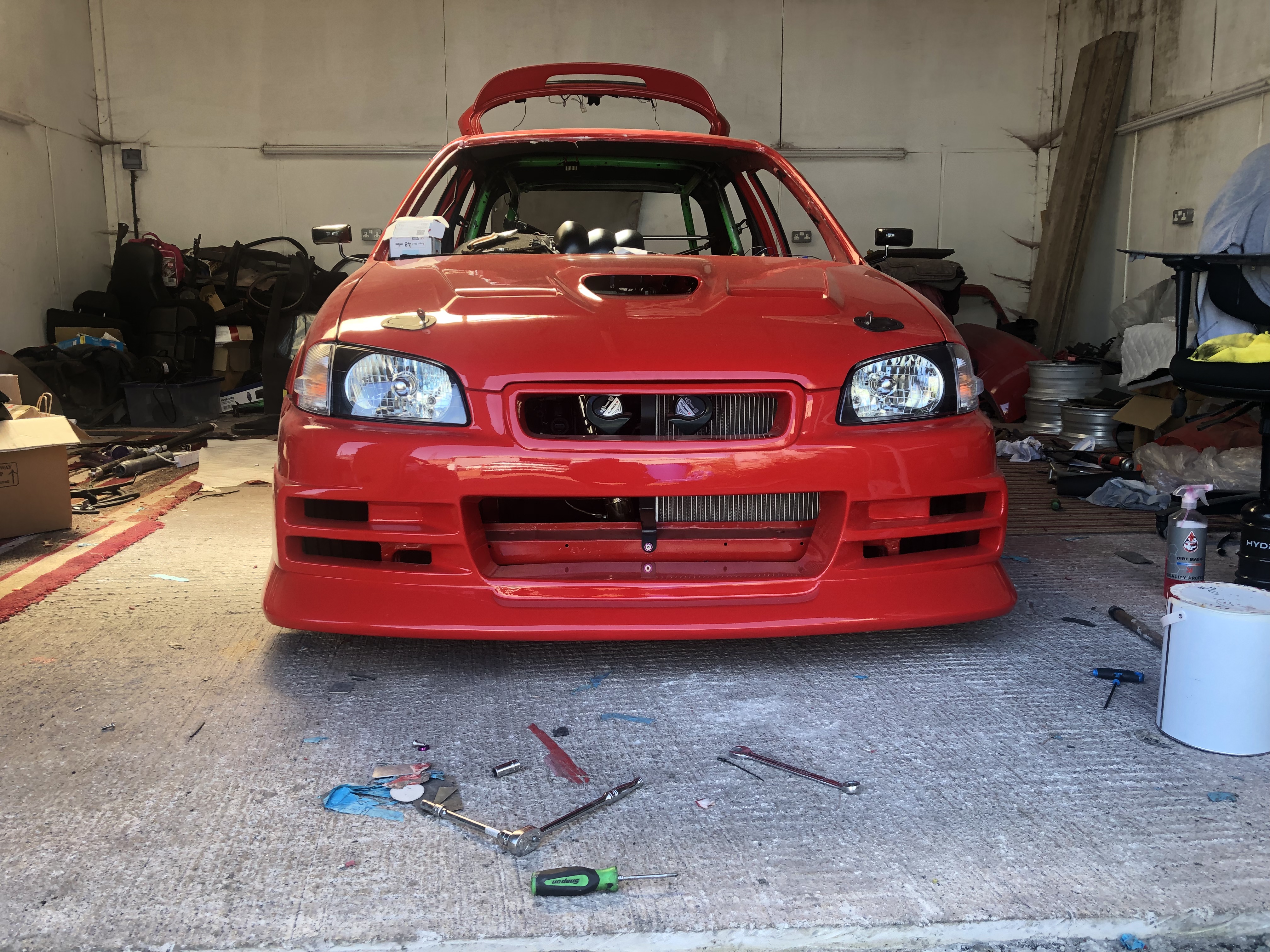

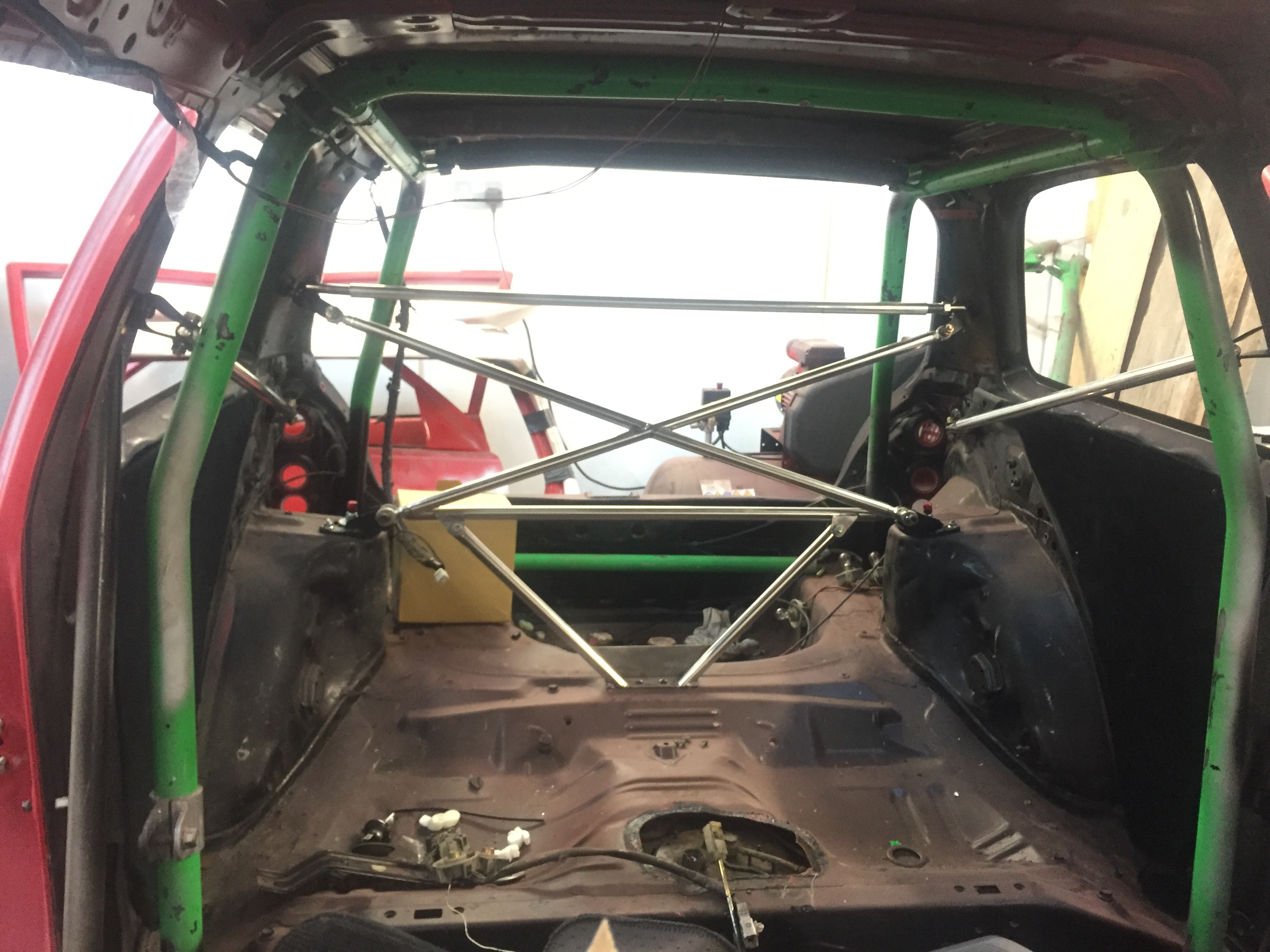

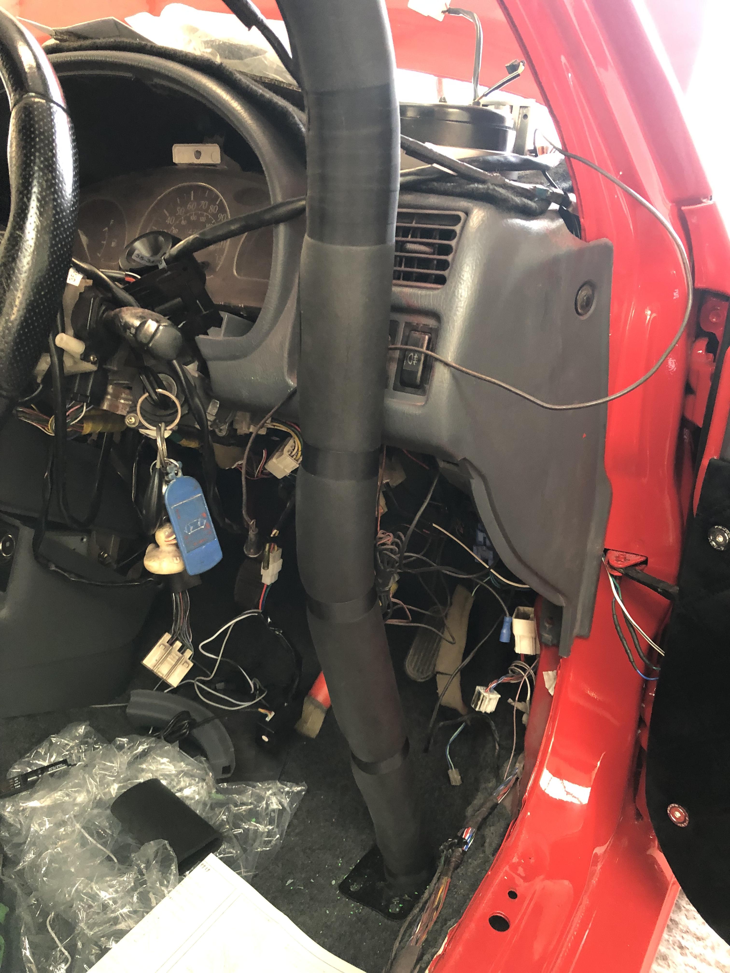

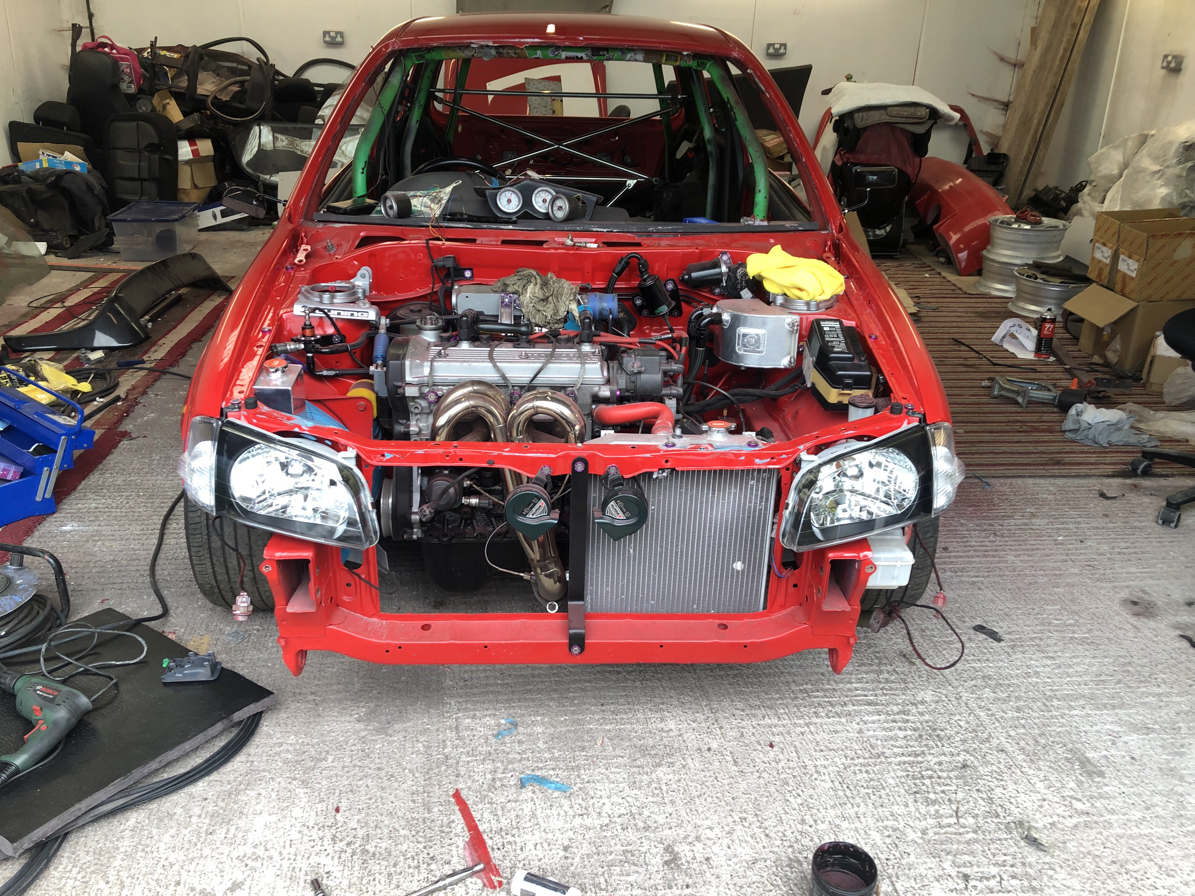

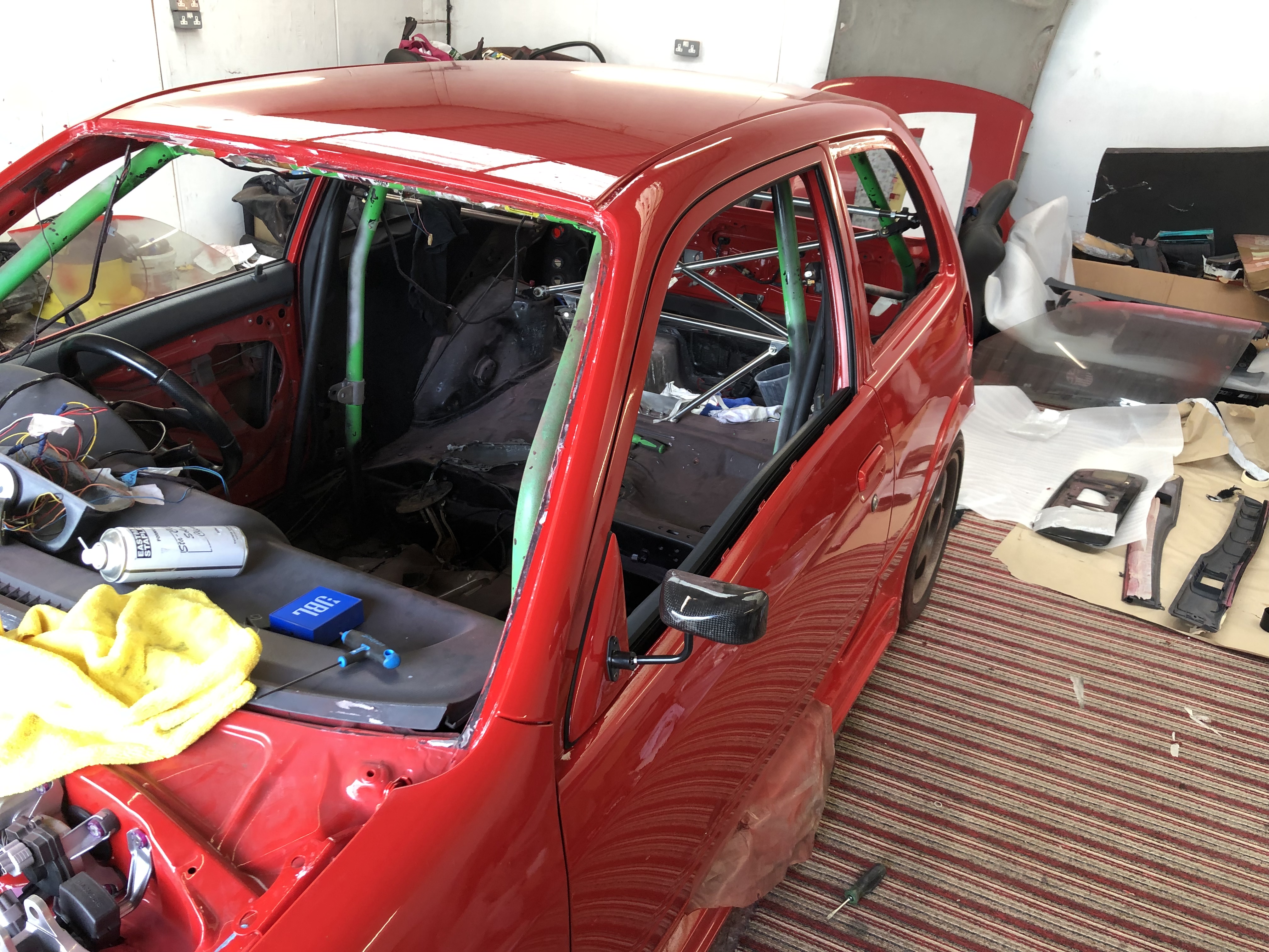

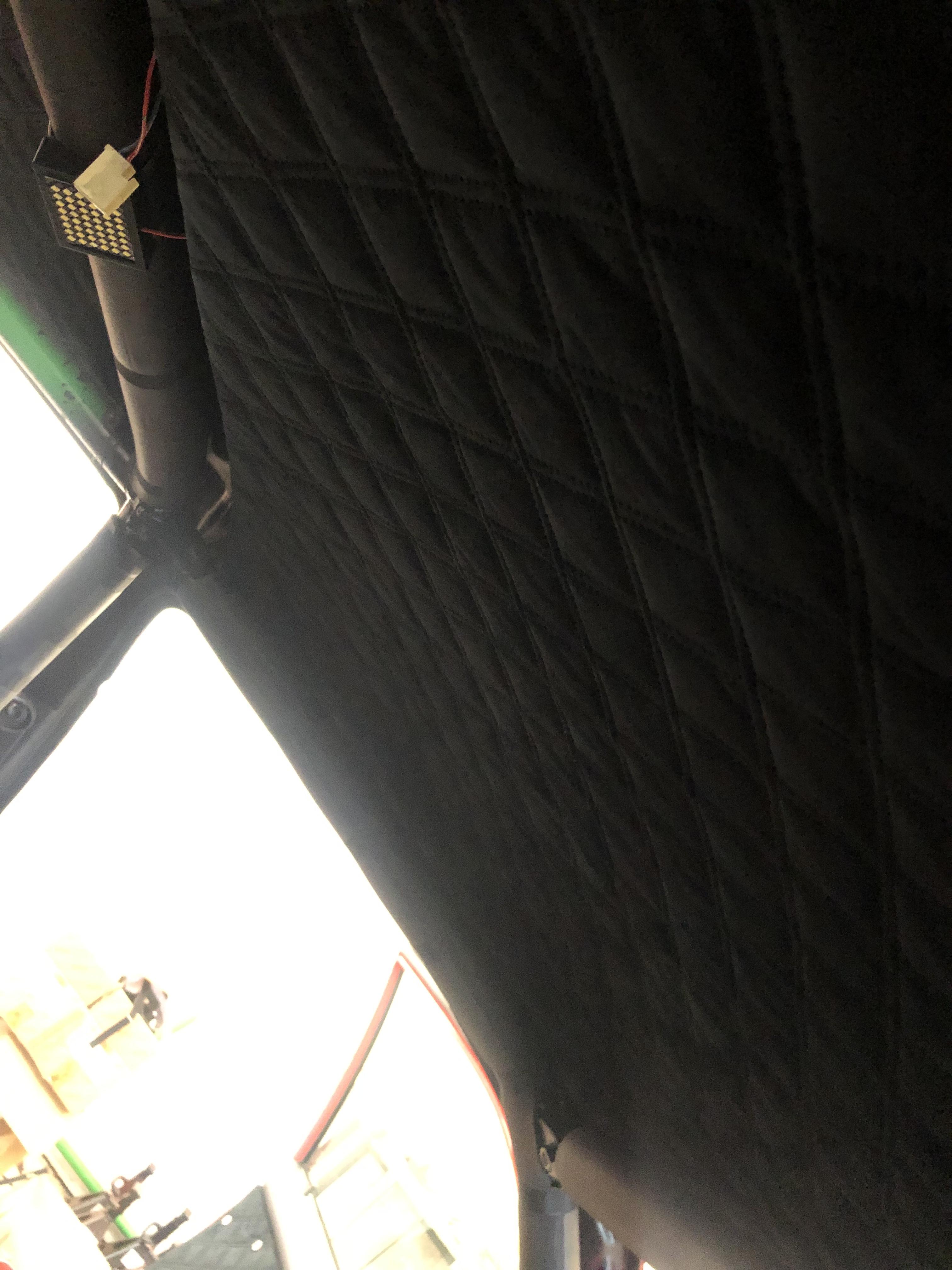

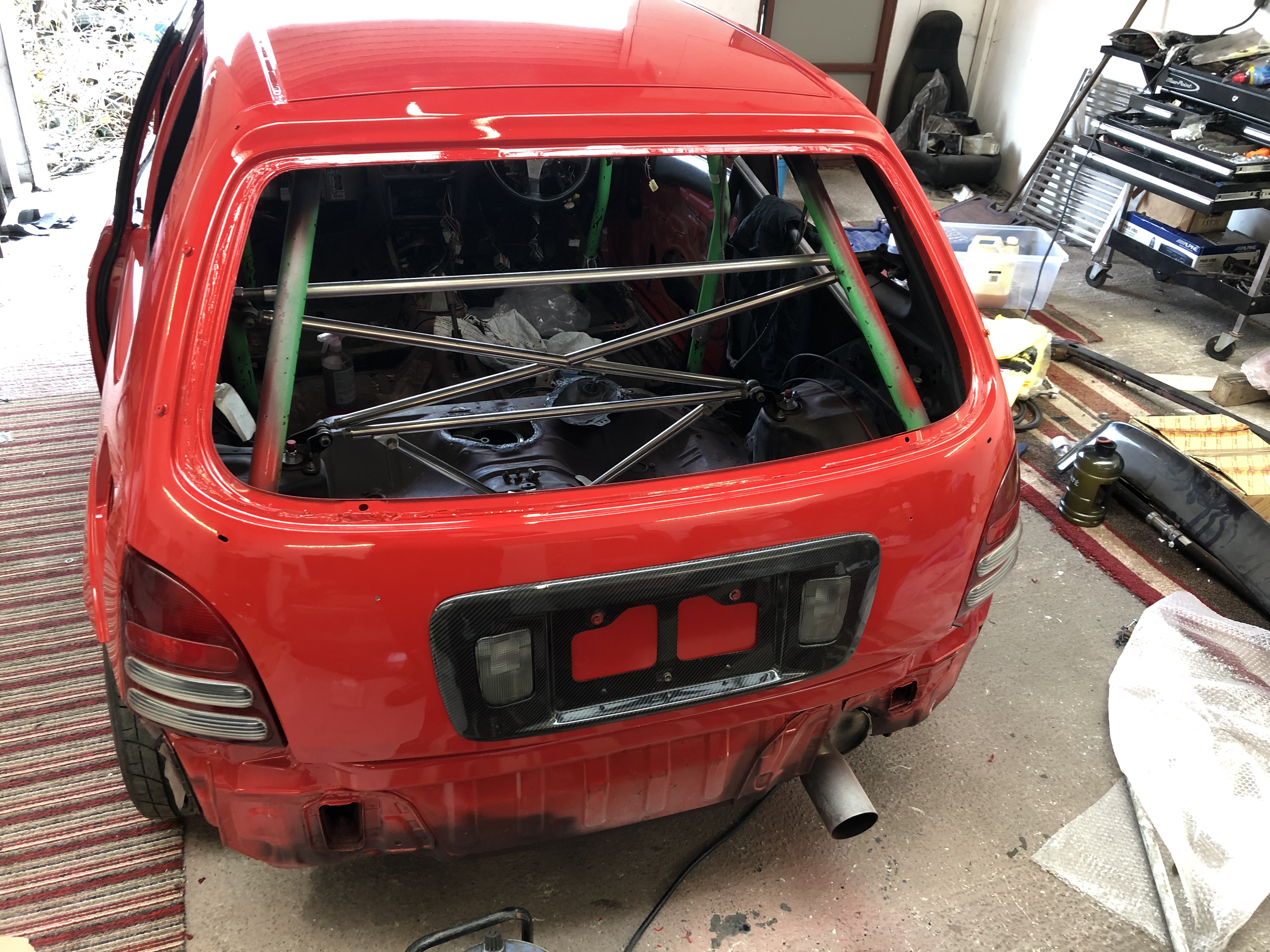

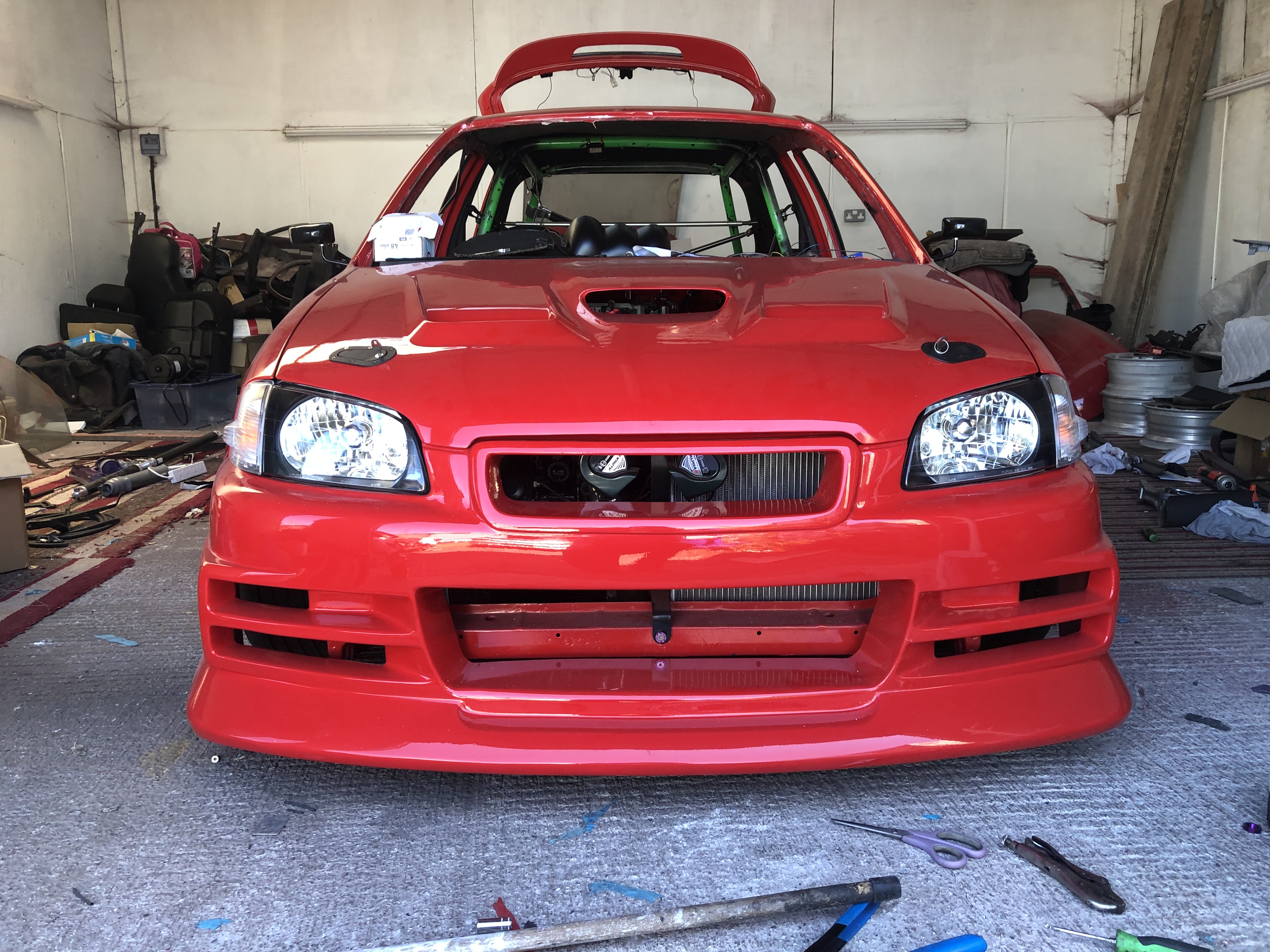

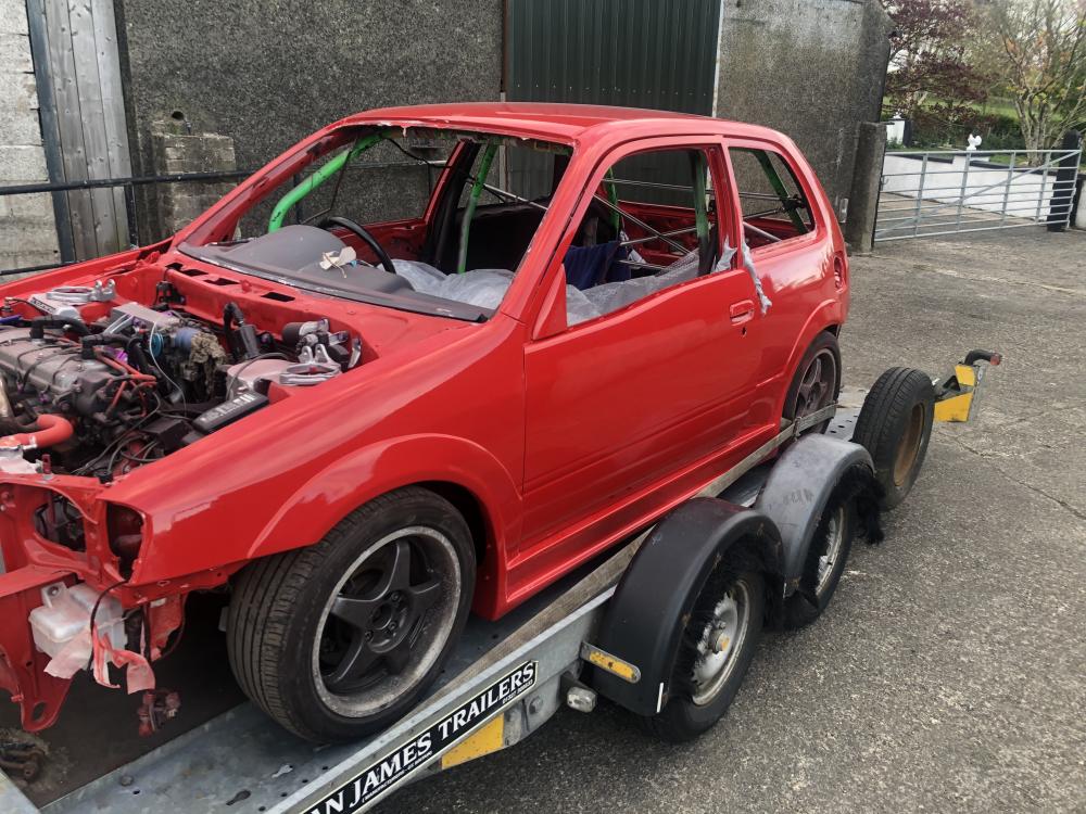

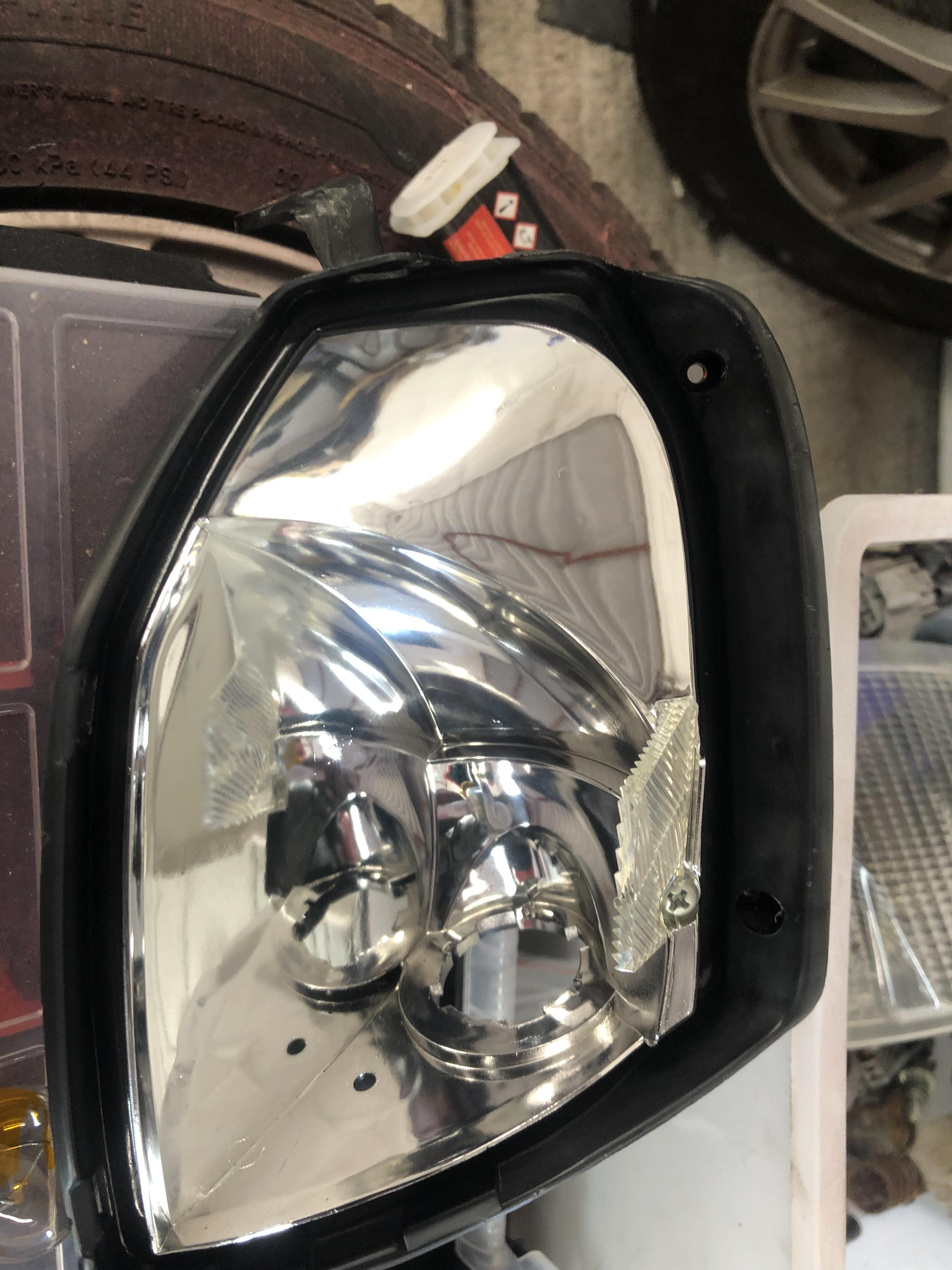

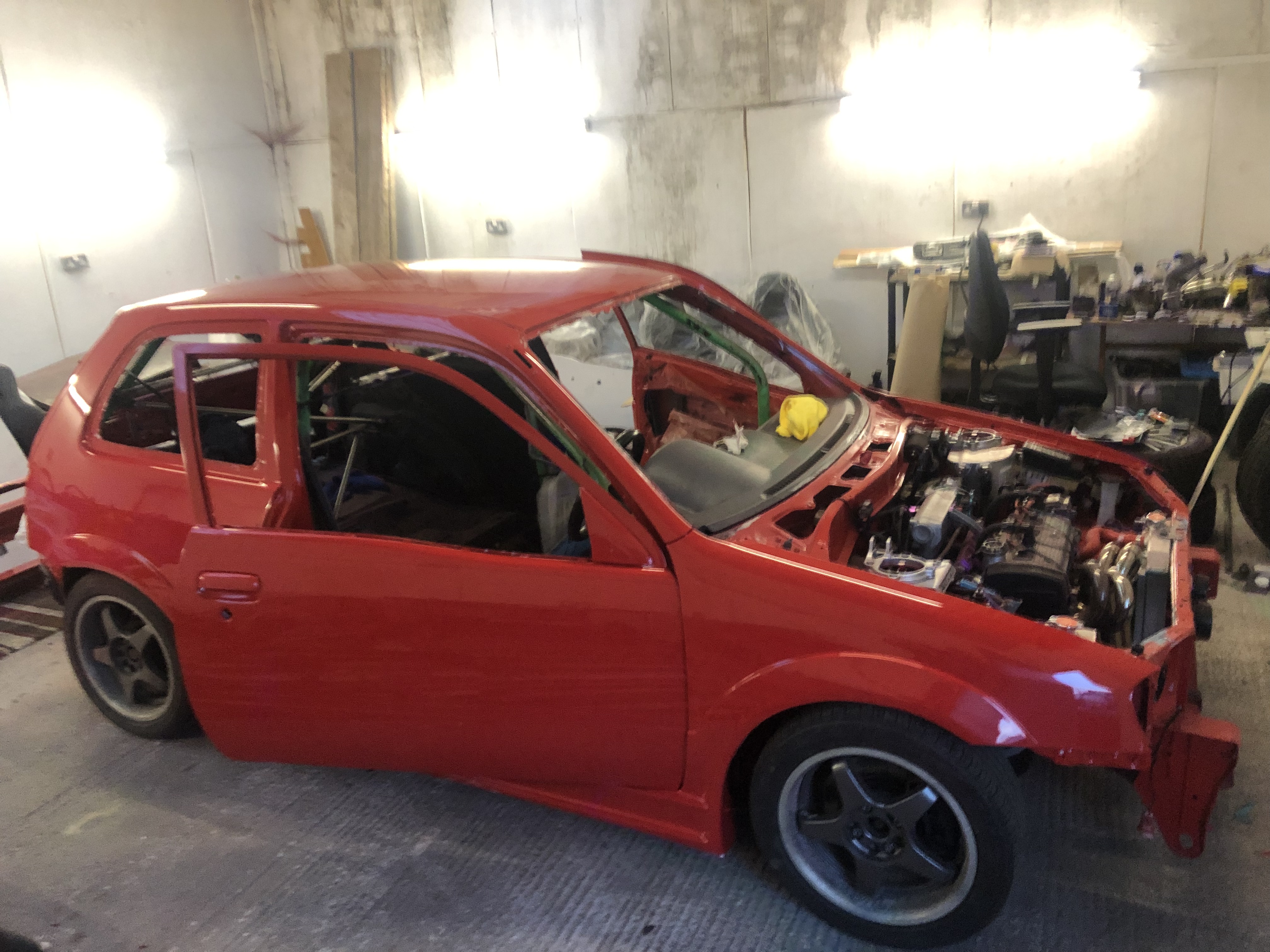

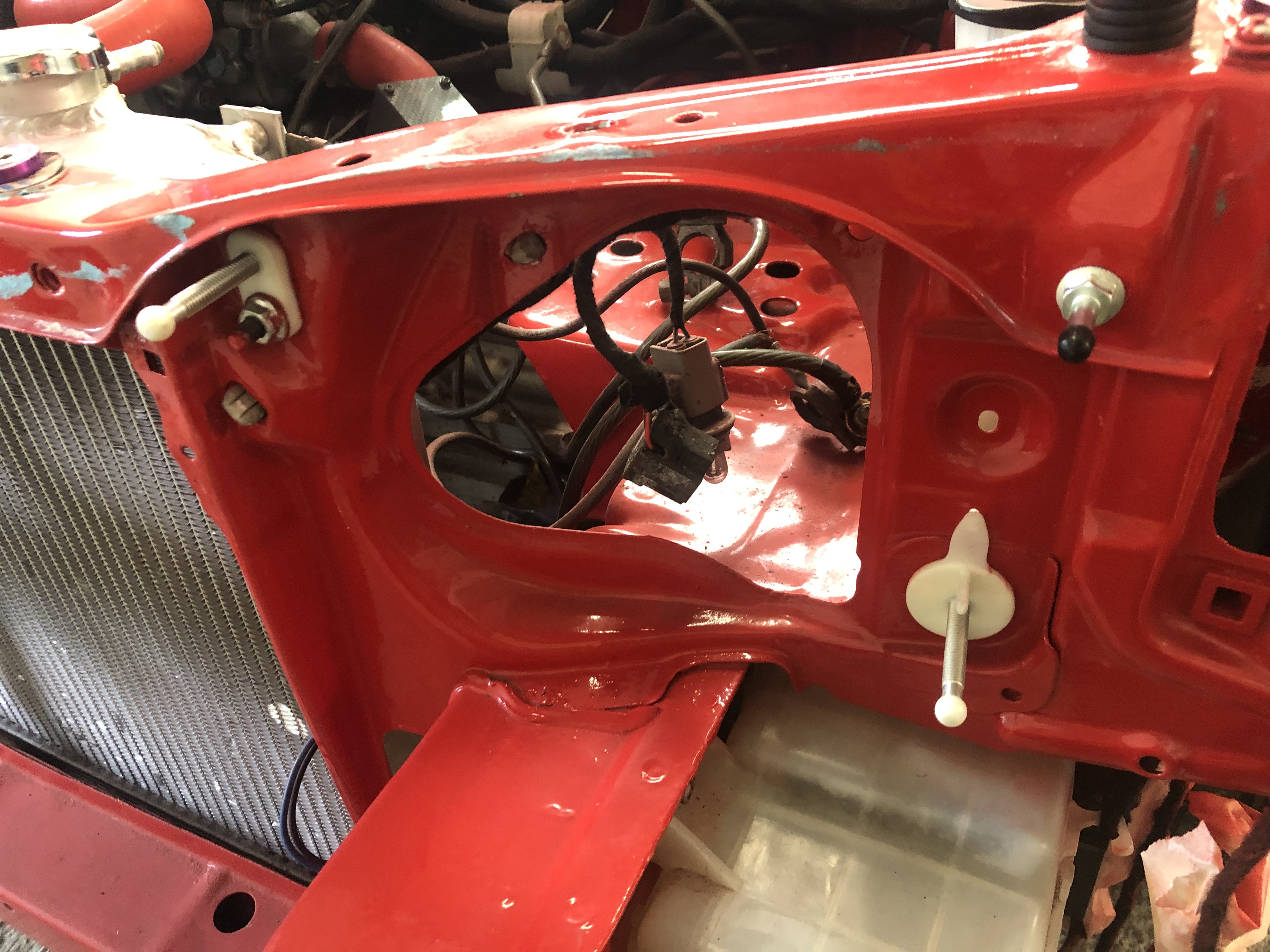

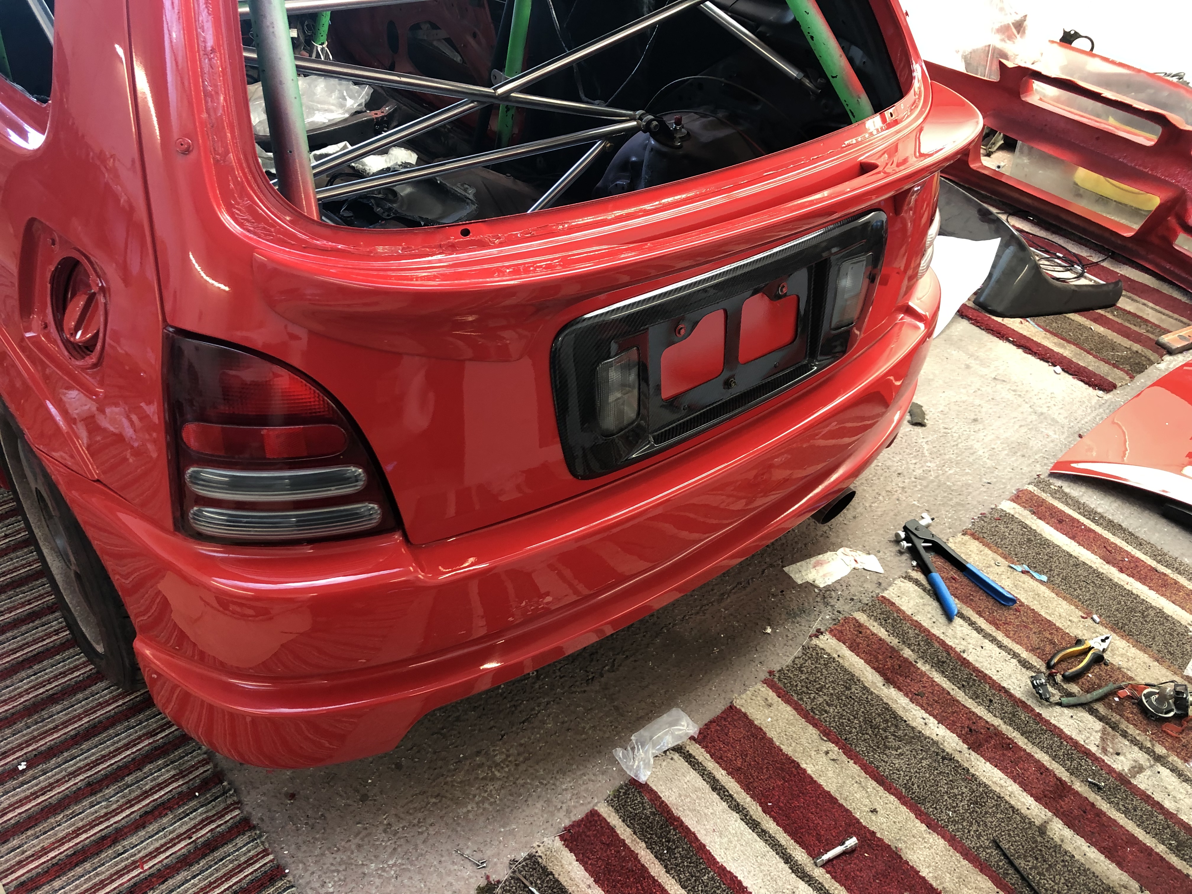

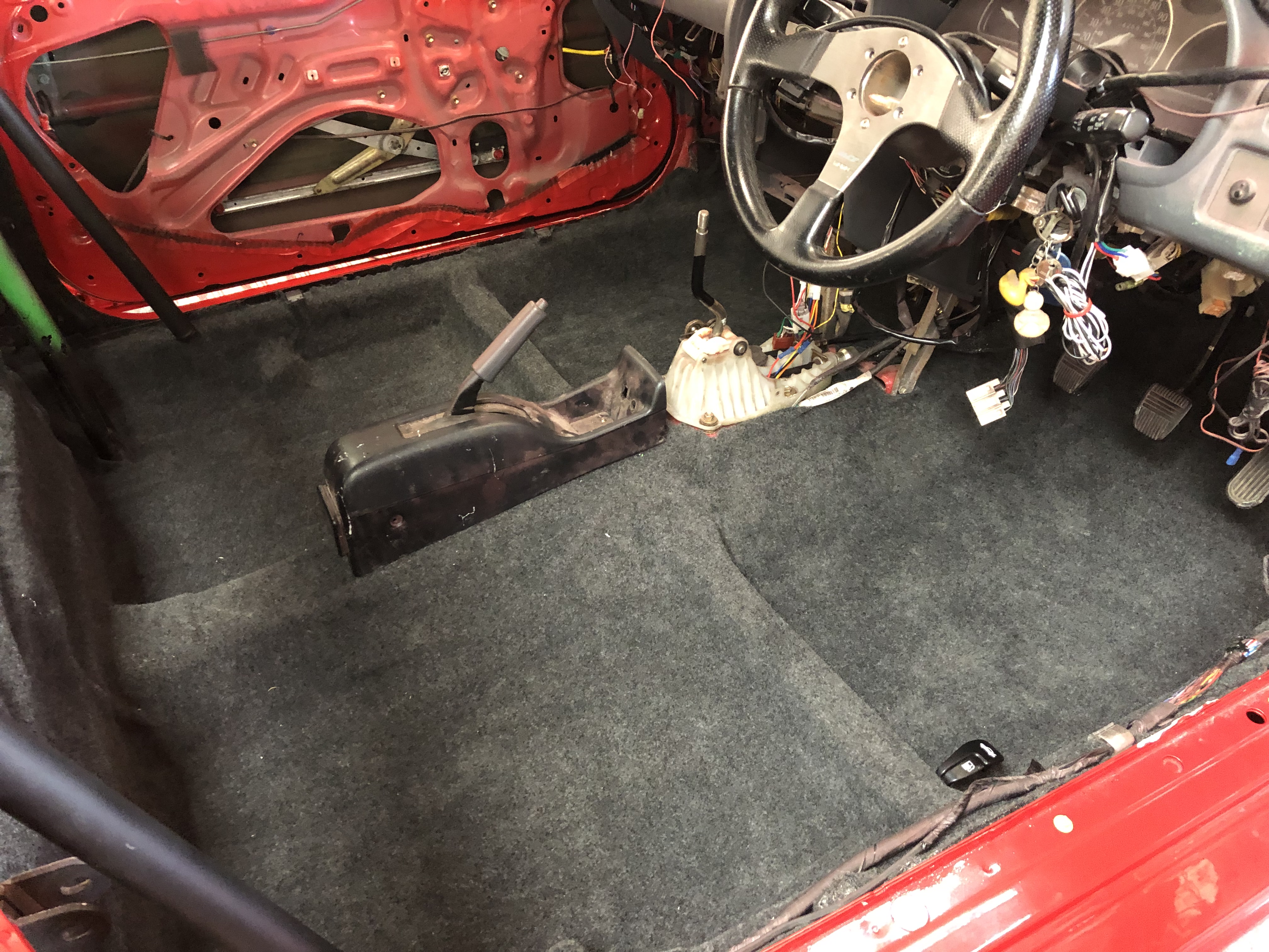

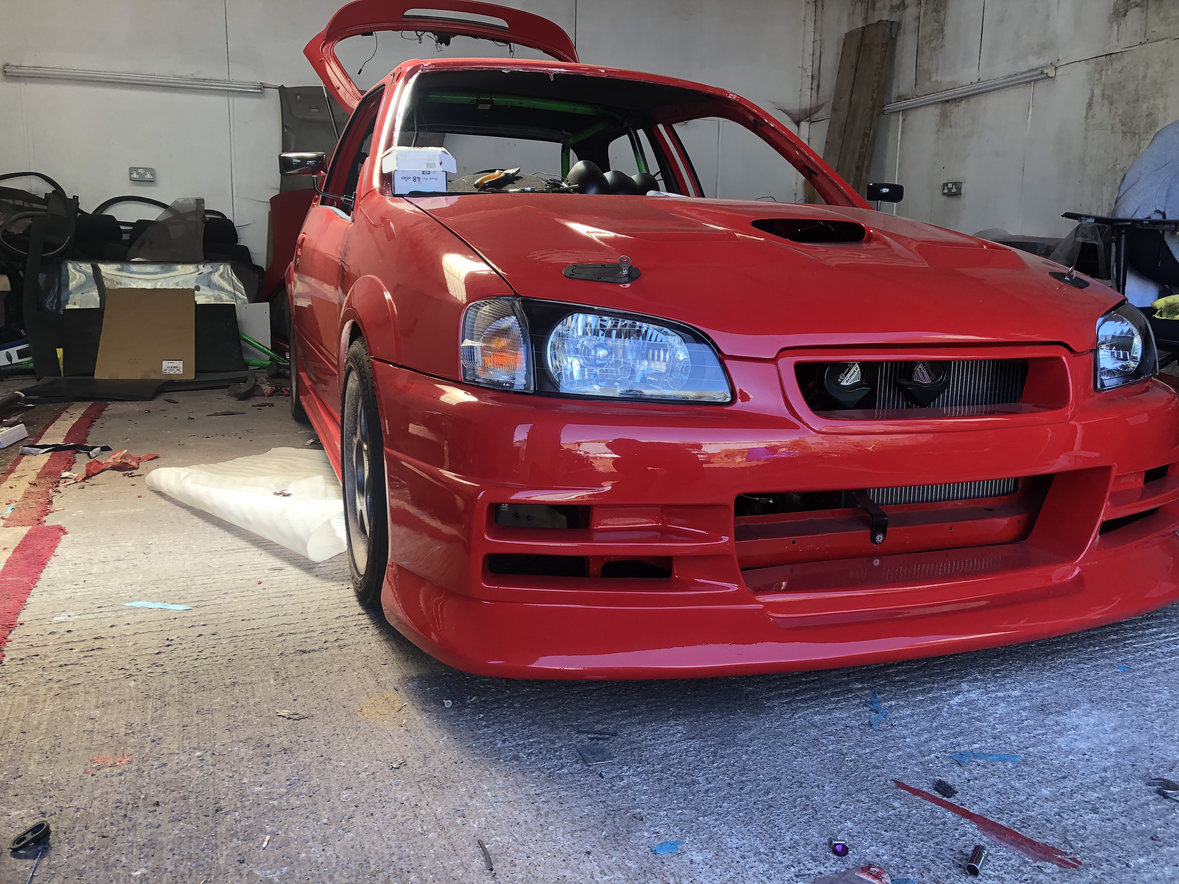

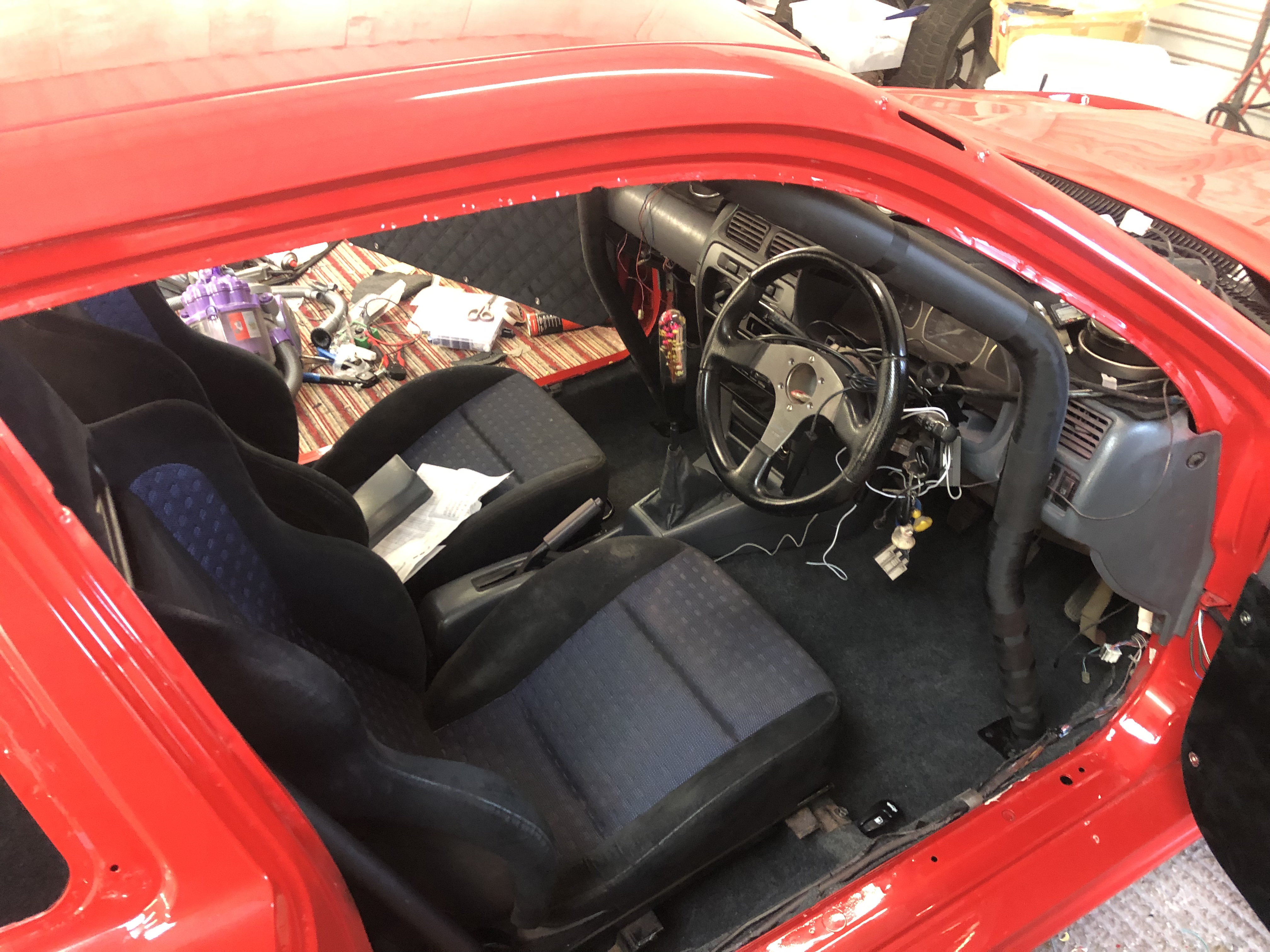

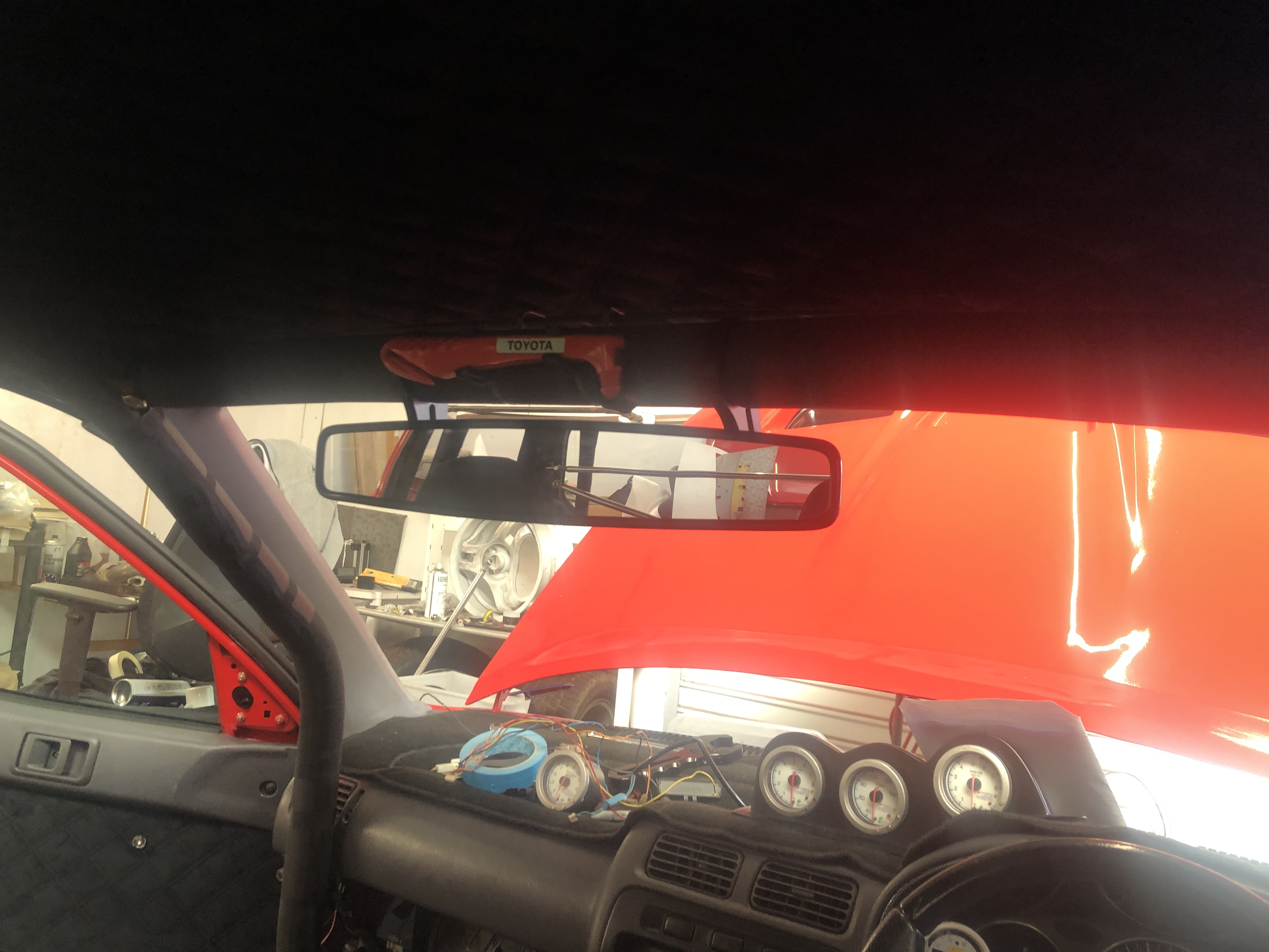

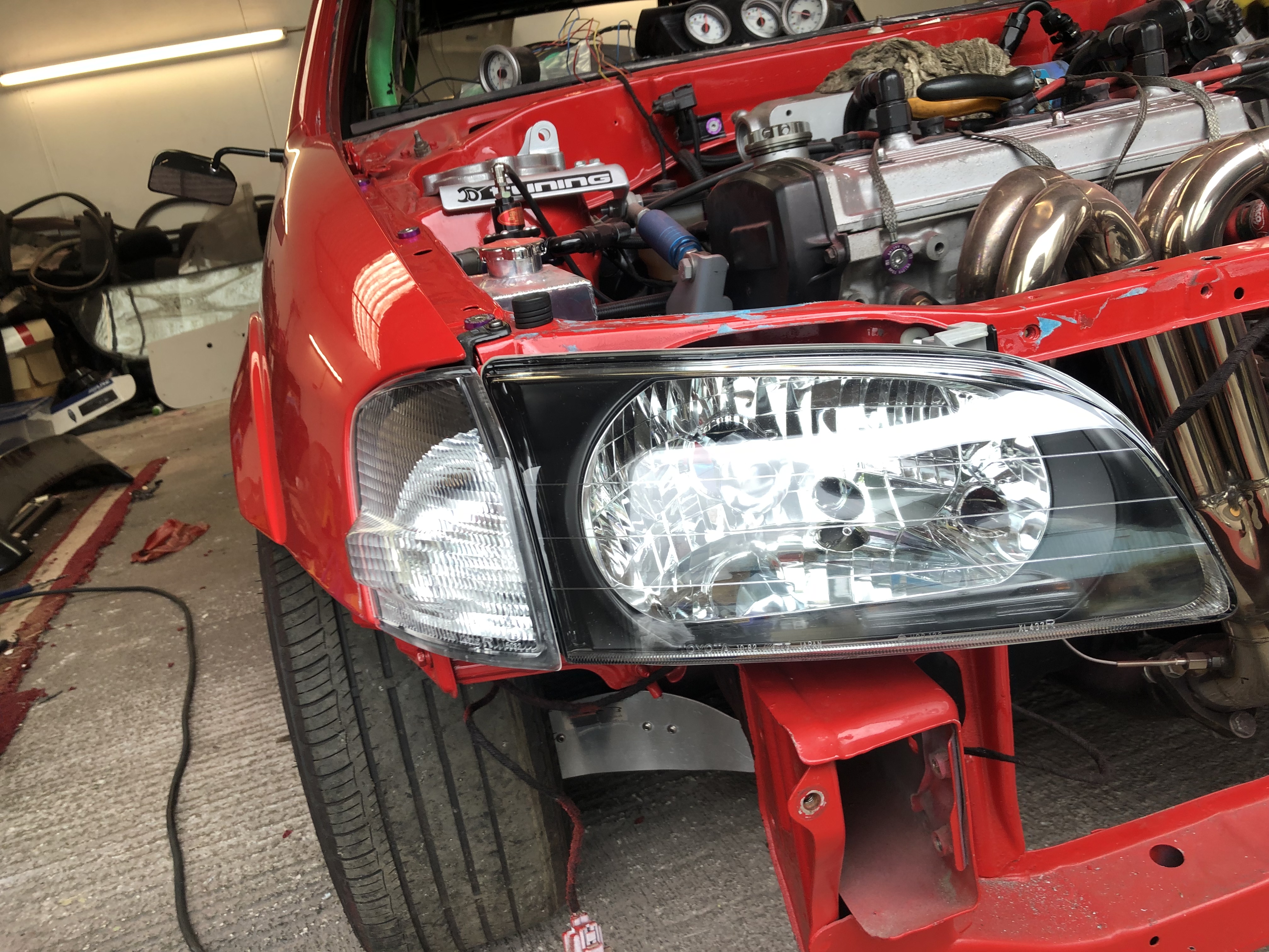

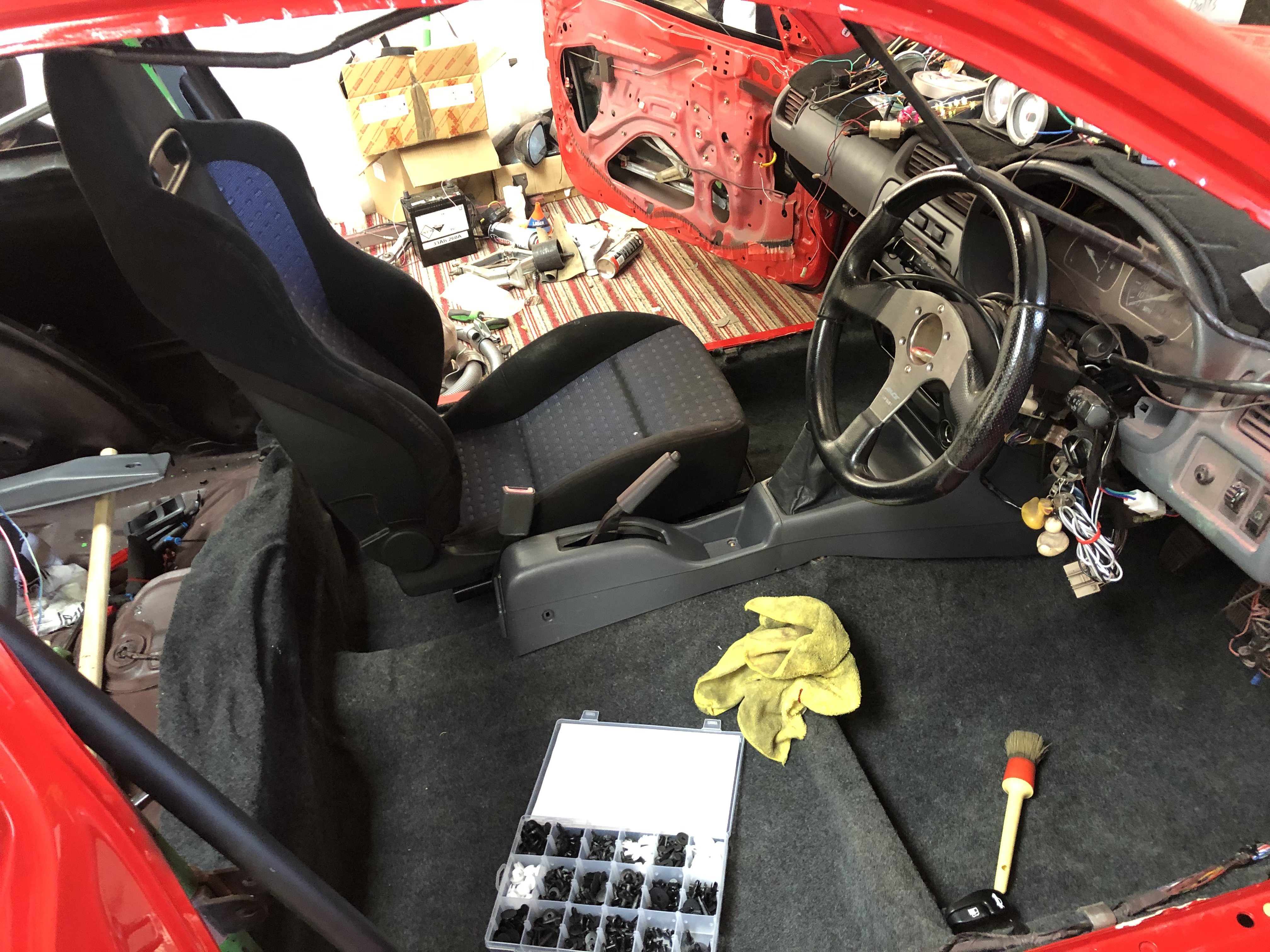

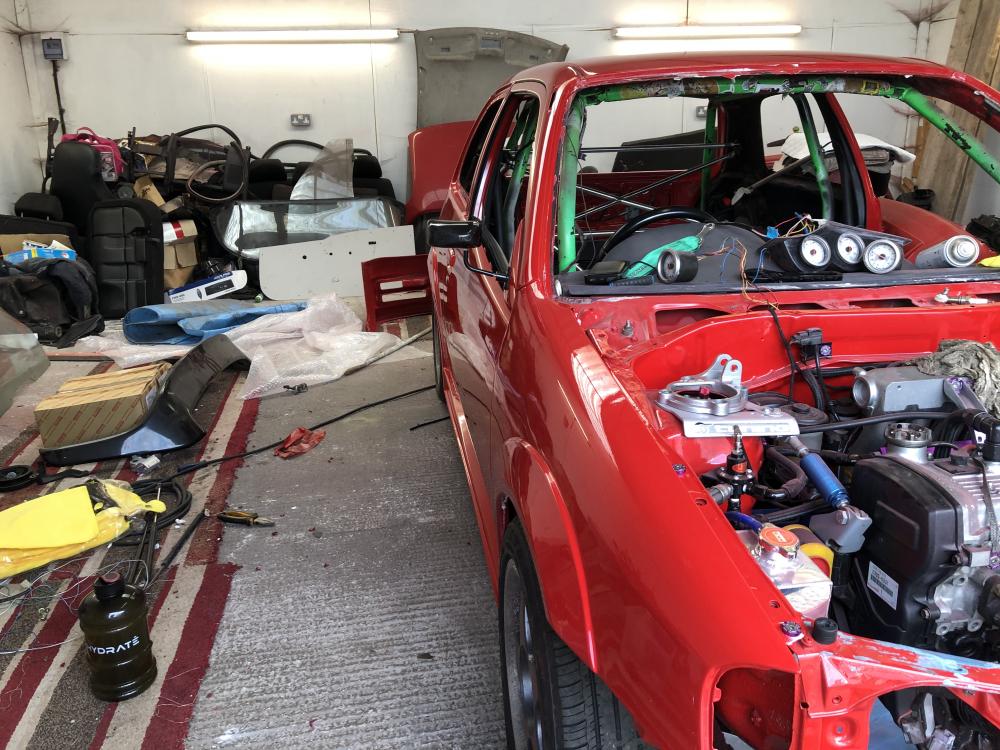

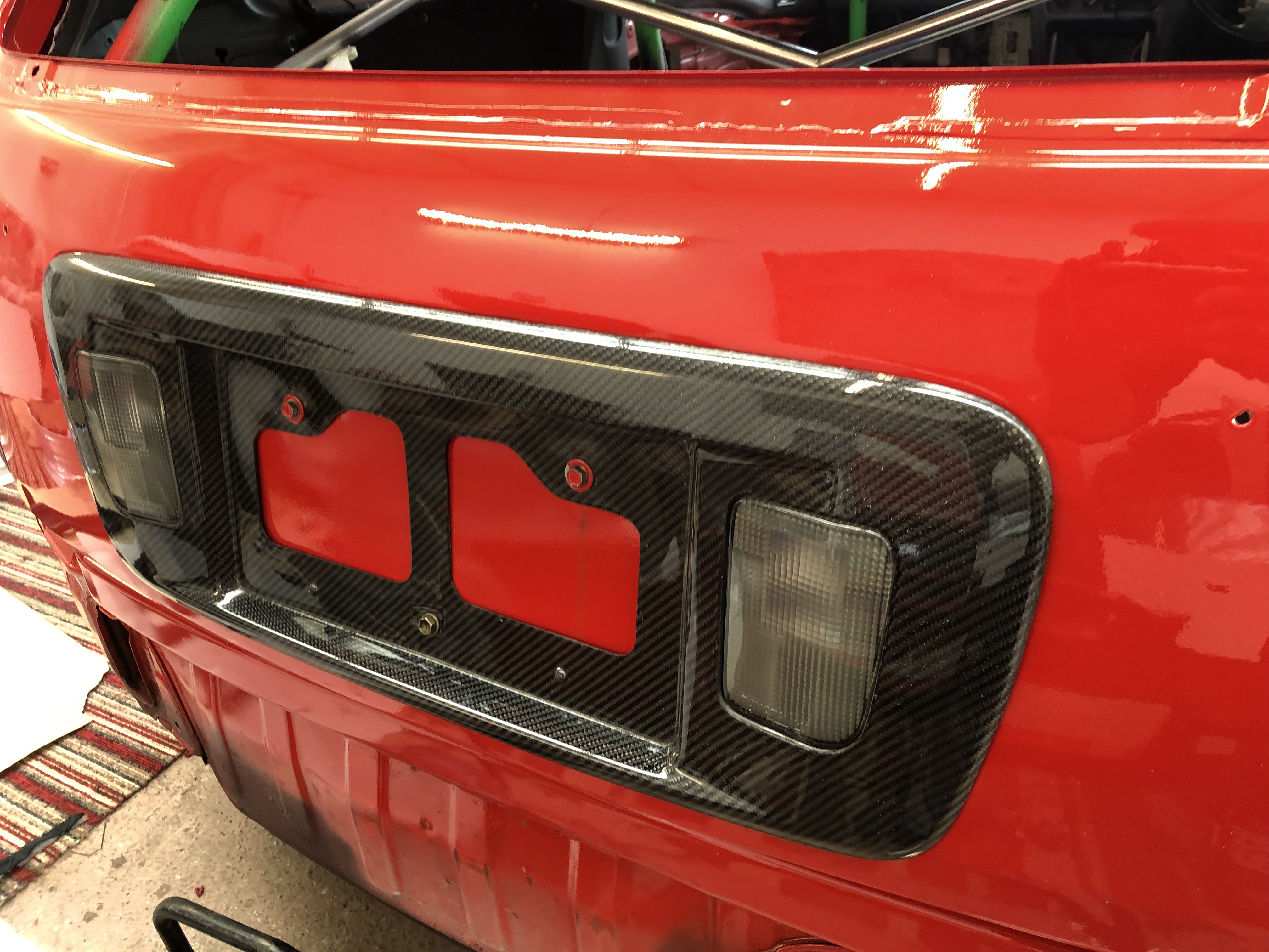

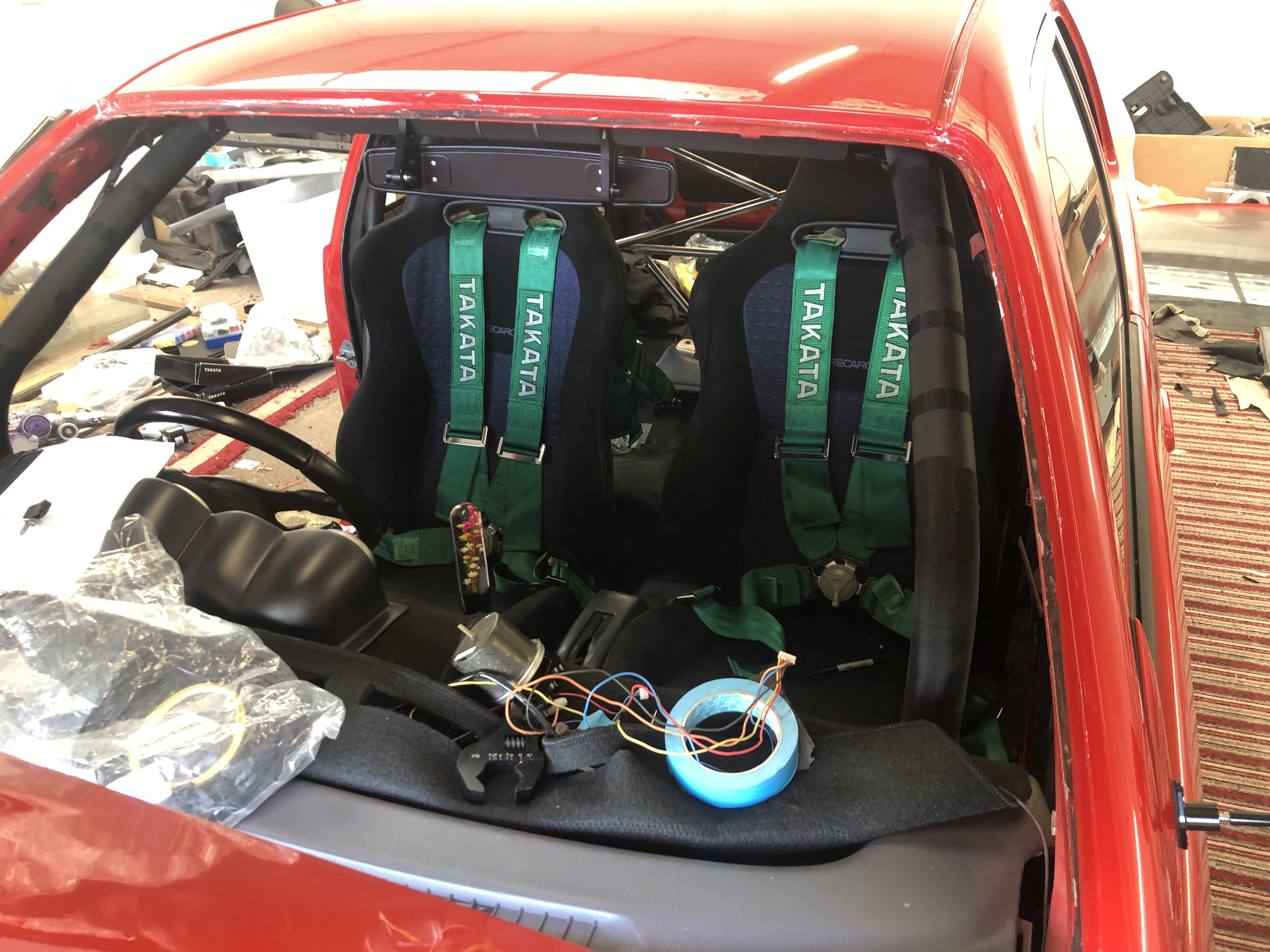

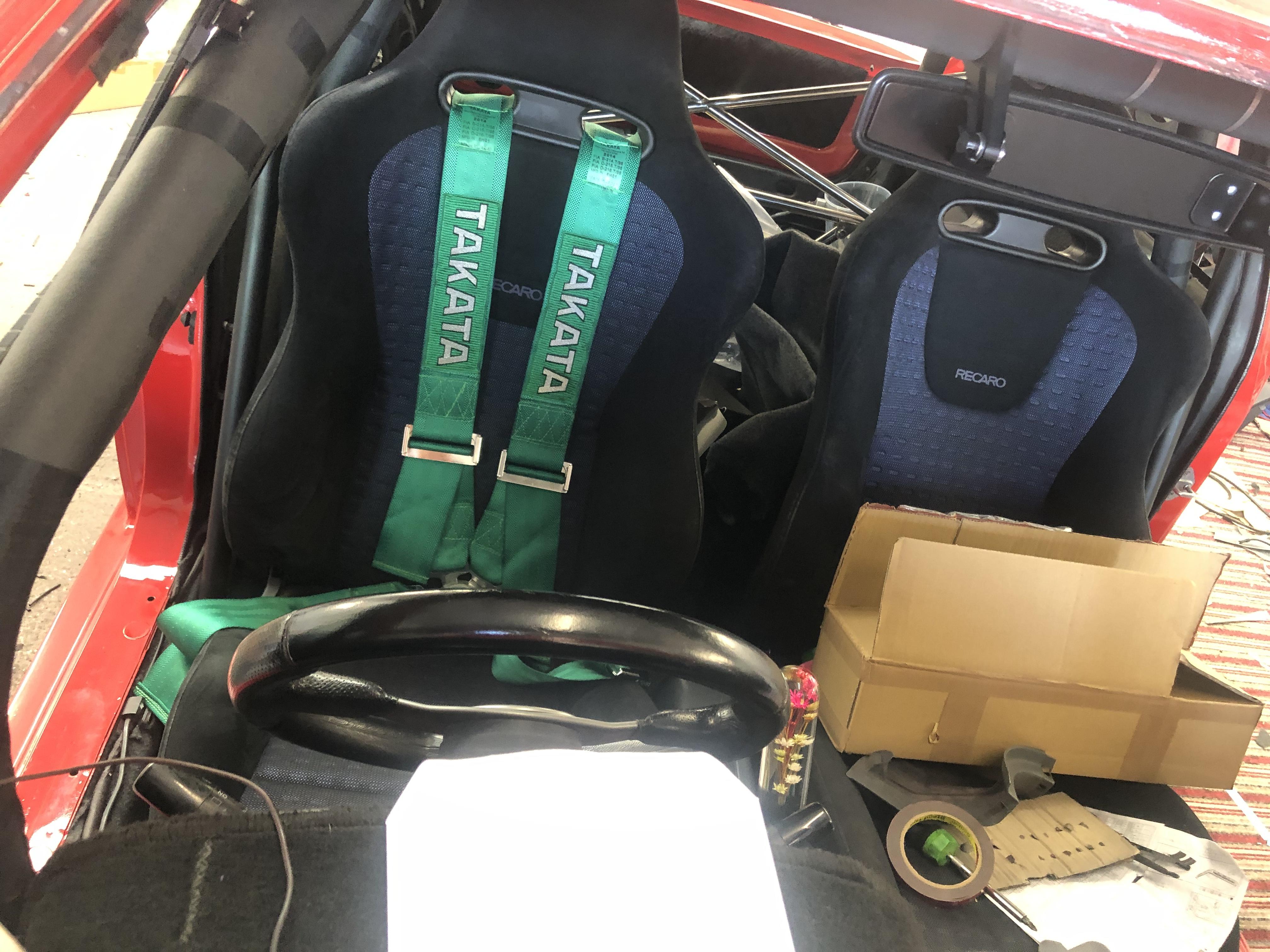

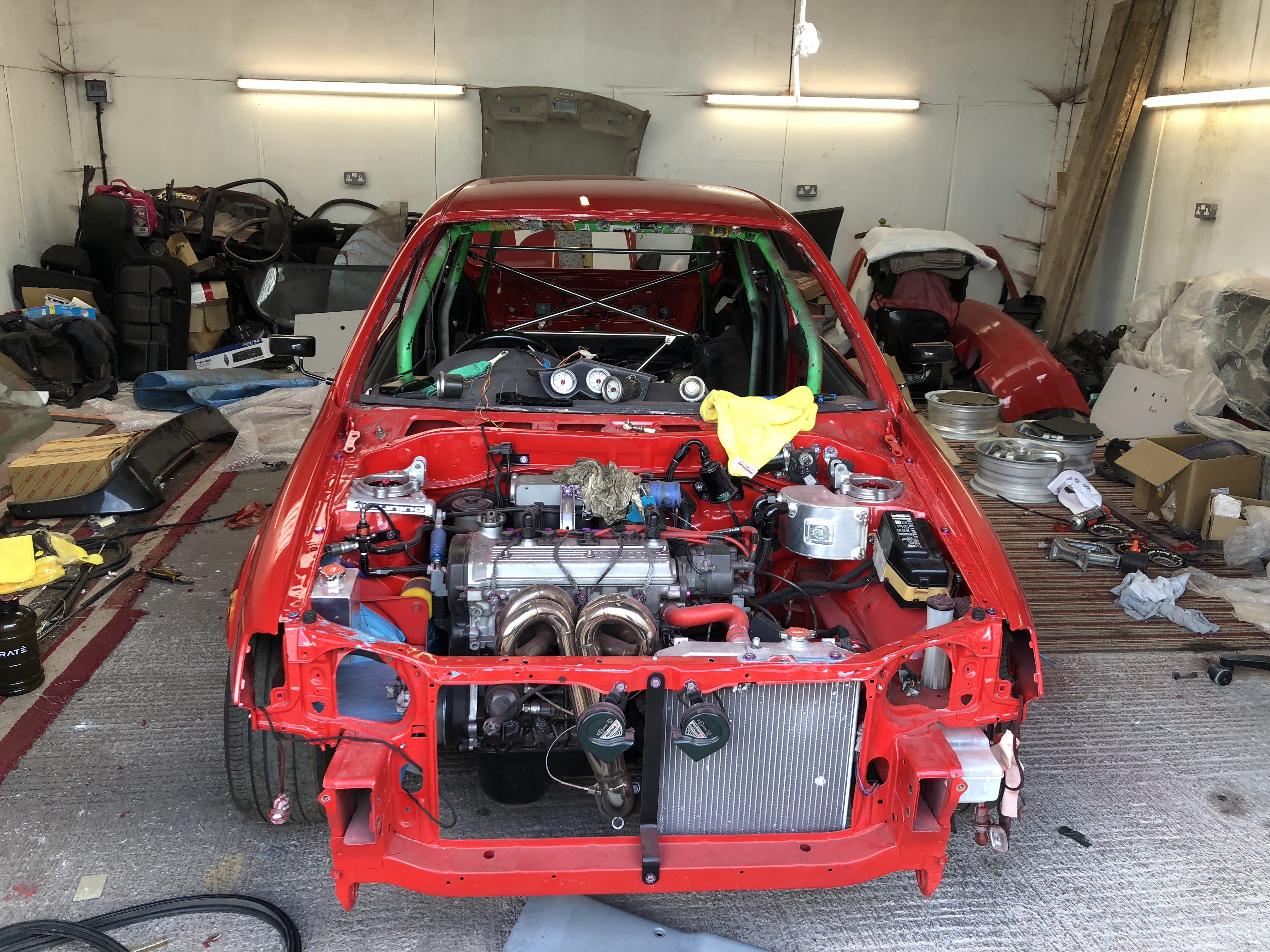

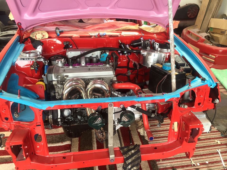

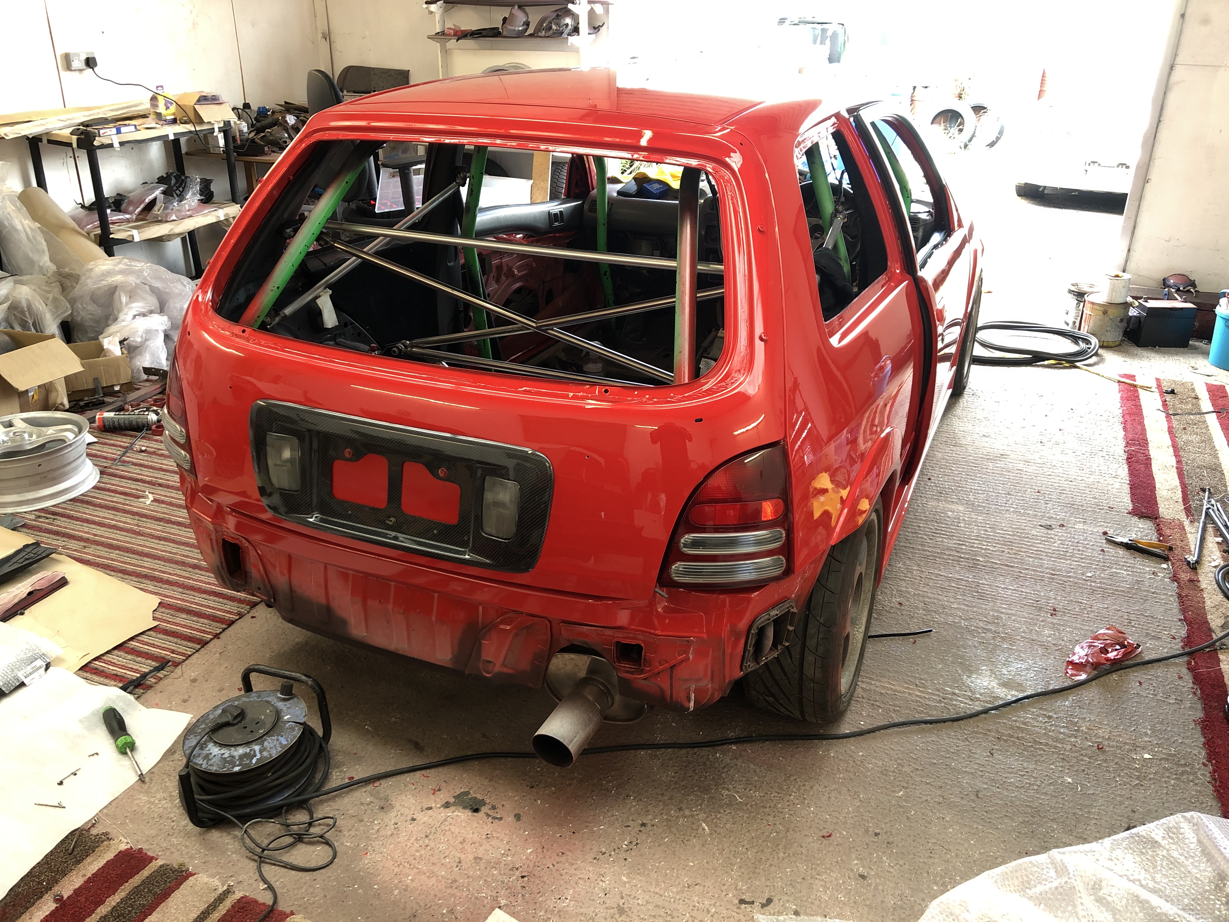

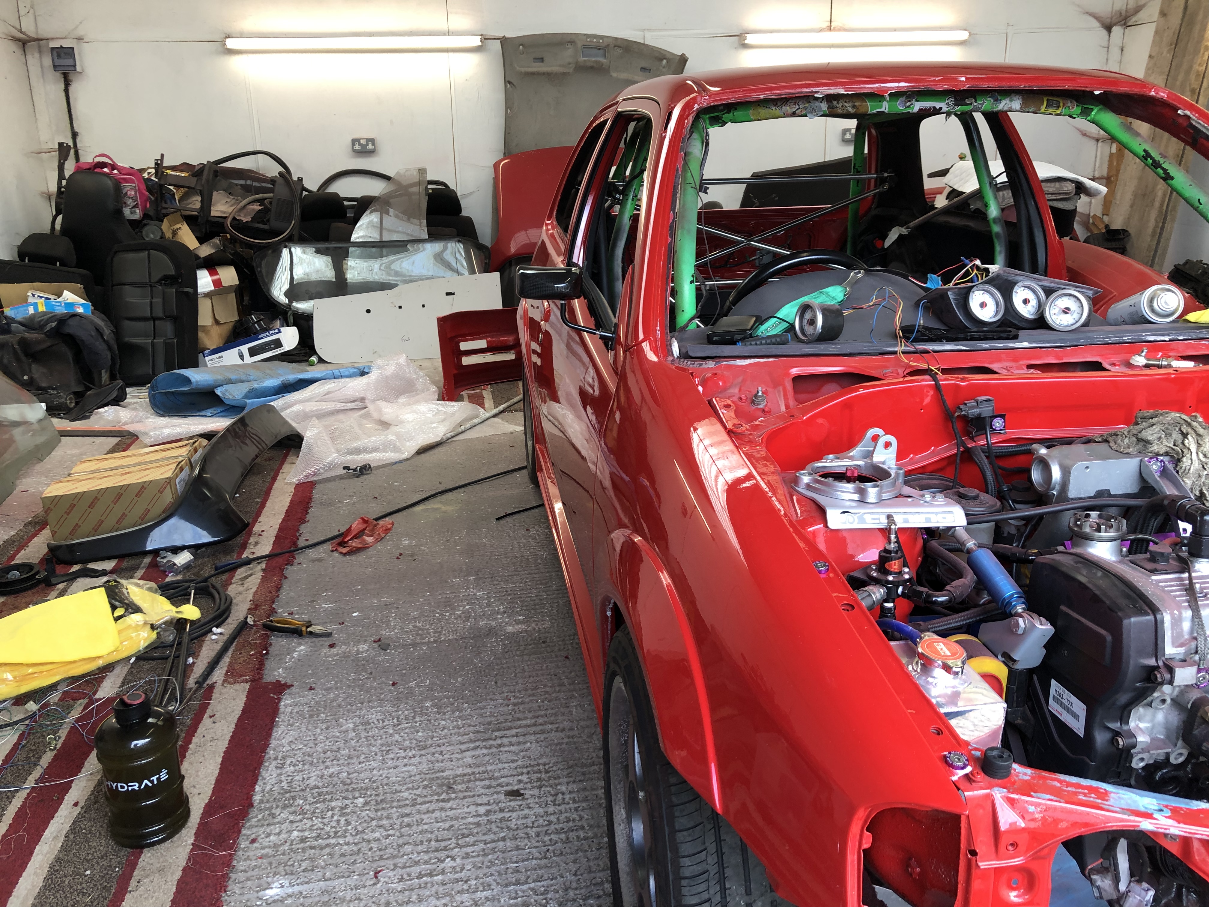

Yea sorry have been making slow progress on the car the last couple of months will bombard a few more pictures here now

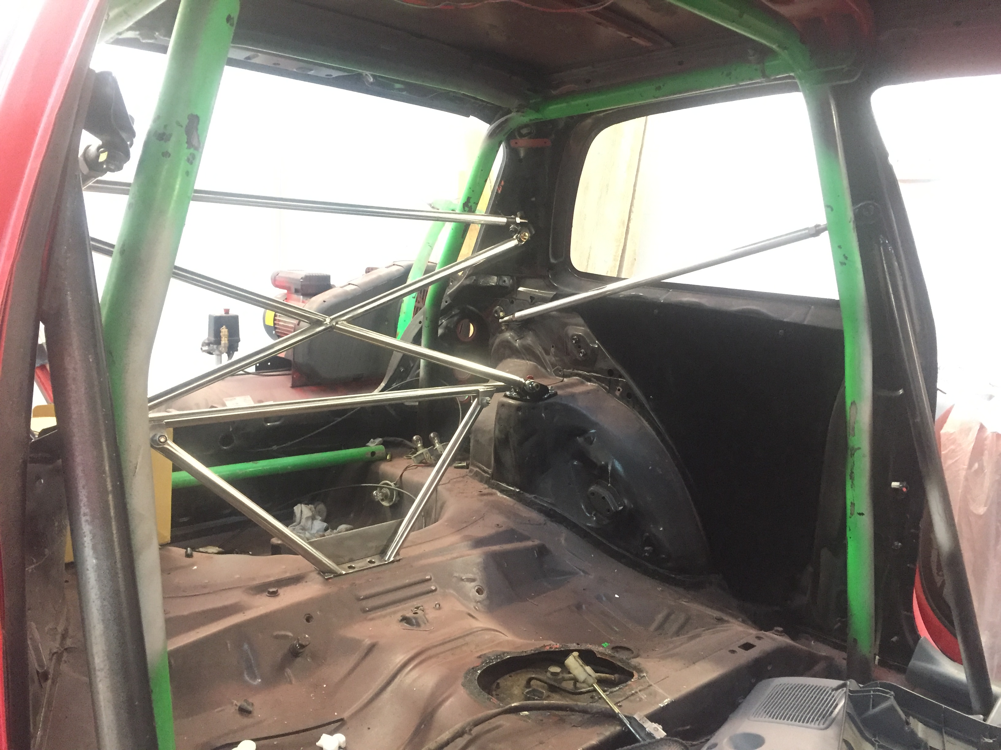

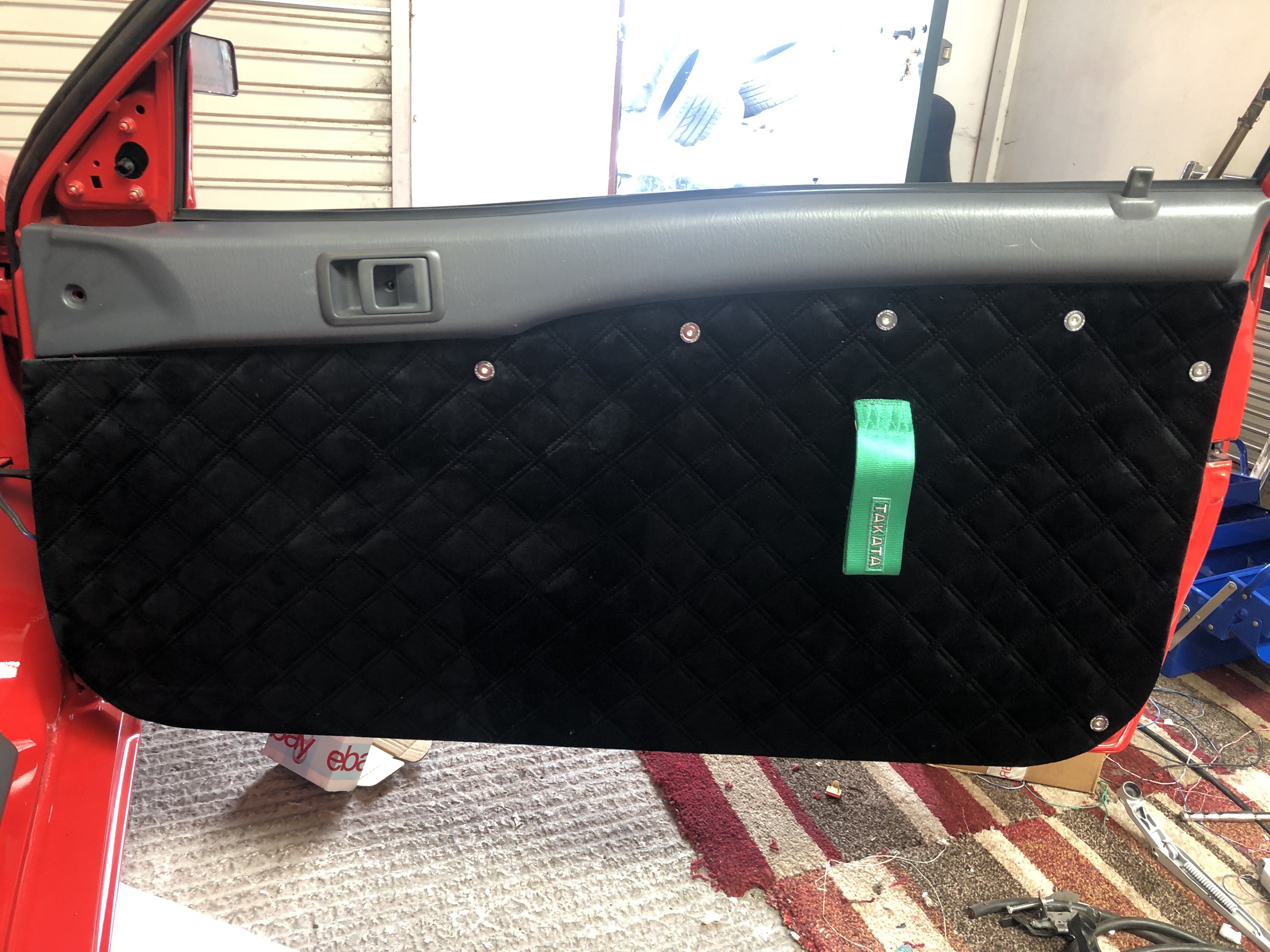

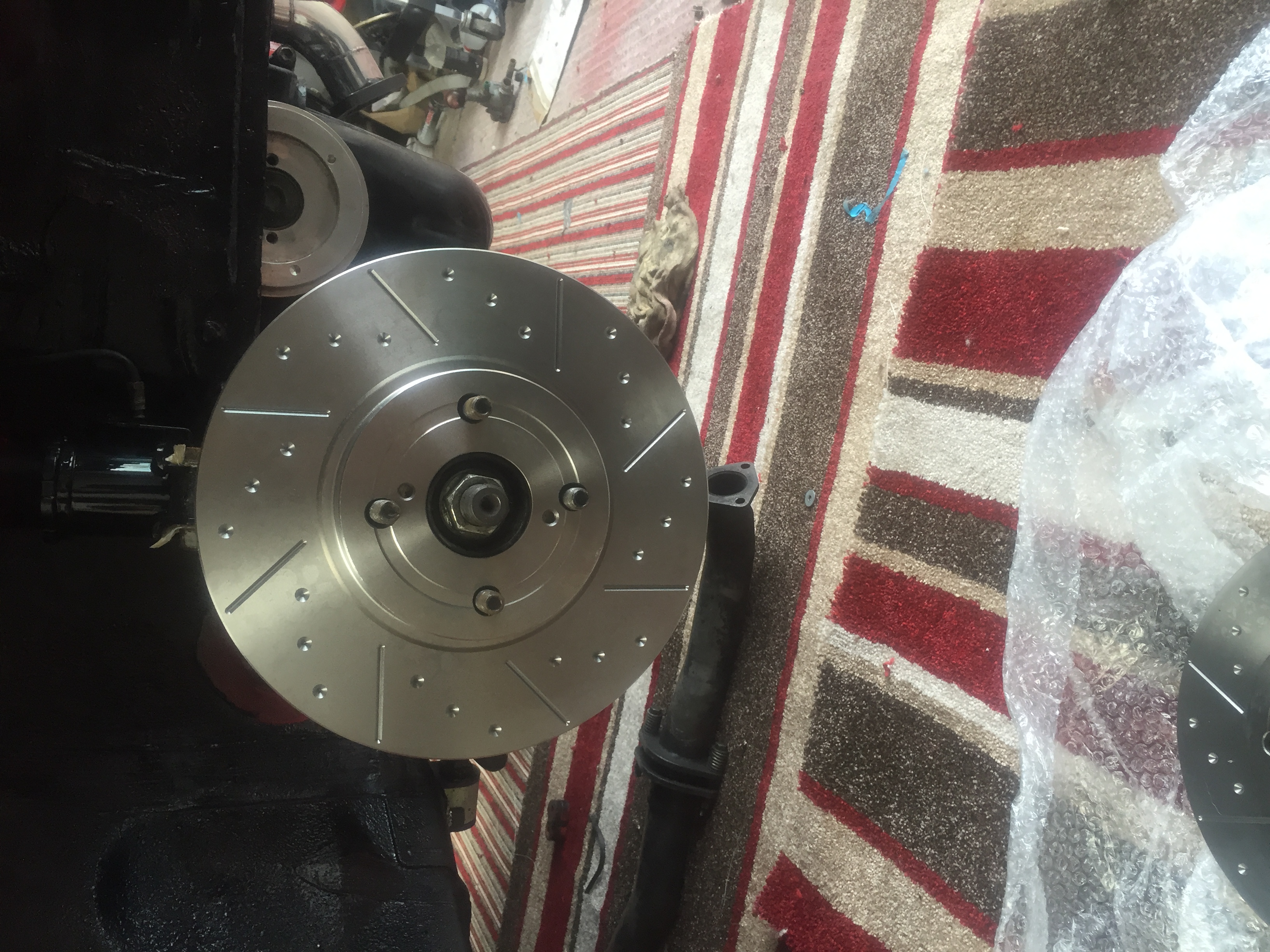

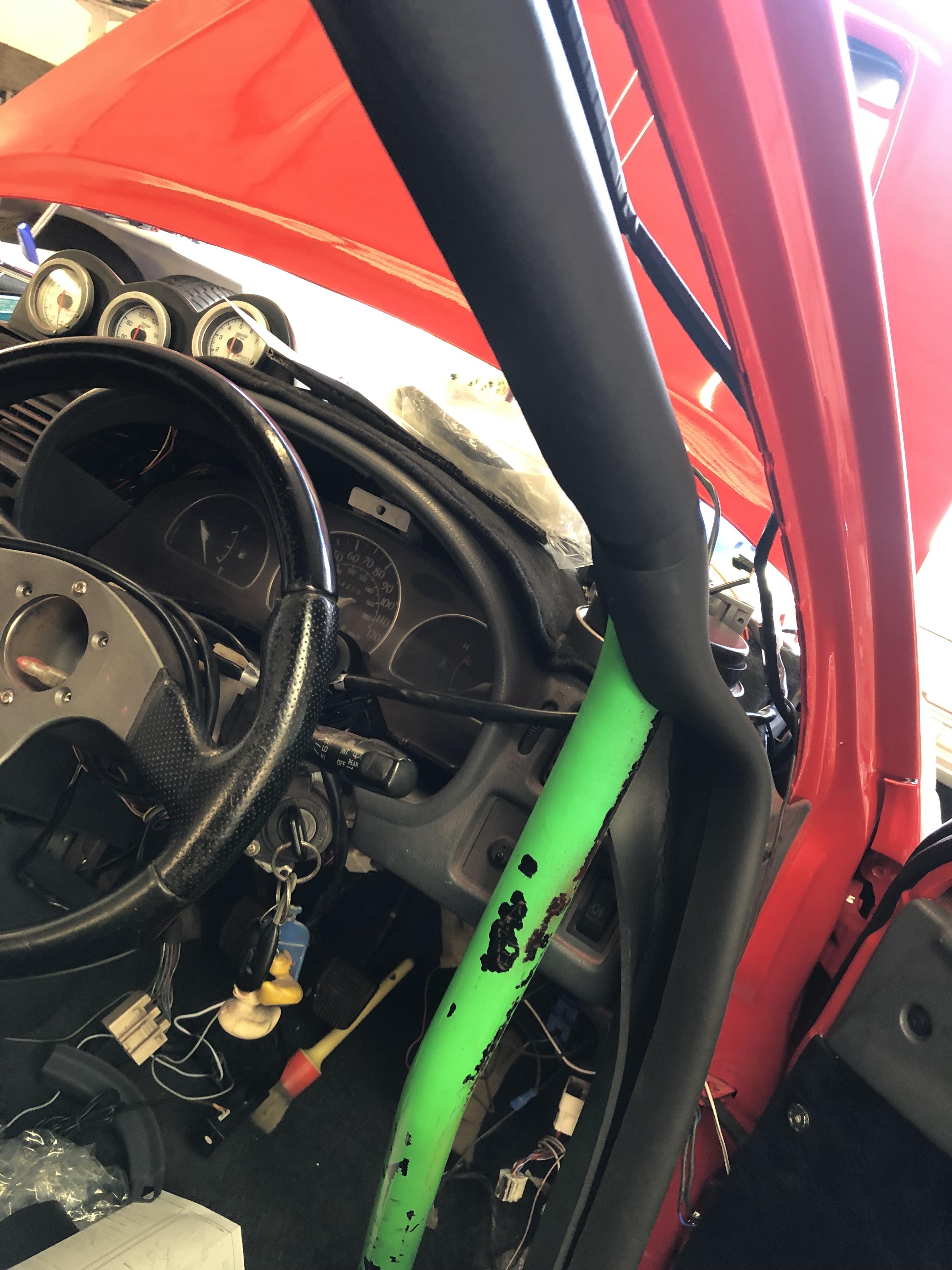

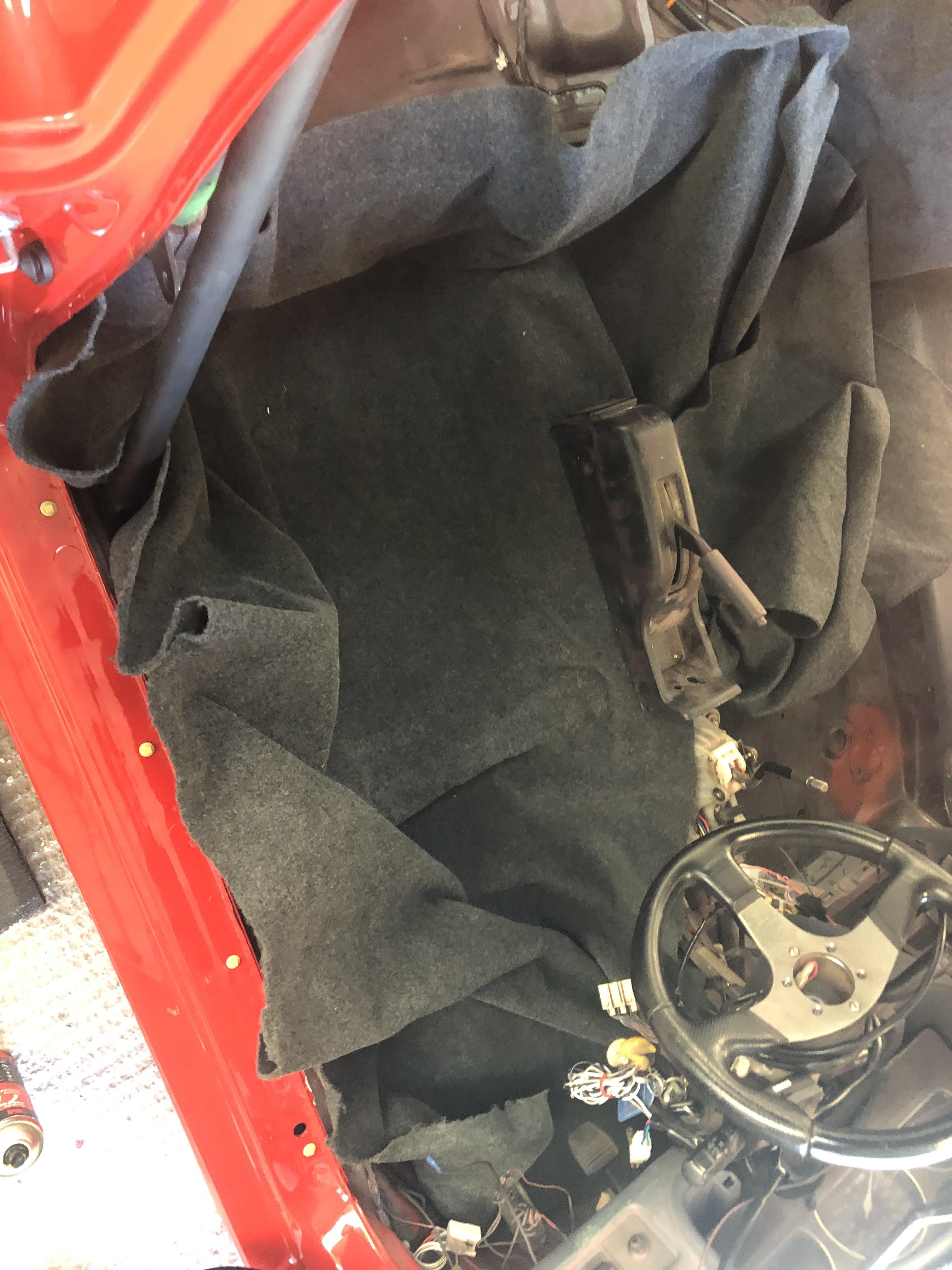

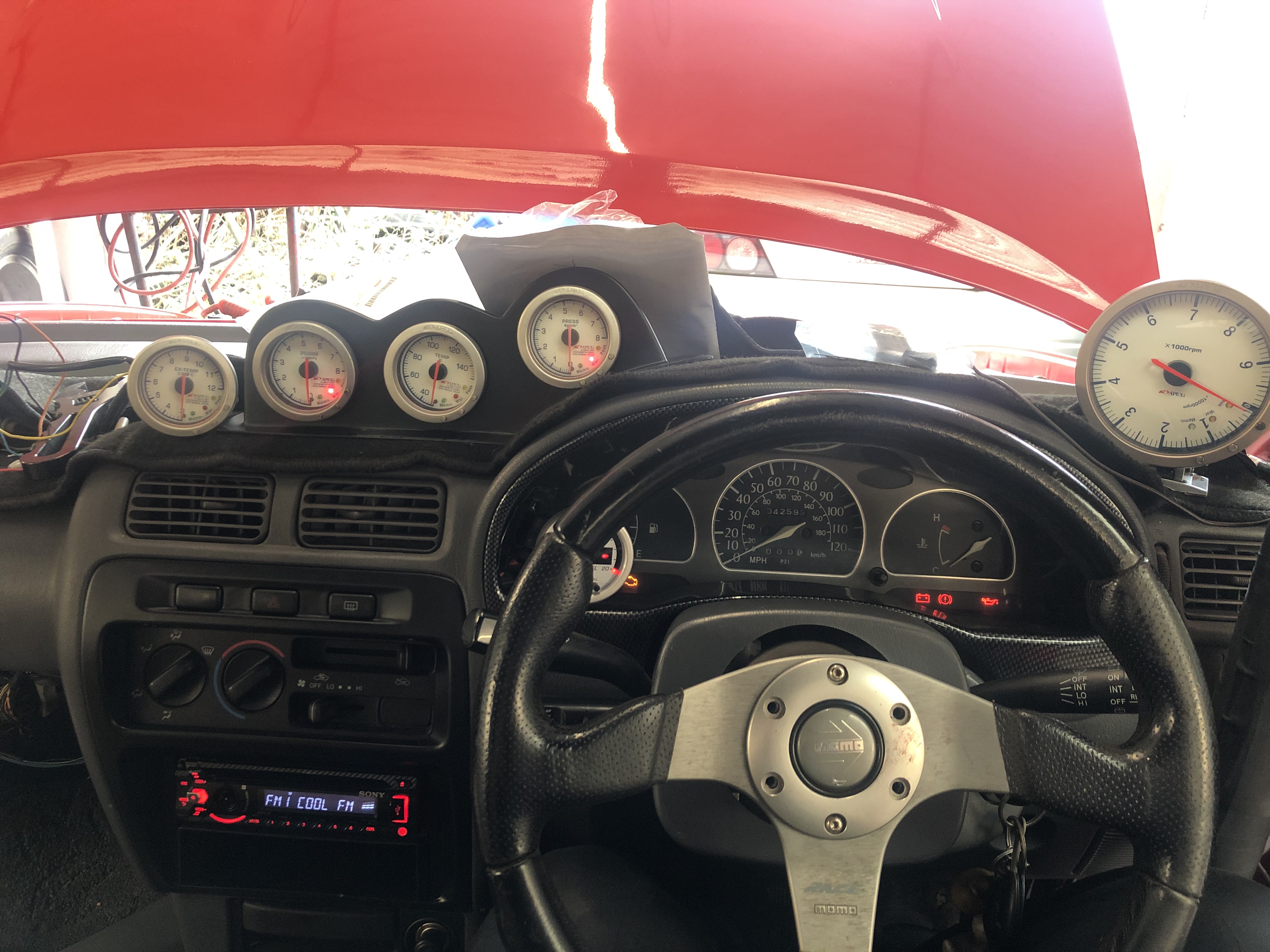

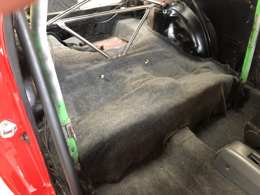

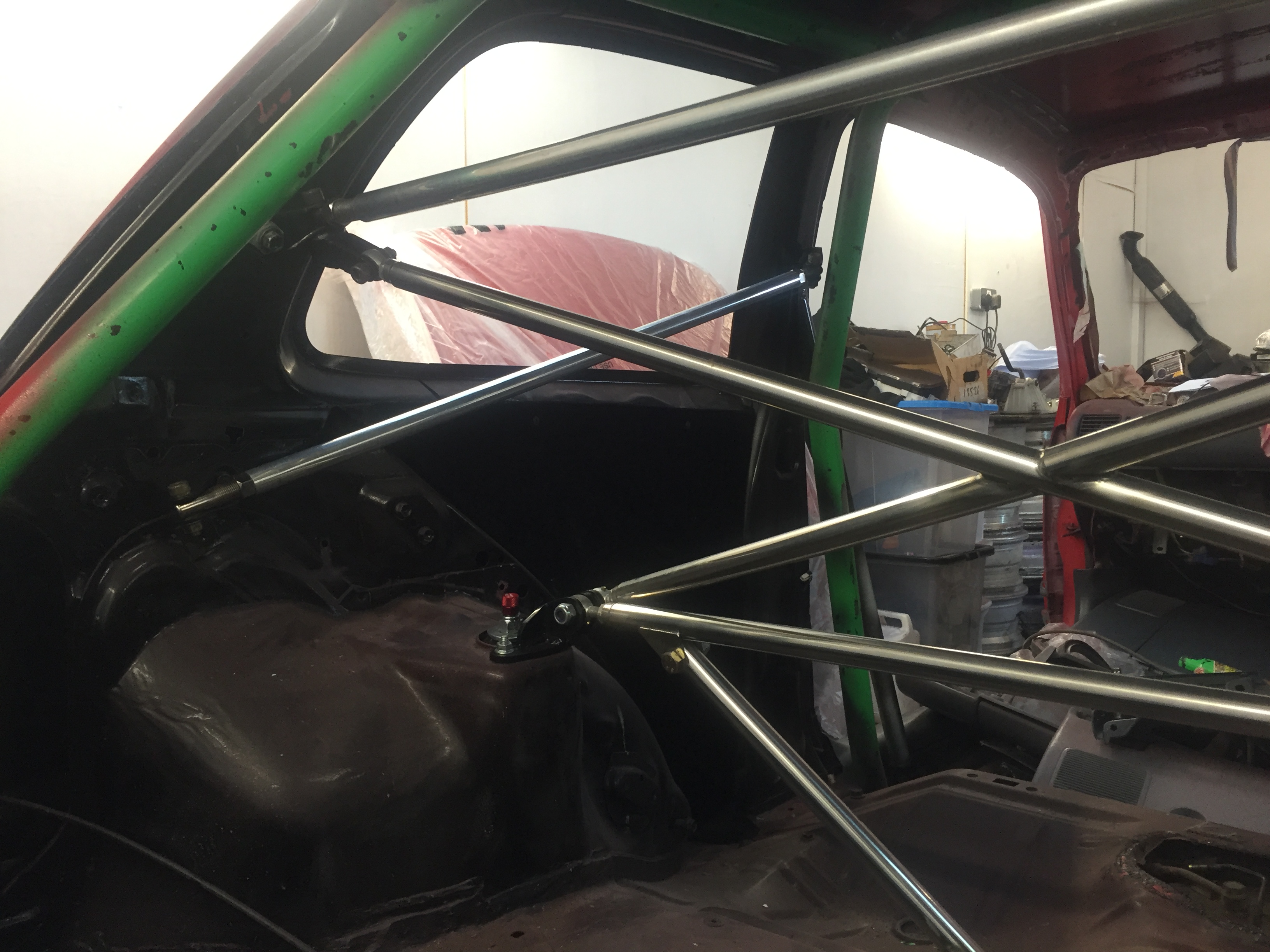

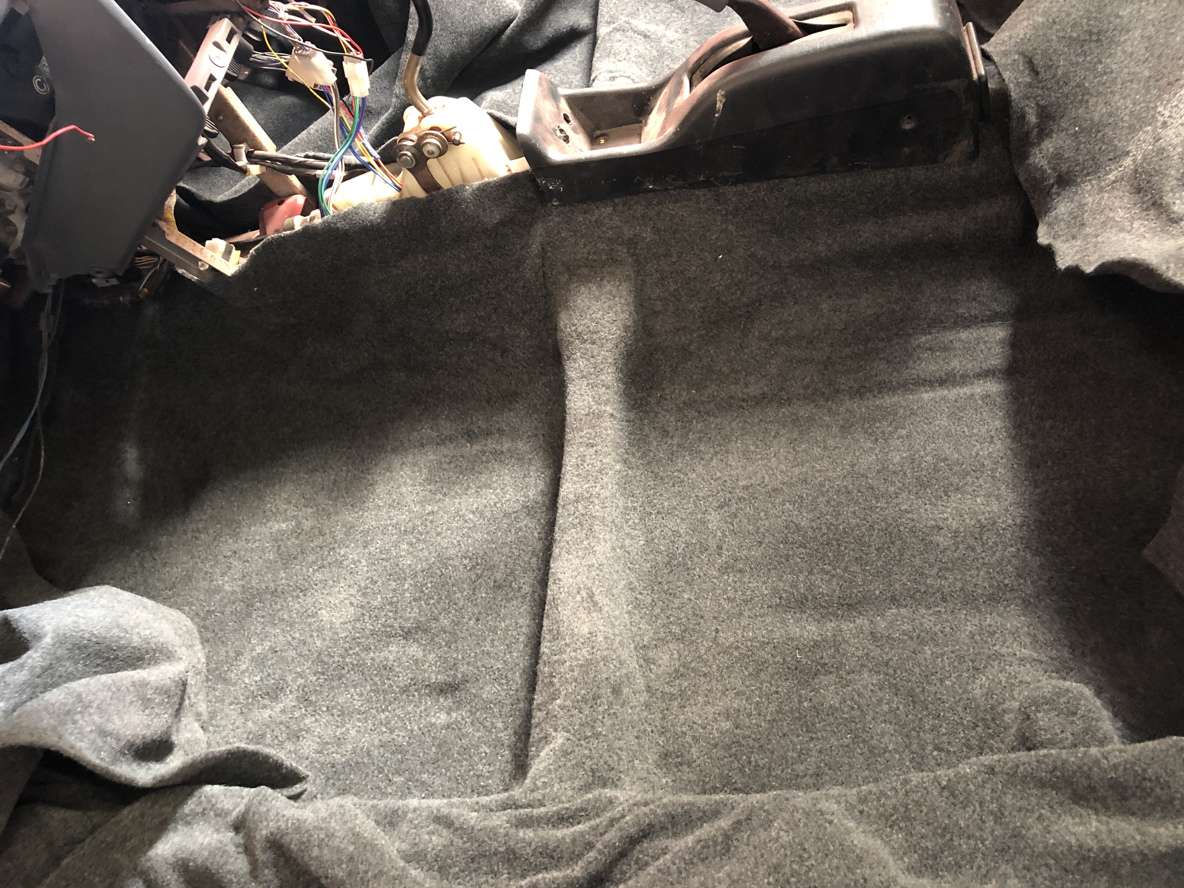

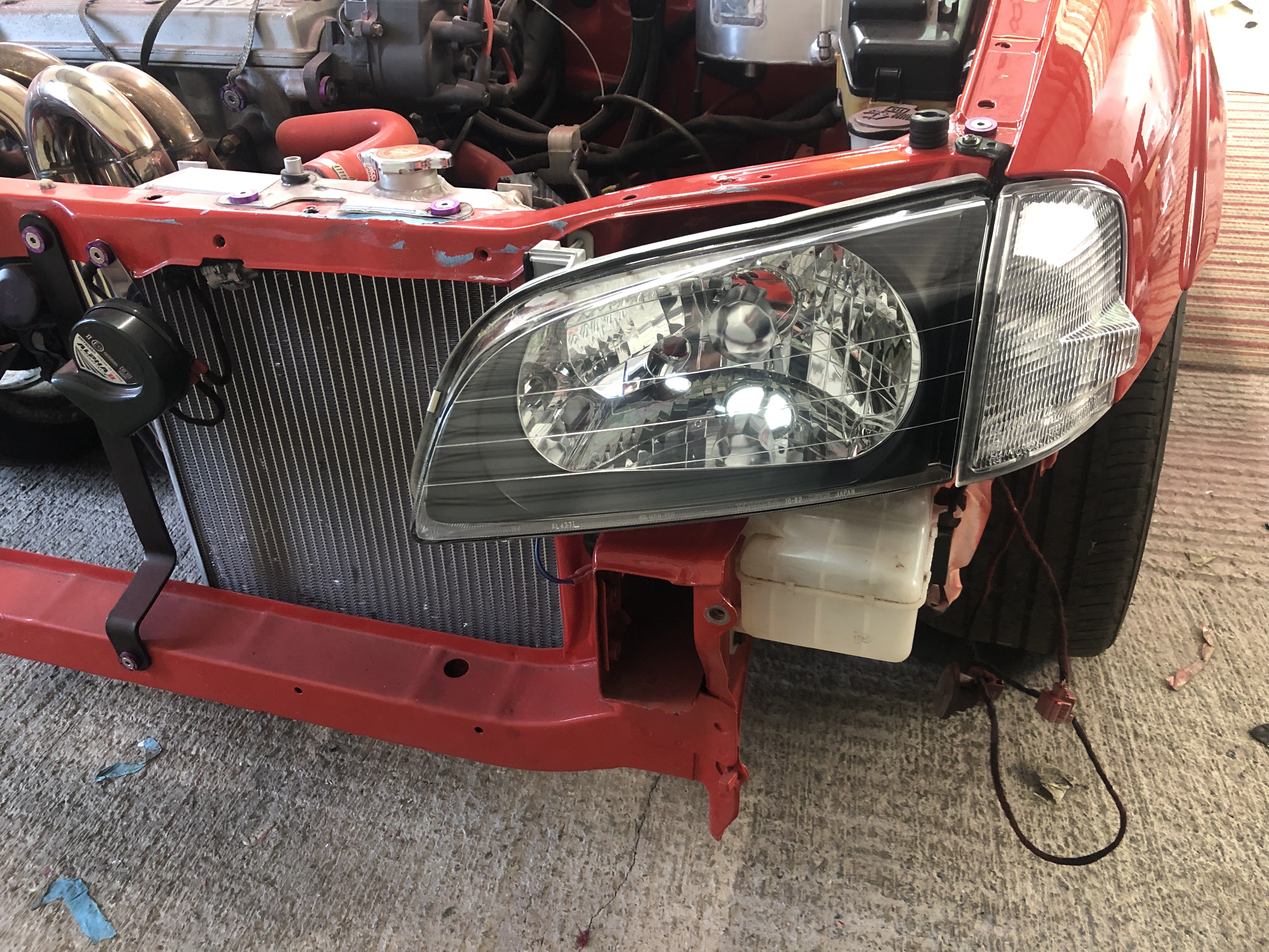

got the front bumper fitted all new window rubbers fitted, made my own carpet and built up a lot of the interior waited 3 months for my cusco cage padding coming from japan, so mostly interior work waiting on a new front windscreen arriving then all the glass can get put in and pull the rear axle fit the powerflex bushes and get it powder coated, tighten all the suspension components then maybe attempt a MOT

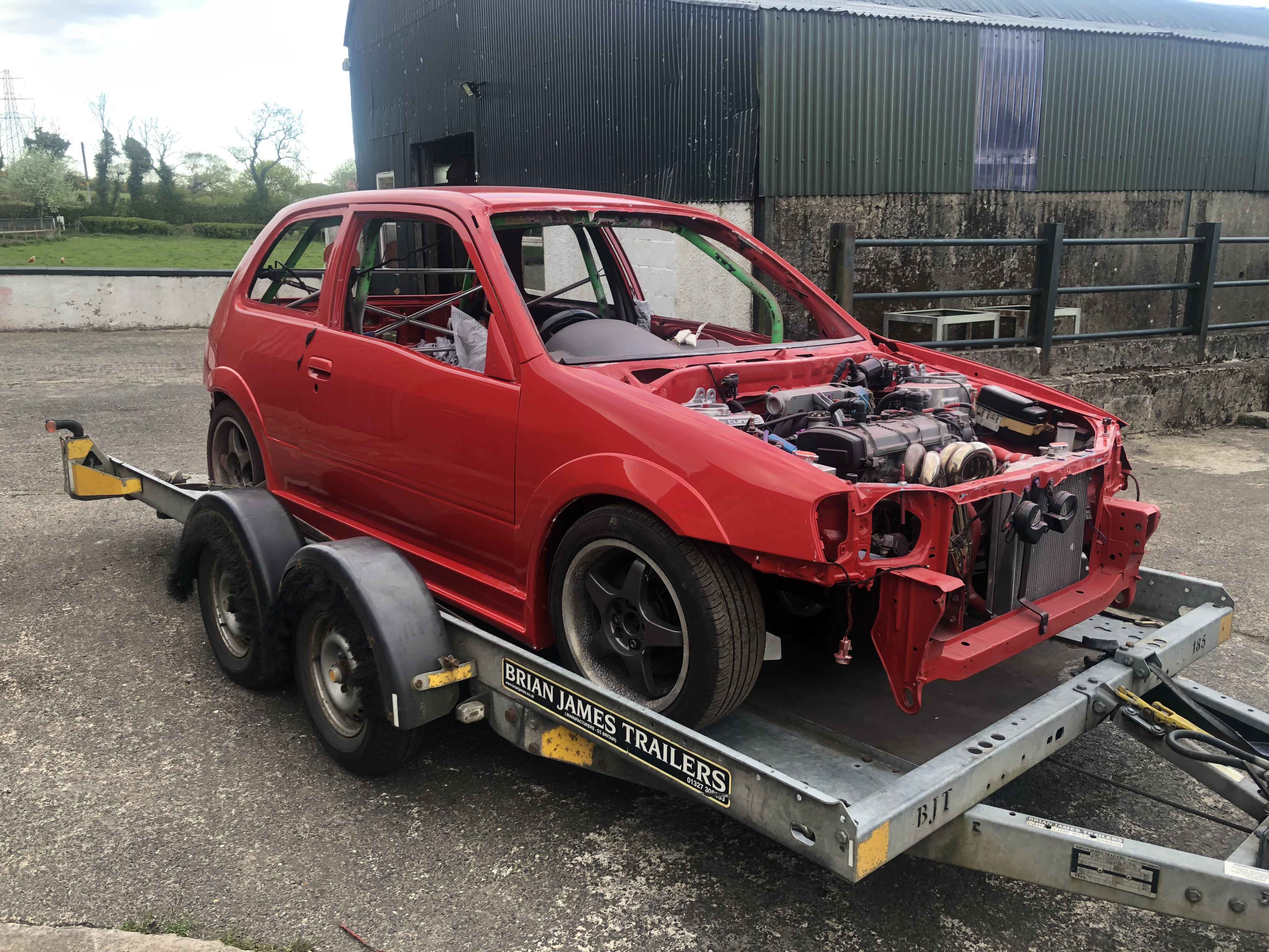

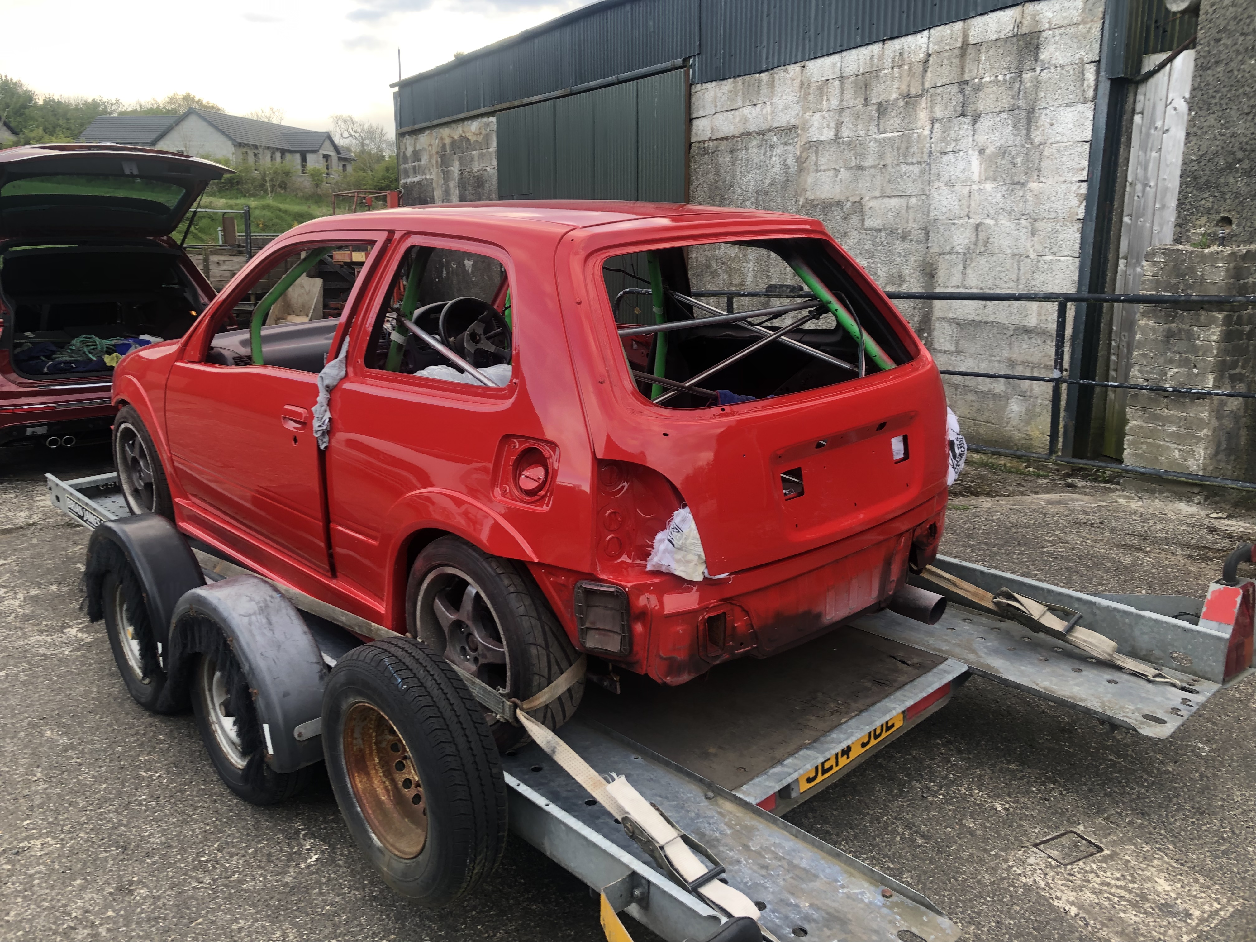

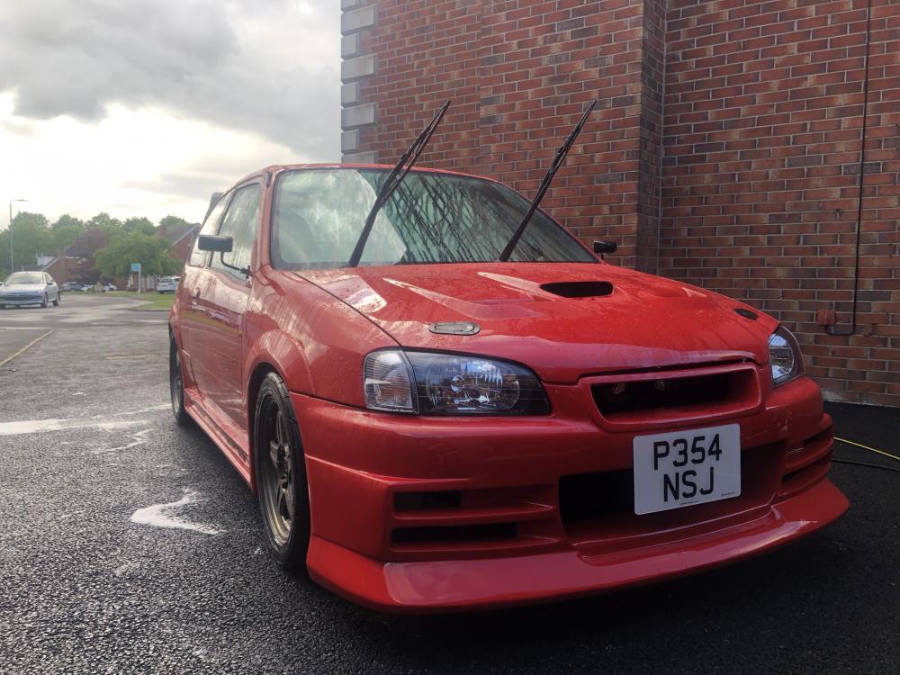

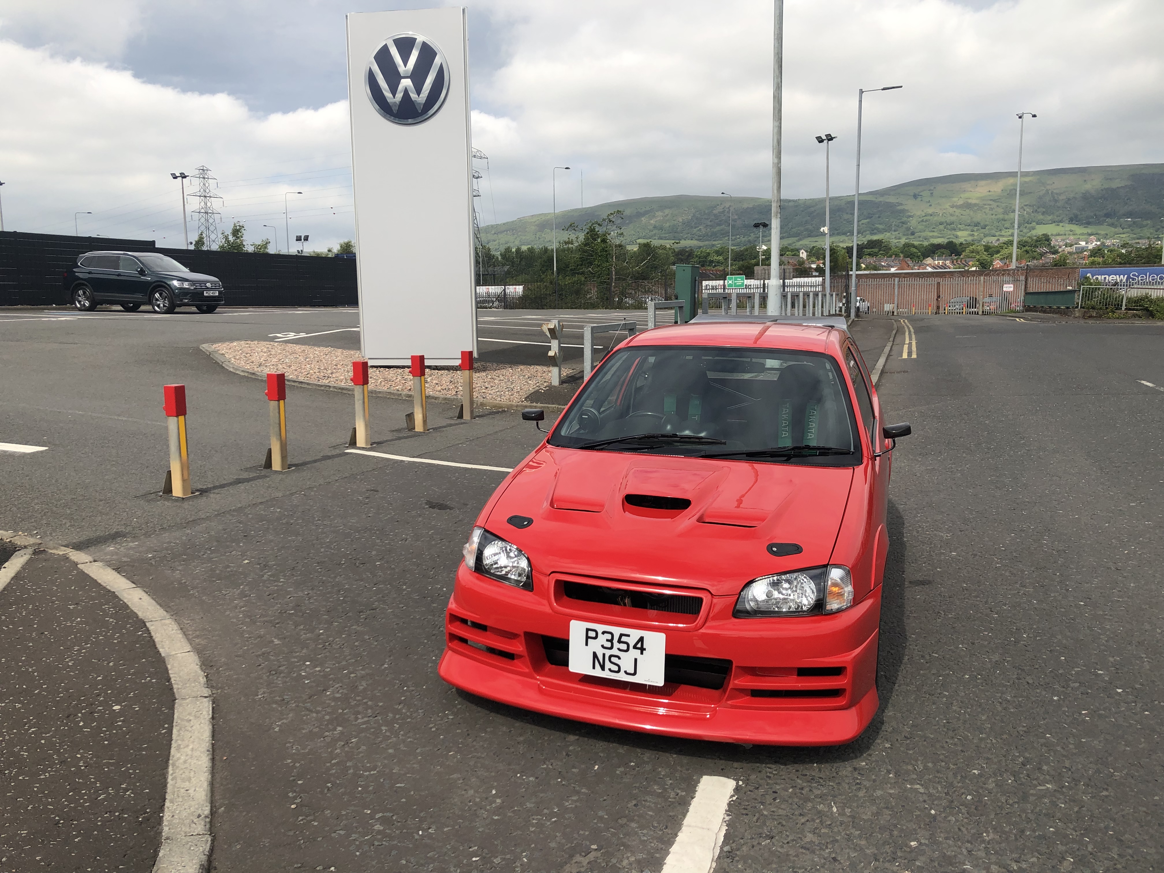

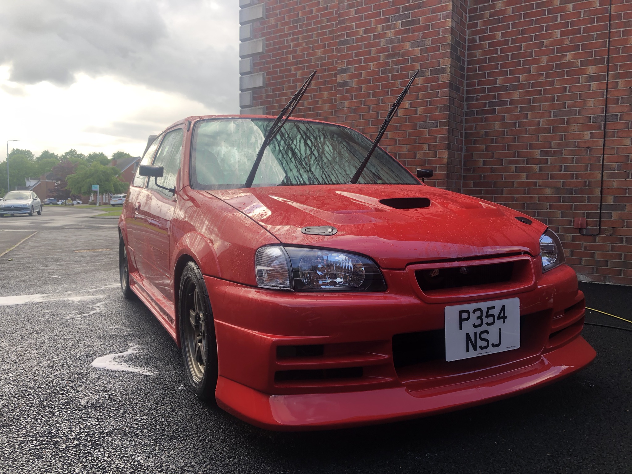

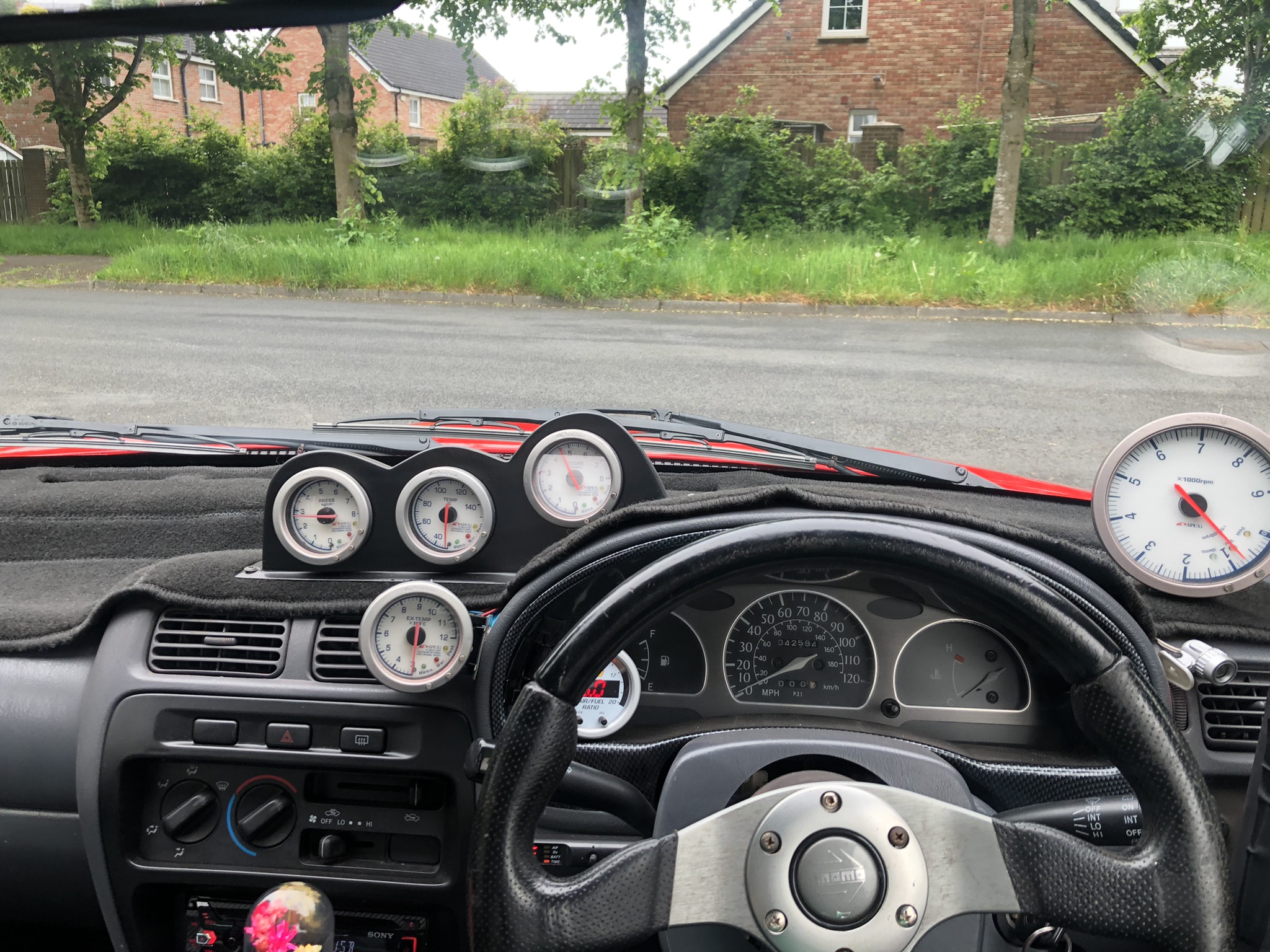

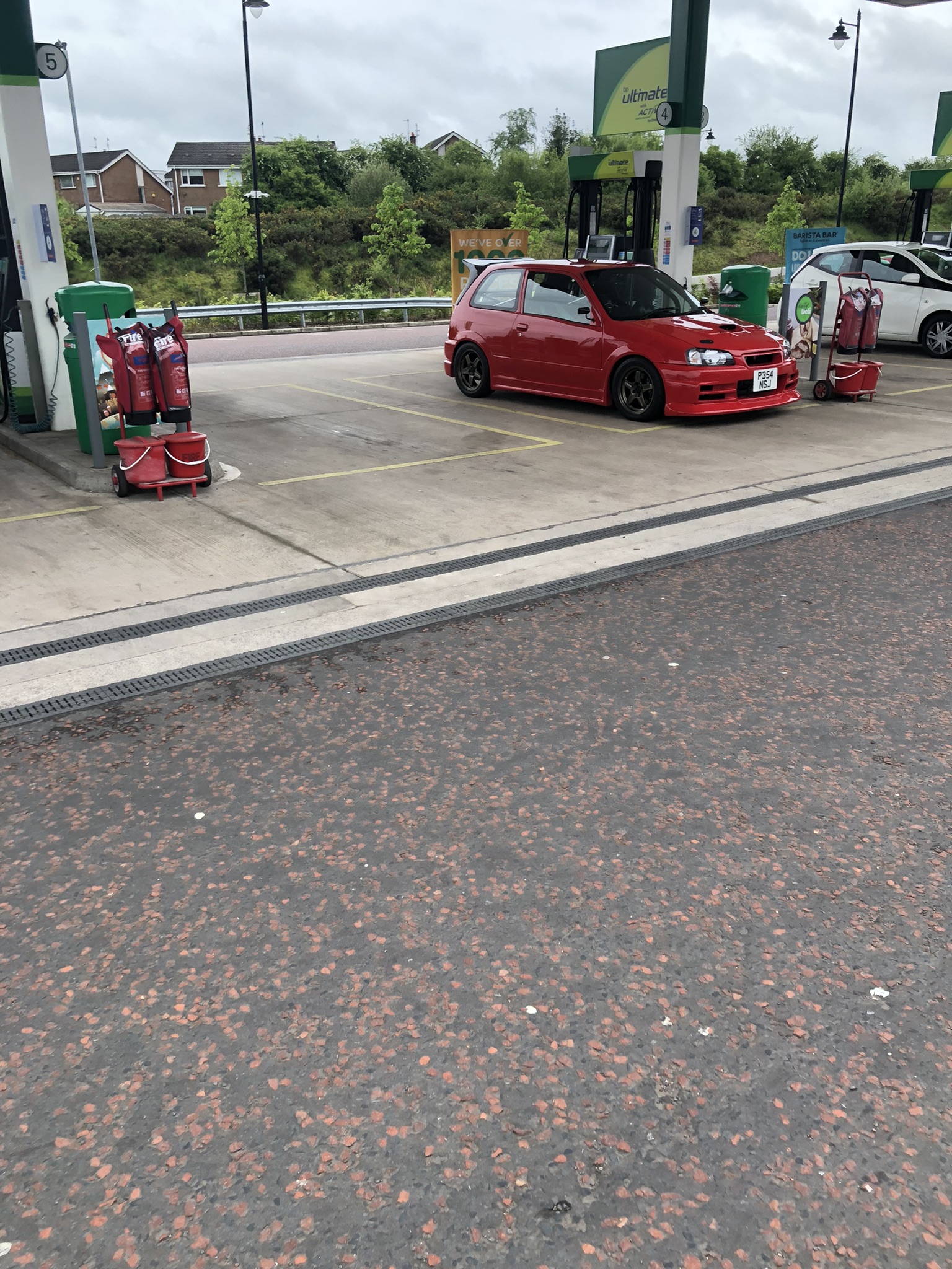

Well it’s been a pretty crazy few months between moving out of my workshop and bring the car home and booking a mot and having a week to get it ready, after 12 years the car is finally back on the road it’s not perfect still a few bits to finish. Have got about 100 miles on the car and it feels great a few little teething issues to sort and will be able to finish the run in miles.
"after 12 years the car is finally back on the road it’s not perfect"
this line resonates with me on the highest of frequencies.... I absolutely love a project that everyone thinks is dead and it resurects from the ashes in front their eyes.....
this car reminds me that the wait is soooo worth it.... shes absolutely stunning teething issues and all...
crack on mate your inspiring all of us whos cars have been down for 5 plus years...
