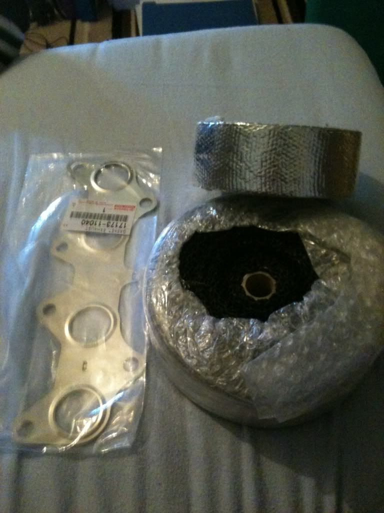

nazzurro19 Posted March 23, 2011 Author Posted March 23, 2011 well another parcel turned up today 30m of exhaust wrap , that will be enough to do the exhaust wont it ? also got a lil message on a lil red card :@ ?? GRRRrrr lol got another 3 parcels to pick up 2moz god knows what they are i love this waiting game haha and also a lil section for sparky : removing abs bits and carbon can etcam i correct in thinking it is all this i can remove all the wring , sensors , can i just unscrew it from bulkhead the black cable wrapped part from bk of inlet the black sensor thingy then remove all the wires and re electric tape i back up haha and then join them to back upand then all the parts on inlet just leave a lil piece of vacum on and then cable tie it over and jobs done yeah ?haha i thougt id leave it till after pod incase it fooks up big time
Sparky Posted March 23, 2011 Posted March 23, 2011 That heat wrap should be plenty mate And yes the first sensors can be removed from the bulkhead and the piping that goes to the inlet blocked with a vacuum with a screw or bolt in it.Not sure if I removed the lil black sensor near the brake cylinder though I'll have to double check for you ro check my thread and see if you can see anything.And charcoal canister can come out just let that pipe that goes to the tank breath somehow, the little black box is a different size so you'll need a big pipe.

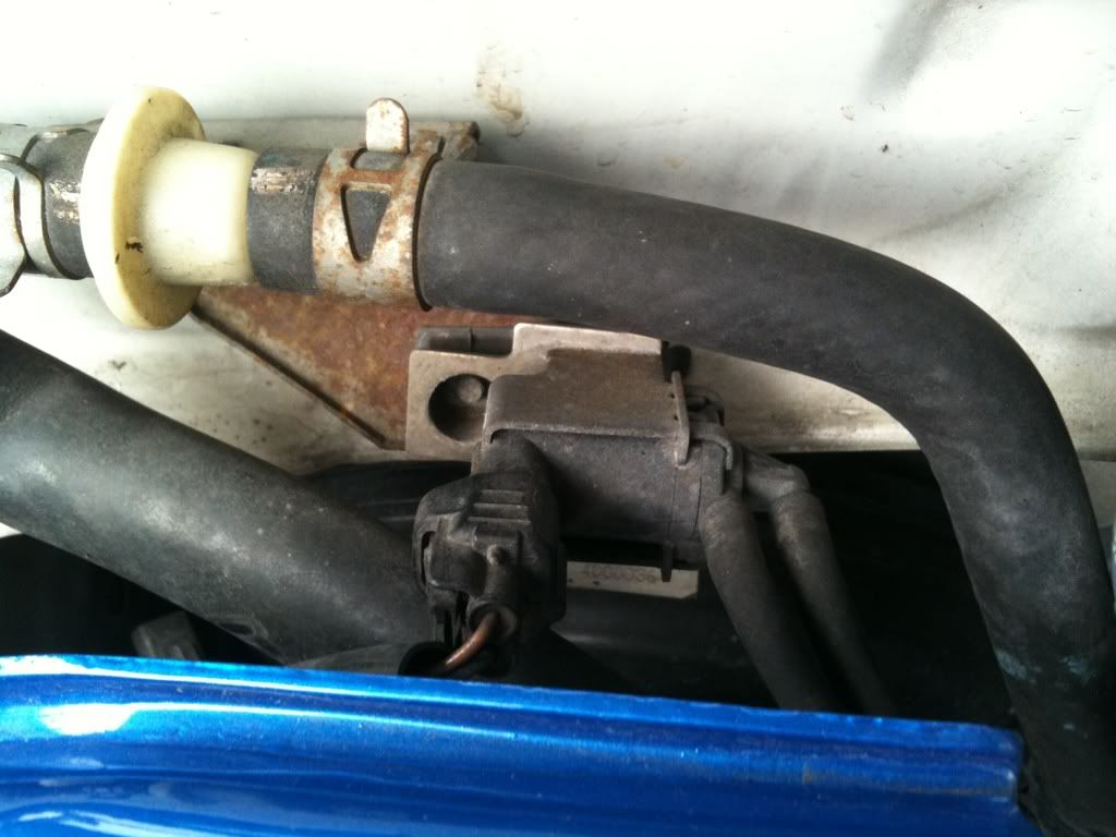

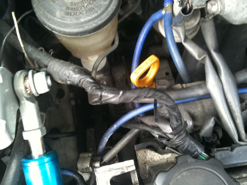

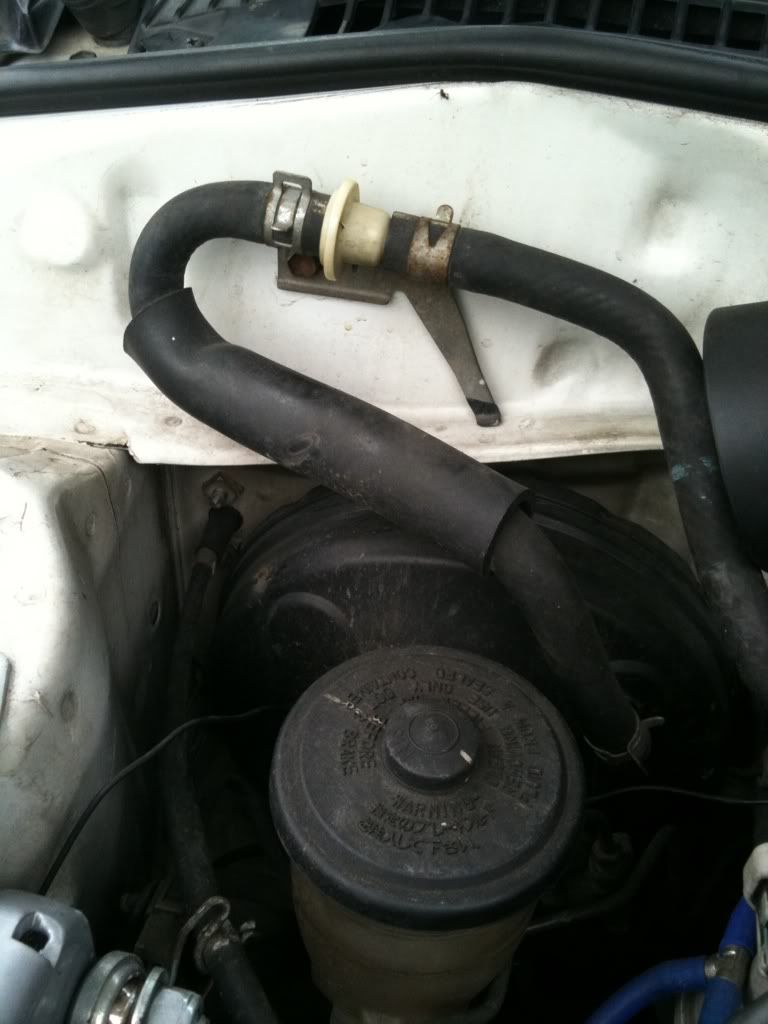

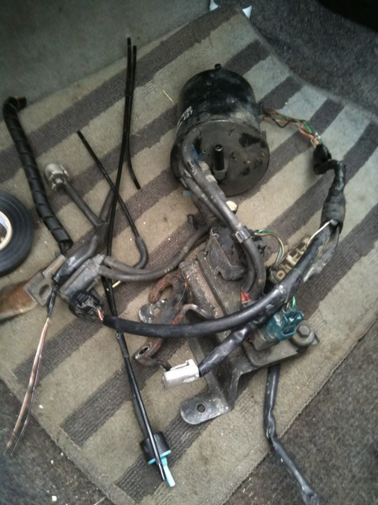

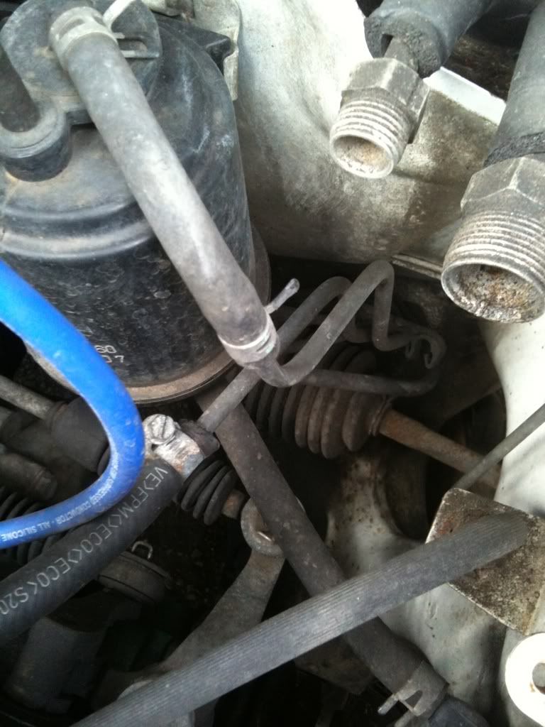

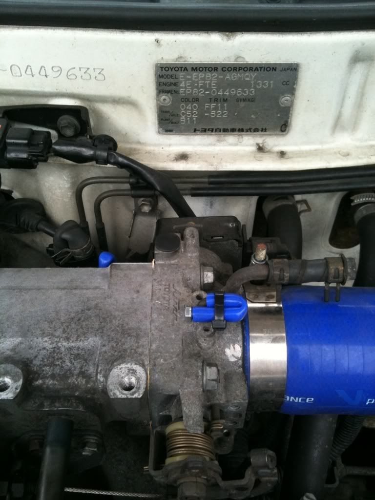

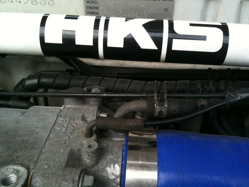

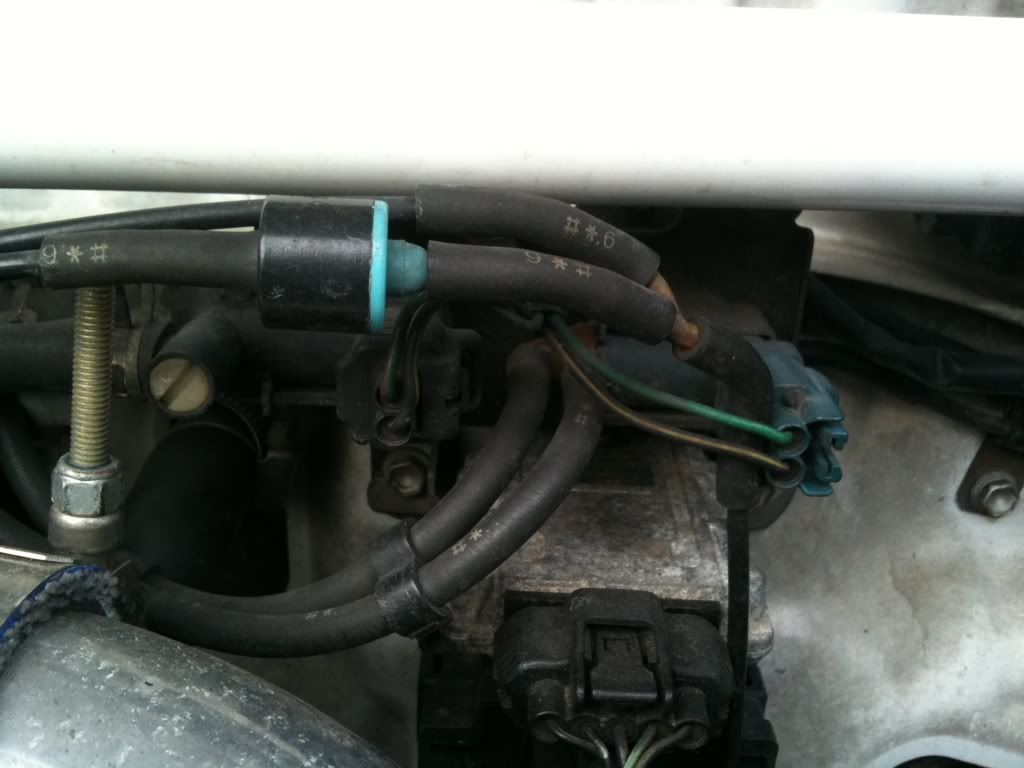

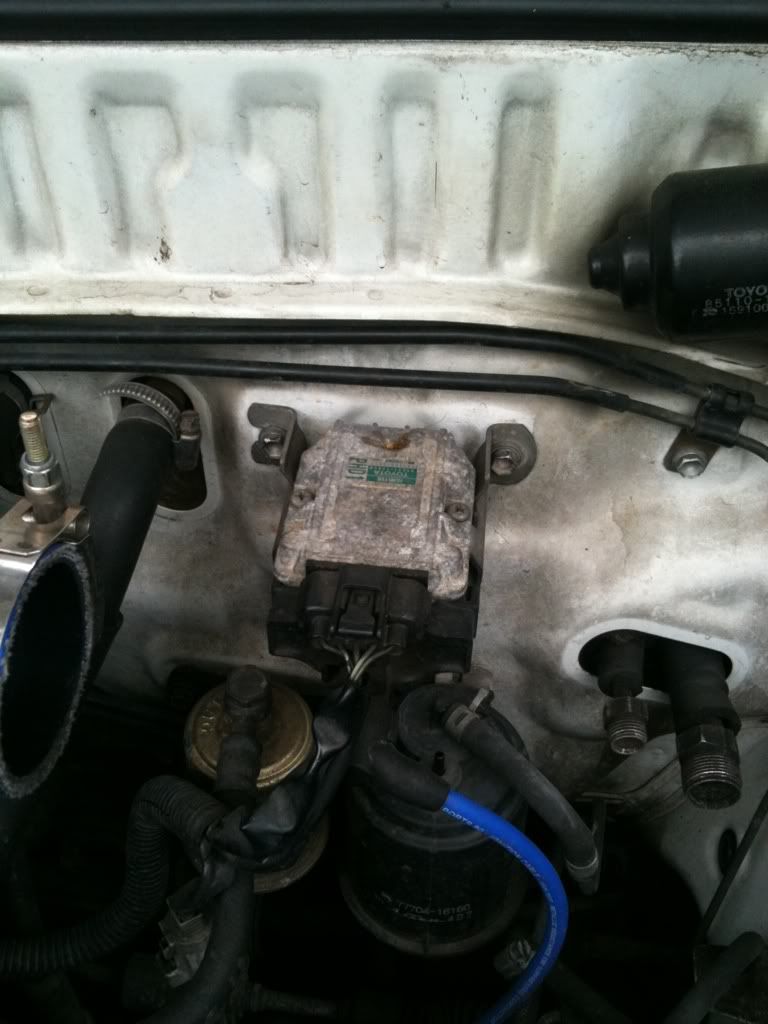

nazzurro19 Posted March 30, 2011 Author Posted March 30, 2011 right well today i decided to take out the aircon sensors wiring etc , all was going well i undid all the brackets took off all the sensors etc, removed all the plastic tubing stuff and then pulled all the bits off the inlet and pull the tube off the pvc only took about 30 mins then i decided to take all the wiring out for the clips , so started to pull it etc then it got stuck and i thought it would be a good idea to cut it so i did and this then happendreally eratic idle, whilst panicking i then realised DUH! i hadnt blocked off all the parts of the inlet so i did that and guess what same thing so i come in absolutely in tears to search the forums , then "BING" idea i remembered i forgot to put the pvc back on and guess what it was fine phew!! haha so whilst at it i decided to sort out my high idle , now the cars running sweetso heres a few pics incase any of you guys shit ya pants too or get stuck so these are the wires to the clips that are up in the left hand corner of the engine bay, all i done was cut it and taped it all up and tucked all the wires back into the plastic box thing from the back of the enginei.e. these clips so heres the before pics and the after i also got some more goodies through the post to go with the build im currently building up parts for haha a gasket , thermal wrap etcand a lil gathering of the boxes and parts i have making the GF complain lolonly got gauges left to get and oil etc then turbo and ecu and jobs done anyway as the thermal wrap was here i decided to wrap my FMIC pipe before - crappy lookingafter all wrapped n shiny n nice ad lastly one nice tidied up engine bay and then really really lastly the amount of crap and weight saving from it all sorry for the essay

Sparky Posted March 30, 2011 Posted March 30, 2011 Shit myself when you said about the erratic idle until I read on, you numpty dont scare me like that again I am gald it works anyway seeing as I havent been able to start mine yet lolNow just remove your glove box and rip the air con matrix out and that will get rid of the pipes that go through the bulkhead Looking good buddy

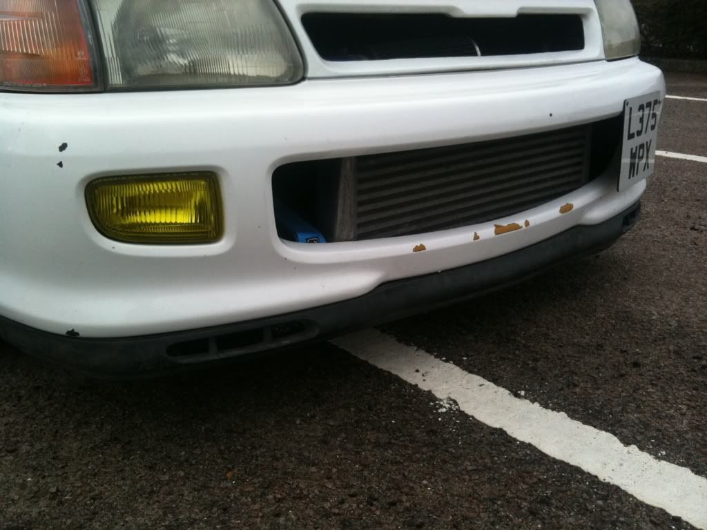

nazzurro19 Posted April 1, 2011 Author Posted April 1, 2011 just a quikie my splitter is now fitted but fook me did it hurt look at this , i done so much screwin lollike 3 blisters in one haha , next time ill get a drillanyway pics of it fitted probs bad qualityit is slighlty short as it come off a escort oh well
wull Posted April 1, 2011 Posted April 1, 2011 nice build mate out of curiosity what way is your fmic pipes routed,i thought it was strange to see the bov and the pipes heading across in front of the manifold........probably some explanation for it but i can't understand why its like that lol
nazzurro19 Posted April 1, 2011 Author Posted April 1, 2011 no idea it was on the cAr like it so probably wrong but it wont be like that way too much longer MwaHahaha
