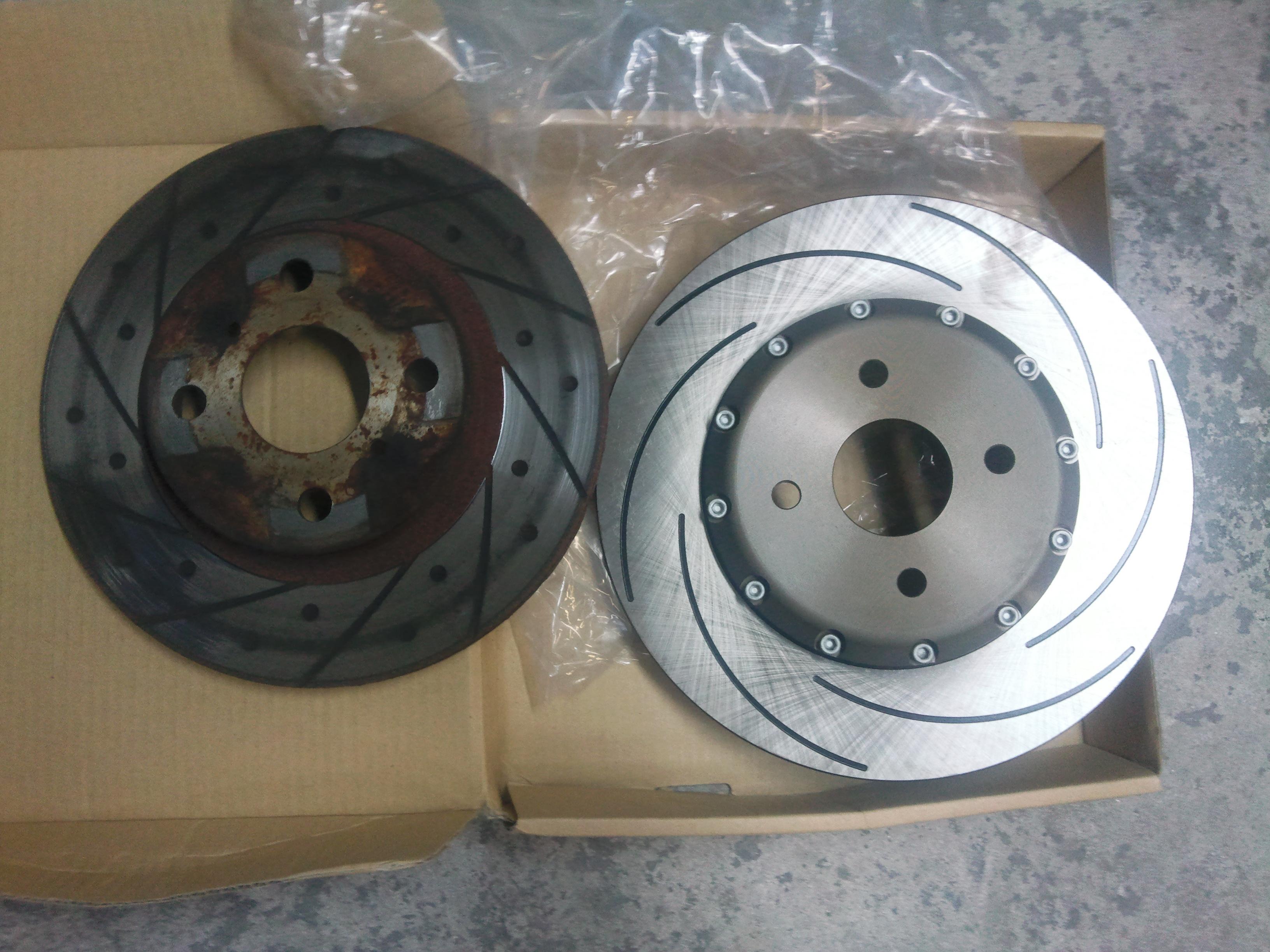

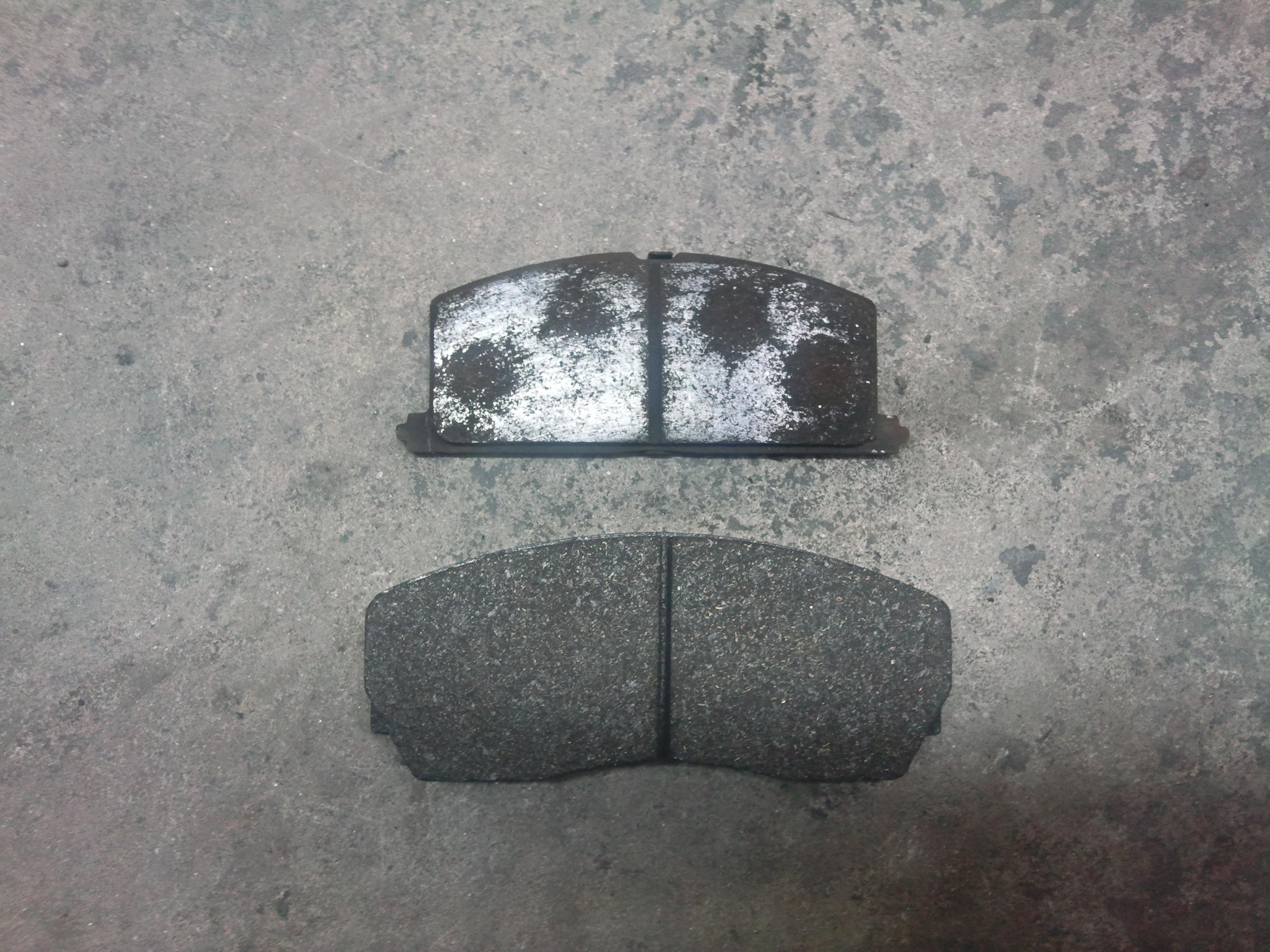

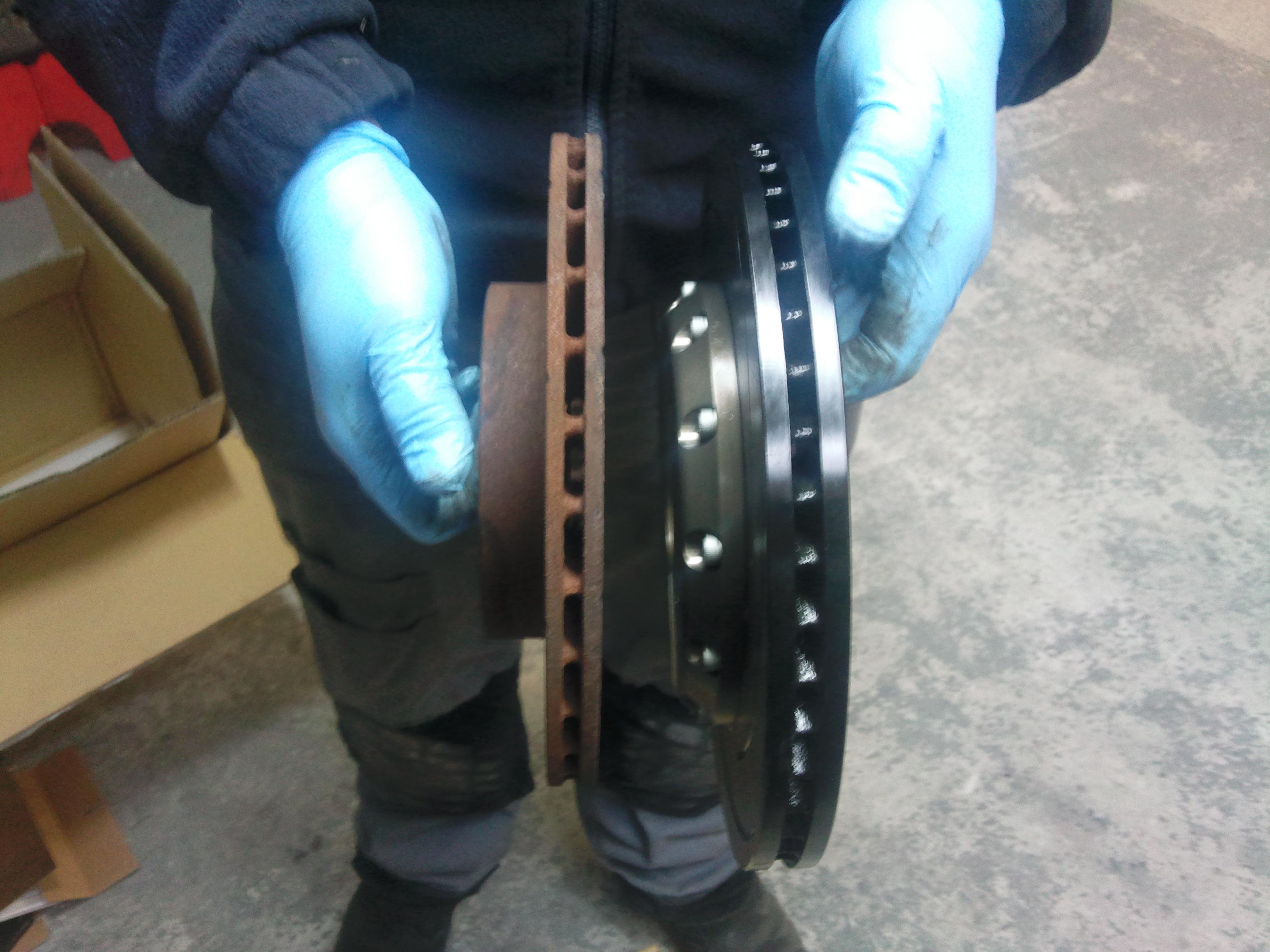

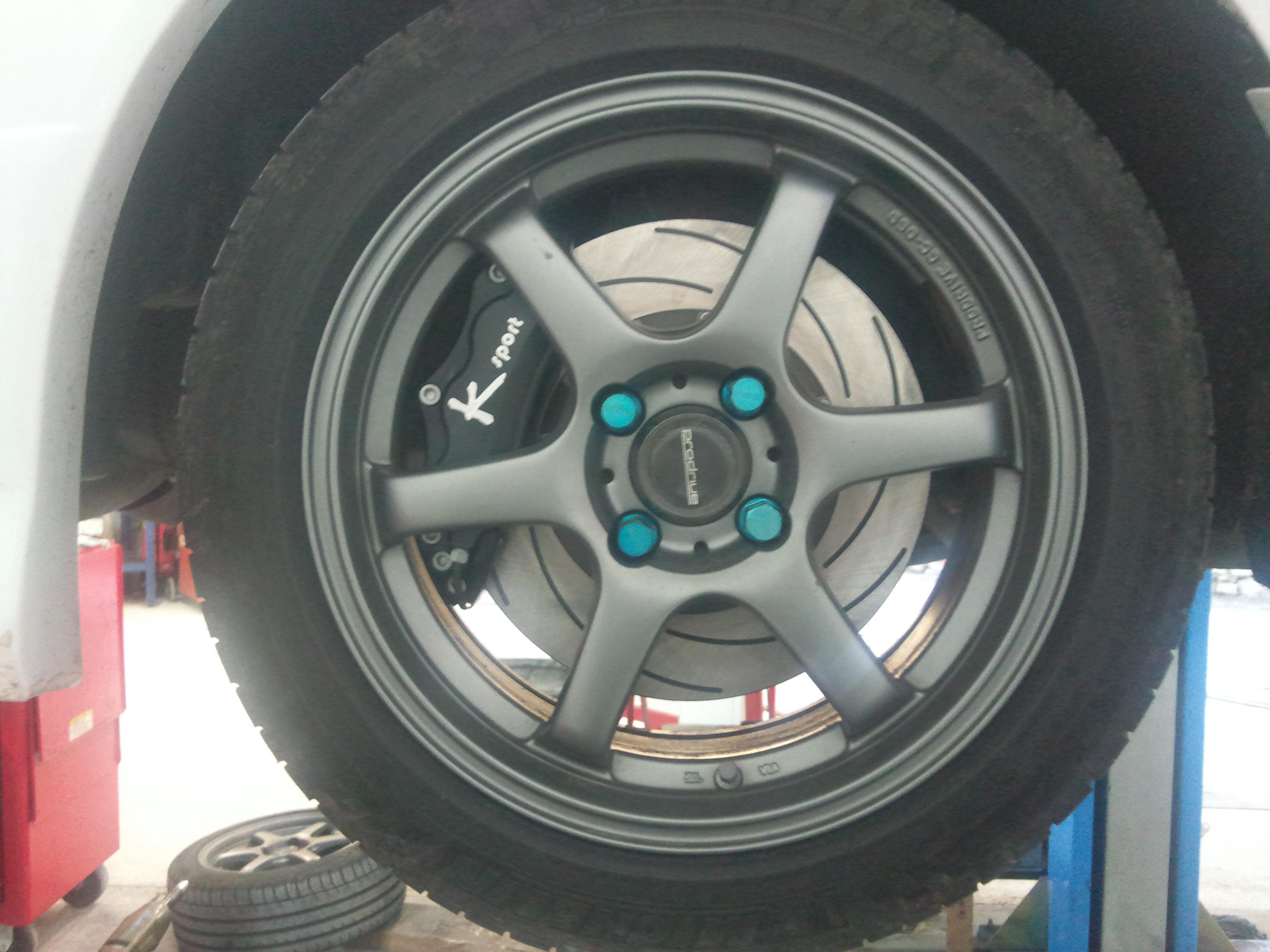

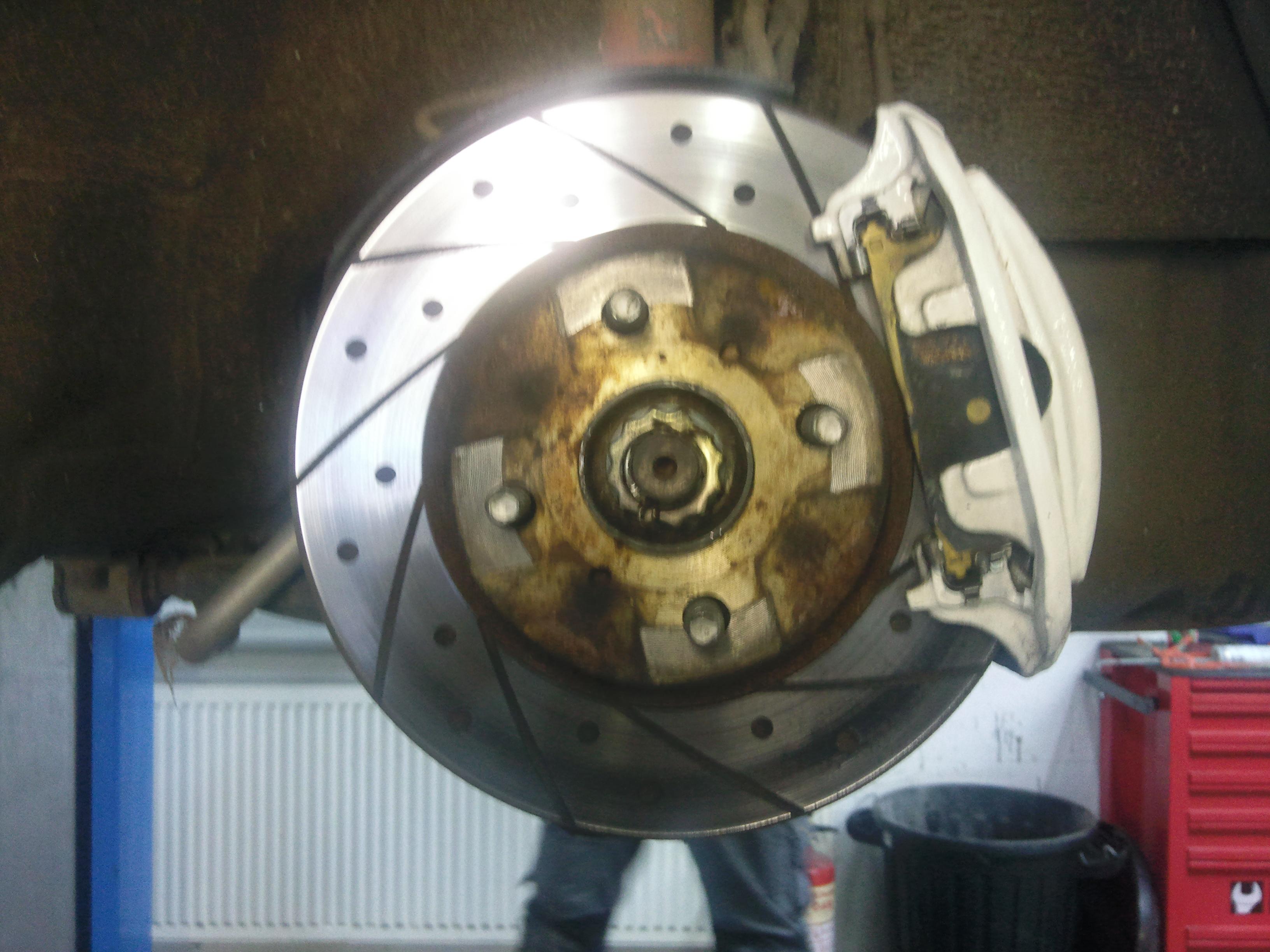

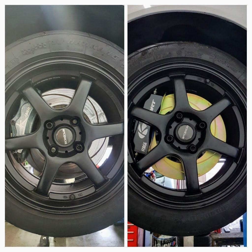

Dave D Glanza V Posted December 29, 2019 Author Share Posted December 29, 2019 On 12/26/2019 at 12:10 PM, Calum122 said: Wow that looks properly smart! Thanks calum Few before and after pics of my old brake setups Standard brakes when I got the car were absolute shite upgraded to grooved and dimpled discs ebc yellow sruff pads braided lines and performance fluid (still shite) Went for some 6 pot k sports with ferodo ds2500 pads and motul rbf 600 fluid by far the best mod I've done to this car really gives you the confidence to push when you know you can stop! I've since changed again now to the new style ksports pics to follow Quote Link to post Share on other sites

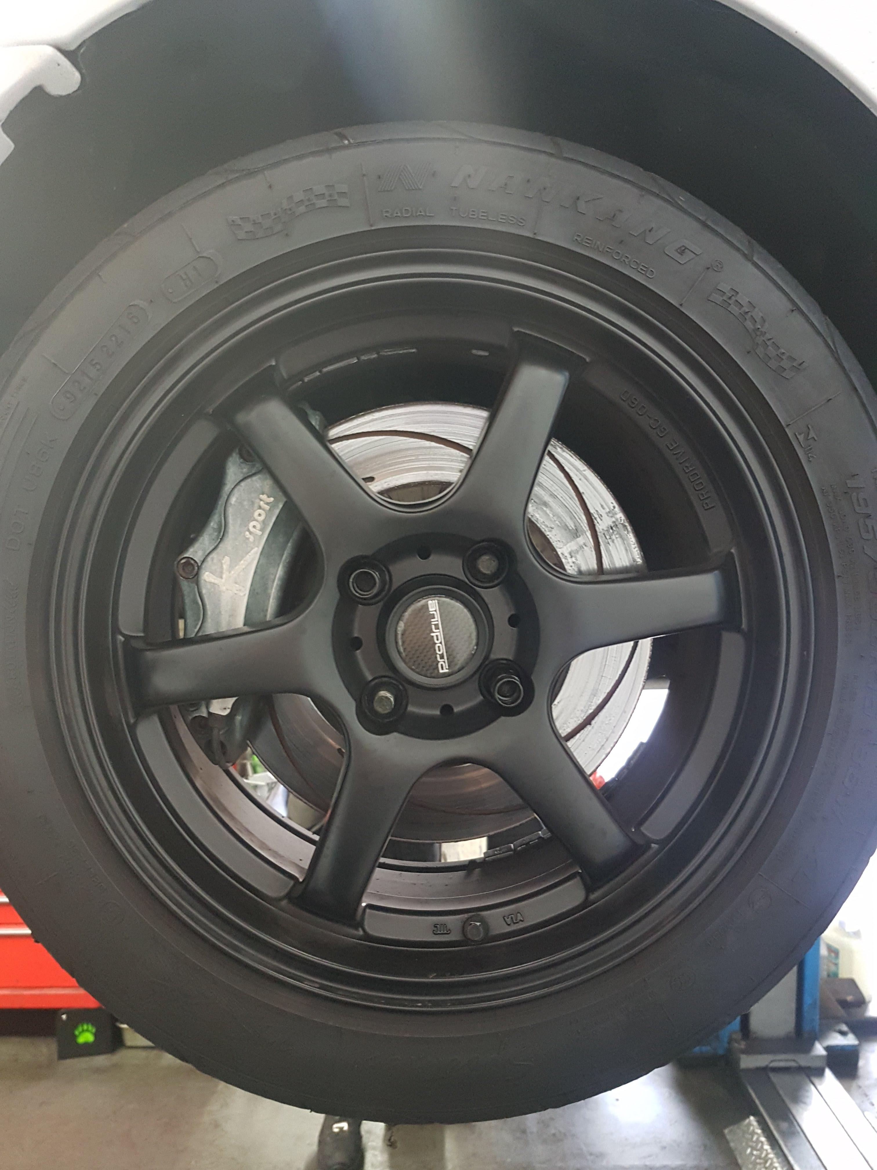

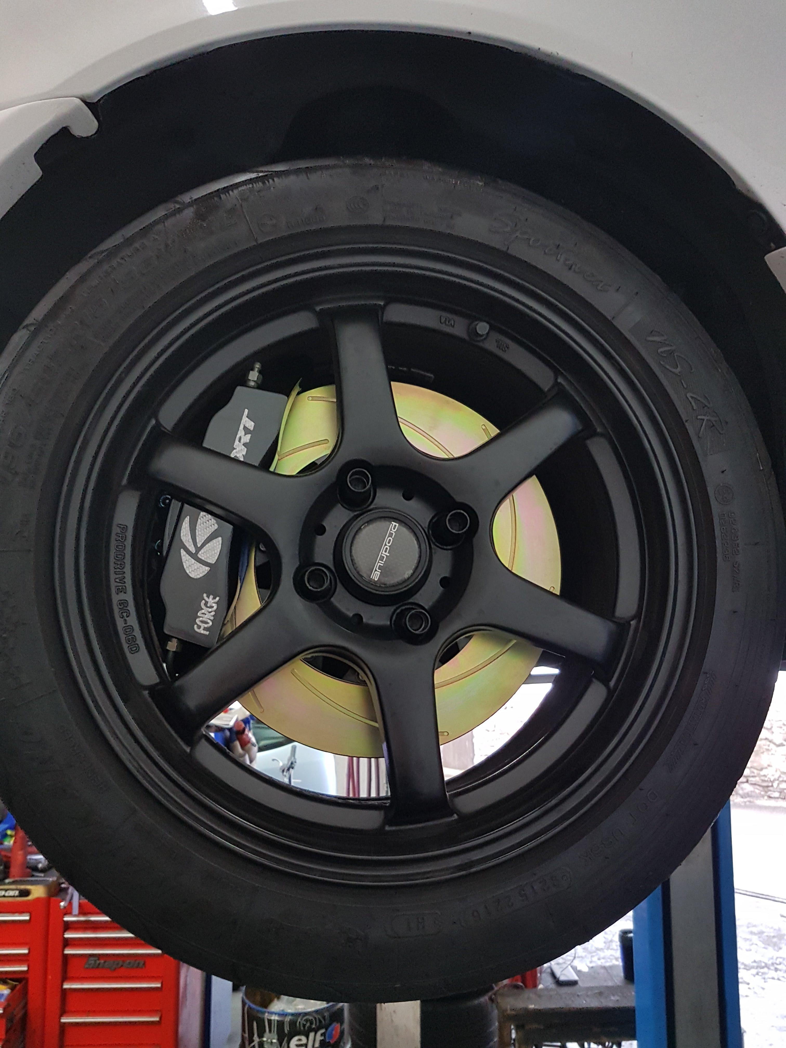

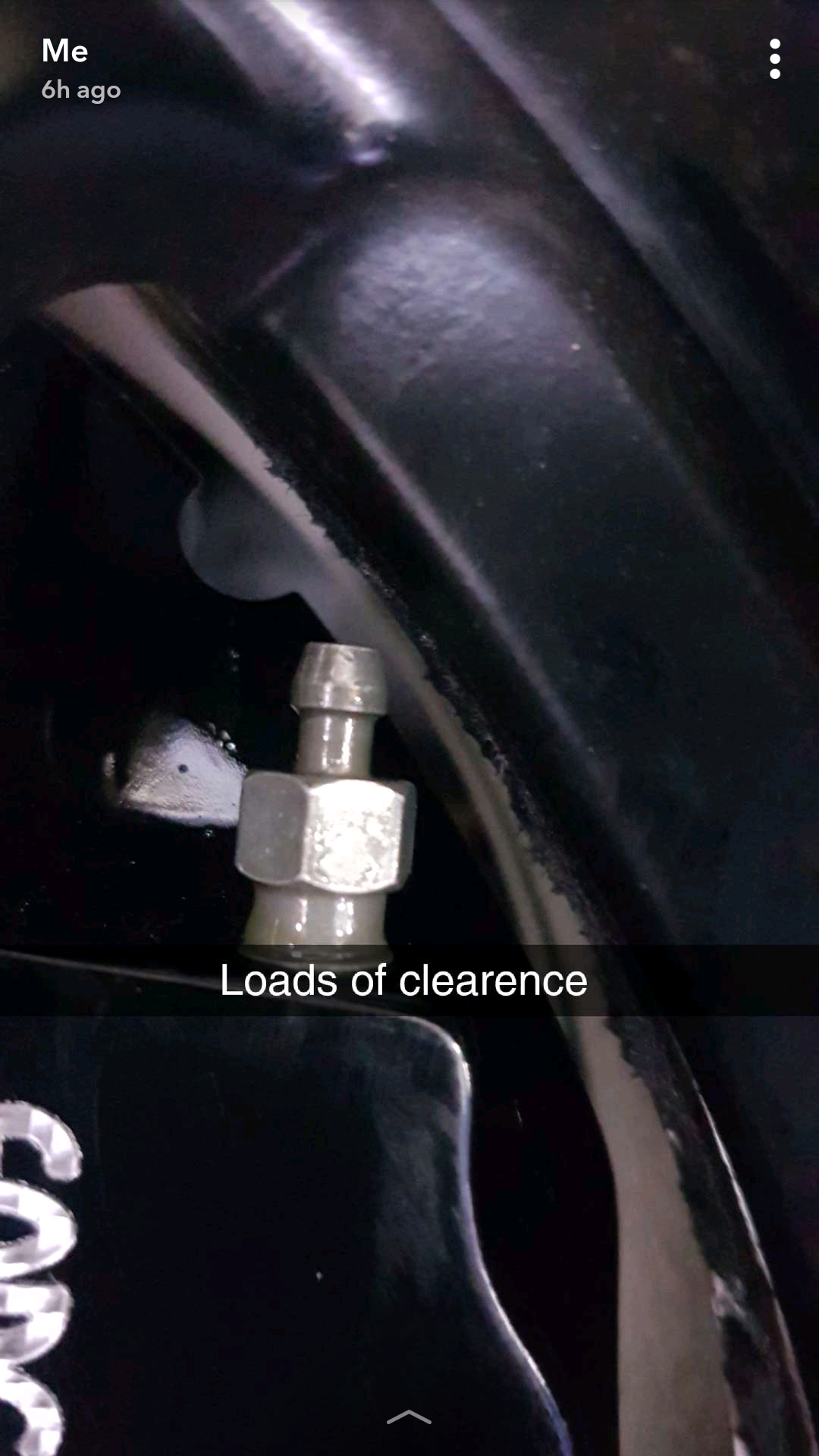

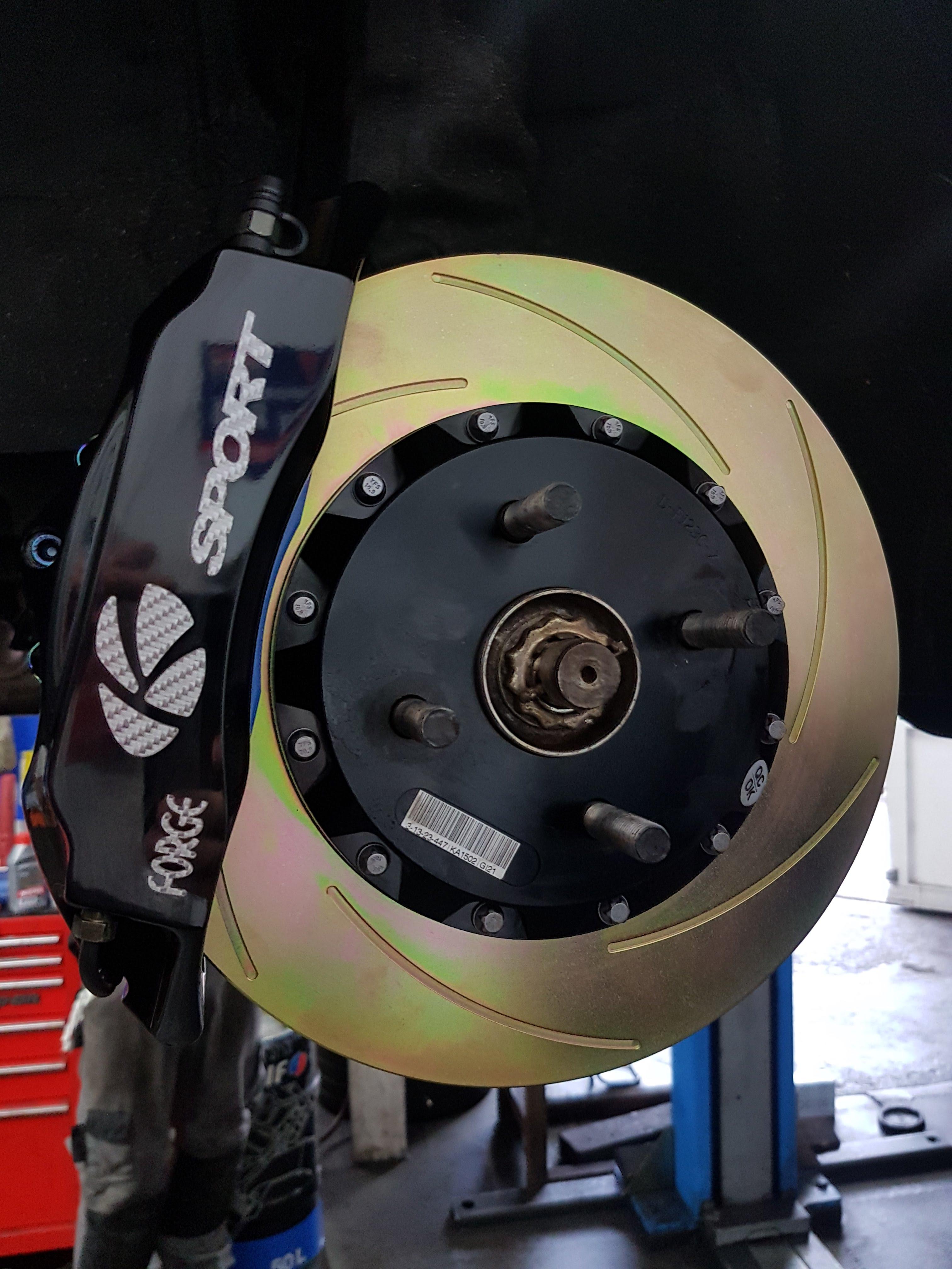

Dave D Glanza V Posted January 5, 2020 Author Share Posted January 5, 2020 Thanks guys So after a few years and some good usage brakes were looking pretty tired so I got the new style set, got in there just before the price increase so happy days. Unfortunately the clearance is worse than the old style, if you look at the pics the bleed nipple is so close to the wheel I couldn't even run the dust covers ha, it meant I had to sell not only my Ray's group nrs wheels but also my advsn sa3r my prodrive were the only wheels I had that I could use sad times Quote Link to post Share on other sites
